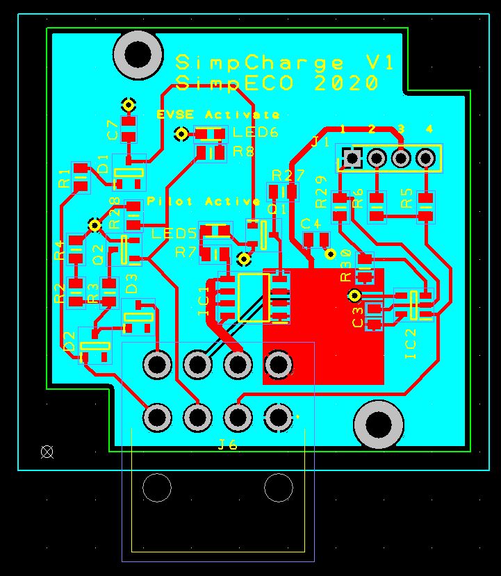

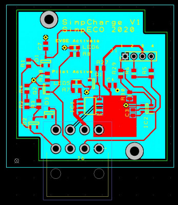

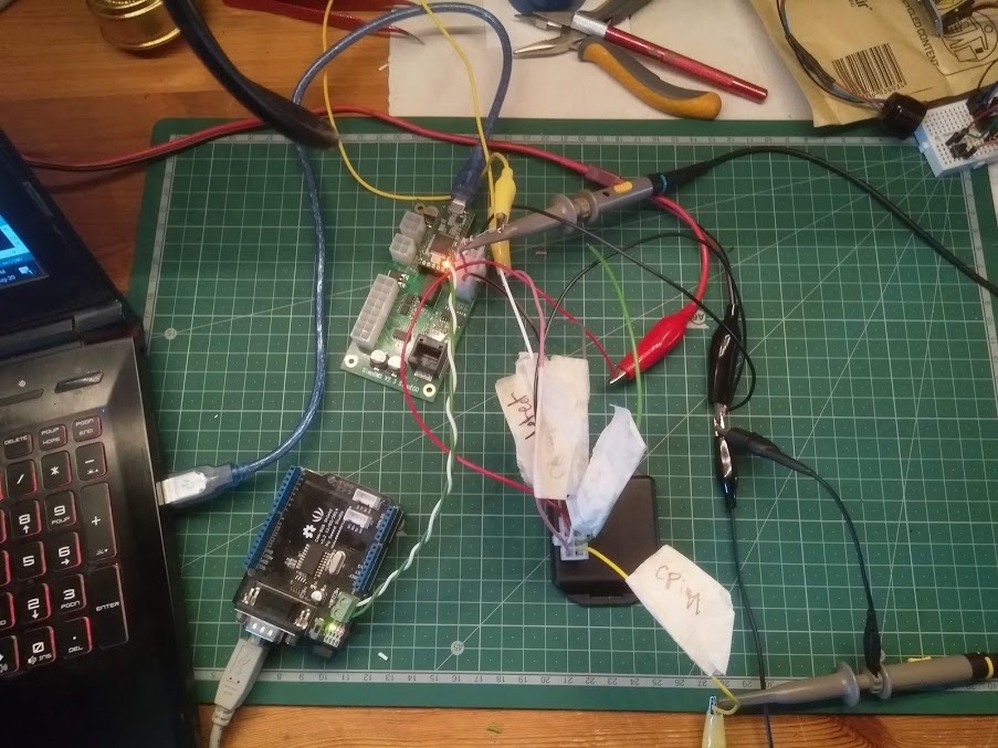

I have designed a new circuit board that will handle the EVSE signals and provide indications for Proximity detect and Pilot signal.
Features:
1- Pilot signal control, READY and CHARGE state switching via simple 12V input
2- Pilot signal detection, if any signal is present on the Pilot signal provide 12V output
3- Proximity detection, if plug resistors detected provide 12V output
4- Provide conditioned Pilot signal so SimpBMS can read the Control Pilot current limit
I have ordered the first PCBs will be looking at making up a batch once the design is validated.
Would anyone with OR without a SimpBMS be interested in this as a product?

It will create the 12V AC present signal and can use the 12V charge enable output to actually request power from the EVSE.
The biggest benefit is that it can then calculate the AC current limit based on the Control Pilot and use that to manage the DC charger.
Should probably mention that the 4 pin header is a jumper to select the different Proximity Signal settings based on the Type 1 or Type 2 and if you have a resistor in your socket.
Pricing is yet to be decided, however there is no programming once it has been tested i can just have it produced and then it can be shipped as is without further work so should be quite cost effective. Shipping would probably be close to the sales price.

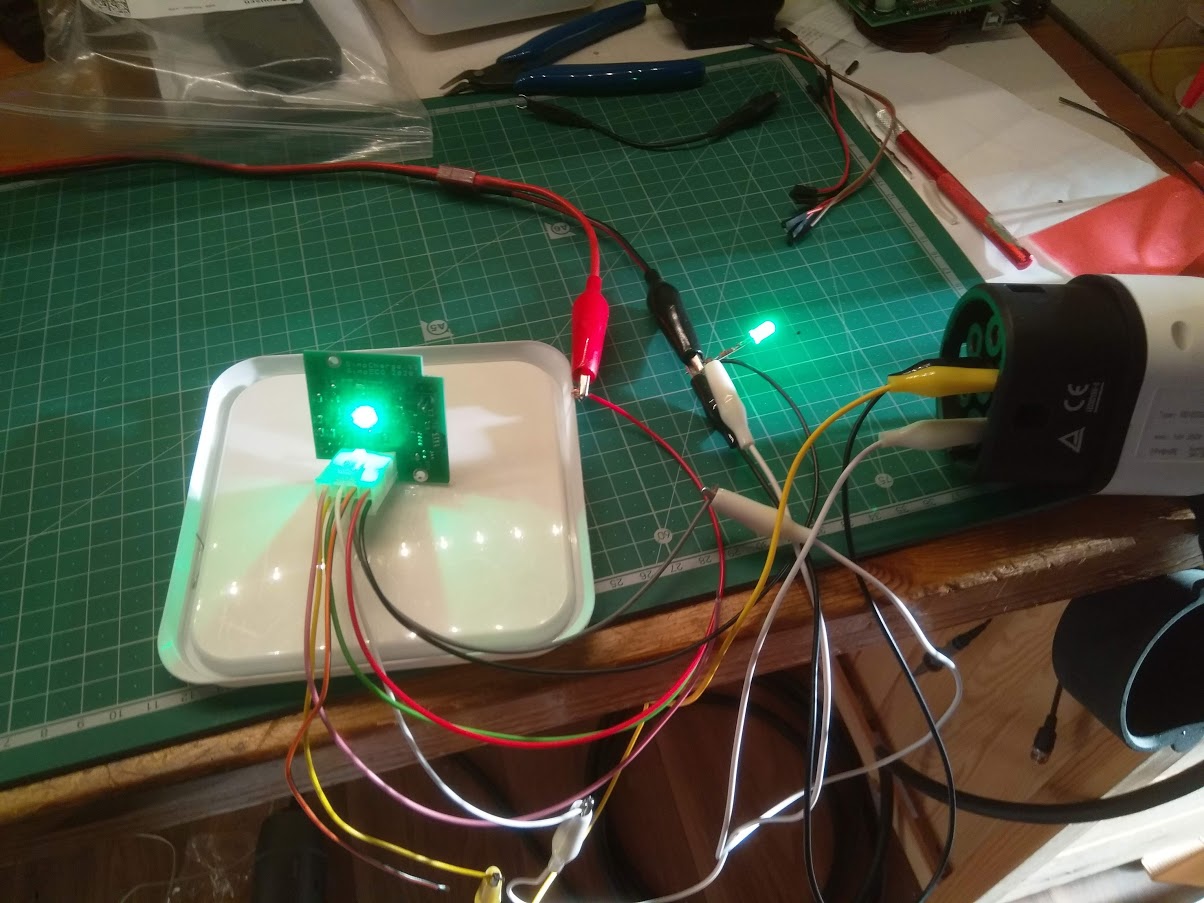

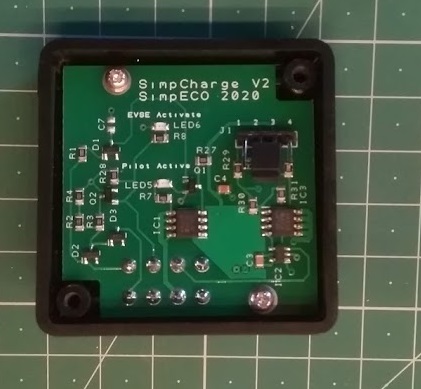

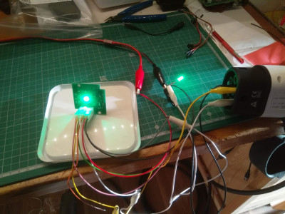

So had to make a revision, had not used the comperator before.
Now all tests out fine. So I am ready to order a small batch to start selling. First need to work out an enclosure solution.
Please have a read of the Manual and let me know if it all makes sense or if there are questions.

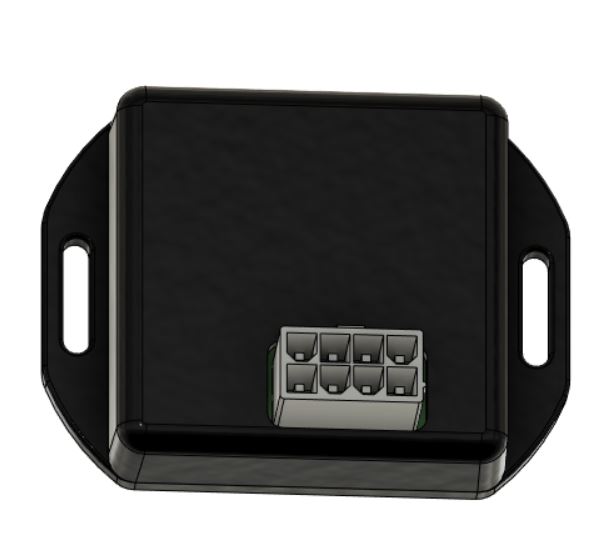

Reached out to Hammond Mfg to get quotations on enclosure modification costs.
Hopefully I will have some sort of price point figured out end of this week or beginning of next.

I do not know if its appropriate to discuss pricing anywhere but in the sales section, can create a topic there if required. Will create one once the first batch is in.
Having done testing I am ordering a batch and some enclosures to go with it. Hopefully will have an update on timing.
Pricing works out at 30GBP including VAT, seeing that this will have an enclosure it should be ok to ship with letter postage.

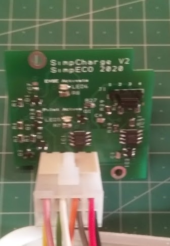

Good news everyone I received the pcbs and housings this week. Completed testing and now I am finishing the documentation.
The integration with the SimpBMS is also completed, had it all running on the bench in a hardware in the loop setup.
Pricing will be 32gbp including vat for the SimpCharge with mating connector.
