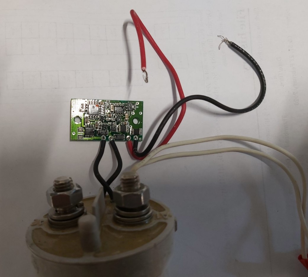

so here is the contactors I will be using.
The pic has the economiser pcb, can I just remove the pcb and use it without, I assume they are just the coil wires.
Are the white wires volt free contacts when the contactor is energized ?

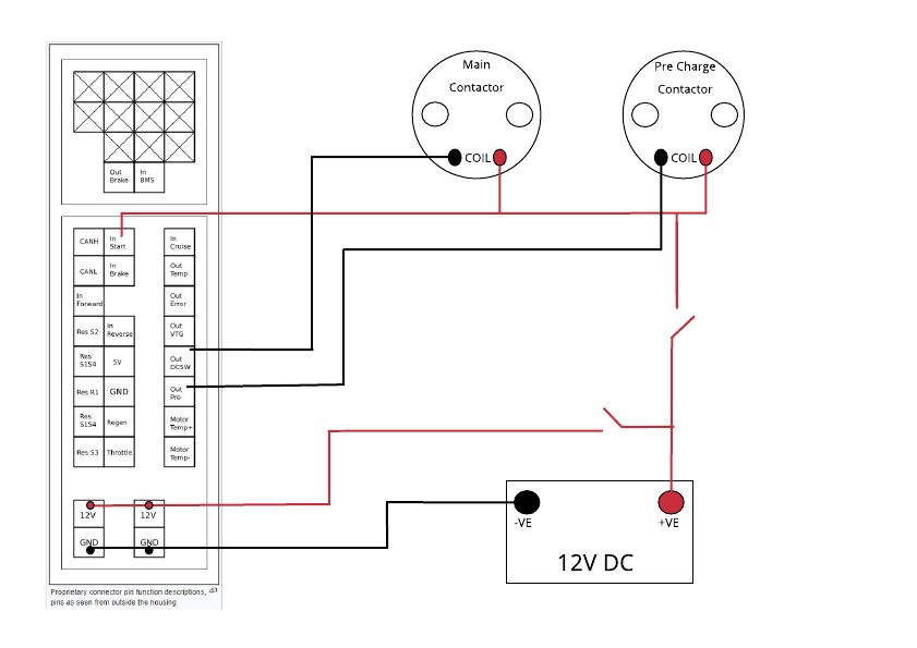

This is how I intend to connect up to the leaf board.
Can someone tell me if this correct ?

Re: Pre-charge and main contactor connections
Wrong
This is correct, the openinverter does not have PWM economizer output, as far as I know.
What is controlling your Negative contactor, normally the BMS
OK.Thanks
So there is no switch on the positive 12v to the contactors ?
So the economizer style contactors are suitable then for this setup.I might try and get one of the leaf contactor packages
I don't know how the Negative Contactor is driven in the OI Mainboard but as a rule we don't use external BMS to control this because of the risk it will destroy the inverter power stage if it drops out under power (a common failure mode when the Tesla boards are wired up incorrectly). We really need Johannes or someone with detailed knowledge to tells us what they have in mind.
IIRC the Leaf Contactors don't have economizer circuits built in.
A quick look at Main Board Rev 3 wiki (here) suggests that the negative contactor is not driven by the OI board. My guess is it's driven by the ignition switch but Johannes will need to confirm that.Kevin Sharpe wrote: ↑Fri May 22, 2020 9:12 amI don't know how the Negative Contactor is driven in the OI Mainboard but as a rule we don't use external BMS to control this because of the risk it will destroy the inverter power stage if it drops out under power (a common failure mode when the Tesla boards are wired up incorrectly). We really need Johannes or someone with detailed knowledge to tells us what they have in mind.

I've attached the contactor datasheet. You can see the EV200HAANA01 part number tells you;
EV200 - 500A 900V contactor
H - Normally Open Contacts
A - 9-36V DV coil (requires external coil economizer)
A - 15.3 inch coil wire
N - no coil connector
A - bottom mount
01 - unknown
I don't think you can drive the main contactor direct from the OI board. The contactor datasheet tells us the inrush current is 3.8A and holding current 130mA whereas the OI board is rated at 300mA max (150mA max for precharge output). A lot depends on the economiser circuit and whether it has a soft start feature. We really need Johannes thoughts on this and ideally a wiring schematic
I see my thoughts were requested a number of times
Agreed you cannot drive any larger relay with the mainboard i.e. the ULN2003 directly - don't ask me how I know. A very effective solution is a P-channel mosfet whose gate is tied to source via 1k or so and is then pulled low by the respective precharge or dcsw output from the mainboard. Source is connected to 12V, drain to your relay, other end to GND permanently. The ULN2003 DIP version can directly switch a Leaf relay though.
I also agree that it is a bad idea to have the contactors controlled by anything else than the inverter. If you open the power path while in regen voltage will shoot up so fast that the slow overvoltage limit cannot catch it. Booom.
