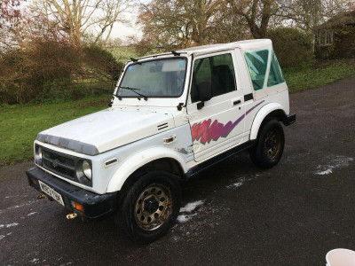

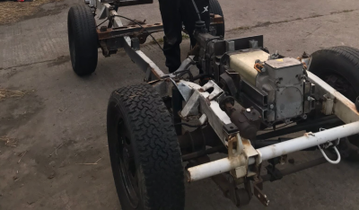

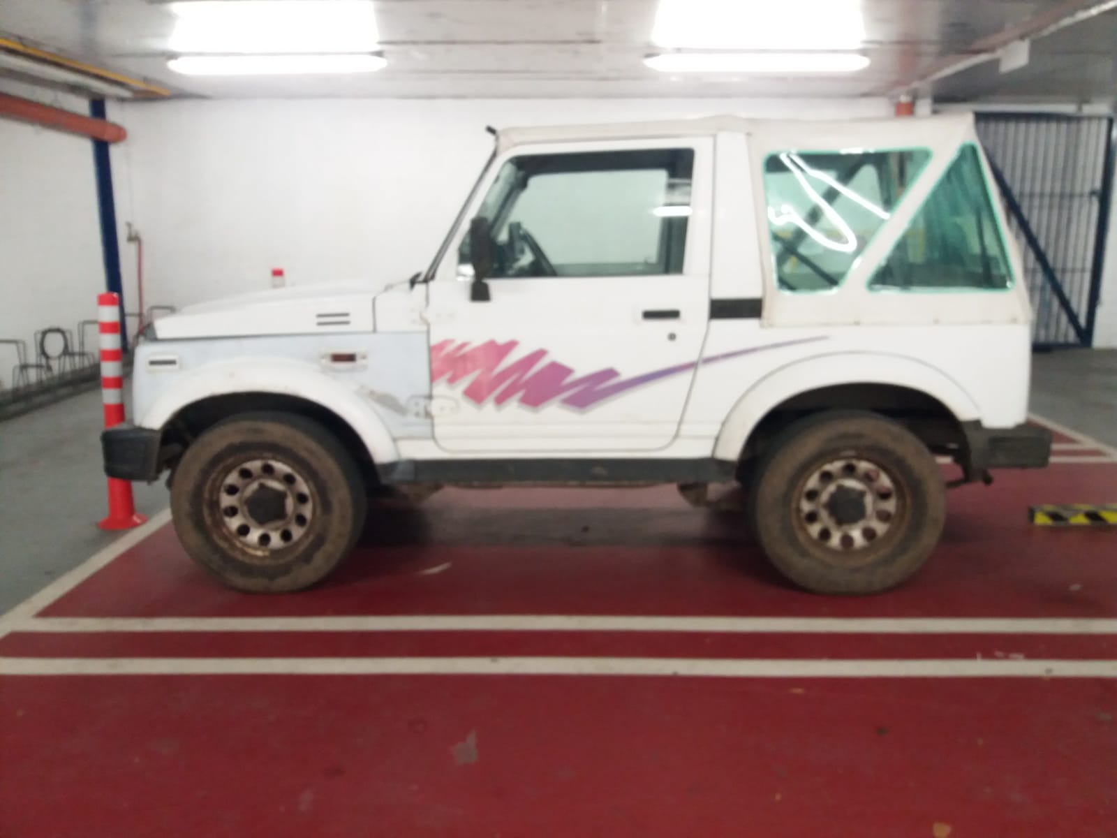

Hello all!
My name’s Hugh and I’ve been scheming a DIY conversion for the last few years.
I discovered Damien’s channel though boards.ie (of all places) and have been steadily subscribing, liking and sharing since.

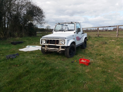

Just before Christmas I bought a 1994 Suzuki Samurai unseen on Ebay, picked it up near Portsmouth on the way back from a London work trip (note: not really on the way), and then cannonballed it to Holyhead for the ferry.
It took me seven hours and as I entered Wales, I realised the soft top had a leak. I missed the ferry, and she was duly christened Holly after the lengthy stay over.

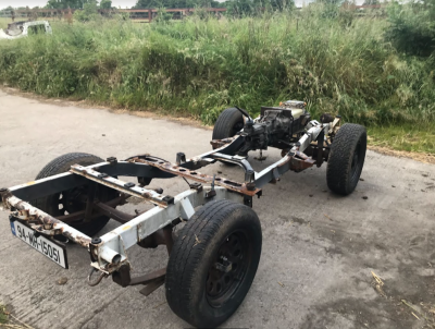

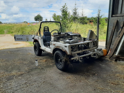

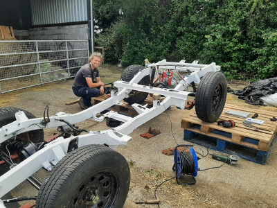

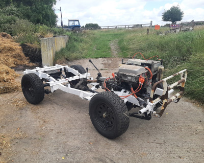

Here she is in all her glory. I’ve been gradually repairing rusty parts of the body since the weather improved.
I’ve signed up for a beginner course with Damien and Kevin, and since it’s been moved until August thought I’d set up this thread to take some project suggestions from the experts here. I’d like to have most of the parts together so I can crack on after the course. I’ve a master’s in mech engineering, some DIY experience, and safe to say the electronics is a learning process.
Here are some of the design considerations:
- Top speed: Probably for the best she doesn’t top 100km/h
- Acceleration: Nippy, not thrilling
- Range: Would really like to be able to get to the west of Ireland (I live in Meath) without having to do too many stops, so ~150km would be sweet (but probably ambitious).
I’m very much coming at it from the environmental/sustainability/circular economy side of things, so I want to make the entire thing out of upcycled parts if I can.
Current thoughts:
- Prius Gen 2 inverter/converter/charger with Johu board (the potential to reduce cost here is amazing, seriously good work!)
- Existing Suzuki 5 speed transmission and 4WD transfer box (would have loved to go full Bexus on it, but transfer tunnel not big enough for the GS450h monster ☹)
- An AC motor. Still doing a lot of thinking here and haven’t come up with a best option yet. Suggestions appreciated!
- I have ~7kwh worth of miserable lead acids for test purposes but will look to follow Damien’s lead and scavenge hybrid batteries as cost effectively as possible.
Thoughts and suggestions appreciated!
Cheers,
Hugh

I am sure outlander motor would be a great choice. It is a 10pole motor so this means lots of torque at lower end of RPM. Nice car. I am sure you can get 30kwh in it if you work hard to fit some up front.

I got a used Siemens 1pv5135 motor, Prius gen 2 inverter and controller board during lockdown and after attending the New Electric Ireland course a couple of weeks ago have started to bring it all together. Should hopefully get it spinning in manual mode tomorrow, and need to get a resolver plug for the motor to get that wired up.
I'll document as I go, but so far I can just say if you're still looking for a good donor vehicle watch out for rust.
Mine might need some chassis welding unfortunately.

Here's the latest:
- Removed body from chassis earlier this summer to fix body rust.
- Welded some patches in the chassis body mounts.
- Coupled the Siemens to the 5 speed manual transmission. I'm nervous that this could be an obvious point of failure, given the rate that Damien chews through transmissions in his BMW.
- Designed and fabricated a motor mount and put the Siemens and transmission back in the chassis. Pretty happy with how that turned out. I was able to use the existing motor mounts and it fits well.
I can get 3 where the old fuel tank was, 6 in the back if I ditch the seats, but I'm finding it hard to fit both the remaining block of 3 cells and the Prius Gen 2 inverter up front.
Task list at the moment:
- Battery boxes
- Finish welding body and refit (waiting on new sills to arrive)
- Install cooling system
- First roll
- Figure out the Zoe BMS
- Figure out Prius Gen2 charging or install an outlander charger
- Power brakes
I also have a Gen2 Toyota Hilux Surf (4runner) that has a diesel leak and I would love to convert.
Any ideas on that from the community would be great. Currently watching the Beached Whale build with strong interest.

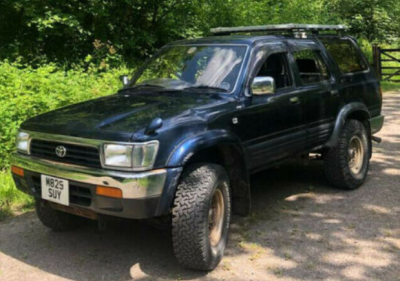

That's the hilux in the background??? Would love to see that done also
hugow93
- Posts: 61
- Joined: Mon Feb 24, 2020 9:33 pm
- Has thanked: 27 times
- Been thanked: 9 times
Re: Upcycling a Suzuki Samurai
Thanks Neil! Spent all weekend measuring it up again, and finally happy with battery box size and location. I know you had your boxes custom made, but I'm going to scour the net first to see if I can find some cheap steel cases that would work to save cost.
That's it alright, another picture below. Pie in the sky until I get the first car rolling, but unsure what else I would do with it!
If/when I get to it I'll be using your build as a template without a doubt. The one added difficulty is that the transfer case is part of the auto box so would have to get a transfer case from a manual.
The Surfs tend to be a fair bit cheaper than the pure Hilux, early models of the pickup can't be had cheap in any condition.
