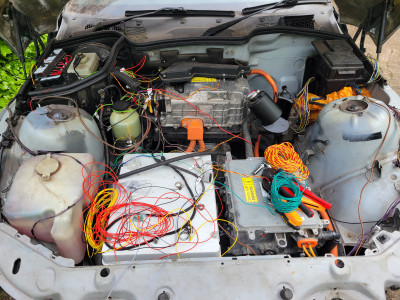

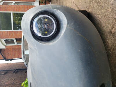

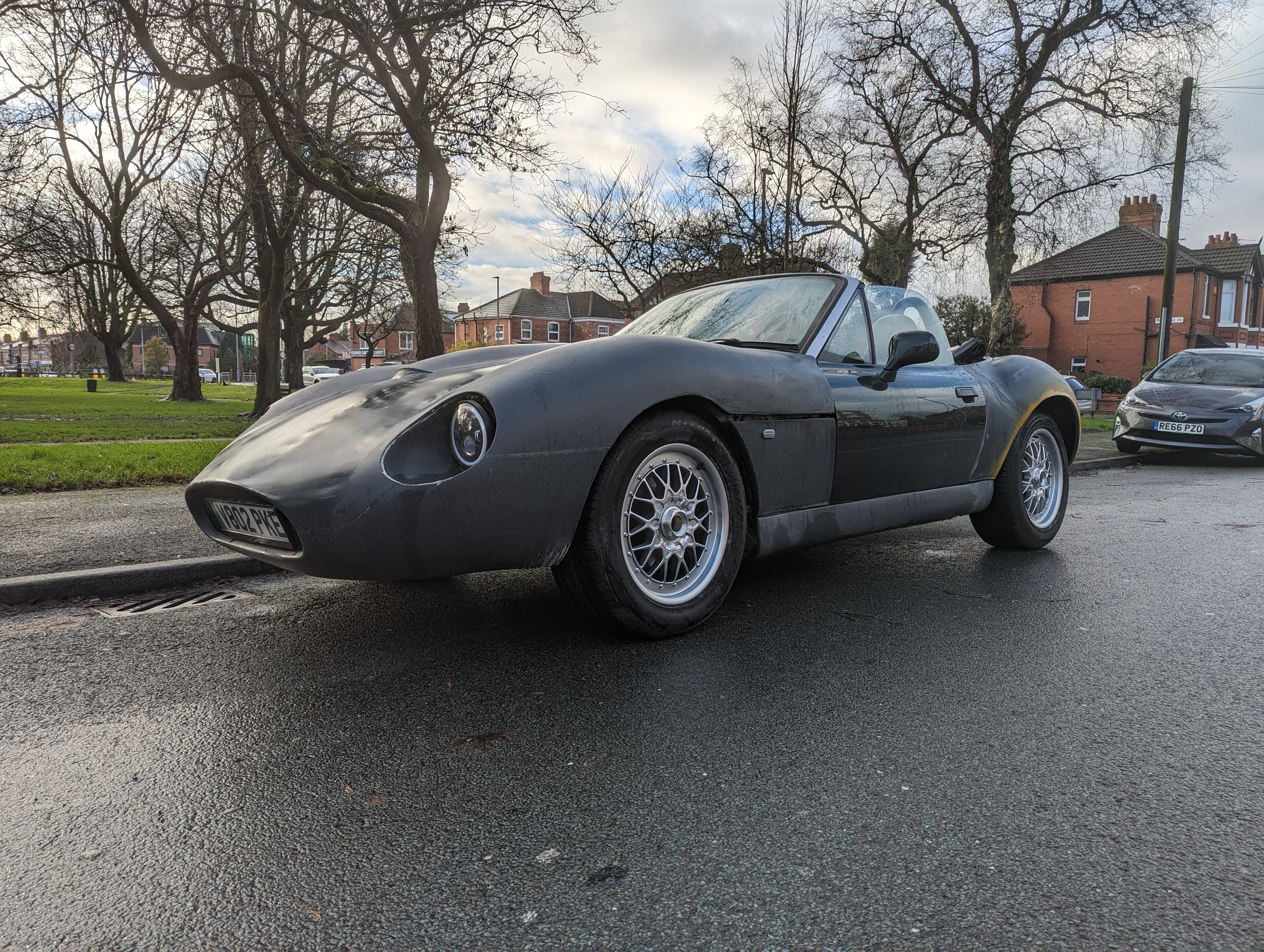

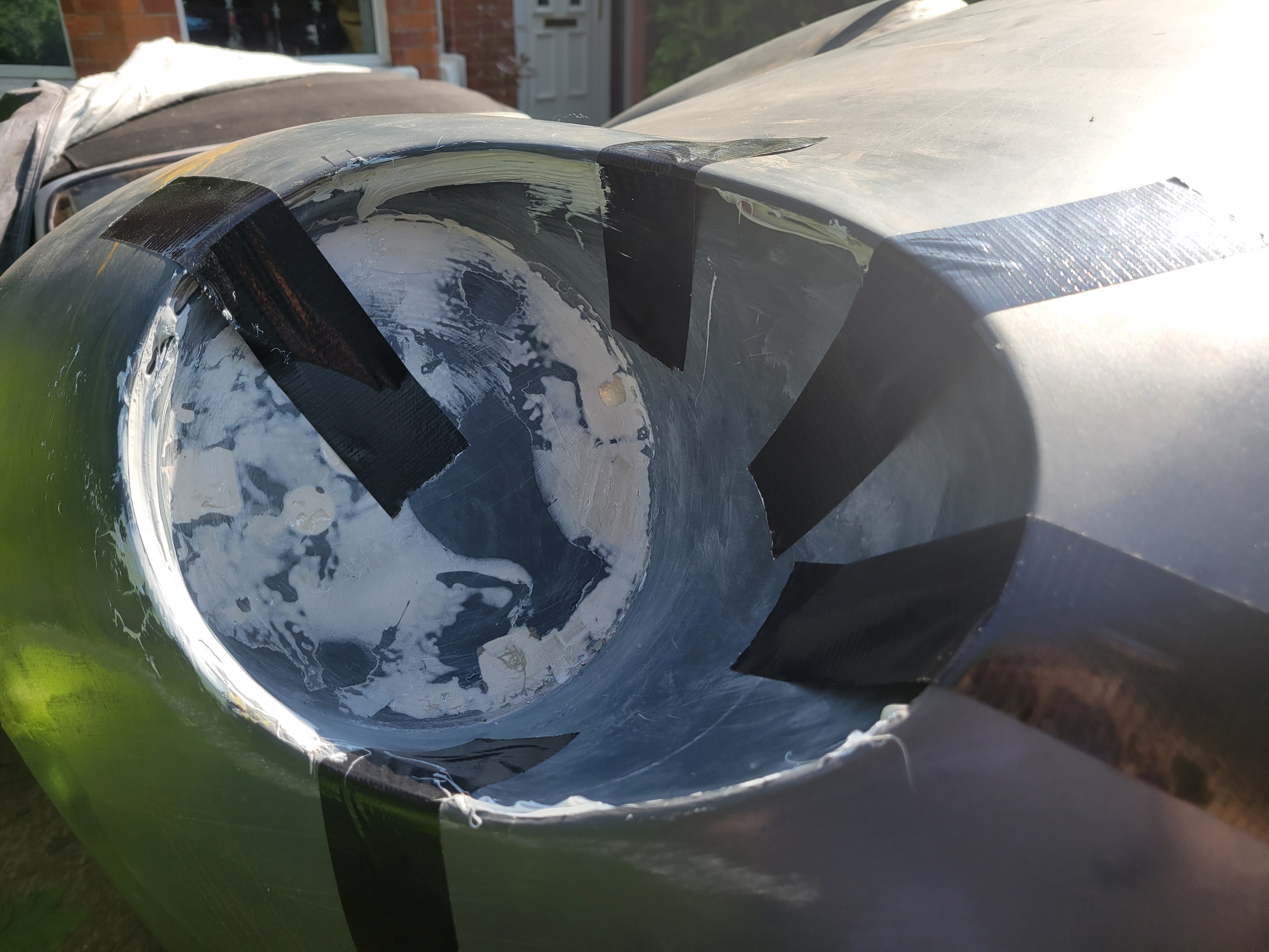

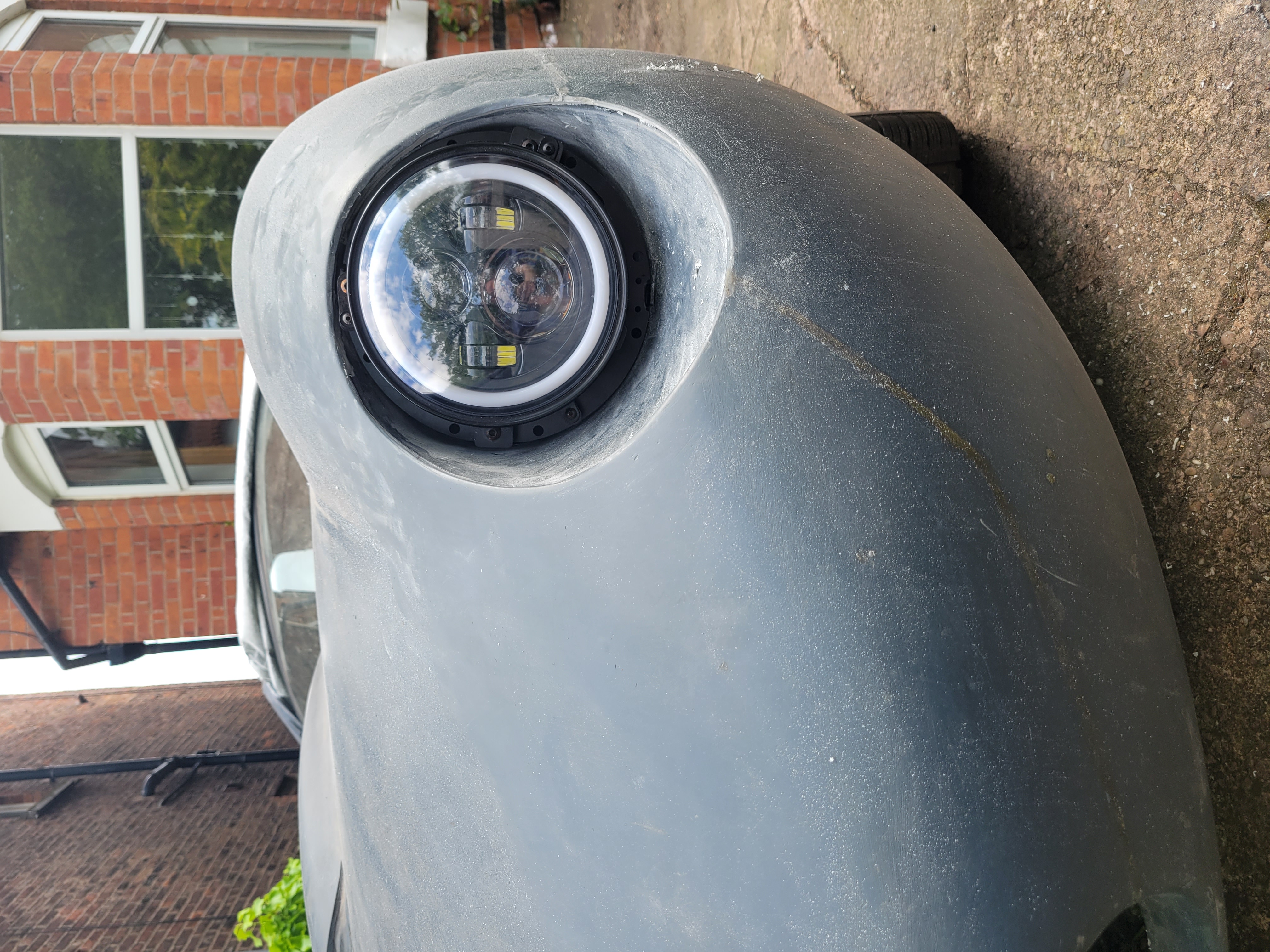

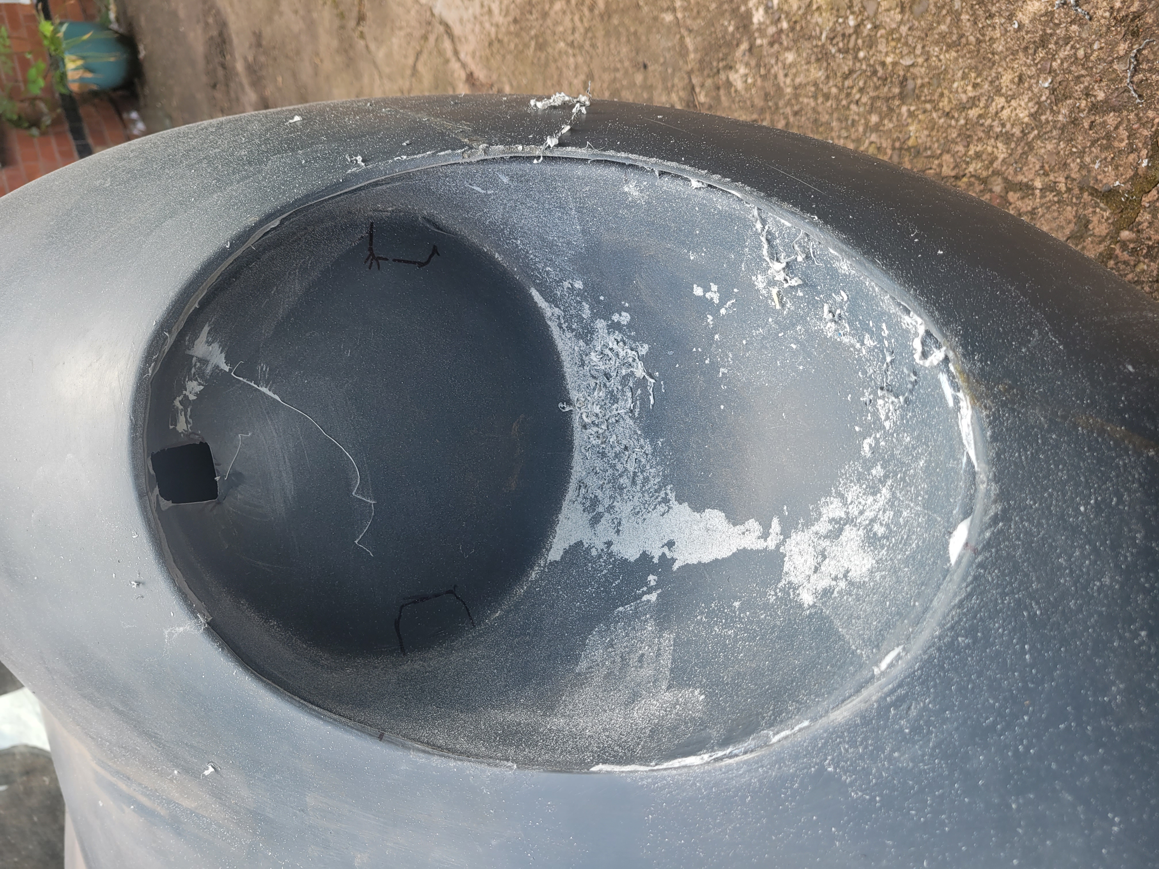

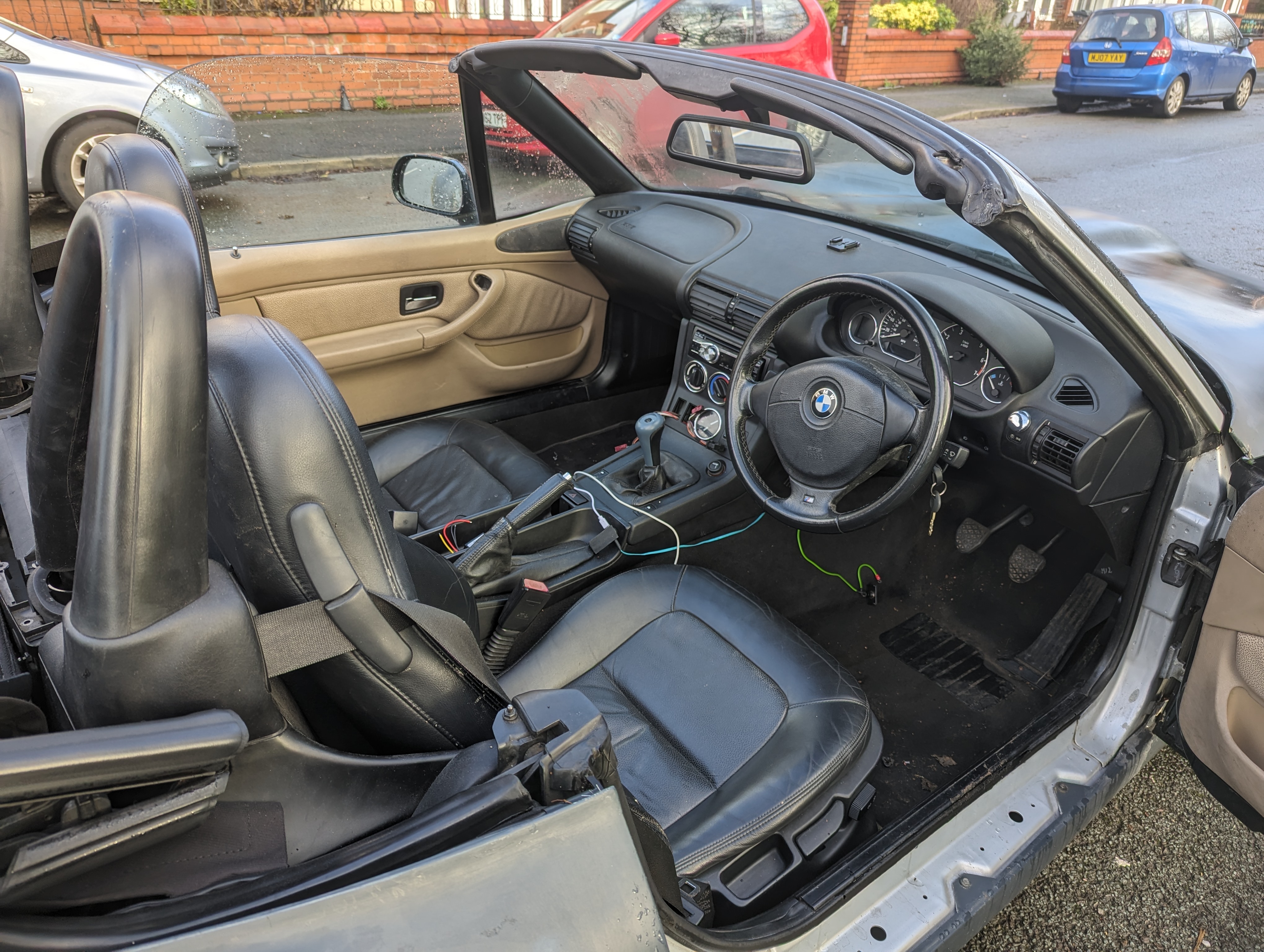

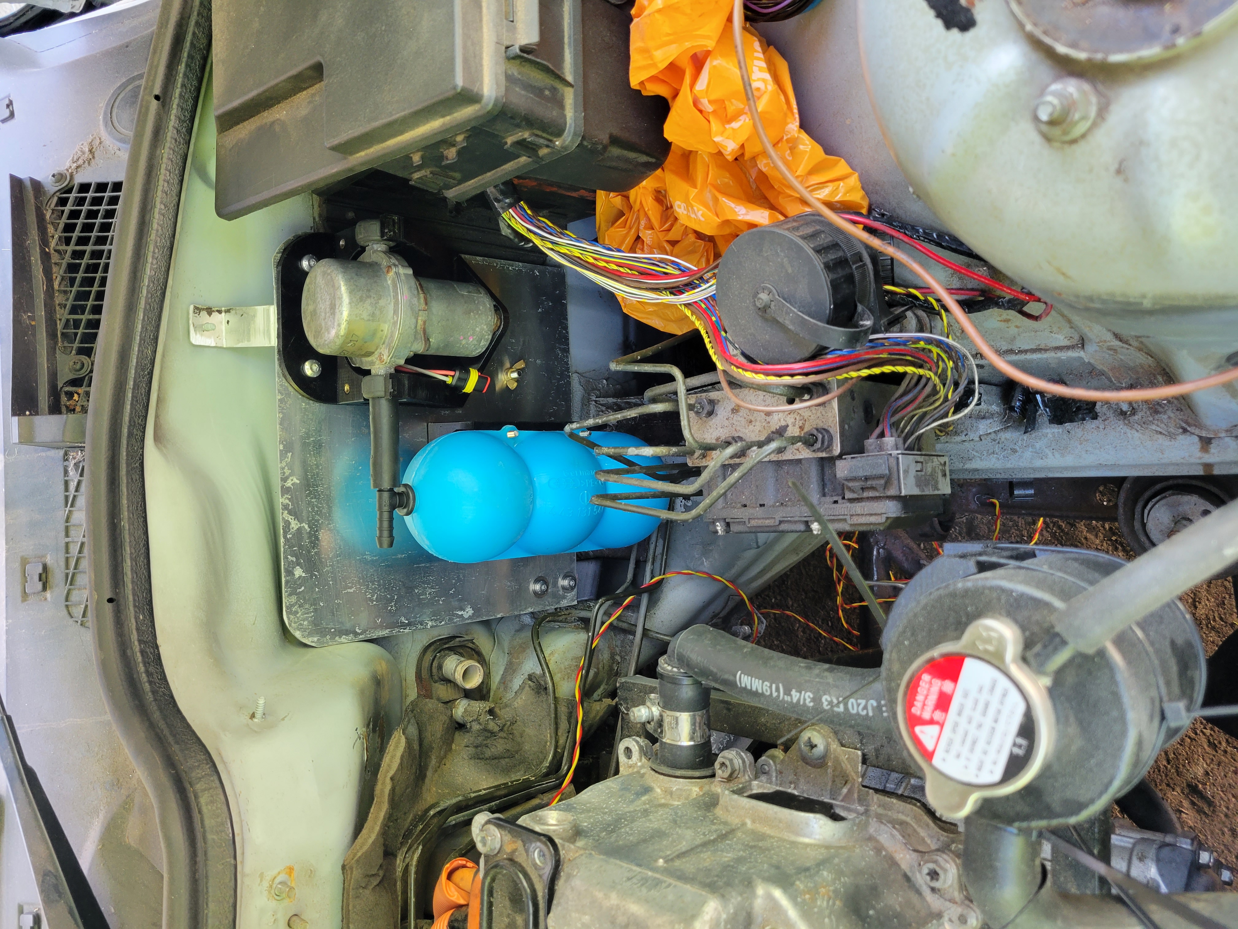

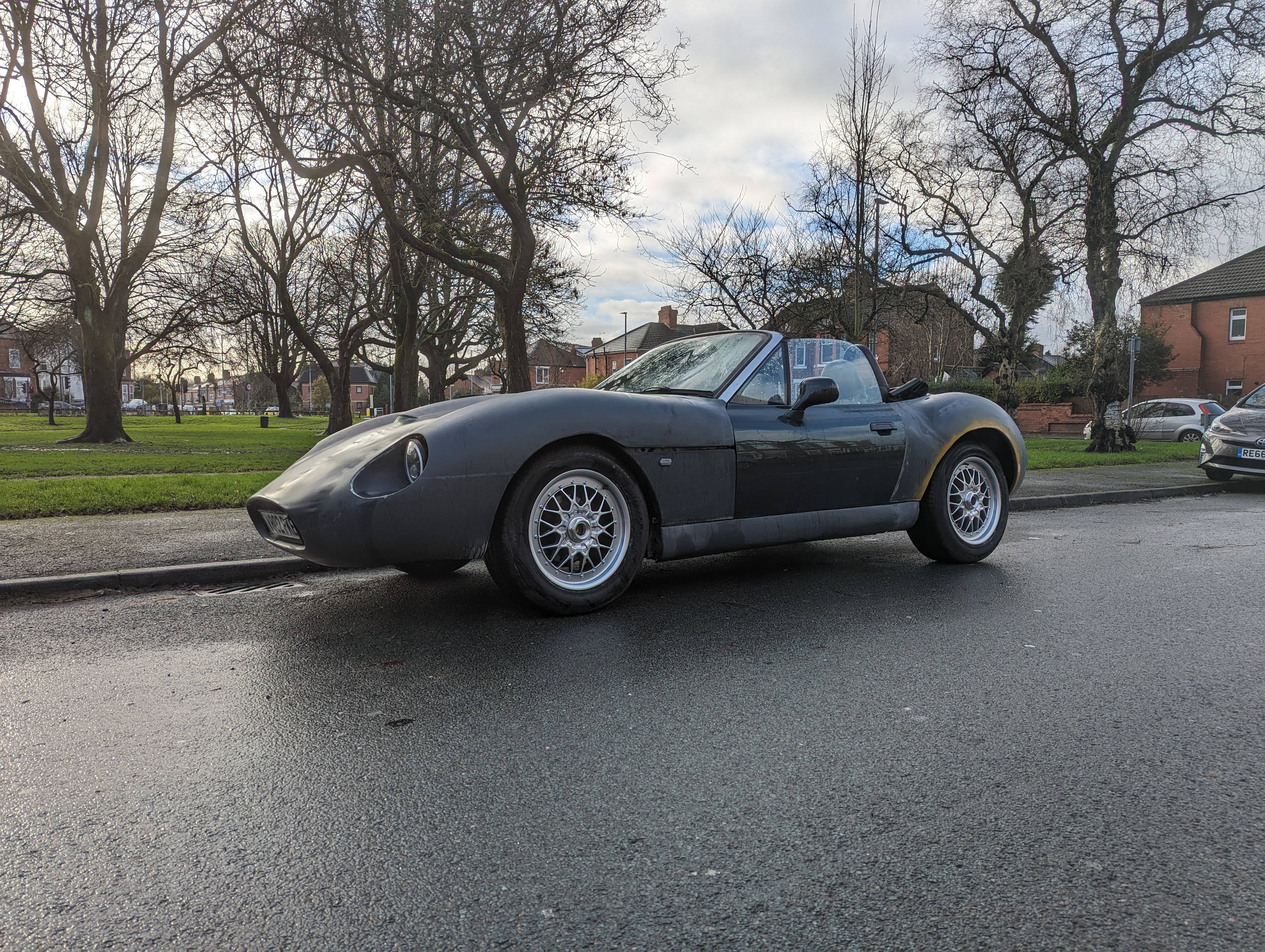

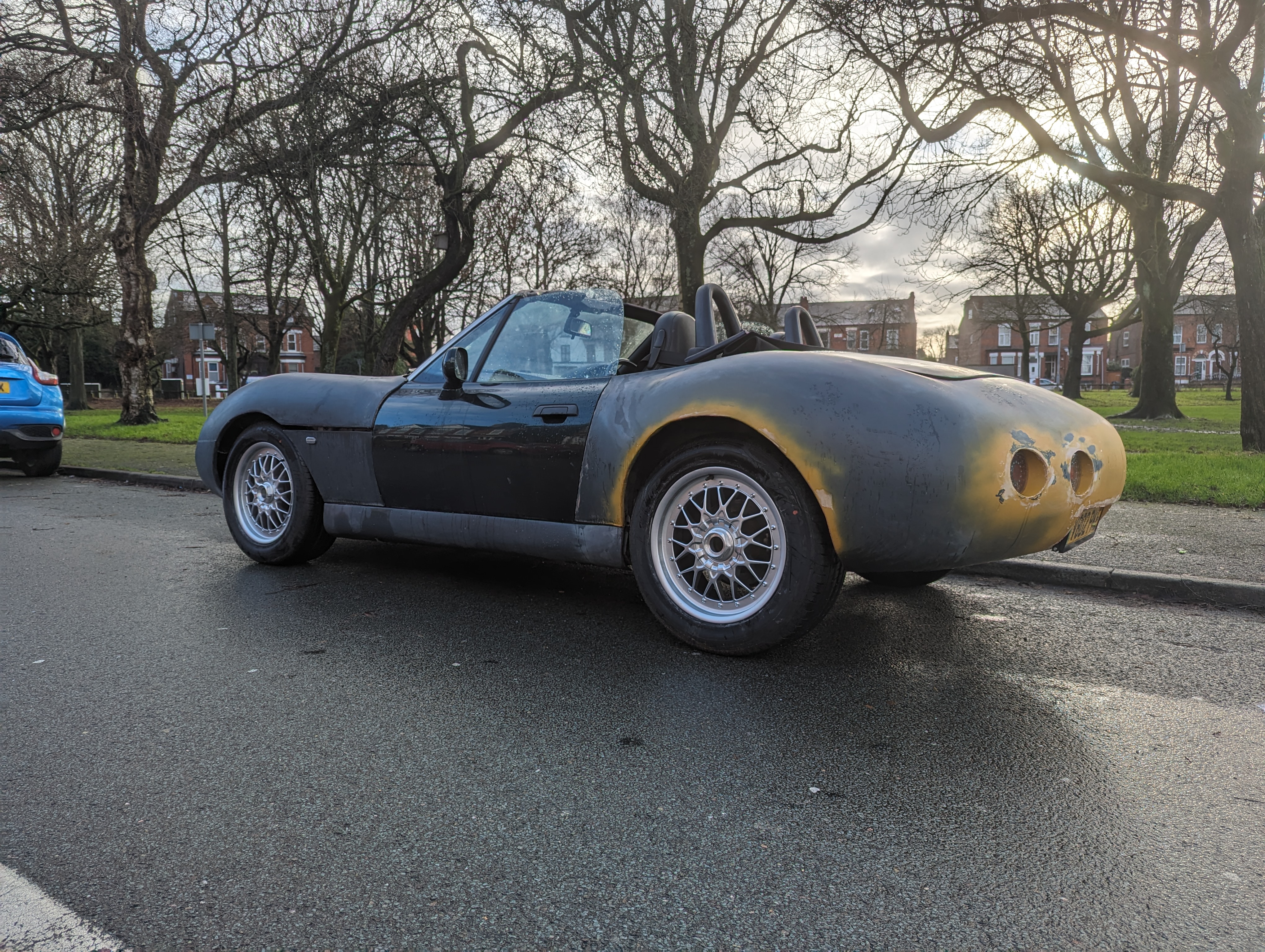

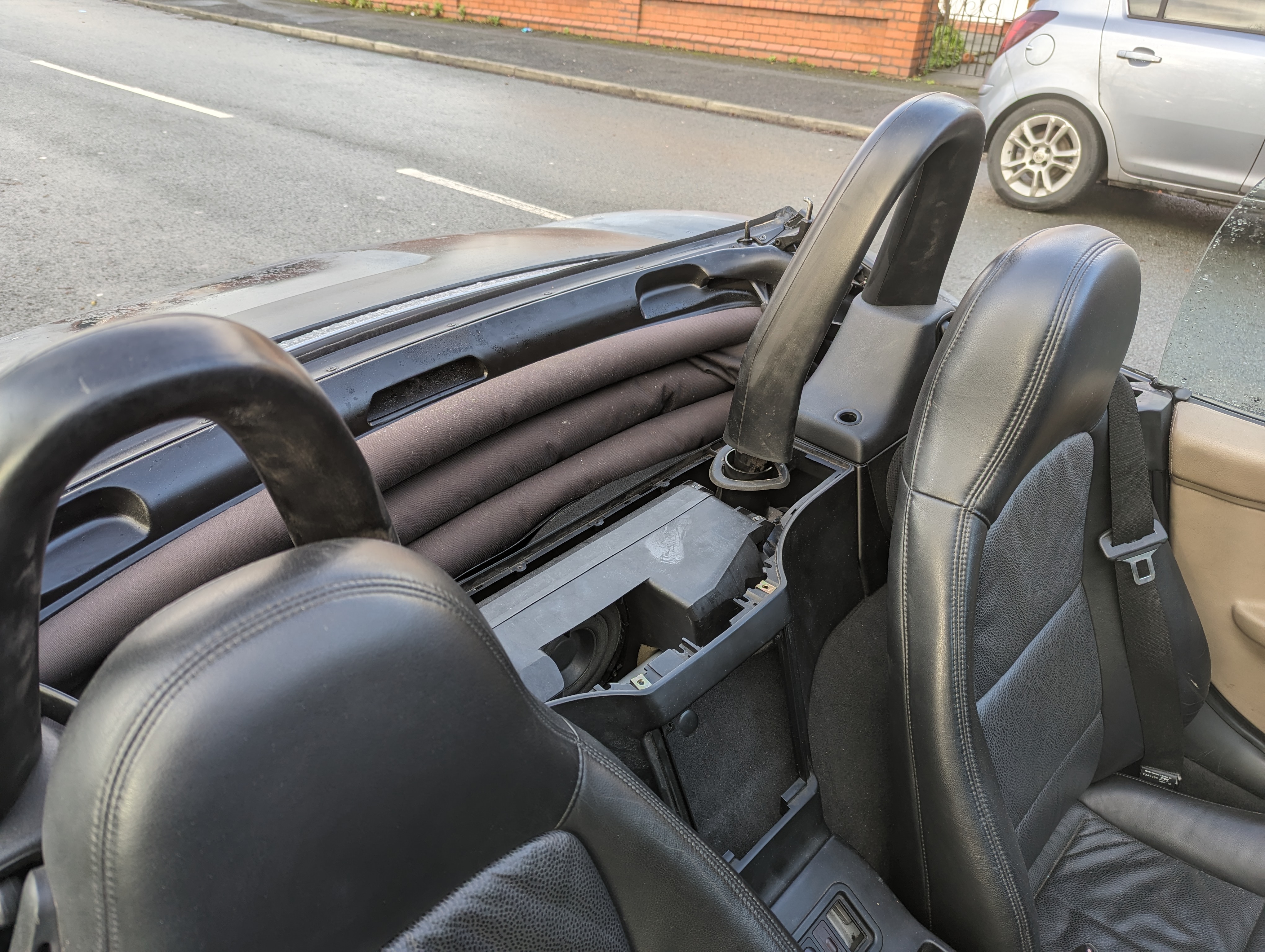

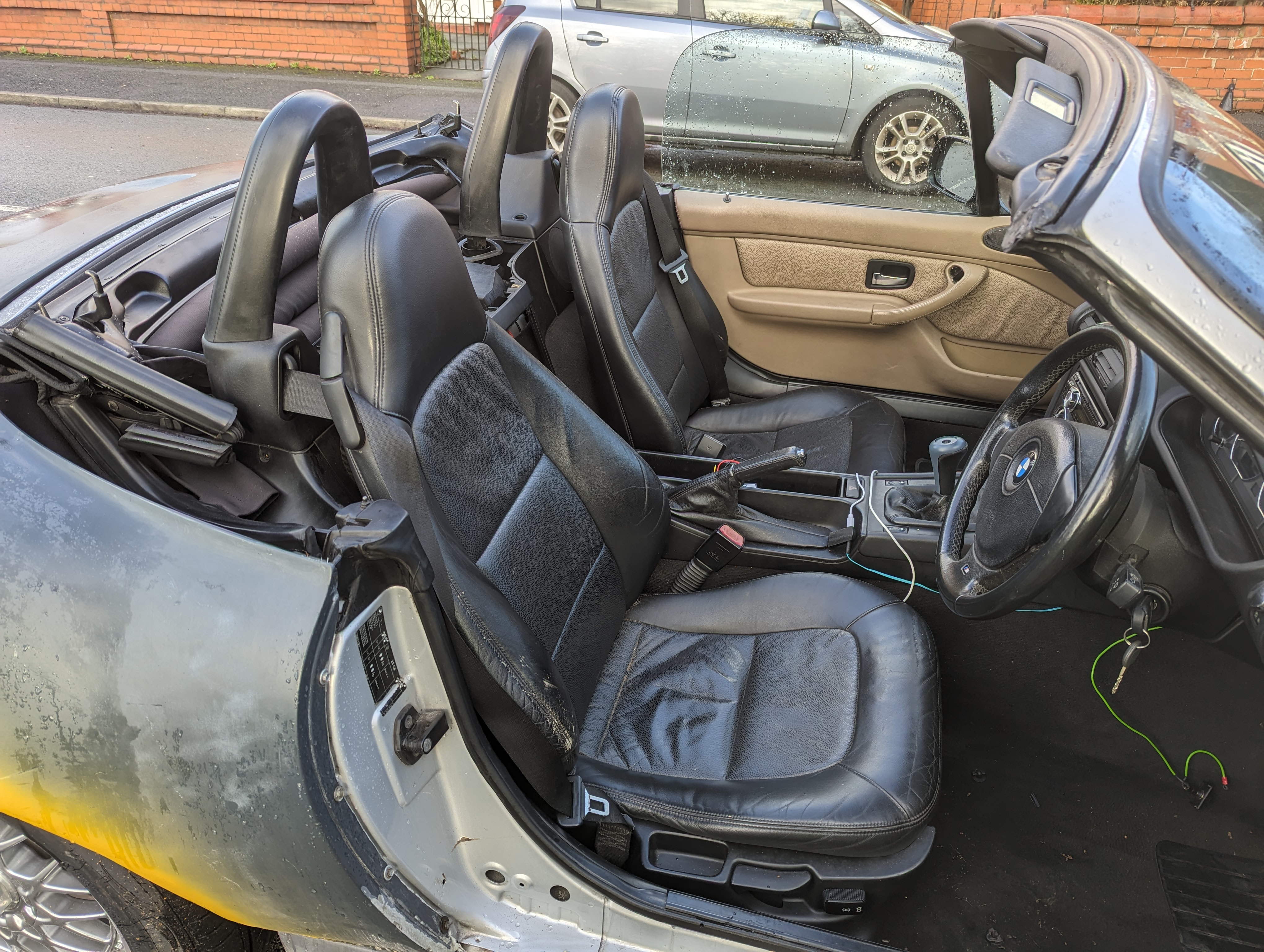

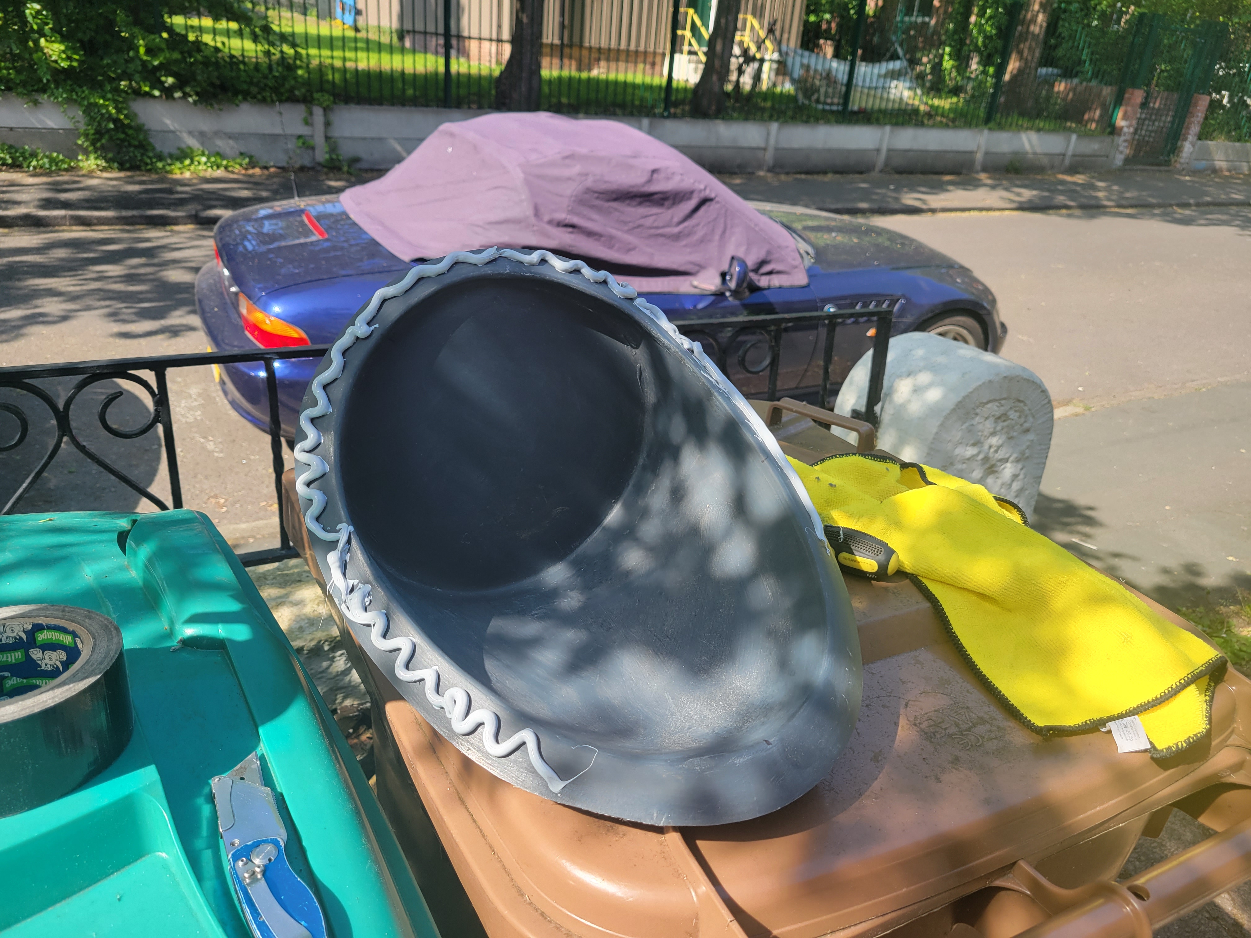

Bloody ages since my last update. Not long after the last one my landlord told me he wanted the garage back. So instead of finishing the car I spent two months moving everything into storage. I haven't been able to find another garage so eventually (after being very grump for a month or two) I decided to wait until I can buy one, and finish the car back on the drive where it started.
It's been home for a couple of weeks and since then, lots of progress.
  • Headlight buckets are in
  • Grille and front number plate mount are on
  • Original loom has been stripped back and modified for new lights
  • EV loom has been largely redone, with just battery management and heater wires to go
  • Brake booster arrangement has been redesigned and refitted
Got a little more to do at the front end (fit the headlights, finish wiring, new gas shocks, fix the power steering, fit and wire in the heater - if only to get it out of the house), then the plan is the flip the car around and start on the back end (rear light buckets, number plate surround, charge ports, door shuts - currently too tight).
Back to doing two videos a week on the YouTube channel (where work/family permits). Goal is MOT in July, then in for paint/wrap. Might be optimistic - not least as to whether my budget will support that/any paint shop will take it on with the amount of prep required, but we'll see.
Slightly jumbled photos but you get the idea.

With the cover on the (blue) z3, it looks like the car is going to the executioner (quote from Mr bigpie :D )

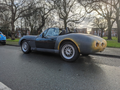

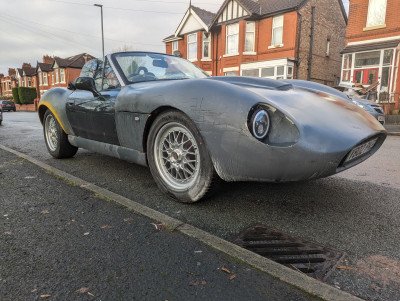

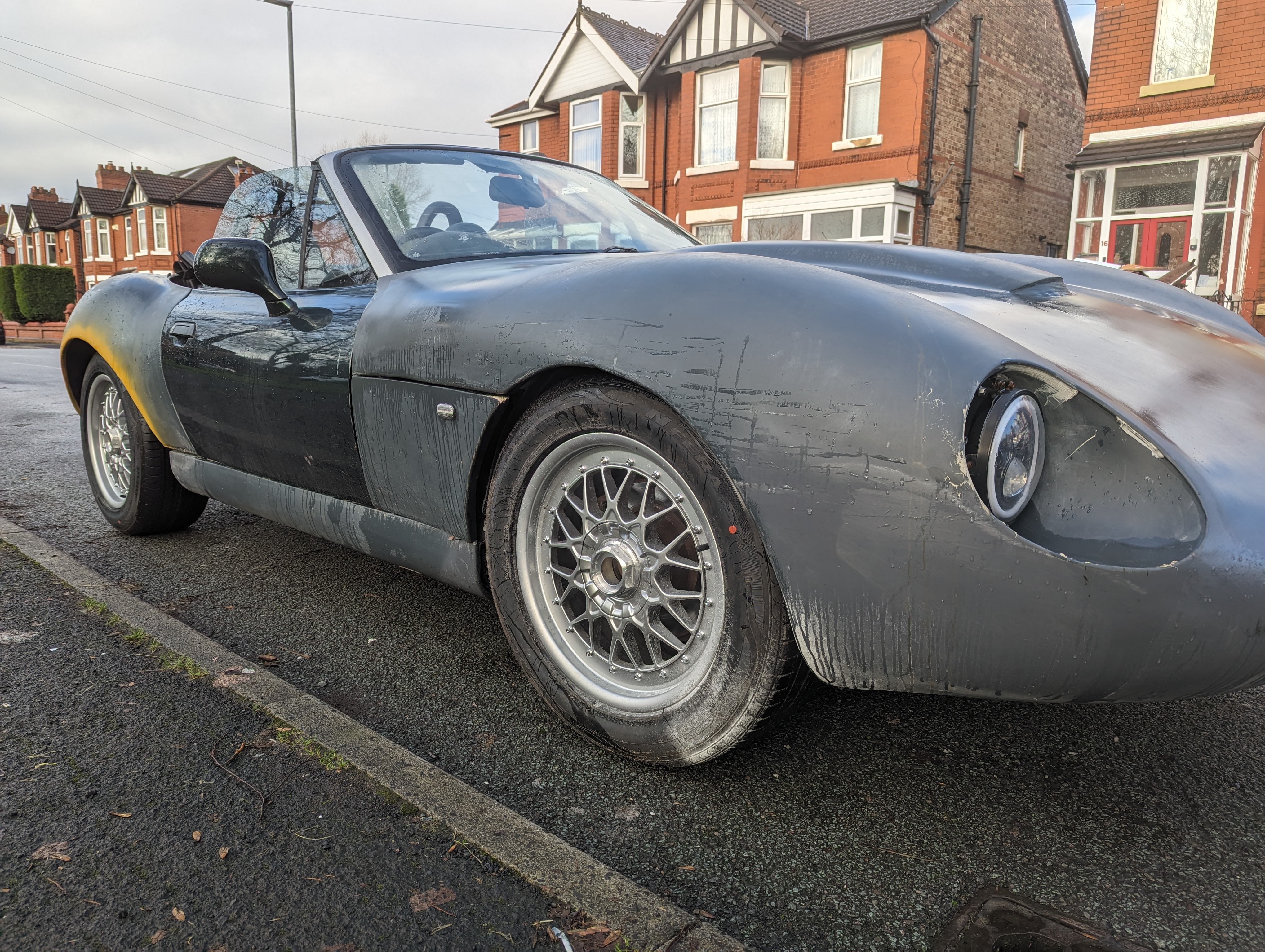

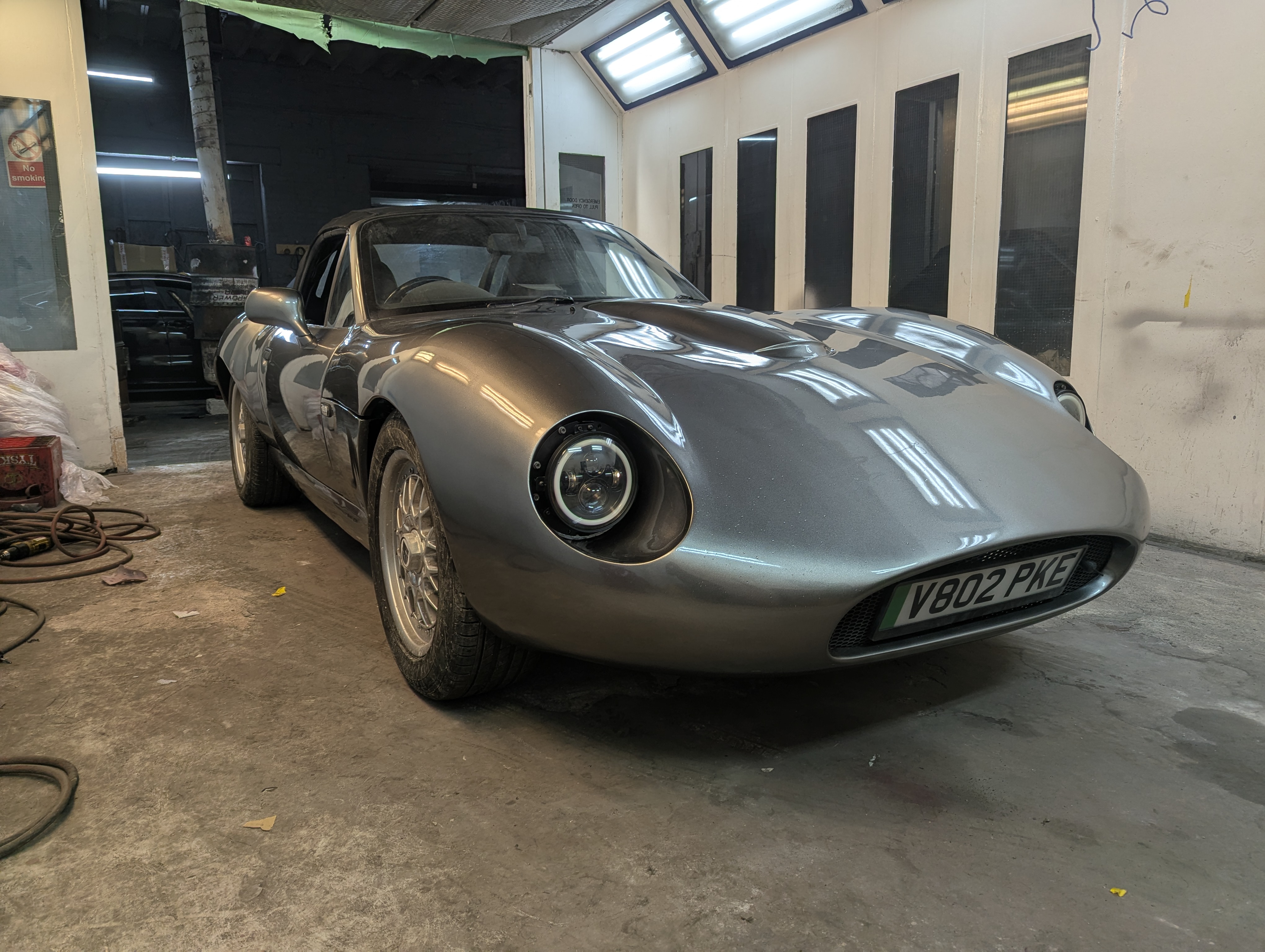

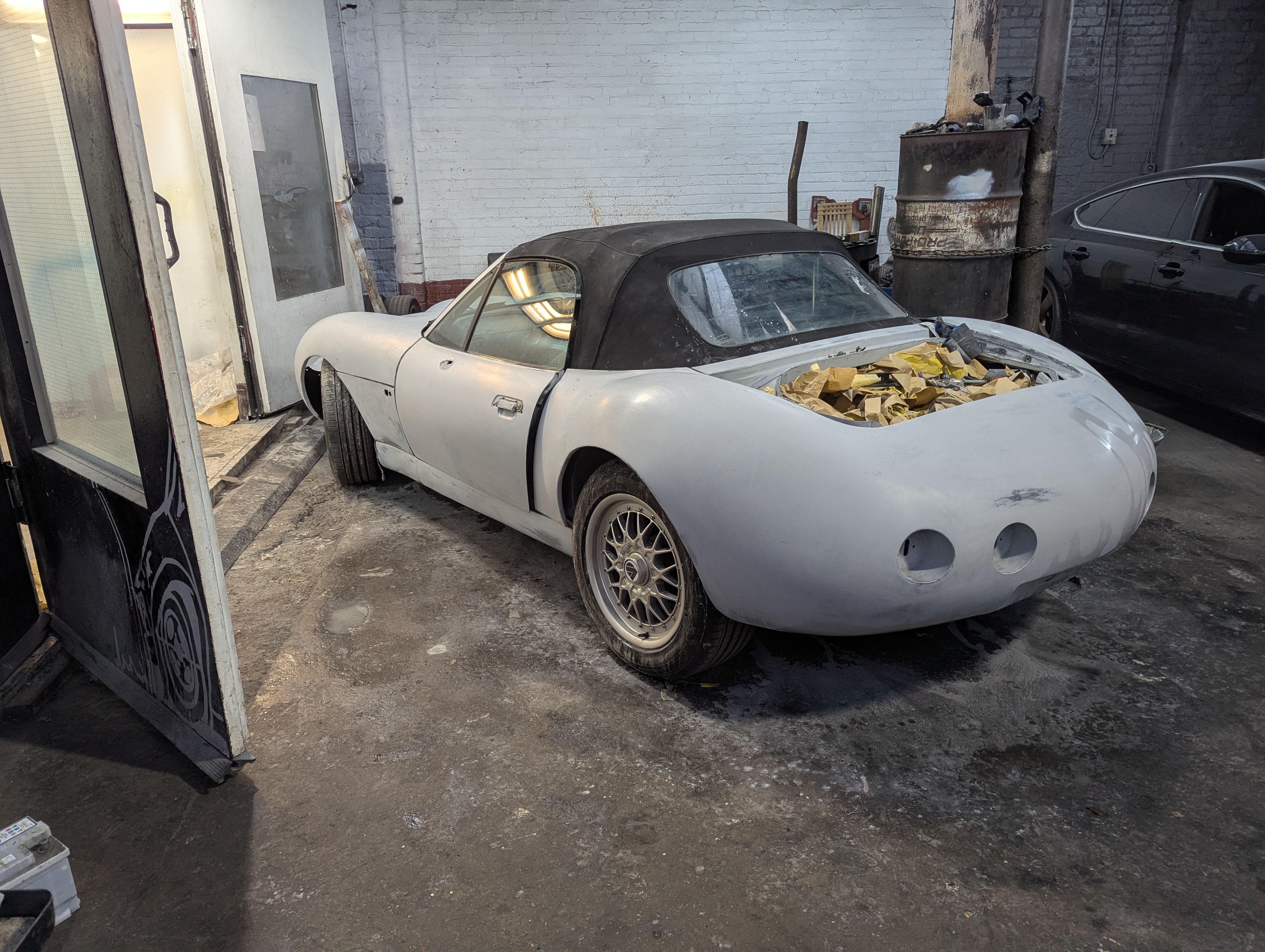

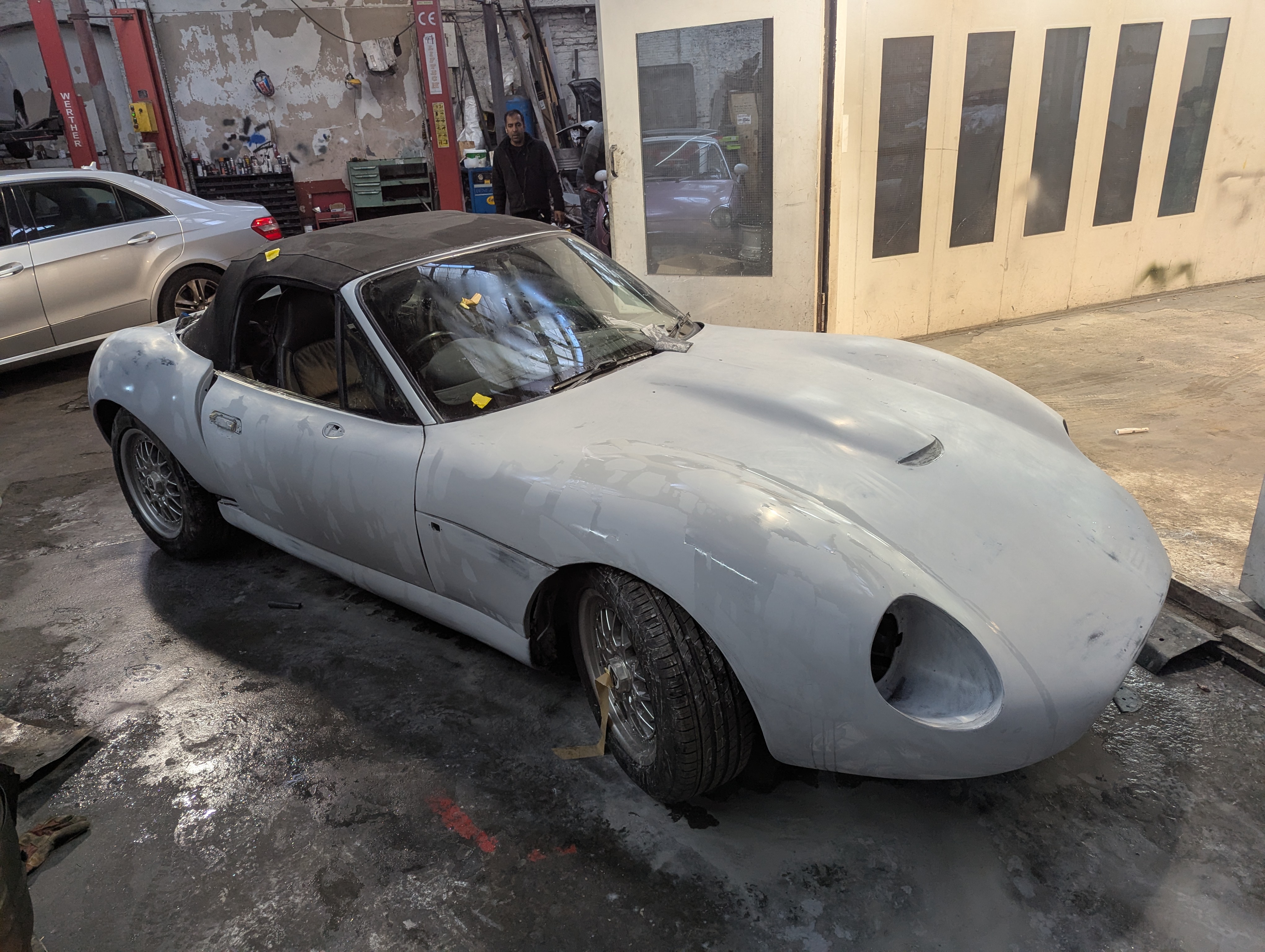

Thought I'd do a quick update with some pics on where I'm up to. Still a long way to go but I'm really happy with how it's looking.
New wheels are on (17in BBS split rims with 235x55 Nexen rubber, all done by Evolution Coatings in Irlam), new seats are repaired and installed (from BMW Spares Scotland - these will be retrimmed at some point), as are repaired/upgraded subwoofer and amp, and roll hoops - need to make a bunch of trim though.
Lots of work still to do on the body when it's dry again. But it's coming along.

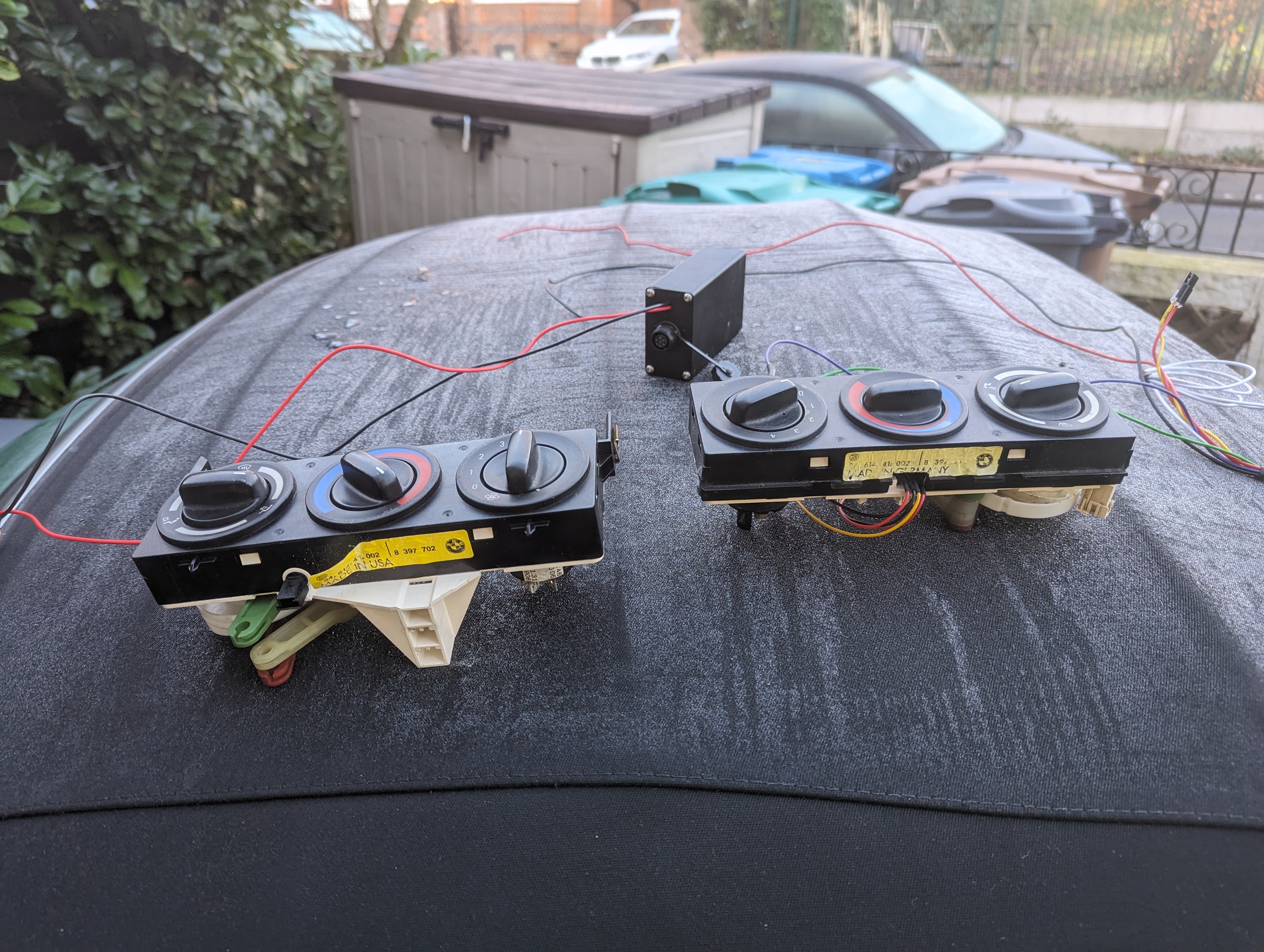

Next is cabin heater. All wired in and just adding some code to my dash display to show status, target temp etc. Photo showing old controls and modified ones with a pot in place of the temp dial.

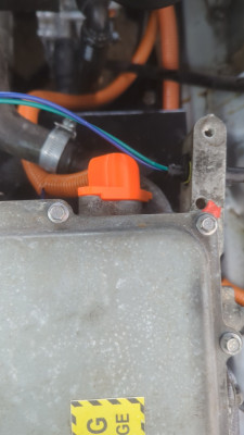

I mentioned in the Outlander charger thread I recently started having issues with the charger cutting out after thirty minutes or so. Do you mind sharing how you are controlling yours?
Also I forget what heater you're using.
I need a bigger hammer!
bobby_come_lately
Posts: 466
Location: Manchester, UK
Has thanked: 37 times
Been thanked: 39 times
Re: [DRIVING] - Z3(00)
Post by bobby_come_lately »
The BMS now controls mine, just pinging out the relevant canbus messages when it's all plugged in. Is yours overheating maybe?
Outlander heater too. Had a horrible thought when I spotted the snow: when I put some fluids in to test the loop, months ago, did I put in anti-freeze or just water? Can't remember I may have a wrecked heater/matrix at worst... eek. Nothing so permanent as temporary...
Alibro
Posts: 873
Location: Northern Ireland
Has thanked: 277 times
Been thanked: 159 times
Re: Z3(00)
Post by Alibro »
bobby_come_lately wrote: Tue Jan 16, 2024 7:29 am The BMS now controls mine, just pinging out the relevant canbus messages when it's all plugged in. Is yours overheating maybe?
It might be overheating, I have a horrible feeling I will have to start stripping stuff out again. :(
Good luck with your heater and please document the process when you get it working..

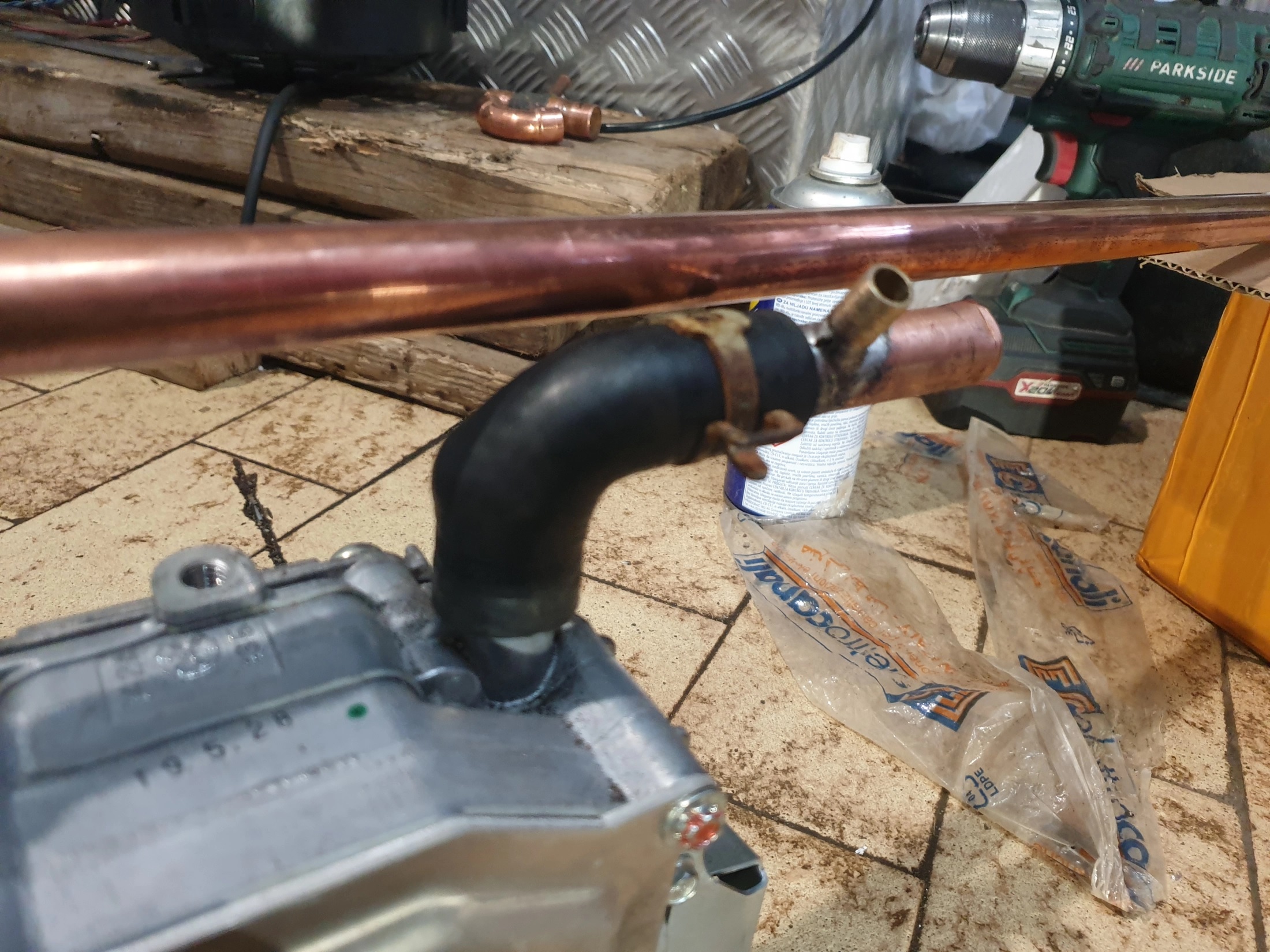

Posts: 3295
Has thanked: 81 times
Been thanked: 242 times
Alibro wrote: Tue Jan 16, 2024 9:33 am It might be overheating, I have a horrible feeling I will have to start stripping stuff out again.

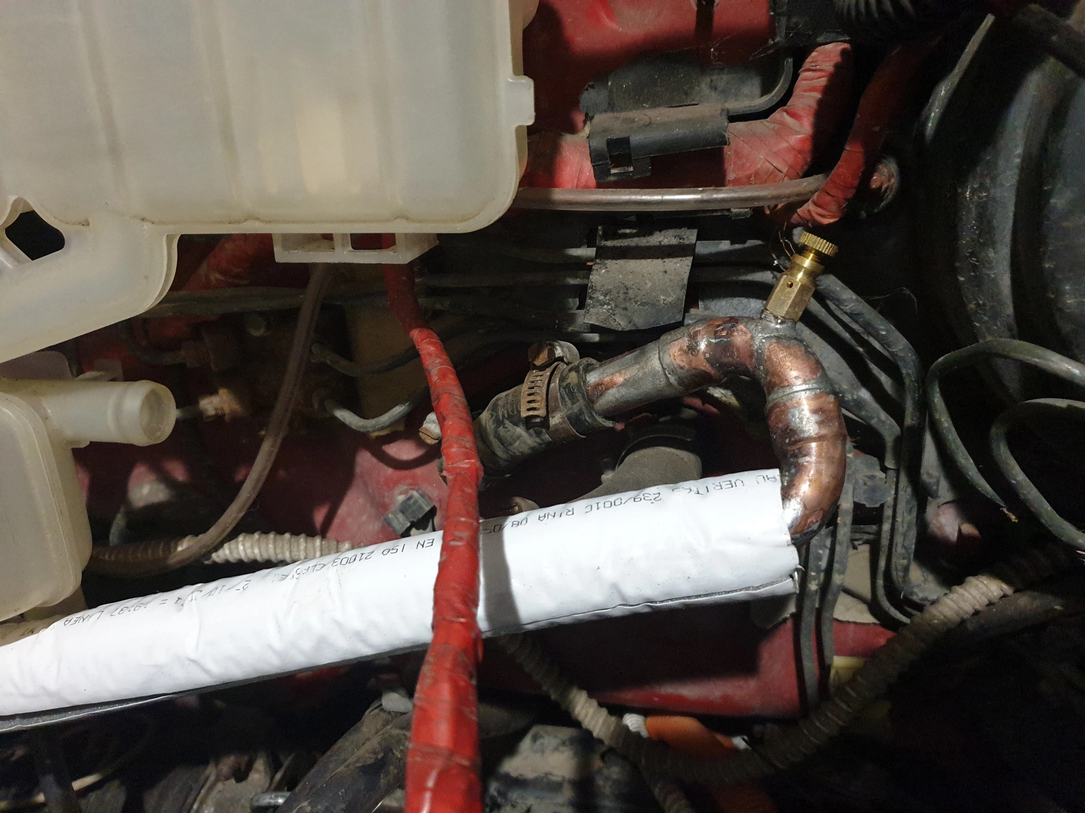

Huh, heater is a fickle thing. It needs to have at least 30ms heartbeat 0x285 and 100ms command 0x188.
Then there could be a problem with pump and fluid if the plumming is not properly bled. My system was very simple but it still kept a lot of air in the heater matrix under the liquid level.
I recommend to get a piece of heating copper tubing and solder a bleed valve to it as a T piece. Then put this tube on the top-most hose in the system.
You can simply open the bleed valve to let the liquid come in from the header tank and the air out at the top.
What i did next was a solution for me... i opened the bleed valve and pushed a 10mm silicon(plastic) tube on it and clamped it tight so there was no leak. Then i lifted the tube up into the air and literally sucked some air out via that tube while pump was running.
Alternatively i blowed air in the tube and watched the header tank if pressure caused bubbles to come out.
After bleeding is complete the coolant surface in tube should rise under the pump pressure, but when pump is off fluid level should drop to the header level.

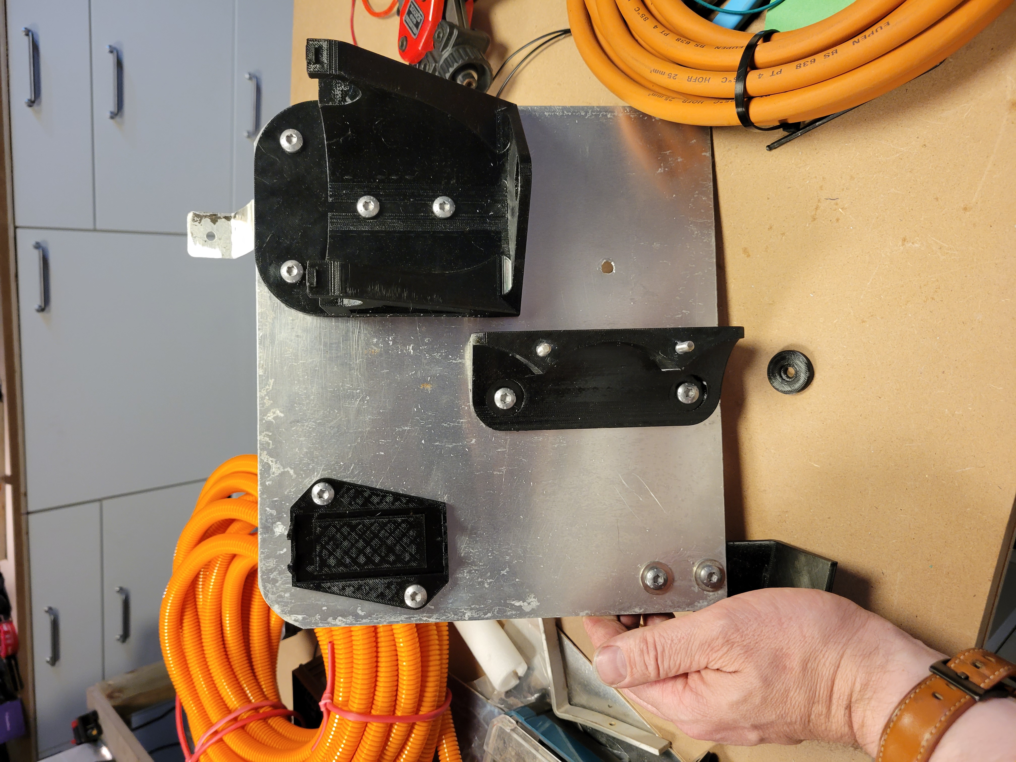

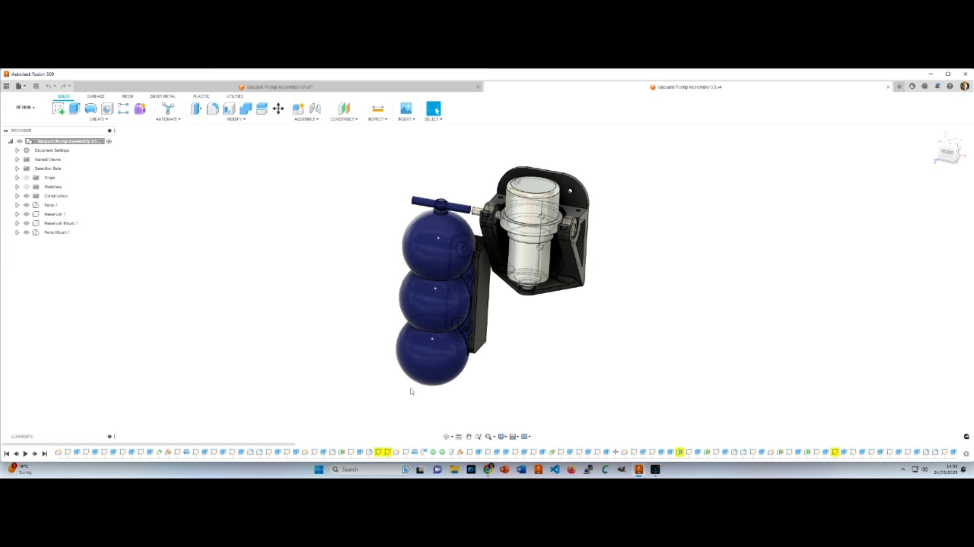

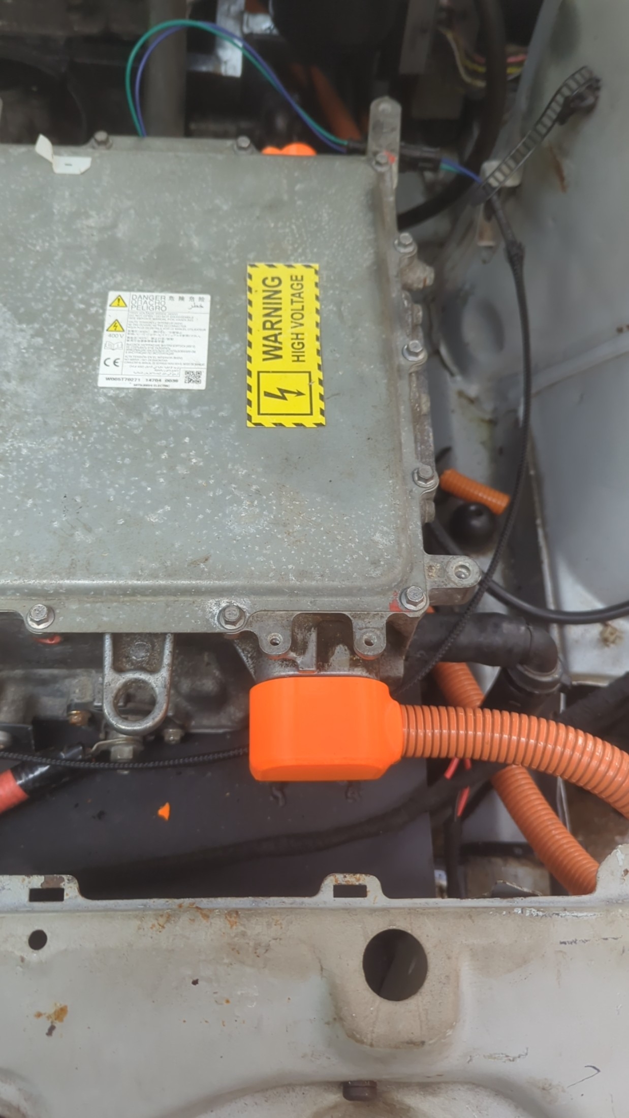

Anyway, reason for post: I did some new 3D printed parts for the Outlander Charger. I know someone has already done some but these are designed to take up less space and not require separate grommets. Look quite tidy in bright orange.
https://github.com/bookofthefuture/OutlanderCharger3DP
