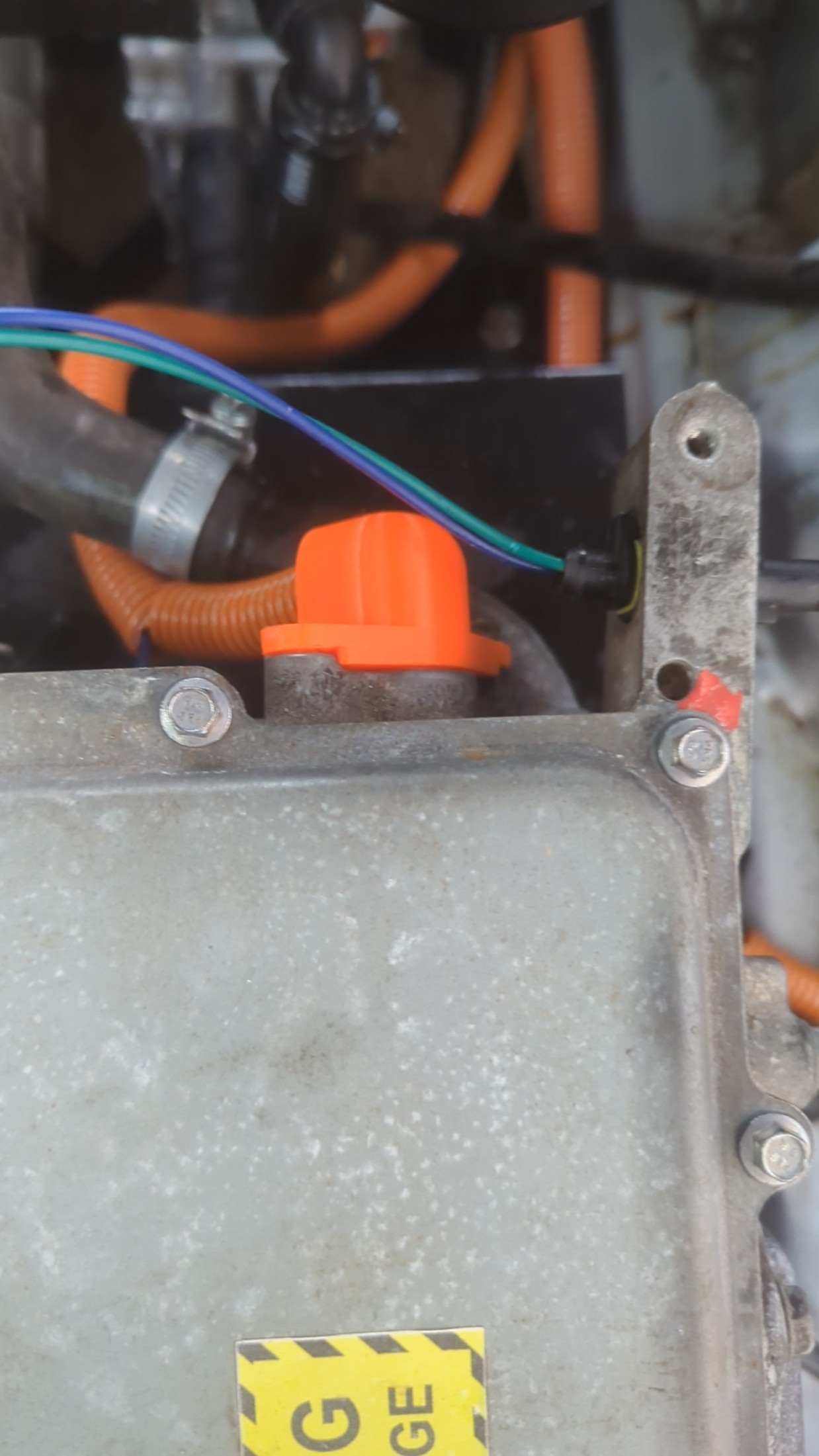

Anyway, reason for post: I did some new 3D printed parts for the Outlander Charger. I know someone has already done some but these are designed to take up less space and not require separate grommets. Look quite tidy in bright orange.
https://github.com/bookofthefuture/OutlanderCharger3DP

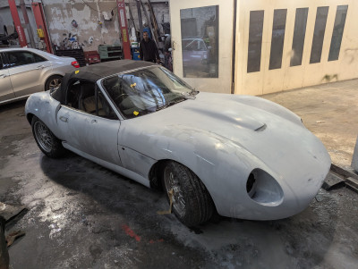

Finally in the paint shop!
bobby_come_lately
Posts: 486
Location: Manchester, UK
Has thanked: 56 times
Been thanked: 63 times
Re: [DRIVING] - Z3(00)
Post by bobby_come_lately »

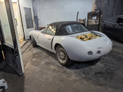

Big progress. The body shop are doing a lovely job.

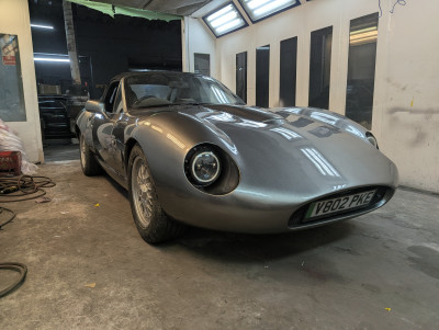

Finally painted. And frankly, it looks awesome.
manifold
Posts: 33
Joined: Wed Sep 17, 2025 2:31 pm
Has thanked: 21 times
Been thanked: 29 times
Post by manifold »
Yes it does looks amazing. I like the retro look and that midnight silver type colour looks awesome on that shape of car and with those wheels. You must be proud of how far its come. I would be. You now need a garage to keep it like that!
