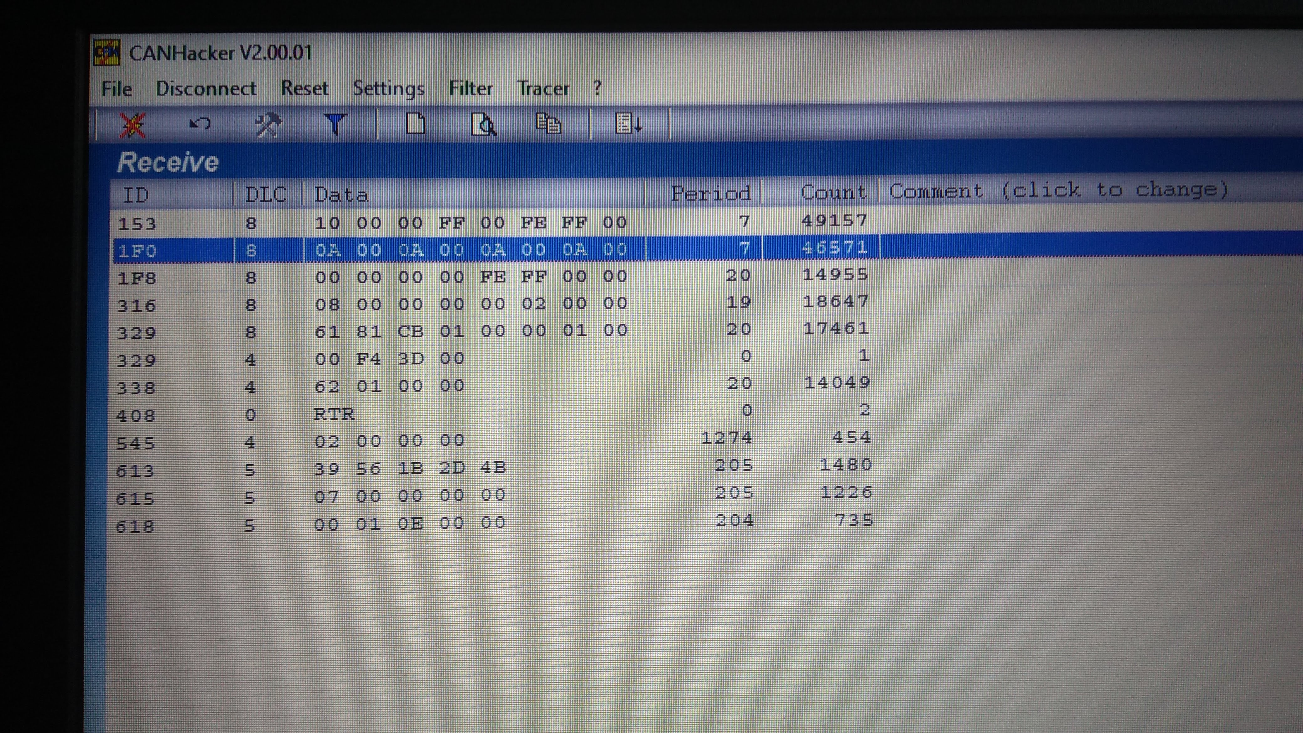

Finally this evening I managed to get some canbus data from the OBD2 port using the shield mentioned earlier.
I've been able to use the examples in the OBD2 library to get info like Engine RPM, Coolant and oil temp and about 10 other stats for a week or so but while it's nice to see the thing working it doesn't give me the data I need, so I've been messing about for days copying bits from one sketch to another.
It's been a steep learning curve as I've done almost nothing with Arduino before so to finally get something (without sending the car into a hissy fit) is a big achievement for me.
Now I need to tidy things up a bit and try to interpret the data I'm getting.

So after an embarrassing number of hours faffing about with this I finally got it working. I think I managed to commit every newbie cockup possible including in no particular orderAlibro wrote: ↑Sat May 16, 2020 11:53 am Hi guys
I have been thinking of converting a car to EV for a couple of years but one of the questions everyone asks is how to control the Dash?
It is one of the BIG stumbling blocks and I suspect may be the reason many projects stall so I decided to look into it first before spending big money on batteries, cars, motors etc.
I ordered a couple of clone Arduino Uno's and a CANBUS shield from Aliexpress and gave it a go in my 2012 C Class.
I have to say I hadn't much success.
When plugged into the ODBII port I got nothing on the monitor
When connected to a pair of CANBUS wires in the boot I got nothing on the monitor but my dash lit up like a Christmas tree with errors flashing. Thankfully after disconnecting the CANBUS shield from the car it was OK but had me worried.
I tried following several online tutorials for this project including
https://wiki.seeedstudio.com/CAN-BUS_Shield_V2.0/
https://seeeddoc.github.io/CAN-BUS_Shield/
https://www.instructables.com/id/CAN-Bu ... h-Arduino/
This is the UNO I was using https://www.ebay.co.uk/itm/UMTMedia-Ard ... 2749.l2649
This is the shield I was using https://www.diymore.cc/products/mcp2515 ... no-diy-kit
I have to admit after a while I ended up going round in circles so I was wondering what you guys use to read the CANBUS signals?
Wrong library for the sketch
Wrong library for the shield
Too many libraries in the libraries folder
Adding or changing libraries without rebooting the Arduino IDE
Wrong baud rate for the serial monitor
Wrong baud rate for the CANBUS in my car
Assuming examples supplied by the shield manufacturer would work with their shield.
If I'd made one of these errors I could have found it and sorted the issue fairly quickly but I was making most of them at the same time so it took a while.
My excuse is ignorance because I'm new to Arduino and haven't programmed anything since I was a kid playing with my VIC20
Unfortunately I'm also a bit stupid so I take longer than some to figure stuff out.

Let me give you some good advice: The challenge is NOT getting the Arduino and CANadapter to work.
Your real challenge will be to understand what each of the 64 bits of each CANbus datagram means.
This is not something you will achieve with the setup you are trying to get to work now (which really shouldnt be any issue at all with the wealth of sketches and examples available).
Best thing you can do now is to buy a working CANadapter that your PC (Windows or Linux) does recognize and dive into getting to understand how savvycan or the kvaser tools work.
By the time you know what to send over the bus to get the action you want you can look into getting the Arduino to work and let it sent these datagrams for you.

SavvyCAN or BUSMaster (From ETAS / Bosch) are probably the best free tools. I use Vehicle Spy, but it is far from free.
And, yes, the data is the issue, not so much getting the physical setup / data capture done.
The first thing I try and do is - control the things you can -- press the brake pedal, open / close doors, etc... Unplug the coolant temperature sensors and see what happens on the dash, see what data changed... See what seems to rise with RPM (probably split over two bytes). It's not a quick task, but definitely rewarding when done.

It's a TD4 Freelander 1, I managed to get the CAN data off it this evening and it looks like there isn't much going on.
Here is a photo of my laptop with CAN data collected from the ECU.
https://photos.app.goo.gl/1j9aZq5EAX7i3Ugs5
