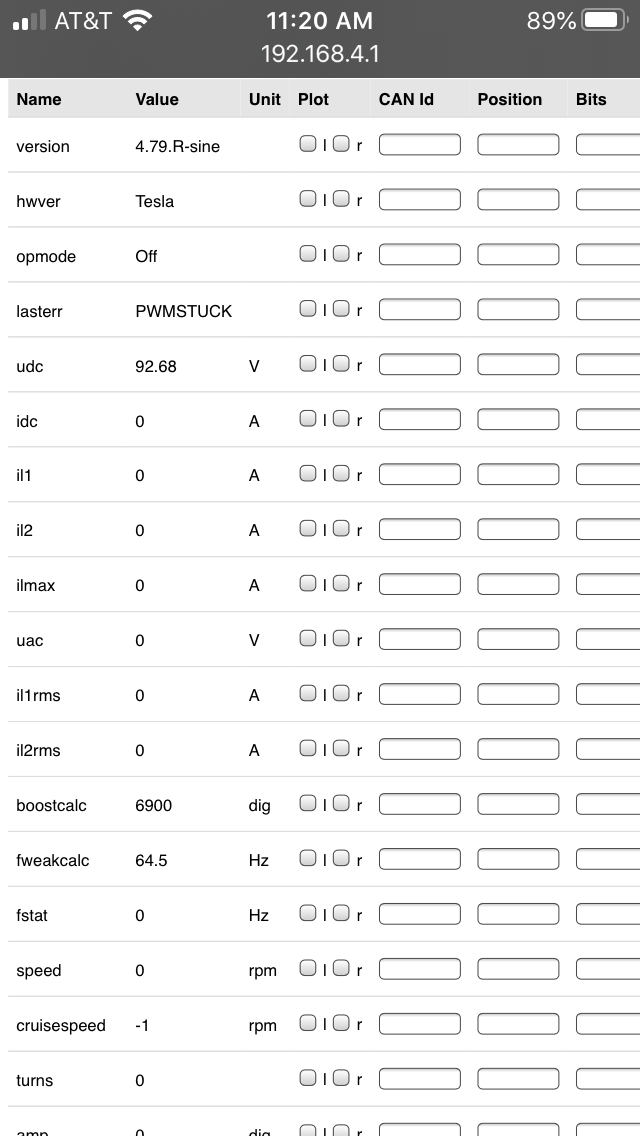

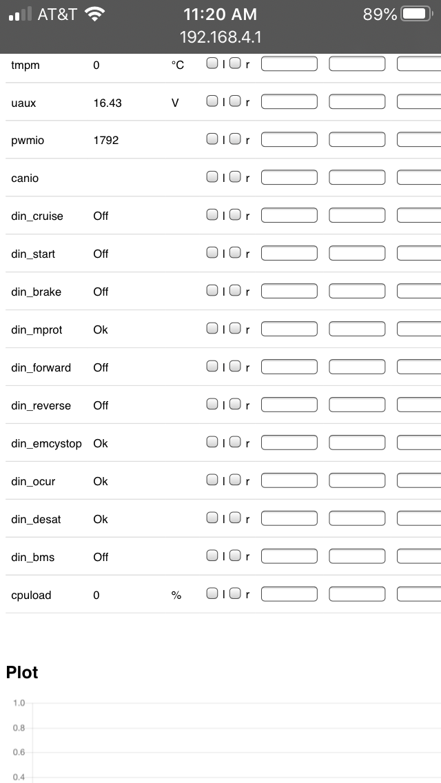

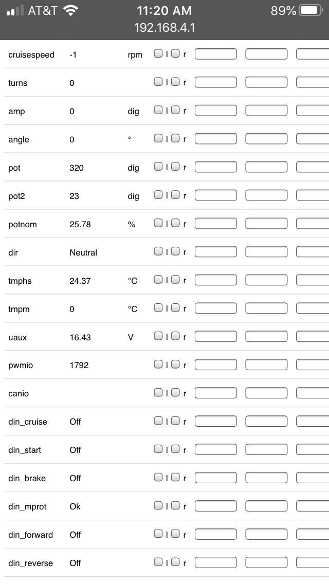

Hi everyone. Upon the advise of Johannes I'm starting a separate thread here.
I've had a few different issues with getting my board to work and the results were scattered in the LDU support thread. I'm going to consolidate what has happened so far since I got the board and hopefully someone can point me in the right direction. Since it will be a while before I can get a replacement board I figured I would take the time to fault find mine while I'm waiting and maybe solve the mystery. Or if it's the LDU itself, find that out.
Here is what has been done and the results so far-
1. Installed the board (came with v4.71), contactor, precharge, pedal, etc. to a Tesla motor
2. Switched parameters to match my 80V test battery and set pedal pot readings
3. Every time start signal was sent, main contactor would close and open again with overcurrent fault.
4. Traced the error to lack of 5V on one of the two current sensors due to bad solder joint on connector.
5. Resoldered connection. This fixed the overcurrent error and the main contactor would close but motor would not spin- still had tmpmax and current limit codes
6. Updated the firmware to V4.78 and then to the fix v4.79 posted on the MUX fix thread. v4.78 wouldn't spin the motor. V4.79 eliminated the temp error but still had PWM stuck code and would not close the main contactor when applying the start signal.
7. Contacted Jon Volk and used his version (v4.56) and his parameters. Main contactor would not close with start signal.
8. with Jon Volk parameters v4.71 and v4.76 would spin the motor but not correctly. It would accelerate and then the motor would keep spinning at the same speed or even accelerate when let off the throttle.
9. I tried each version with Volk parameters again and once got the motor to spin correctly (quickly stop after letting off the accelerator) with V4.79. 5 minutes later I turned on the system again to try it again and the main contactor wouldn't close again. Still giving PWM stuck error when ignition was turned on.
10. Jon looked at my parameters and noticed that my encoder was set to "single" instead of "AB".
11. Switched the encoder to AB. Motor would run extremely slow and rough/jogging. Would accelerate very slightly with throttle, same jogging/rough running.
12. Also tried Damien's parameters. Motor won't spin at all.
13. Tried a different battery (100V), no difference.
14. Tried swapping AB encoder wires, no difference
spinning motor-
wigmanparameters2.json
(1.33 KiB) Downloaded 106 times

Can you attach your parameters to the opening post, please (edit). Also some info on your testing environment, most of all DC voltage. A video or screen capture of the non-working situation would help identifying the problem also.
