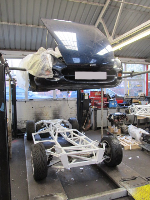

Learning a lot from this forum and the incredible OpenInverter resources already, as I look to convert my Cerbera to have more power than it left the factory with!
Current plan:
- GS450h transmission with inverter
- 50kWh of batteries split between front a rear to maintain 49/51 weight ratio
- ZombieVerter ECU
- Maintaining as many of the original dials and gauges as possible
- Charger port is going to be an challenge because the existing fuel filler cap is hidden inside the boot to maintain the seamless external appearance. Current plan is to hide CCS under the rear number plate.
I will try and share my learnings as I go and no doubt I'll be looking for help at some point.
