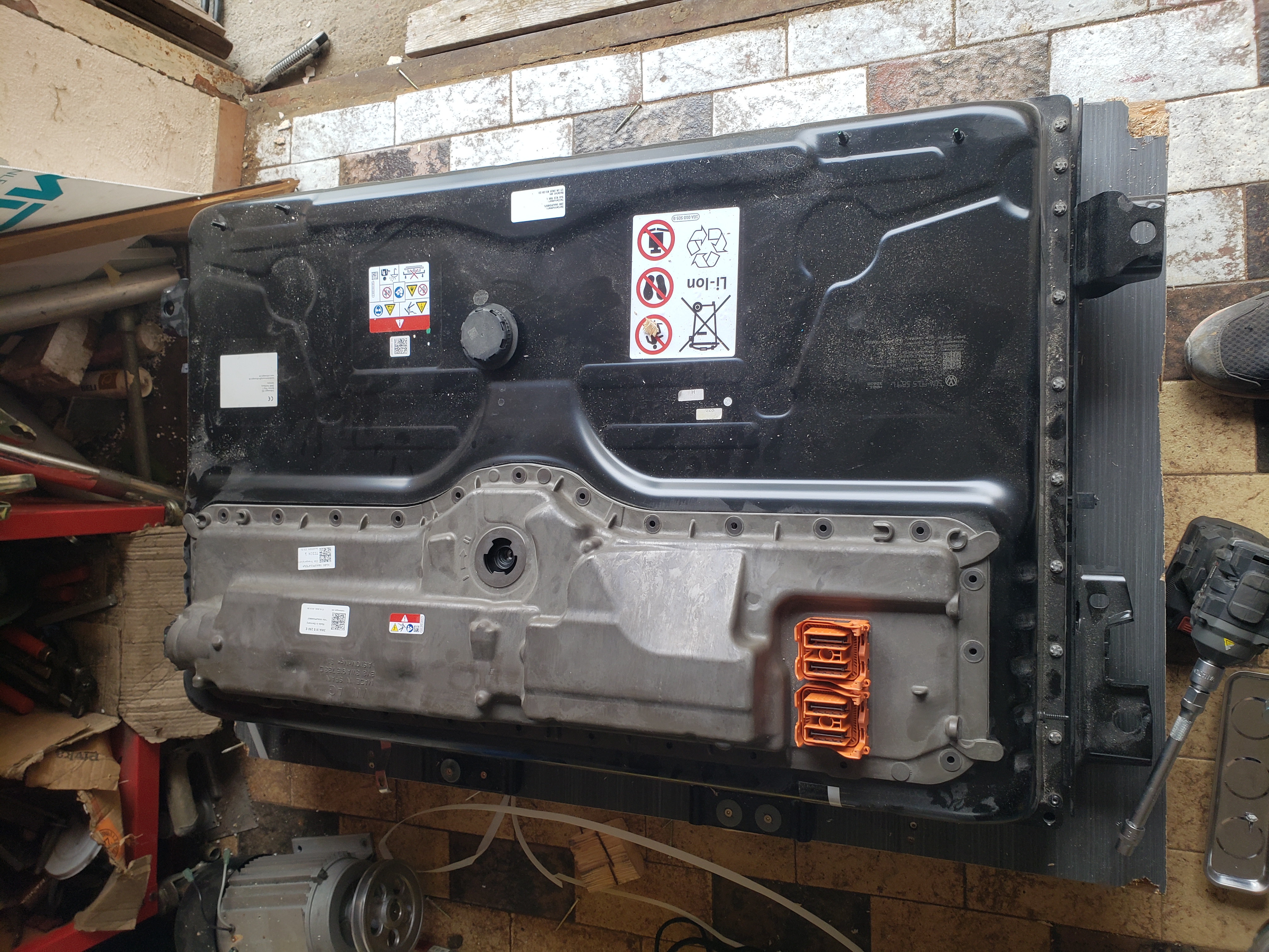

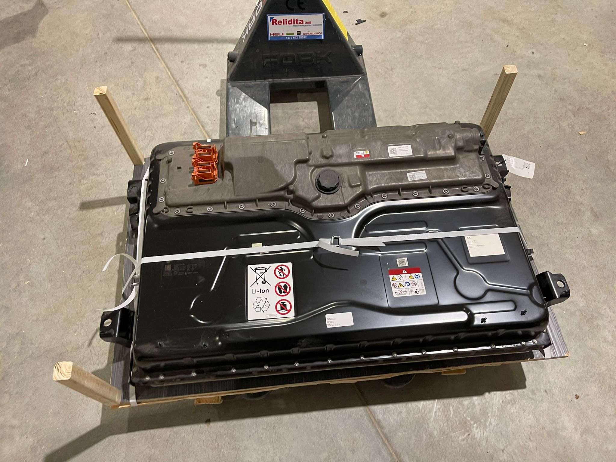

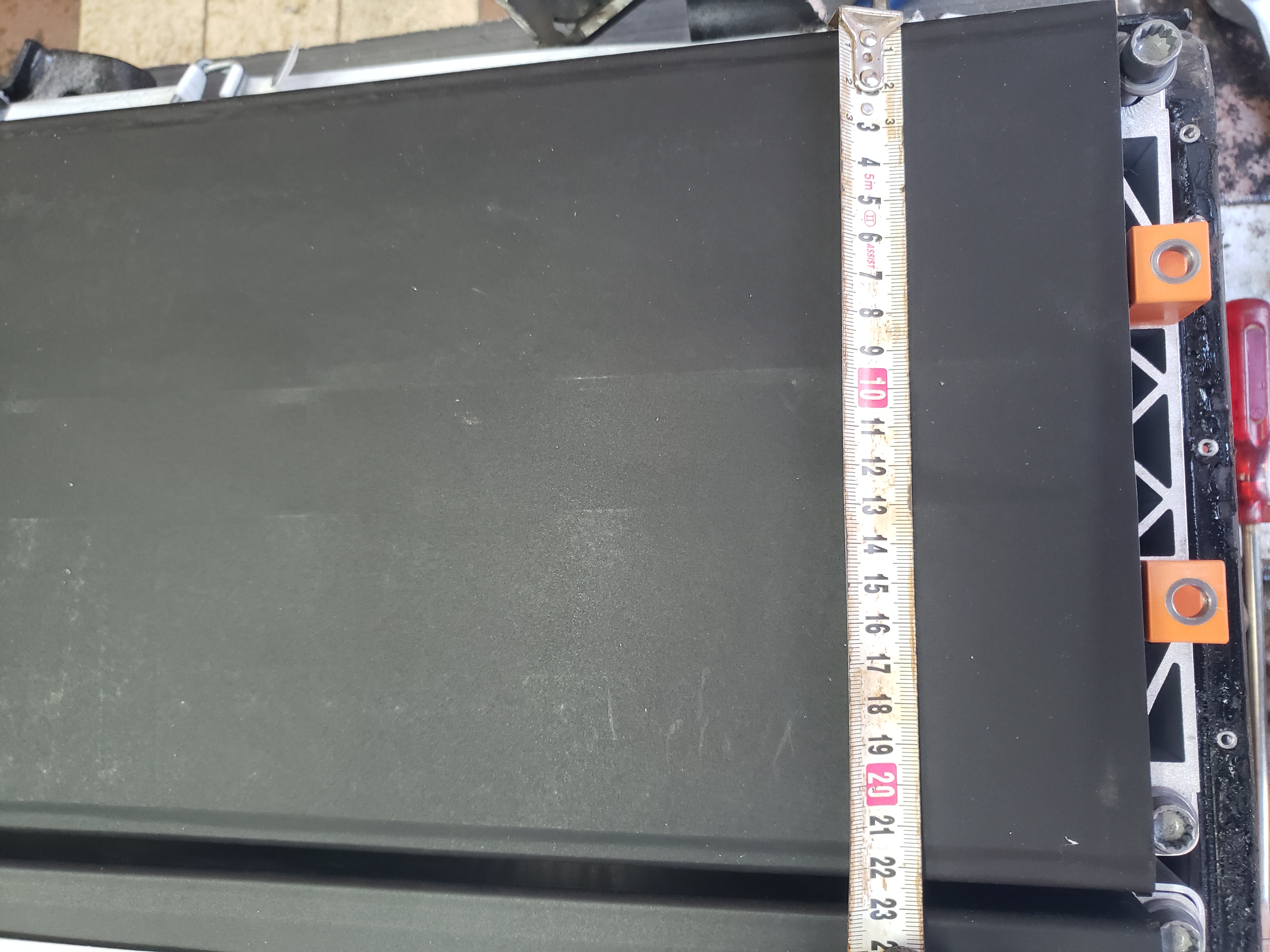

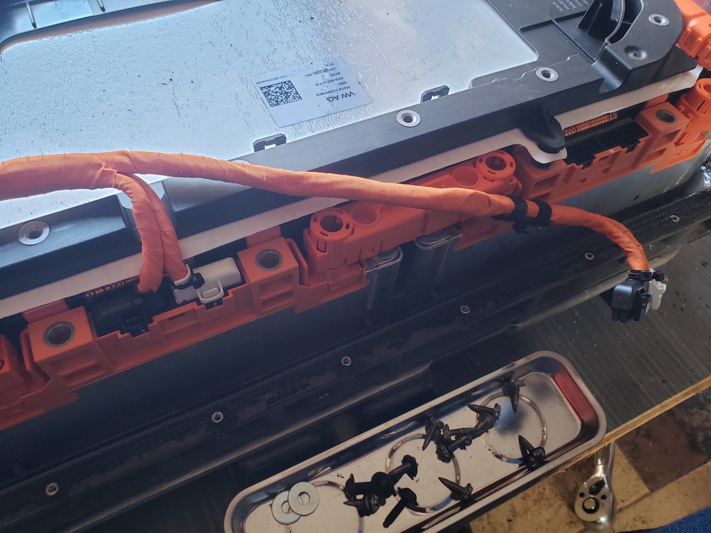

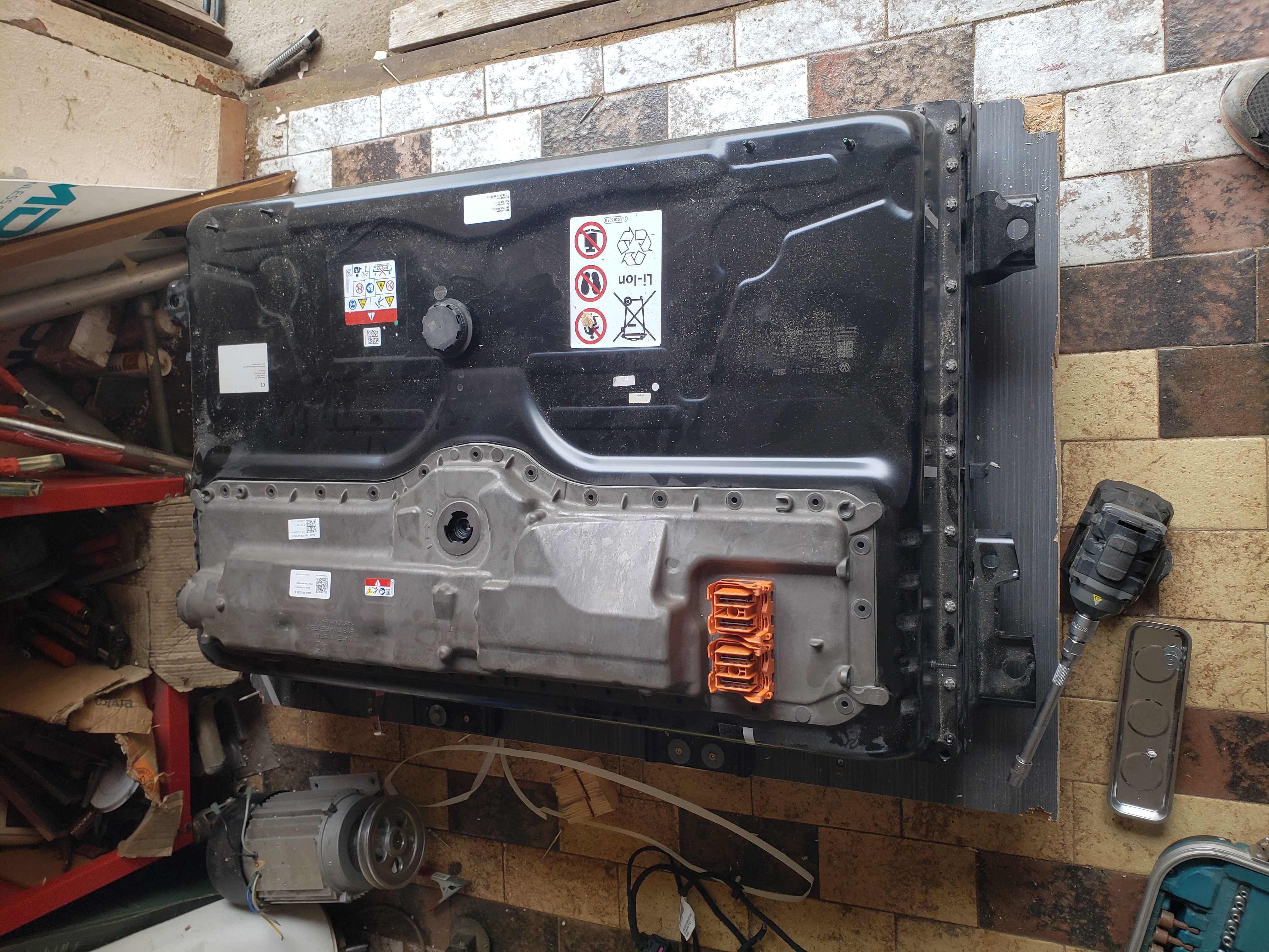

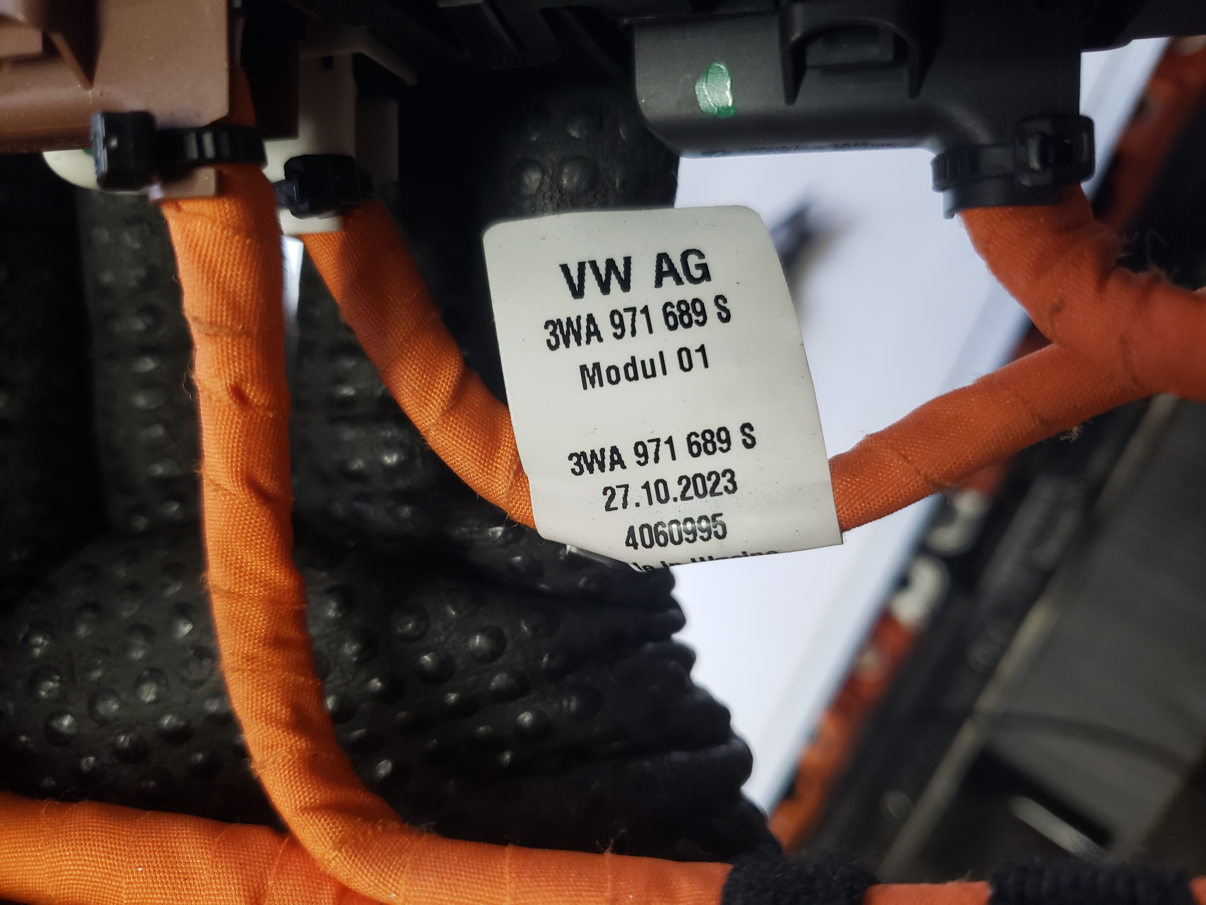

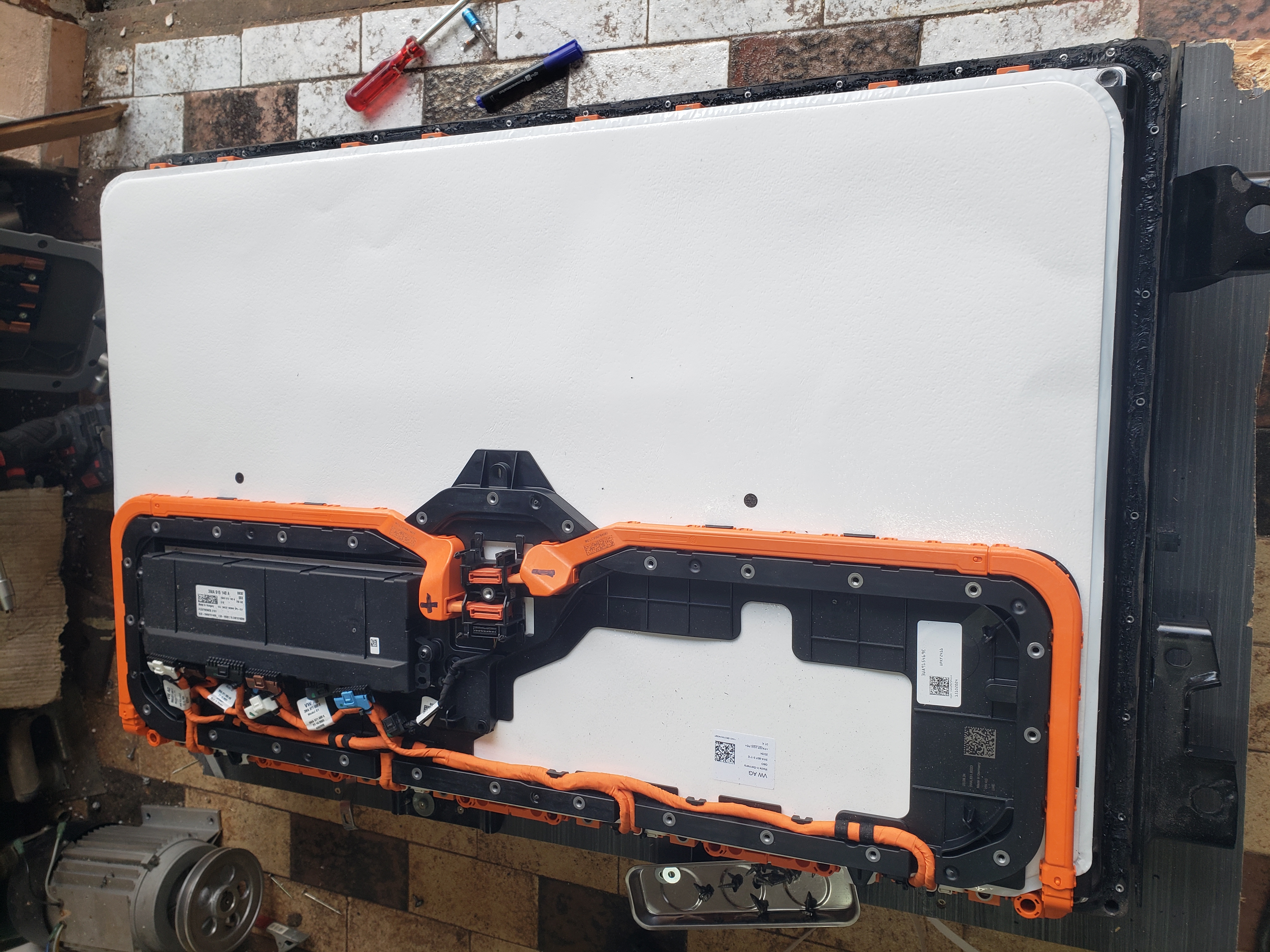

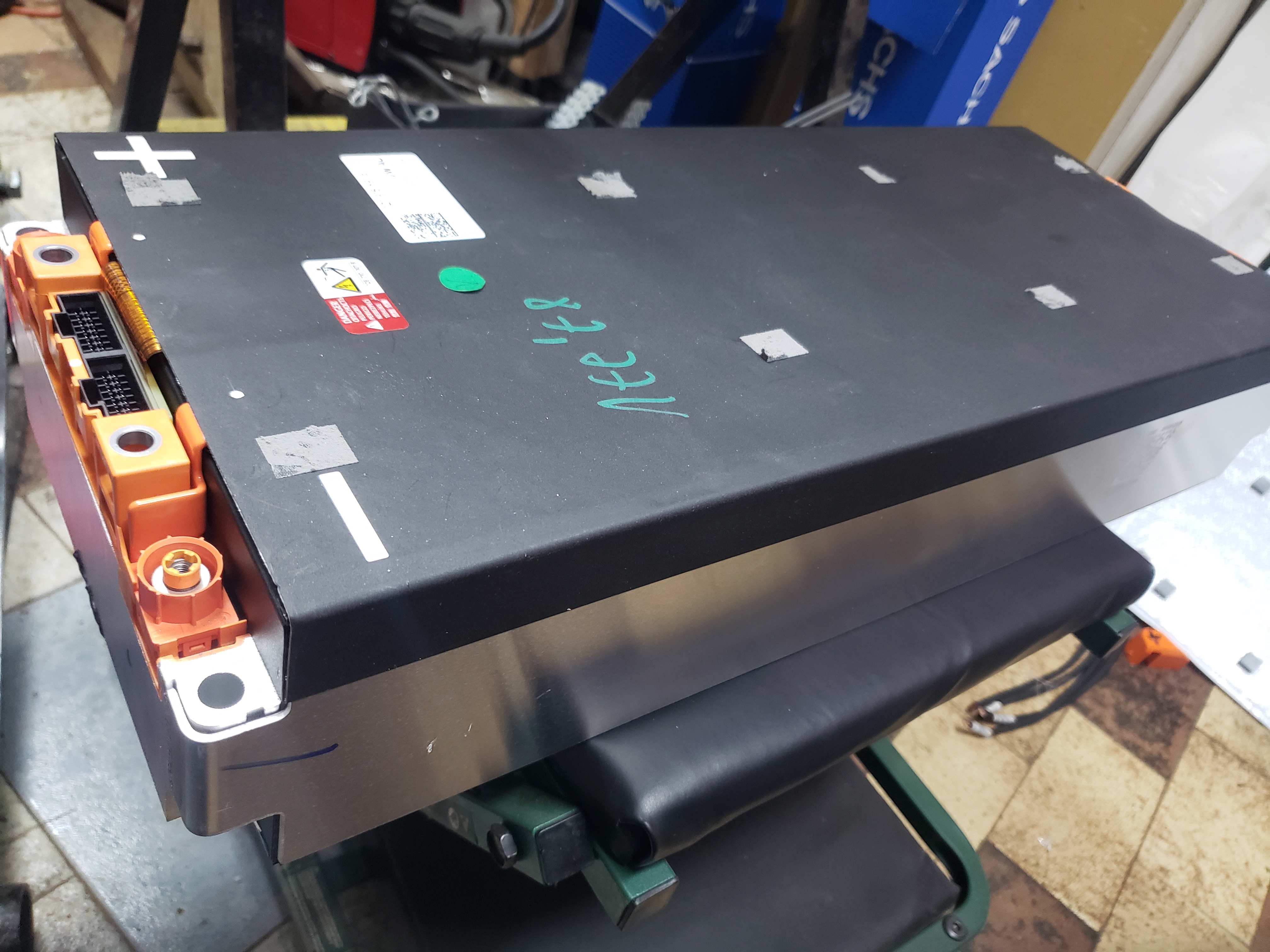

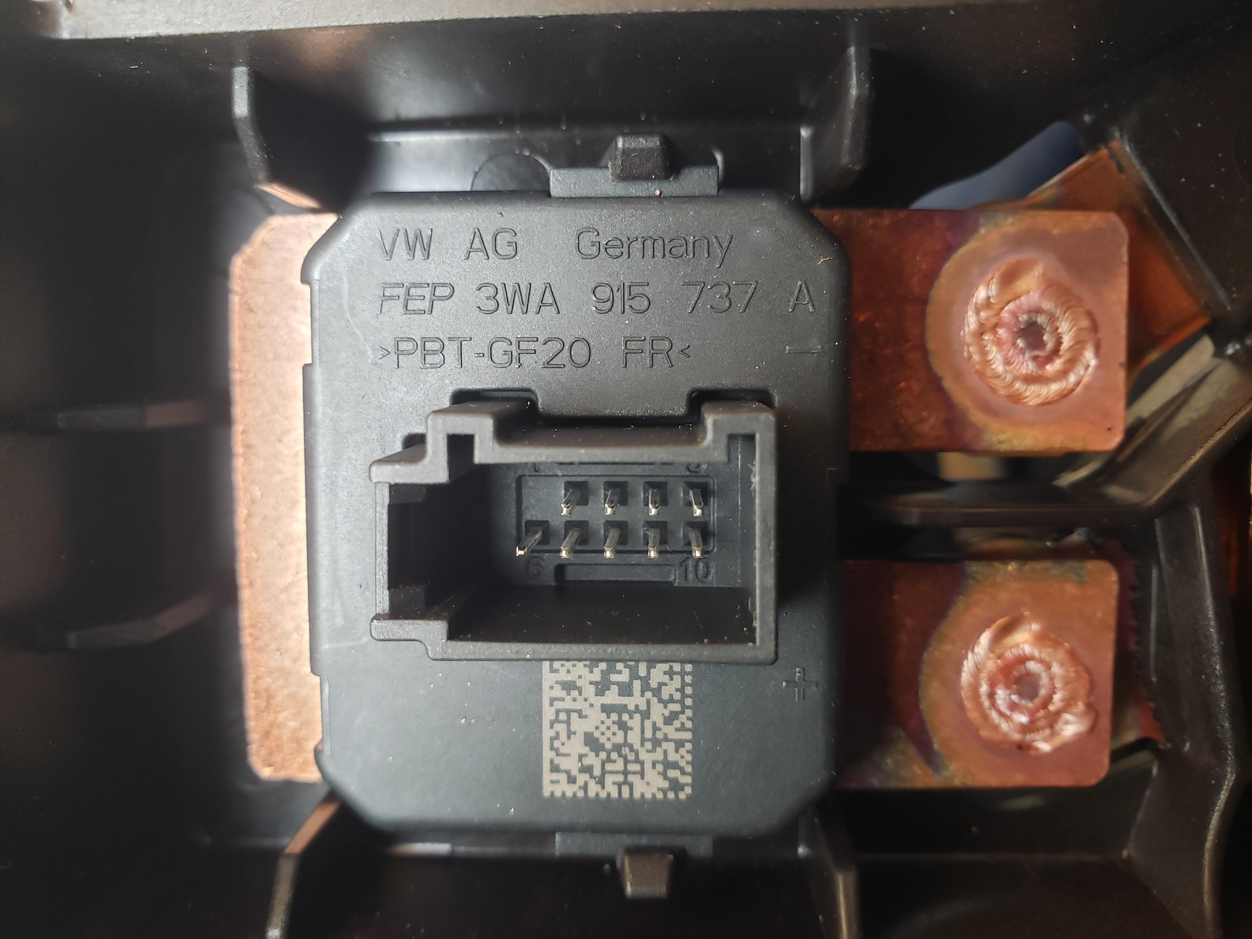

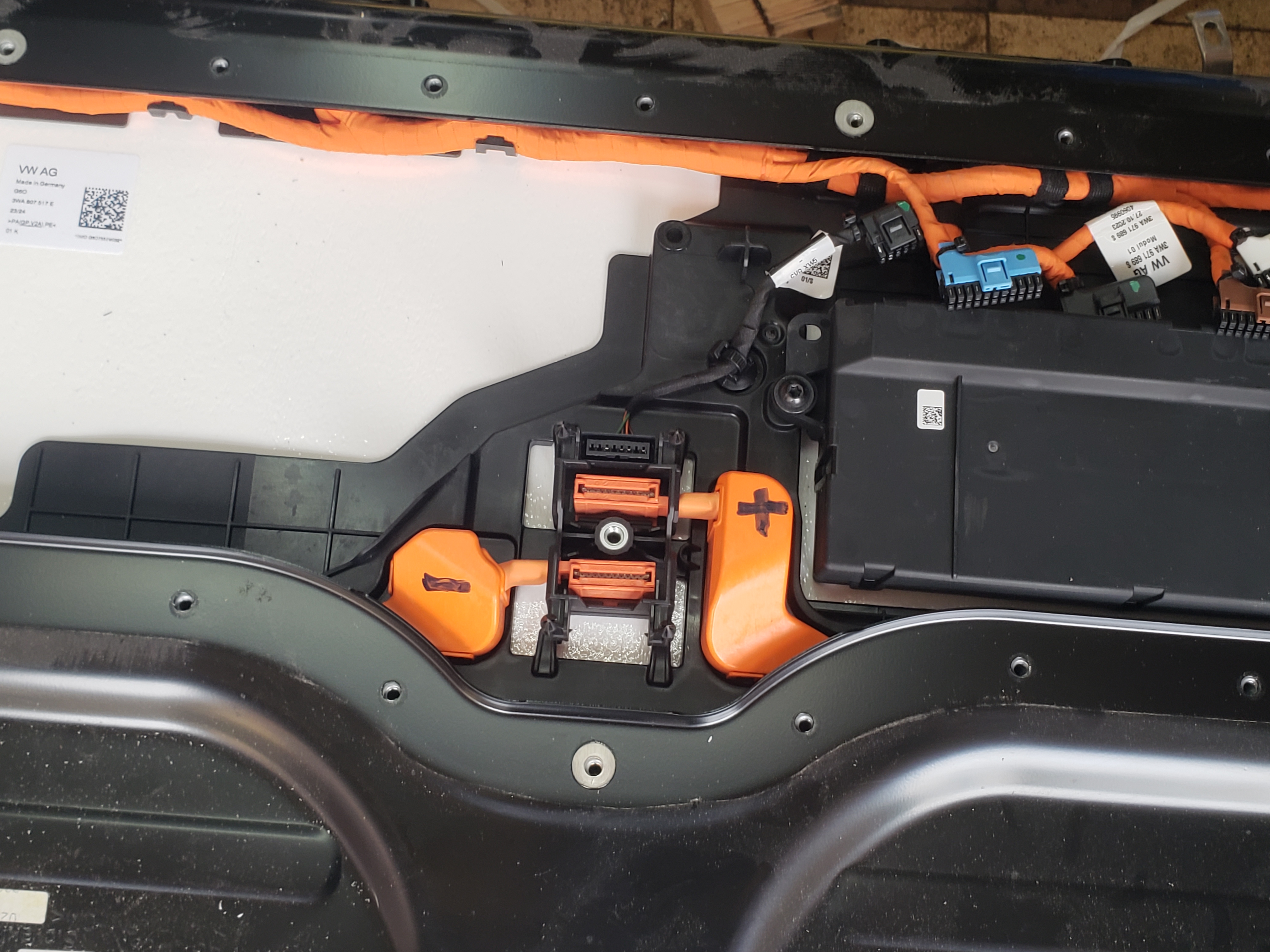

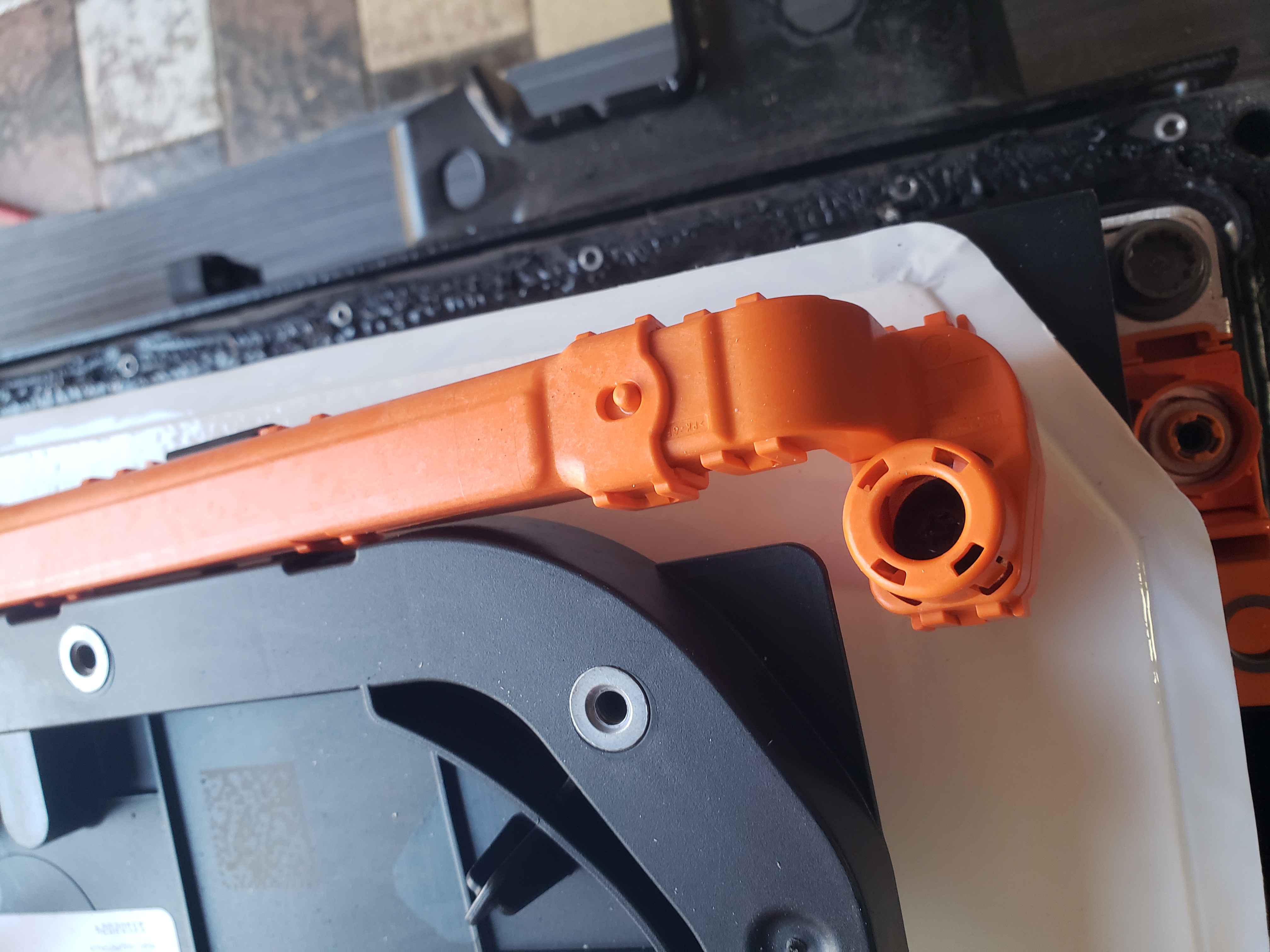

Like i showed cell top is covered by a thick white plastic.

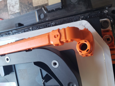

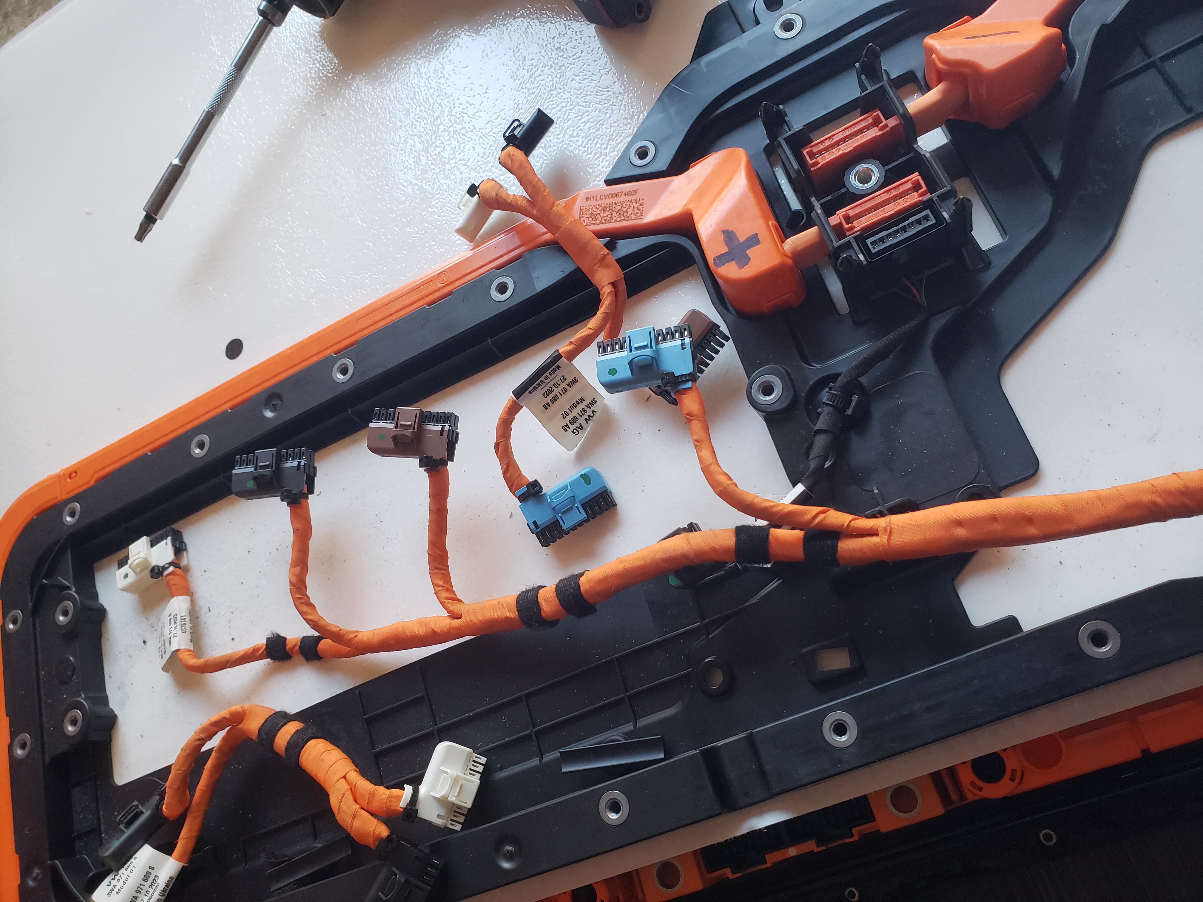

At the front this is framed by orange DC rails which is about 30mm2 of copper and close to 60mm2 of braided copper wire on flexible points.

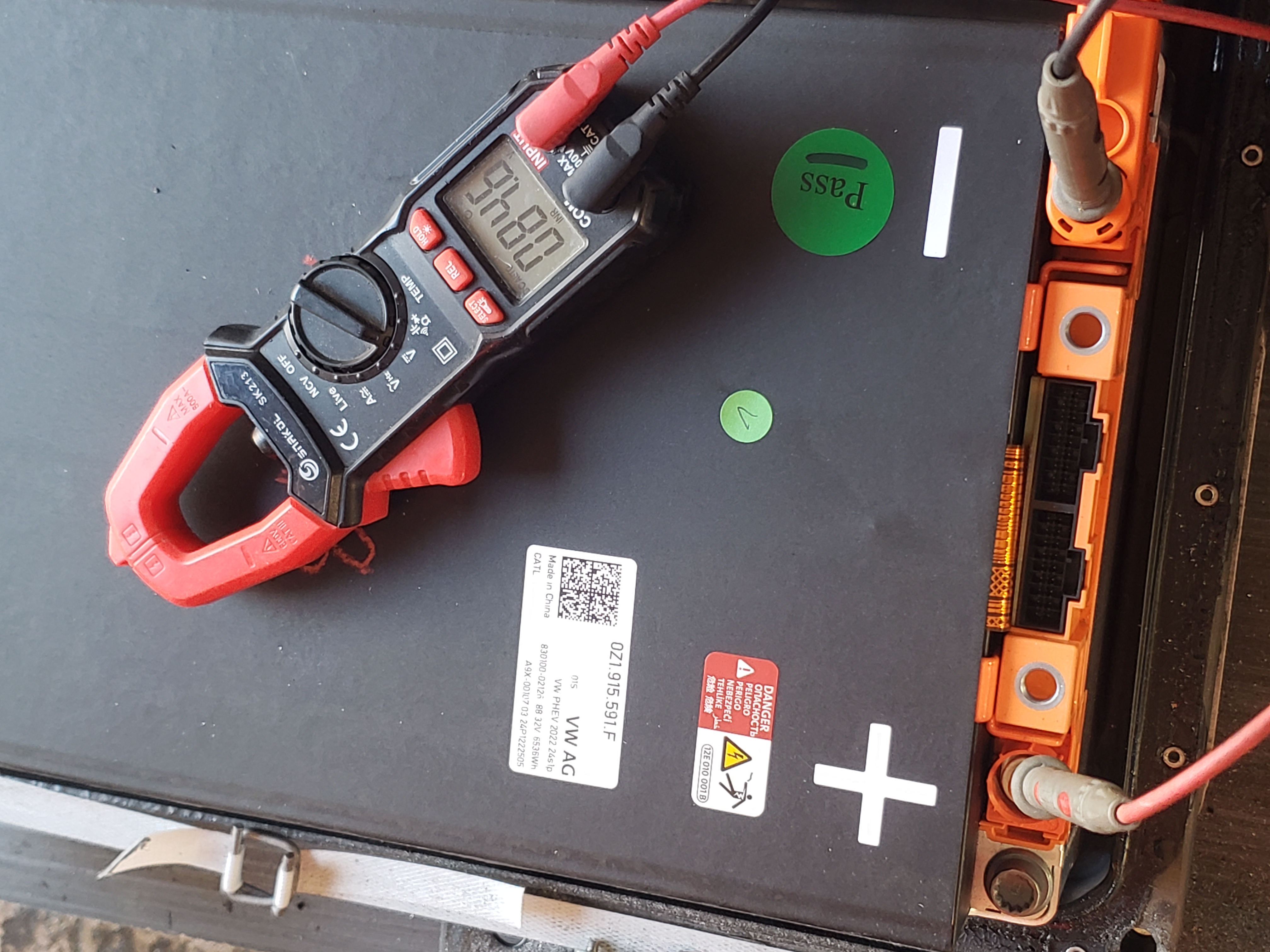

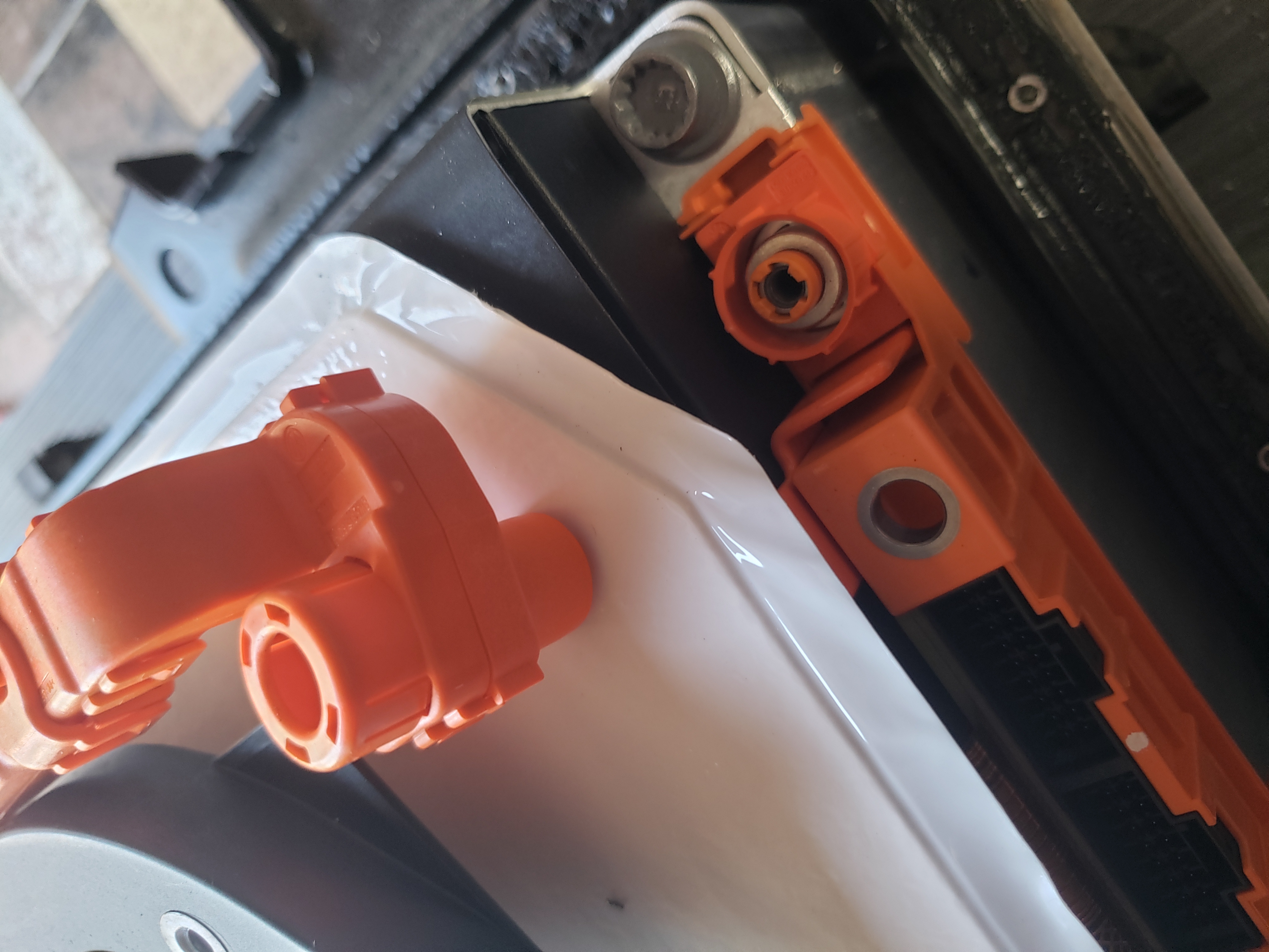

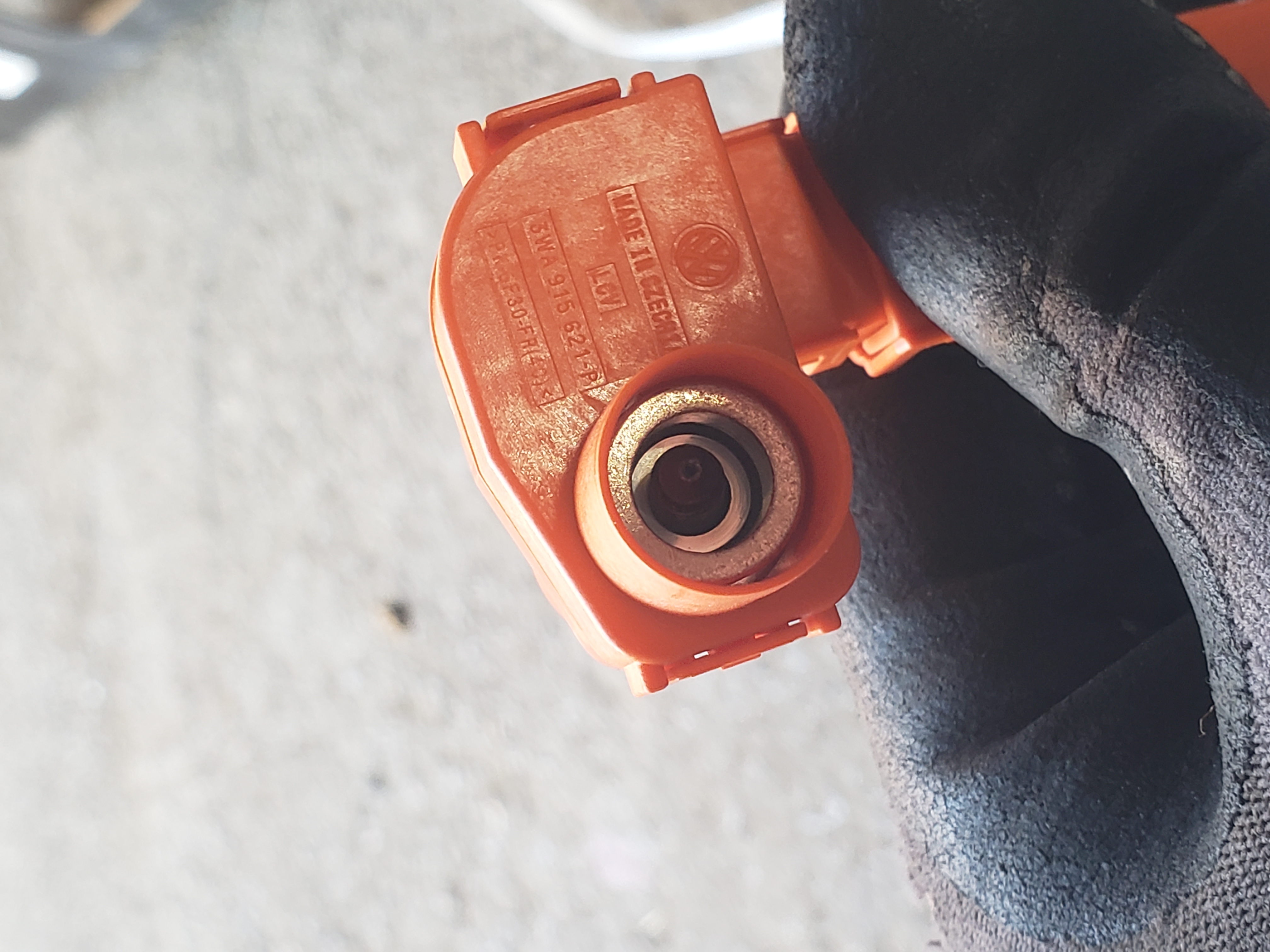

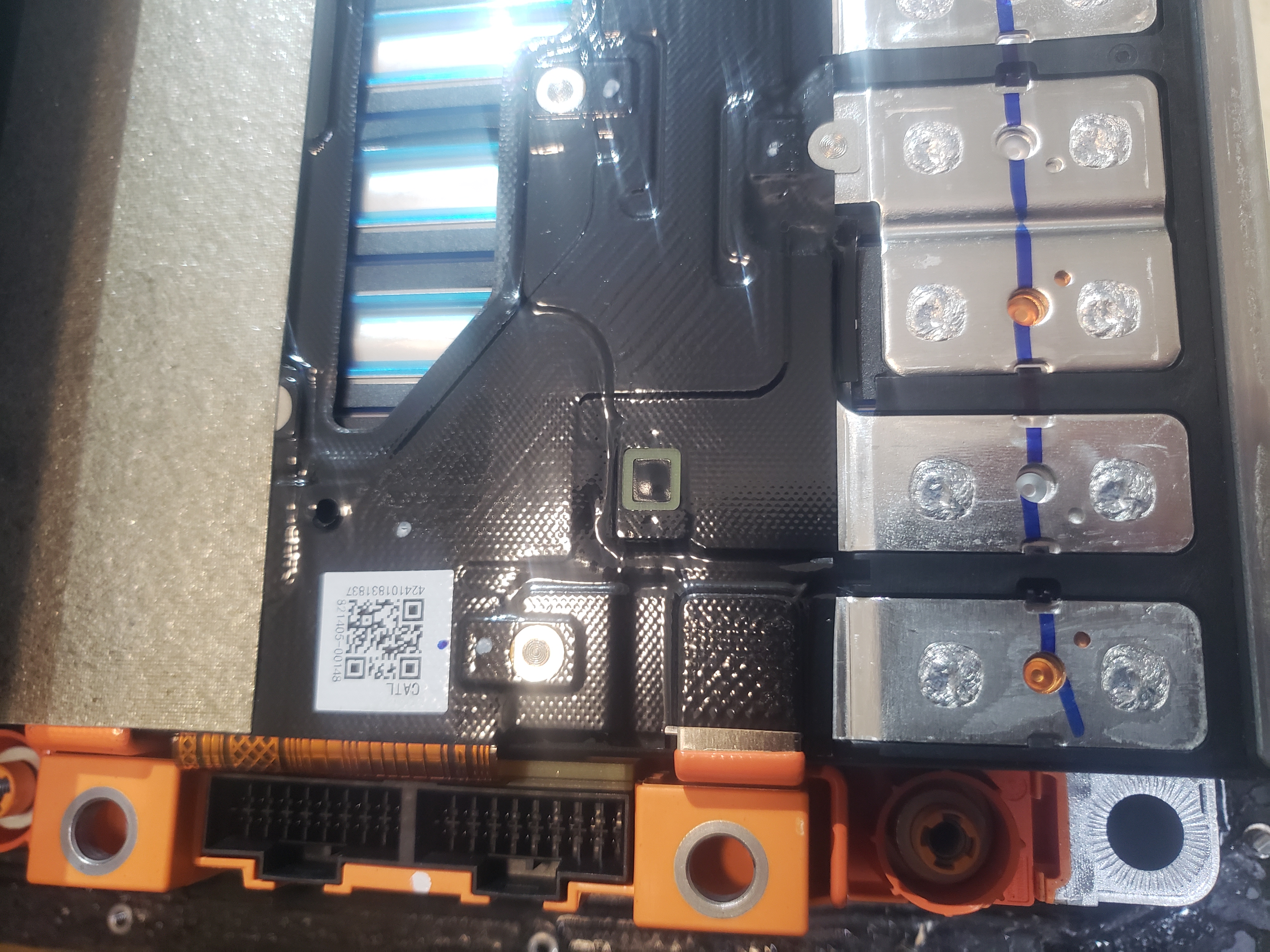

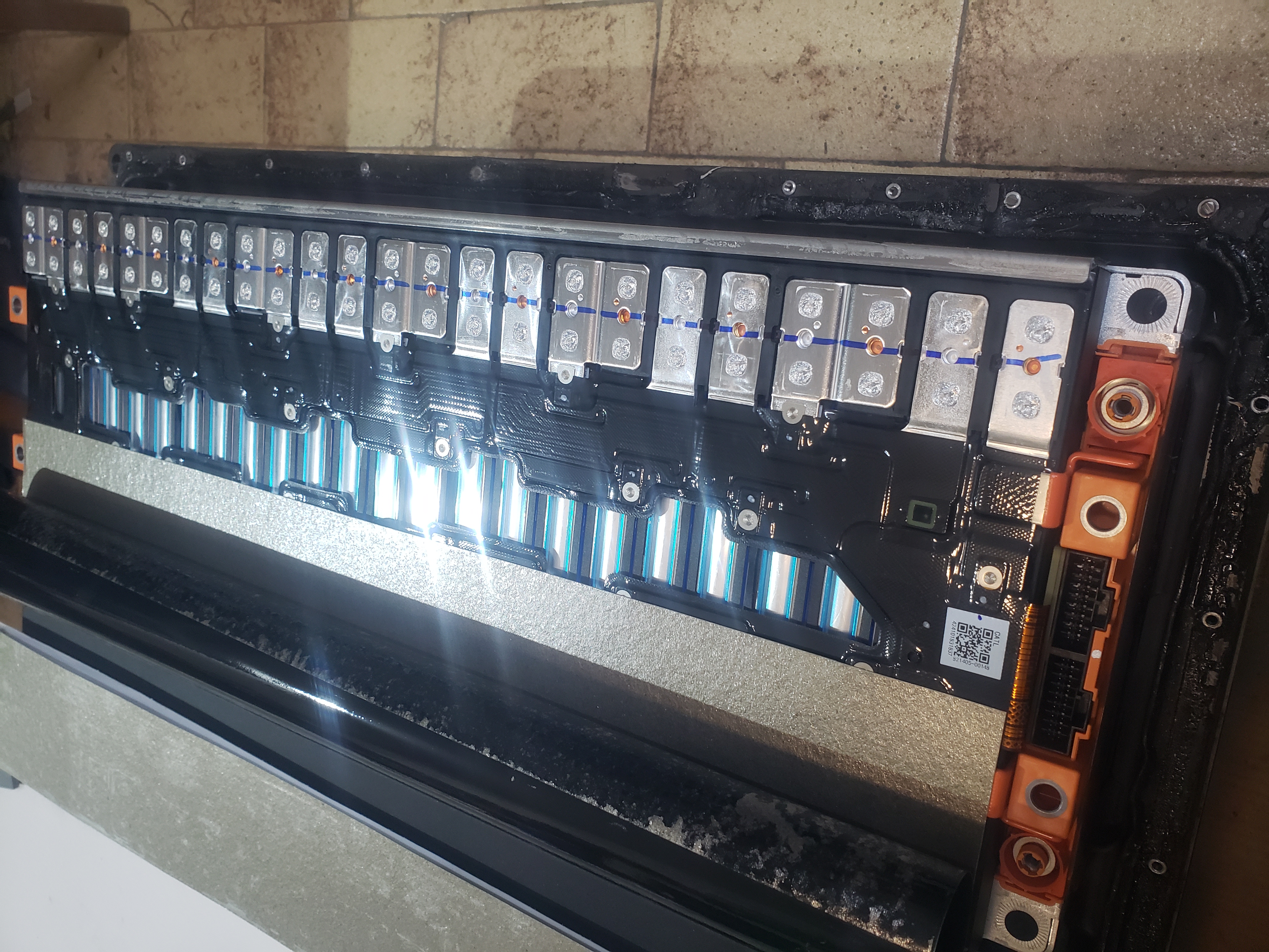

Cell connections are made by unique round joint with M6 torxs screw in the middle.
This is easily unbolted, however i am not sure how much power can those puny contacts carry...

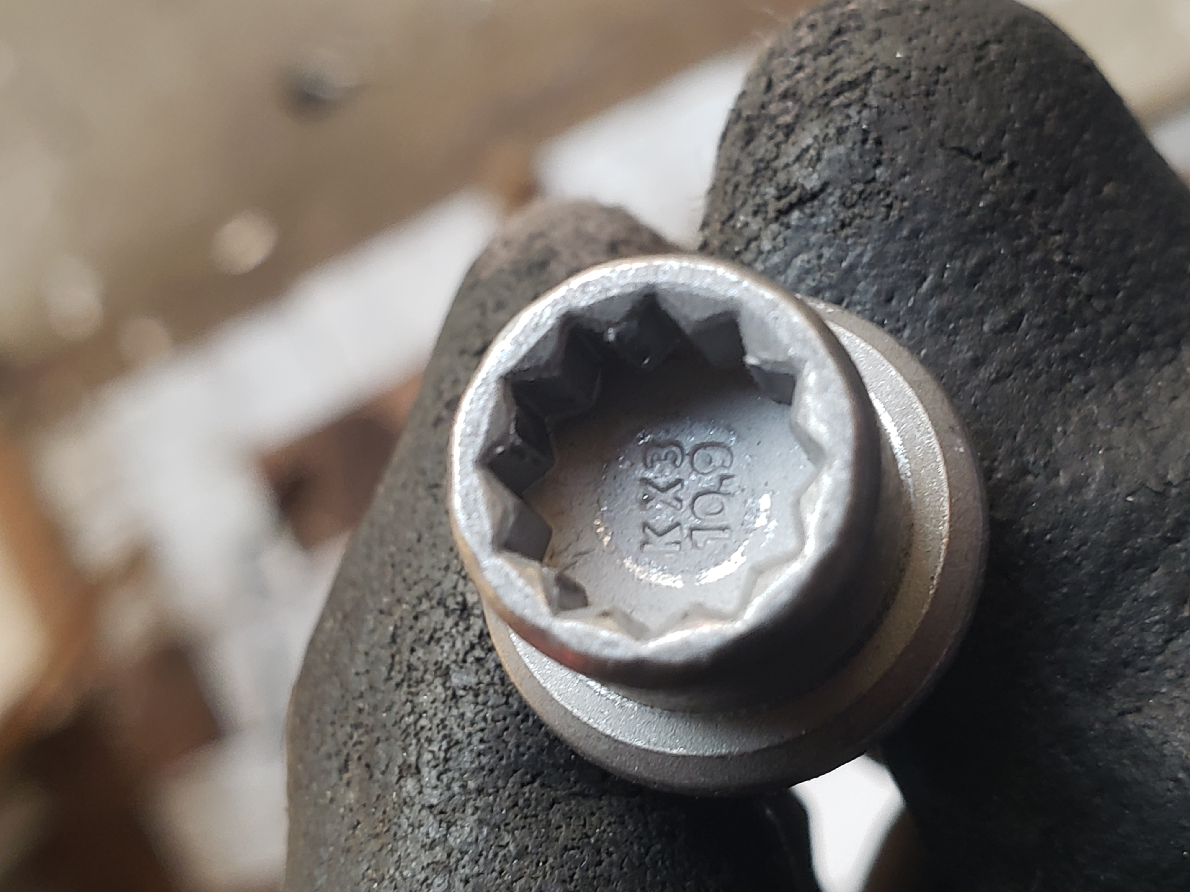

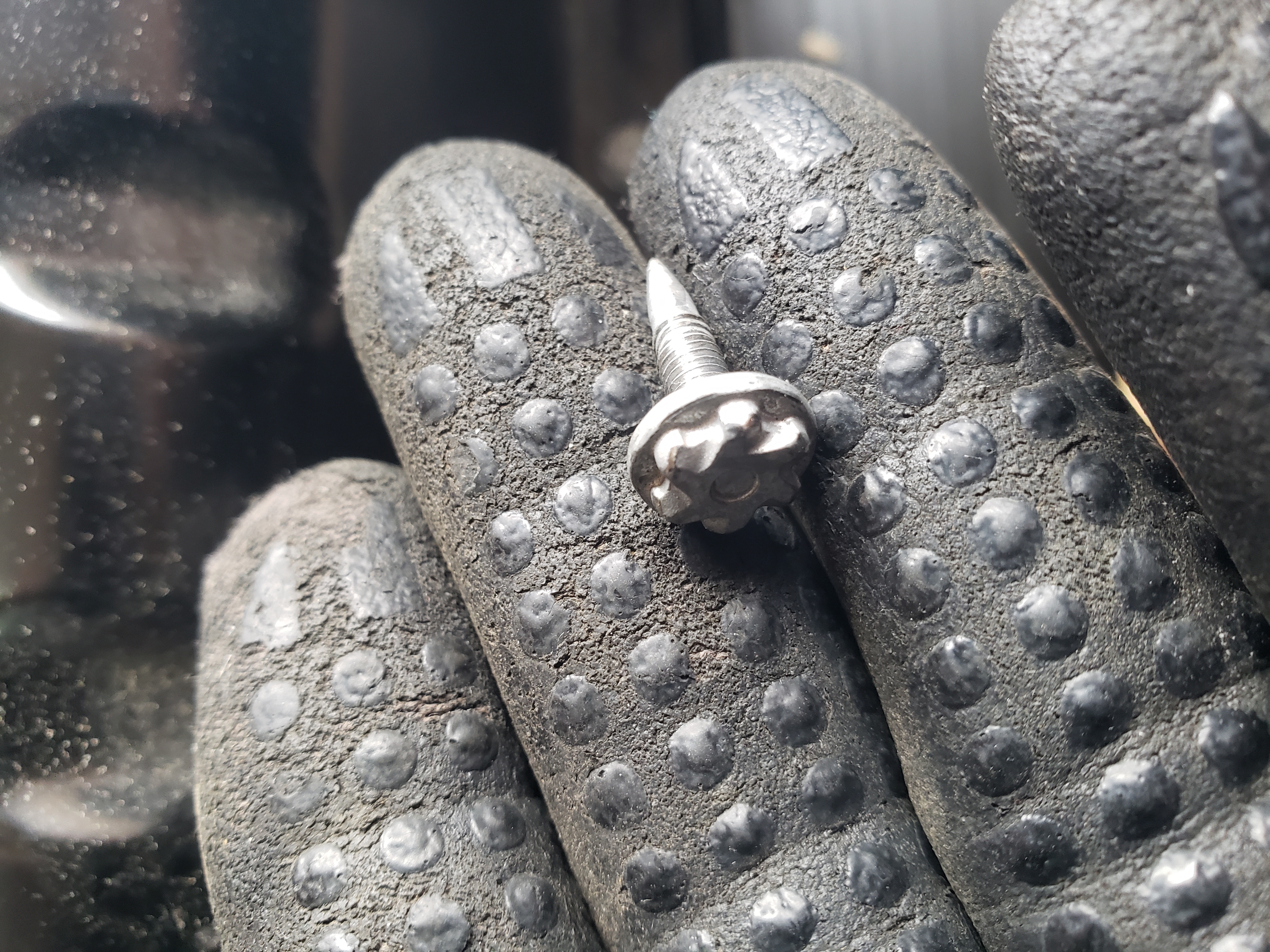

Cell modules are retained by 4x M8 strange torx bolts per module. I had to get a special tool from a friend because i dont have this one and my ordinary torx would skip if i applied too much torque...

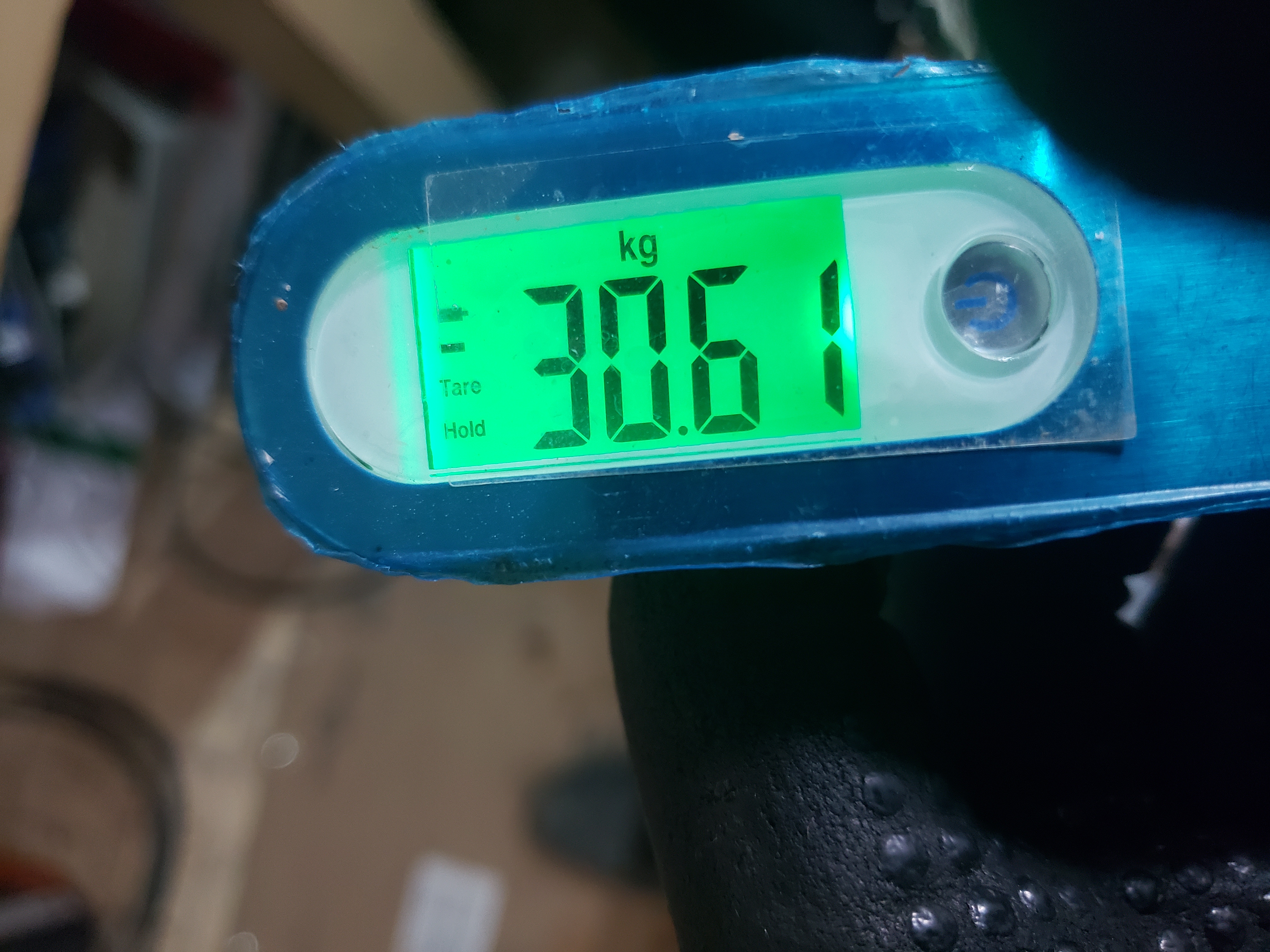

Modules are 4x 24S1P configuration energy 6,54kWh and about 50kg each. I will weigh them later using a luggage scale when i prepare myself

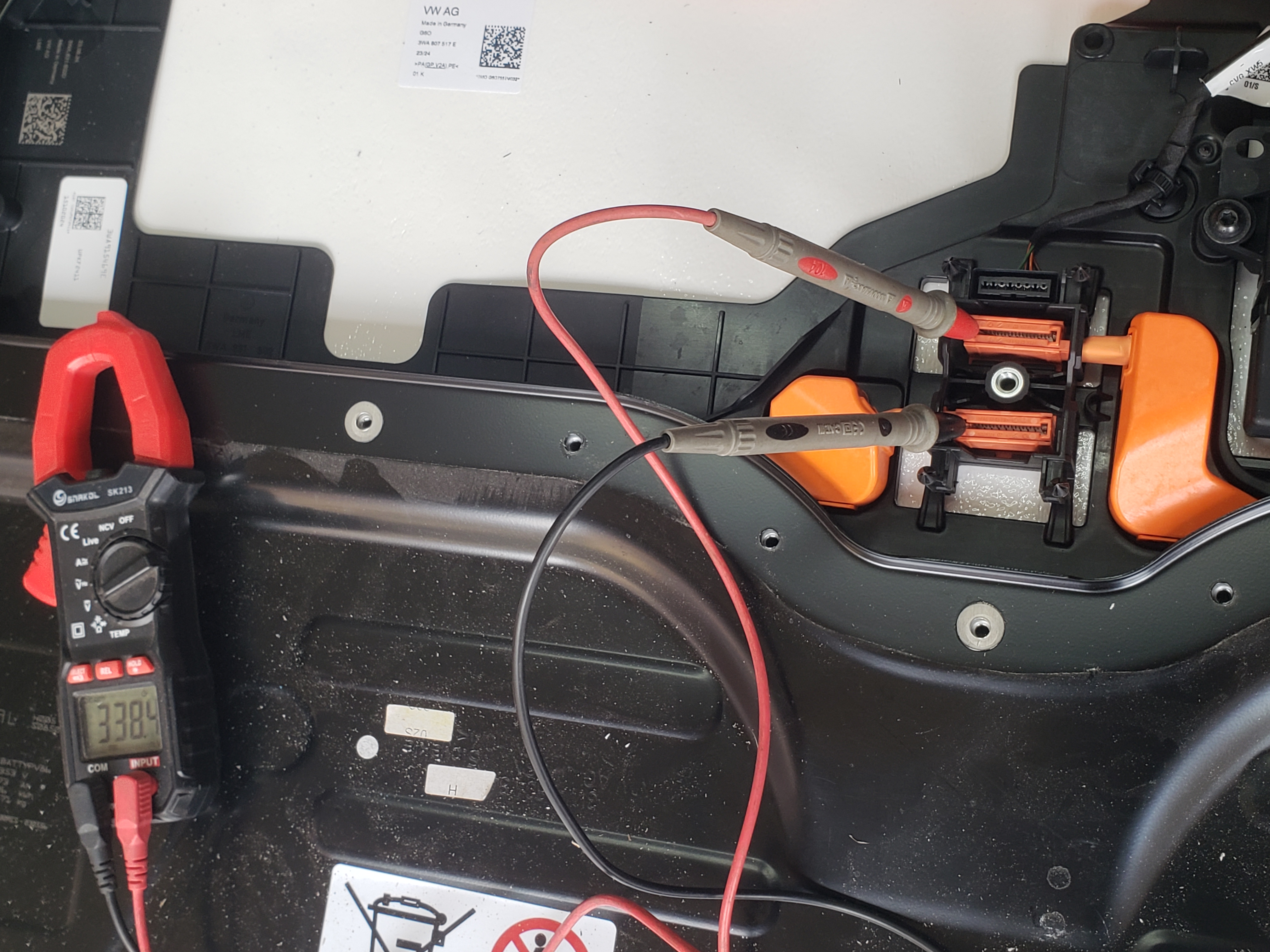

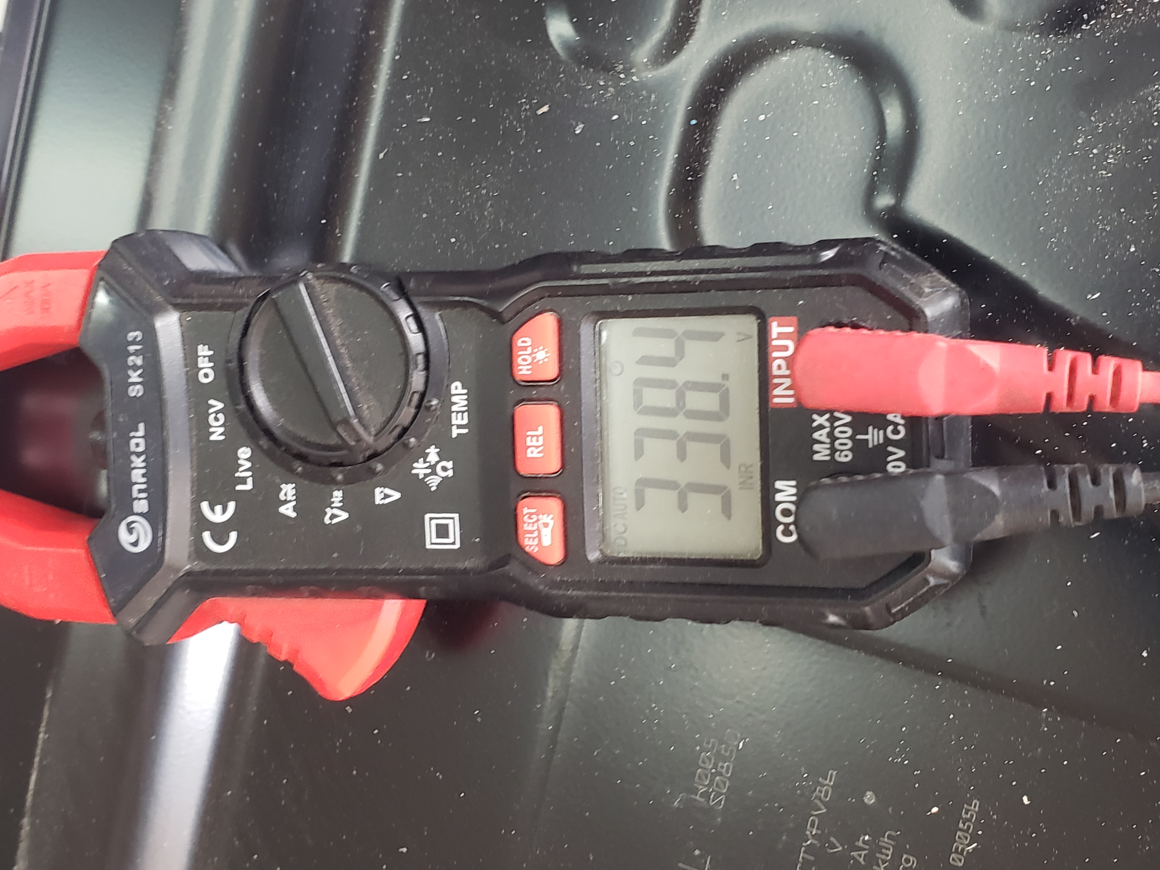

I tested them for voltage and all were exactly at 84,6Vdc

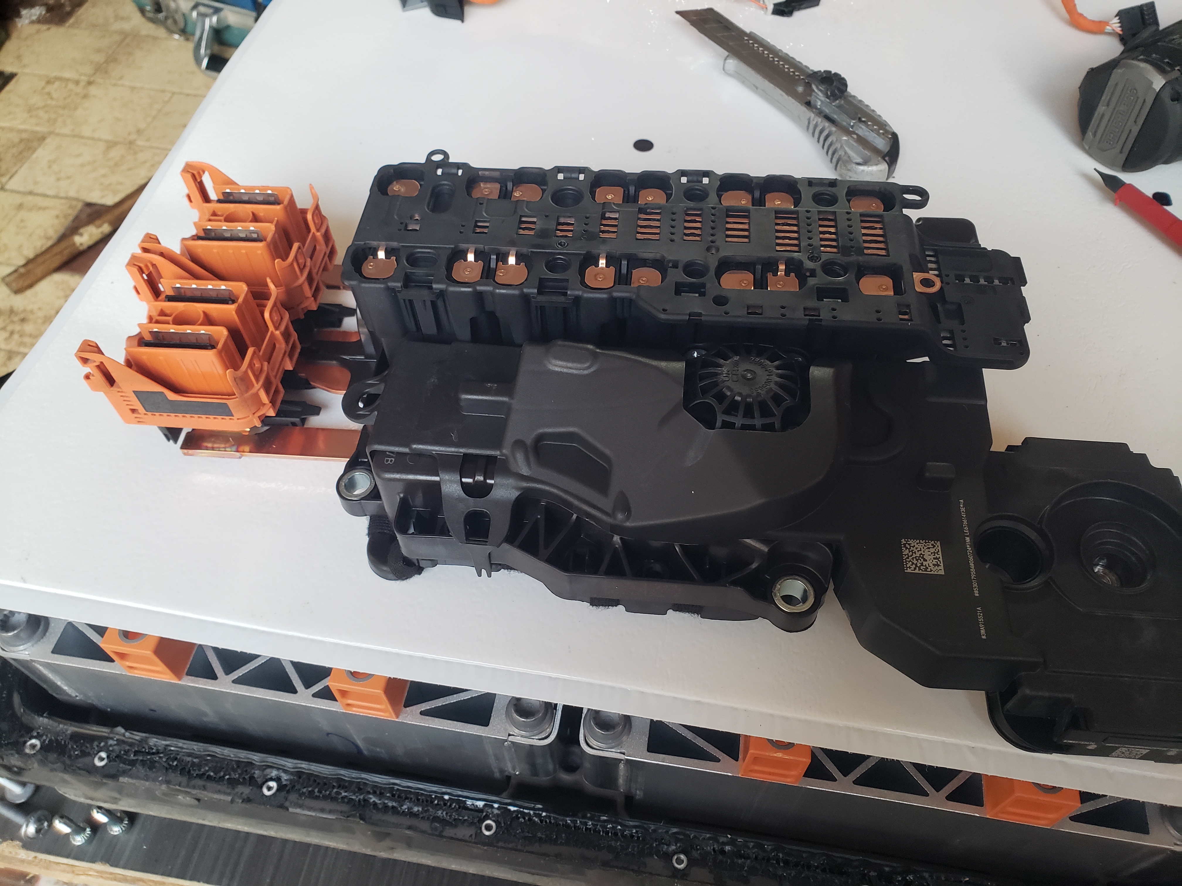

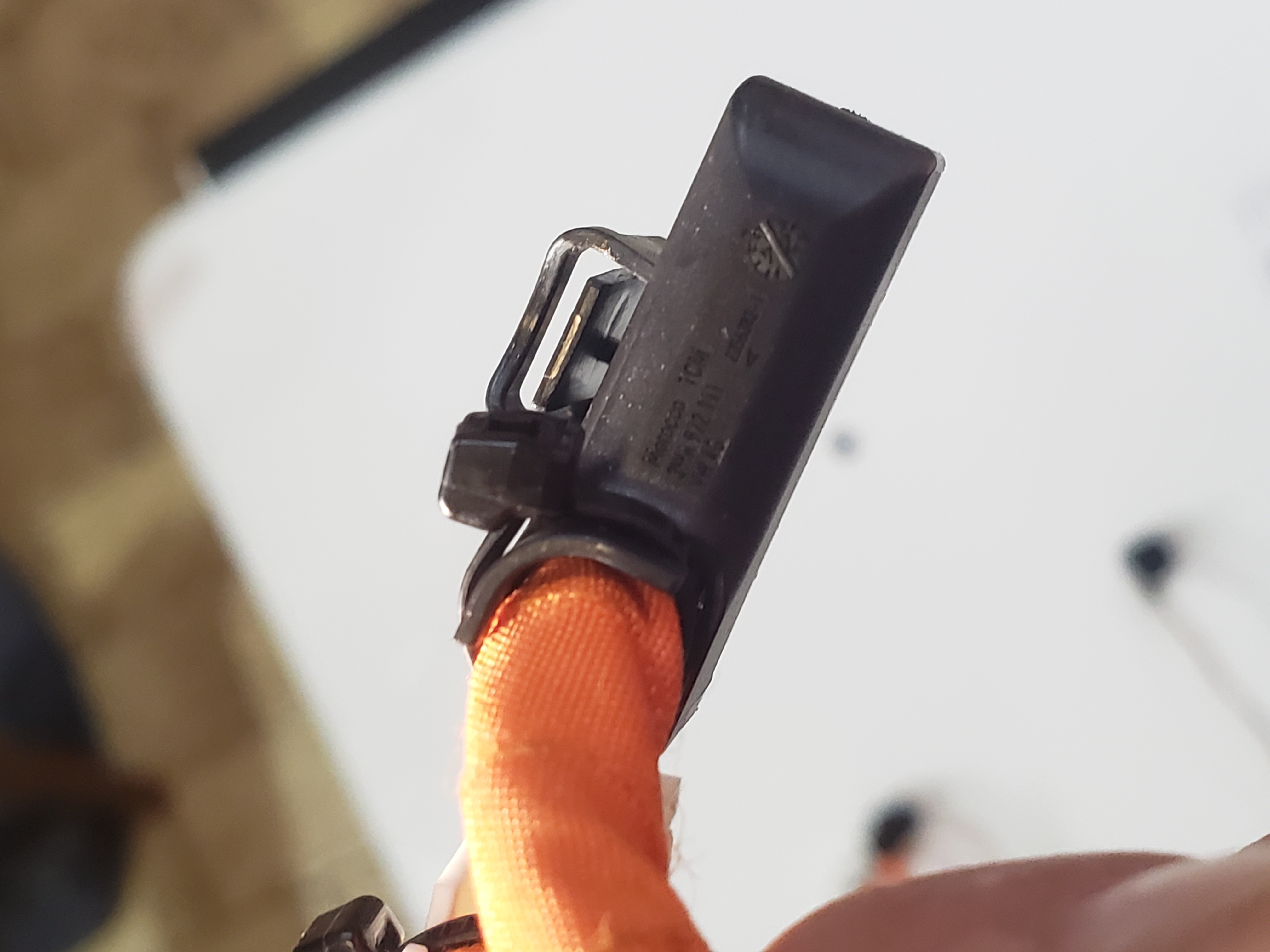

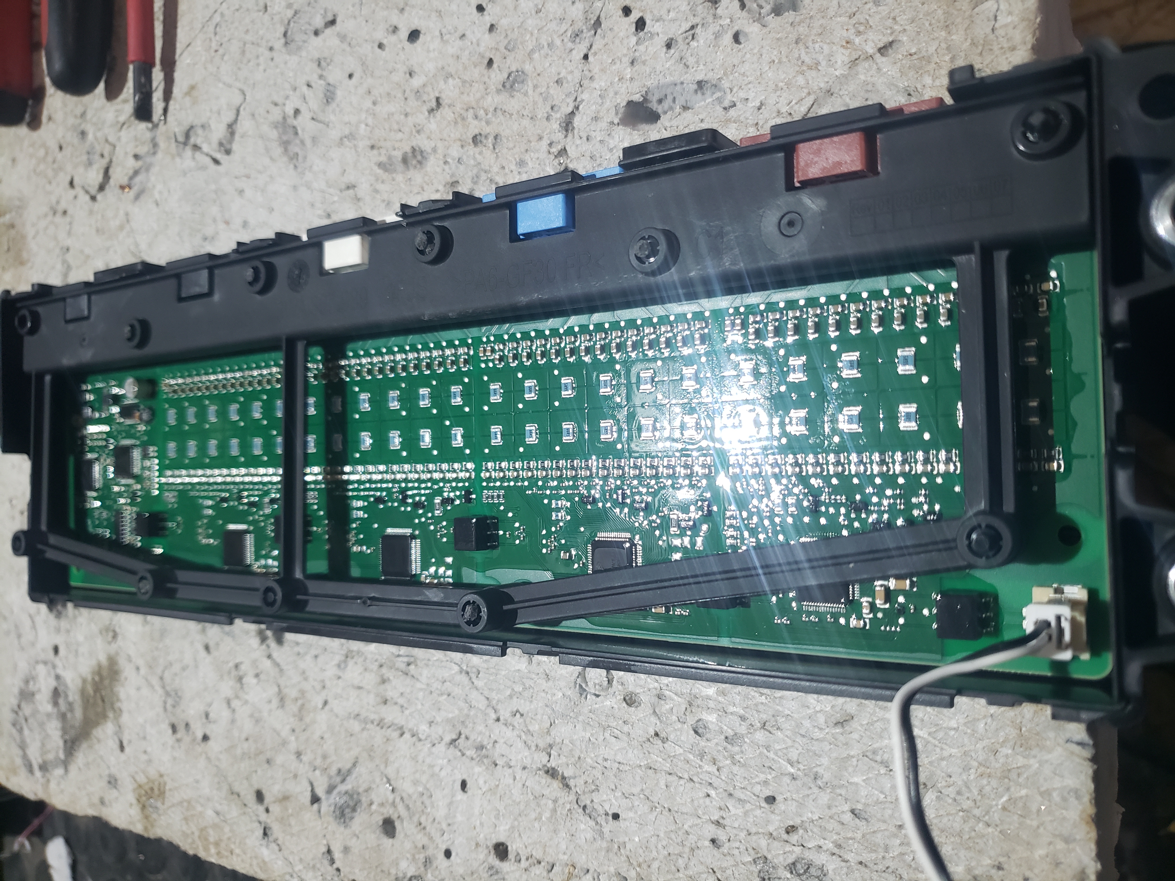

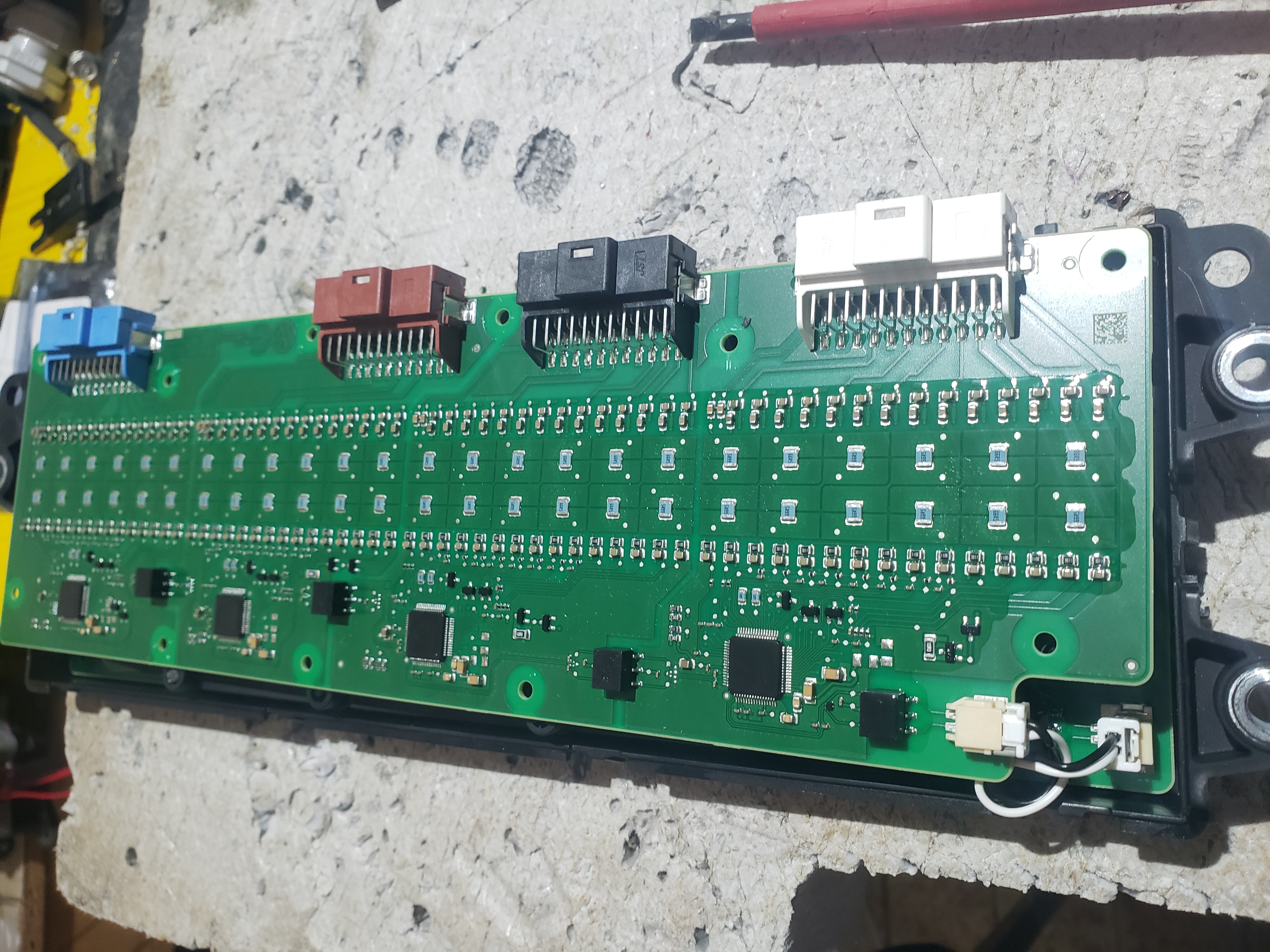

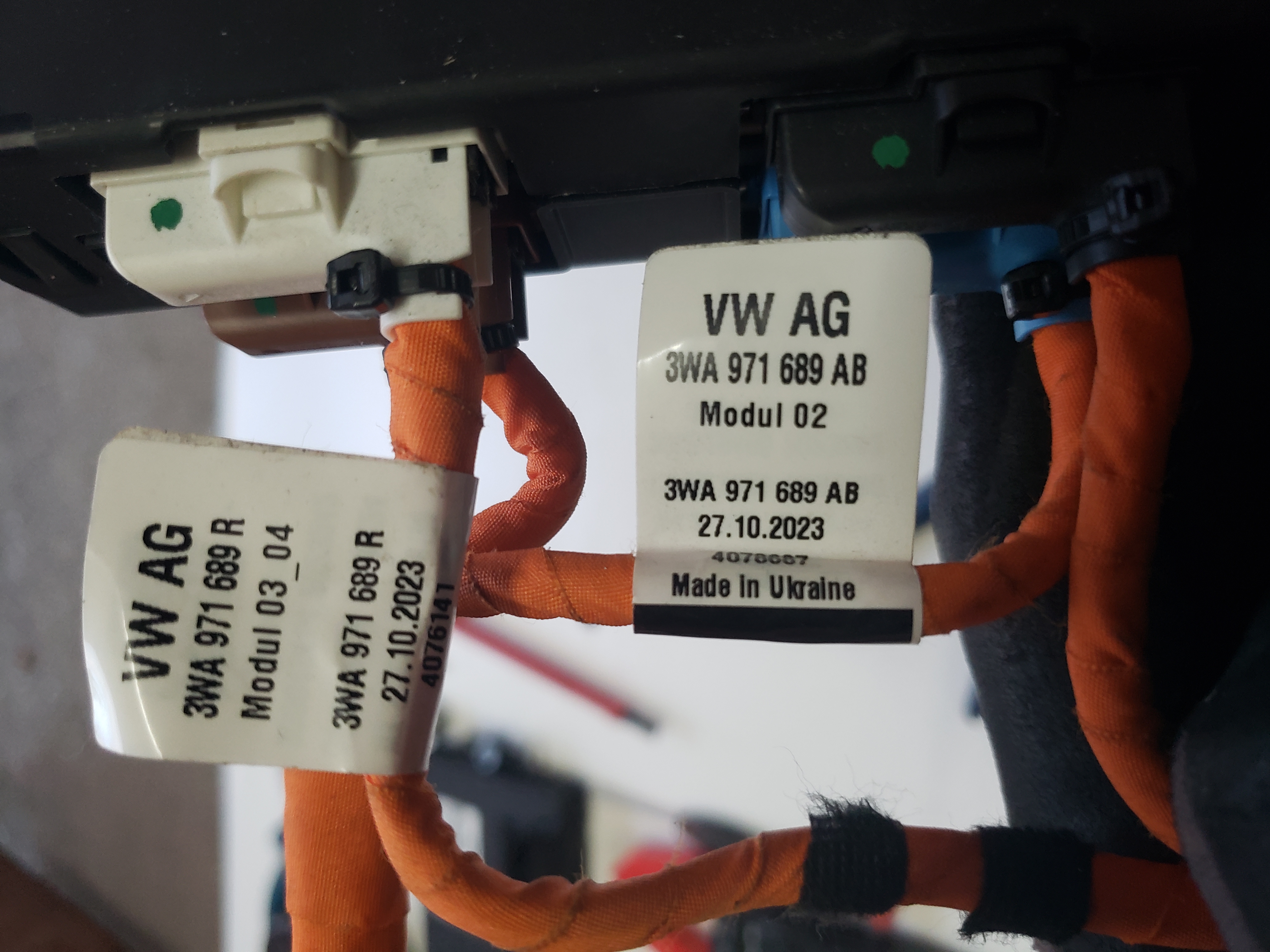

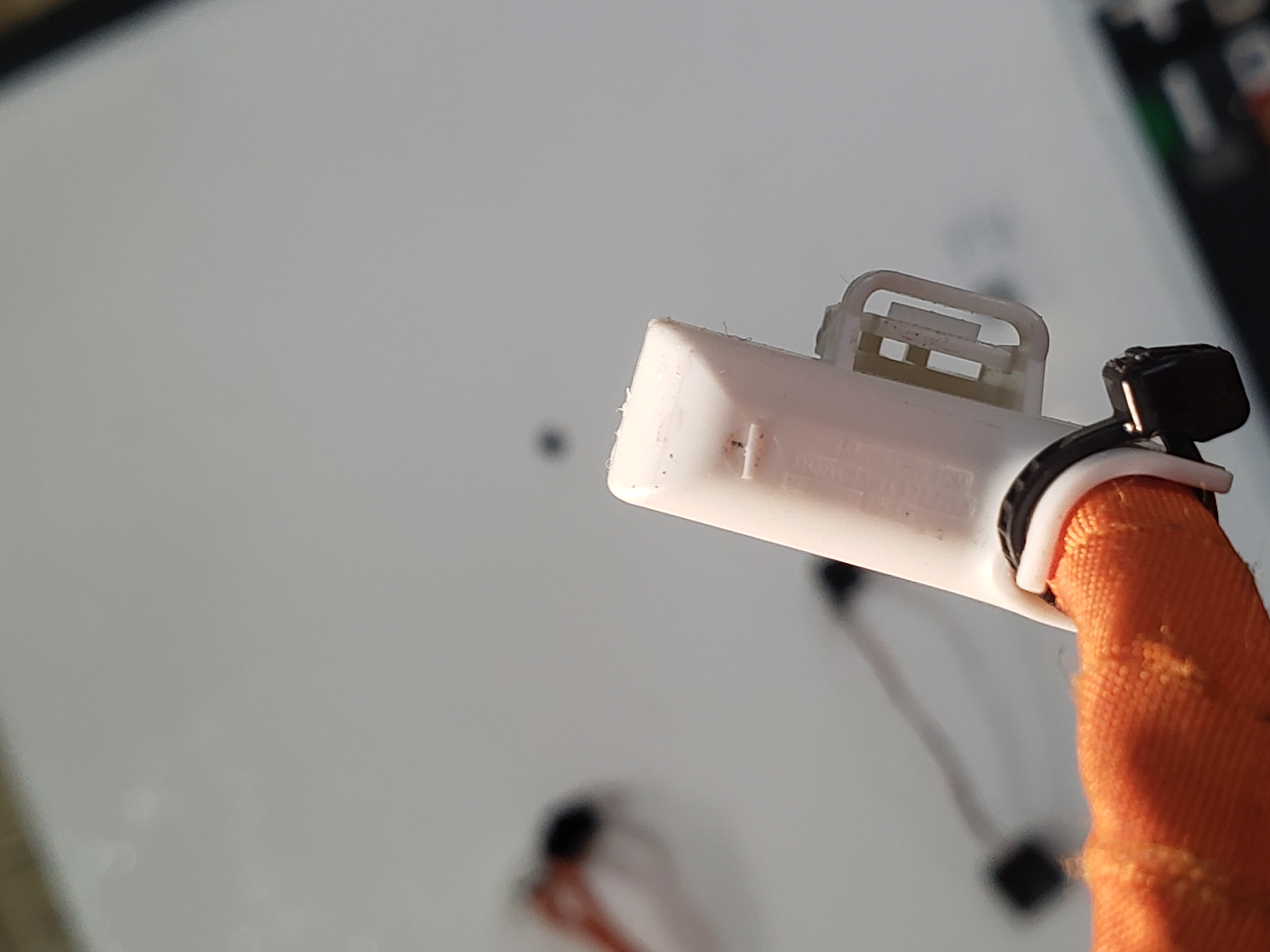

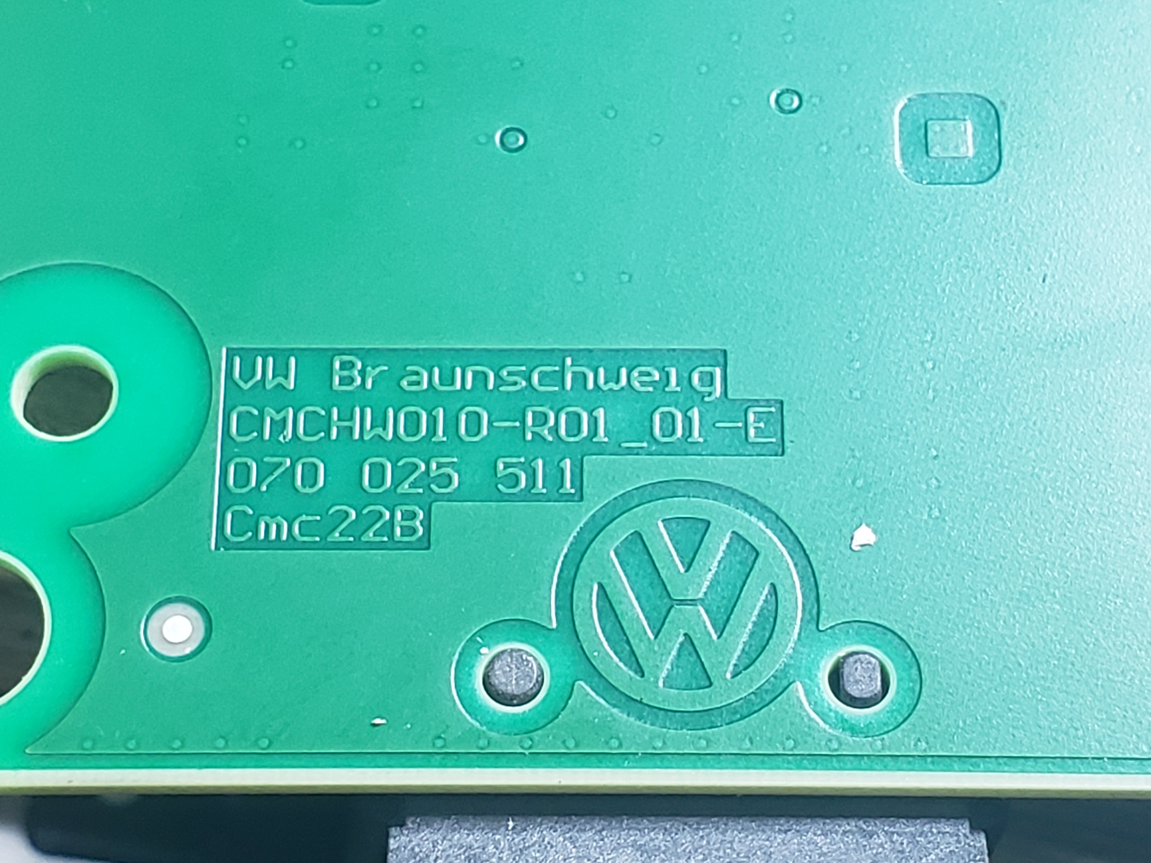

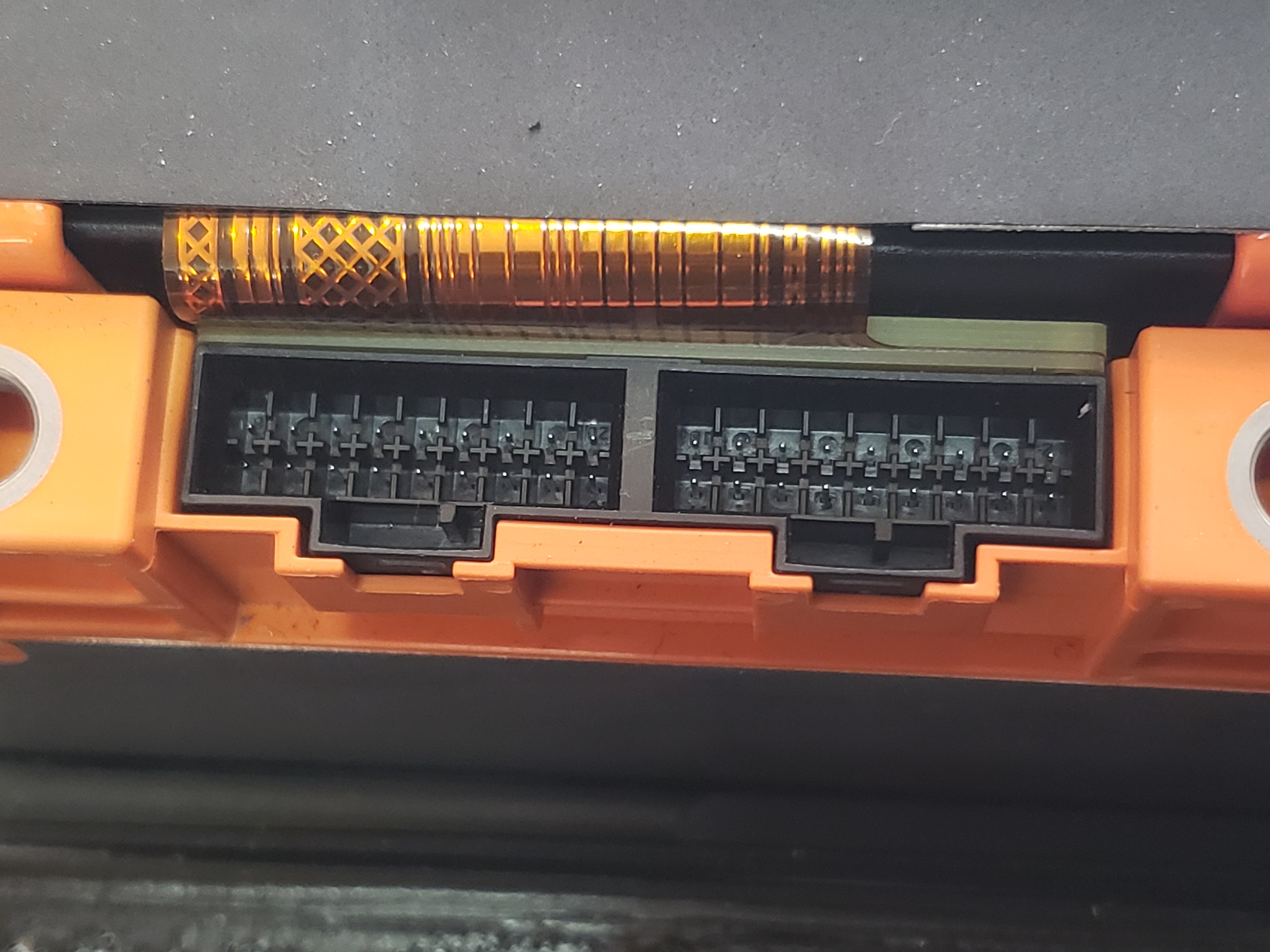

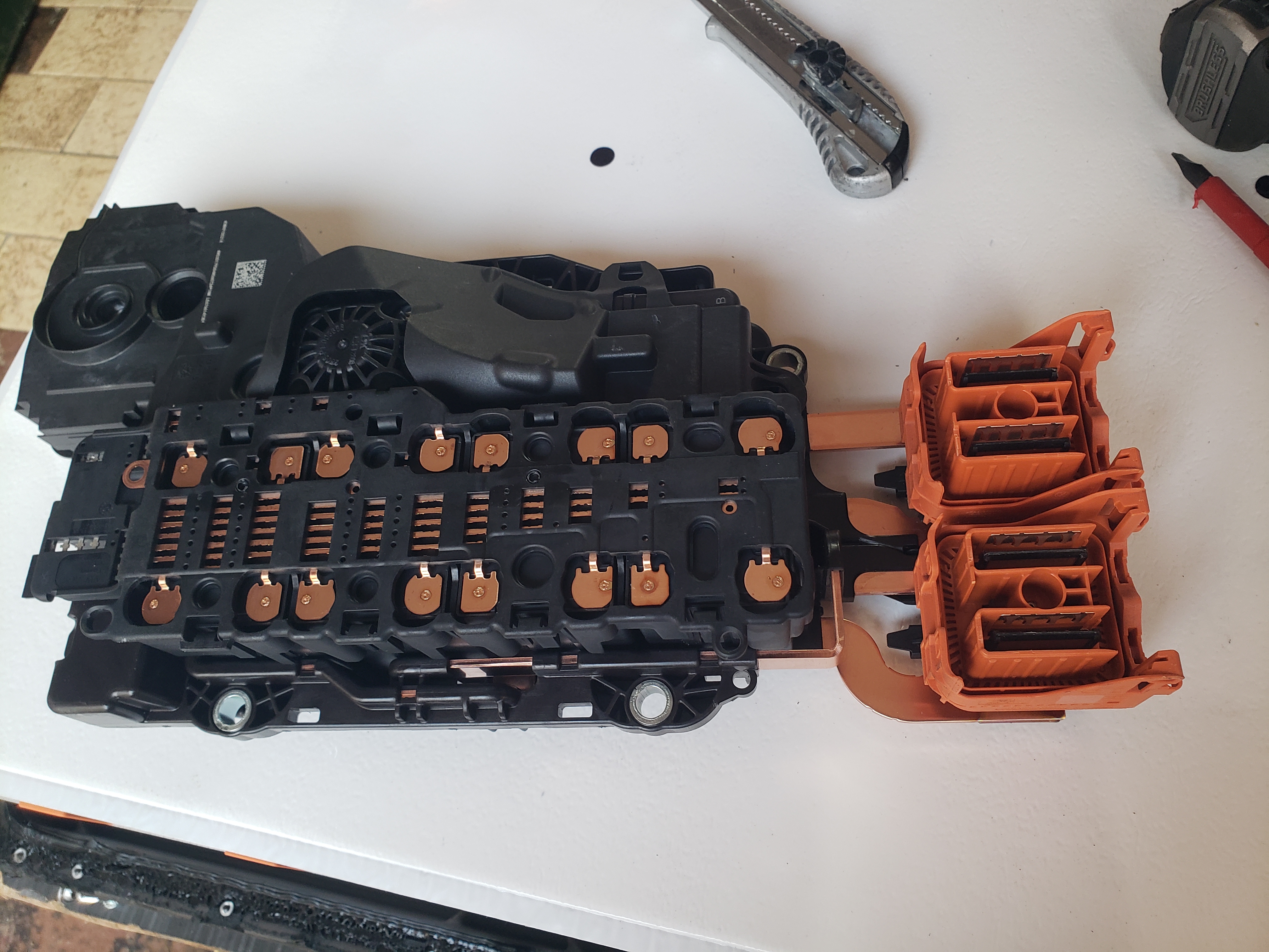

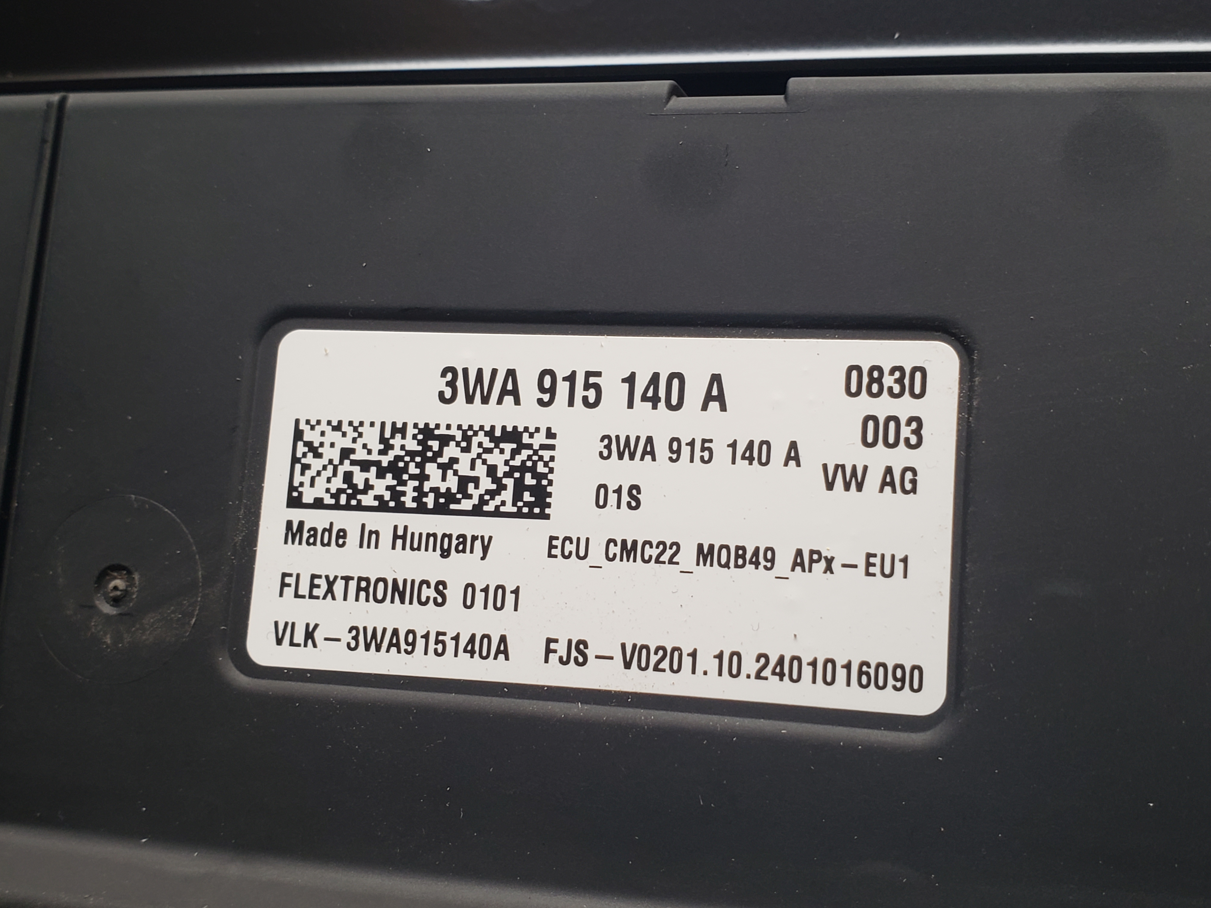

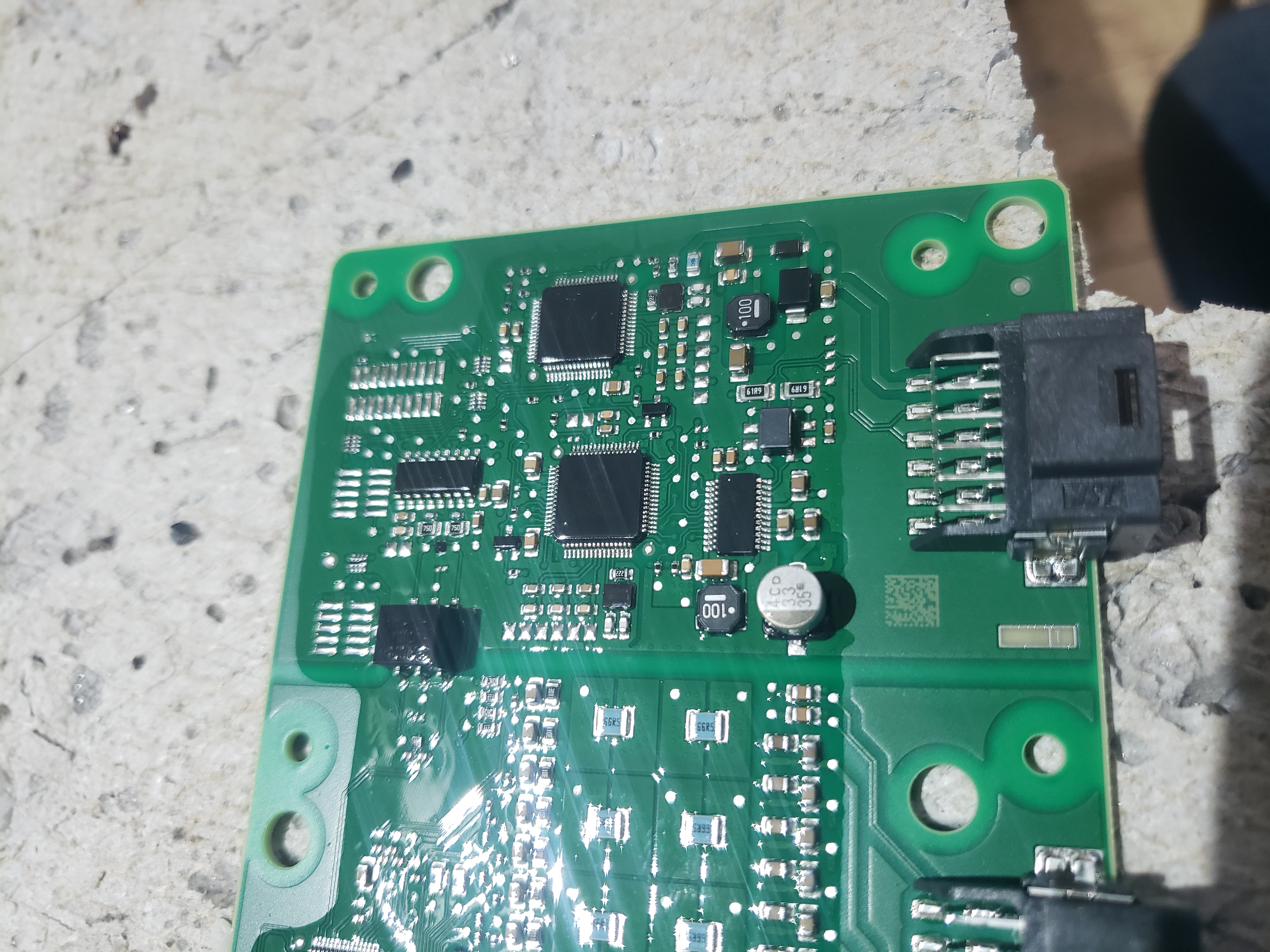

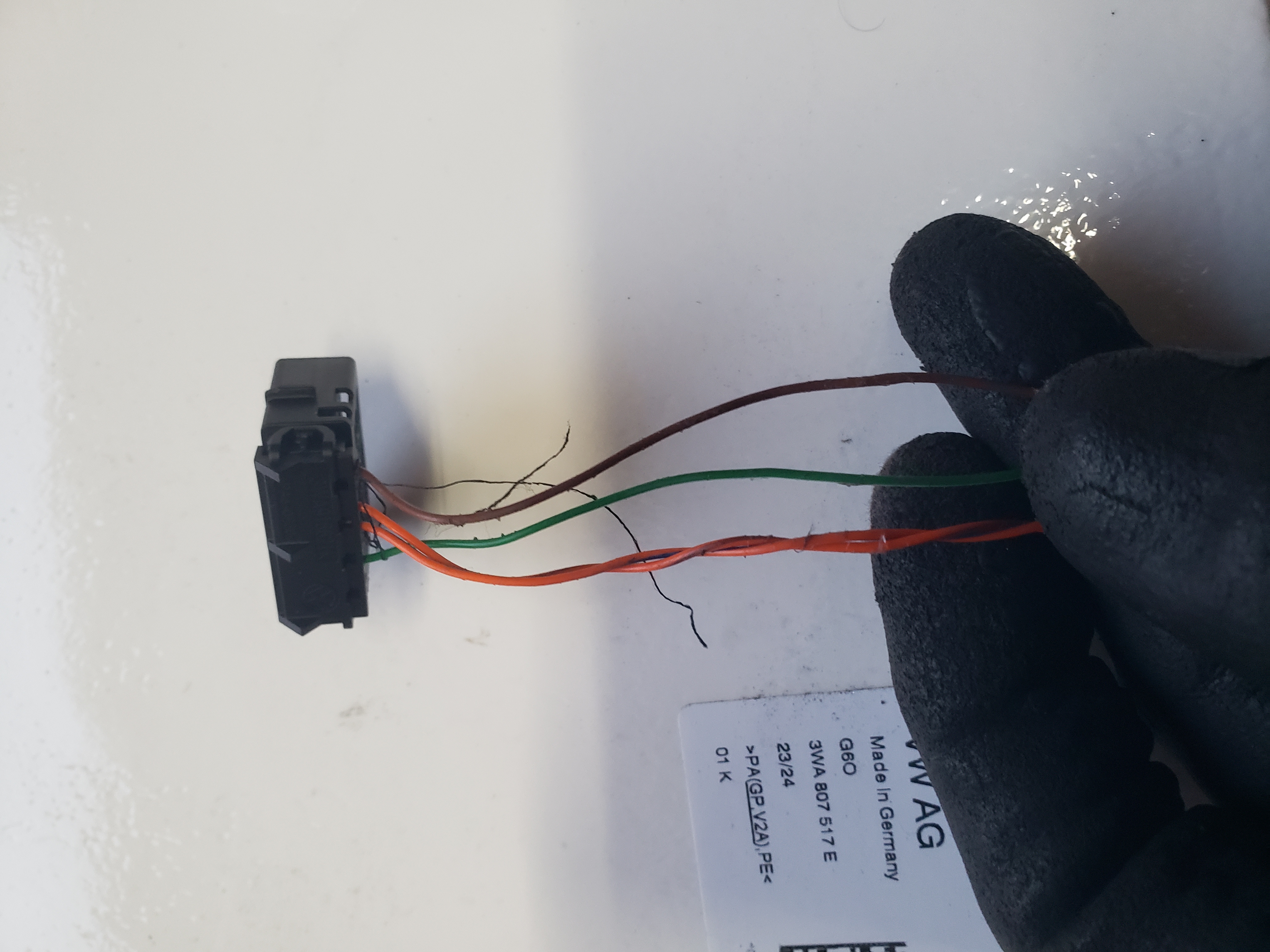

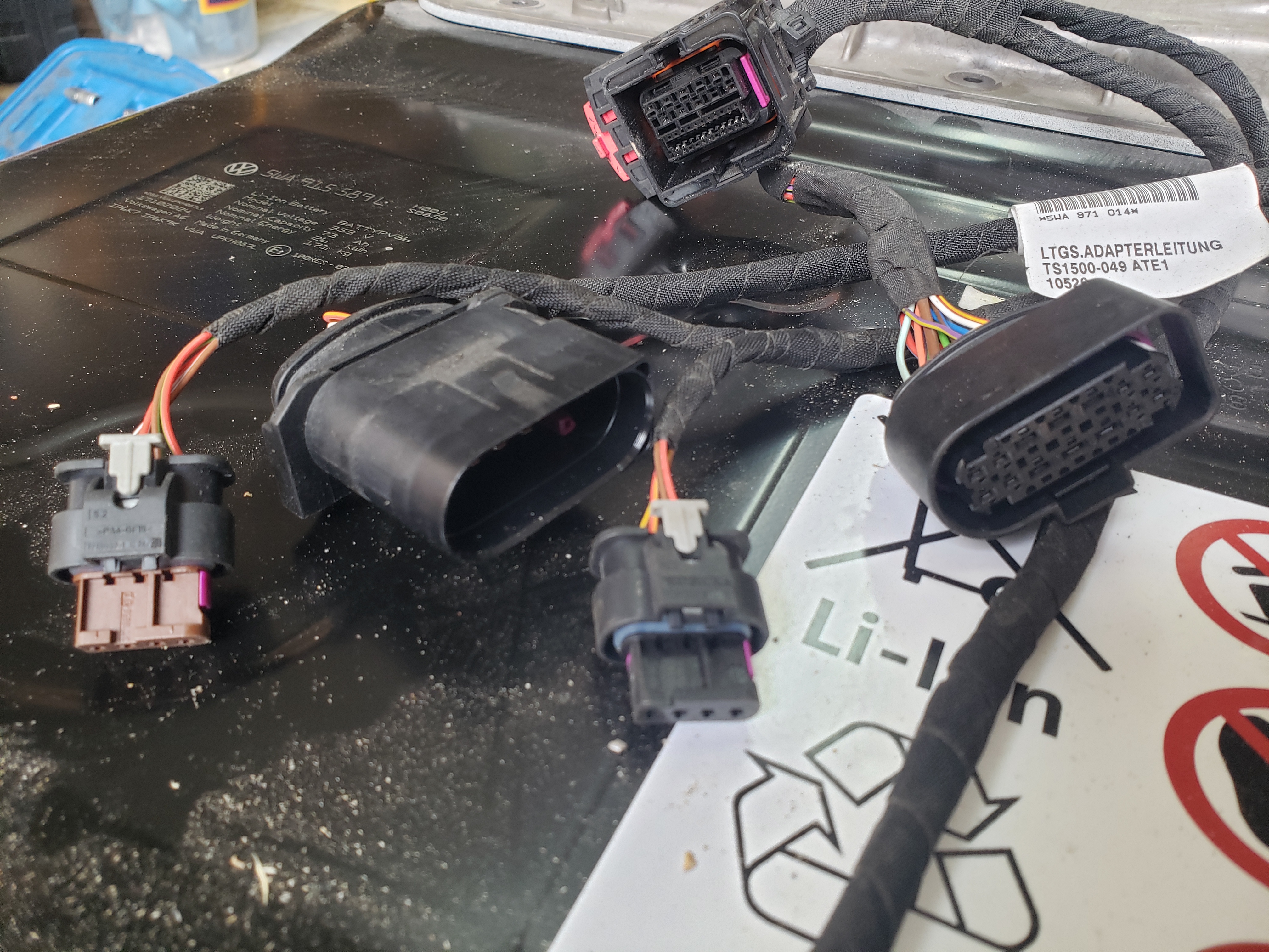

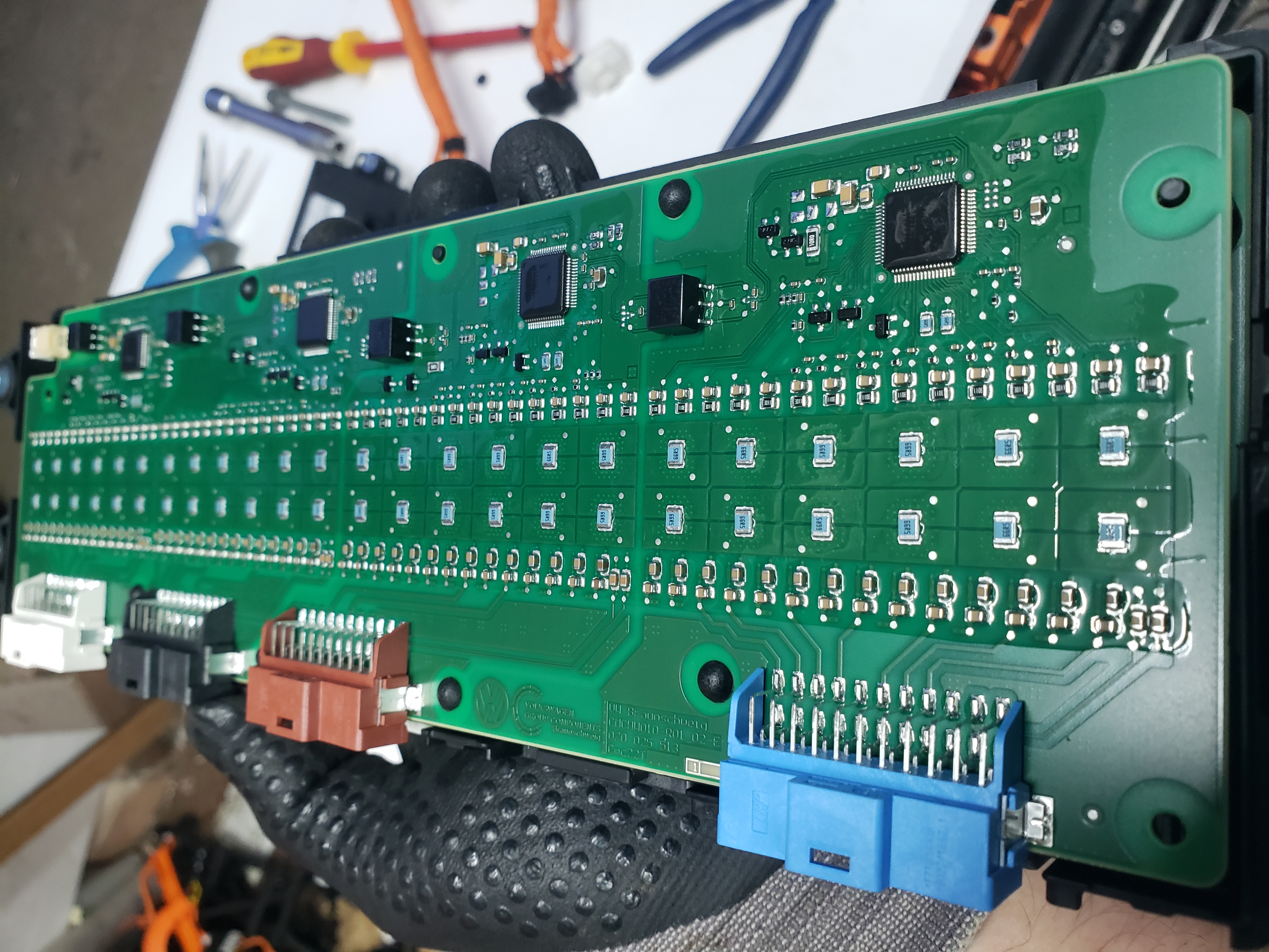

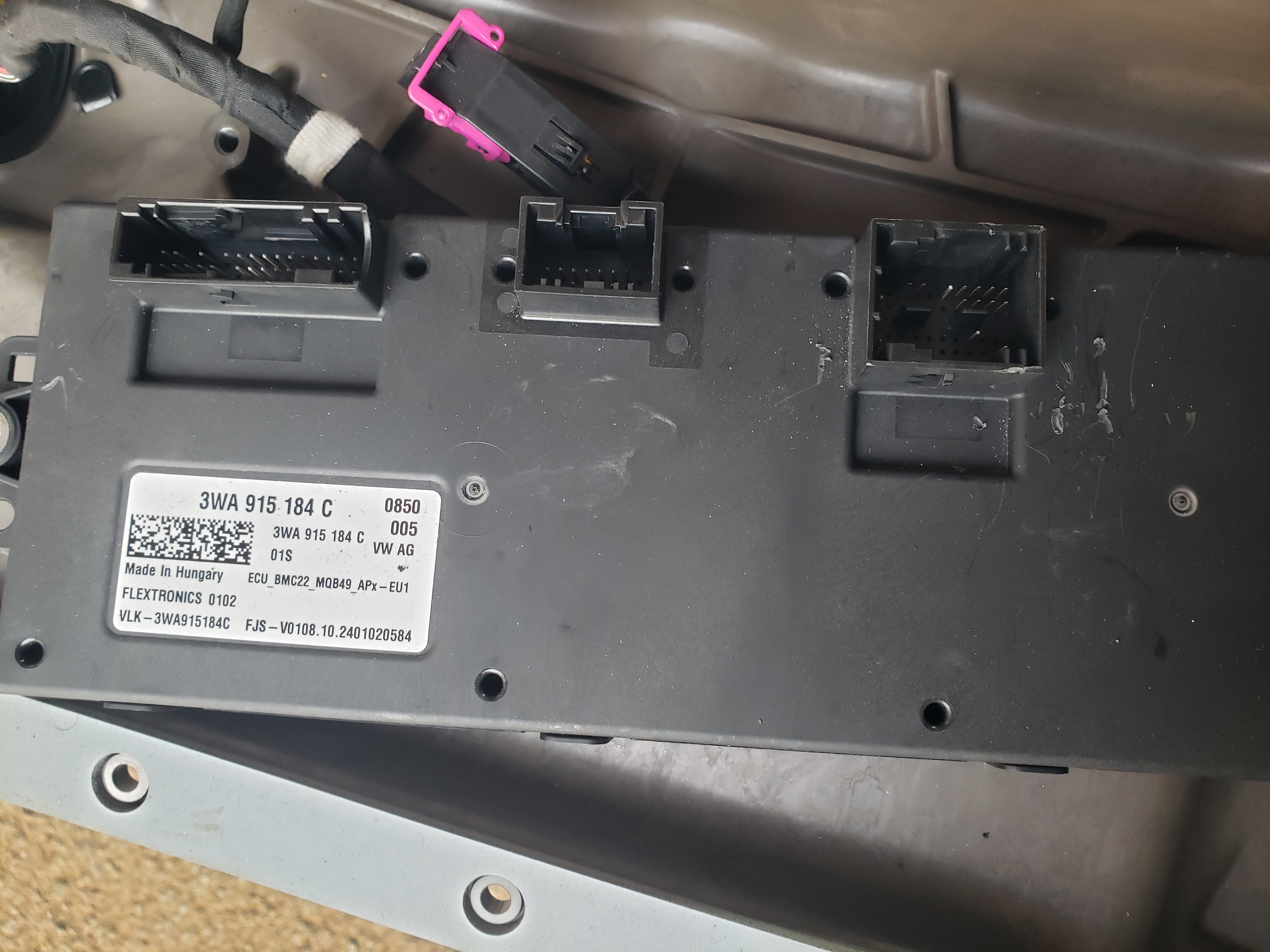

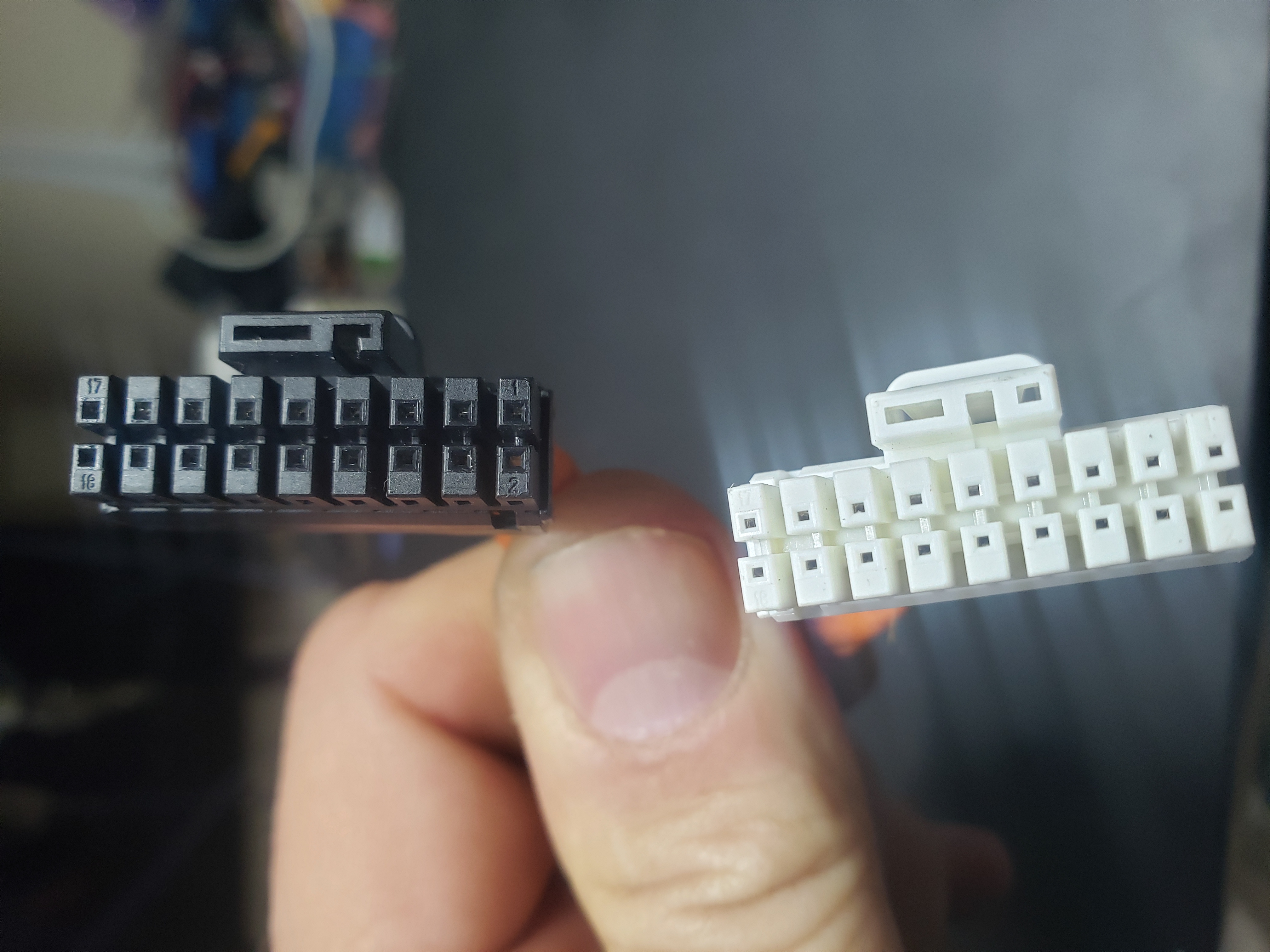

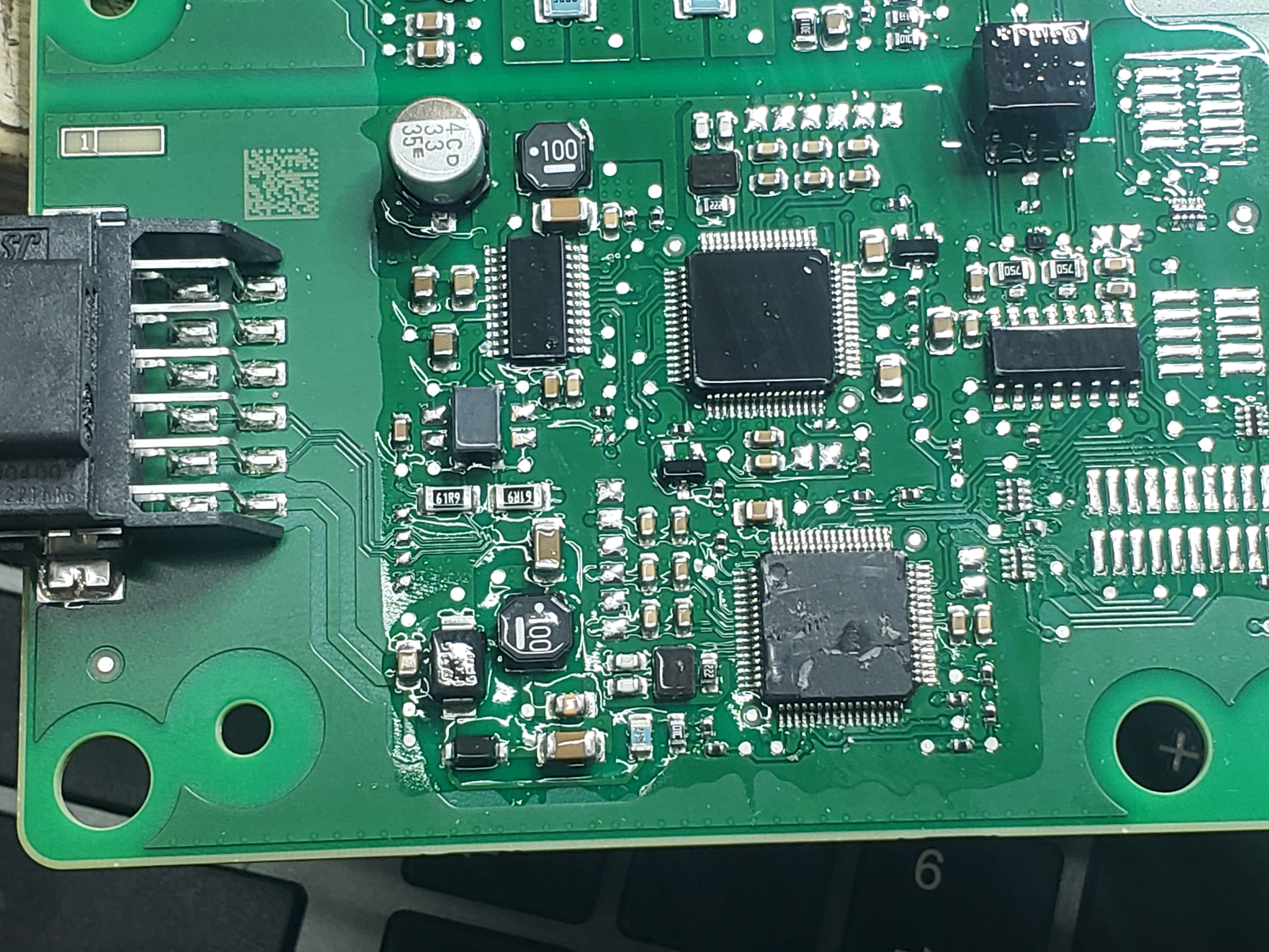

Then there are 18pin cell level connections. As before with VW ID3 cells i can measure thermistors from connector edges with cell voltages in the middle

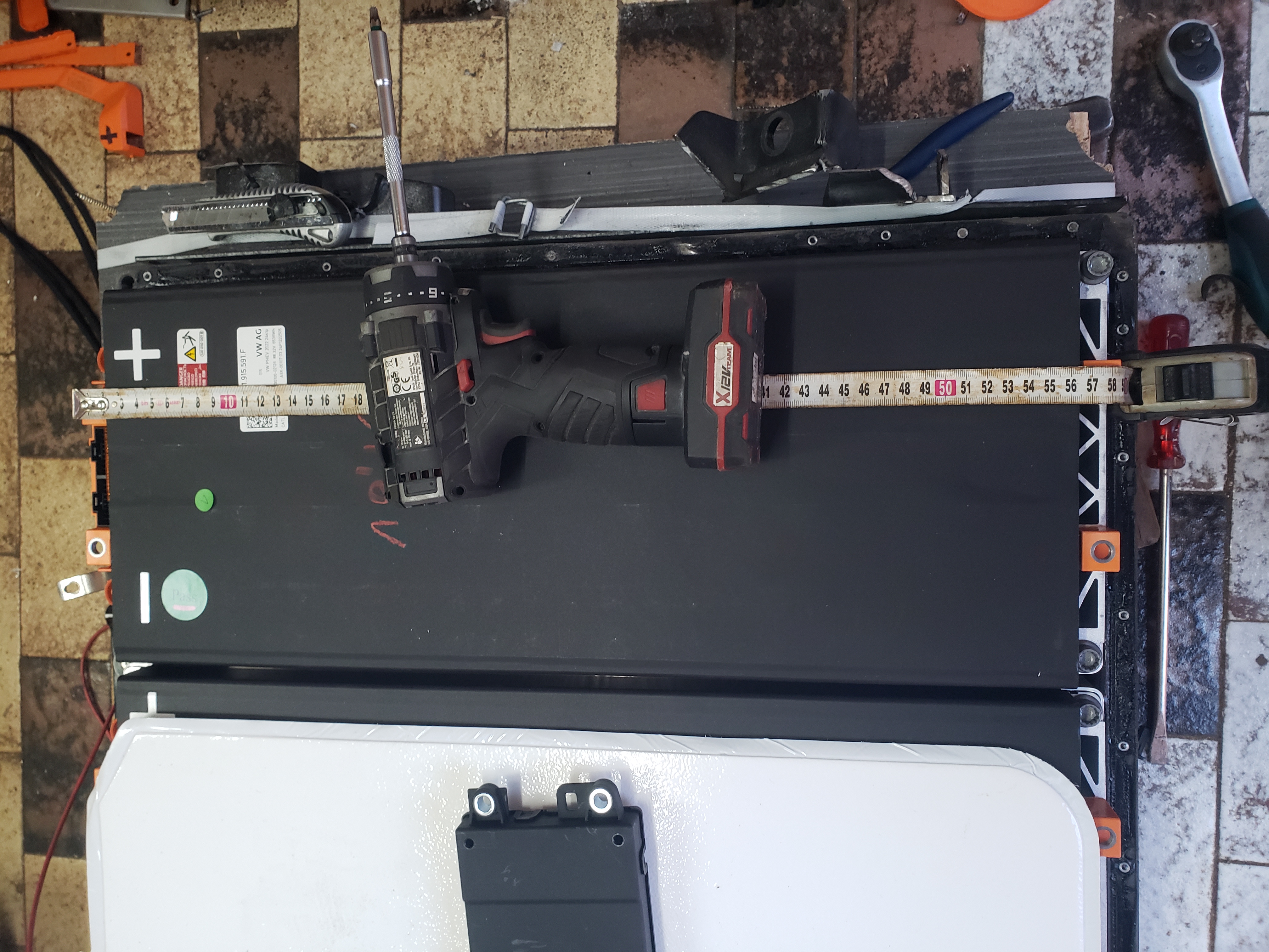

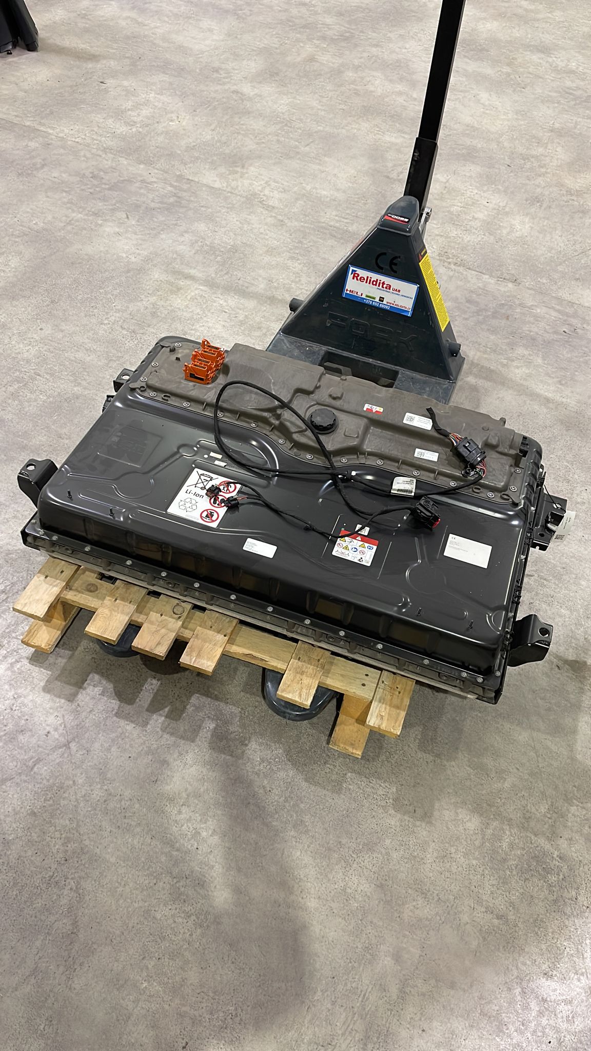

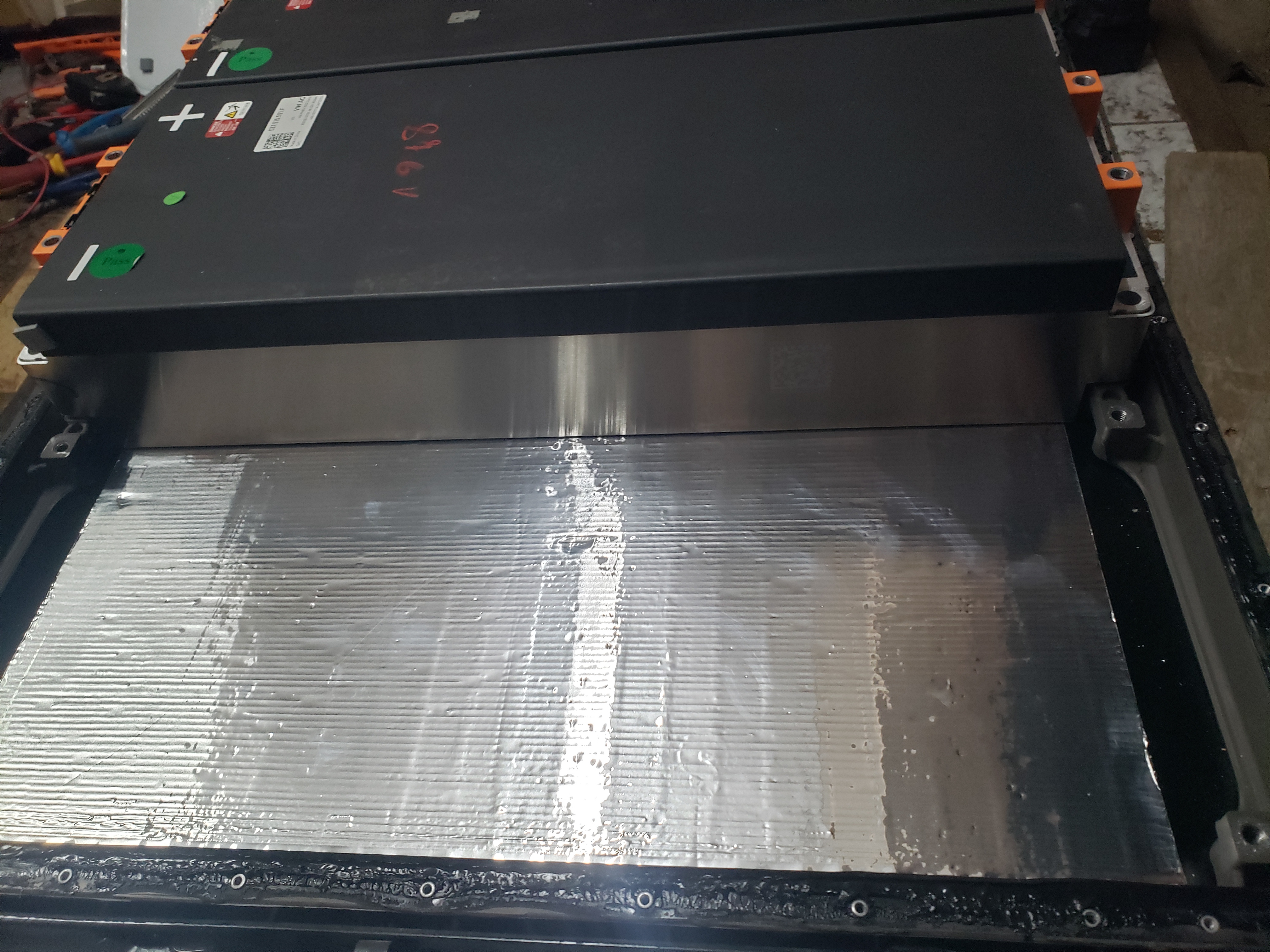

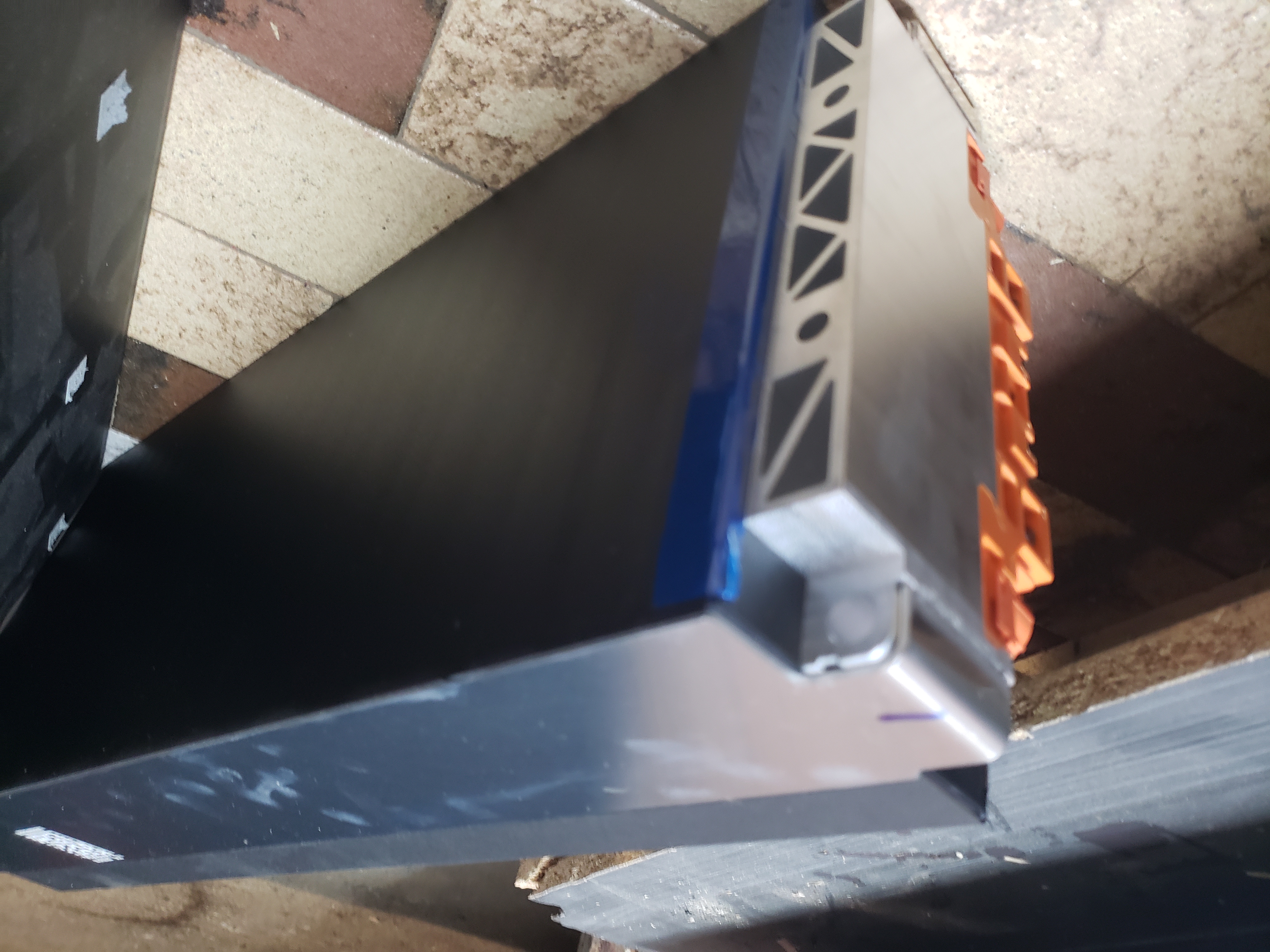

Modules are arranged by 4 bolted in alu box with pressed sheet metal liquid cooling under the box.

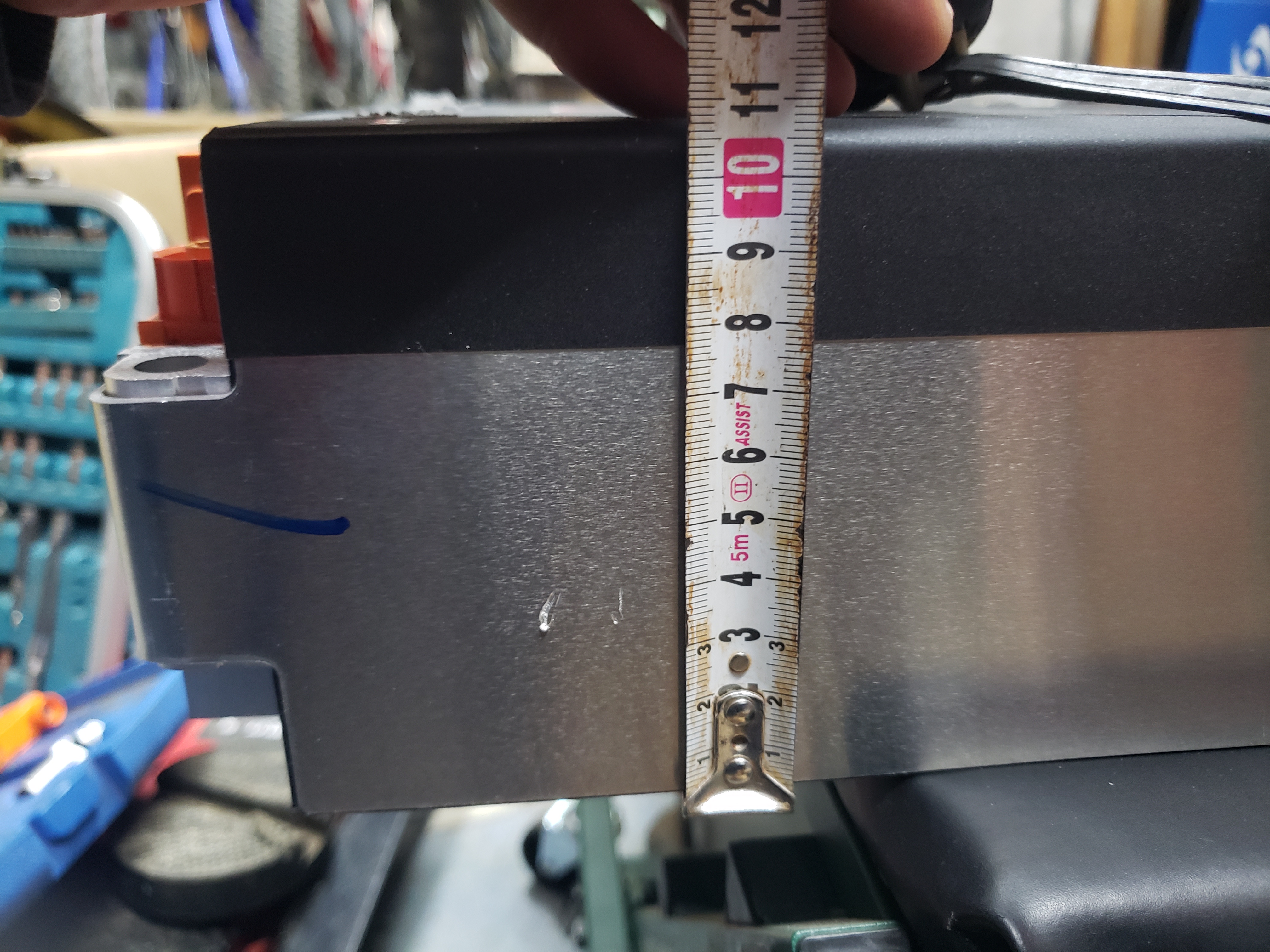

Modules are under 60cm in length 22,5cm in width and under 11cm in height.
Some more photos of cell modules
Alu casing is only on the module edges and makes for cell protection and retention. Under and over that is soft plastic covering. On the underside i can feel cell block mass. This is pressing to the heat transfer foil that is located underneath battery tray.
I will dissassemble and show more of the liquid cooling tomorrow when i sort oout where to put the modules. In the mean time the mounts and steel braces really help with module retention as the box itself is really just a thin tray. What is giving it strength and stiffness is a large 8mm alu plate in the bottom where coolant outlets connect to.
