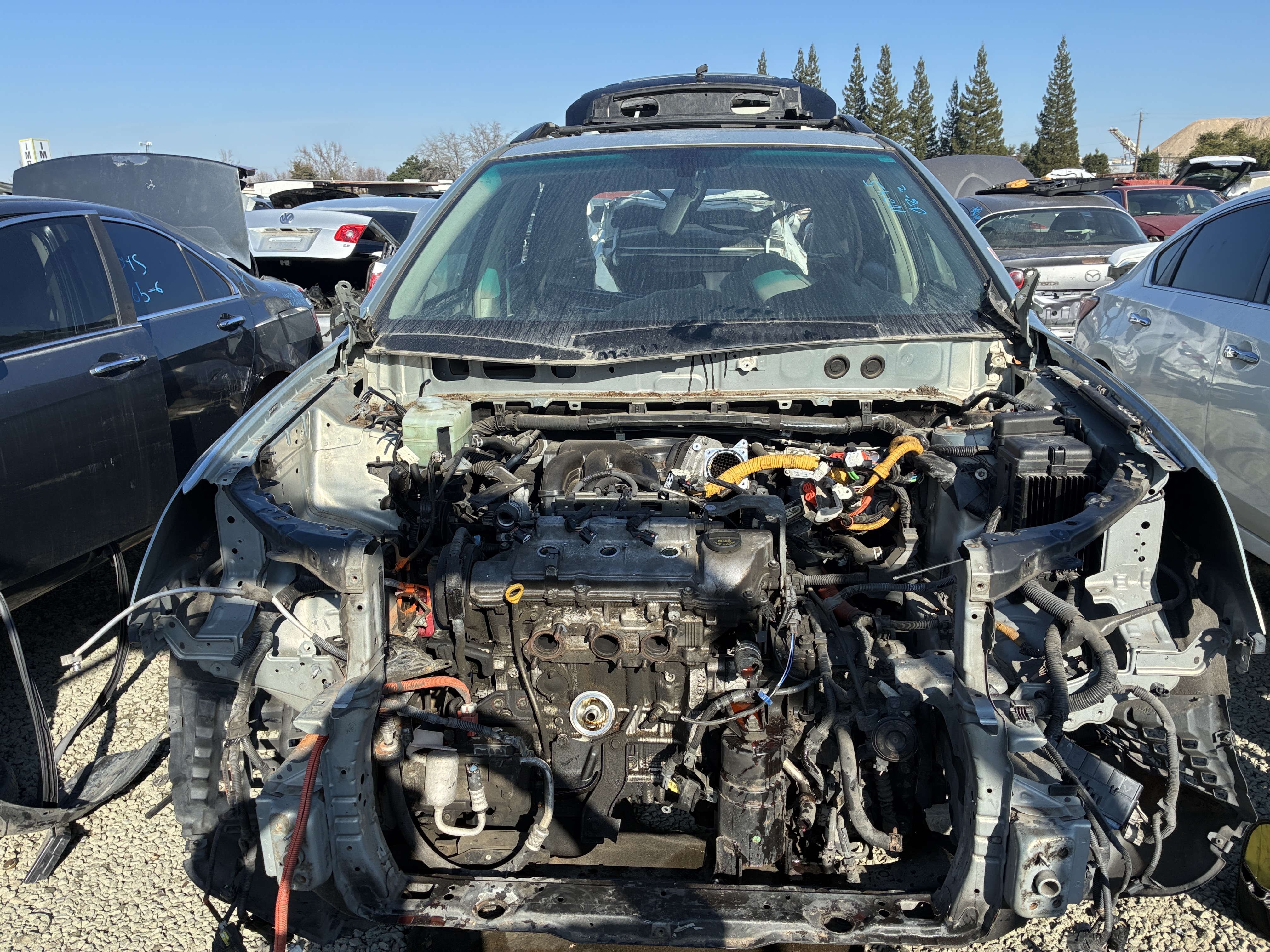

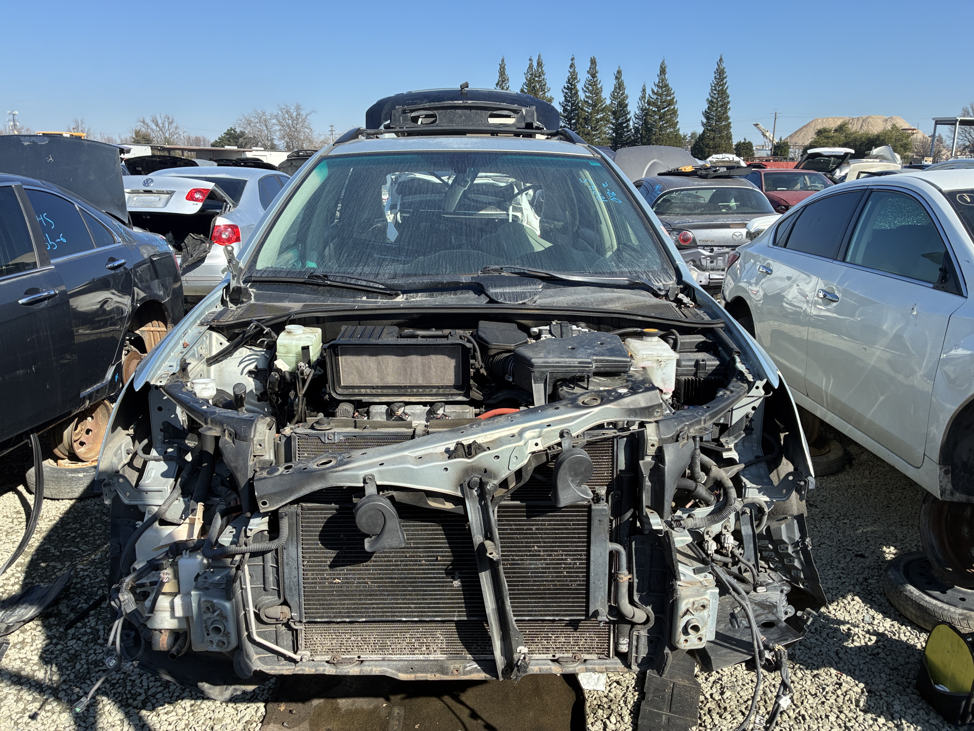

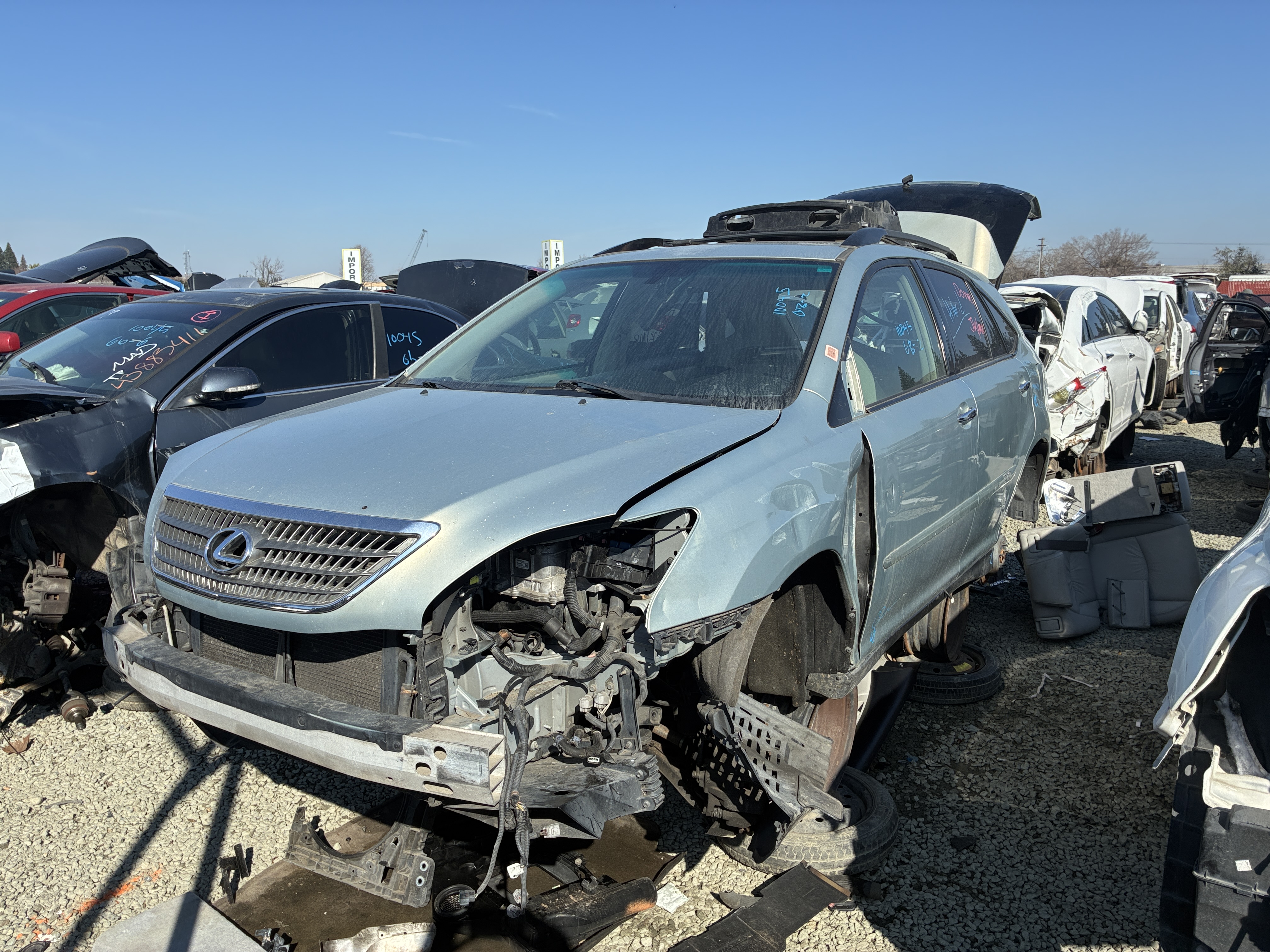

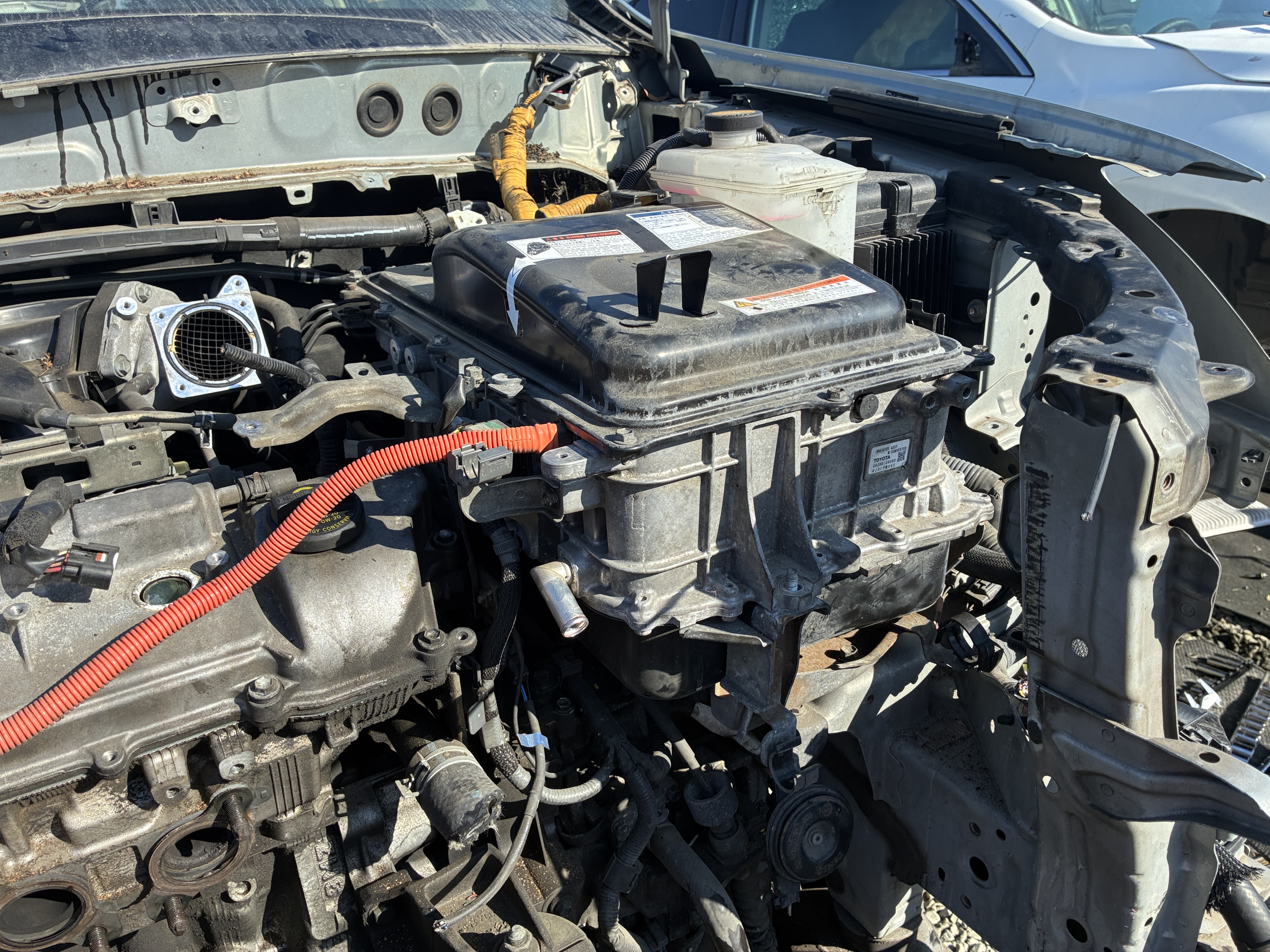

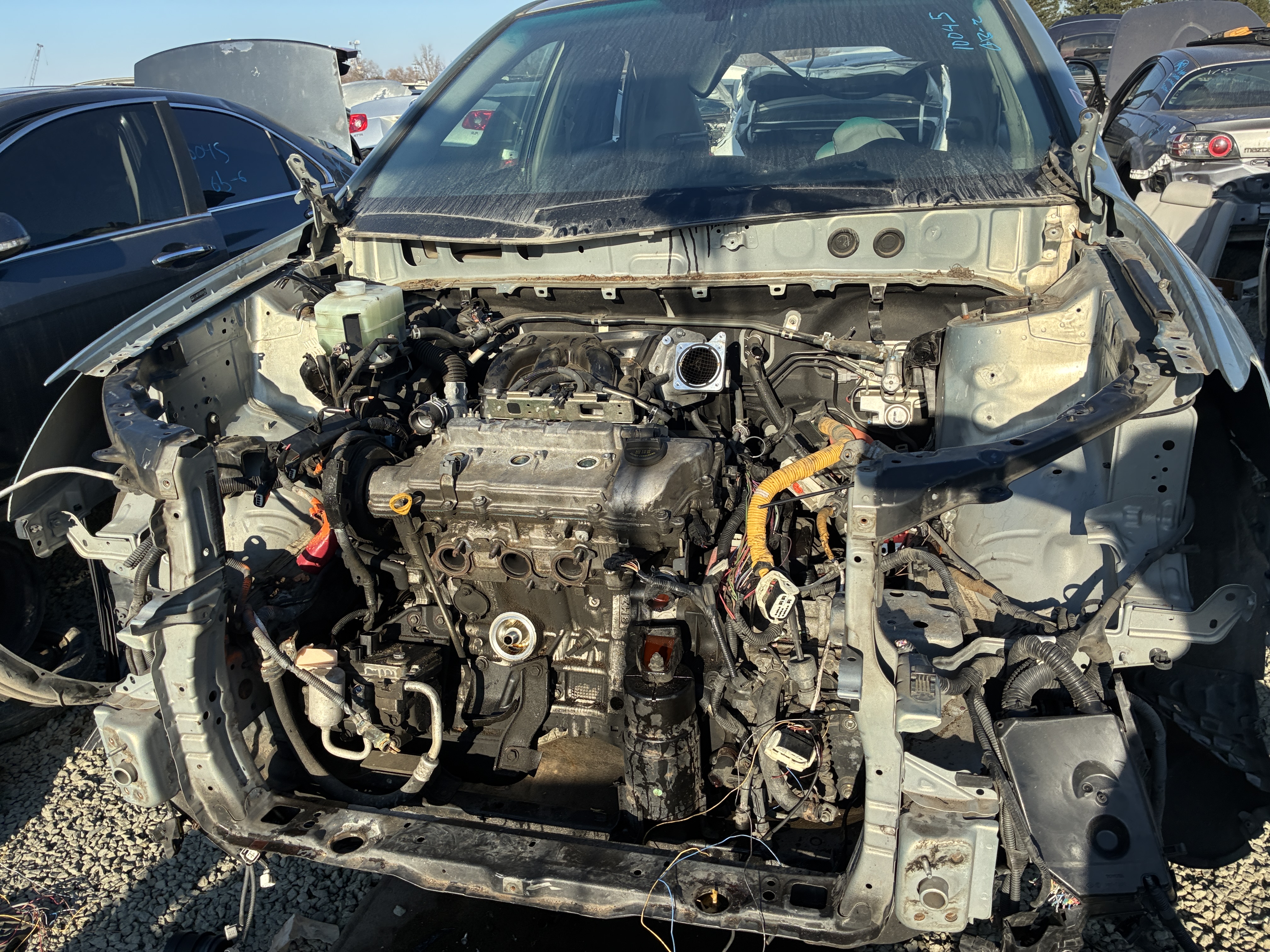

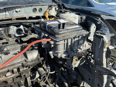

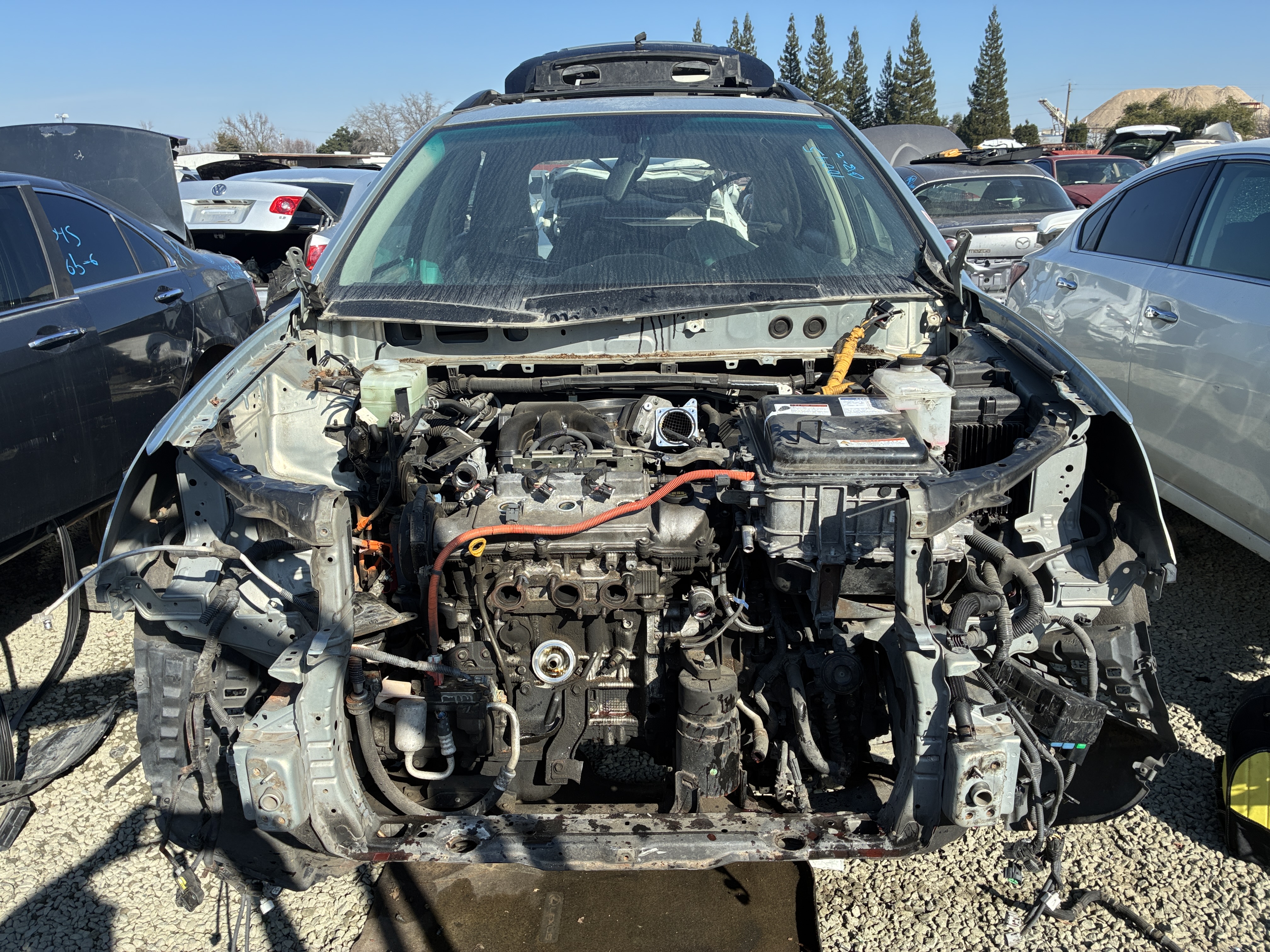

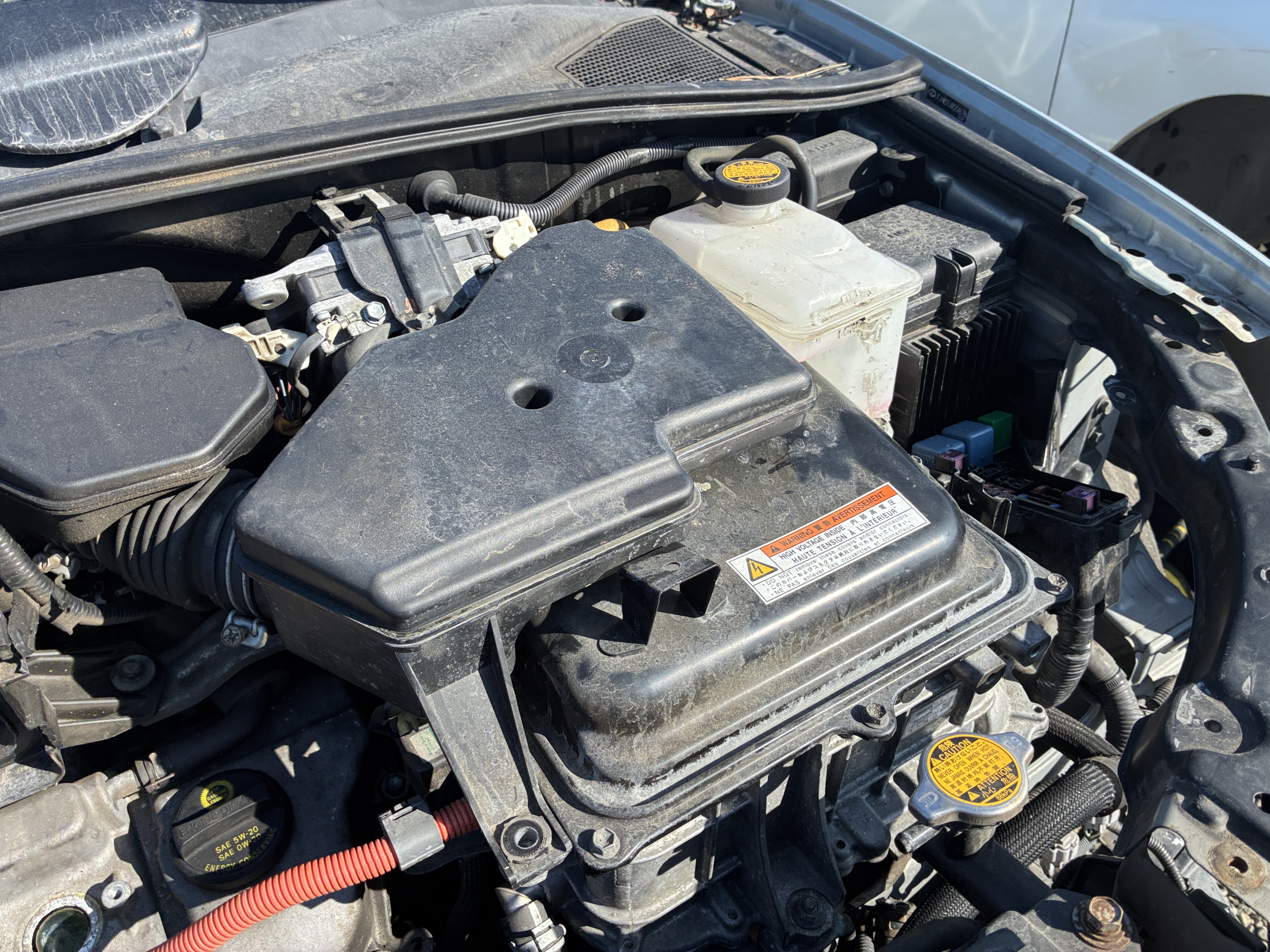

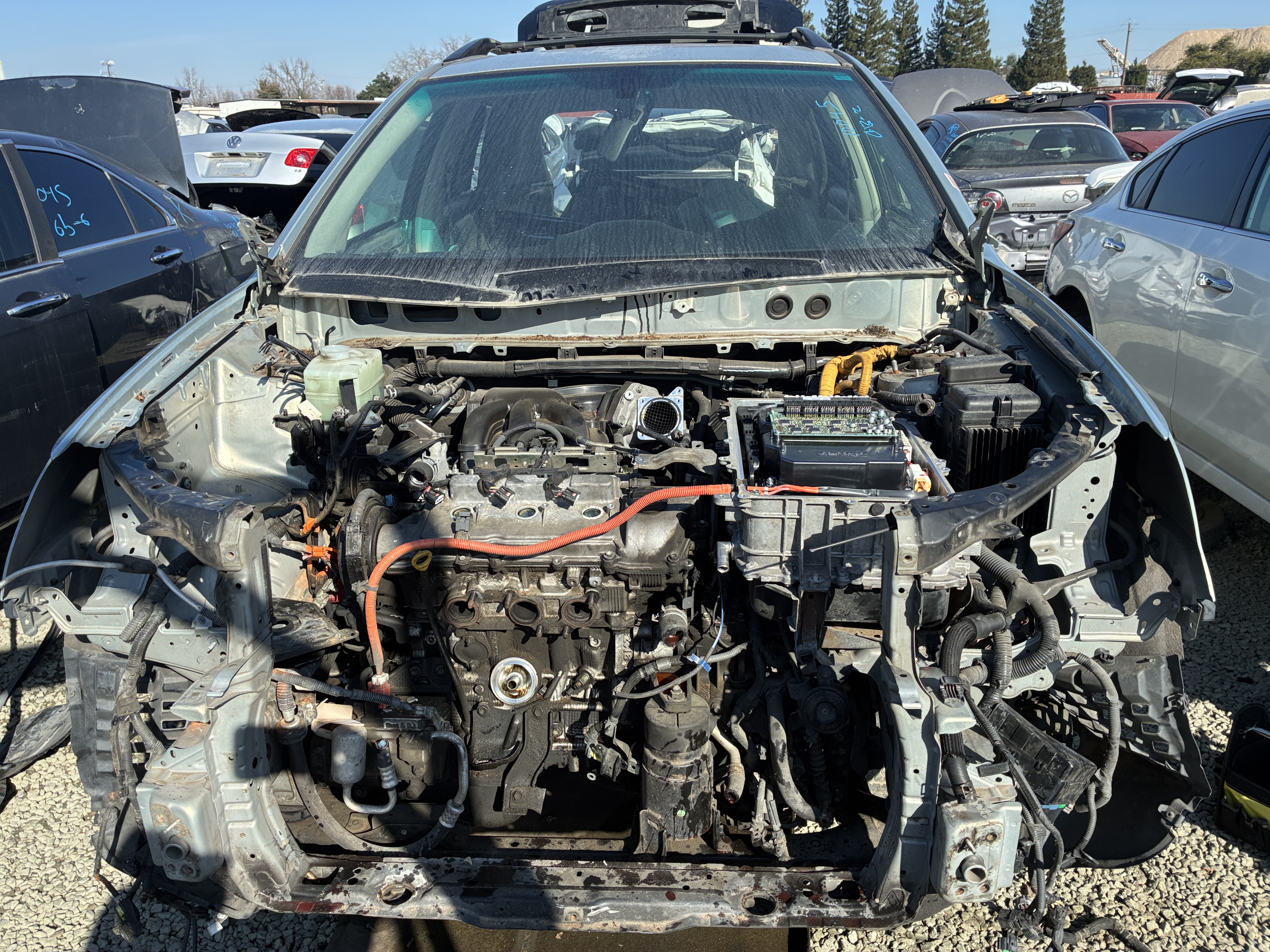

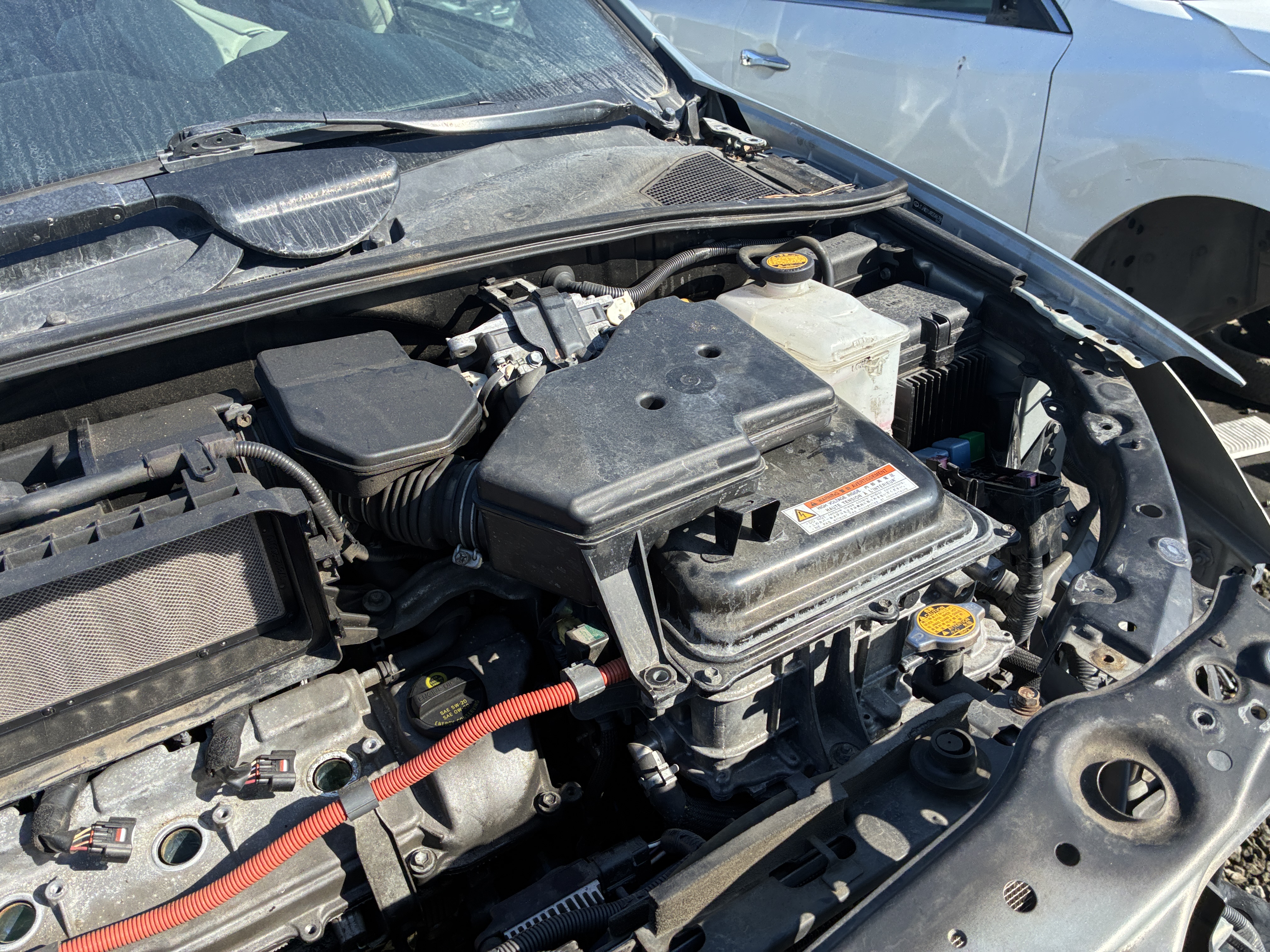

let me just rate pulling the inverter out of this vehicle as the most difficult strip I have ever done did, if I'm being honest I attempted to yank the one out of that 2009 Toyota Highlander but gave up!
Fun Level: -400
here is a fun little progress timeline of the front of the car during the three hours it took from start to finish
got the hood [pronounced: "bonnet"] off of the car cause some dingleberry deleted the prop stick, and the front bumper came off
modern cars have that silly windshield cowl under the windshield wipers which I swear covers a 3rd of the engine bay, so that had to go, as did the rad
on these older style inverters the whole lid has to come off in order to undue the three bolts for each of the three HV motor cables
and the inverter is out, but we were far from finished as I decided to go after the resolver cables next, and of course any pig tails

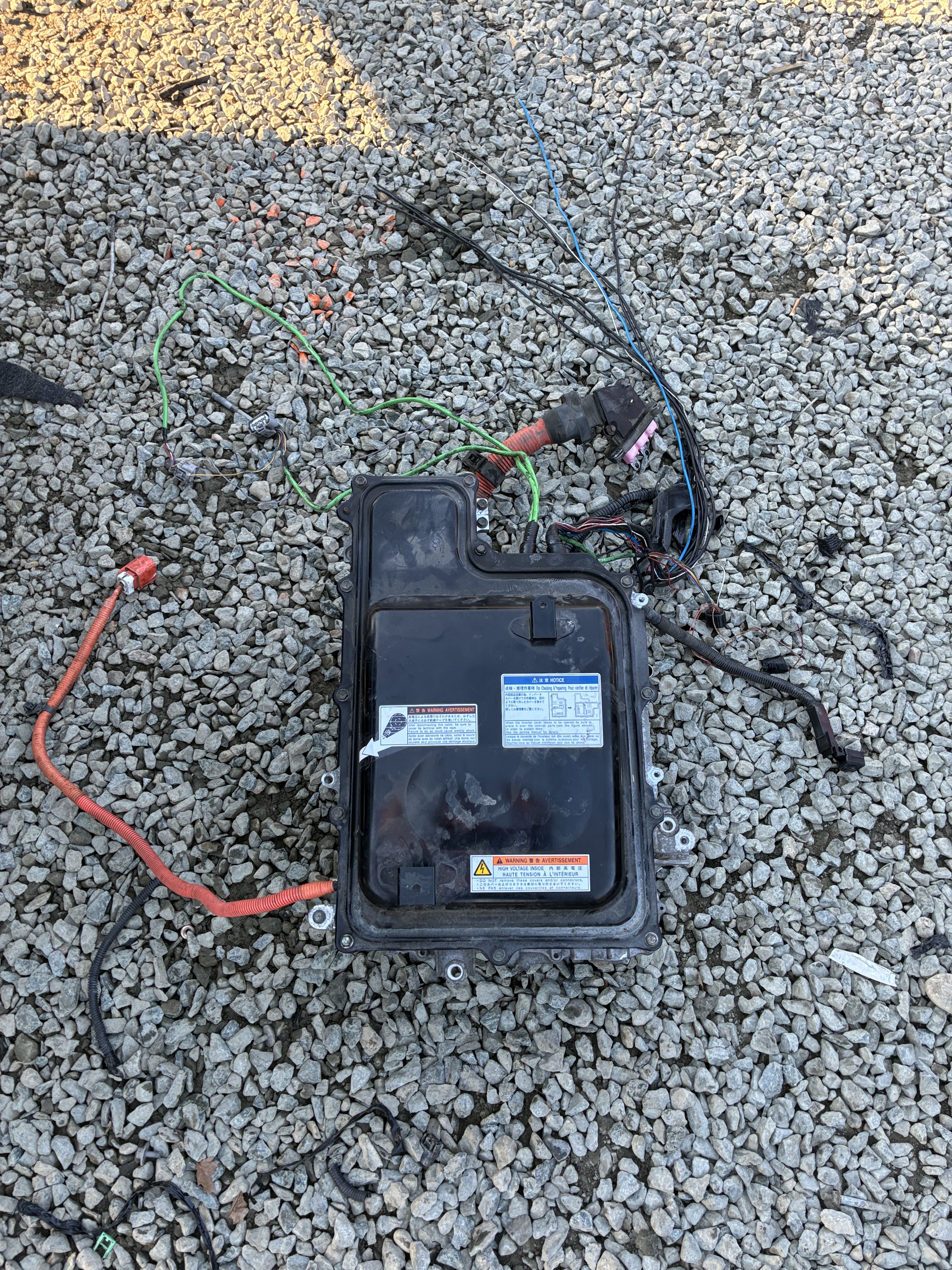

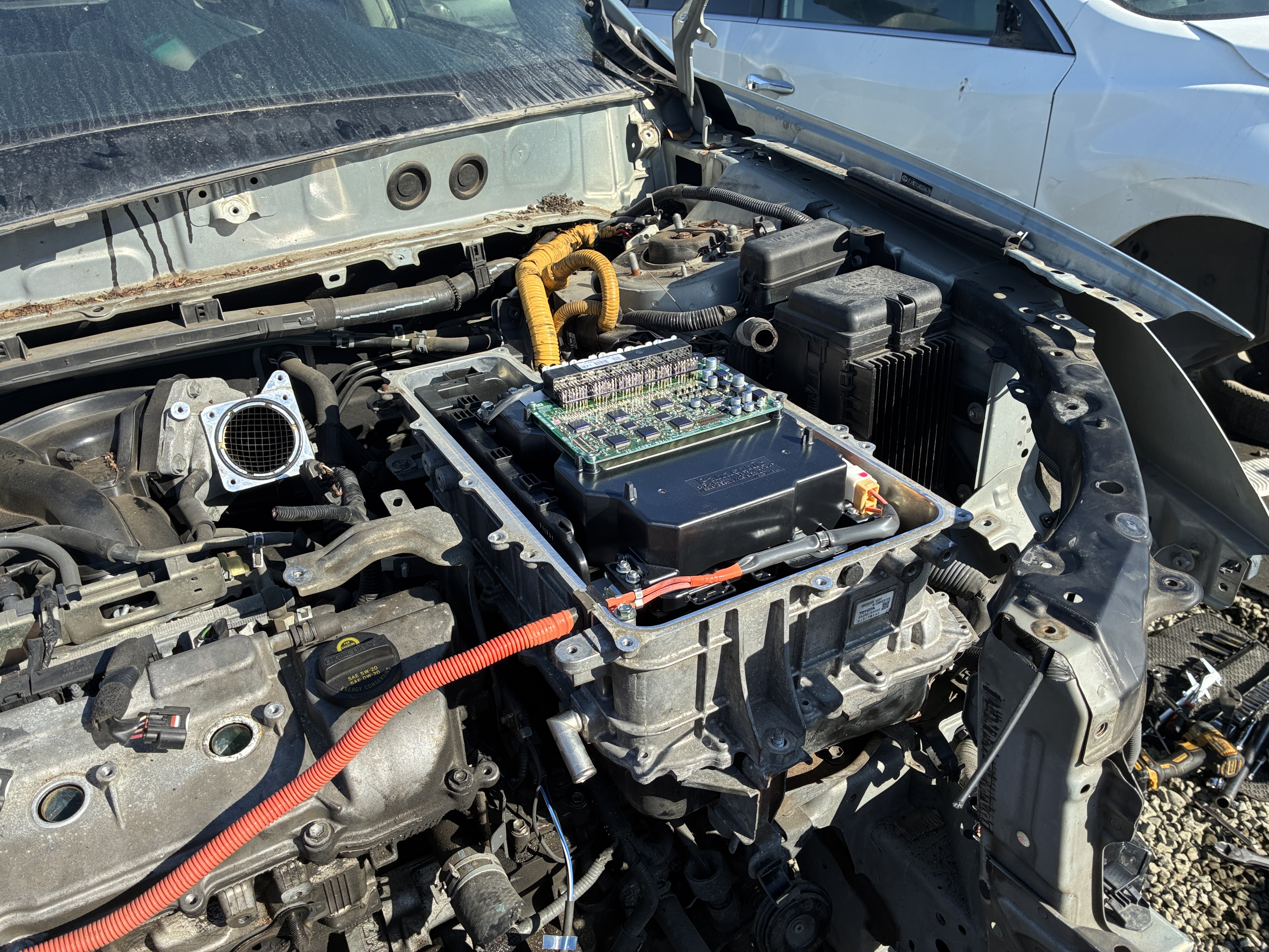

so this is what we were after, and I needed another inverter like another hole in my head

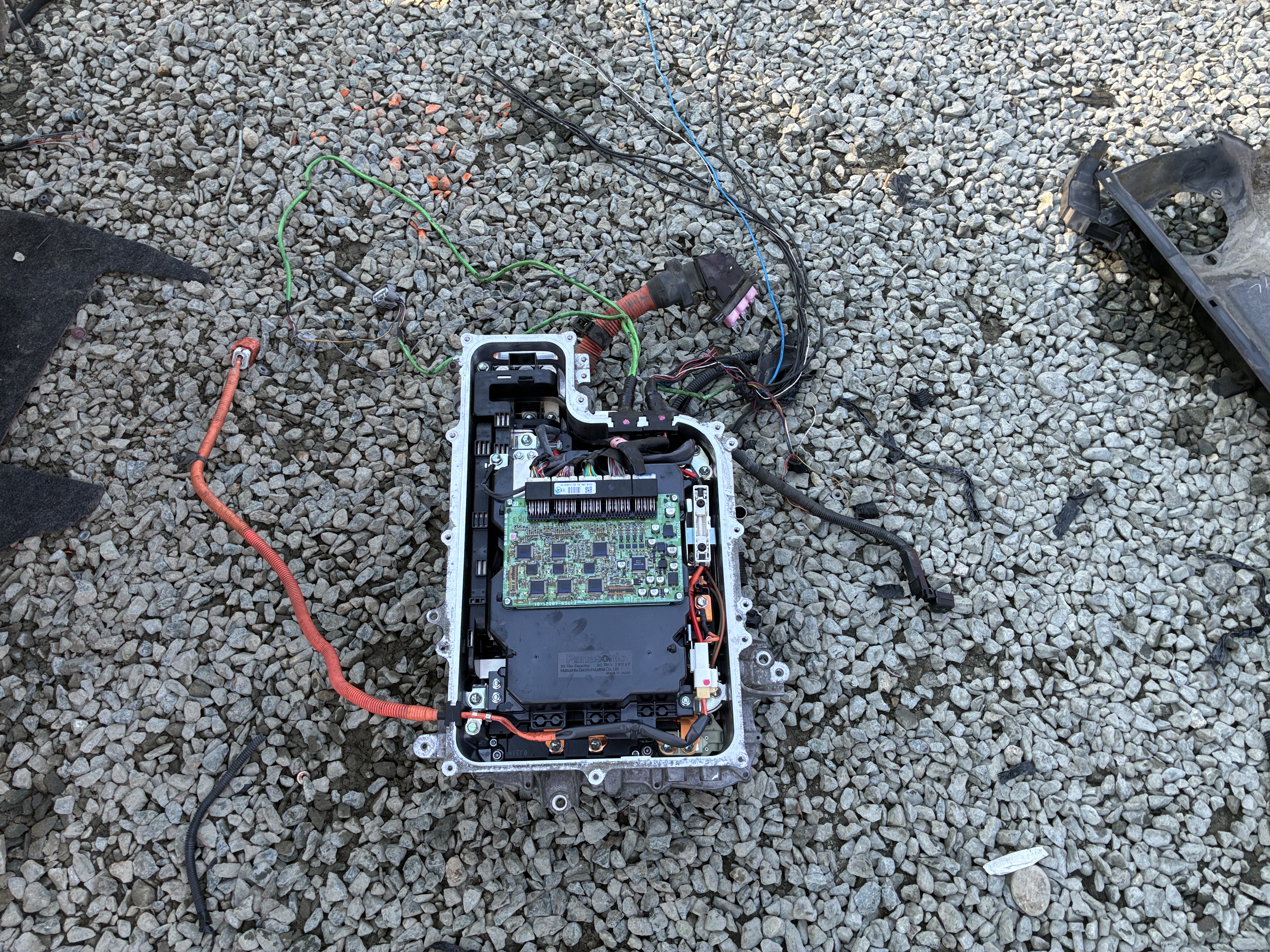

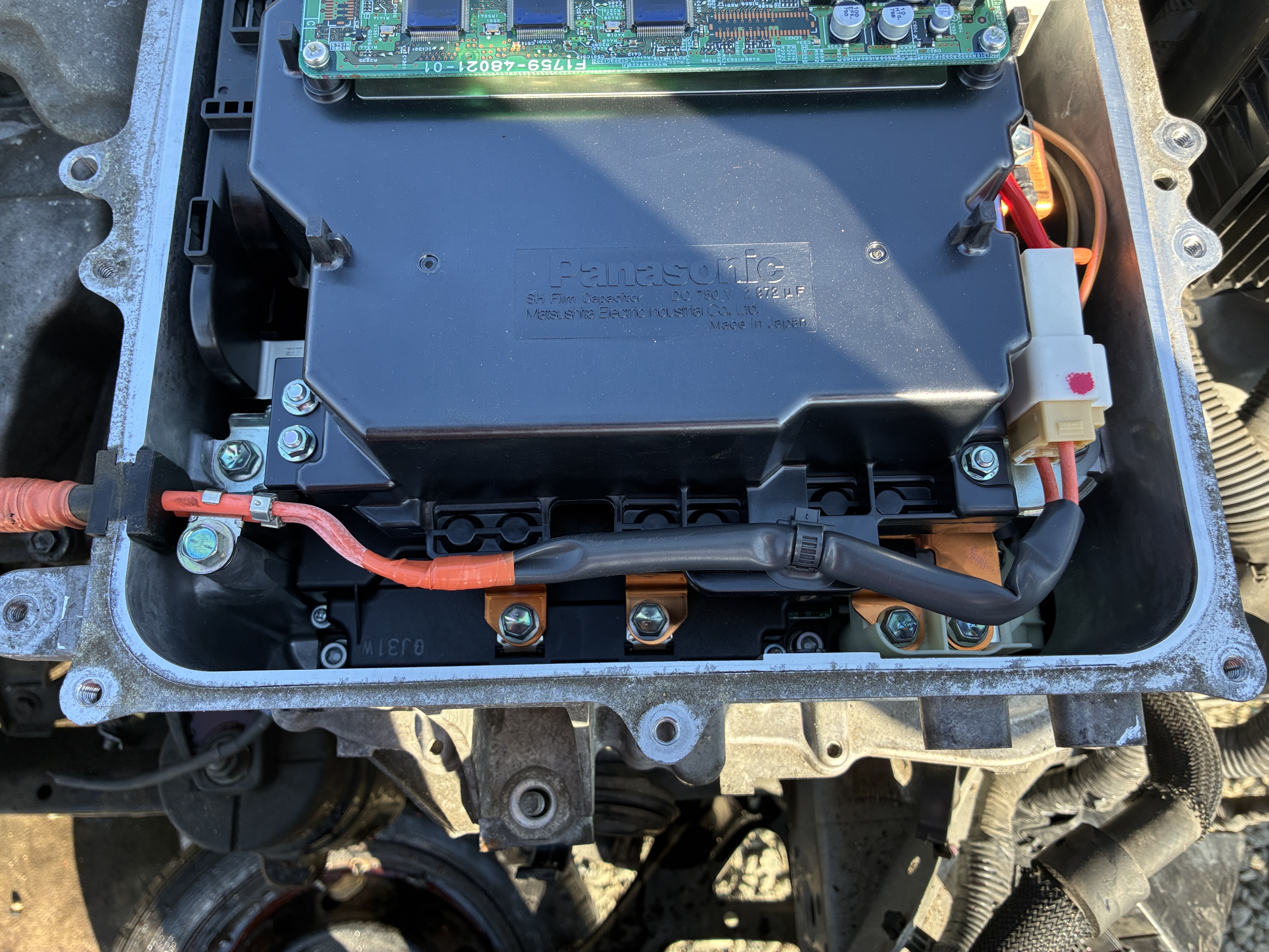

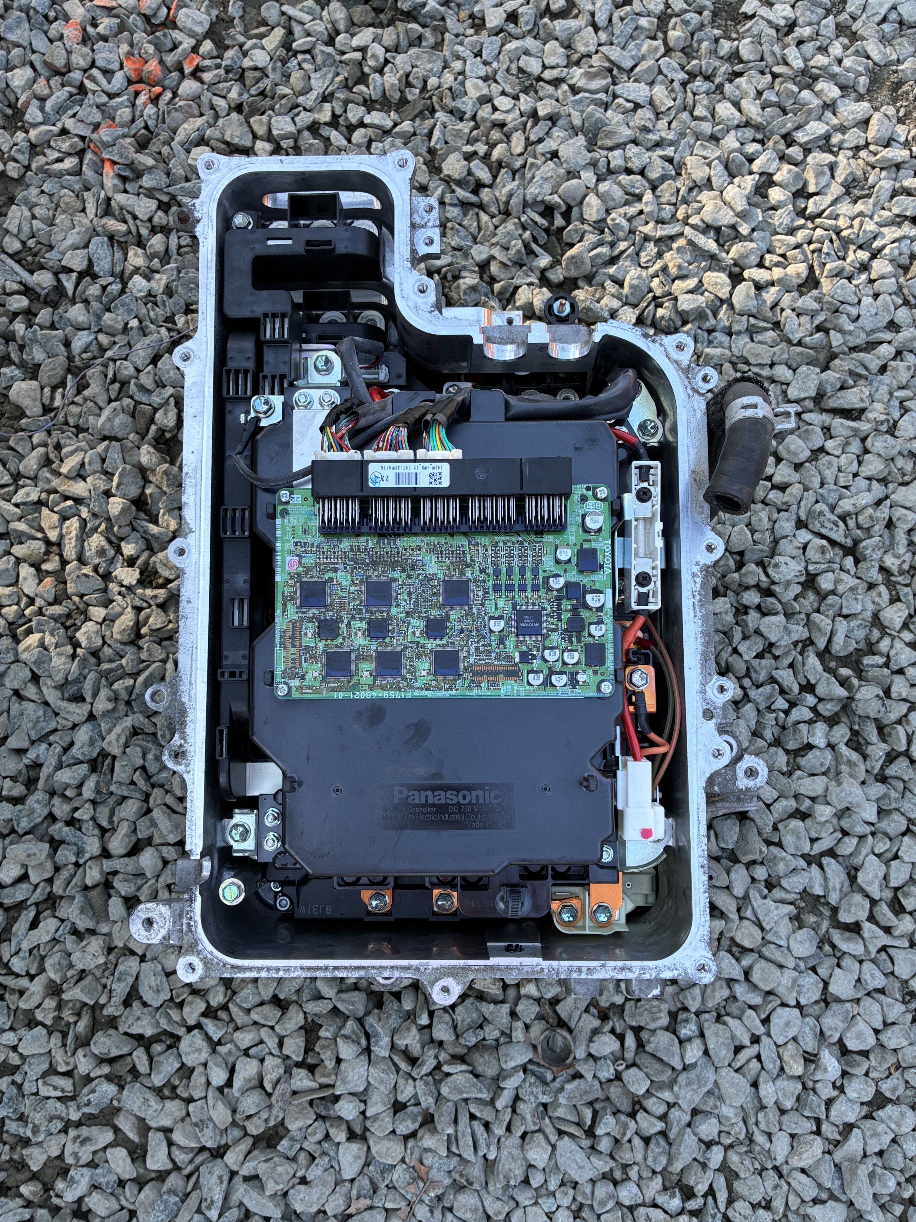

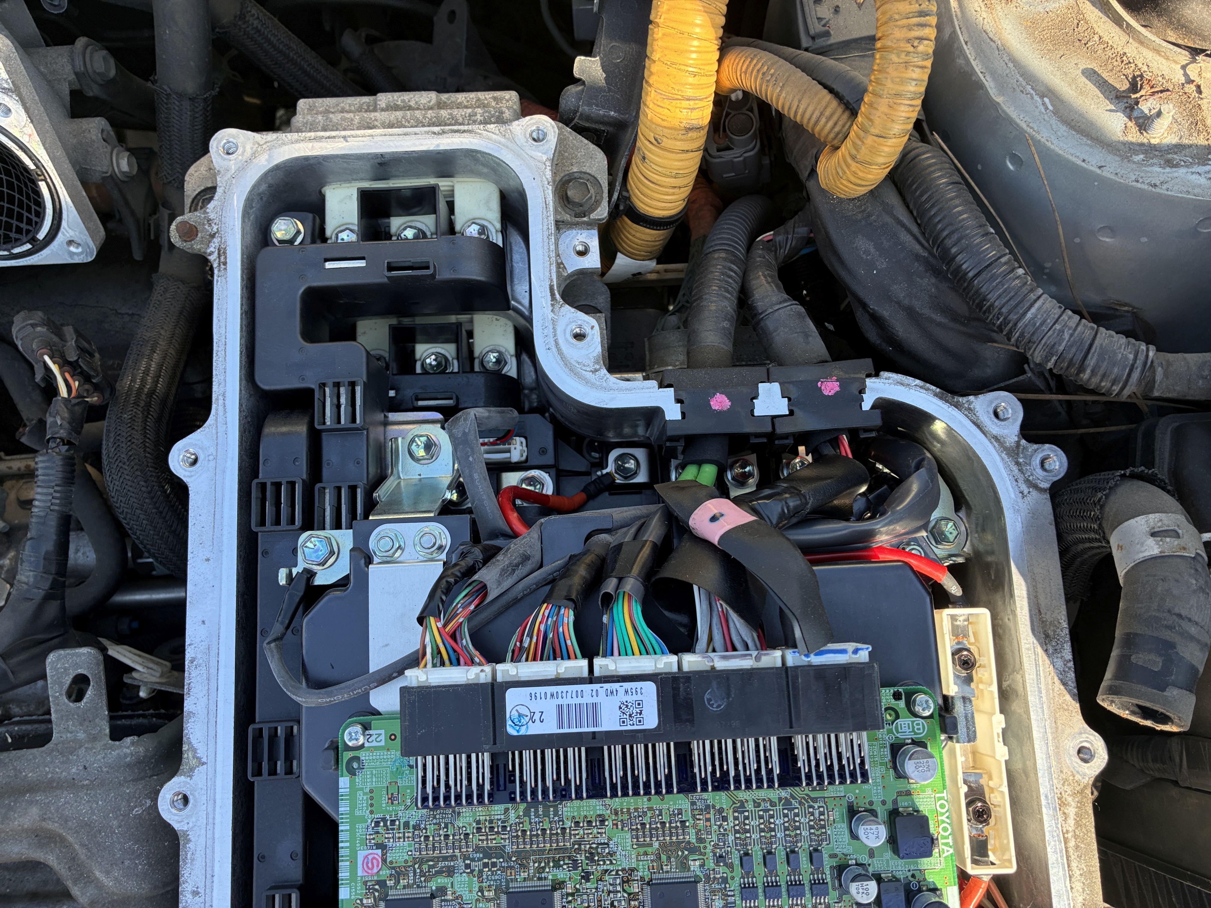

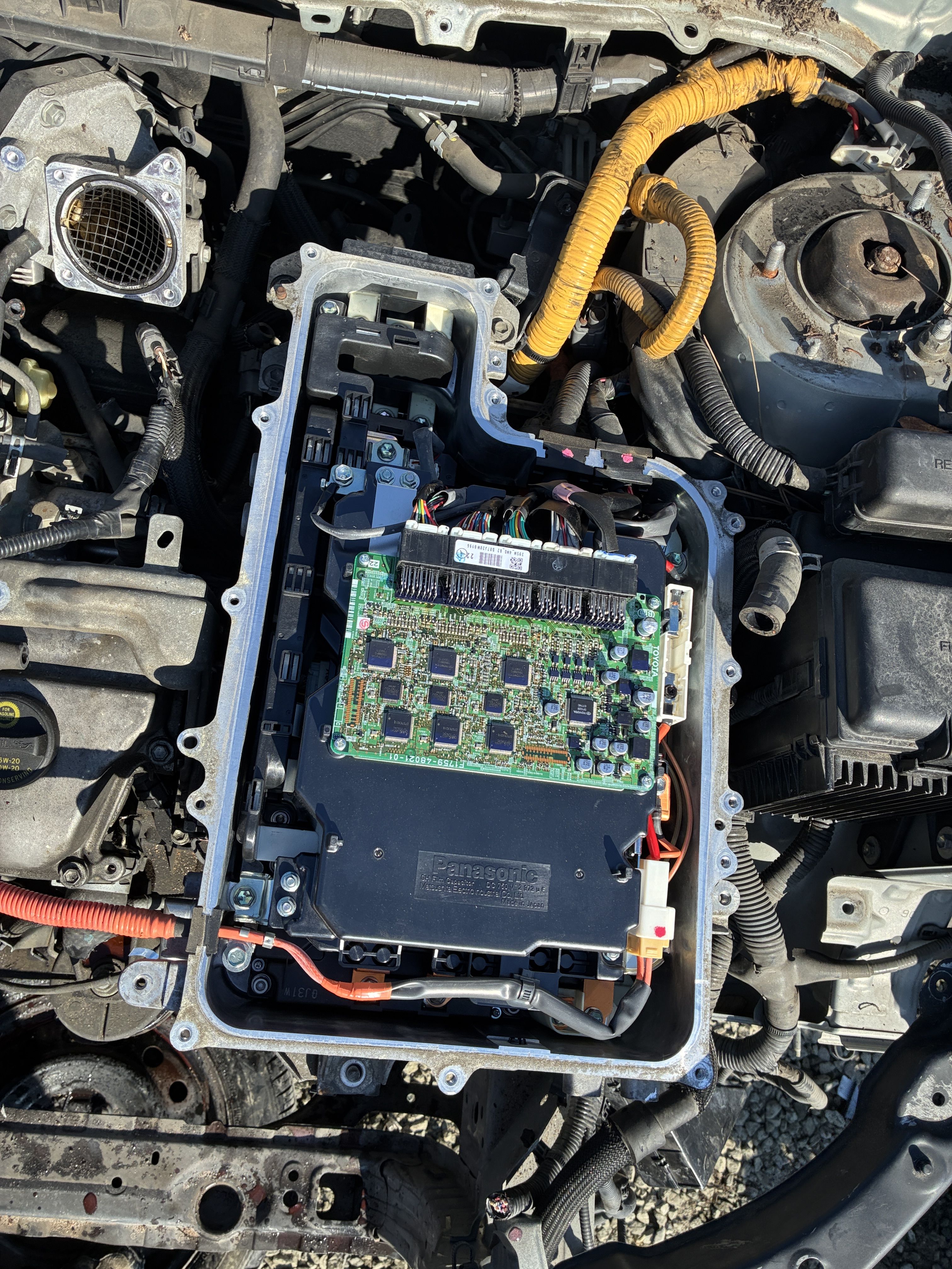

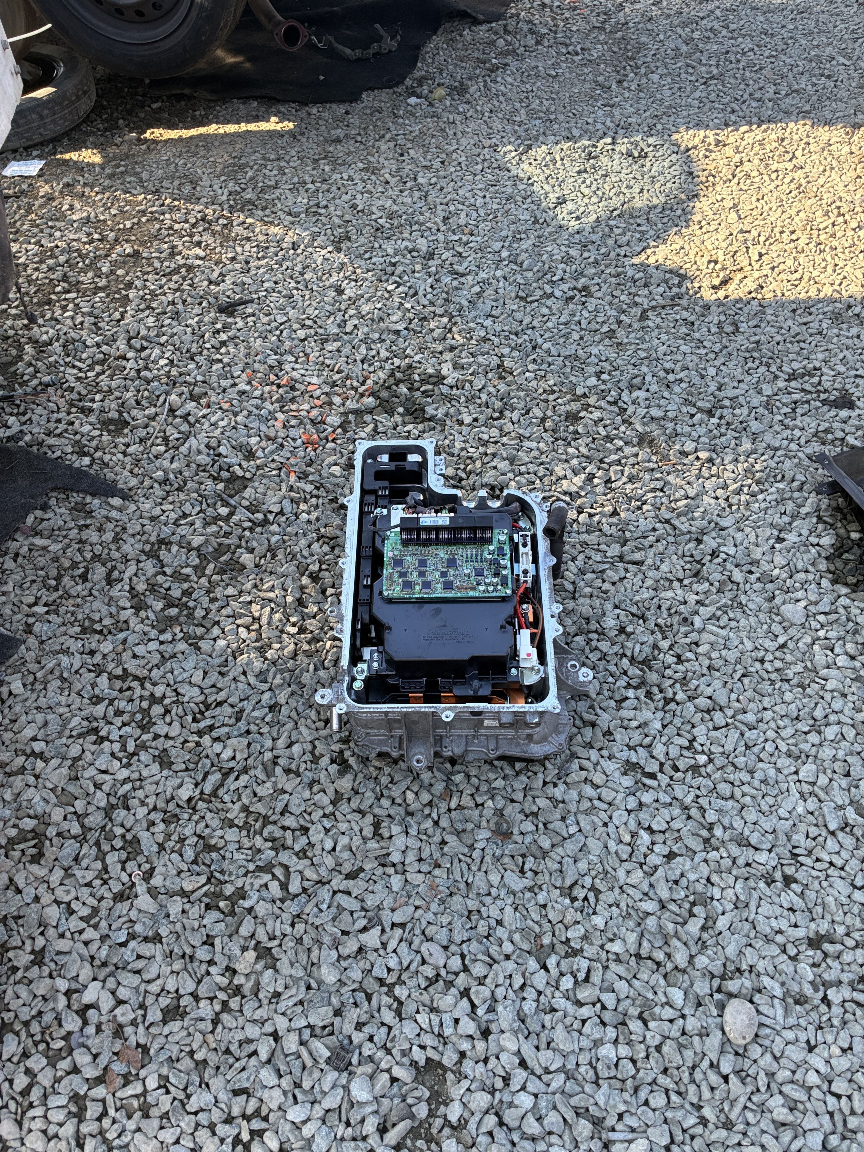

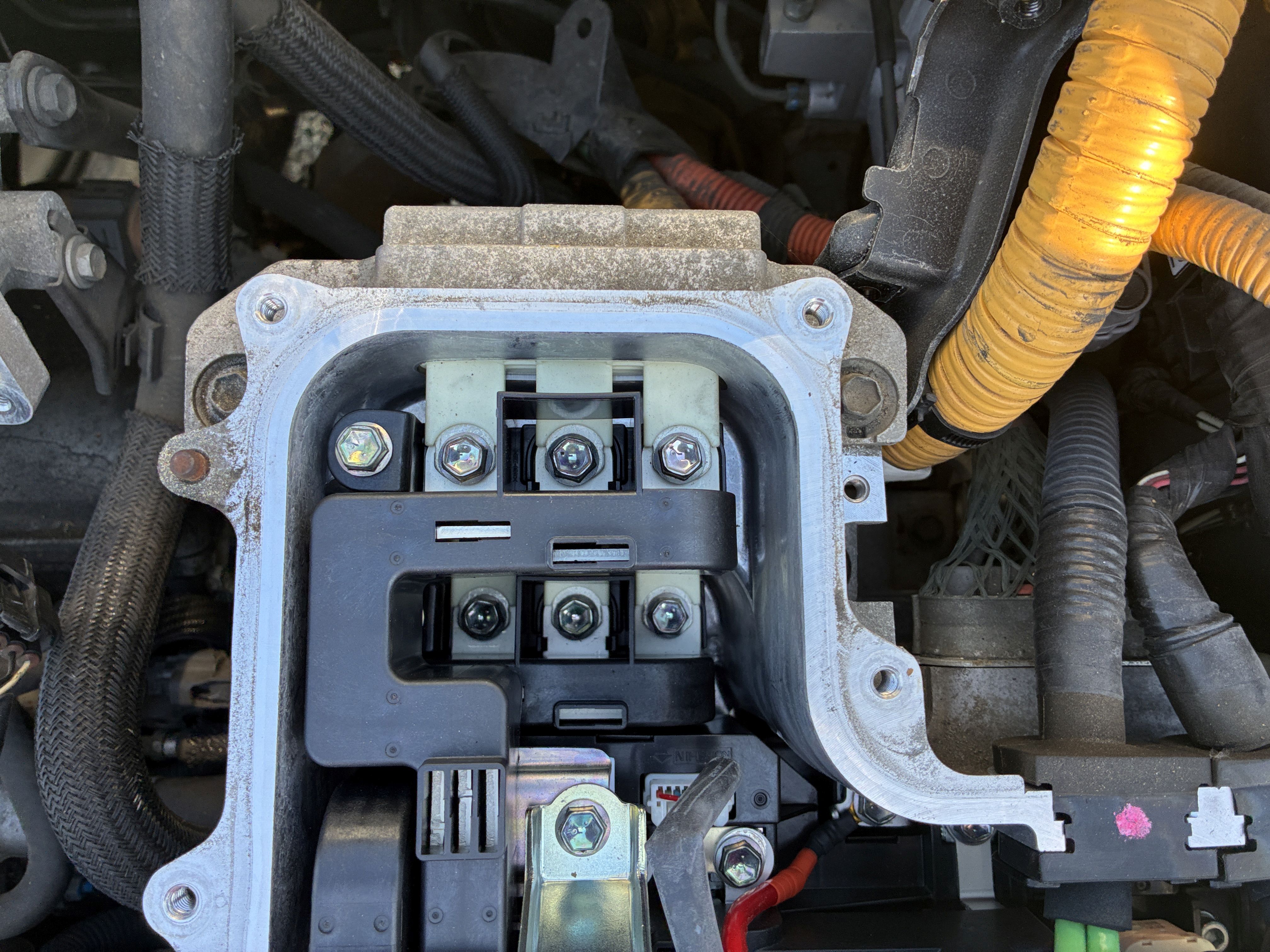

and here's what it looks like inside, all the connections are hard wired
I decided to intelligently remove/unplug all the external connections such as this Air Conditioning high voltage cable (don't ask me why)
and this is the business end of the inverter
THREE motors connect back here (if you want to get all their bolts out, bring a magnet on a stick, trust me)

and approximately 90 joyous minutes later she was out, but we weren't done yet
Note: all the external connections have been carefully and properly unplugged and removed

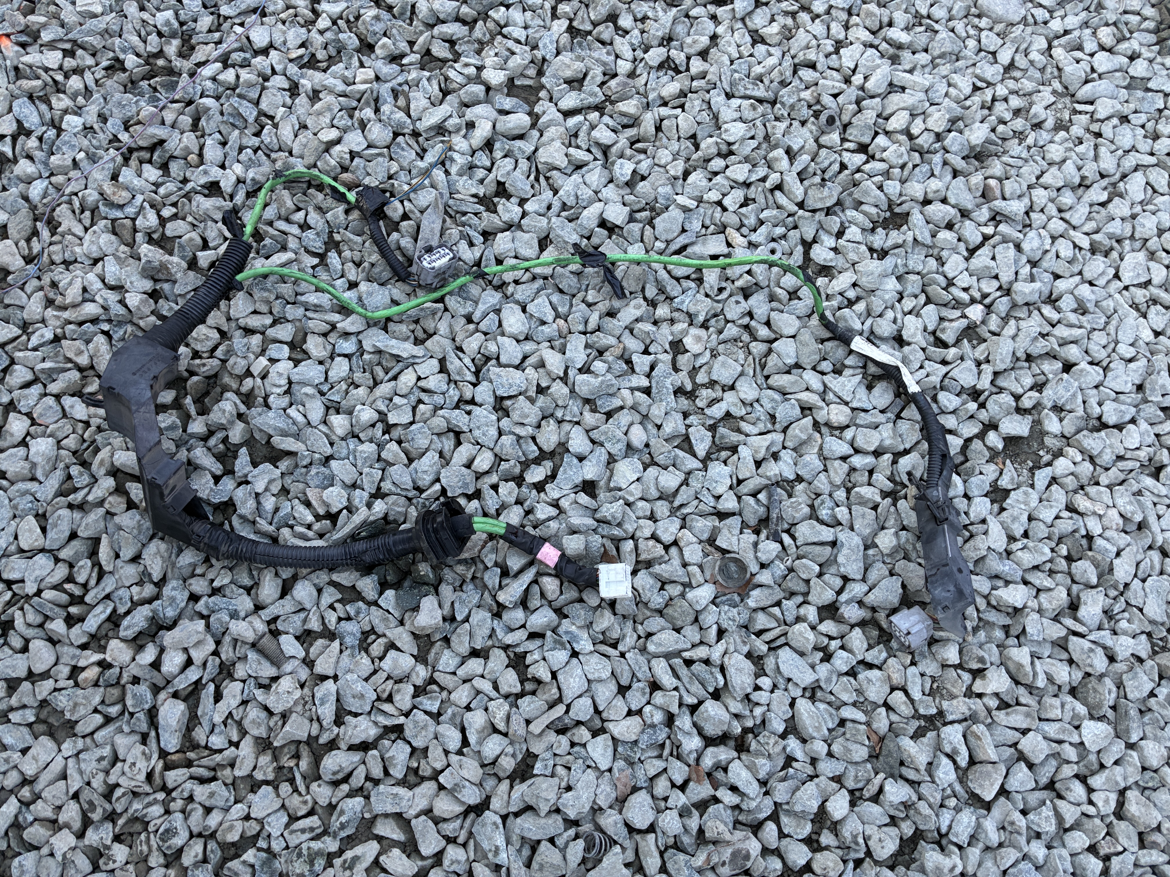

I went after the MG1 and MG2 resolver cables next - you know The Greg he just has to have his OEM harnesseseses

I kept picking her to the bone and got the Sync Serial harness as well or at least a good length of it

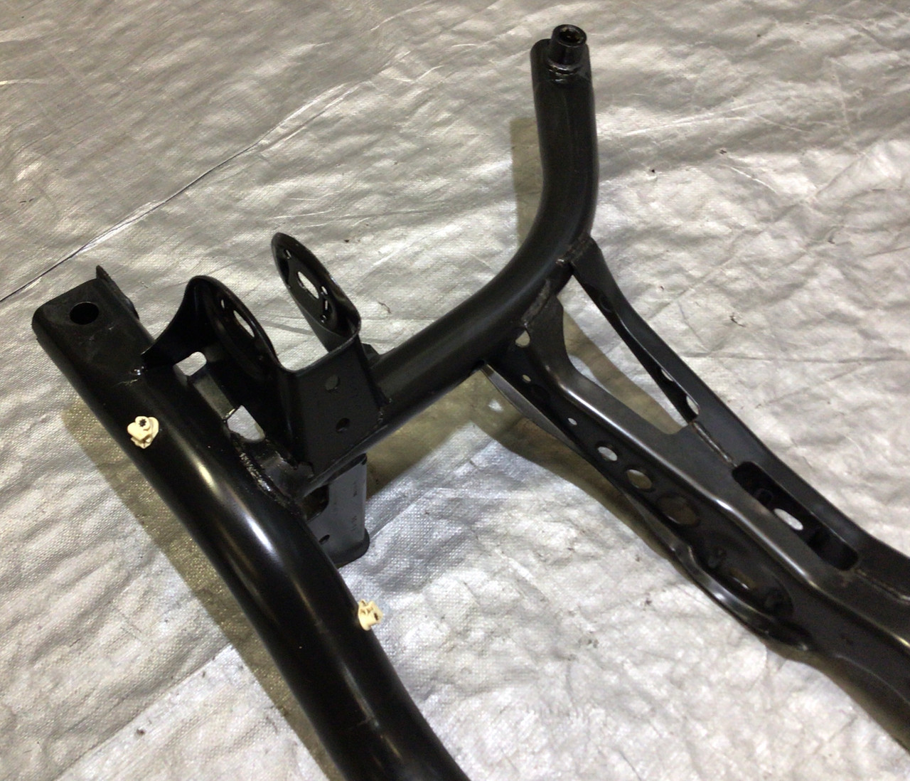

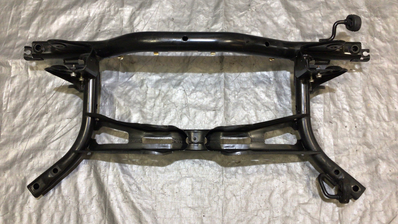

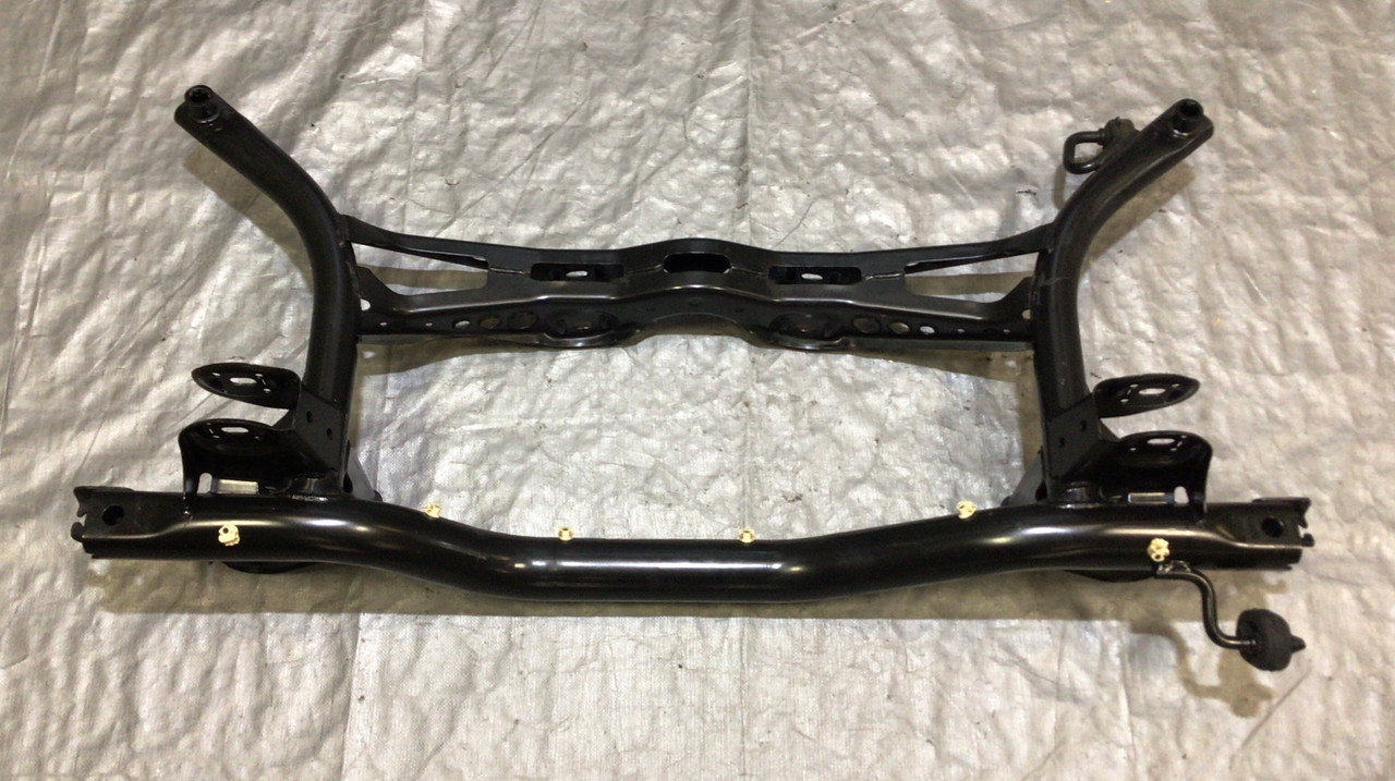

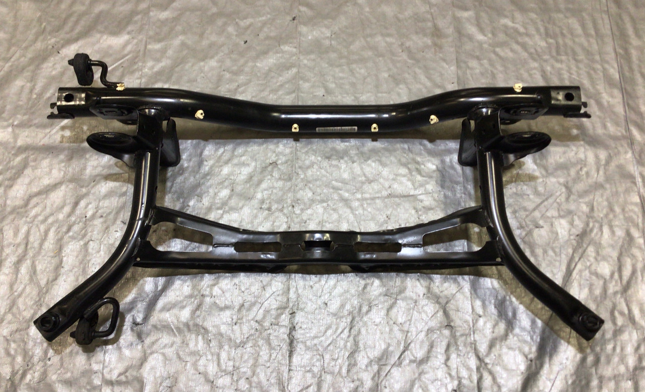

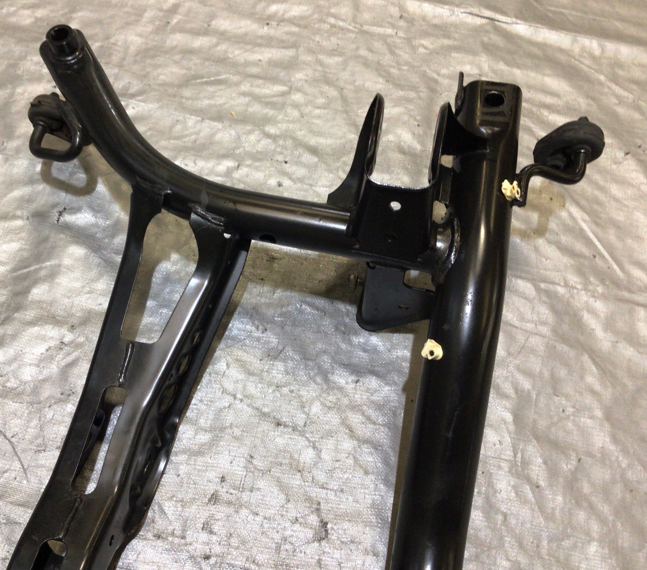

The goal here is to see if we can take a complete rear motor / subframe out of one of these animals and bolt it up or graft it in to some OEM rear engined vehicle such as the VW Beatle or the Corvair. Since the 2009 Toyota Highlander AWD seems too wide
WHAT WE KNOW
The 2006–2008 Lexus RX400h has a rear track width of 61.2 inches (1,550 mm). BINGO !!!
The rear track width of the modern Volkswagen Beetle (A5 generation, 2011–2019) is approximately 61.1 inches (1,552 mm).
as much as I would love to convert a classic Beetle or Fastback, I must follow the path of least resistance
2012-2019 Volkswagen Beetle Rear Subframe Crossmember / 61k / VB004

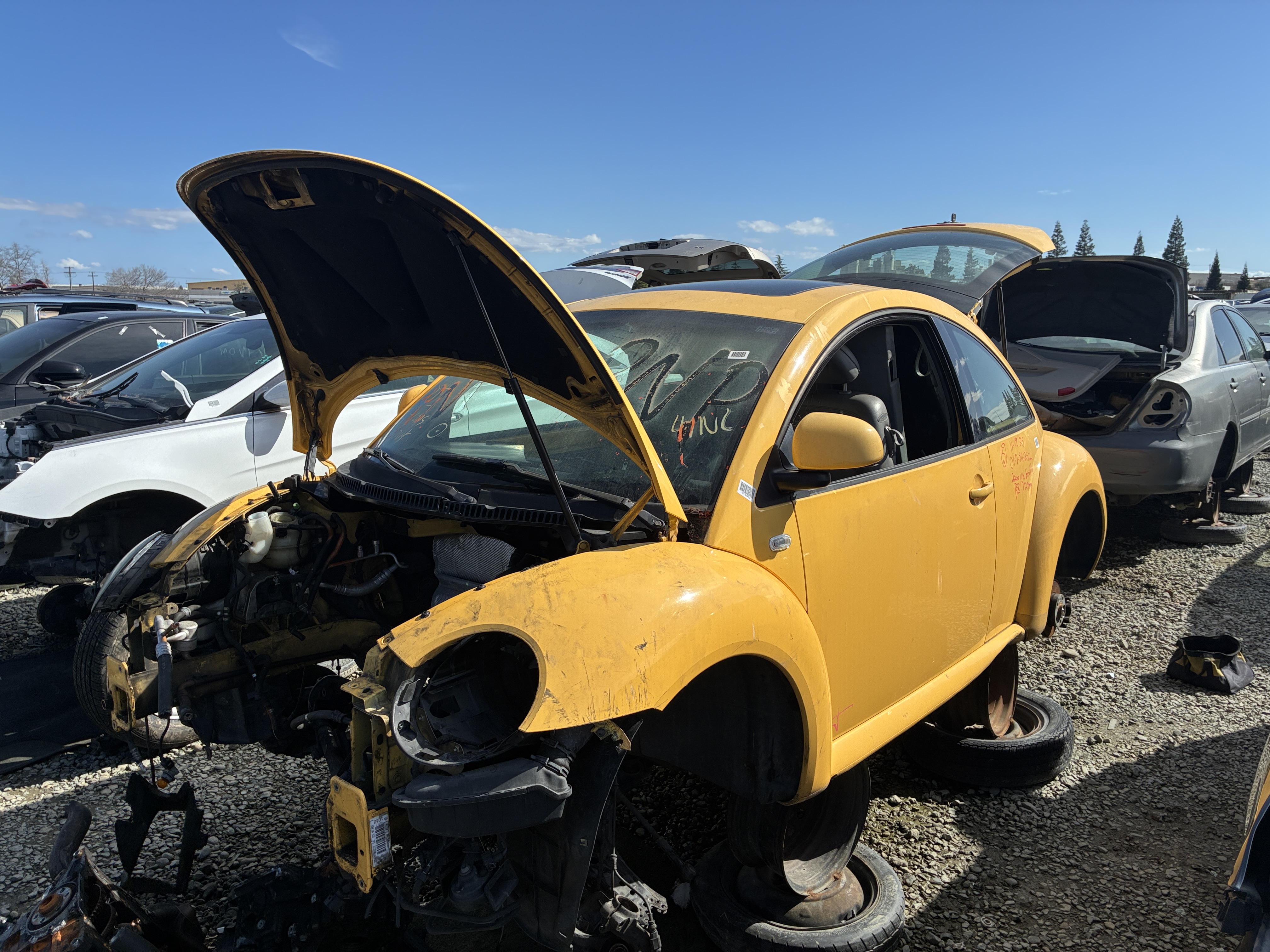

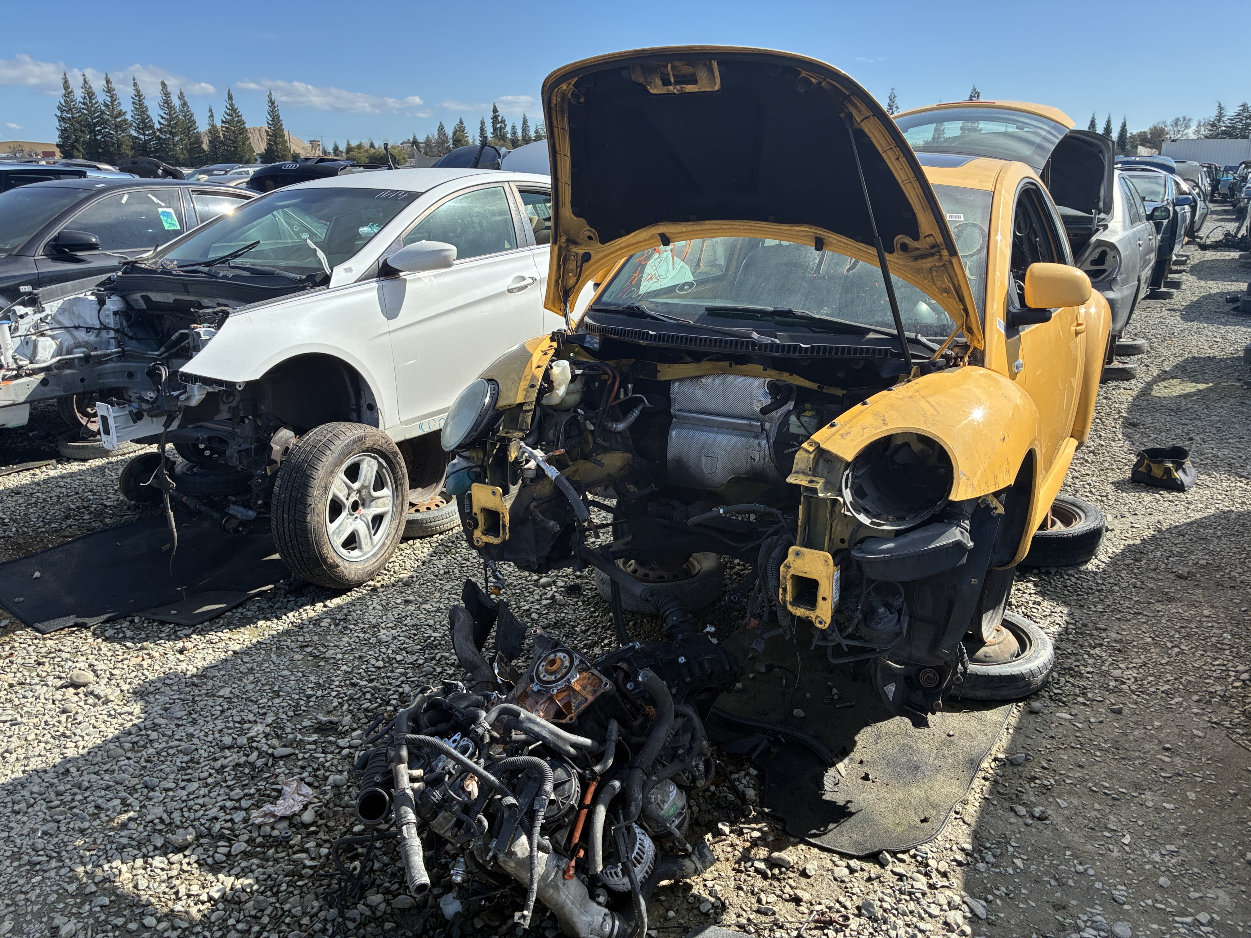

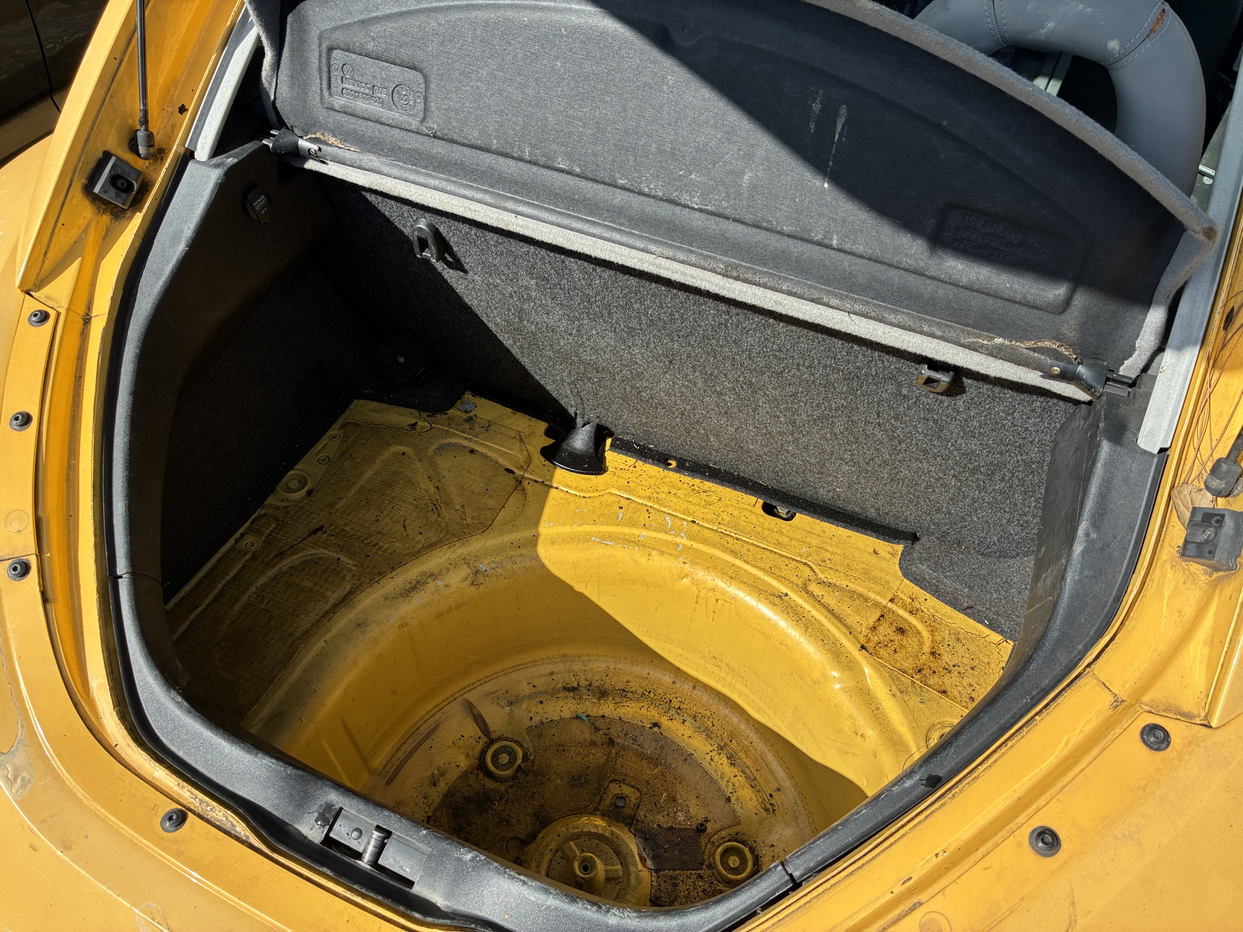

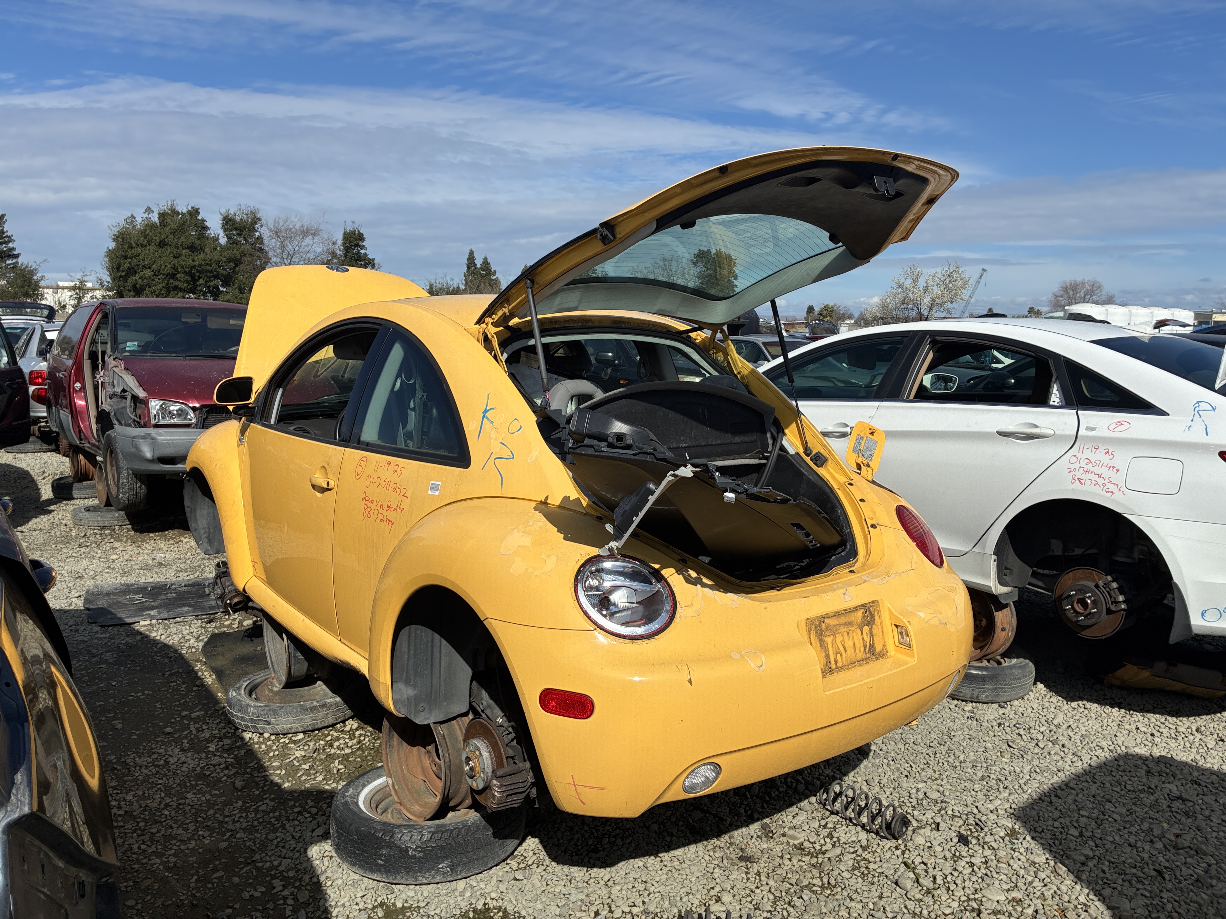

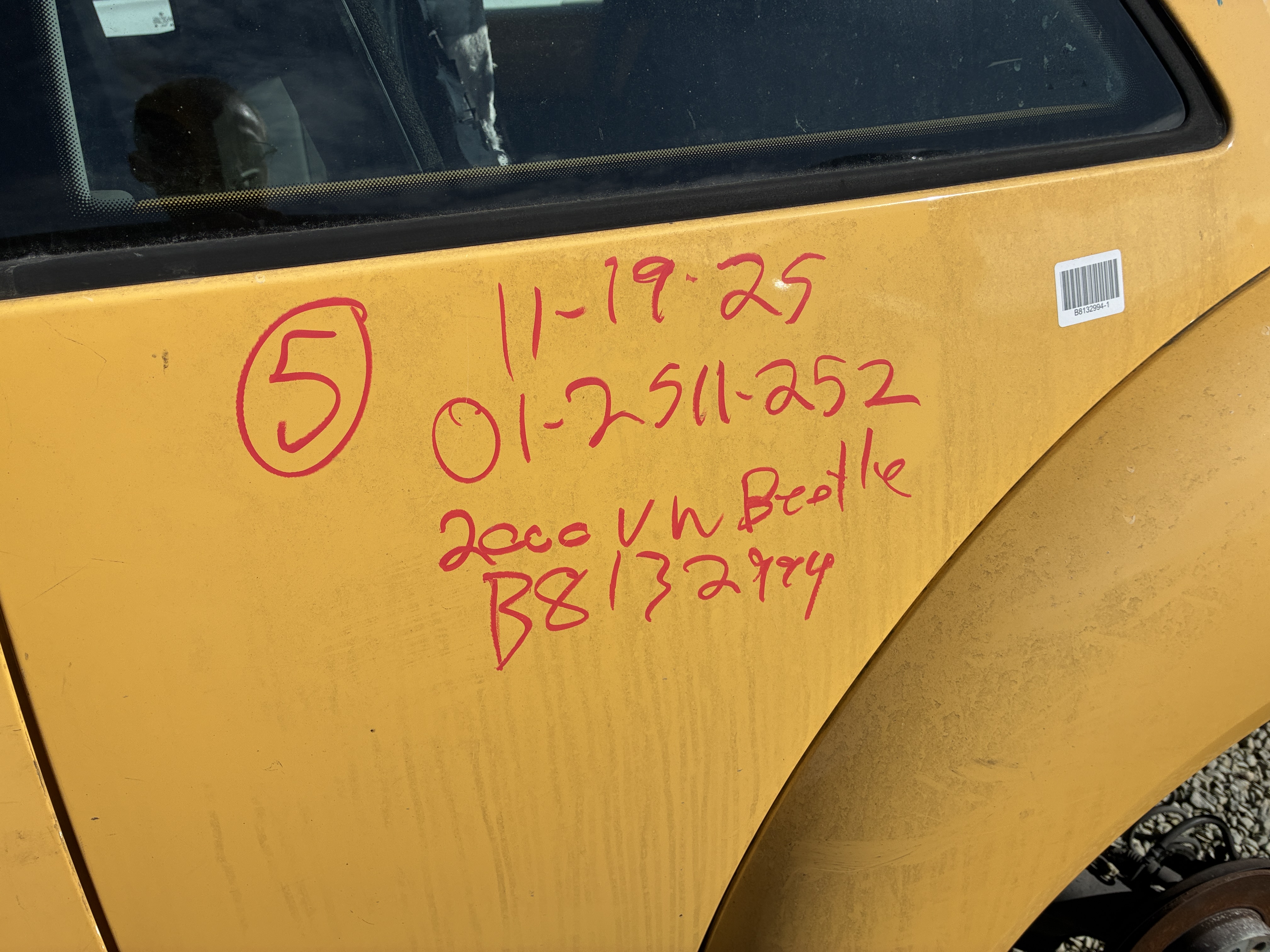

So today I decided to go do some "modern" VW Beetle recon in the junkyard, and tell you what a complete fool I am
What's wrong with this picture ?
Gregski
Posts: 3156
Has thanked: 628 times
Been thanked: 1606 times
Re: Junkyard Report: 2008 Lexus RX400h AWD
Post by Gregski »
That's right, the engine is in the FRONT ? Did I know that, um no, yes I am a complete idiot! What next, four door Porsches?
so I am aborting the modern Beetle conversion and may try to convert a proper rear air cooled engine classic one, if I find one at the right price or for FREE, I am also tying to convince my Bestie to buy one and partner up with me on the conversion where he ends up keeping the car

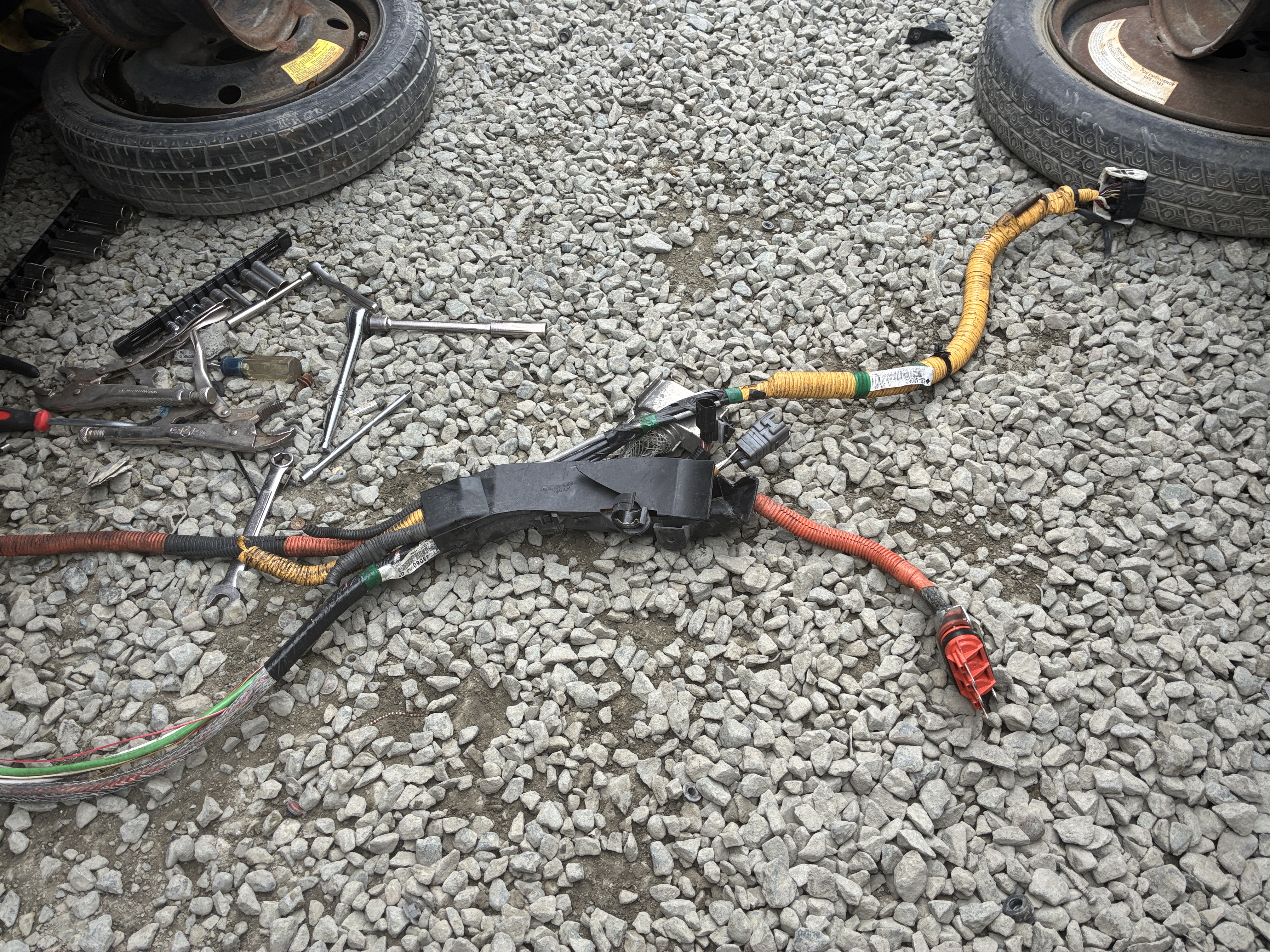

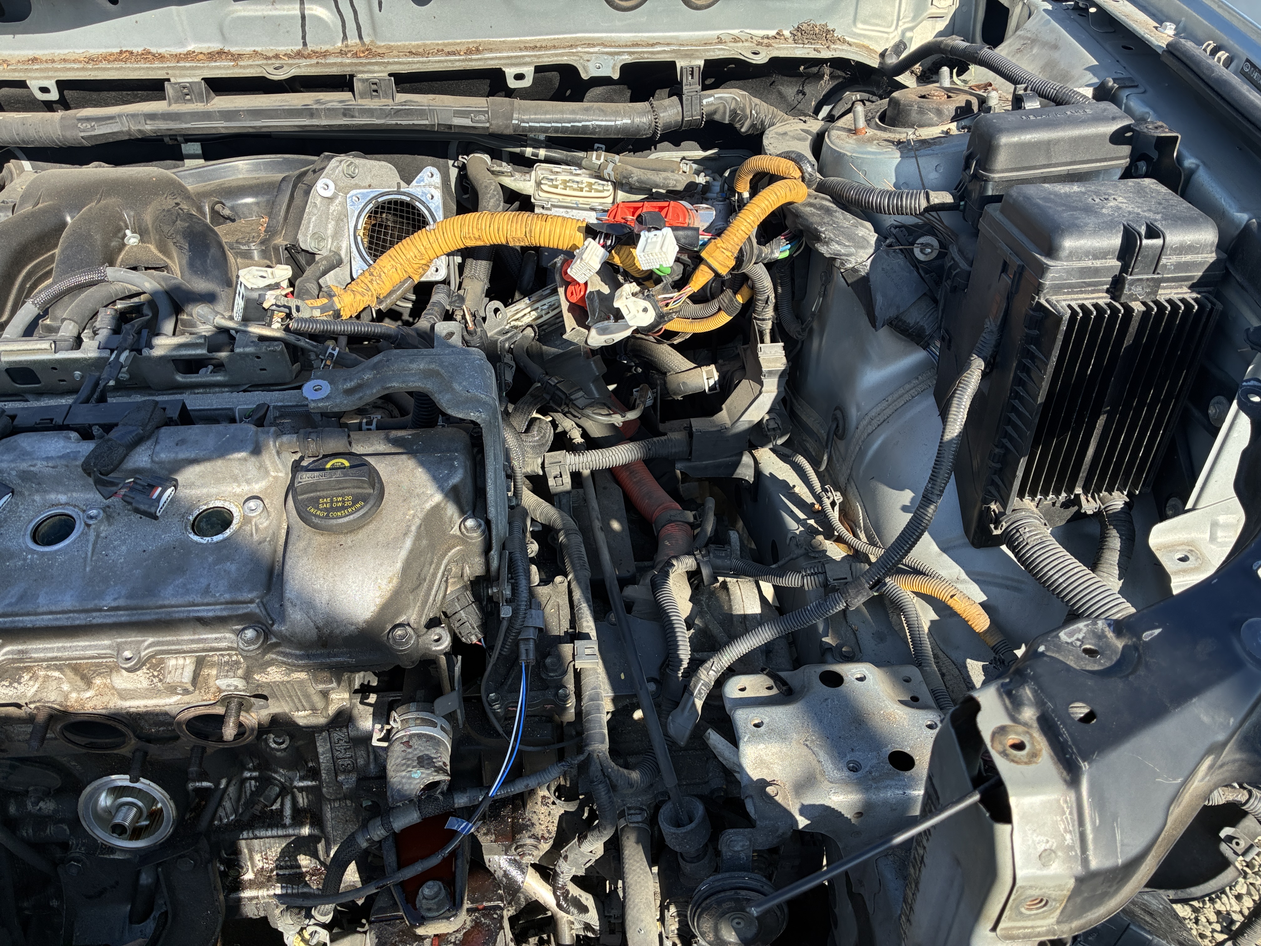

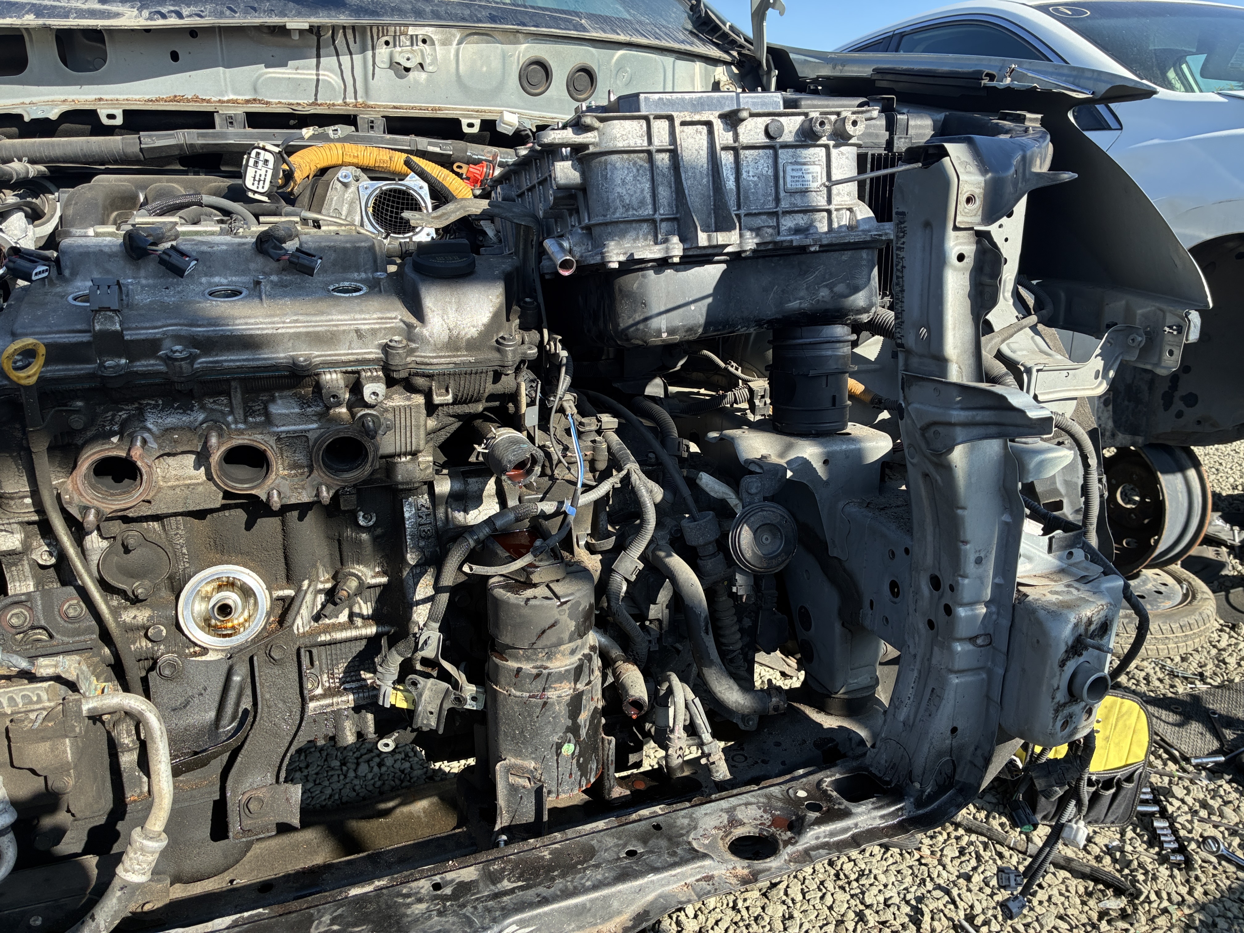

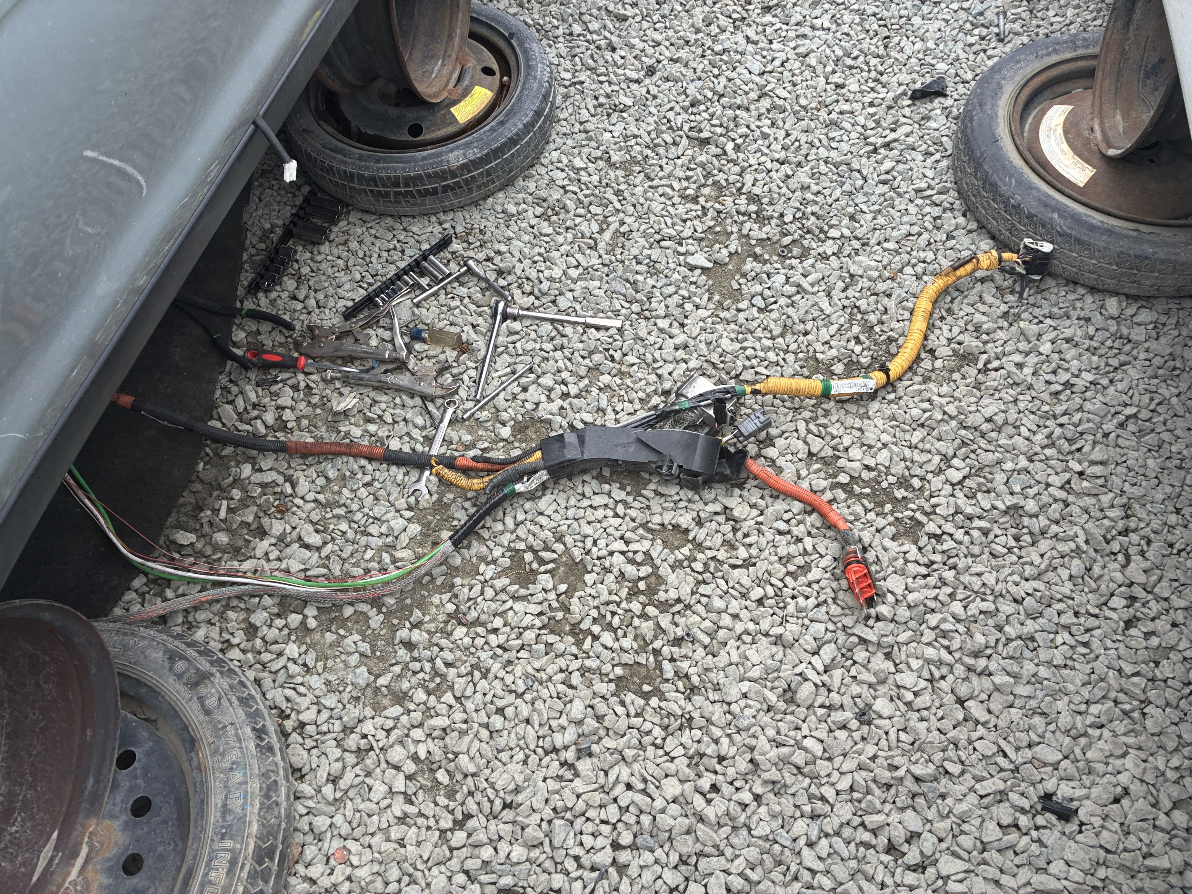

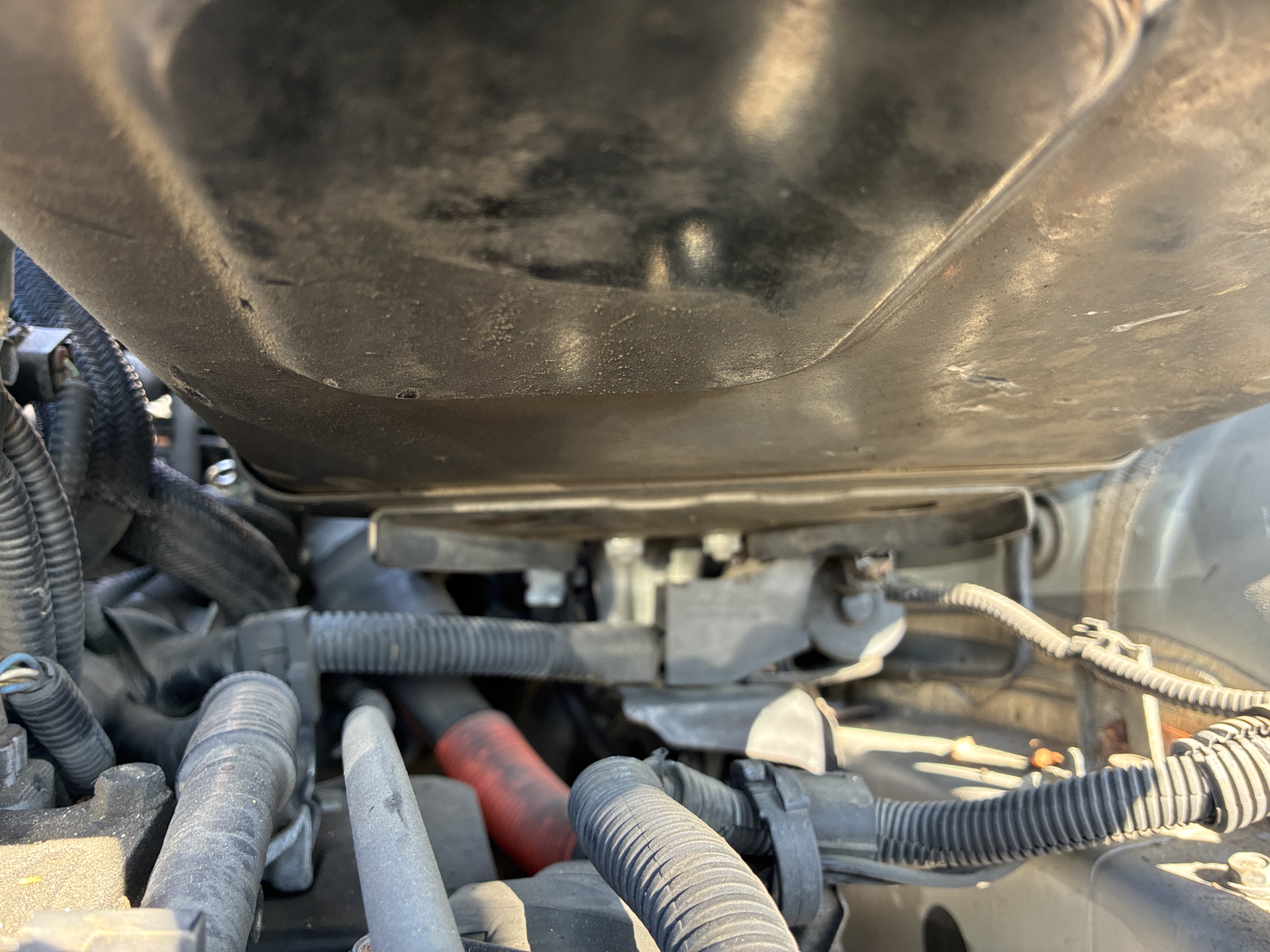

So with my tail tucked in between my legs I decided to revisit this RX400h and see if I can pull some of them MGR motor and inverter cables and maybe battery cables as well
here is part of the octopus pulled from the front of the vehicle and out from under, of note is that yellow section which runs to the electric power steering rack
and here is the battery pack cable liberated

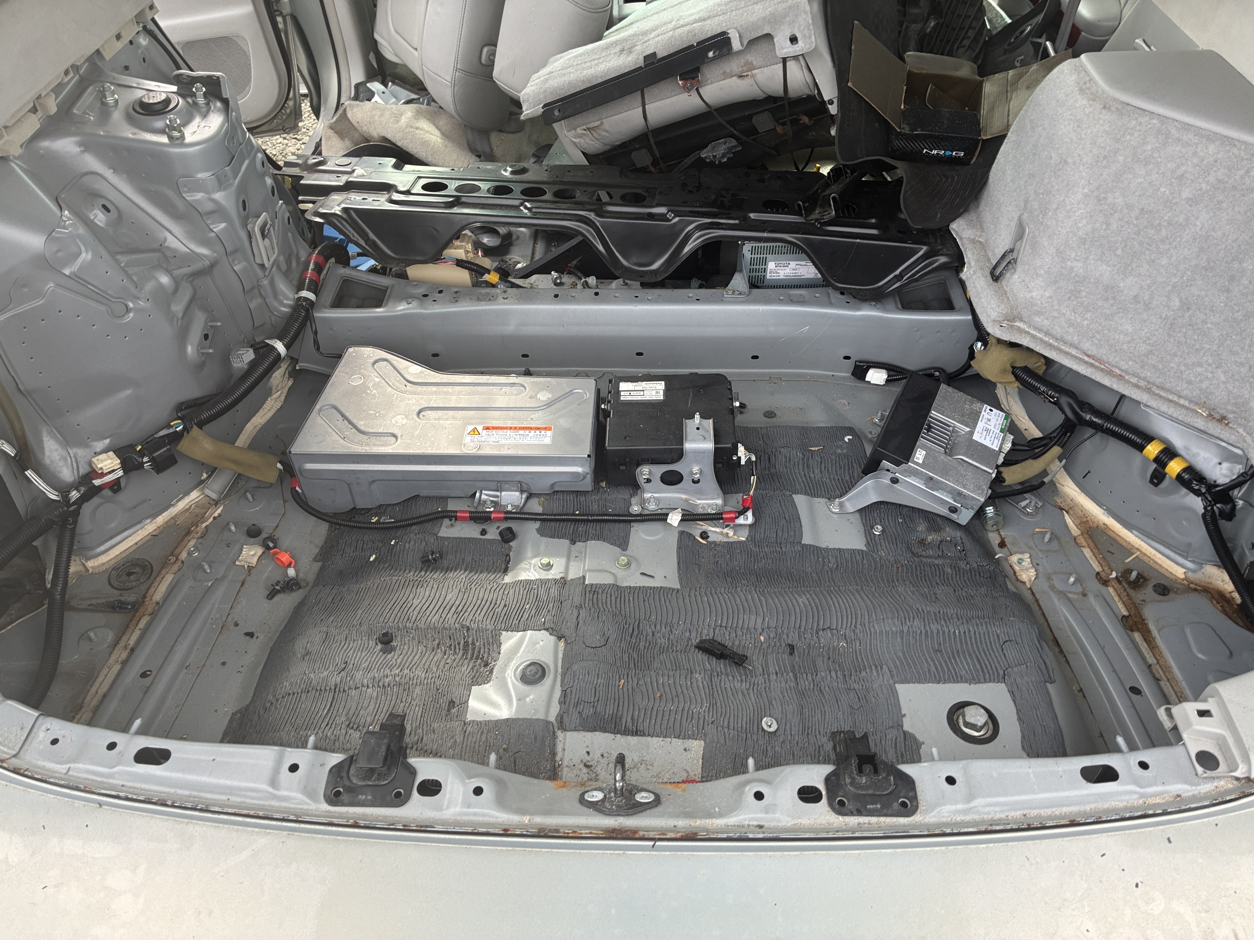

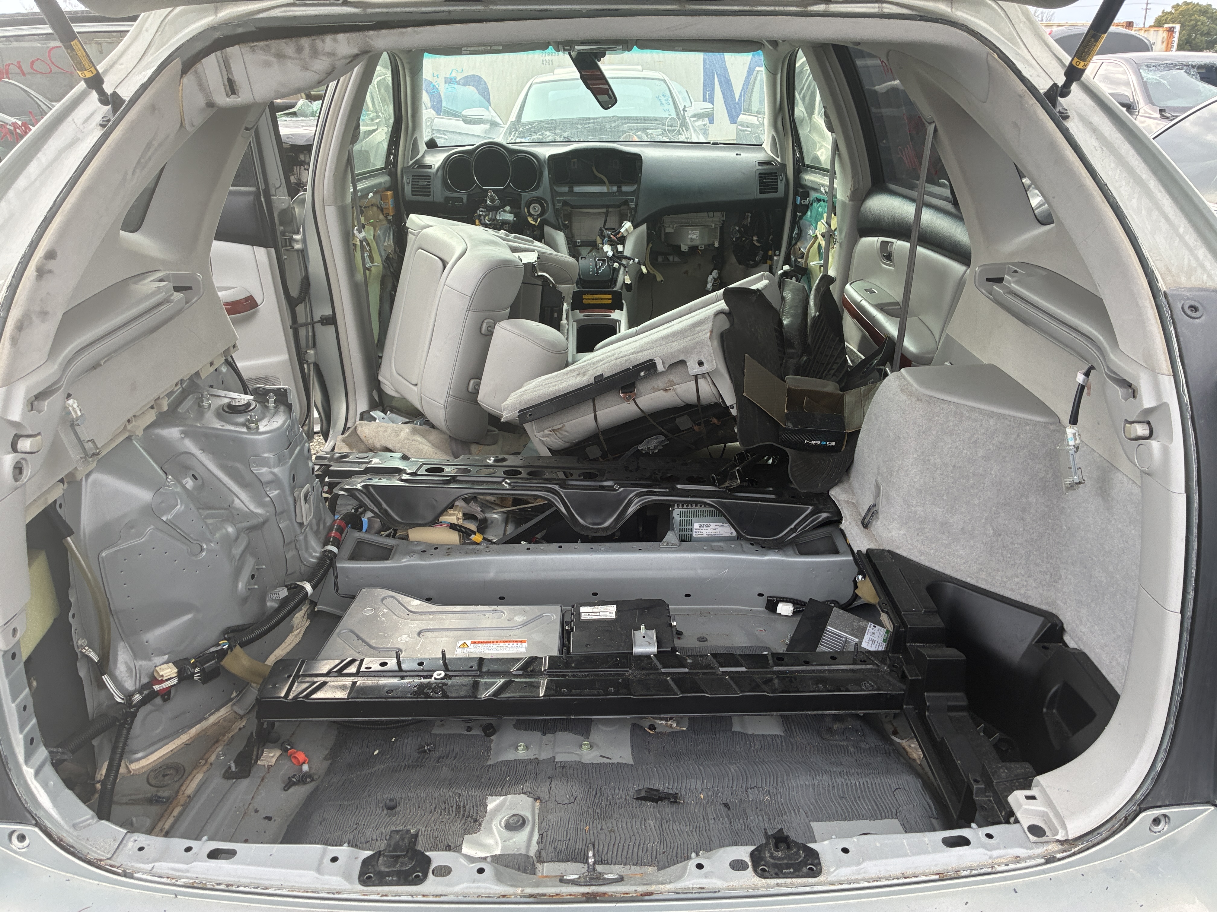

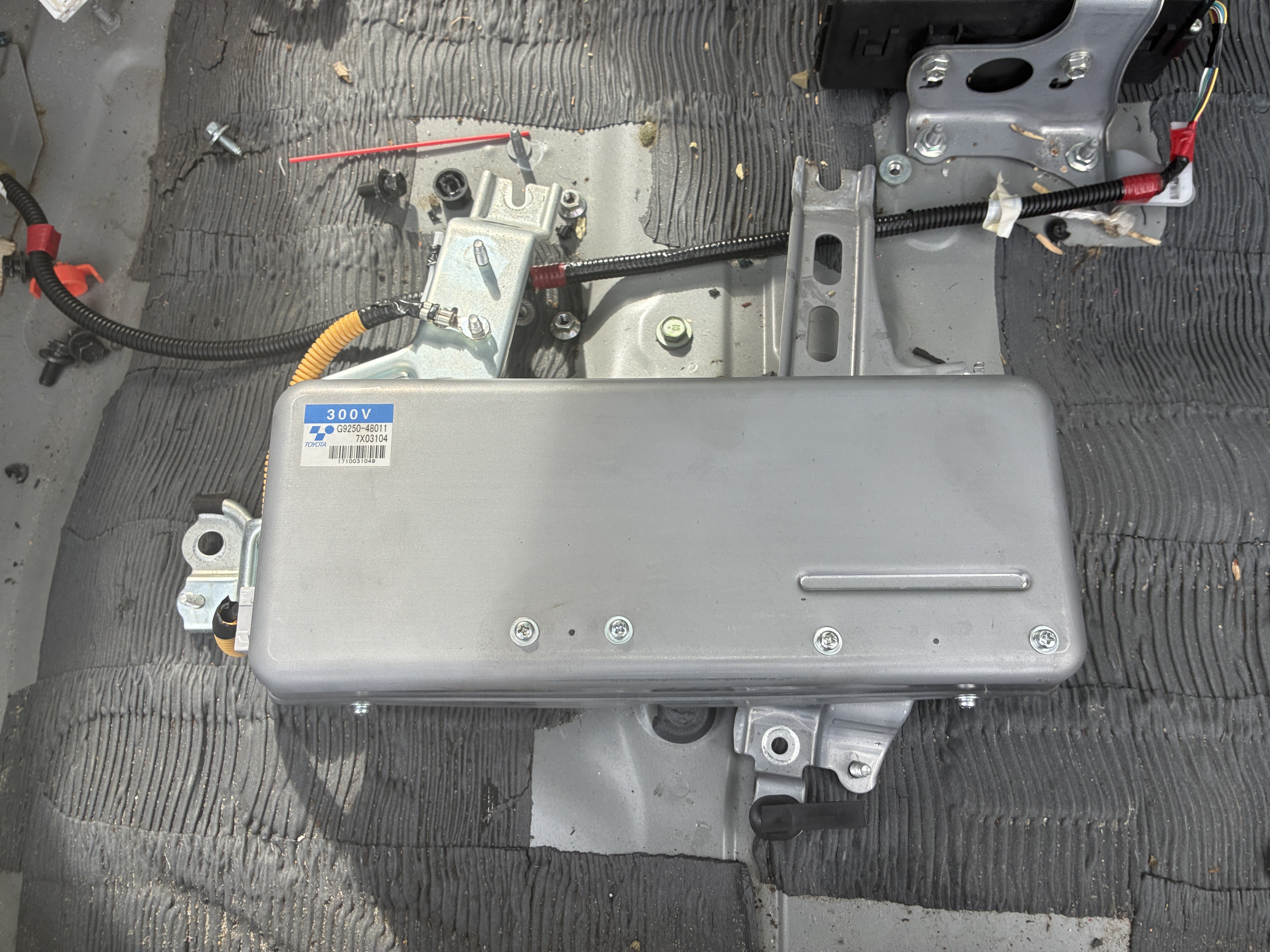

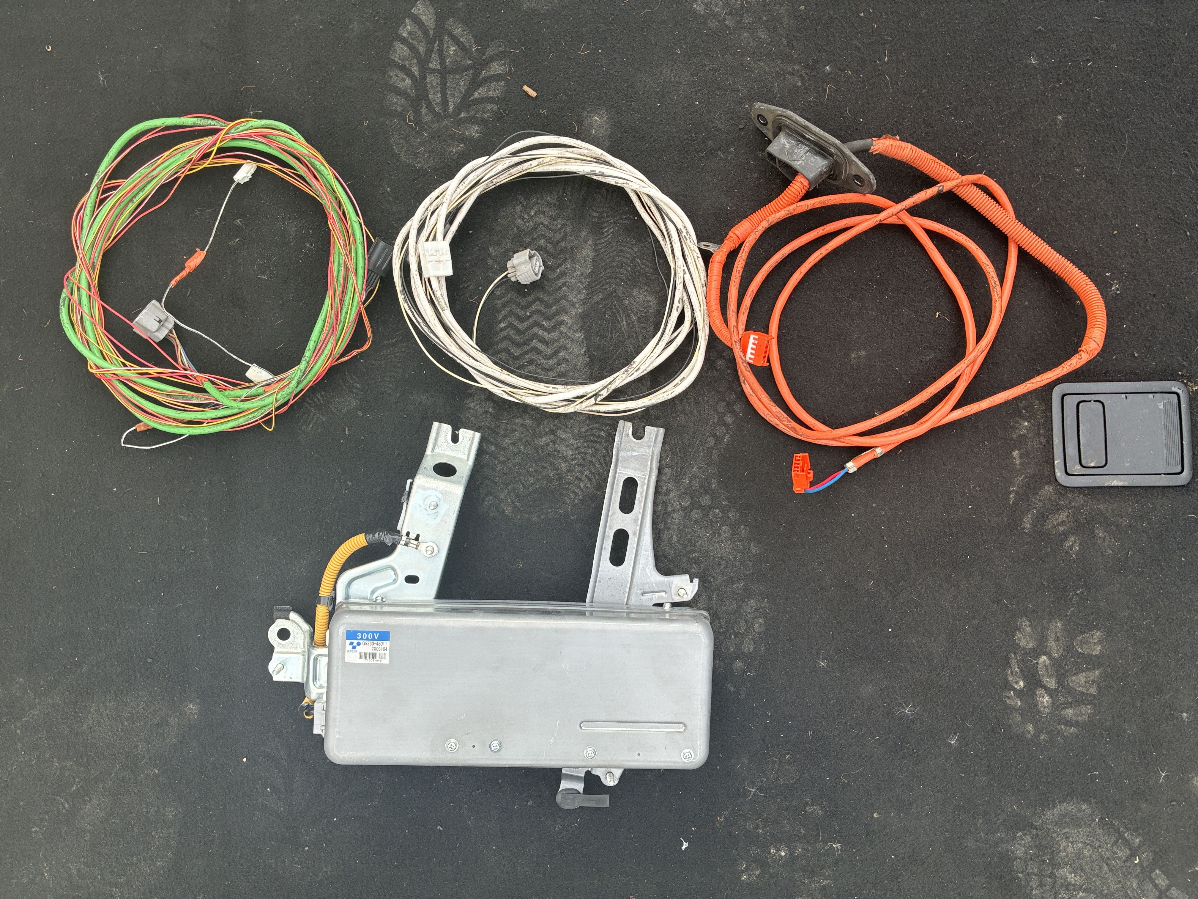

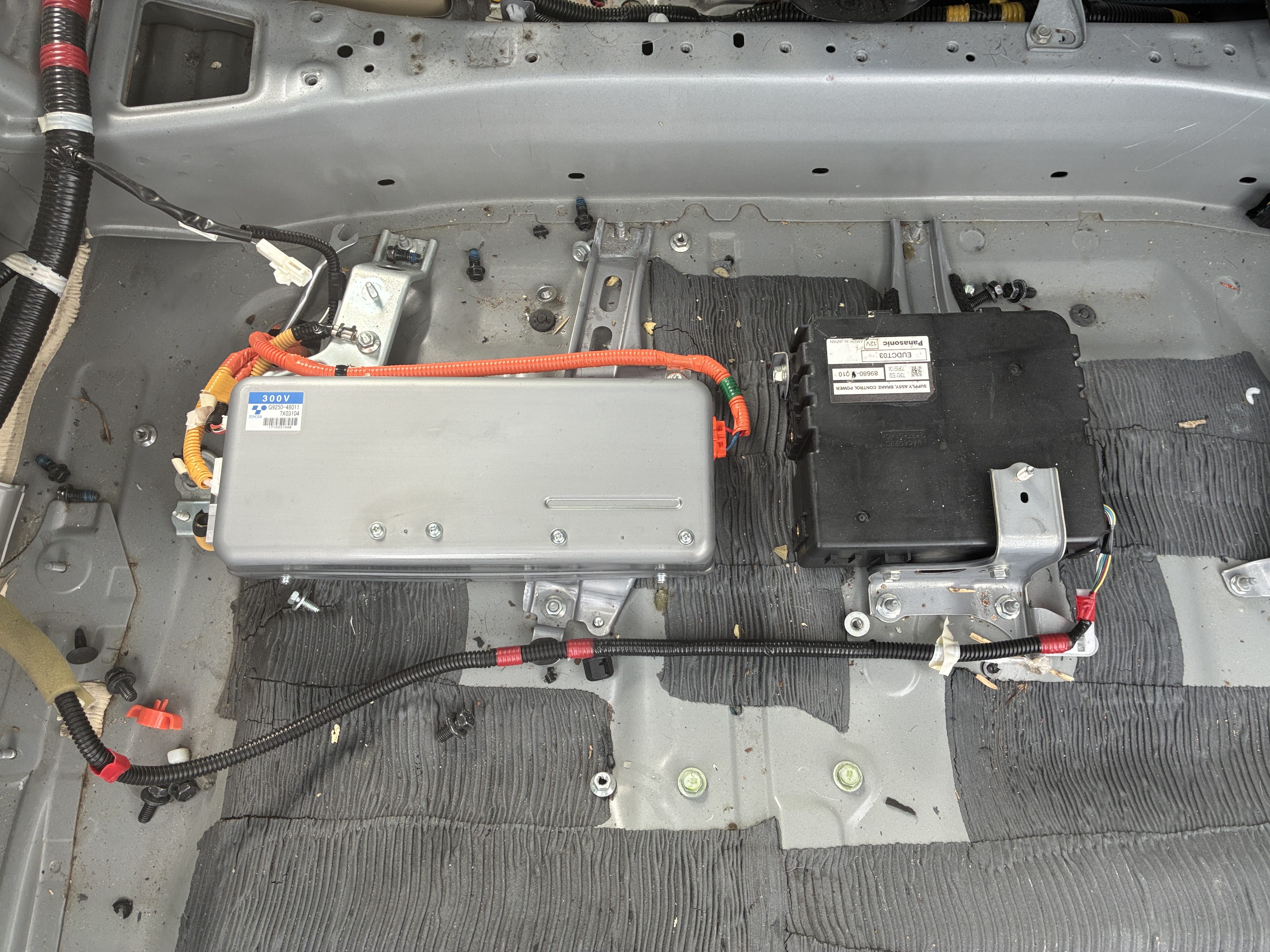

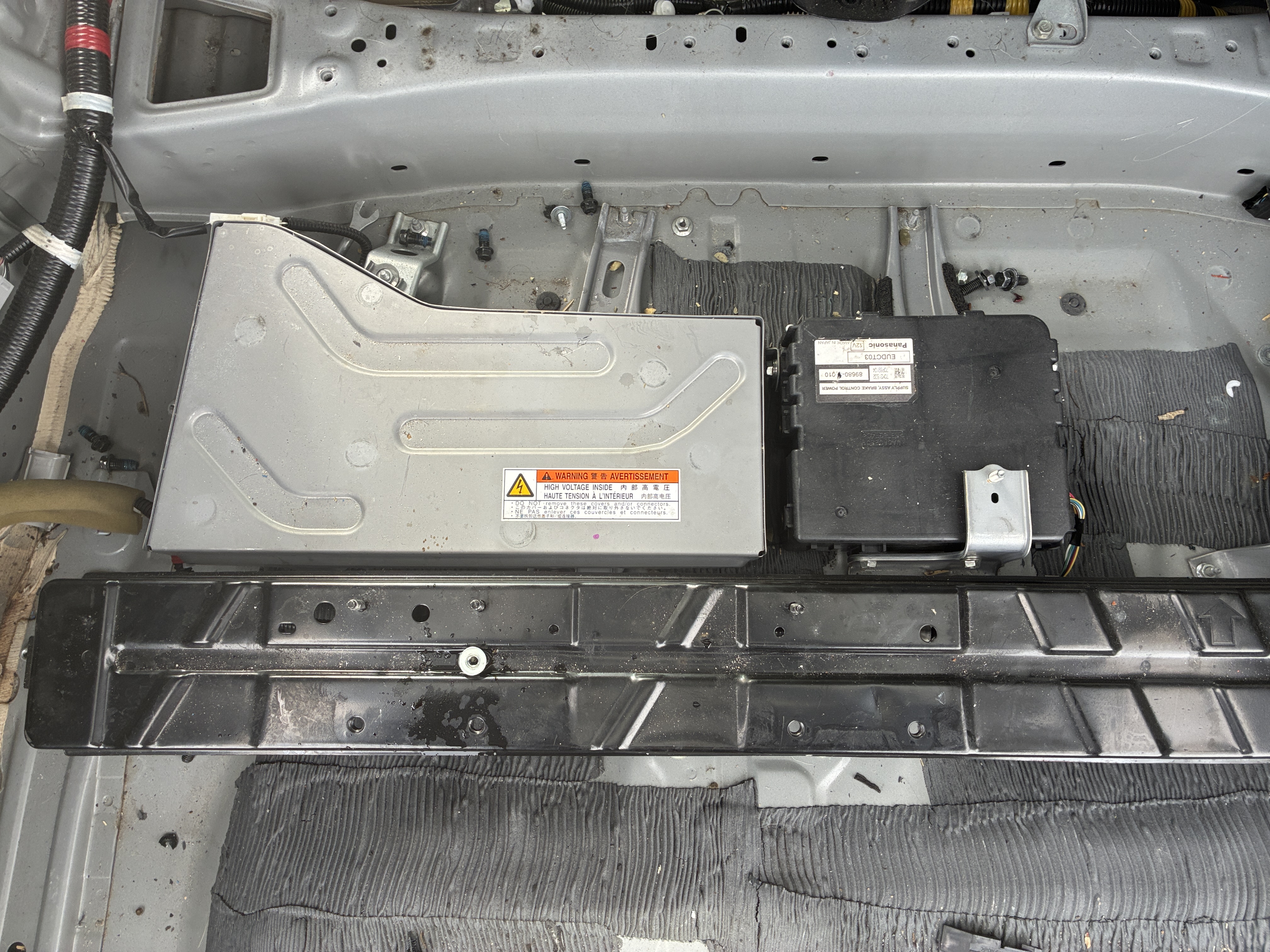

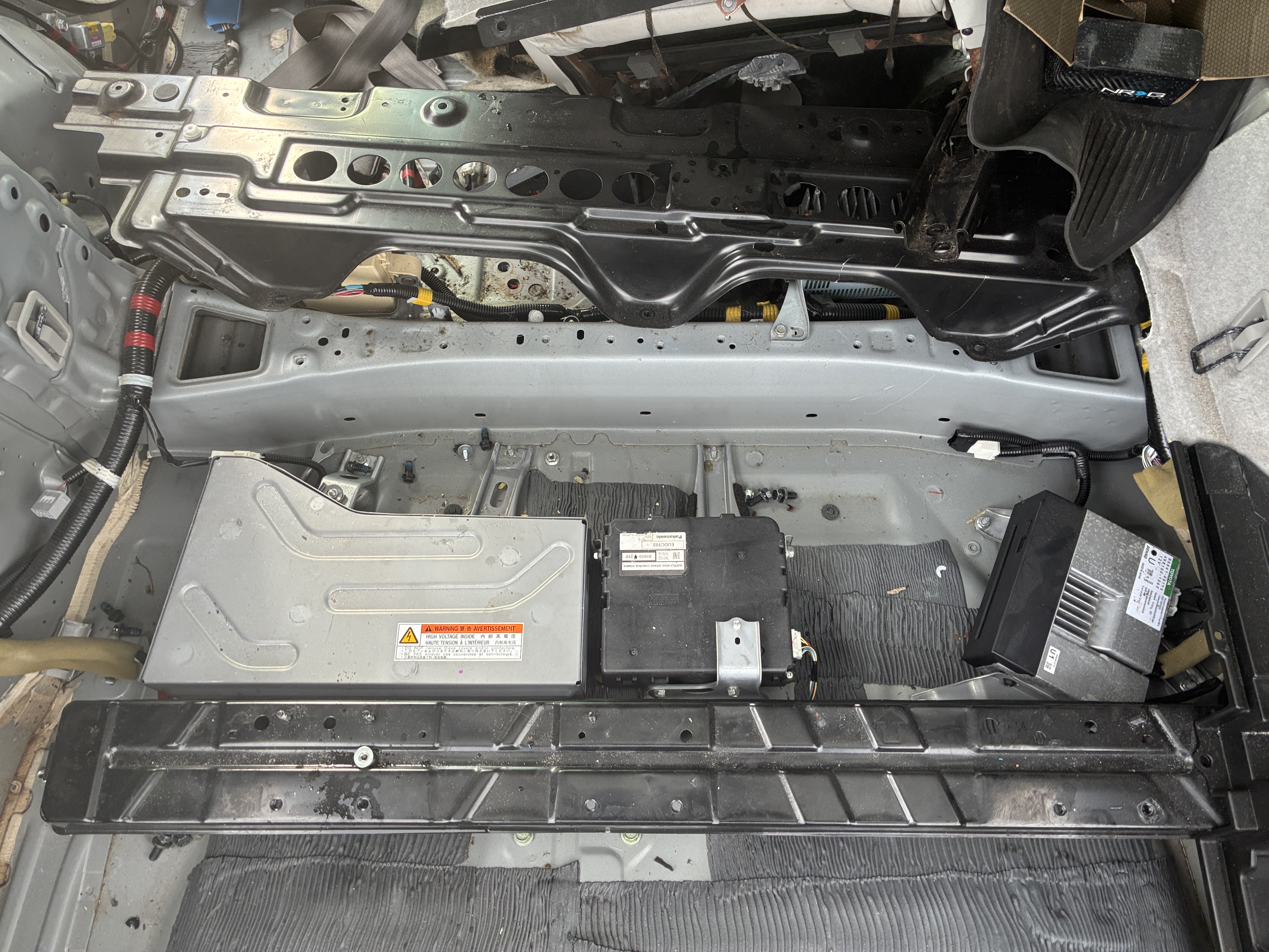

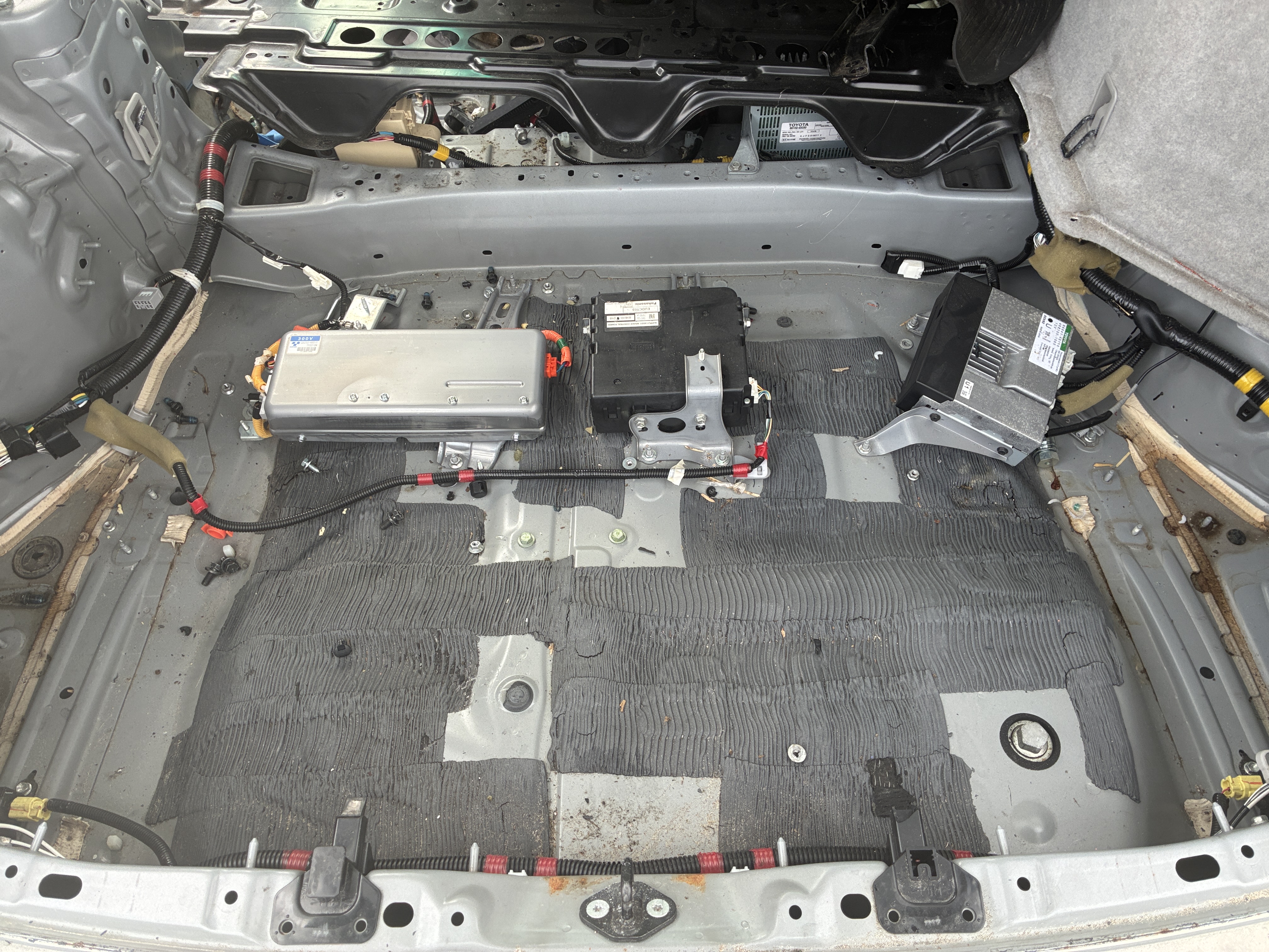

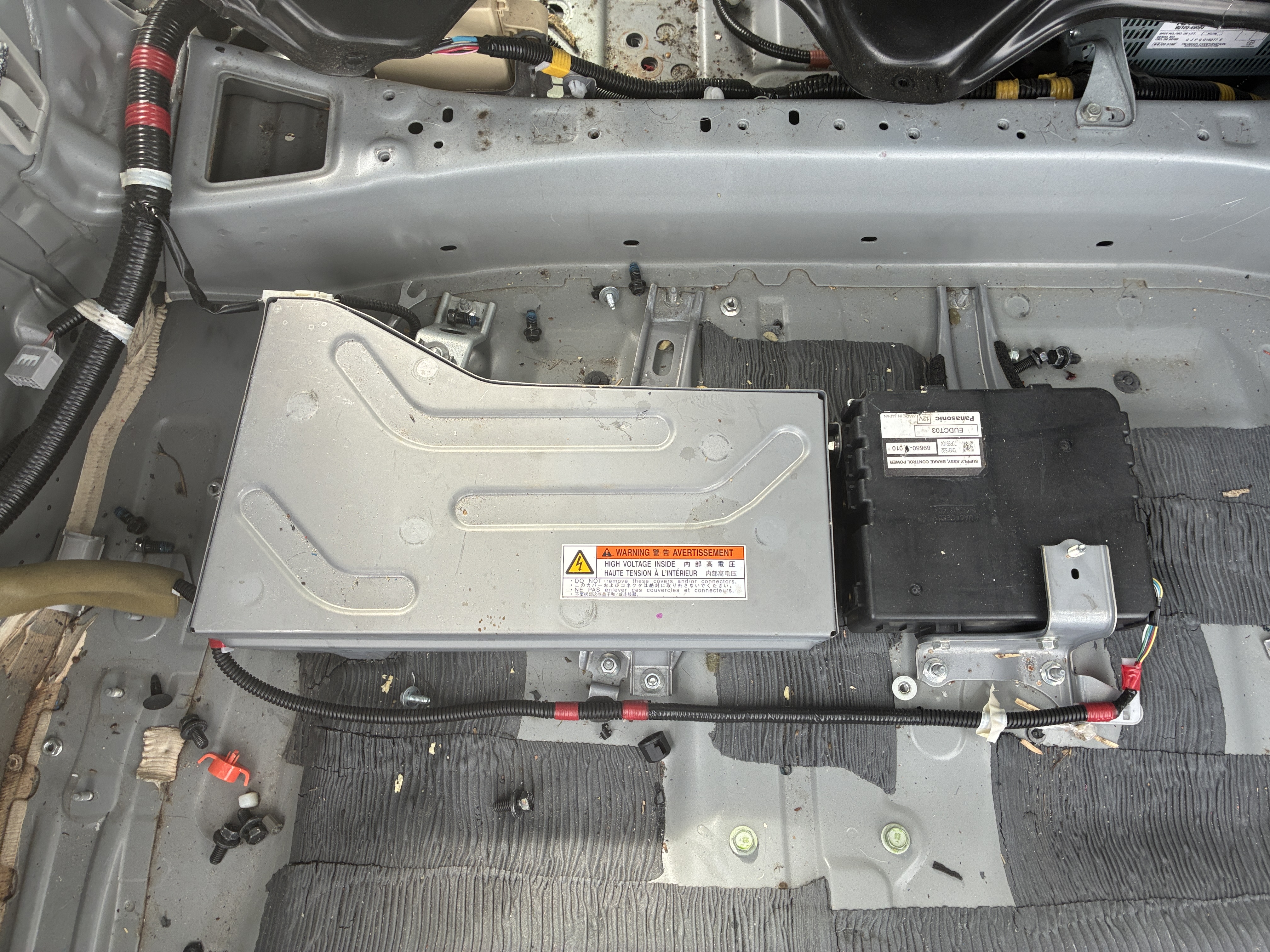

Hidden in the back of the vehicle is what I believe is the 300 volt air cooled DC-DC Converter part number G9250-48011
Gregski
Posts: 3156
Post by Gregski »

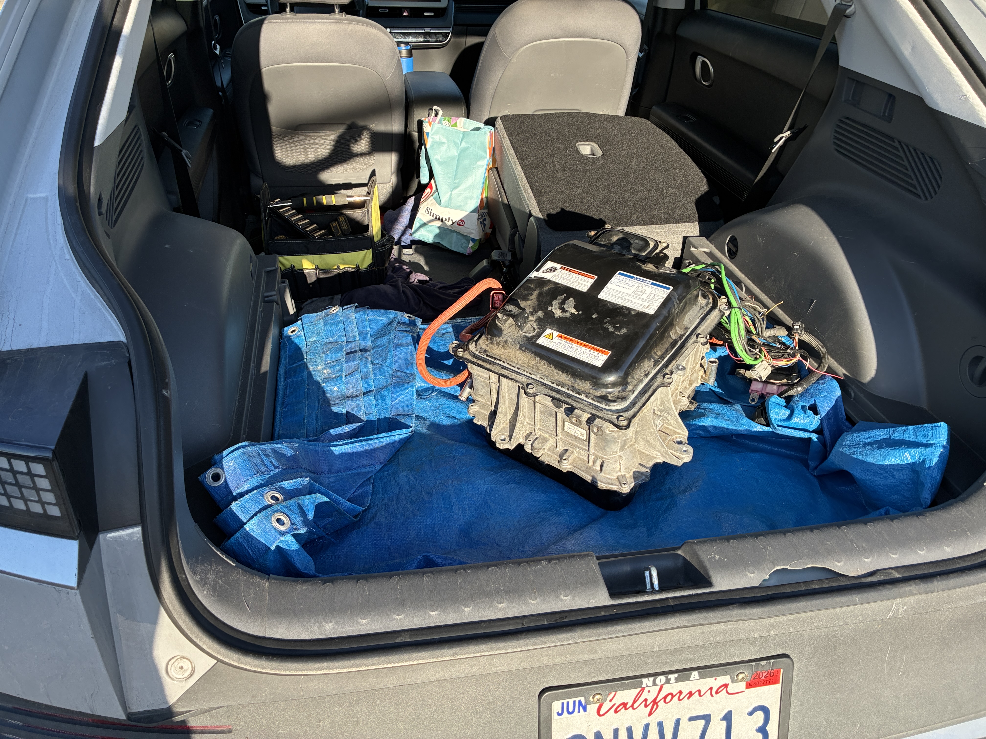

I did not end up buying the DC-DC converter I just took it out for a photo shoot

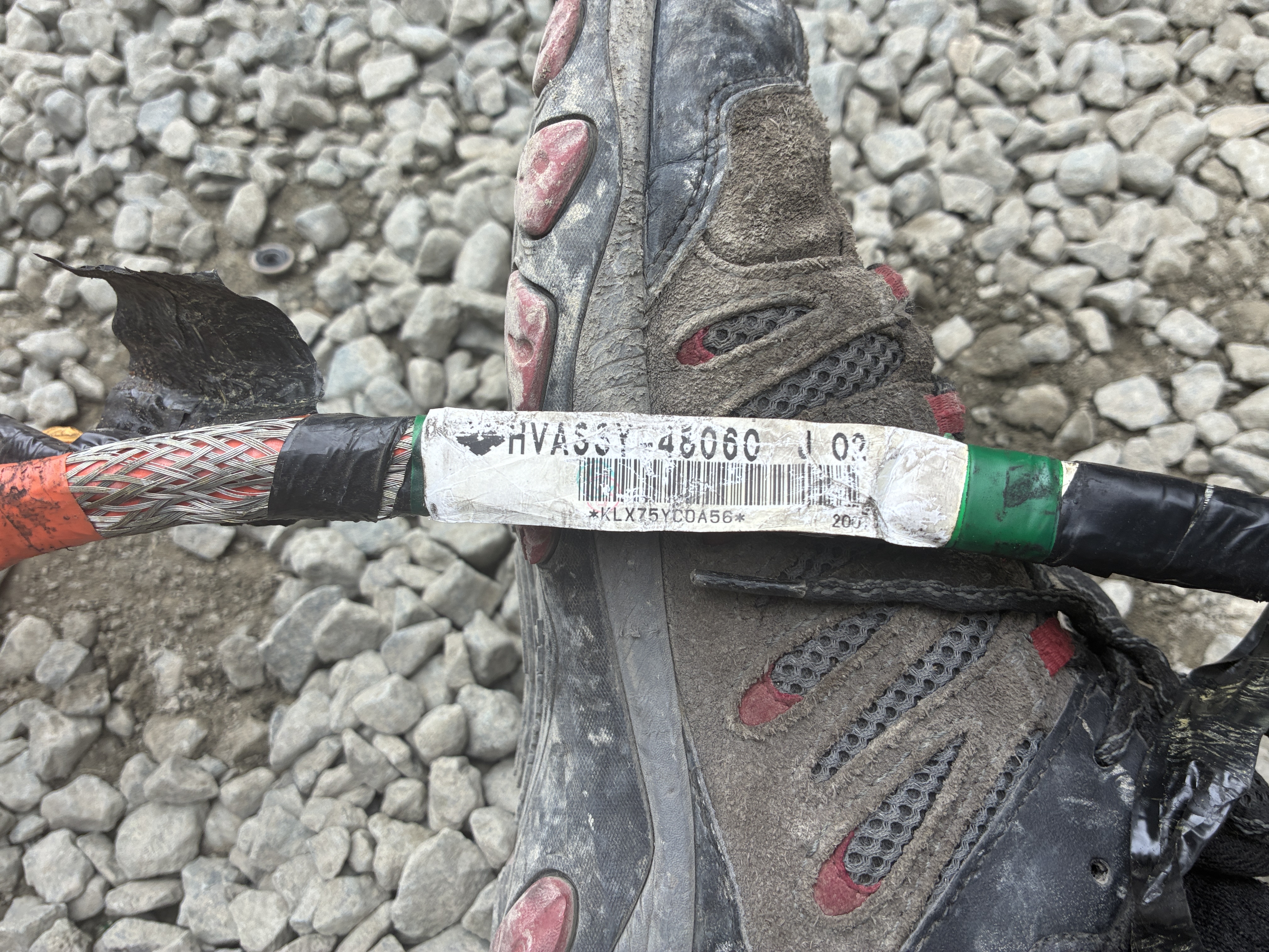

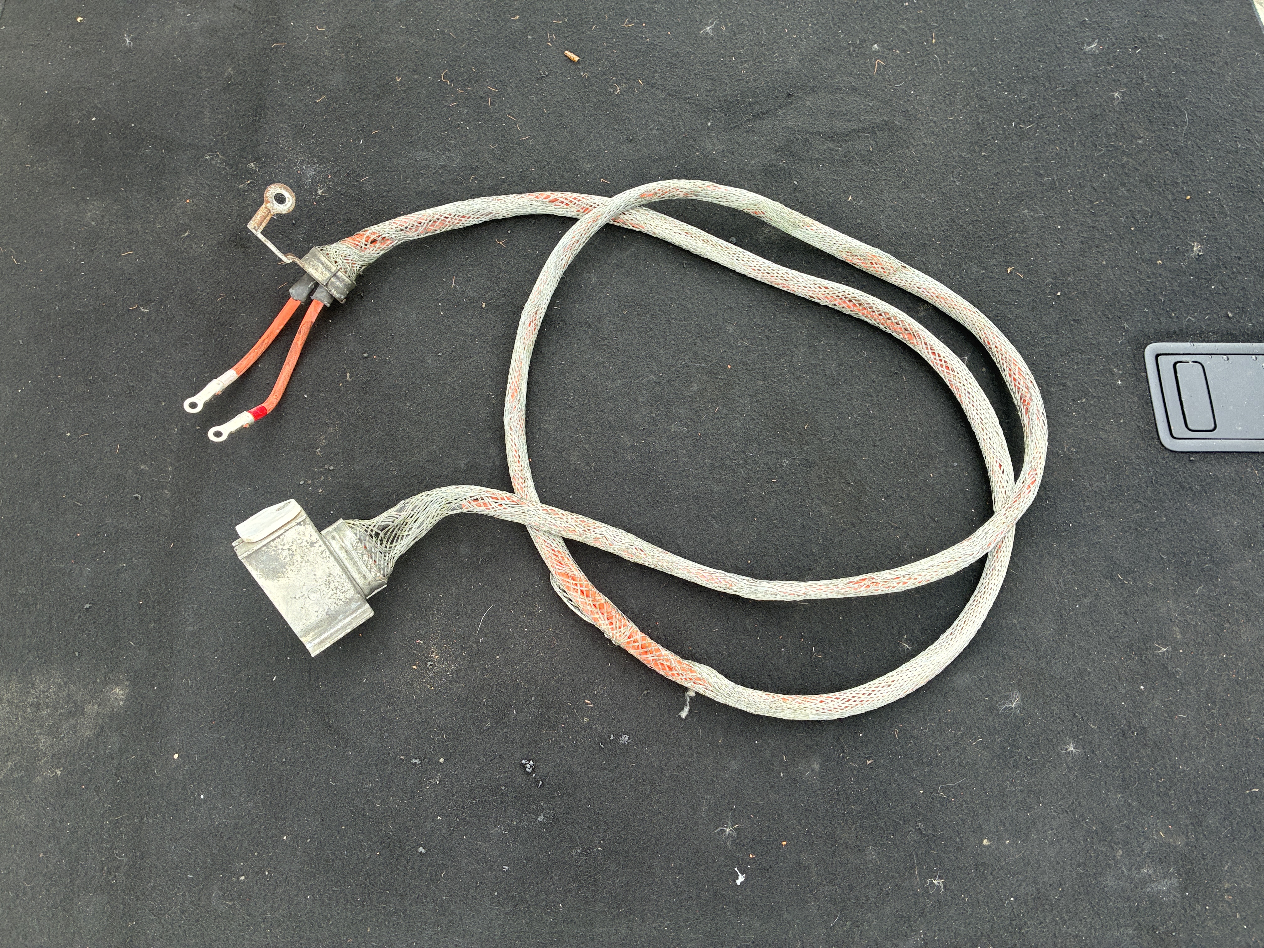

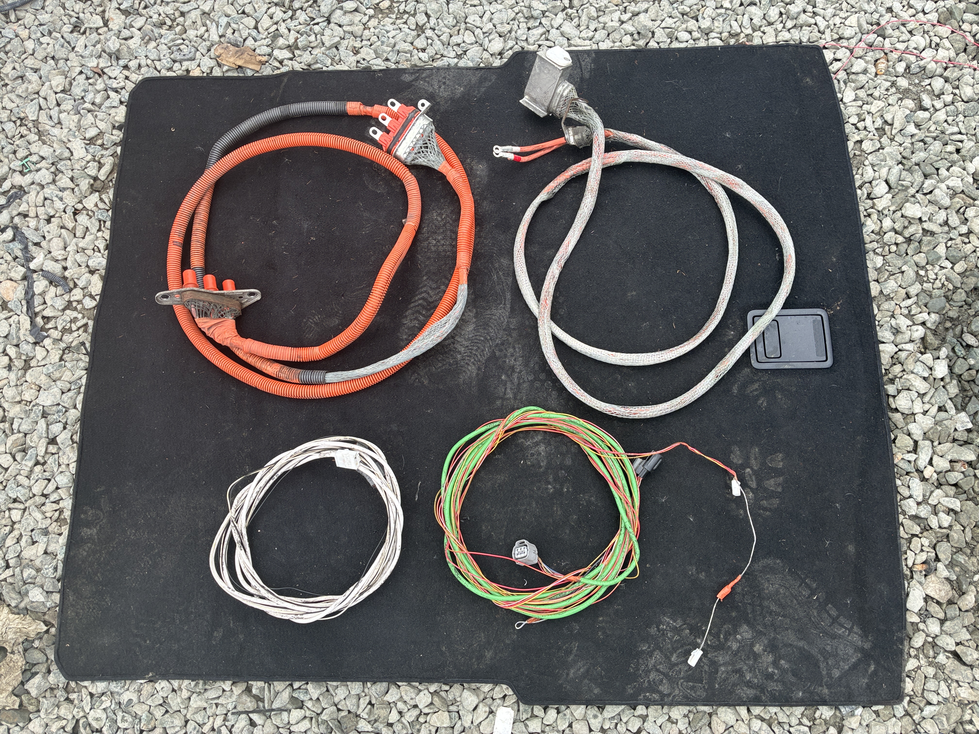

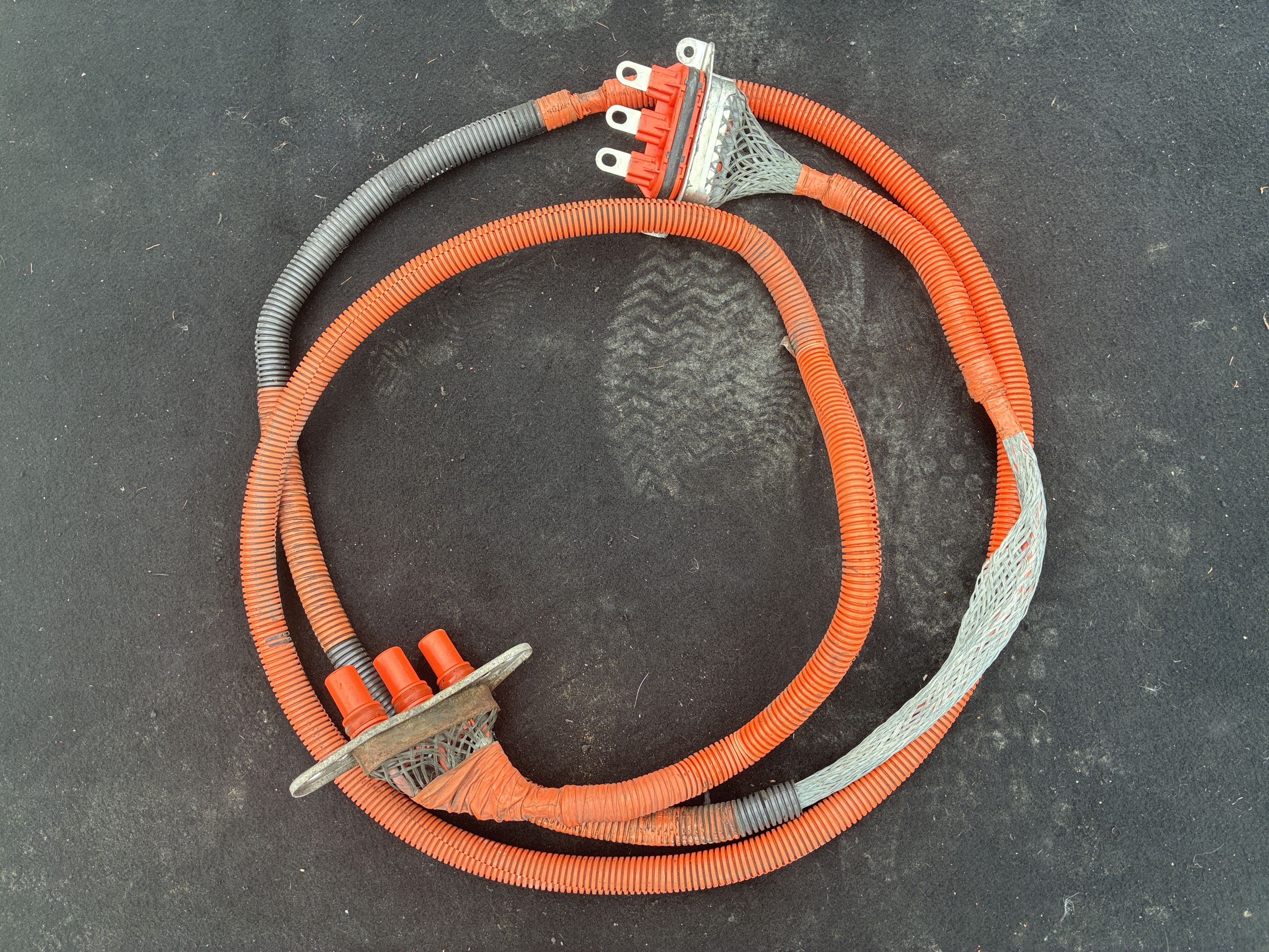

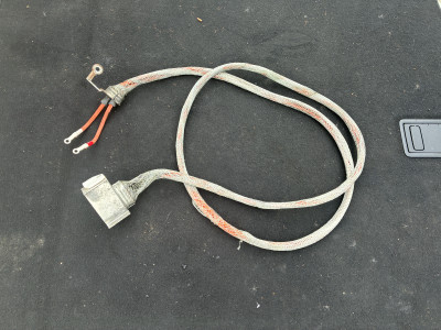

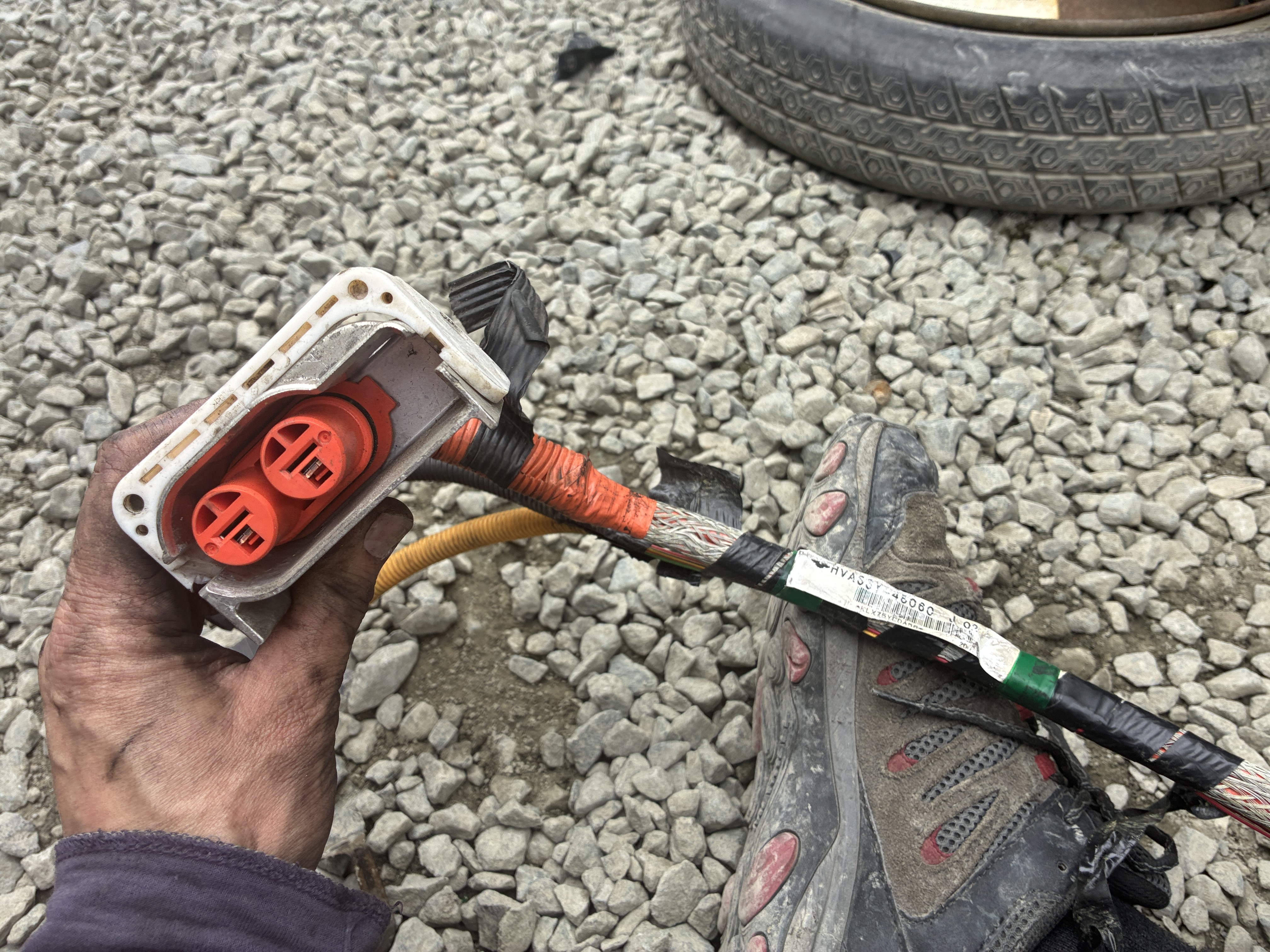

I was super happy to be able to extract the home run MGR rear motor cobles that run the length of the car from the trible inverter housing all the way to the rear diff without having to drop the motor
Gregski
Posts: 3156
Post by Gregski »

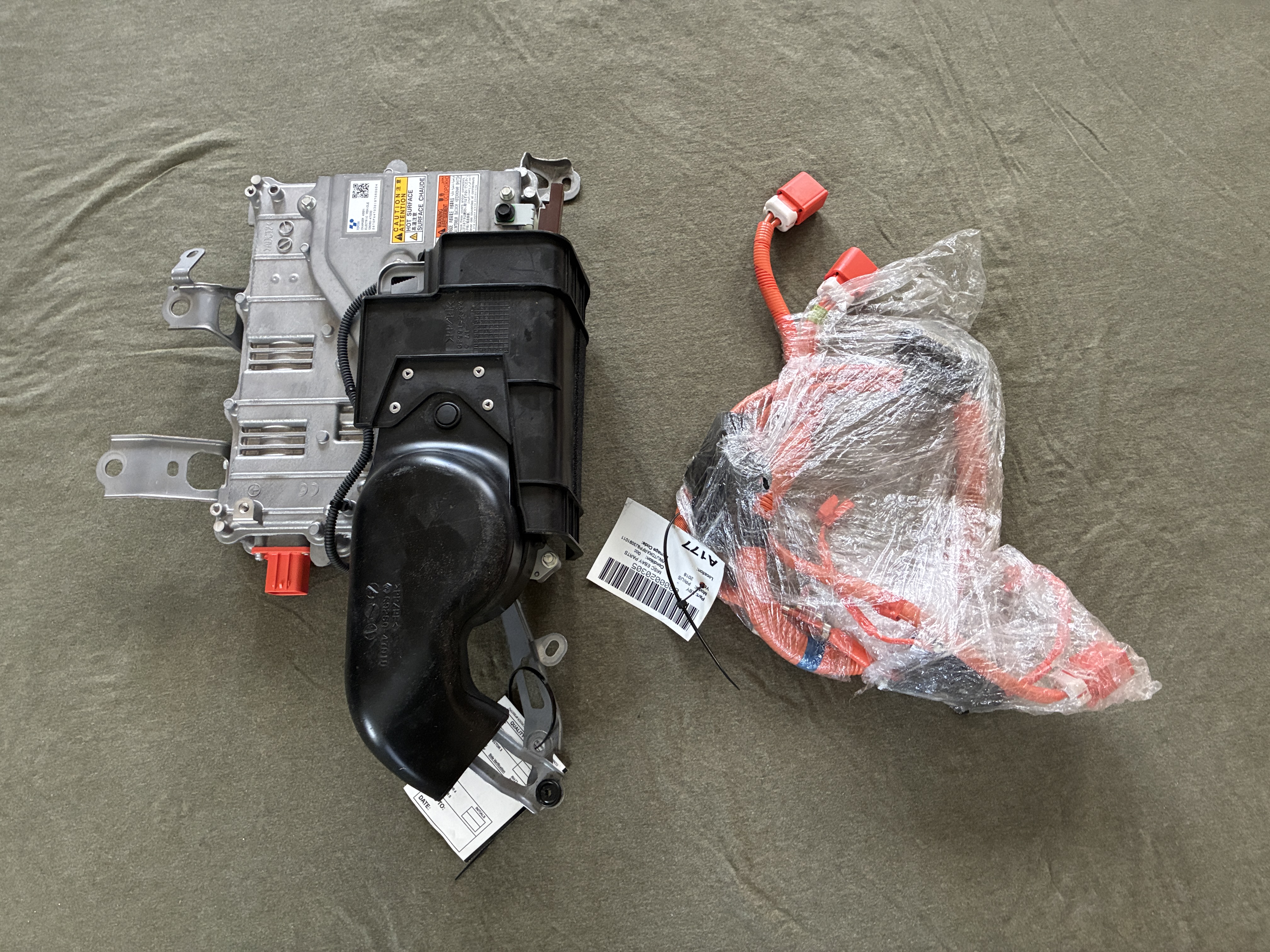

so this is what I ended up buying for a total of $67 dollars, the guy charged me like $20 bucks each for what he called miscellaneous Electrical cables, don't ask me about Pick N Pull math
so Motor Cable, Battery Pack cable, Motor Temp sensor harness, Resolver harness (green)

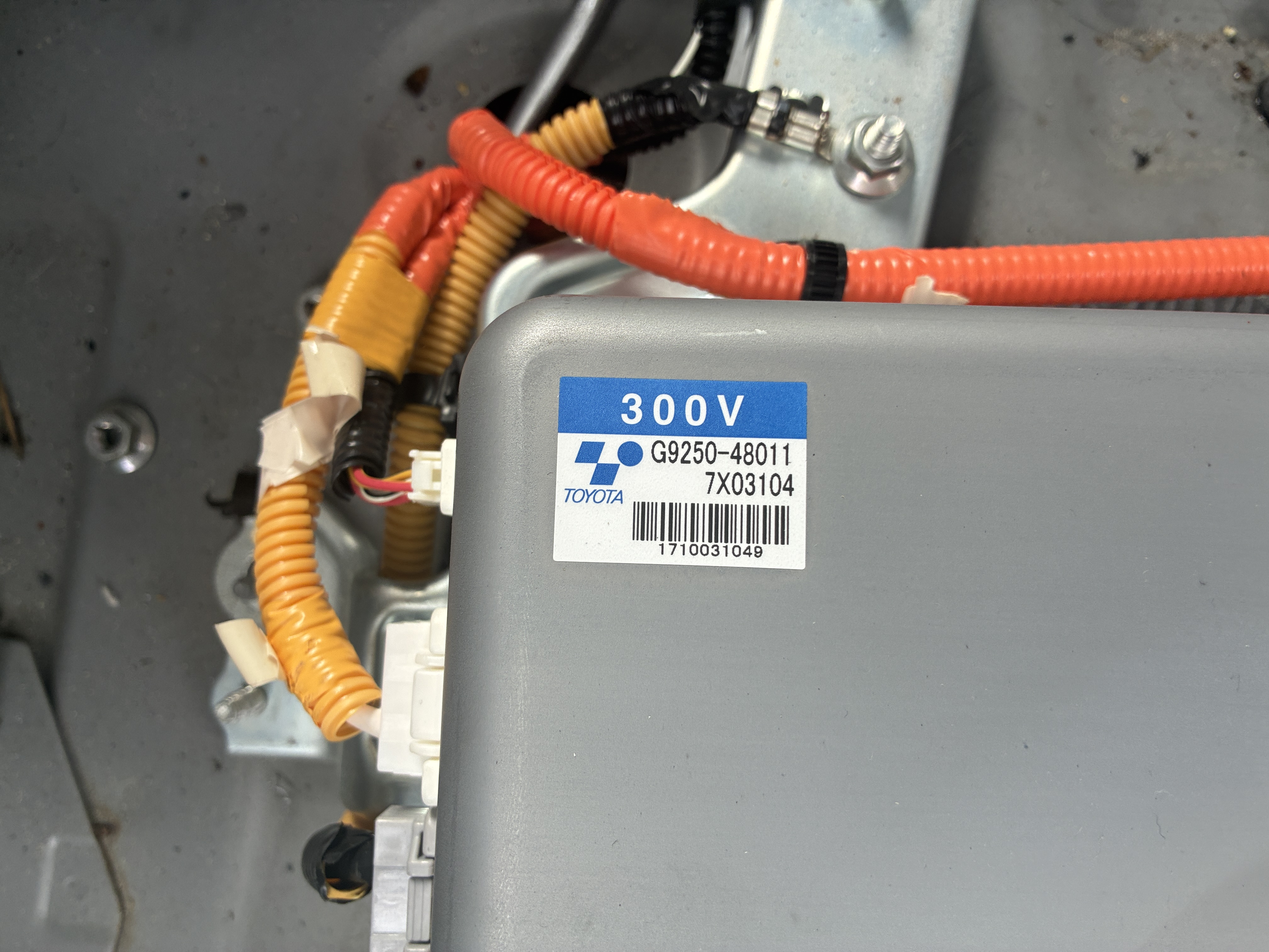

Hey Greg, do you know if there has been any work done on controlling that DCDC converter? The leas coolant pipes the better is my thinking…
Gregski
Posts: 3156
Post by Gregski »
Scrappyjoe wrote: Mon Feb 16, 2026 8:06 pm Hey Greg, do you know if there has been any work done on controlling that DCDC converter? The leas coolant pipes the better is my thinking…
honestly I don't know, but if that 300v spec holds true I would guess it would be highly unlikely as that is about 100 volts too low for what we run our 400v EV Conversions on
if you are not a fan of liquid cooled DC-DC converters or separate units for that matter, please consider any of the following options, most definitely not in order:
the air cooled Gen1 Chevy Volt DC-DC converter
The Two In One Mitsubishi Outlander onboard battery charger with a built in DC-DC converter
it is also common for the Inverters themselves to server as DC-DC converters, think Gen 2 Prius (and maybe Gen 3 Prius as well)
and finally keep your eyes out for this 2017-22 Prius Prime air cooled onboard battery charger / dc-dc converter soon to be reverse engineered
Scrappyjoe
Posts: 211
Joined: Fri Feb 25, 2022 3:16 pm
Has thanked: 55 times
Been thanked: 32 times
Post by Scrappyjoe »

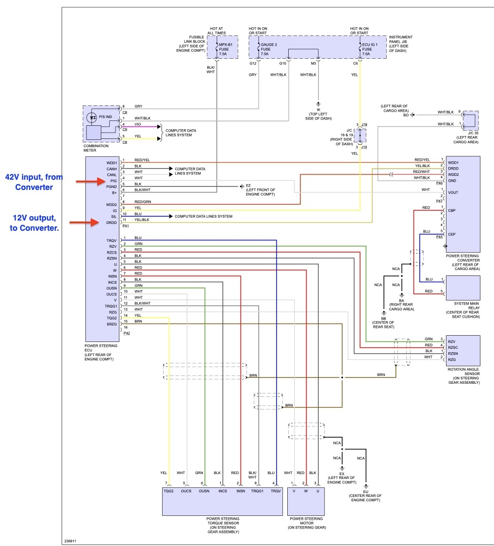

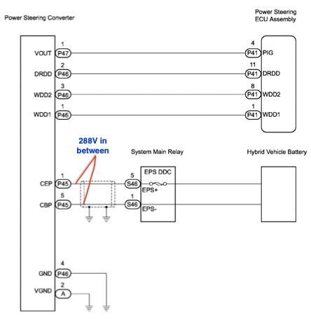

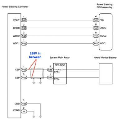

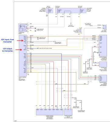

Quick note on this:
This unit is generally sold on eBay and the like as either a 'power steering control module' or 'power steering convertor assembly'. So I think it's a step-down converter that does not put out 12v.
Googling the RX400h electric power steering specifications, I found one document here https://techinfo.toyota.com/techInfoPor ... rx400h.pdf which states the EPS is rated at 42v.
Another Toyota doc says 46v https://techinfo.toyota.com/techInfoPor ... 0h_erg.pdf, but most references are for 42v
The 42v comes out of the yellow cables.
This link https://www.mri-auto-diagnostics.com/c1 ... us-rx400h/ details guidelines for debugging inoperative power steering on an RX400h. It includes two handy wiring diagrams.
The attachment image.jpeg is no longer available
These are the diagnostic instructions:
Testing:
- Check for 42 volts on the White wire at the Power Steering ECU connector (P47 – 1).
- If there is voltage, the converter is good. Suspect Power Steering ECU.
- If there is no voltage, disconnect Power Steering ECU connector, start the car, and apply 12V to Yellow/Black wire (P41 – 11). This is 12 volts coming from the Power Steering ECU to tell the Power Steering Converter to output the 42 volts. 42V should now appear at the White wire (P47 – 1).
- If there is no voltage, verify that between the Red wire and the Blue wire at the Power Steering Converter there is at least 288V when the ready light is on. Check fuse if there is no voltage. Fuse is replaced together with the Main Relay.
- If there is voltage, check Power Steering ECU power and grounds. If OK, replace Power Steering ECU.
- After replacing old PSU Module with the new one, it will need to be calibrated (Torque Sensor), otherwise, it won’t work.
This suggests to me that if you (1) ground the convertor (2) apply HV to the HV input cables and (3) apply 12v to the yellow/black wire, you should see 42V coming out the other end.
No idea on rated current, can't find that documented anywhere. Can't find a fuse either. Apparently it's fused on the inside of the pack.

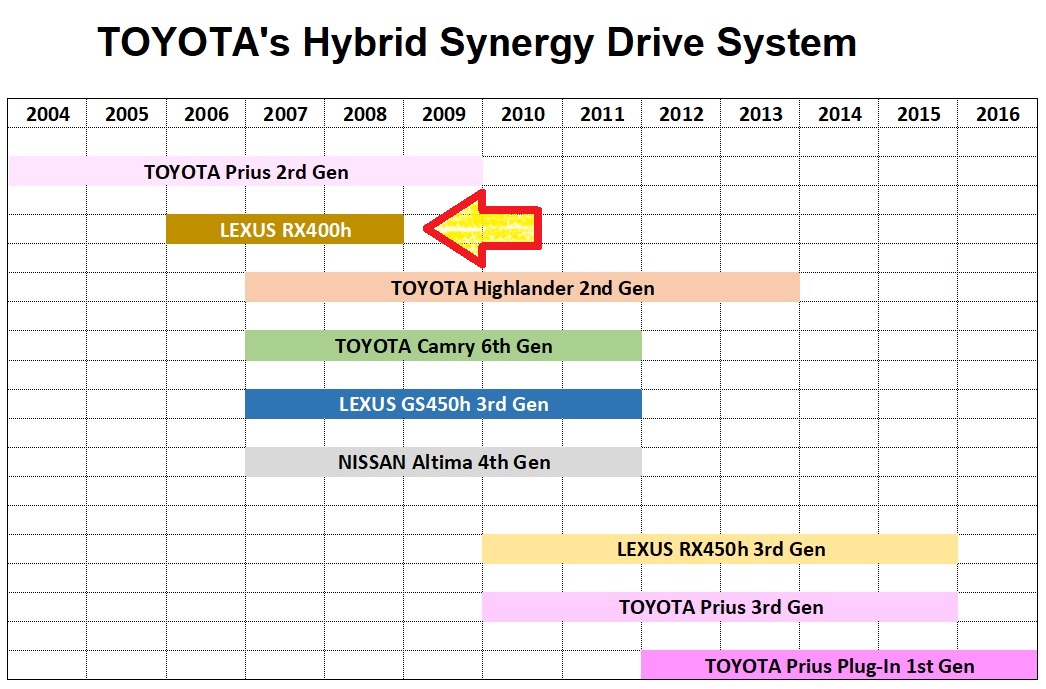

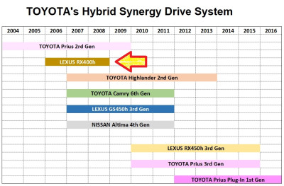

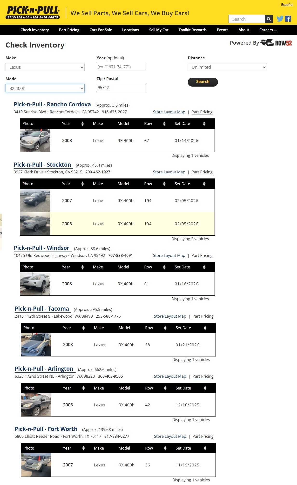

just wanted to share where the short lived Lexus RX400h falls on the TOYOTA's Hybrid Synergy Drive System - THSDS
for a three year run (2006, 2007, and 2008), Pick N Pulls sure are littered with them, hmmmm ? makes you wonder why
