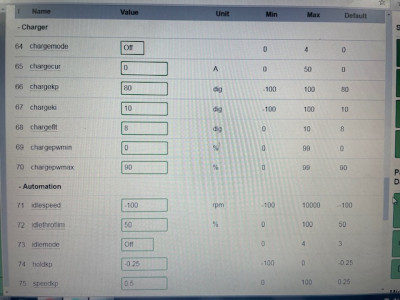

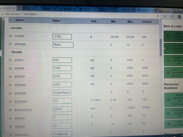

hi again i have made progress with my small rear drive fault ive got the new board installed managed to get the over current fault fixed i now have the motor in run mode fans all running but still no drive it knows what gear throttle seems to function ok but the only thing i have in spot values is "din-ocur"error can anyone tell me what that is and could it be why the car has no drive ( the last fault was throttle but ive adjusted the paramiters now)
many thanks
many thanks

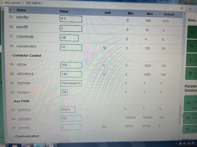

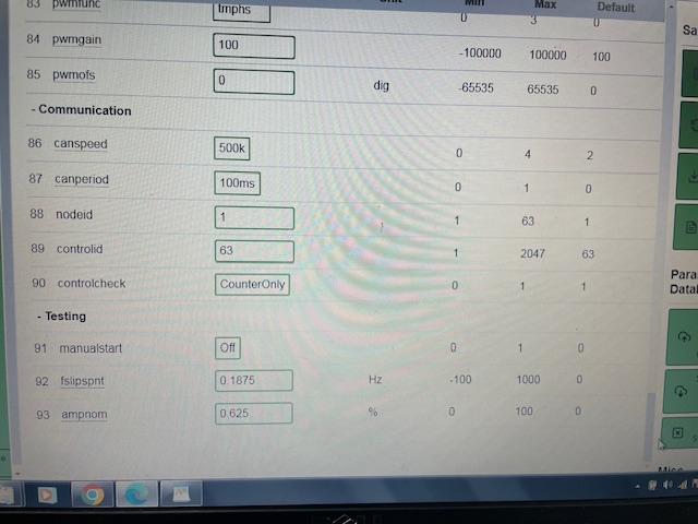

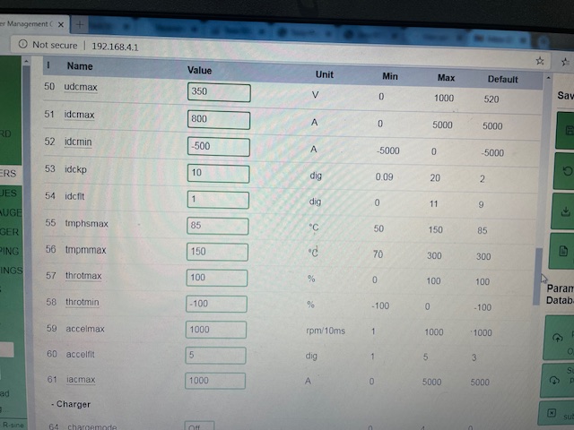

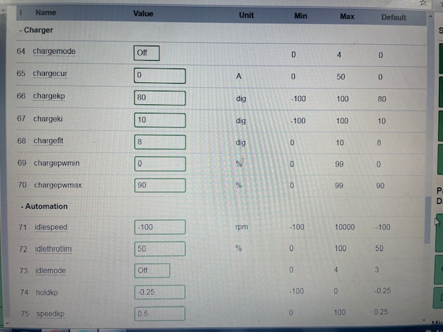

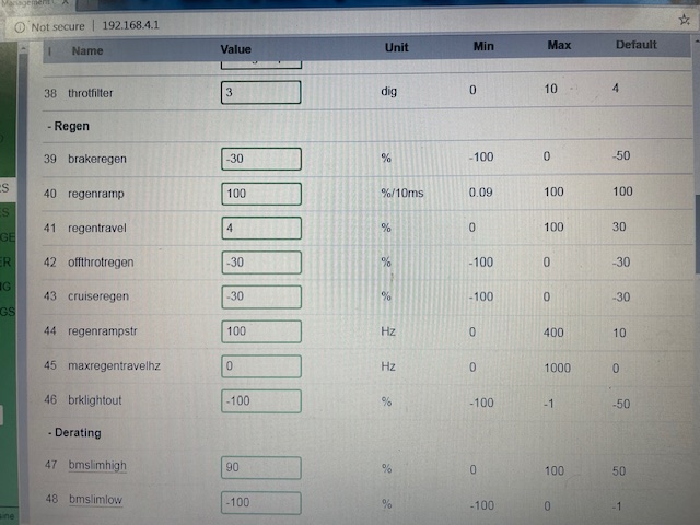

Re: small rear drive fault
these are the current paramiters the motor goes into run mode shows gear selected fans run throttle shows movement but no drive !

1. din_ocur means "digital input over current" which translates to
a) problem with current sensors
b) gate drive flags an error
c) gate drive has no power
d) interlock from DC connector no connected
Please search for "SDU overcurrent" for more suggestions
2. Please post parameters as json file. Link for that on the web interface itself.
ok so ive had another go
ive changed the peramiter on ocurlim to positive thats got rid if my din-occur error
ive checked the trouble shooting page and bridged conn2 on the v9 board as instructed
i now get no codes until i press the throttle the wheels turn very slightly then i get the overcurrent code
strangly forward is now reverse but shows forward in spot values
i will download peramiter file next
