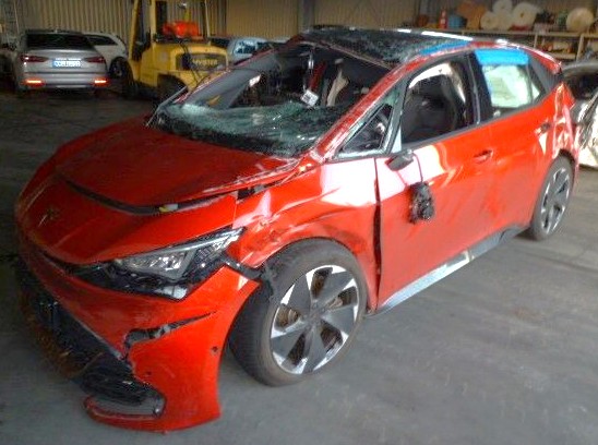

In 2024, I found and purchased a complete Cupra Born (identical to the ID.3) with approx. 21,000 km from 2022 with rollover damage for very little money.
I thought I could use most of the electrical parts. But... When i looked deeper in the project so i saw, it is not so easy to use electric-parts such as DC/DC converters and chargers from a Born/ID.3. I have since switched to Tesla for the DC/DC converter and onboard charger.
For the motor/inverter, I am currently analysing the structure and pin assignment of the internal plug connection. I will publish pictures and my findings in another thread. I don't think it should be a big problem to get the motor running.
This is the donor vehicle

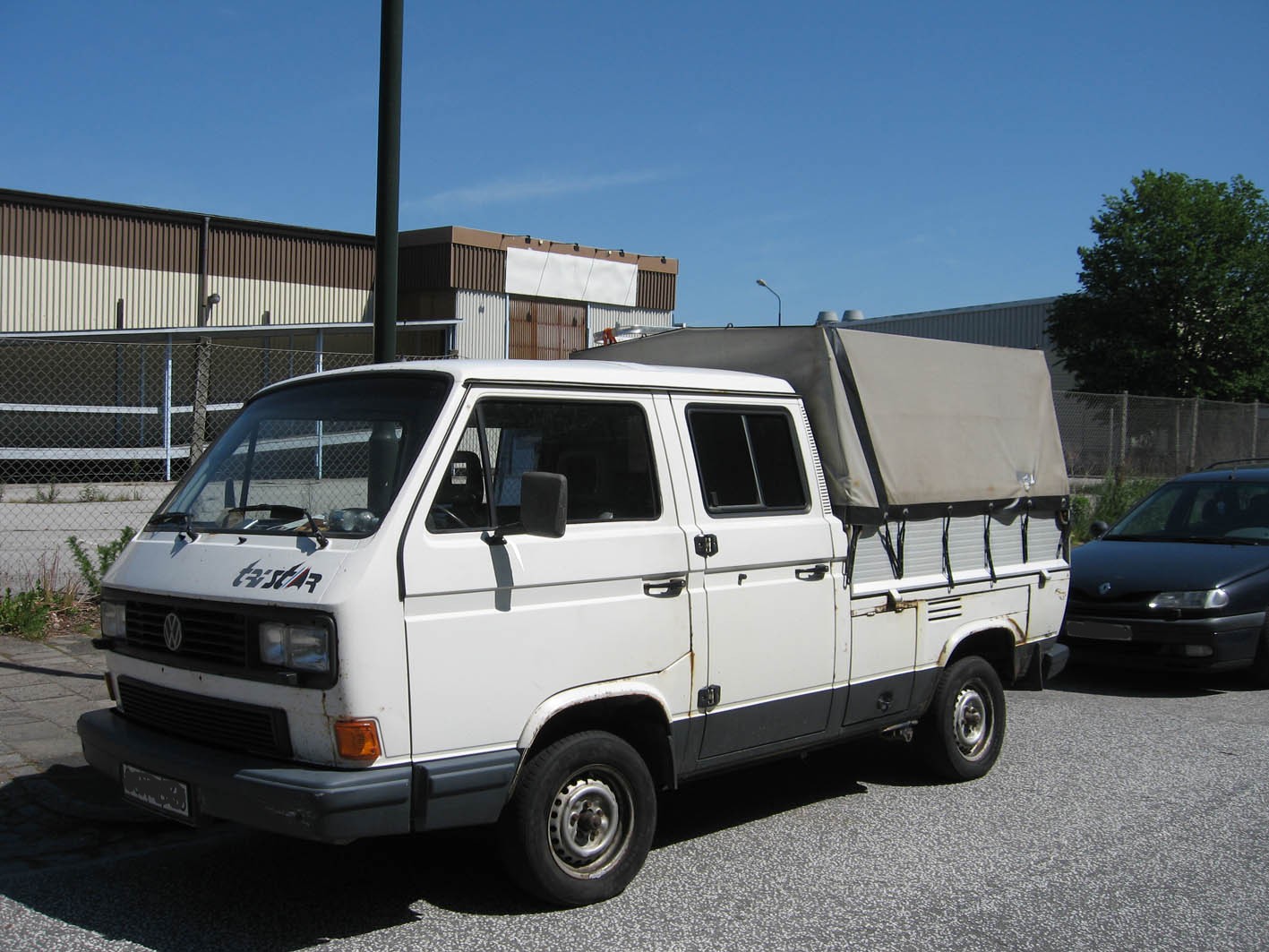

and this is the T3 Doka in which the drive is to be installed.

Ok, here are the pictures
ianlighting wrote: Thu Jan 15, 2026 8:37 am There’s a few Doka projects here aswell, have a search. Bratitude’s is quite recent.
I have seen the posts. Most of them use Nissan leaf or Tesla drive units. I will try to use a MEB drive unit from a Cupra Born /ID.3.
