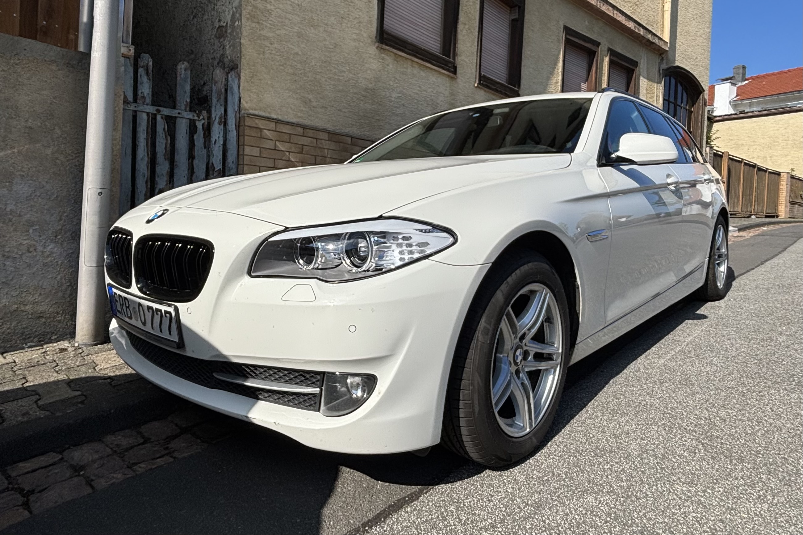

I start the conversion of my BMW 525d now officialy
My prioritys are:
- range over power (daily use)
- seamless integration (using existing gauges and handles)
- AC and DC CCS2
- V2L
- using OEM (roadlegal easy)
Driveprofile:
- city
- countryroads
- rarely on highways (max. 150 kph is OK for me)
My first ideas:
- placing the drivetrain in the rear subframe as replacement of the differential gearbox and custom made driveshafts, to get as much space that I can get (enginecompartment, gearboxcompartment, tunnle, and fuletankcompartment) for batteries charge- and V2L-Equipment.
My first steps:
- More research
- get my backyard-barn ready as a usable workshop
- get as much can-information as possible, while the n47 still fires up (rod-knocking)
- Remove the engine, gearbox, central driveshaft, differential gearbox, exaustsystem, fueltank and determin the weight of every component.
To be continued….

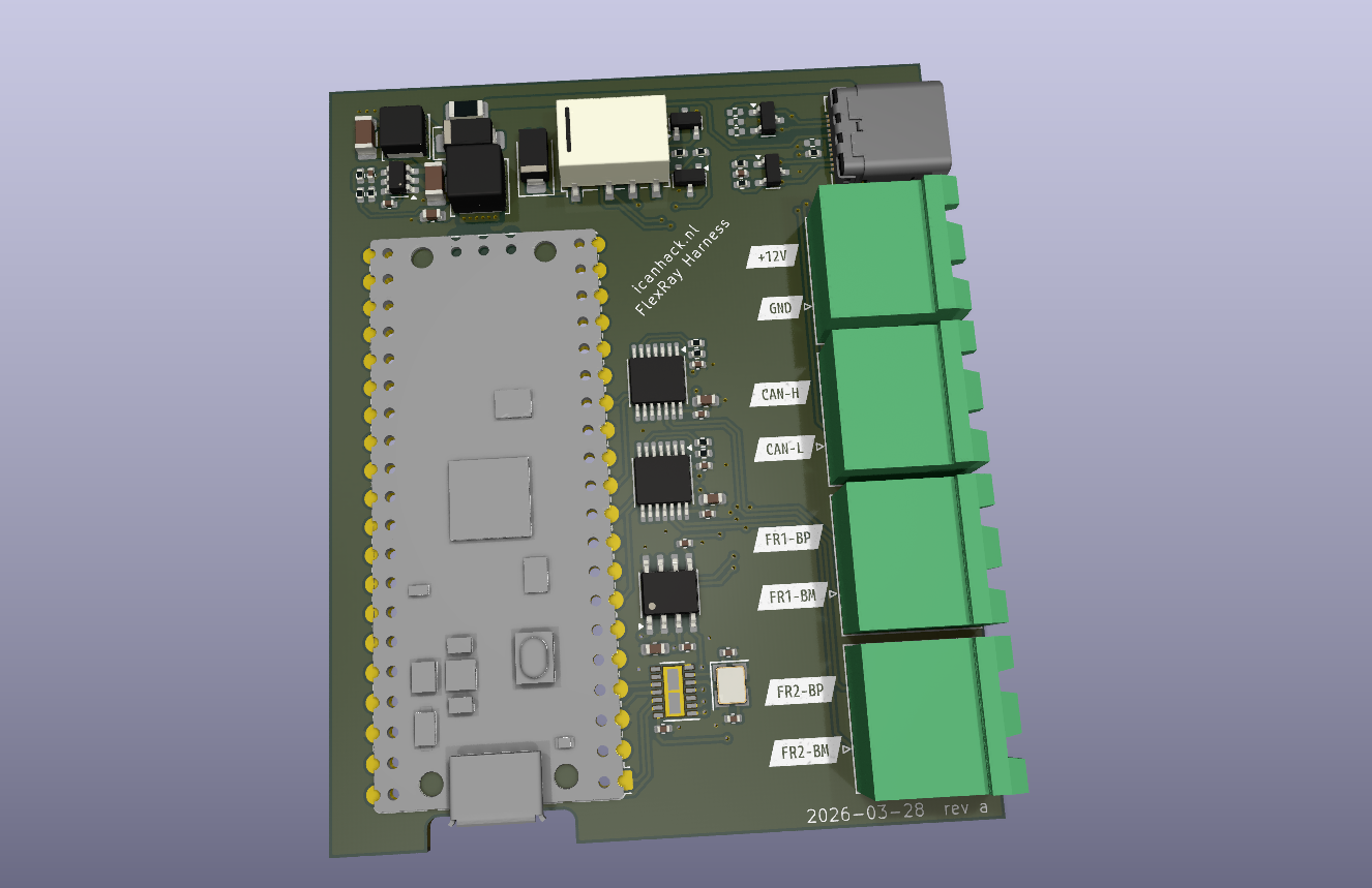

Re: BMW 525d F11 conversion
OK my Research goes on. Flexray will be a Problem to be solved. Biggest Issue is, that there are 4 ECUs that establish the initialisation of the Flexray Bus and DDE is one of them. The Others are ZGW, DSC and ICM.
The ZGW as the Master of puppets Starts the process of initialising and it needs 2 of the other 3 ECUs. So it could be possible to do this without the DDE. But if there are any issues with one of them, the whole vehicle might be dead. Let the DDE stay in the Car will cause a lot of Errorcodes to Handle with.
Based on the information i got, that it is possible to deaktivate the FlexRay-path to the DDE by coding in the ZGW via e-Sys/ISTA/tool32, there are two „easyer“ways to solve this and a hard and expensive Way.
First the easiest:
Remove the DDE, teminate the FlexRay-Pins in the Plug with 45 Ohms. Then deactivate the DDE and the FR-Port to the DDE in the ZGW. The Parameters Engine Torque and RPM can be transmitted from the EV-VCU via Pt-CAN witch will distribute it to the FR for the other ECUs on that Bus Like DSC and ICM.
Pro: easy and cheap
Con: unsave, one fault ECU may lead to a total shut down of the car.
Second:
Very similar to the First. Only the DDE has to be deactivated in the ZGW. A blank DDE (flashed without Engine) works as a FR-hub that can establish the initialisation so that we have the three ECUs for this task (one redundant). The rest is the same.
Pro: relatively easy, Safe
Con: 500,-€ extra for the tuned DDE
Third and hardest:
Emulating a fully functional Flexray node with a Infineon TC277 / TC297 TriCore Evaluation Board (used in any BMW-ECUs) or a FPGA solution to bring the needed parameter like engintorque from the EV-VCU directly to the FR-Bus. Like a Flexray interface for the Zombiverter.
Pro: I‘ll be the Star of the Community
Con: I‘m Not a Software engineer
, i‘m not a PCB-engineer
, i‘m not a Pro in FlexRay or FPGA
and a a workload of 500+ h of programming for a Pro means impossible for me
OK Folks thats it for the Moment and the Journey will Go on and thankyou for the comments….

Interesting project. imho it depends what you want out of the project. If you want to get running and driving option 2 is the way. If you want to have fun and learn it's option 3. This might be some help : https://github.com/dynm/pico-flexray

I don't want to pollute your build thread but I've been down quite a rabithole on flexray and it seems the folks working on various openpilot and others have gone a long way to making flexray more accessible. I'm gonna try and source an F10/F11 dme and see if I can listen to it on the bench.
I ordert the TJA1082 Flexray-Transceivers with DIP-Adapters and a Raspi Pico 2 is still in any Box. First try is with a breadboard. If that works, i‘ll solder it on a pervboard. Thank you all (especially to Damian) for your suggestions.
