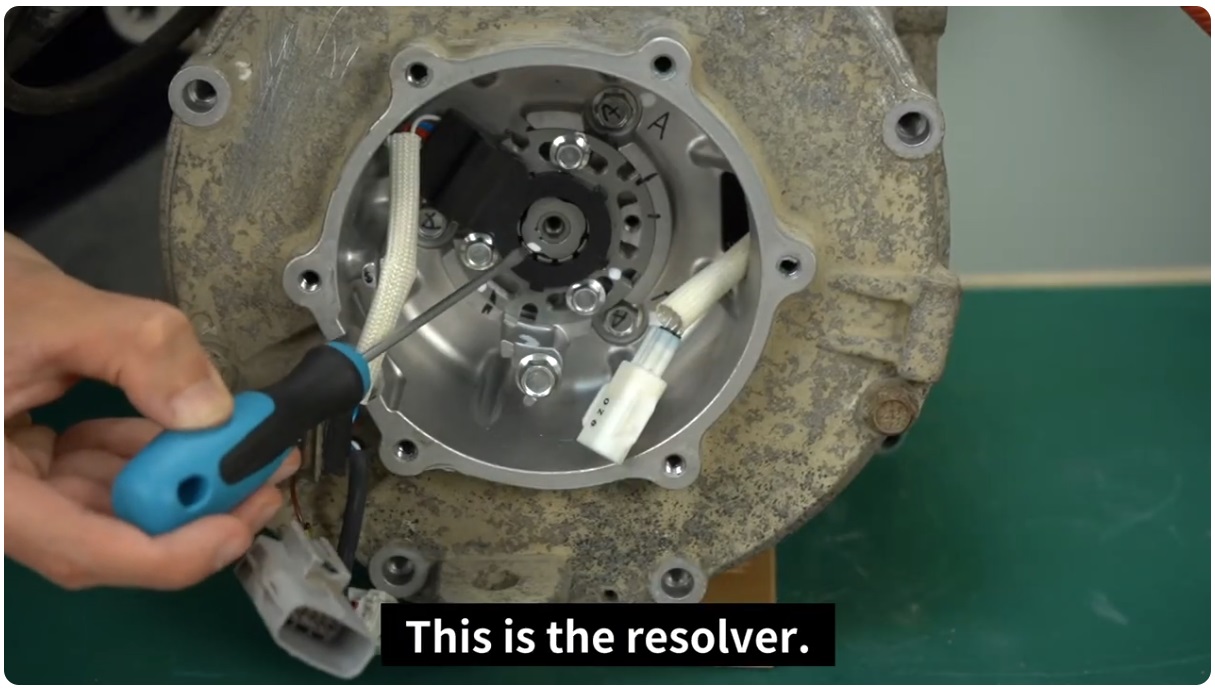

MITSUBISHI i-MiEV 47kW Electric Car Motor & DIY Inverter
Post by Gregski »

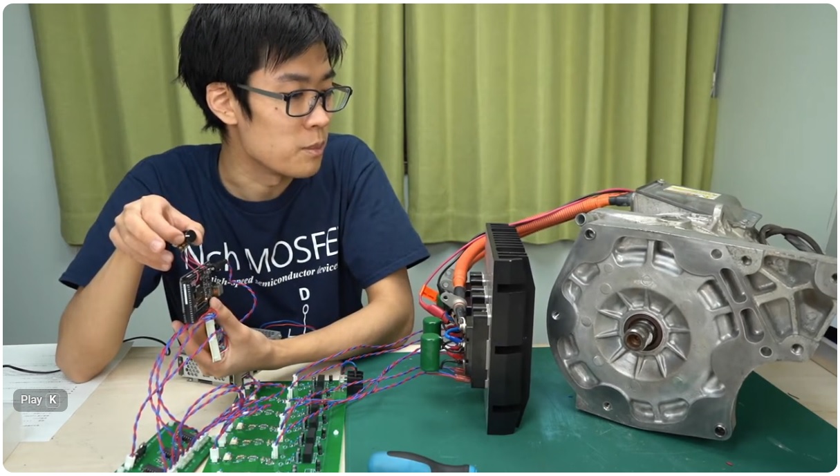

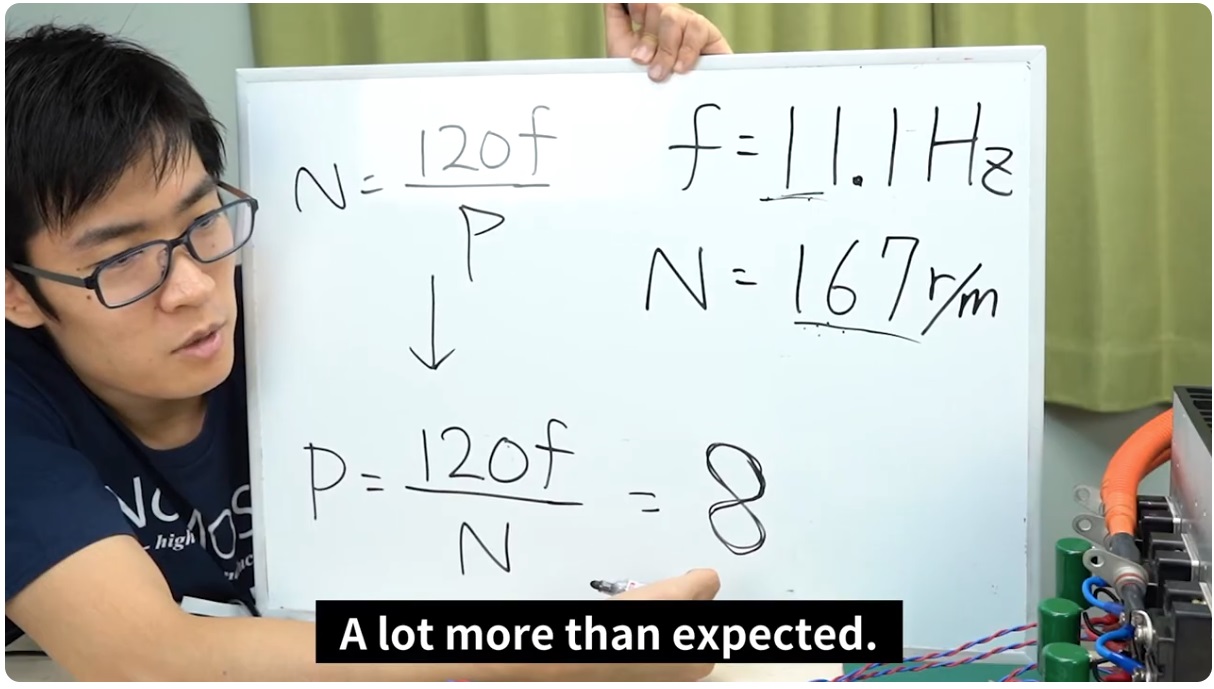

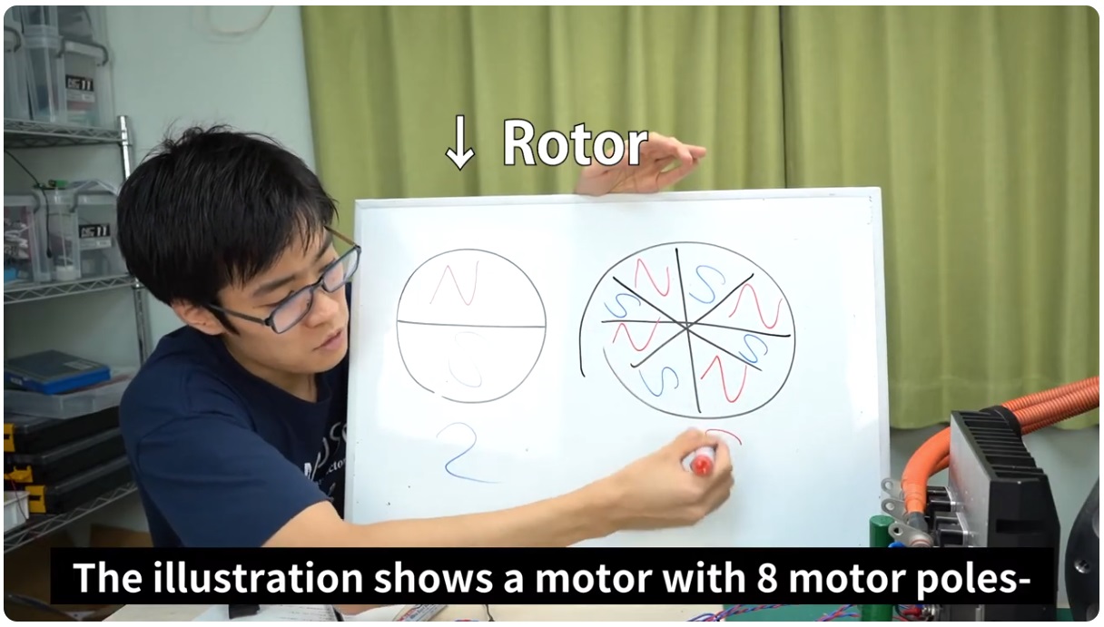

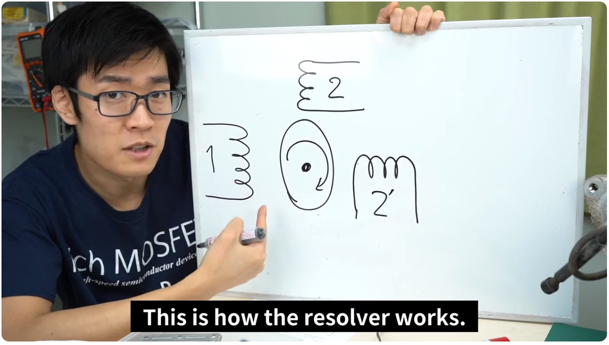

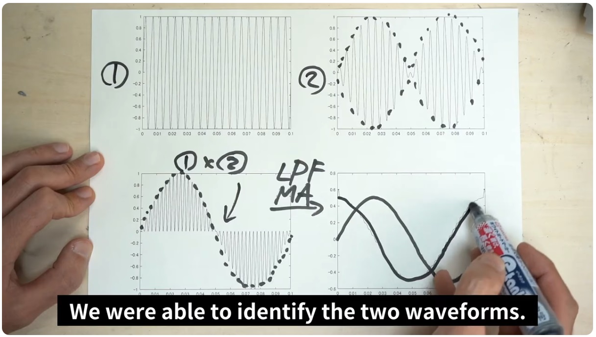

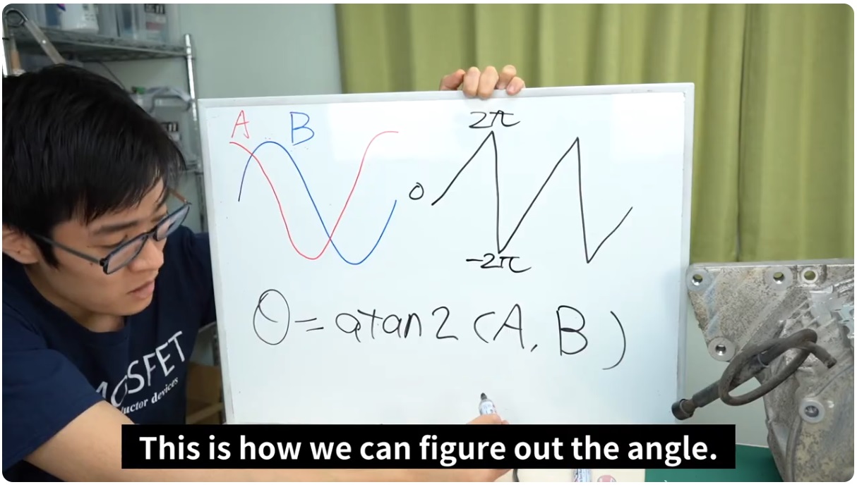

47kW Electric Car Motor from MITSUBISHI i-MiEV
