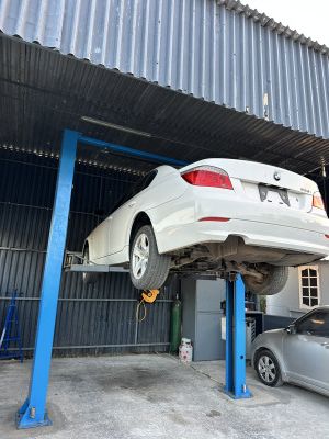

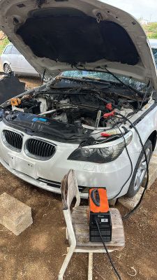

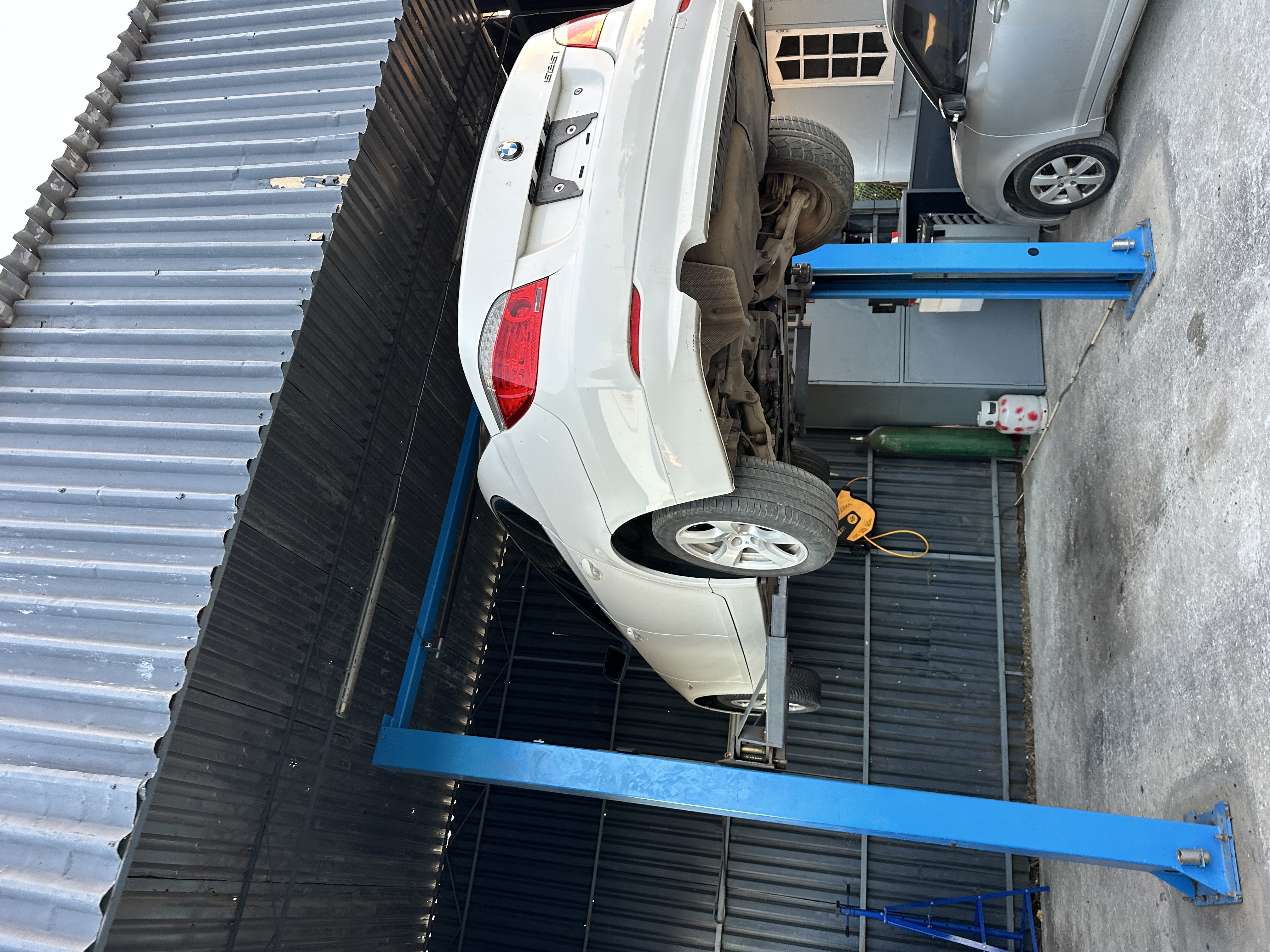

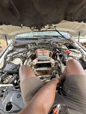

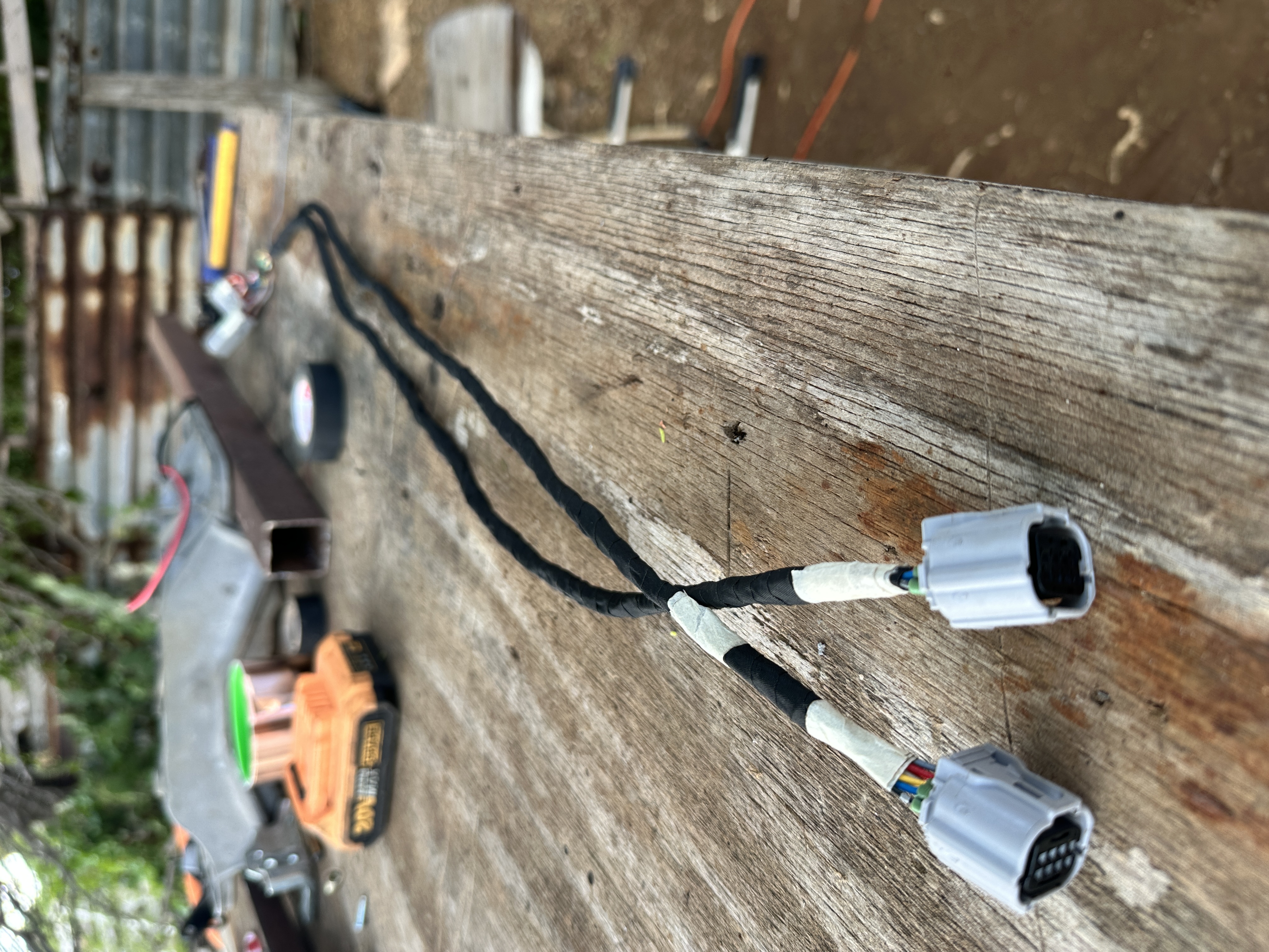

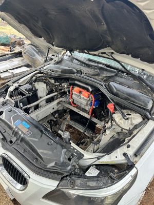

Happy new year!!!!
Had to go on small vacation with my family for christmass 24-27dec
couldnt wait to get back.

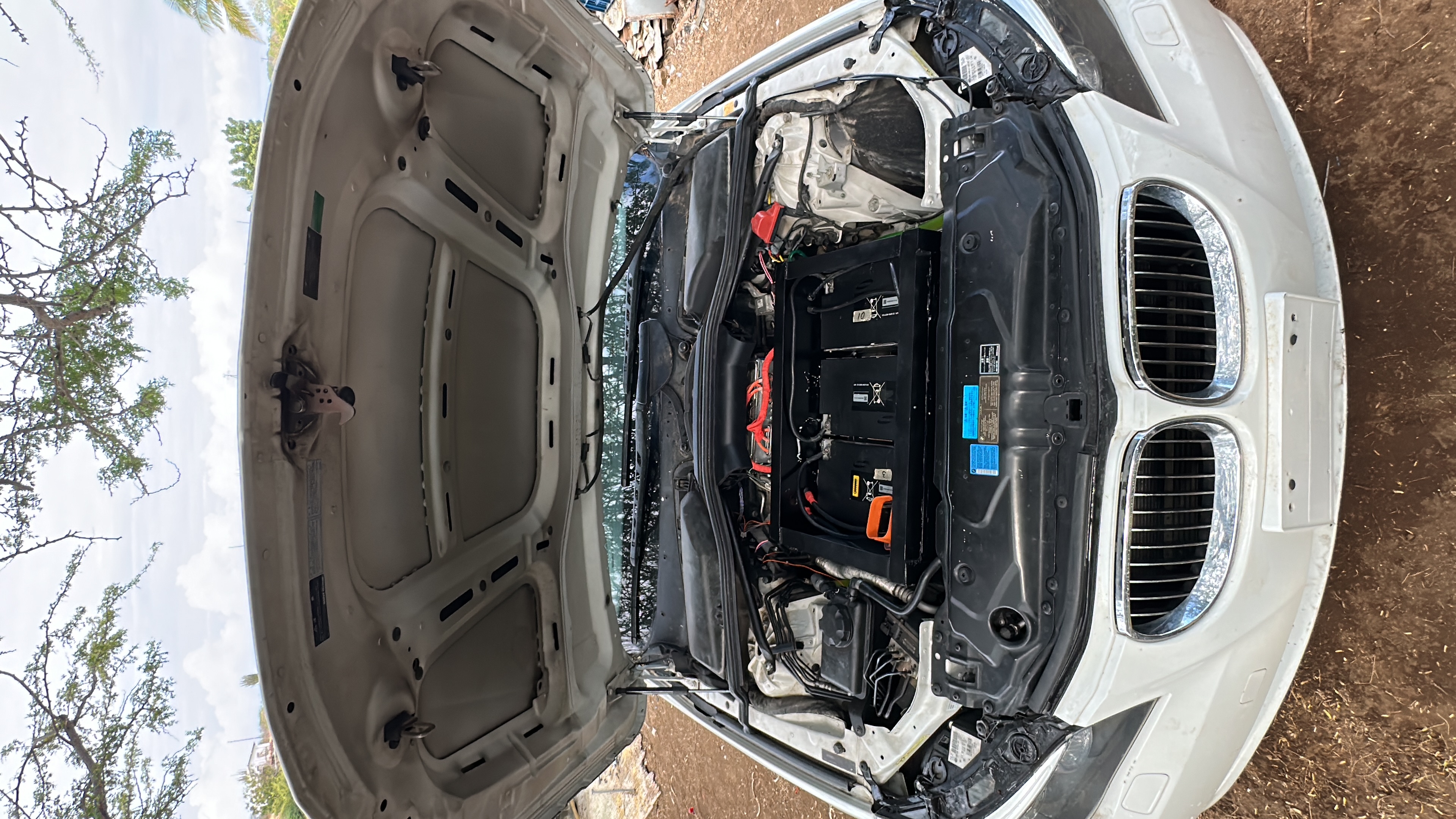

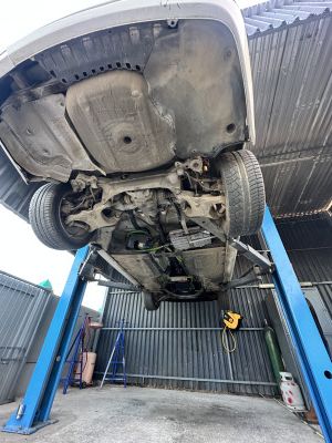

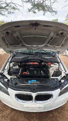

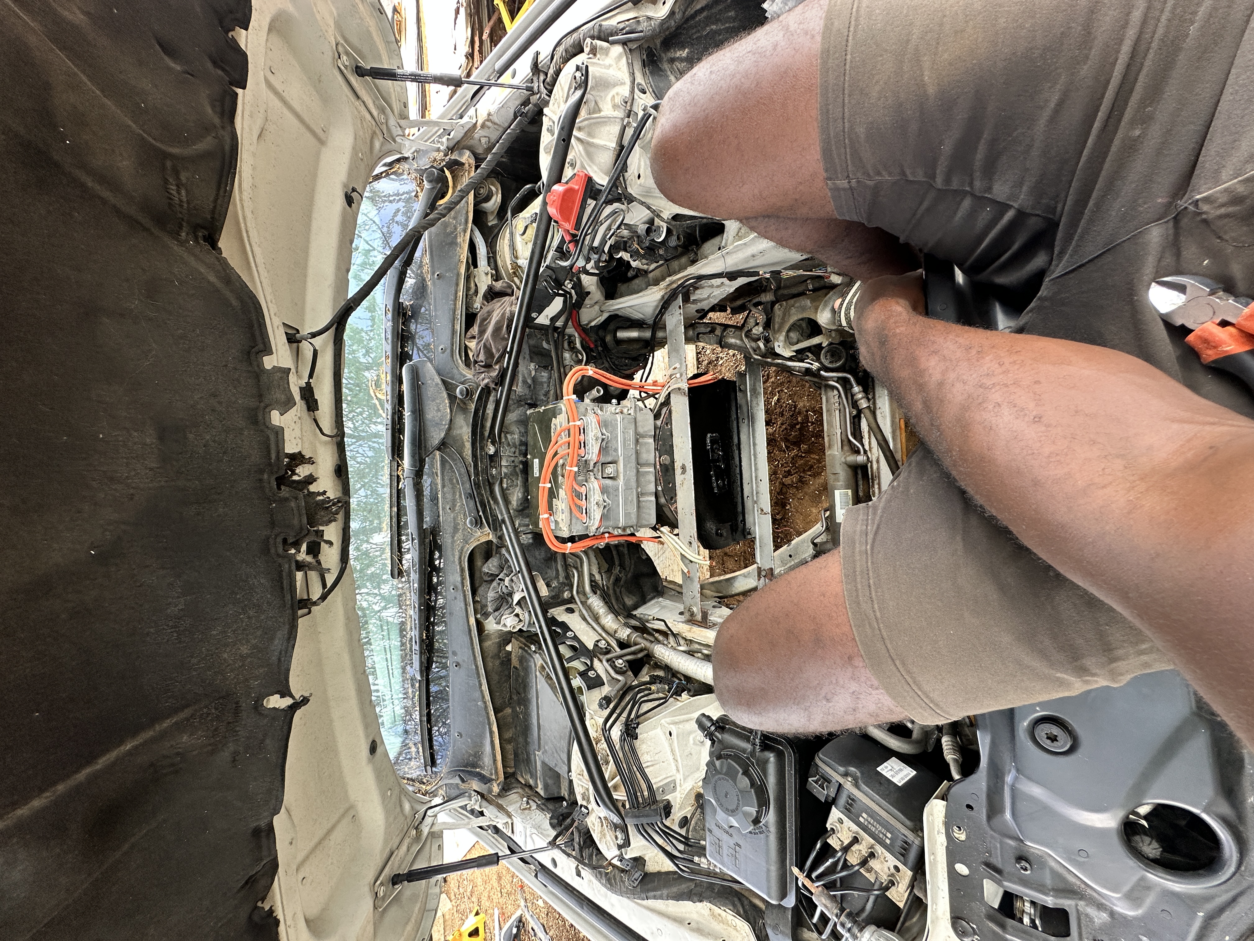

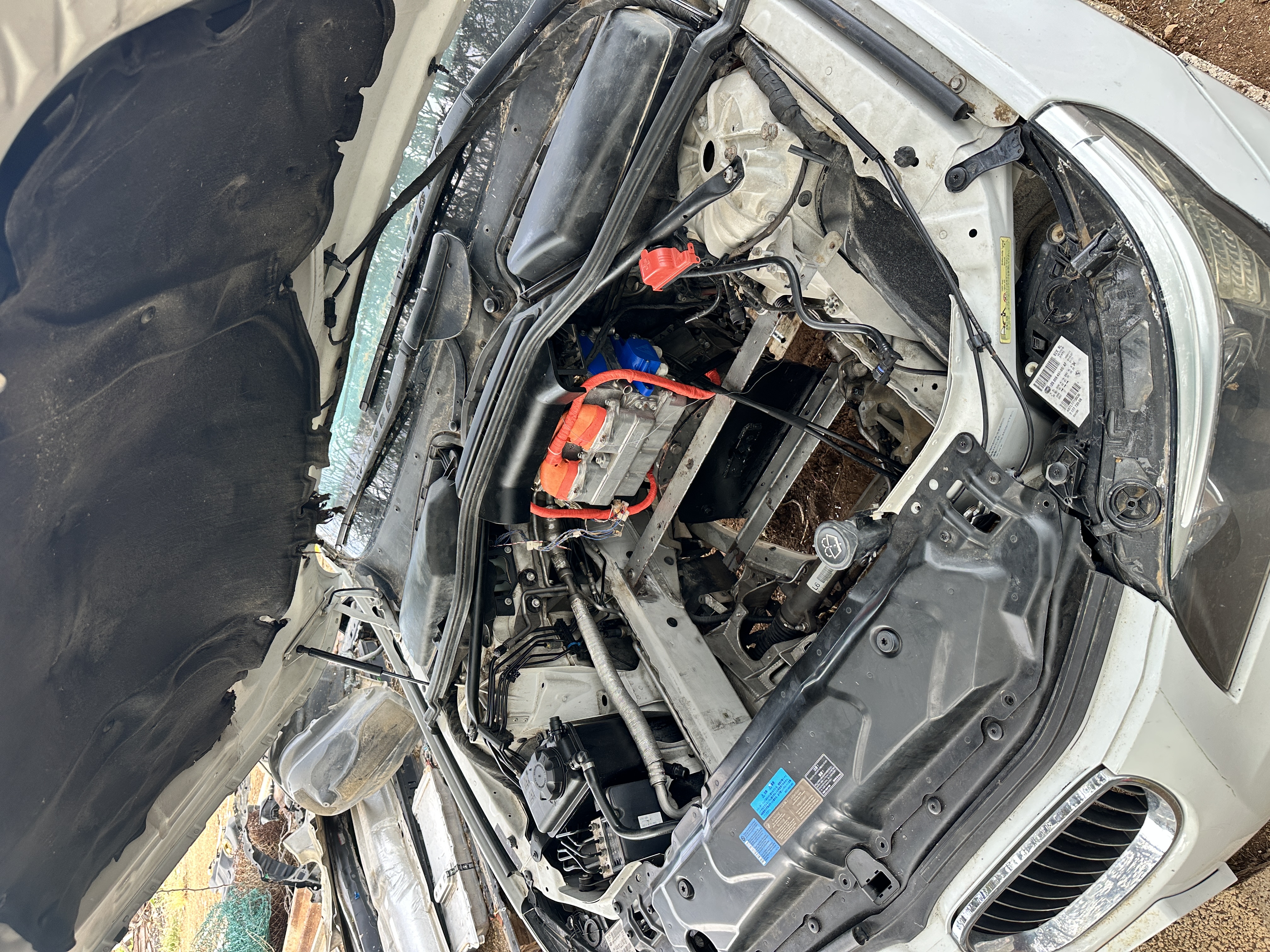

Got back the 27th around 6pm....by night the GS450h was out of the Audi.
since then ive been working non stop and today jan 1st, inverter and gs450h are installed in the E60.
And of course i forgot to film, so here are some pictures.
later today I am going to start with wiring the VCU to the car.
then install the Gen2 DCDC and charger where the fuel tank was.
PetersonOctavius

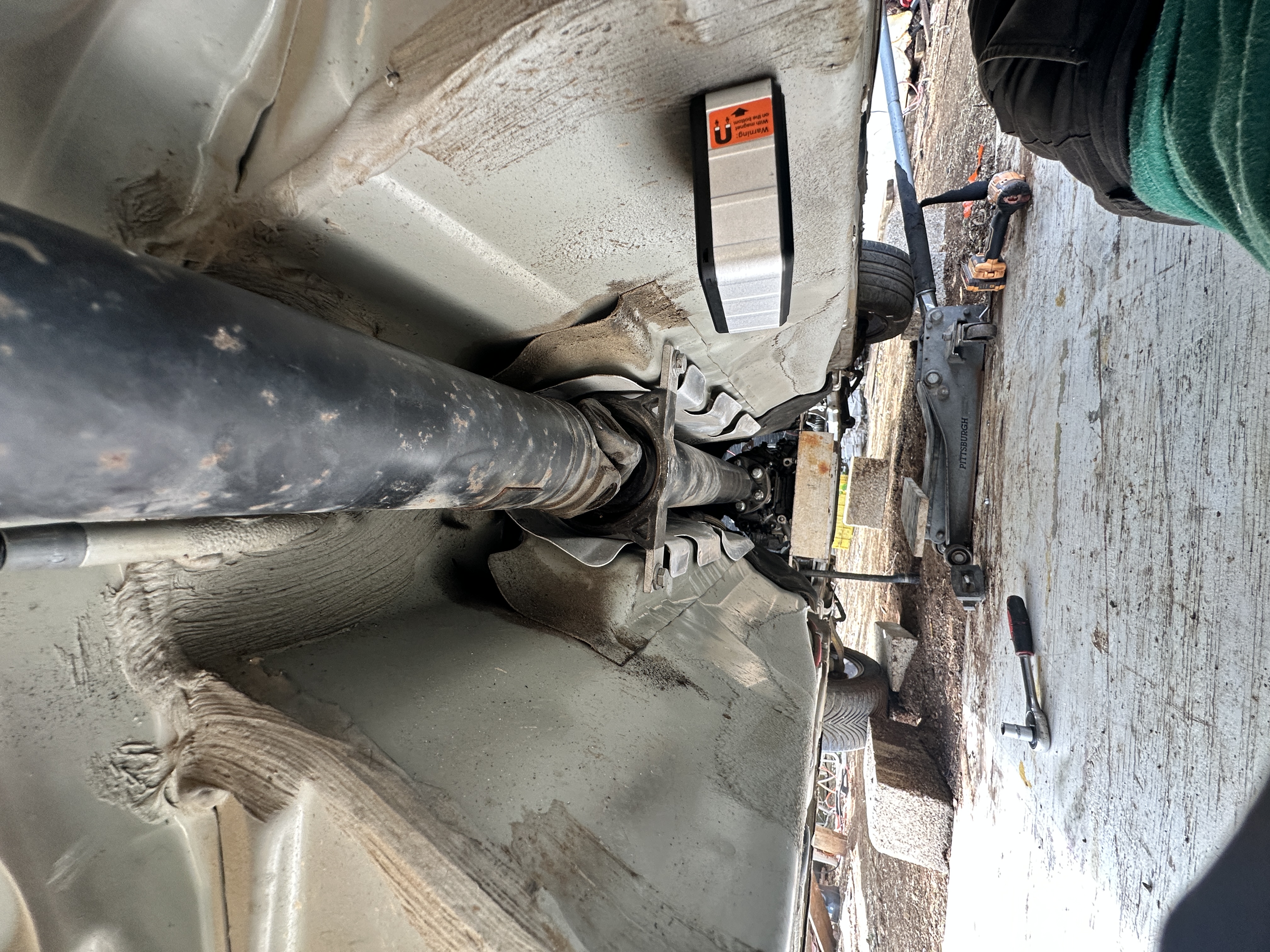

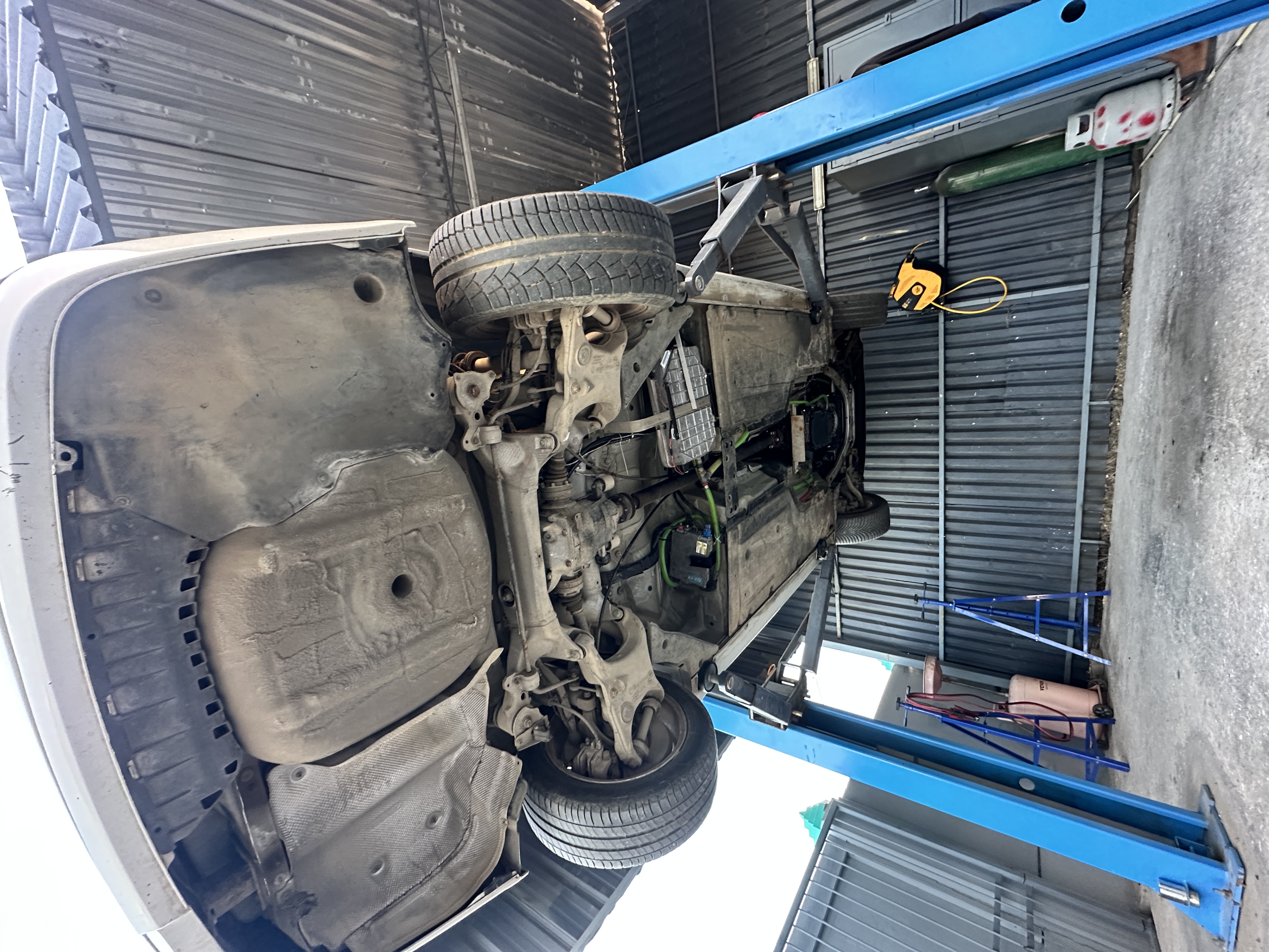

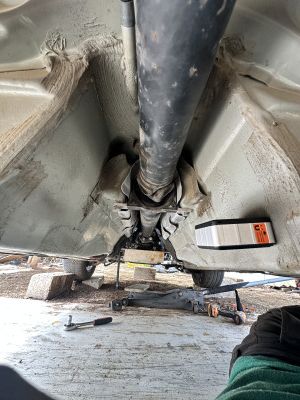

And today, i drove the car from my dad's farm, where i was building it, to my house.
then from the house to a garage close by to check what the heck is that sound.
turn out i installed the GS450h to high, the guibo is slight bent. ill try to drop the rear of the GS lower tomorrow.

PetersonOctavius wrote: Thu Jan 01, 2026 9:40 pm Happy new year!!!!
I am so not That Guy, I'm not, I'm not, I'm not, but... this man has worked too hard (and FAST) to not have his work presented properly

and not having this glamour pic right side up, is grounds for having your EV Conversion Card revoked
PetersonOctavius
Posts: 151
Location: Willemstad, Curaçao
Has thanked: 98 times
Been thanked: 38 times
Re: BMW E60 2007 conversion
Post by PetersonOctavius »
HAHAHAHAHAHAHAHAH Thanks Gregg...
after working hard...i get home and just upload those pics ...as is where is

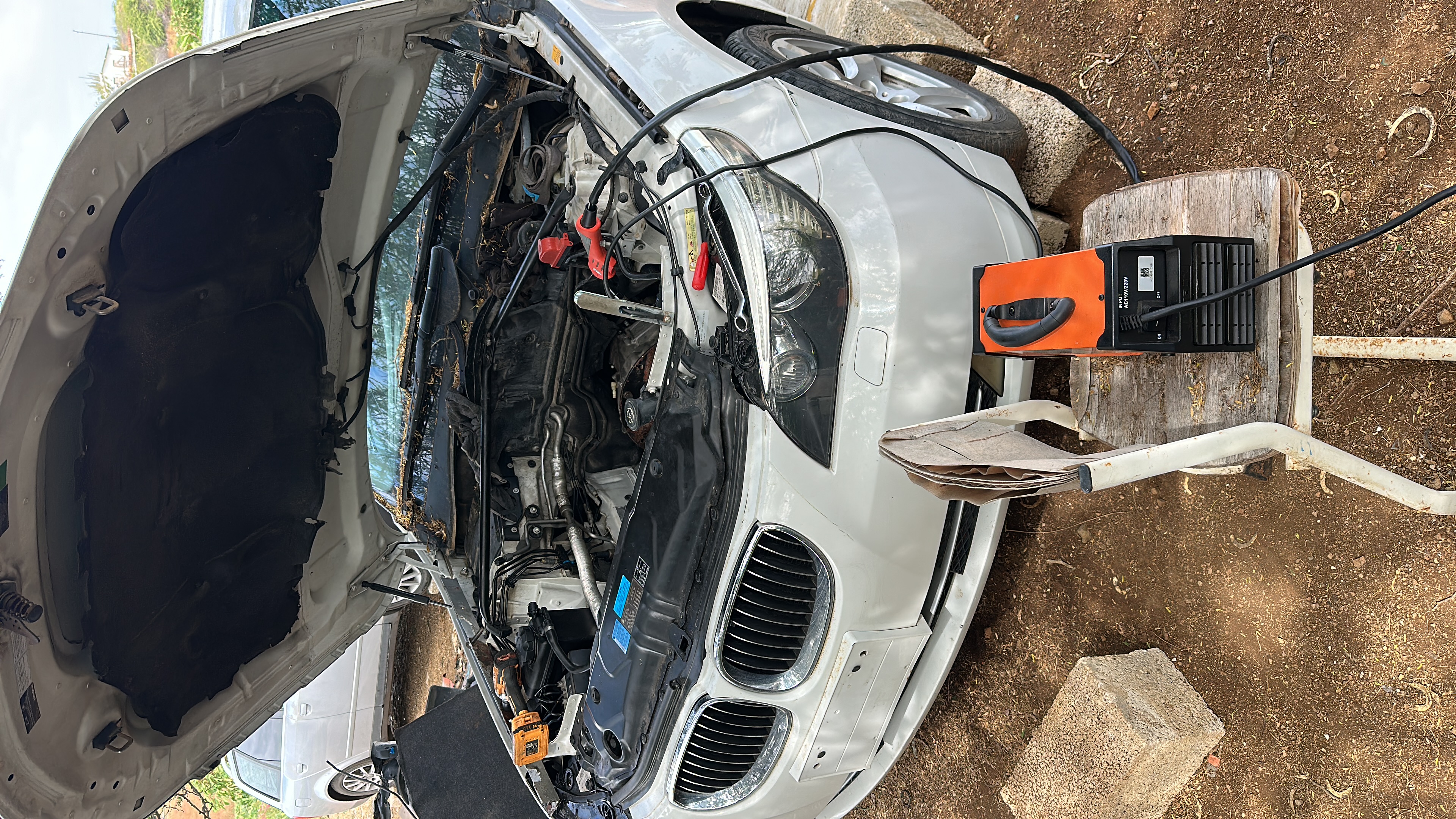

PetersonOctavius
Posts: 151

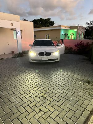

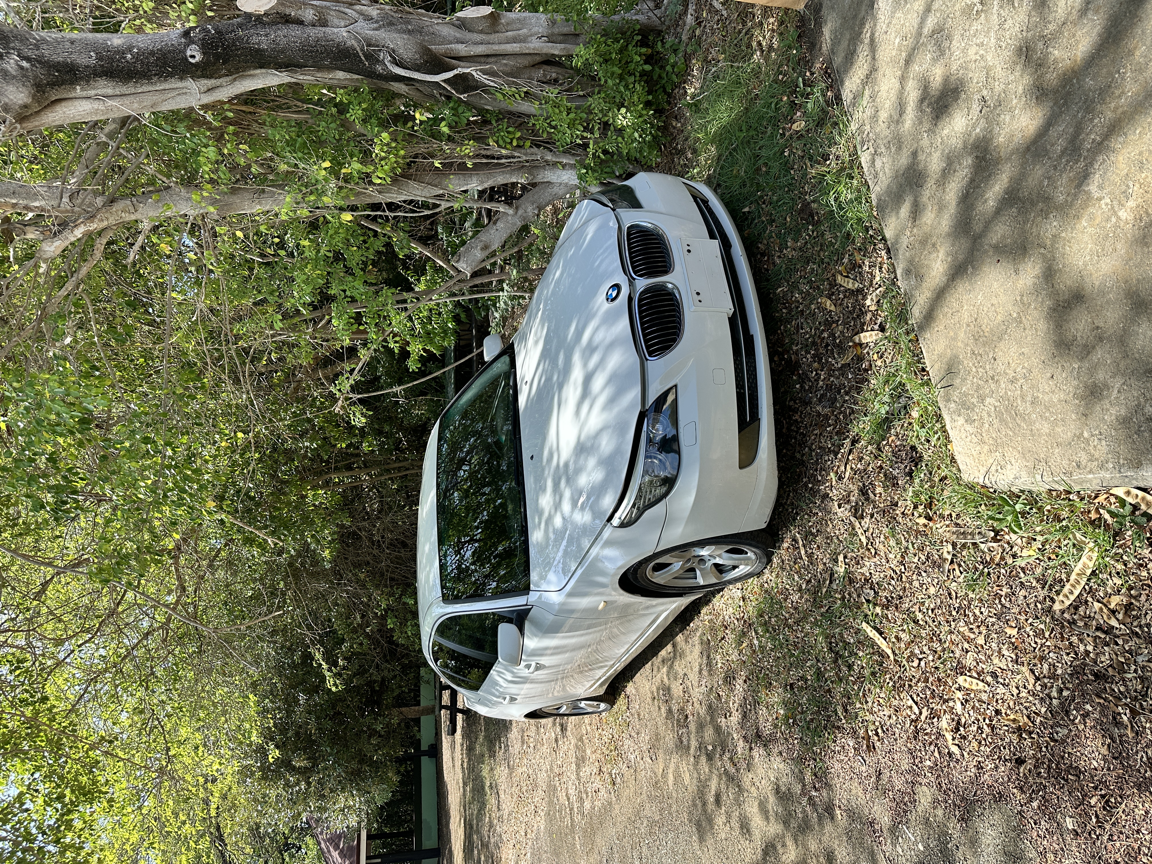

annnddd. today jan 20th, 2026......road legal
still need to install and plumb the AC system...but i can drive it to the shop.
im suprised...did it in less than a month...
idontknow why the pictures are sideways...sorry Gregg
Been thanked: 1918 times
Someone had the brilliant idea of putting orientation information into jpg. So now it's no longer just how the picture is "naturally" rotated but also how the producer thinks it is. Once that info is lost (apparently on thumbnail creation) the pic is sideways. You'd have to open and rotate every single picture on your computer to prevent.
Or I find a way to augment thumbnail creation. Observe how it's correctly rotated when clicking it.
That said 1 month is monumental

PetersonOctavius wrote: Wed Jan 21, 2026 1:18 am annnddd. today jan 20th, 2026......road legal
