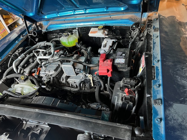

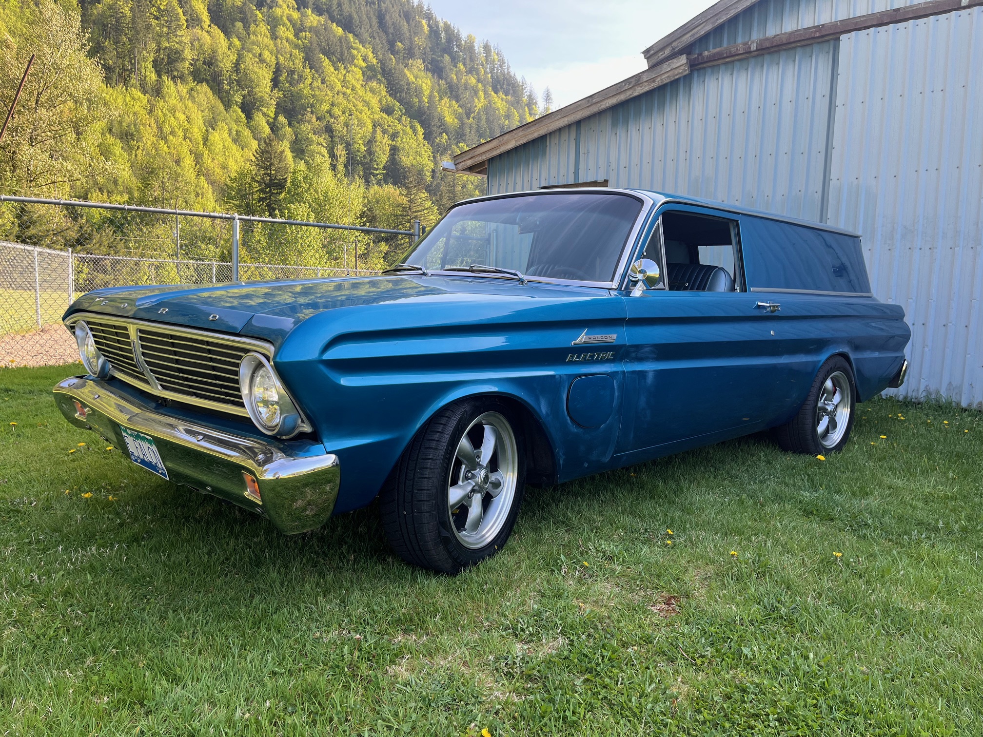

]Hello All: I have fitted the majority of the system from a 2021 Mustang Mach-e into my 1965 Ford Falcon sedan delivery.
The can runs great. Lots of power and a 229 mile range to boot!
The problem I have is that there are a number faults displayed on the IPC ( dash panel) and there is a constant chime when the drive is running.
Is there anyone who has had experience with fitting an emulator to convince the BCM the modules I deleted are sending 'active' signals.
I have retained the complete HVAC , ABS, touch screen , battery pack, onboard charger, cooling system, rear drive motor /inverter as well as the six speaker sound system .
