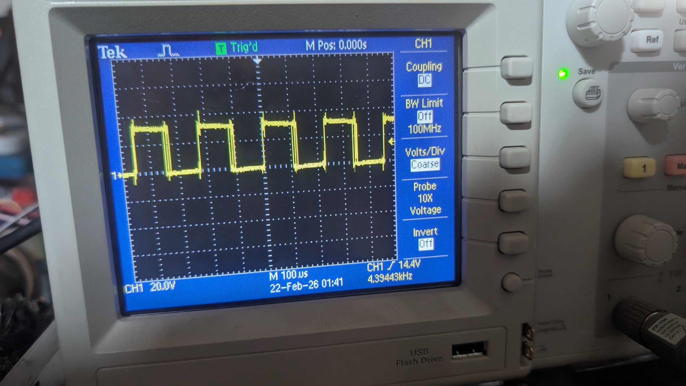

Problem: My motor won't turn, even though the PWM signal is present. What am I missing?
This is my first time using Open Inverter.

There is a PWM signal present on the MG2 phases, but I'm just seeing the frequency of the mains voltage (60 Hz in my case):
Is there a problem with my Gen 3 Inverter? I have a second one, and installing the board on that one gives the same result.

Can you include a complete list of your spot values. And please upload the pictures and files to the forum. (see Attachments in the full editor)
With manual start on and fslipspnt and ampnom set. Do you see the angle change in the spot values or in a plot?
Do you have your probe grounds connected to the "HV" negative? if they are floating they will pick up 60hz.

Did you ever figure this out? I'm having a similar issue. I just get an amplified version of the PWM signal coming from the three output of MG2.
I've got 30v going into the HV battery lugs and I'm using the dual motor board (like you). The angle does change and the duty cycle oscillates. I created a short video here ...
