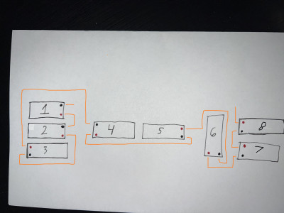

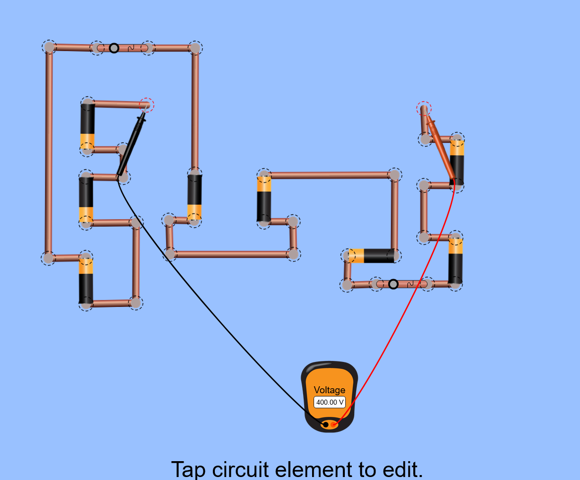

Hey im planning on making my high voltage connections soon and just wanted to get a another pair of eyes on the wiring before i go ahead.
I have eight 12s battery modules scattered throughout the vehicle for a total of 96s and am trying to put my pack contactors in the correct location per the Orion Bms so each 36, 36, and 12 pin connector doesn't pick up voltage of another connector when the pack contactors arnt latched.
Any wiring/routing help would be appreciated, the plan is SDU up front, LDU in rear with the main contactors,fuses and charge contractors in the cargo area.
