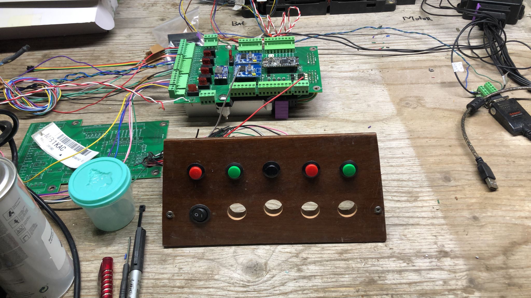

Hi, You only need two connectors, the wiring loom from the Leaf motor stack has all the wires you need. Next to that you need to wire up the BMS, 9 wires, you can use the original round connector.

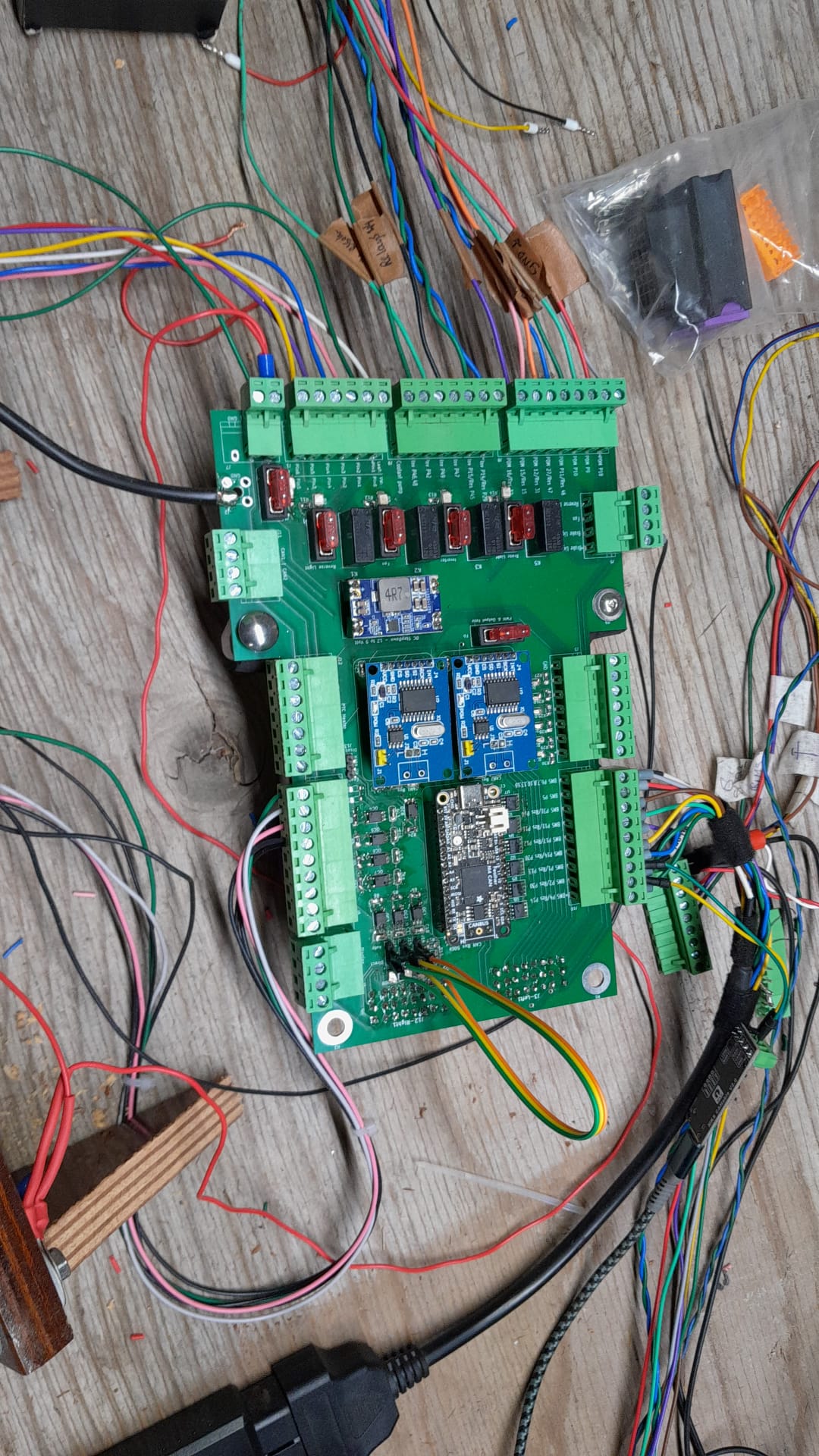

However, I came up with this, I wanted to have it more organized so I designed a breakout board which also features extension for 3 extra CAN buses and allows to add an Adafruit Feather board to control the heater and/or car dashboard interface.
All the connectors are going to all the components, easy to connect and trouble shoot. It also has high amp relays for the inverter, brake light and reverse light, all with indicator LEDs.
It also has I/O ports and a 3 bit gear shift option next to the push buttons needed originally (jumper cable)
You can see, the Resolve controller under the board to make it more compact. The two connectors are soldered to the breakout board.
