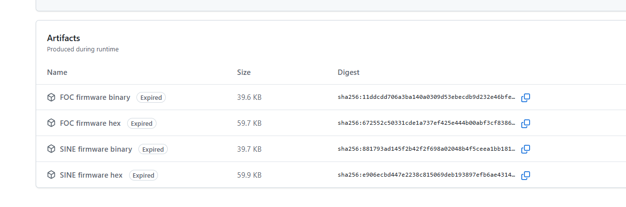

If you want the latest software. You can download it from github. You need to be logged in to github. got to https://github.com/jsphuebner/stm32-sine/actionsmuehlpower wrote: ↑Sat Oct 25, 2025 12:36 pm Johu recommends in another thread: “Install the latest version of stm32-sine, which you can find on Git, i.e., compile it yourself. It fixes various CAN issues compared to 5.35.R.” 5.35.R is the latest version I can download as a binary file.
And select the the latest commit of the branche you want. Scroll down to Artifacts and select the FOC or SINE file.

Sorry did not see that they are expired. Maybe johu can redo the copile or change the expire settings?

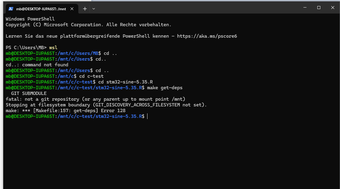

Ubuntu is installed, make and git are running. “make get-deps” produces an error message.
davefiddes
- Posts: 416
- Has thanked: 206 times
- Been thanked: 257 times
Re: Modify and compile a program
make get-deps will not work on the unzipped source. You need to "git clone https://github.com/jsphuebner/stm32-sine.git"

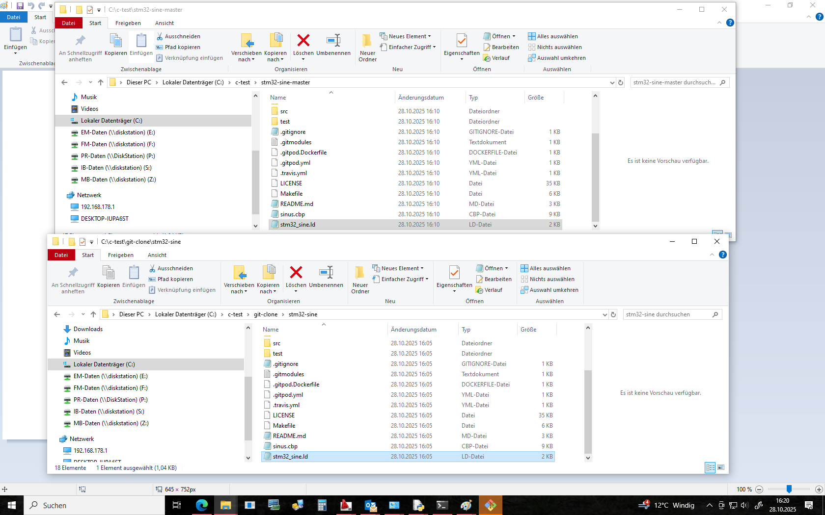

- muehlpower
- Posts: 807
- Been thanked: 188 times
I have now created a local copy using git clone, and the result looks exactly like the unzipped version of the downloaded master zip file. Is there a difference?
davefiddes
- Posts: 416
The "git clone" will have created a special ".git" folder which is not present in the zip file. You should be able to run "make get-deps" now which will fetch and build libopencm3 and libopeninv which the project needs.

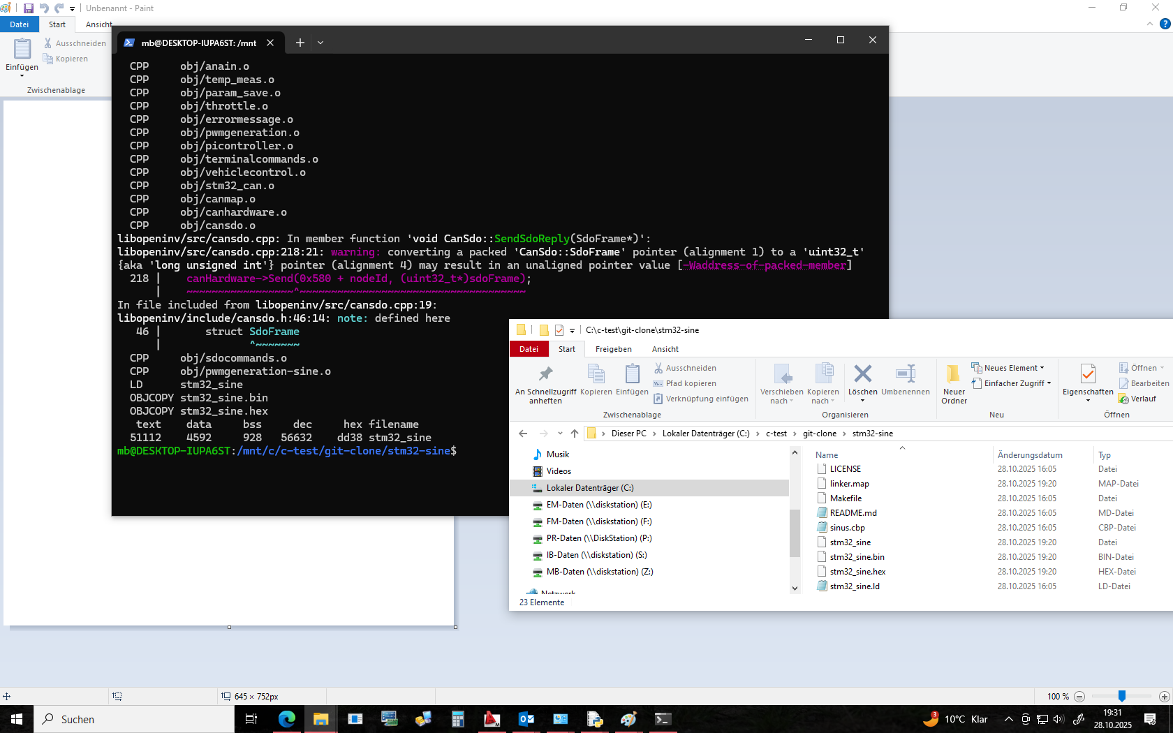

You're absolutely right, I didn't see that. “make get-deps” worked, and so did “make.” So the newly created hex and bin files should be the ones I can load onto my board? I've only changed the version number for now and will test whether it's correct after loading.
What does the warning mean?
davefiddes
- Posts: 416
Yep. You can take the bin file and upload it via the web interface or CAN as you would with an official release. The stm32_sin file (without an extension) is what you need for debugging.
The warning can be safely ignored. It's a compiler bug(ish) cause by some slightly convoluted code in libopeninv. Newer compilers like gcc 15.1 don't complain.
