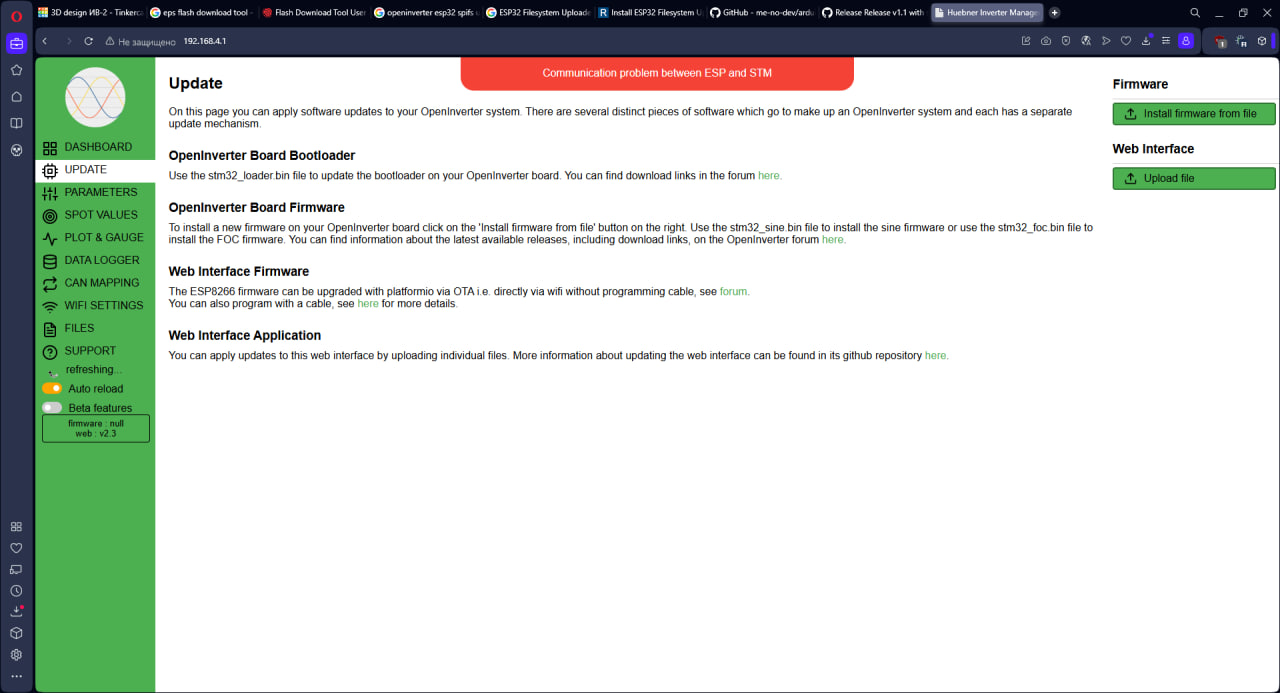

Yes ESP32 repo on jsphuebner is good. On the uart-backend branch.
Install the latest stm32-sine that you find on git, i.e. compile yourself. It fixes various CAN issues compared to 5.35.R
And these parameters are fresher than those on git: https://openinverter.org/parameters/view.html?id=27

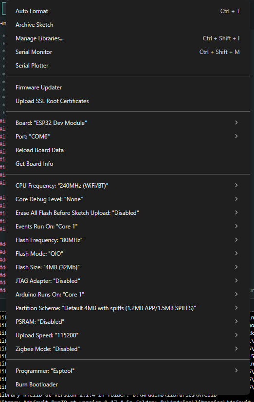

Next, configured arduino ide. I use fresh version 2.3.6 - updated esp32 core and libs etc.
Then opened downloaded sketch and compiled - got some errors related to SPIFFS. It's because sketch misses inclusion:
#include <SPIFFS.h>
Add it after #include <FS.h>
I also installed ESP32Time library.
Make sure that STM32 has no FW - it will mess up the process!
Next - go to Tools and select ESP32 core - with board ESP32 Dev Module.
Leave other settings as is - partition scheme is Default 4Mb with spiffs, 240MHz core clock etc...
Set up COM-port with connected adapter - I use cheap CH340E one. Port speed should be 115200.
Then go to sketch - Export compiled binary. Correct any errors if any spawn in process.

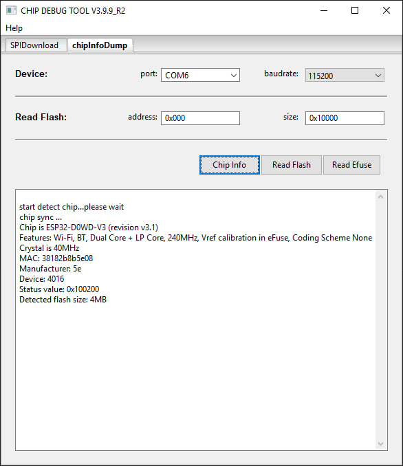

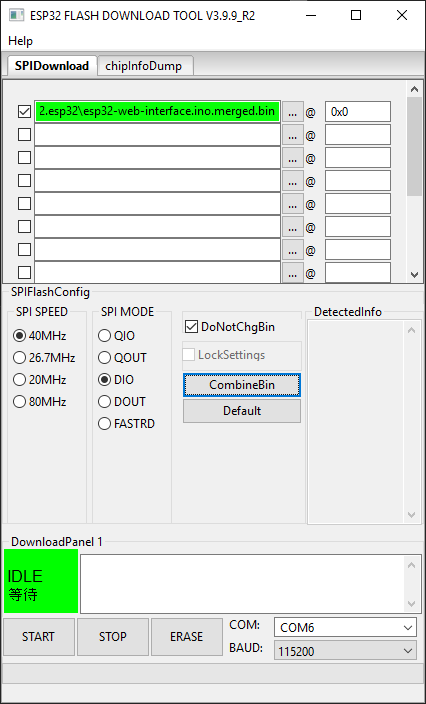

Now, open flash download tool (FDT in short), set prog-gnd jumper and connect your adapter to SDU board.
Give power to SDU and make sure that you can read chip info from FDT.
If everything is wired good - you will get data. Now open SPIDownload tab, select esp32-web-interface.ino.merged.bin, set write offset to 0x0 and hit START. Wait till process is done.
Remove prog-gnd jumper and restart SDU power. Connect to adapter with arduino IDE/

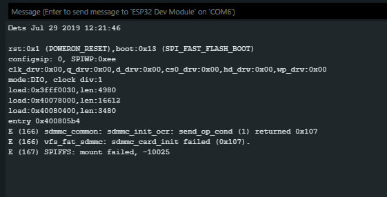

If everything is good - you will se error E (167) SPIFFS: mount failed, -10025
It means that firmware works, but has no SPIFFS. I you connect to wifi and open 192.168.4.1 - you will get file not found error.

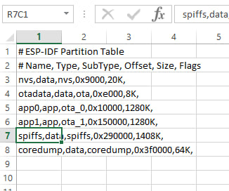

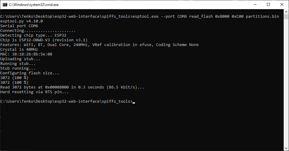

1) We need to know needed size and offset of spiffs image. To get them i used esptool.exe. Put prog-gnd jumper on and restart power to reboot ESP32.
2) open cmd and navigate to esptool.exe folder
3) read partition table data like this:
esptool.exe --port COM6 read_flash 0x8000 0xC00 partitions.bin
Use your com-port. 0x800 is default partition table offset and 0xc00 is default length.
In esptool folder partitions.bin file will be created.

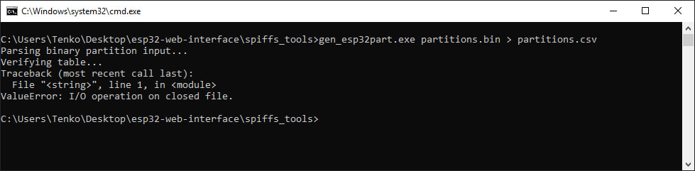

4) Use gen_esp32part.exe to get partition data:
gen_esp32part.exe partitions.bin > partitions.csv
5) Open partitions.csv and find SPIFFS-related line.
It contains partition offset and size - in default case 0x290000 and 1408K.

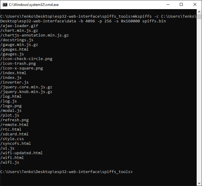

6) Generate SPIFFS image itself. 1408K is 1441792 bytes or 0x160000 in HEX.
Use mkspiffs to create image from provided data folder. In my case - like this:
mkspiffs -c C:\Users\Tenko\Desktop\esp32-web-interface\data -b 4096 -p 256 -s 0x160000 spiffs.bin
This will create needed image of this exact size.

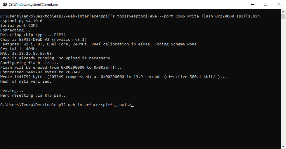

7) Upload image to ESP32 - set prog-gnd jumper, reset power. Navigate to esptool folder and use this command to upload:
esptool.exe --port COM6 write_flash 0x290000 spiffs.bin
Now it should be done - if you remove prog jumper and reboot - you will have your web-interface on 192.168.4.1

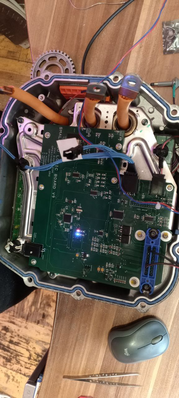

Action time~!

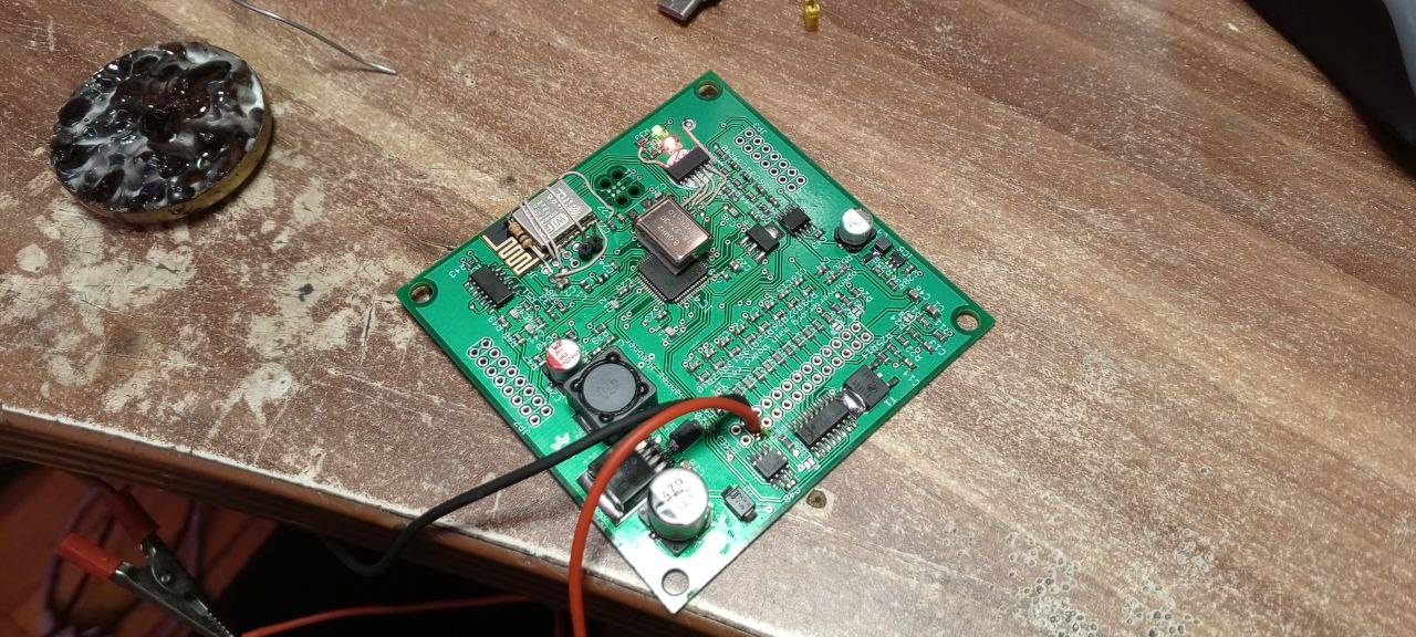

Actually, I soldered regular board and wired ESP-M2 8285 module - and it worked better. This time upload script did the job properly, so I had no problems with filesystem. But 8285/8266 is very different from ESP32 in terms of filesystem approach and memory handling anyway. 1,5 years ago I also had no problems with it, so no surprise here. New interface seems to work much better compared to one I used that time with 'Leaf-o-Cycle' project and my homebrew pcb...
This one also needs some testing - I had a little bit of trouble finding single 3-input NAND in SC70 package and temporary replaced it with regular SO-8 74hc10. Also used LM2733X in place of MIC2288, but it should work no problem - a bit higher switch frequency, same feedback voltage, same pinout and generally same output characteristics. All of this can be ordered, but I wanted to test right here and right now, so for a moment I will let it be.

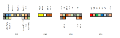

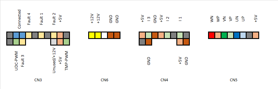

In one of Gen1 threads it's said that Gen1 uses analog signal for thermal sensor and voltage sensor. In our case it was clearly PWM signals.
My current pinout for CN3 and other sockets is like this:
Colors are not corresponding to real wires colors.
I need info mostly about CN3 pinout - I'm not sure that Fault 3 and Fault 4 are actually fault signal pins on Gen1. And I also don't know which fault signal corresponds to which error. It's possible to find out, but I wouldn't want to risk the controller board and driver board...
For now it's the only information left that i'm not sure of. As i said before - we already had motor spinning.
And for god's sake why do we need to connect two pins together on CN3?

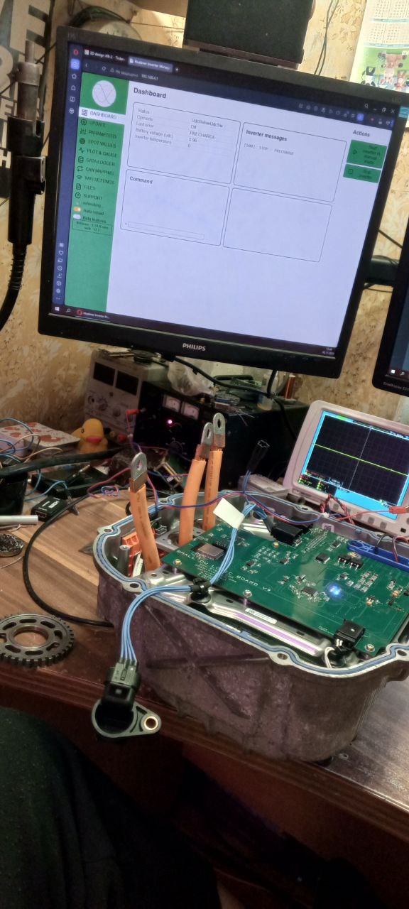

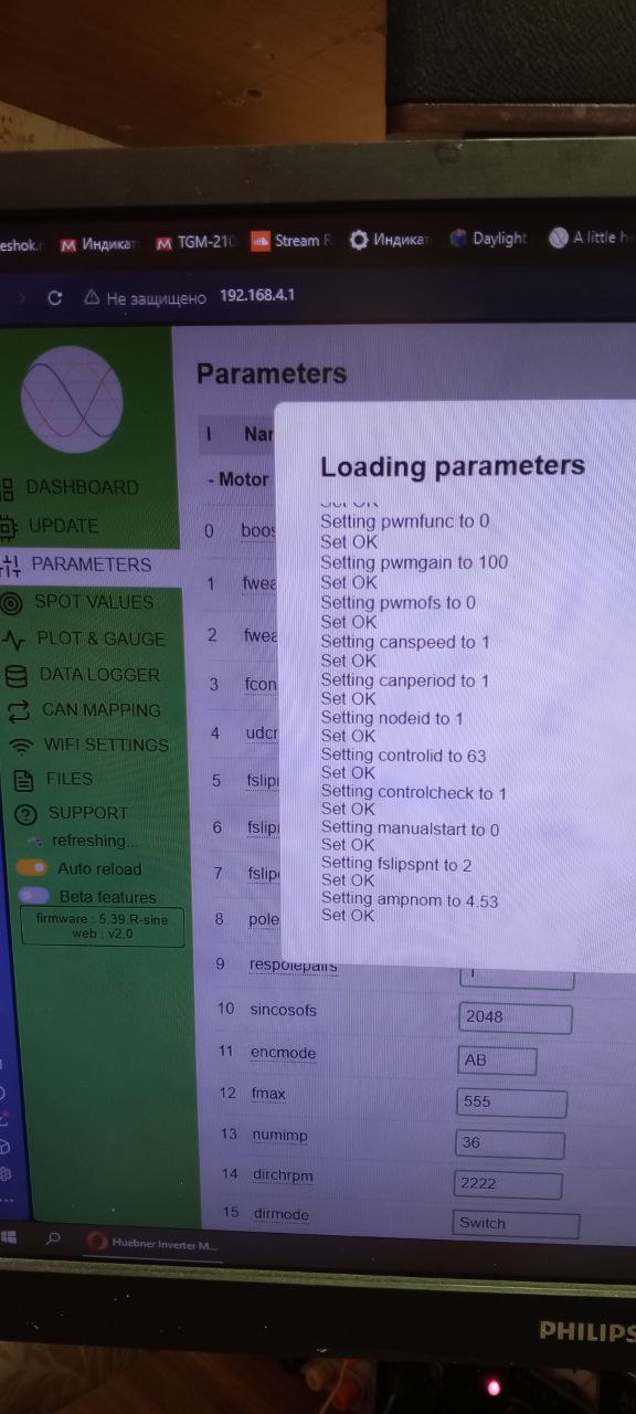

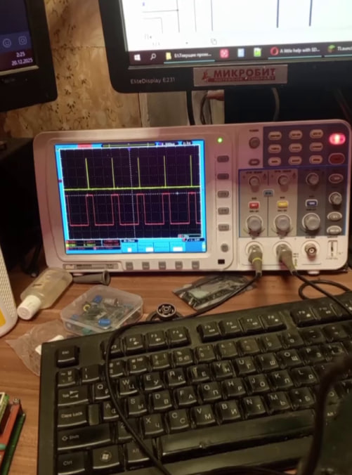

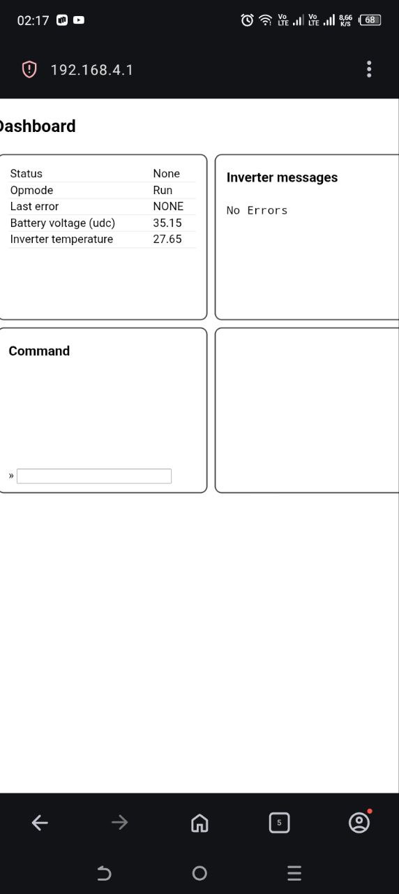

Ok, finally got to testing of SDU. Doing Damien's V9 board so carelessly was a mistake. Nothing died in process of testing the actual device, but I had to replace 90% of the resistors because V9's schematic had almost all values set to 1k, and I was too sleepy and too hot-headed at the same time to actually check the logic behind them. V8 schematic also shared the same mistake, but V8's BOM has correct values, and difference between V9 and V8 is very small. I also compared values to V6 just to be sure. Not a problem for now because it seems that Damien deleted revisions V7 to V9 and started KiCad redesign project. So you can't simply download schematics with wrong resistors now.
After replacing all wrong resistors I was able to start inverter without any errors and got correct voltage, current and temperature measurements.
Phases control signals also look good here, and encoder input levels now look good. Tested on low voltage PSU at home:
FW is latest release 5.39 from git.

Ok, back to testing.
Now, all readings are good. But i only have weak and somewhat stuttering spin with high jumping current.
Phases are good - checked phase-to-rail and phase-to-ground short circuits.
Voltage readings are good - use 50V supply for initial tests. Board currents are also good. Board can properly see encoders (speed graph reacts to manual spinning). Switching A/B makes it worser, but reverts back to original state when i swap phases 1 and 3, also rotation direction changes.
So, initial wiring must be good.
Spinning speed has no corelation with pot turn angle - i use electrobike handle for tests, all pot limits are set the correct way.
Strange thing is that controller starts seding PWM to phases even when I don't touch the handle, or even without handle. All i need to do is start it with hardware run wire - and it somehow tries to start spinning.
I don't know what is going on. HW is all good, but it just lives its own life.
Please help anyone.
Quick vid to get better idea.

Ah, nevermind. I set pinswap to phases 1 and 3 - runs good.
