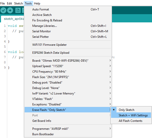

- Arduino/File -> Preferences -> Additional Boards Manager URLs: http://arduino.esp8266.com/stable/packa ... index.json
- Tools -> Boards -> Board Manager -> esp8266 -> Install
- Tools -> Boards -> Olimex MOD-WIFI-ESP8266-DEV -> Flash Size -> 2M (1M SPIFFS)

Re: Web interface problems V2.1 mainboard
A bit strange that SSID is set to default. Maybe try erasing WiFi settings?
Chapter 3 !
After a lot of trial and error experiments with different versions of Arduino ide and esp8266 boards, I got to the point where
I could compile FSbrowser.ino . So I exported the .bin file and tried to flash it to the esp8266 , using esptool . After that my pc still sees"esp_56520",
but asked me for a password !, same source code ,different flashing procedure ! Will keep experimenting , somethings got to work soon !

Are you sure you soldered GPIO0 to 0? After done flashing solder it back to 1.
Post your result screenshots.

Yes , I did. I have three 8266's now and I'm starting to think it must be the usb-serial cable . If I try putty to communicate with it I get no response from two of the 8266s . The 3rd responds with version no. etc. But I haven't tried to flash this one ,so I'm not sure .Maybe my attempts to flash the other two have mangled any code that was there ?
I think I will ask Johannes to send me a pre-flashed 8266 so that i can move this project further on . I have a friend visiting soon who knows a lot more than me ,computer and code wise so hopefully he will be able to figure it out.
Dima , thanks for your help so far , I'm sure i'll need more soon !
Will keep you posted !
