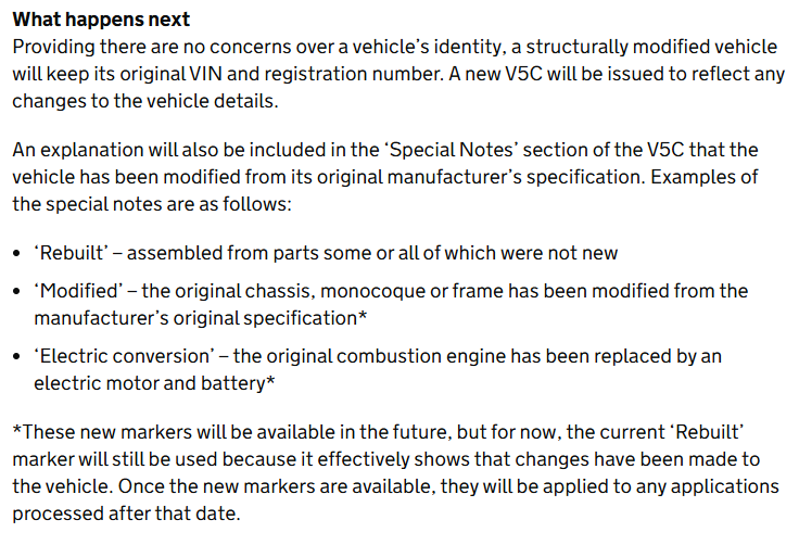

Not sure what it means at the moment, I'm told that they're going to also update the V5 on 2001+ vehicles, but we will see. It'll be live on the website from the 26th apparently.

Sorry, it looks like they we're miss-informed and 2001+ will not be updated.

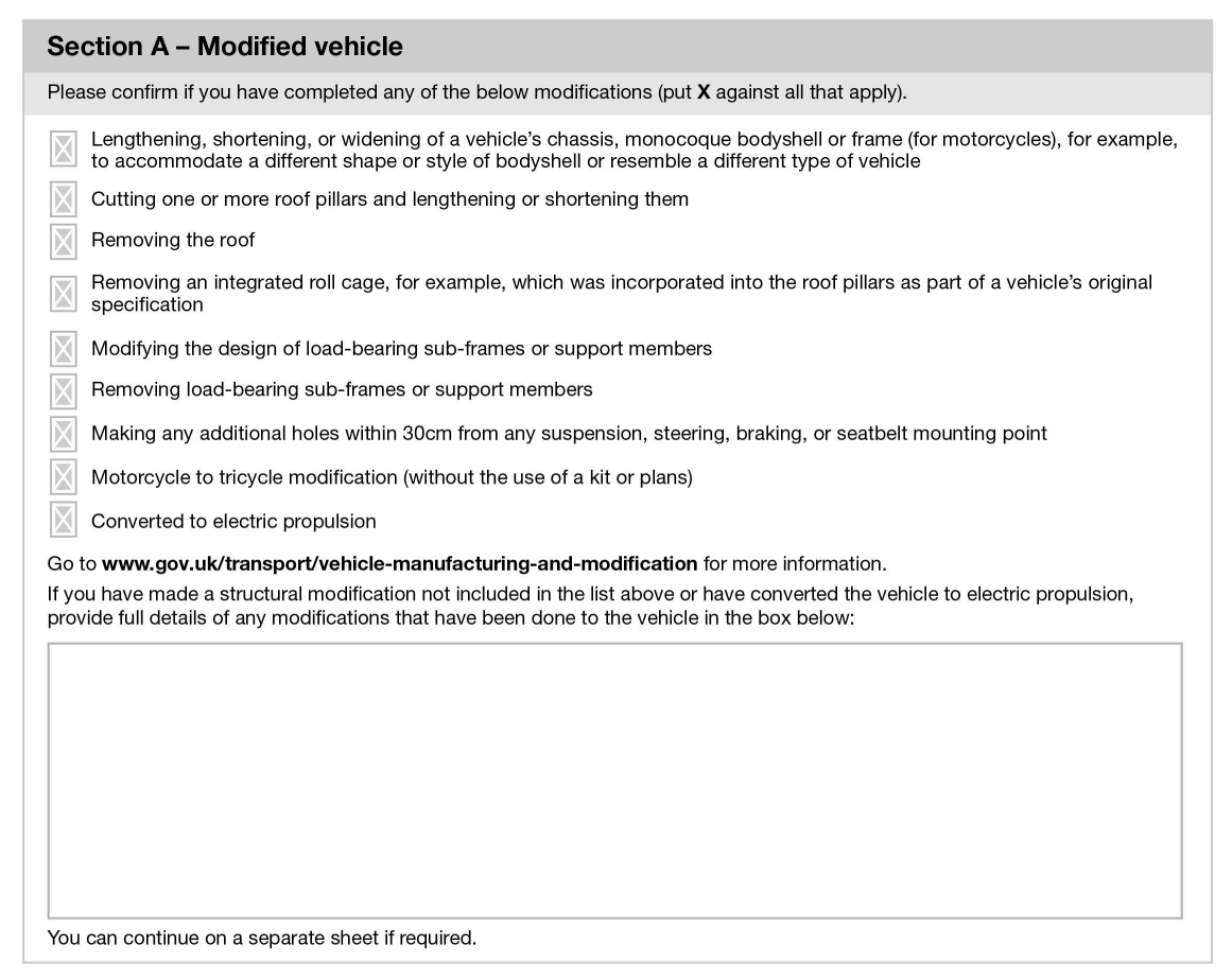

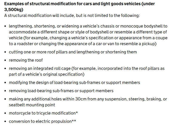

As expected, swing and a miss for the DVLA. The only mention of EV conversion is "You also need to tell DVLA if you modify a vehicle by converting it to run on electricity, even if you do not make structural modifications like changing the appearance."
We can now make additional holes in certain areas, but no mention of the maximum size of said hole.What counts as structural modification
Structural modification of cars, motorcycles or light goods vehicles (under 3,500kg) can include:
altering the chassis, monocoque bodyshell or frame (for example changing the shape so it looks like a different vehicle type)
lengthening, shortening or widening the frame of a motorcycle
cutting, lengthening, or shortening roof pillars
removing the roof
removing an integrated roll cage
modifying or removing load-bearing sub-frames or support members
making additional holes within 30cm of a suspension, steering, braking or seatbelt mounting point
turning a motorcycle into a tricycle

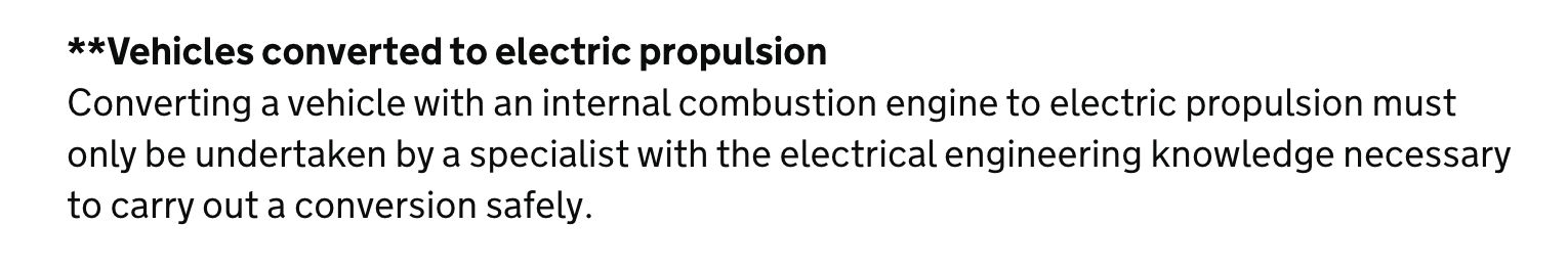

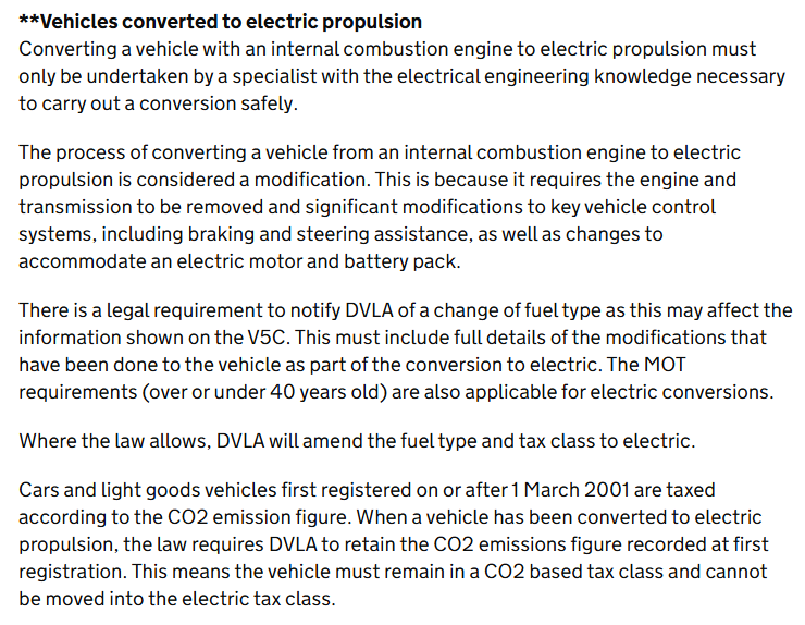

Re: DVLA change - huge news!
There are some more mentions of EV conversions here: https://www.gov.uk/government/publicati ... les-inf318
Here are the bits that are most relevant:
It seems the old points system is gone and EV conversions are now considered structural modification regardless of if the chassis is actually modified. I'm not familiar enough with the old system to say whether this is better or worse but at least EV conversions are considered more explicitly.
This part is concerning from a DIY point of view.
I'd not be concerned from a diy conversion perspective. It seems worded carefully to allow those without specific qualifications. If they wanted qualified personnel and to a particular level they'd have to state it. What this suggests is that anyone converting a vehicle should educate themselves as much as possible to have sufficient knowledge in order to convert a vehicle without it becoming a risk. Whether the DIY conversions are without risk is another matter.
Interestingly, the above does not conver hybrid conversions (not that many or any have happened). It's quite binary in it being either an EV or an ICE.

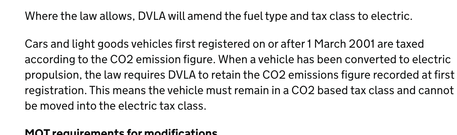

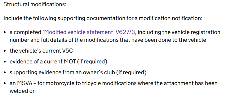

Looking at the V627/3 form it seems that most structural modification only have to tick a box but EV conversions have to "provide full details of any modifications".
That is not actually true. Since the vehicle becomes 'electric' it is no longer governed by the part of the regulation that states the emissions cannot be changed. DVLA are perfectly entitled, by law, to change the relevant details on the V5C. That is the legal opinion I have obtained and also that of my local MP, but DVLA are too dumb to fully understand the regs and the government is too lazy to do anything about it.
Besides which, it is purely a bureaucratic issue. The regulation that prohibits changes to the emissions stated on the V5C is quite logical for ICE powered vehicles which would require complex and expensive testing to establish any change to the vehicle's emissions and that would be impractical to the point of impossibility. However, removing the ICE entirely renders that completely irrelevant and a simple MOT could be used to establish the lack of ICE.
So the law actually states they can change the emissions and hence the tax class and there are existing methods that could be used to verrify the change. The fact that DVLA is still making such a big deal of this makes me wonder what their motives are. Saving the planet from pollution not being one of them, obviously.
From memory, re-shell used to be okay with a new shell or chassis of original spec (makes sense, and like galvanised chassis replacements on land rovers).
But to allow a used shell....! Seems to open up more possibilities of people scamming people with high value classics where specific models are worth money.
But holes outside 30cm is a good thing?
Modifying a "load bearing" vehicle subframe is notifiable, but modifying wheel arches for wider wheels isn't? Even if I cut away the body...? I'm confused.
