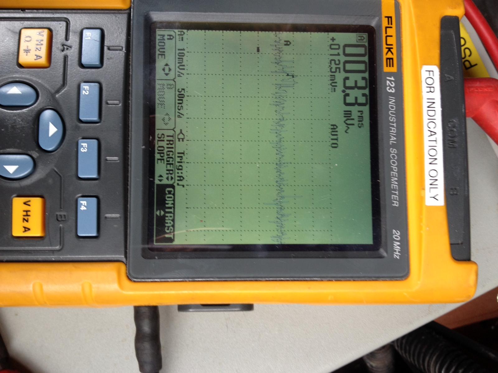

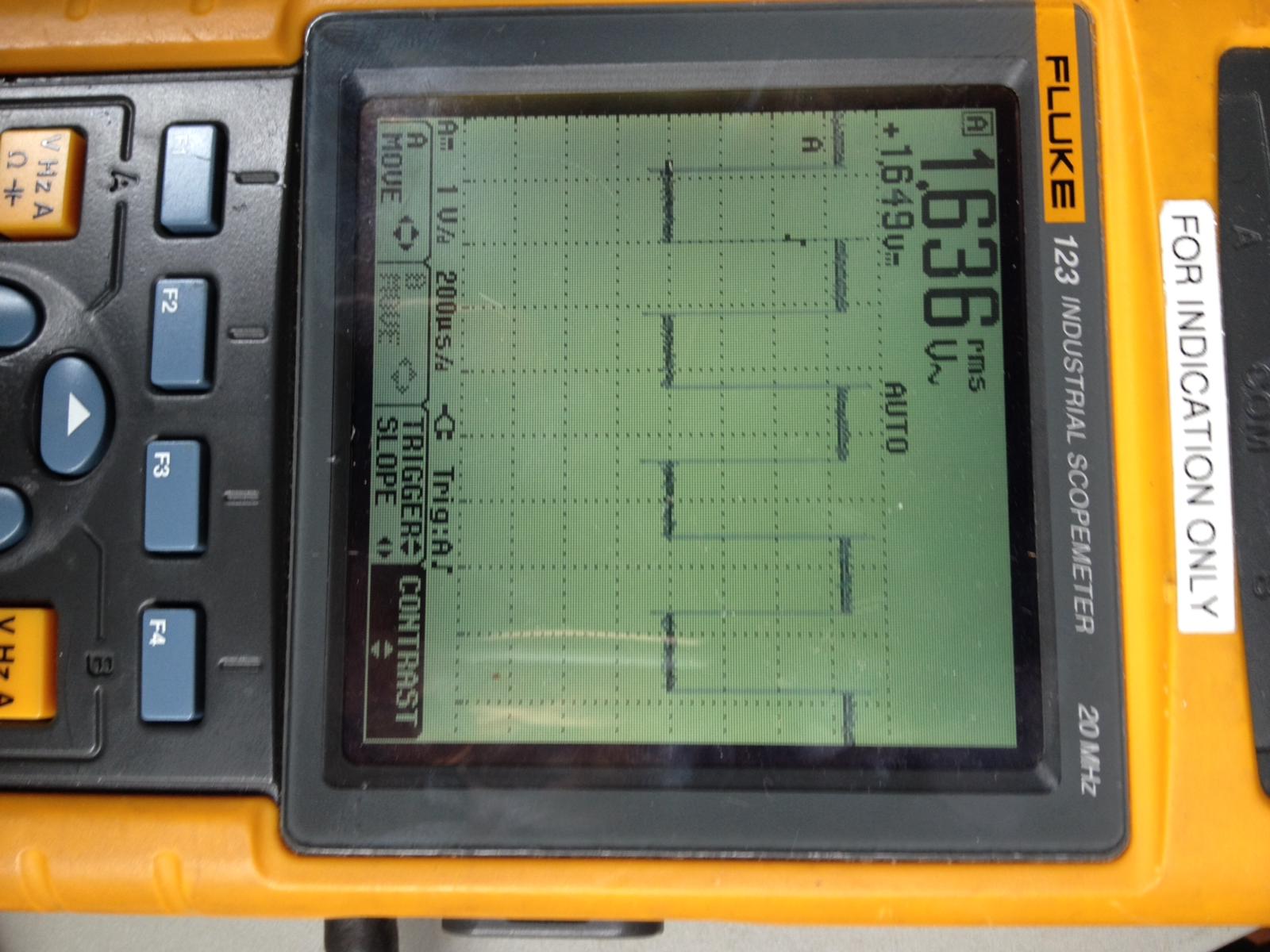

Just done some more investigation with a scope.
With the inverter in operation and a direction selected I have a 50% duty cycle on 5 of the 6 gate driver outputs, swinging from +15V to -5V. The other gate driver output remains at a constant -5V. It's the EM_H and GATE_H of phase 3 if that makes any difference.
I then scoped the non inverting voltage control input (pin 2, VIn+) on all of the A337J chips. They were all showing a 3.3V PWM signal apart from the one that has the problem. I've attached a photo of the bad one compared to the other 5 A337Js.
This suggests to me that the output from the Olimex could be dodgy. Any thoughts on the most likely cause?
Re: Enova Combi Board
Yes! That’s probably the faulty STM32 output. I had a very similar issue with this uC before. All 5 pins had a 0-3.3V square wave but one of them (it was CH3N, in my case) had something like 2.5V-3.3V, effectively keeping the gate at “on” state all the time. Luckily, the Olimex board costs only several $

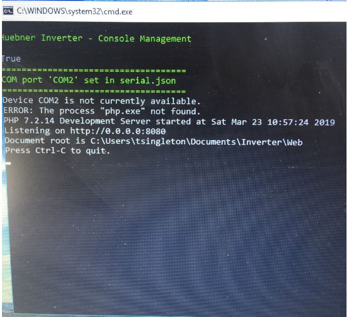

I'm having some problems. Previously, to set up parameters etc, I used this web interface - https://github.com/dimecho/Huebner-Inverter. The PC that I used last time has since died so I've had to set it up on a new laptop.
Previously, I would just connect to the combi board via USB, run the Huebner Inverter.bat file and it would work fine. Today, I'm getting the error shown in the attached photo. Any ideas?
Also, I've realised that I'm not actually sure how to flash the brand new Olimex. Do I need a special programming tool or can I just do it over USB?
Sorry for all the questions, I'm pretty new to this kind of stuff!
@tom3141, in order to flash a bare STM32, you need some adapter like either ST-Link v2, or ARM-USB-TINY-H. There are cheap Chinese ST-Link clones available in the market, you can just use the cheapest one you can find in the local shops around you.
For the serial communication, you should be able to see the COM port in the device manager. Just type devmgmt.msc to the Start->Run menu (Win+R) and find your device under Ports (COM & LPT). Without flashing the software to the STM32, you can open the COM port but you won't be able to send/receive data, of course.
That web interface was developed by @Dima and he can assist you better, but I suggest you download PuTTY from here: https://www.putty.org/ and connect to the COM port you see in the devmgmt.msc with 115200 baud rate.
Or you can try finding the file Web\js\serial.json, manually edit the "COM2" port to the one you see in devmgmt.msc, and try opening the web interface again.

I managed to get the web interface working on another laptop. I think the problem might have been a firewall on my work laptop that I couldn't turn off.

I'm still having troubles getting the motor to spin up properly and after some investigation with a scope this morning I think I still have the same problem that I had with the old Olimex. I checked all the PWM input pins on the A337J and they all show a 3.3V square wave apart from the one that I had the issue with last time. I've not had the motor spinning properly since I swapped the Olimex over so I don't think I have actually fixed the problem. I'm not having the shorting issue on start up anymore but the motor just rotates very slowly and jerkily - I guess this would make sense as 1 of the phases isn't working.
Any ideas on what else could be causing this? Is there anything else on the PCB that would affect this PWM signal? Or could it be a firmware issue? Just a dodgy solder joint? I might try to measure the output pin on the Olimex (rather the pin on the A337J) but I need to figure out which pin this is.
I had a few problems with the precharge circuit that turned out to be due to my 12V aux battery being flat. Everything would turn on but then the main contactor wouldn't close when it should. Fixed this now by using a fully charged 12V battery!

Hi tom3141. I am using the Combi V8 board too. Have you checked you are getting good noise free(ish) signals back from your encoder ? Also I had problems trying to run my Enova motor and spent weeks adjusting parameters to no avail. Contacted Johannes who set up a test with a Combi board (thanks once again Johannes) I was running version 2 with the Olimex, check if its version 1 or 2 when you read parameters, Johannes suggested I remove R21 which is to do with RPM output, once removed it reverts to version 1 (I snipped one leg at such a point where I could re-solder the leg if needed later without removing the pcb) the motor ran great immediately !! Worth a try as my motor would jump about crazily like it was missing a phase and tripping out on overcurrent and encoder signal, check to see what errors you have. Might be worth a try. Fingers crossed. Peter
Interesting. Not sure if this could affect the PWM output to the gate driver but worth some investigation.
Are you talking about the ‘hardware version’ in the parameters? Mine is set to v2 if so.
I presume R21 is a resistor on the Combi board?
Hi tom3141. Yes its the hardware version, R21 is on the Combi board. Simple enough to test I guess. Peter
