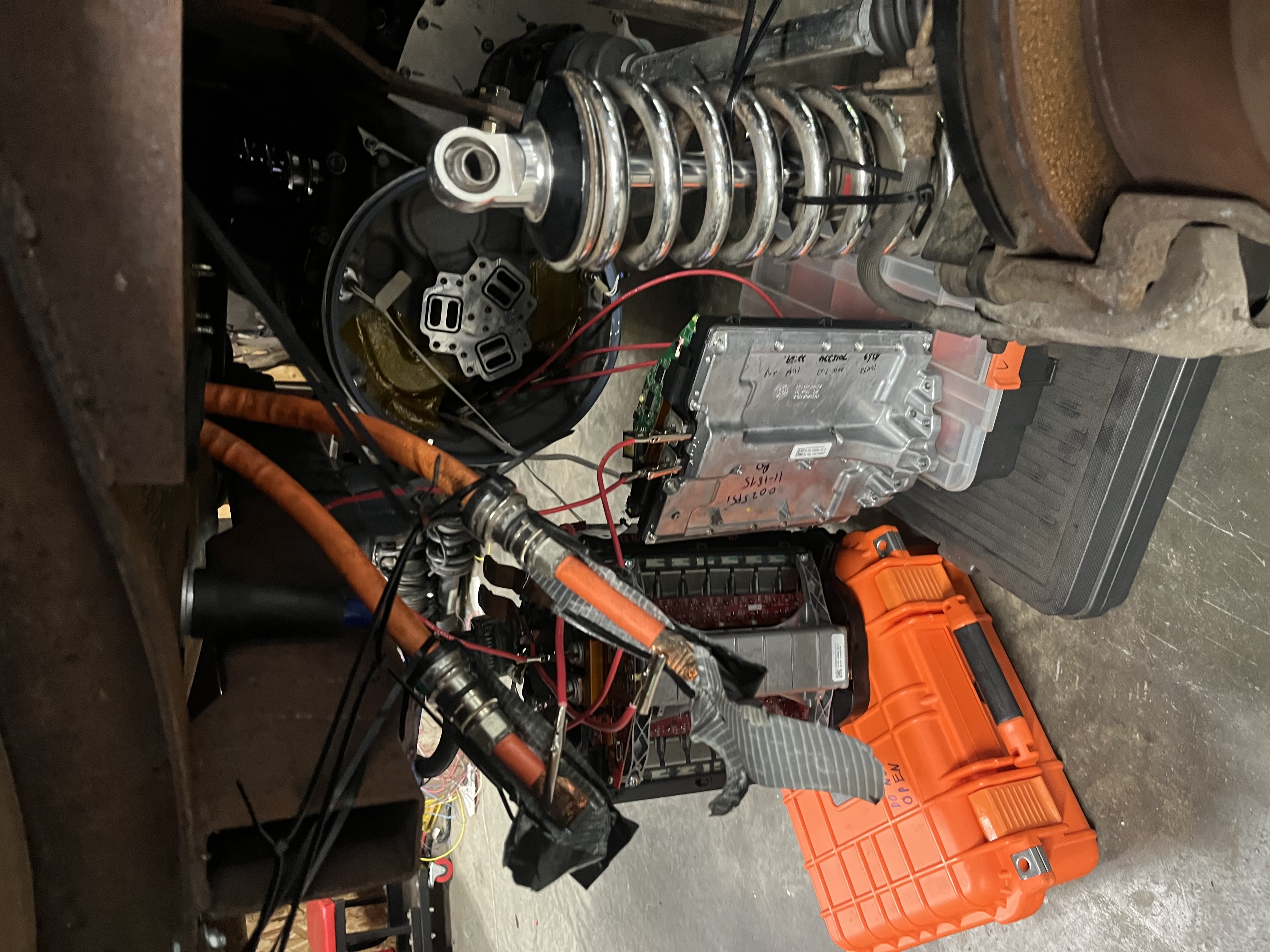

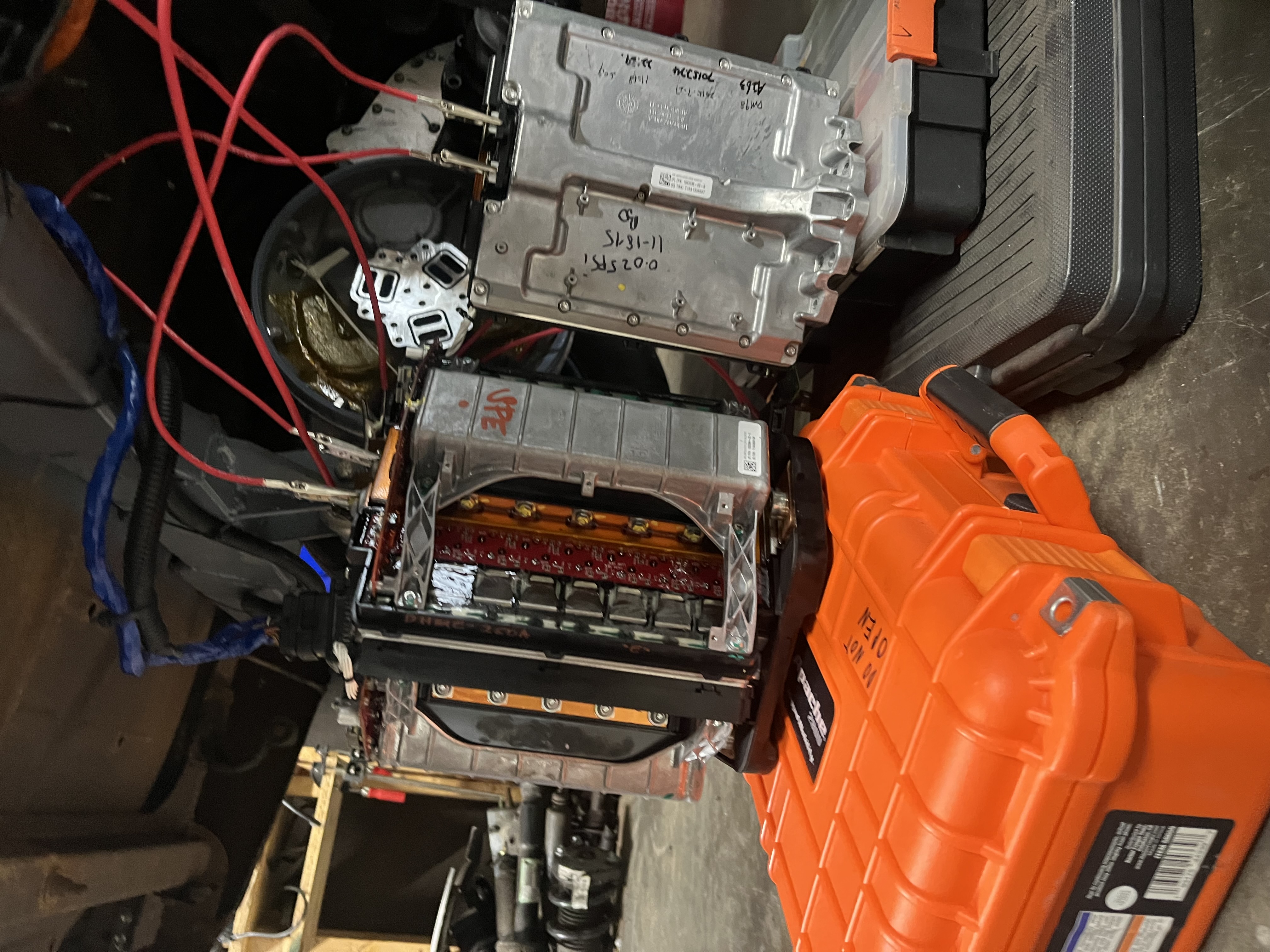

Well I'm back around to a loose connection. I think. I set up the inverter sitting on a box with jumpers to HV and the motor, and with a base phase subbed in for one of the Sport phases. The plan was to keep switching this around in place of each phase, with hope that it would work in place of one phase, and that would tell me which Sport phase had a bad gate driver.
[WARNING] Dumb hot rodder alert, do not try this at home. (go over to a friend's house) So I set that all up, powered things up, and it worked! What luck, the first phase I tested was the bad one!?!? Then I remembered its never that easy with this car. I disconnected the base phase, and using the same jumper set up, connected with all the sport phases, and it worked! Which means it wasn't a bad gate driver. The only thing I can think is that something is loose. I did let it sit for almost an hour and tried again, just to make sure, and it still worked.
I did notice a capacitor on a gate that wasn't completely solid, and some of the connections to the brain board seemed ok, but a little loose. What I decided to do was use some potting compound on the capacitors on all 3 gates, and then use some UV setting superglue to permanently attach the wiring harness to the brain board. If I ever have to swap the brain board, I have a spare wiring harness. I'm going to let that all set overnight, and try reinstalling in the car tomorrow or Tuesday.if it doesn't work again, I'm going to start throwing tools.

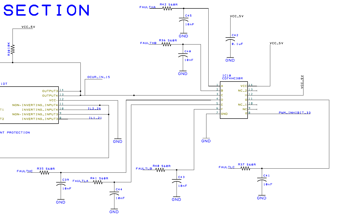

Does "won't start" mean it faults out with OVERCURRENT? If so it would be worthwhile checking the 7 fault signals
Maybe even go as far as soldering wires to them and scope if they look fine statically?Support R/D and forum on Patreon: https://patreon.com/openinverter - Subscribe on odysee: https://odysee.com/@openinverter:9
- muehlpower
- Posts: 689
- Has thanked: 14 times
- Been thanked: 141 times
Re: New Tesla LDU fault - inconsistent failure to start
for my understanding, what triggers an “overcurrent” message. Of the 7 inputs on IC10, 6 come from the error lines of the gate driver. One comes from IC8, and is also transmitted to the CPU. The output of IC10 suppresses the PWM. Is this suppression also output as an “overcurrent” message? If not, the error message can only come from IC8.
- Posts: 6708
- Has thanked: 367 times
- Been thanked: 1536 times
If only someone had programmed it that way
EDIT: fixed it, @Paul do you want to try? https://github.com/jsphuebner/stm32-sin ... 5507451451
extern "C" void tim1_brk_isr(void)
if (!DigIo::desat_in.Get() && hwRev != HW_REV1 && hwRev != HW_BLUEPILL)
ErrorMessage::Post(ERR_DESAT);
else if (!DigIo::emcystop_in.Get() && hwRev != HW_REV3)
ErrorMessage::Post(ERR_EMCYSTOP);
else if (!DigIo::mprot_in.Get() && hwRev != HW_BLUEPILL)
ErrorMessage::Post(ERR_MPROT);
else //if (ocur || hwRev == HW_REV1)
ErrorMessage::Post(ERR_OVERCURRENT);
timer_disable_irq(PWM_TIMER, TIM_DIER_BIE);
Param::SetInt(Param::opmode, MOD_OFF);
DigIo::err_out.Set();
tripped = true;

- Removed the inverter from the car. Performed a diode test on each phase, all pass.
- Tried using jumpers to swap in a known good phase and test with the inverter on the ground, Fault did not occur.
- Used the jumpers to connect the Sport inverter, with nothing changed from when it was previously faulting, and the Fault did not occur.
- Glued a few things in place that might have been loose.
- Installed inverter in car.
- Tested on jack stands, and test drove, no faults.
- Parked for 24 hours.
- Went to test again, and the fault occurred.
12V supply voltage or amperage
current sensor
dissipation circuit
OI board (was not doing this with the previous base/sport hybrid inverter)
At least one of the Sport phases (as it was in the base/sport hybrid)
An actual failure of any IGBTs - all phases pass a diode test on the bench.
What I Think It Could Be
Based on the fact the phases pass a diode test, don't show an error light, and do in fact work sometimes, it seems to me there is some gate driver that isn't working 100% correct. I'm not sure why time is a factor, but it seems to be.
Next Steps
- I have already bought a "for parts" sport LDU from Ebay, but I'm not picking it up until next weekend. The idea would be to harvest a good phase or two and swap them into mine, and hopefully eliminate which phase has the bad gate driver?
- I think I will have time this weekend to test a few things. Of course, there is the chance that when I remove the case it magically starts working again. I have a couple of multimeters but I do not currently have an oscilloscope (I know, I know, it's been on the list to buy for a while. Someday I'll get one)
- What points should I test, and what should I be looking for?

Based on that I still vote for intermittent connection problem, caused by moisture or wear.
a) cracked solder joint of connector on OI board. Diagnose with microscope or by wiggling every single pin with tweezers. (I don't think a continuity test will discover this because intermittent).
b) Corroded pin or female connector
c) same as a) but on gate driver side (were you able to trace this back to a specific phase board at all?). Less likely than a)
d) ok, maybe something funky such as damaged gate driver. But not really buying this one.

Thanks - I will check it over again. The thing that has me the most confused is it a) drives into the garage, then faults the next time when nothing physical should have changed. b) seems to consistently not fault the first time I test and will start back to back, but then will fault the next time I go to drive it if its been a few hours. It seems super odd. Maybe it is the dissipation circuit and I just didn't give it long enough when I tested? And the reason disassembly "fixes" the issue is some errant short/spark across the bus bars dissipates some remaining charge? (I'm not entirely sure how that whole thing works, so I don't know) But that board was in it and working fine previously.johu wrote: ↑Sun Jun 08, 2025 4:30 pm Based on that I still vote for intermittent connection problem, caused by moisture or wear.
I have not yet been able to narrow down which phase is the issue. I think I have it narrowed down to 2, because the 3rd was in it when it was a base/sport hybrid, but I'll check all of the connections again. And if it still faults when I take the case off I'll try to check which fault signal it is.
