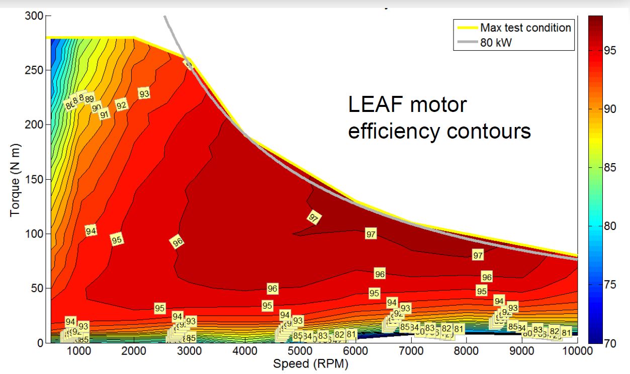

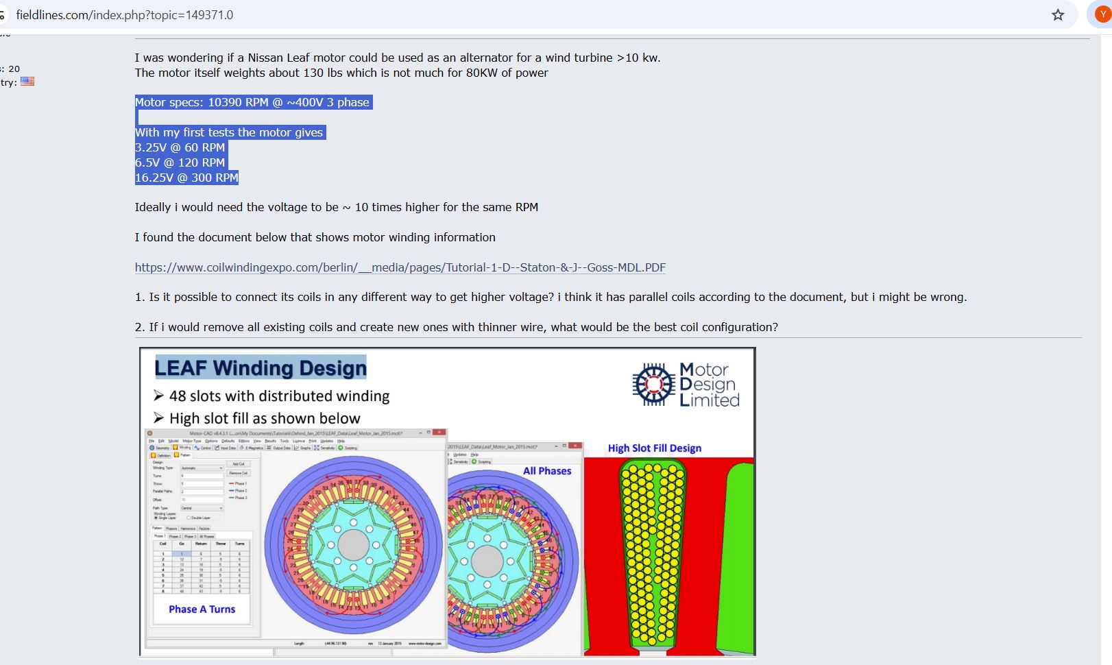

tom91 wrote: Thu Apr 03, 2025 5:36 pm So no idea what the rpm/V curve is
What I found is this data and this graph.
With 1/6 of the voltage I don't know why it could not output 1/6 the power.
Been thanked: 1918 times
Re: Solar Catamaran 45ft with dual Leaf motor
Here's my take on it. At 350V it can output 160 kW and it will run in field weakening above around 4500 rpm.
So you would think, ah, no problem at 58V it can do 26 kW at 750 rpm. Thing is it can only do so short term as it runs around 400A per phase. Half that, *may* work continuously. I wouldn't go as far as saying no way here but it's a gamble.
Romale here on the forum runs it at pretty low voltage I think, maybe he can chime in
