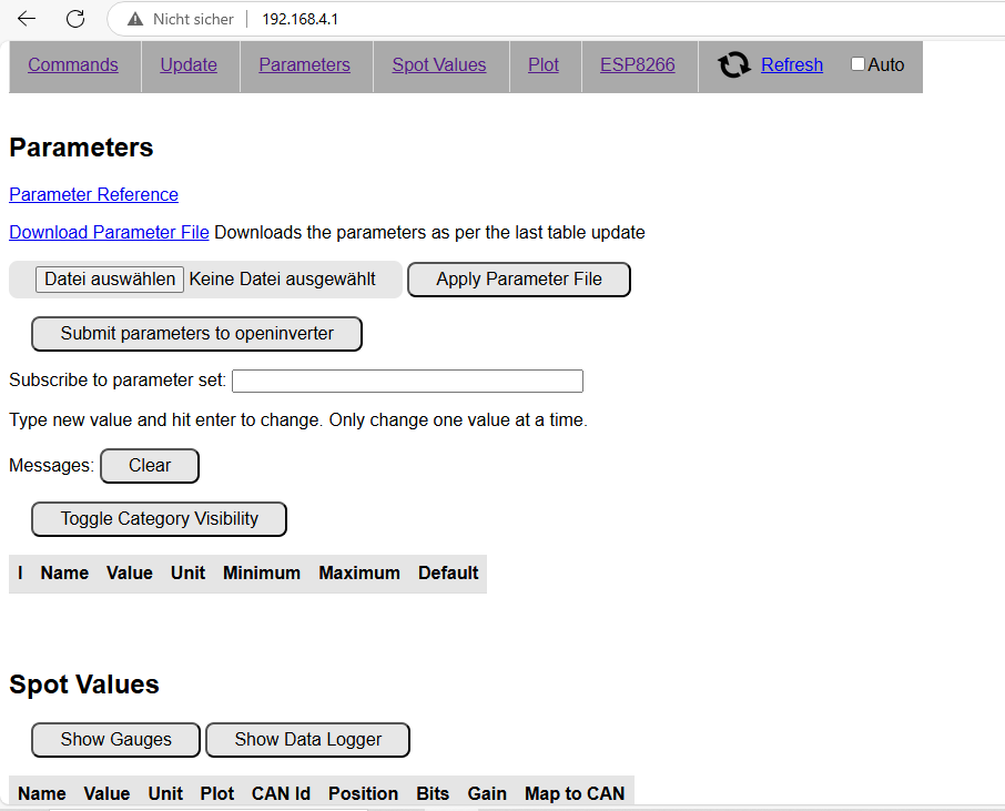

Happy Weekend everyone,
I had tried to update my ZombieVerter via the WebUI but afterwards the paramters and spot values option are not visible. I further tried restoring the Zombie using the ST Link and cleared the memory and tried it with V2.17a and V2.20a but no change. The Software states succes so I hope it actually did something. If I download a parameters file it is empty, so that changed for sure. Any tipps to get back at it? And or does someone have a paramters file for the GS300h? I am confident this motor will spinn soon enough.
Thanks for the help in advance.
Marvin

Nevermind it works now :/

Hi Marvin,
I had quite a lot of trouble with updating past 2.15 on my quite old Zombieverter. The behaviour was as you described - no spot values or parameters. With 2.17 the issue was intermittent, and with 2.20 I pretty much never had any success.
I tried many different ways to solve the problem, but in the end the only thing that worked was to update the ESP8266 to the latest version via an UART cable and updating the STM32 via STLink. Basically a full reflash of everything.
If you keep having issues I’d recommend that.

I also have the same issue when "Auto Refresh" is set on to display spot values.
It often requires multiple screen refreshes on Chrome to sort.

I also have the same issue first ignition switch power up. I have to wait sometime before It will display spot values on any web type os's PC or Table.
and sometime doesn't ever show display spot values at all, so will have to do a power cycle
I fully power down zombie as it draws to much current as only running small Ah battery.
