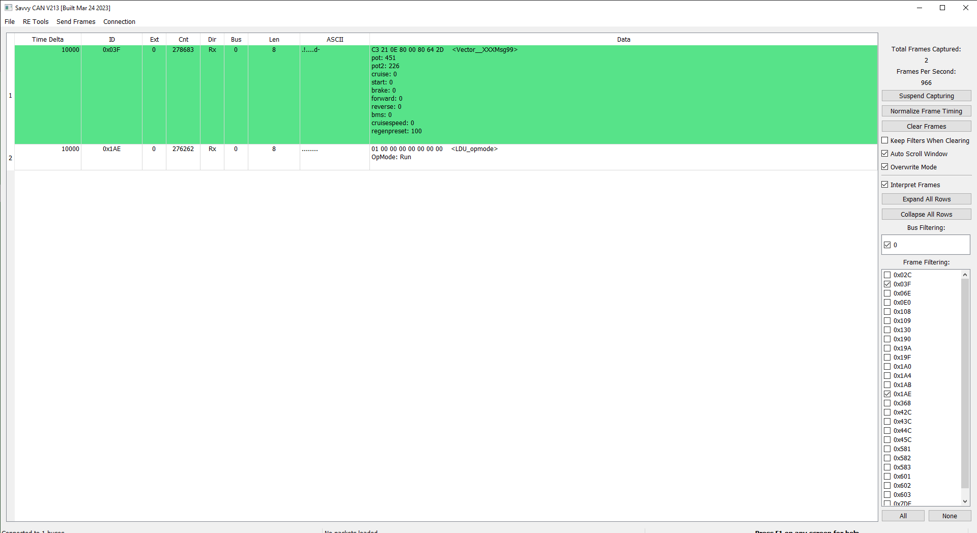

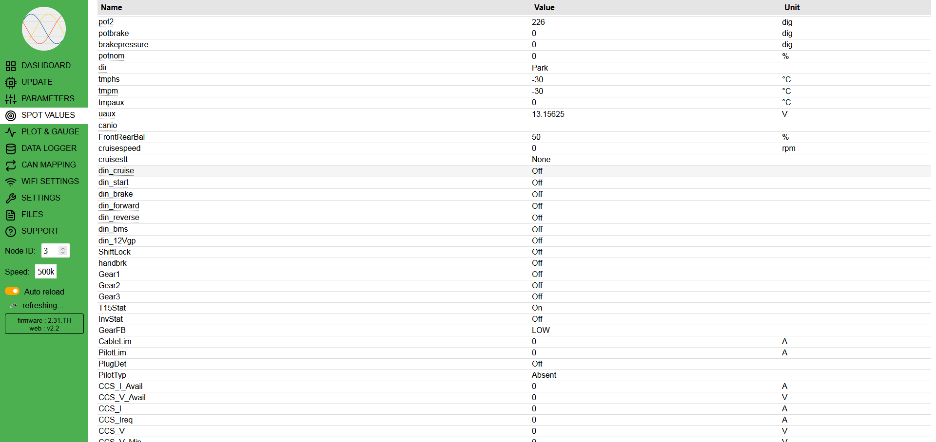

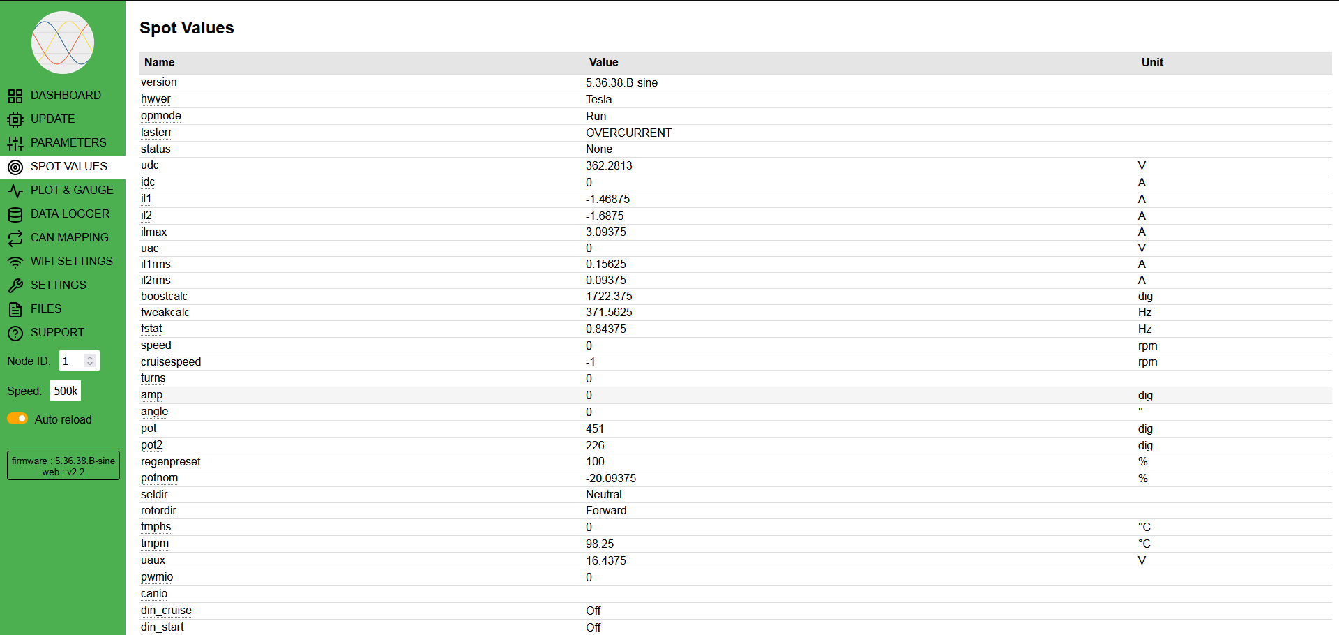

Is it normal that the ldu inverter stays in run mode, even if errors are present

I suppose the inverter was restarted after it tripped? Lasterr isn't reset then

The LDU is started via the VCU, this happens with every start, in the VCU at the spot values ​​it is shown that it is off, but in the LDU it is still set to Run, at least here on the desk
