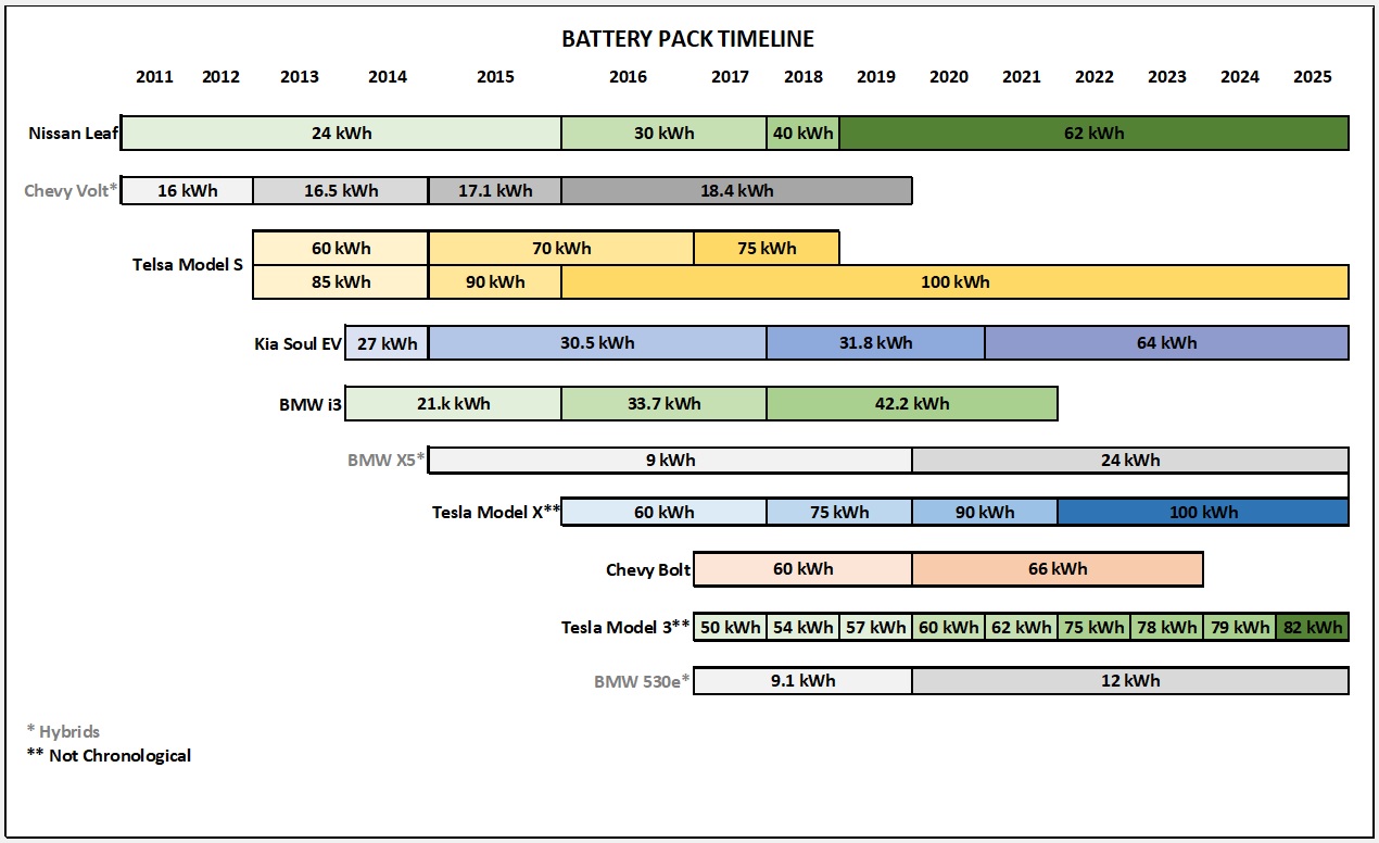

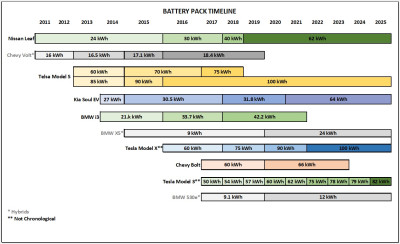

This may be useful to someone who is looking to jump in to the sport. Forgive me for the slight US bias as we do not get all the good cars as the rest of the world.
Top Tip: I use 3.5 miles per 1 kWh to guestimate my range out of a pack. In my personal opinion I think 100 mile range for an EV conversion using a 30 kWh battery pack is the sweet spot.
3.5 miles x 30 kWh = 105 miles of range
If you dig this idea, and would like me to add more vehicles, please feel free to post those cars below, this is a group effort.
(I hope to see this become clickable some day)
Battery Pack Timeline

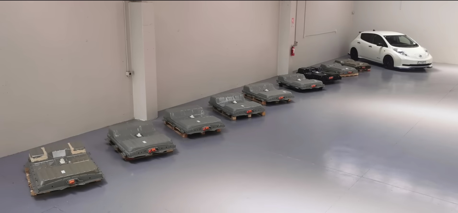

10 years of Nissan LEAF Battery Evolution (2010-2020)
