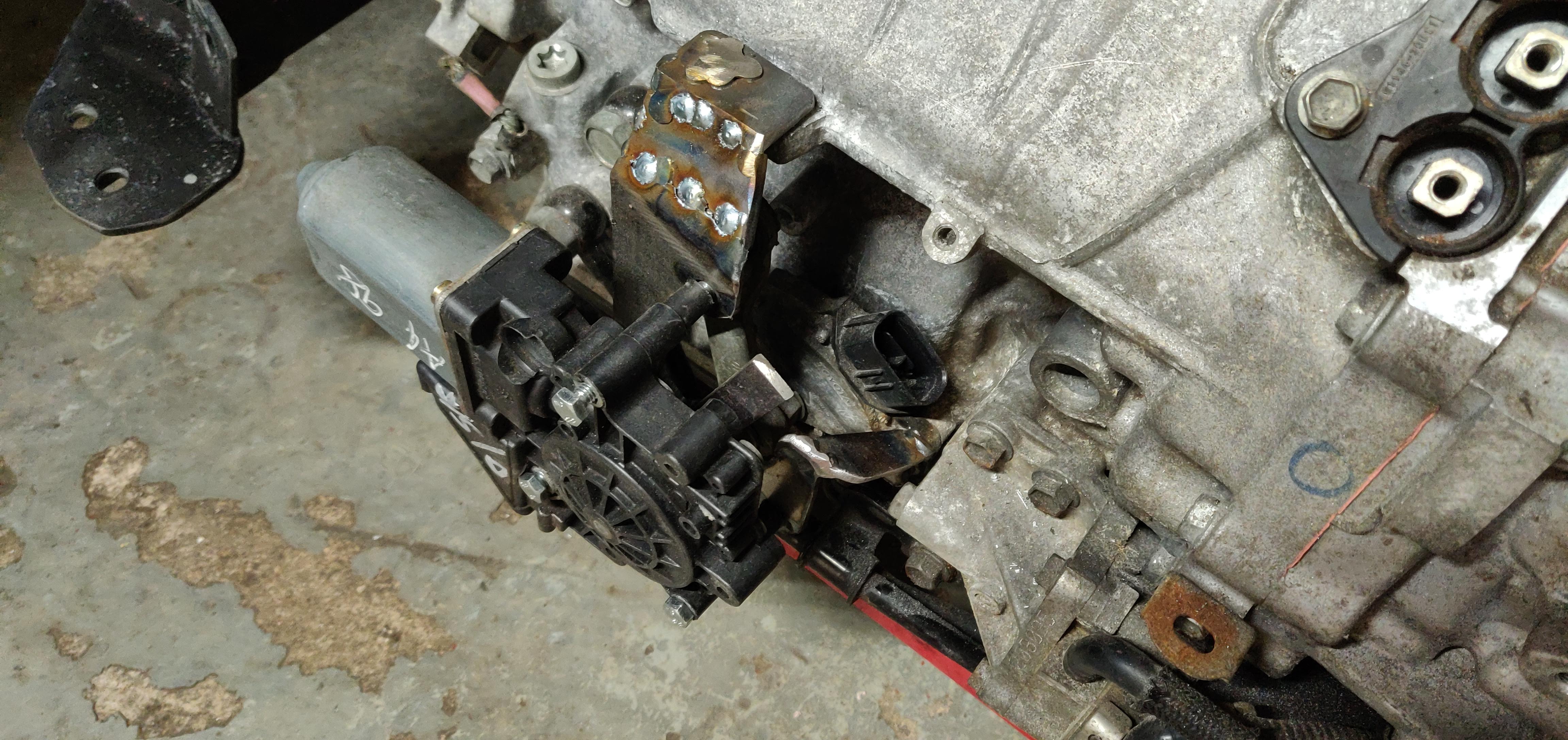

I used a window motor from an Audi A4 (cheapest on eBay) connected to where the GS's shift lever used to fit. The PRNDL switch on the side of the gearbox provides feedback telling the motor when to stop turning.
The Audi A4 unit has two relays built in, one for up and one for down, cross wired to provide the two directions. There was also a PCB with various IC's on there, it's likely CAN driven. I ripped out the PCB and drive the relays diretly from digital outputs via a MOSFET and some protection.
If you use a dumb motor then you'd need a H bridge, relays, etc to handle control. Maybe a stepper motor would be a good solution. The window motor was good for me as it comes with a gearbox already and is quite compact. And cheap.

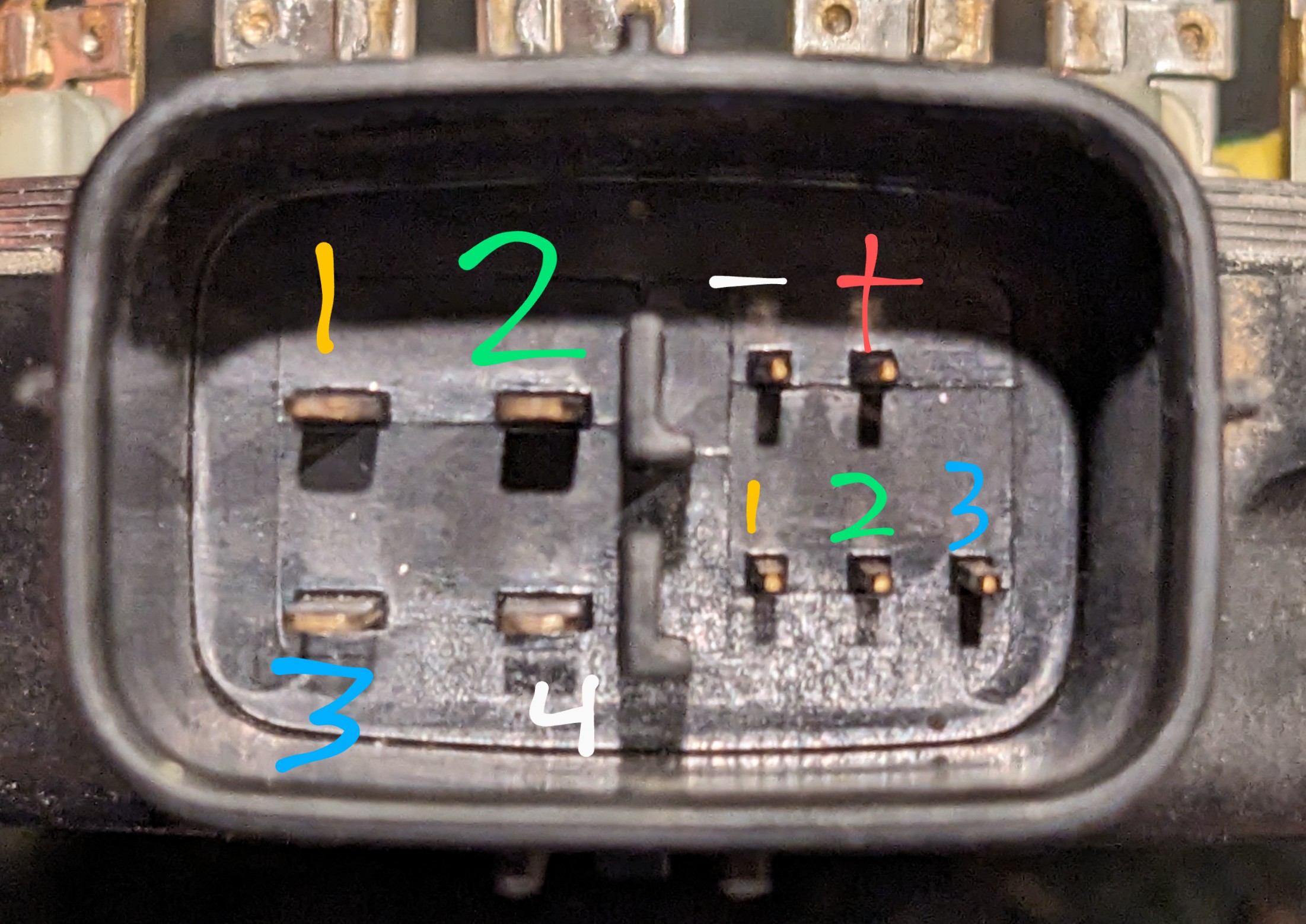

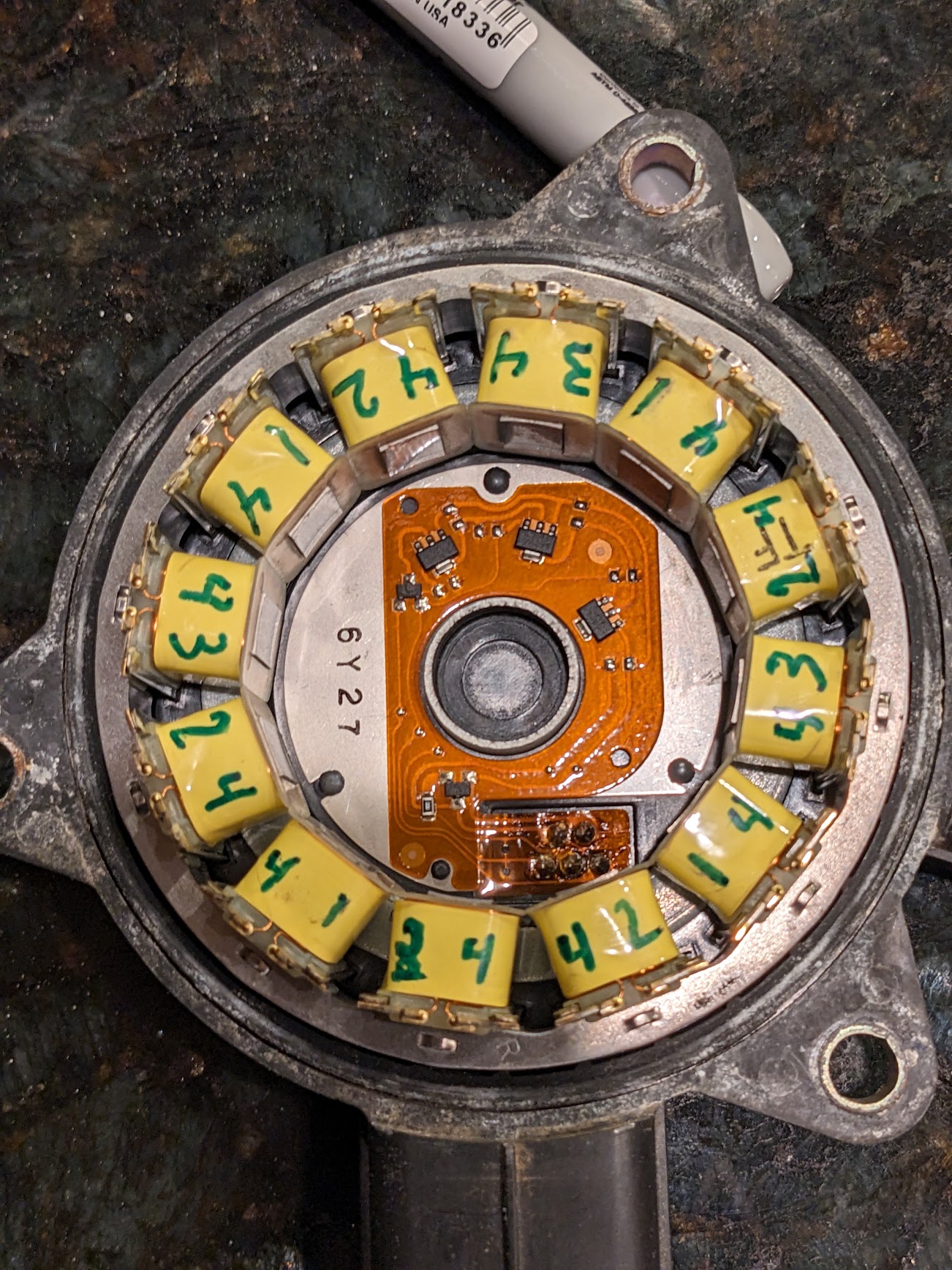

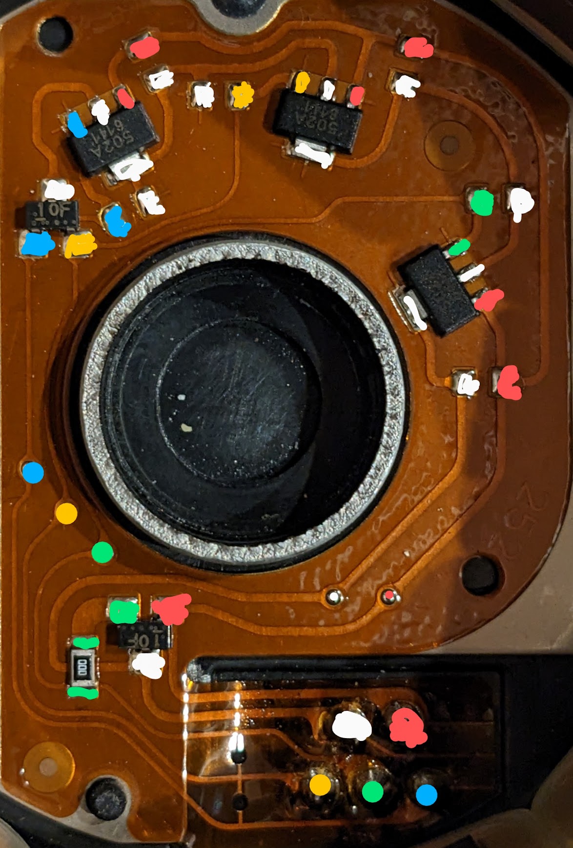

I'm going to assume most Toyota hybrid parking brake actuators are relatively similar. Here's how the Gen 2 Prius motor works.
Basically it's just a 12v stepper motor. It has 3 phase wires and a common wire.
The 4 larger pins are the motor. Pin 4 is ground. Pins 1,2,3 are the phases.
The smaller 5 pins are the hall effect position sensors. I assume it's 5 volts but it might be 12.
Looking at the diagram for the 502A hall effect sensors it looks like you need a 1.2k pull up resistor on the 3 outputs.
I was able to drive the motor with a simple program that just stepped through this sequence.
001,011,010,110,100,101
