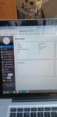

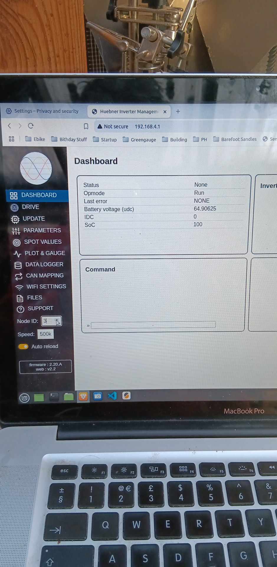

Re: Zombieverter 2.20 and OI board in a leaf gen2 80kw inverter - UDC
Right, I've got precharge sorted after managing to initialised the shunt and swapping to U1 on the shunt (It was originally on U3 which was likely the real issue).
Now I'm not getting zombie to switch the relay for the inverter on when going into run mode.
Are there any parameters, can mapping or other things that are required for the Inverter to switch on?
So far, I've mapped UDC, Speed, TMPHS and OpMode on the OI board as per the wiki. Not mapped anything else on the zombie, but presume the mapping isn't the issue. The relay has 12V going to it and then grounds via the zombie LS input.
The zombie dash following precharge The OI dash following precharge
Posts a param dump if you want help.
For some reason (dont ask me why)
if(selectedInverter != &openInv)DigIo::inv_out.Set();//inverter power on but not if we are in charge mode and not if OI-

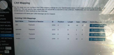

So Params from today after putting the bench setup back together...
No can mapping on either board although I have tried sending Speed, TMPHS, UDC and OPMODE from the zombie and receiving on the OI board which does get the OIboard into run mode. however these are not saved to flash upom restarting the OIboard
I do have a brake check status on the OI board this remains regardless of Canmapping.
OI board is only provided with 12V, GND and CAN H and L. nothing else is connected.
both boards are running the latest official firmwares.
On occsaion I have had a CANCounter error, I'm not 100% on what leads to this but think it may be when can mapping is set only as set on the zombie to send, nothing set to receive on the OIboard.
Let me know if anything else is required to help with suggestions on trouble shooting and I can get data.
When unpowered, my canbus resistance between H and L is around 40ohms which I know is lower than recoemmended but I'm under the assumption this shouldnt be an issue on a bench with short runs etc.
ok some progress,
I found the brakecheck error was to do with cruisemode. Turning this off got me into WaitStart and I got a spinning motor, however I am now getting overcurrent errors quite easily with the motor stopping suddenly.
I've had a little play with params, (attached my latest ones)
but still getting this issue.
I'm also not entirely sure which takes precedence over the settings of overcurrent and throttleramp etc. between the OIBoard and Zombie, or is it a tuning between the two?
Finally, I was expecting MotorDir in Zombie to control the motor direction, however this does not appear to be the case. Is this possible via the interface?
Thanks for the help so far all.
