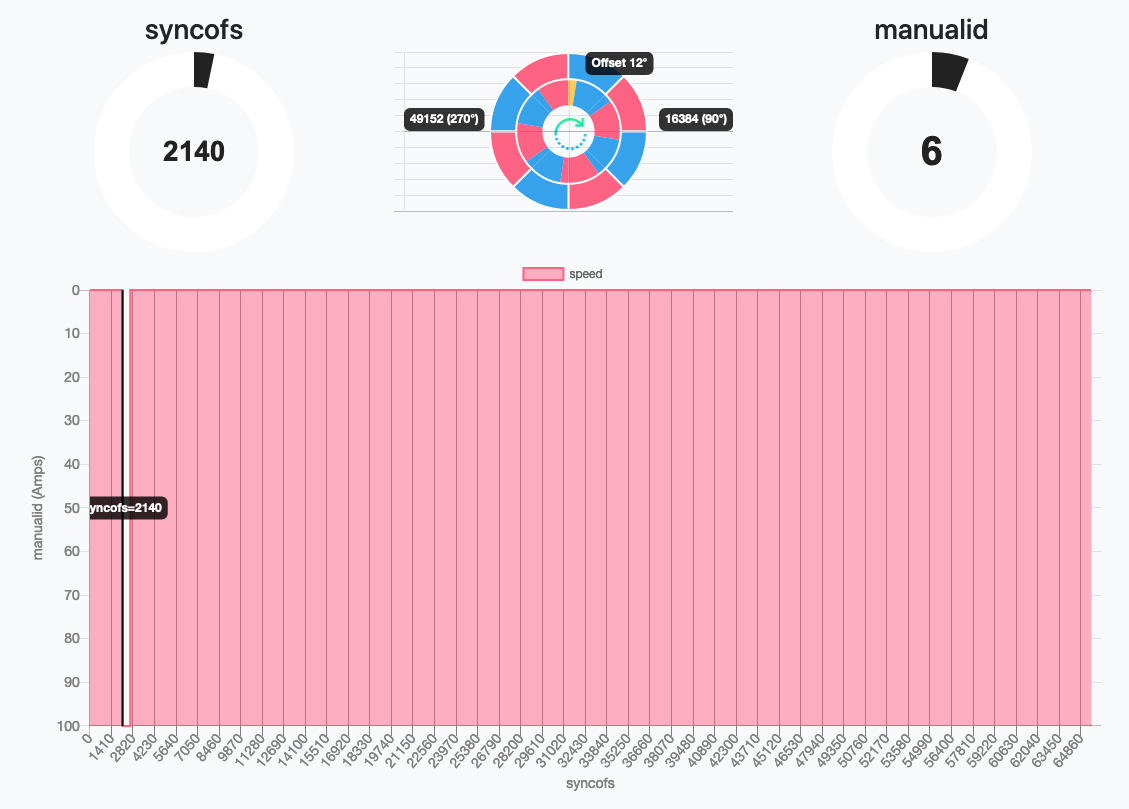

I have a small "tweak" and idea! But I cannot visualize it.
Maybe someone can explain in a "round" perspective how angle "looks like" relative to all those magnets.
I know that it is calculated by:
angle = (syncofs * 360 / 65536)
but how to visualize that? Is this diagram way off or am I on the right track?

I think maybe showing all the poles makes it too busy. Maybe only display it as a 2 pole motor and only 3 windings like this
