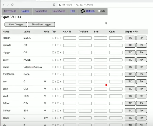

I hope you’re doing well. I’m currently running a Nissan Leaf drivetrain (inverter, PDM, and motor) with a ZombieVerter as the VCU. I’ve attempted to access the gauges through the "Show Gauges" option in the web interface, but after being redirected to a new tab, nothing is displayed.
I would greatly appreciate any guidance or assistance you can provide to help resolve this issue.

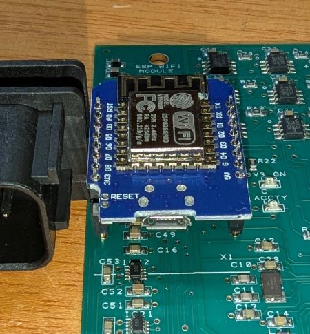

Are you using the CAN or UART based web interface?
Re: ZombieVerter Show Gauges Guidance
I’m not entirely sure. I received the VCU from Damien, and it came with the web interface already configured. I simply access it by entering 192.168.4.1 in the browser. However, I suspect that I might be using CAN. Am using the new recommended Wi-Fi as shown below
Ok. So that's the usrt backed. So which version of the UI do you have? Can you post a screenshot of the homepage?
Are you checking the box on the parameter screen for the specific parameter you want the gauge to display?
As Robertwa says. Select the parameter/spot value you want to display first.
have selected and it has worked . thank you very muchJacobsmess wrote: ↑Tue Jan 21, 2025 9:00 pm As Robertwa says. Select the parameter/spot value you want to display first.
