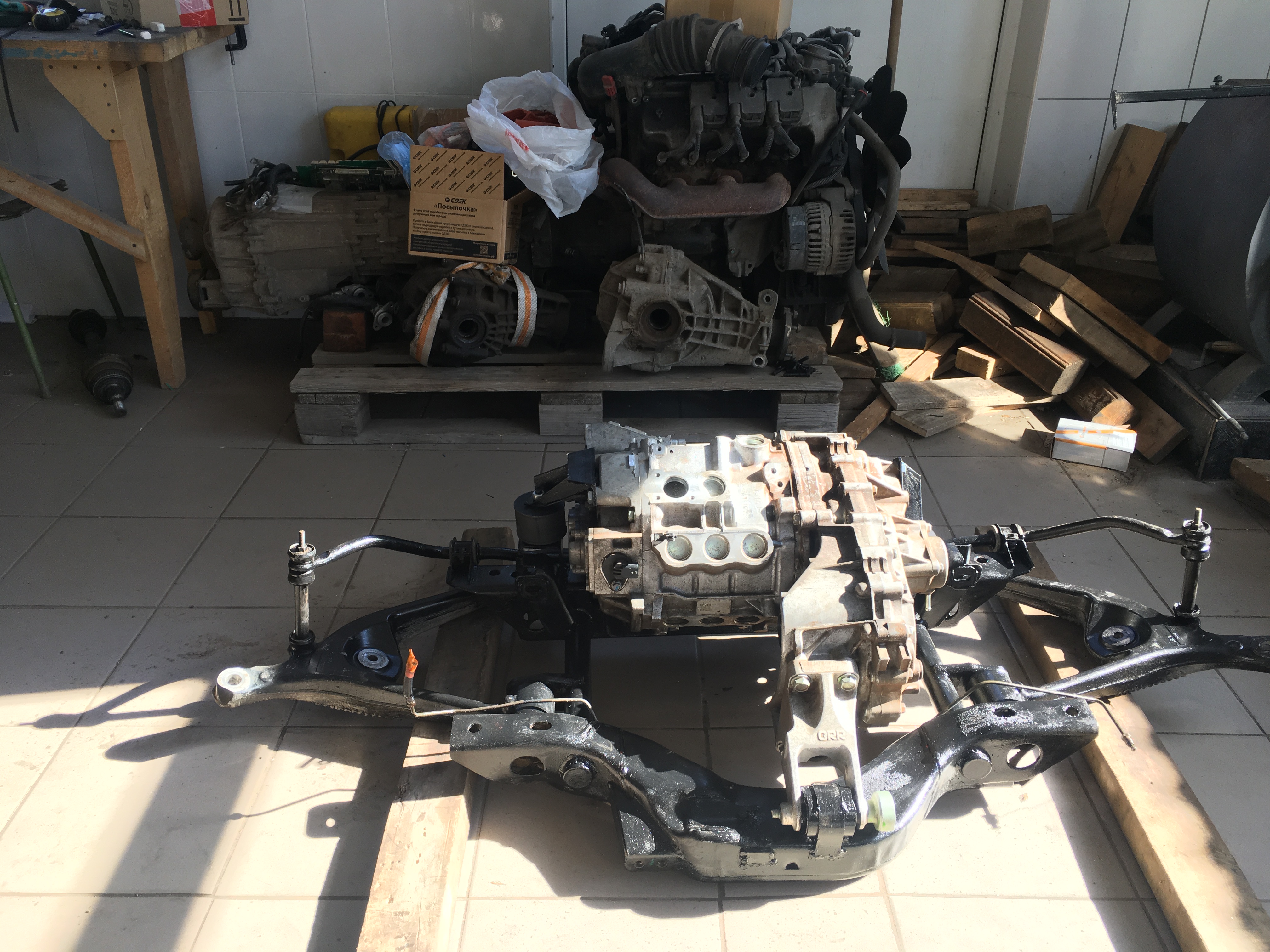

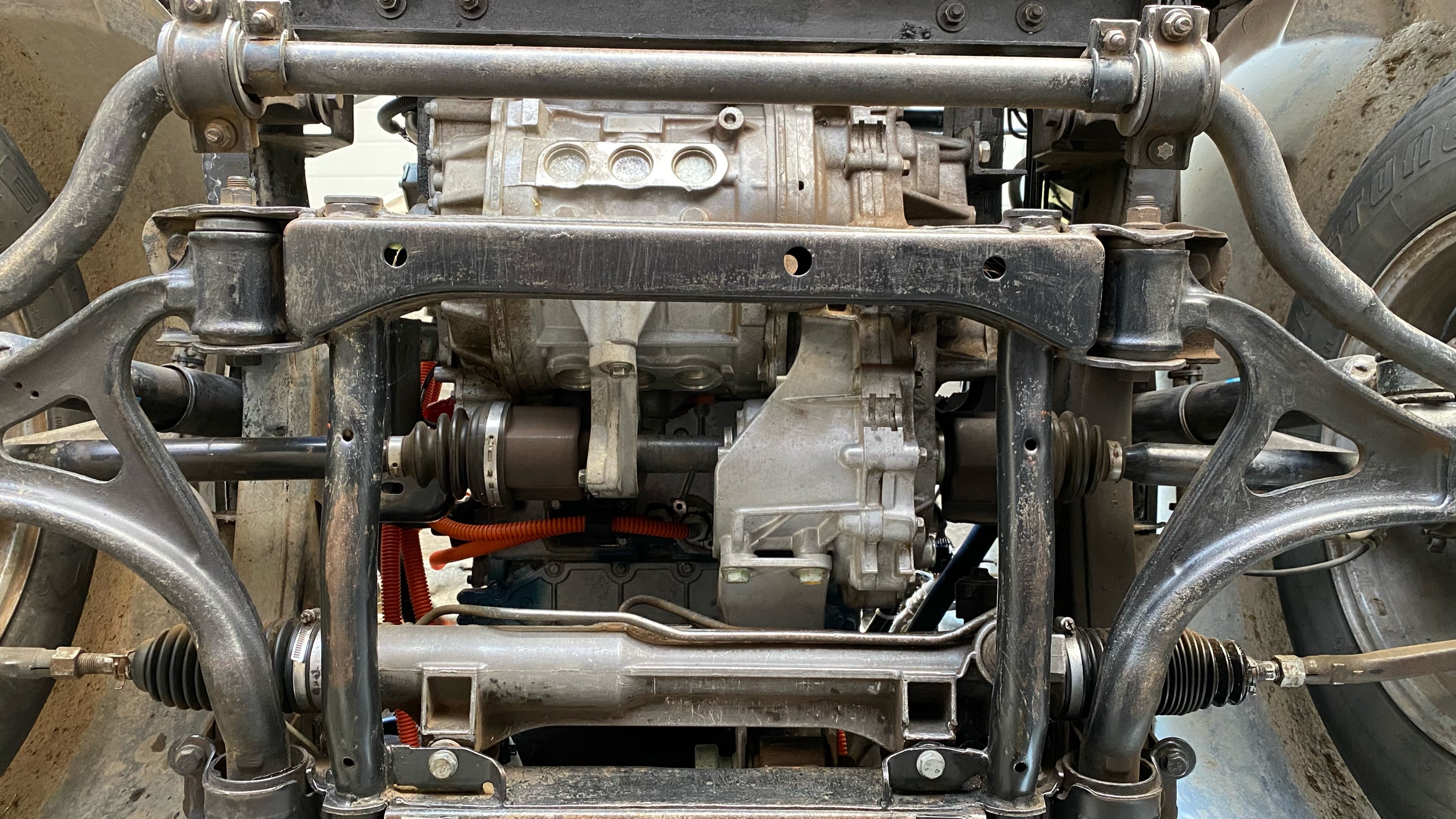

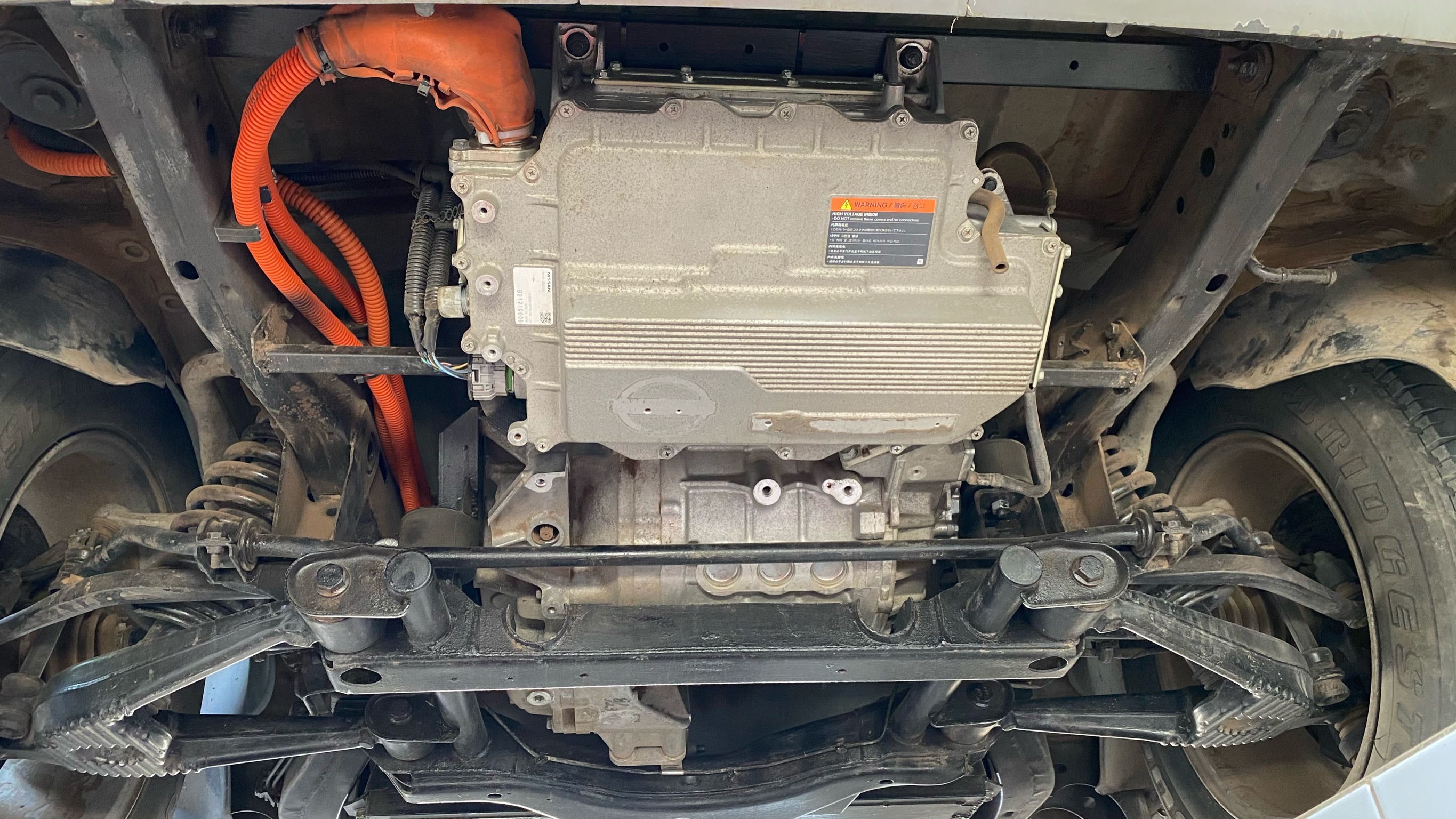

Riding on two motors is very good, for example you can turn on the motors in different directions.
Attached my old video, not sure if it will open.

What Motors are installed in your car? How do you controll them both? What happens if one spins faster than the other one? I would love to have an awd golf cabrio but I am kind of scared its two much power for this little car :)

Front and rear EM61, Leaf Gen1, the torque targets are the same, the total power consumption from the battery is limited to 100 kW.
On a slippery surface, one of the motors tries to slide, and here the standard ABS-ETS system of the car helps, it is highly advisable to start it.
