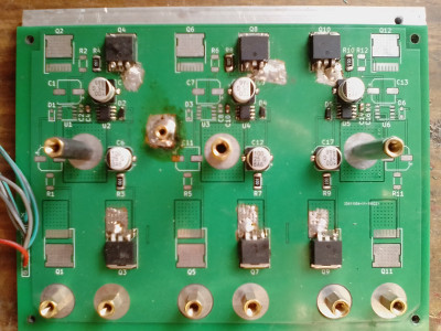

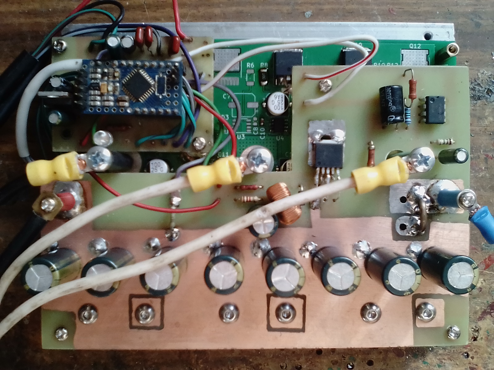

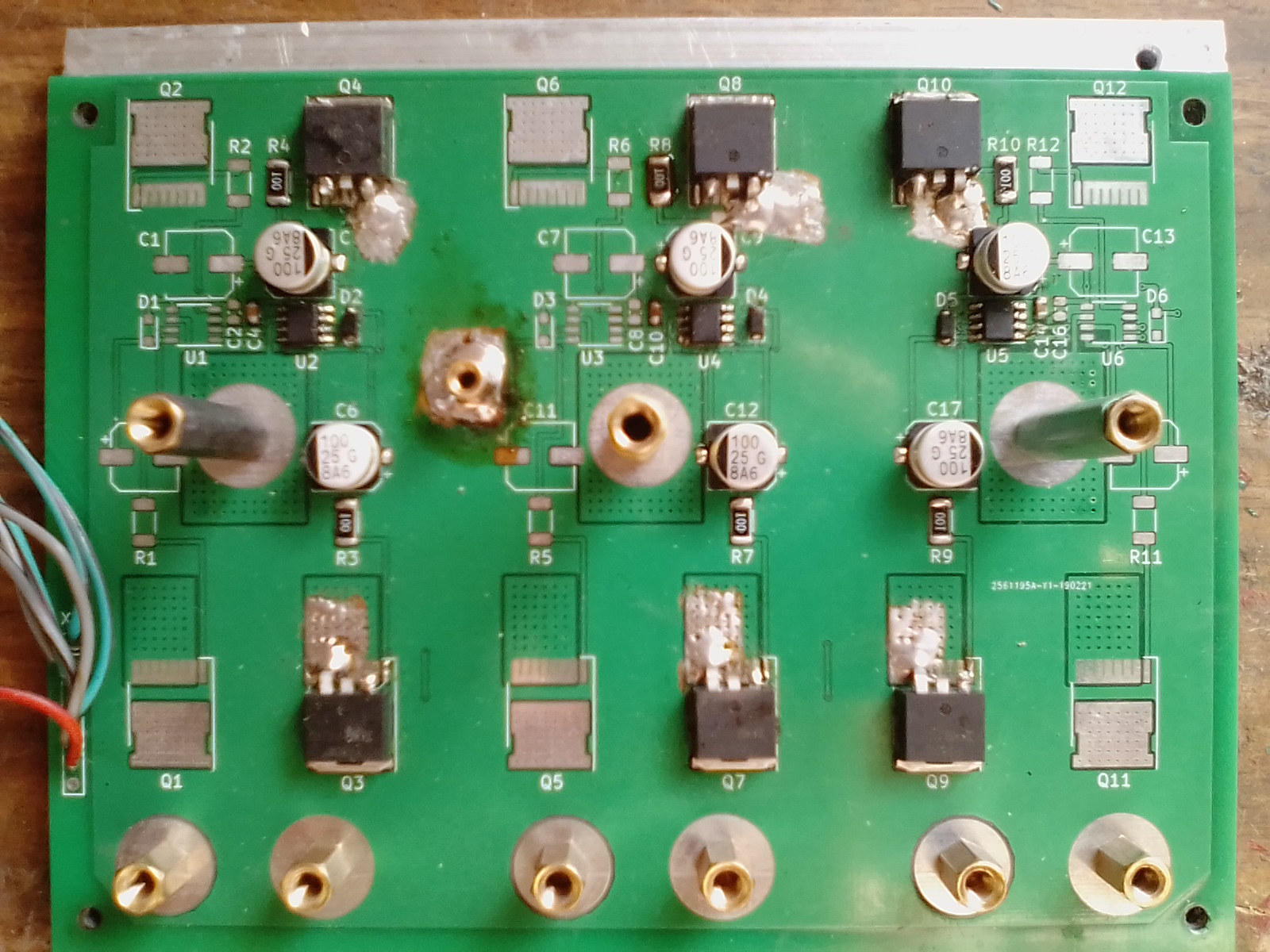

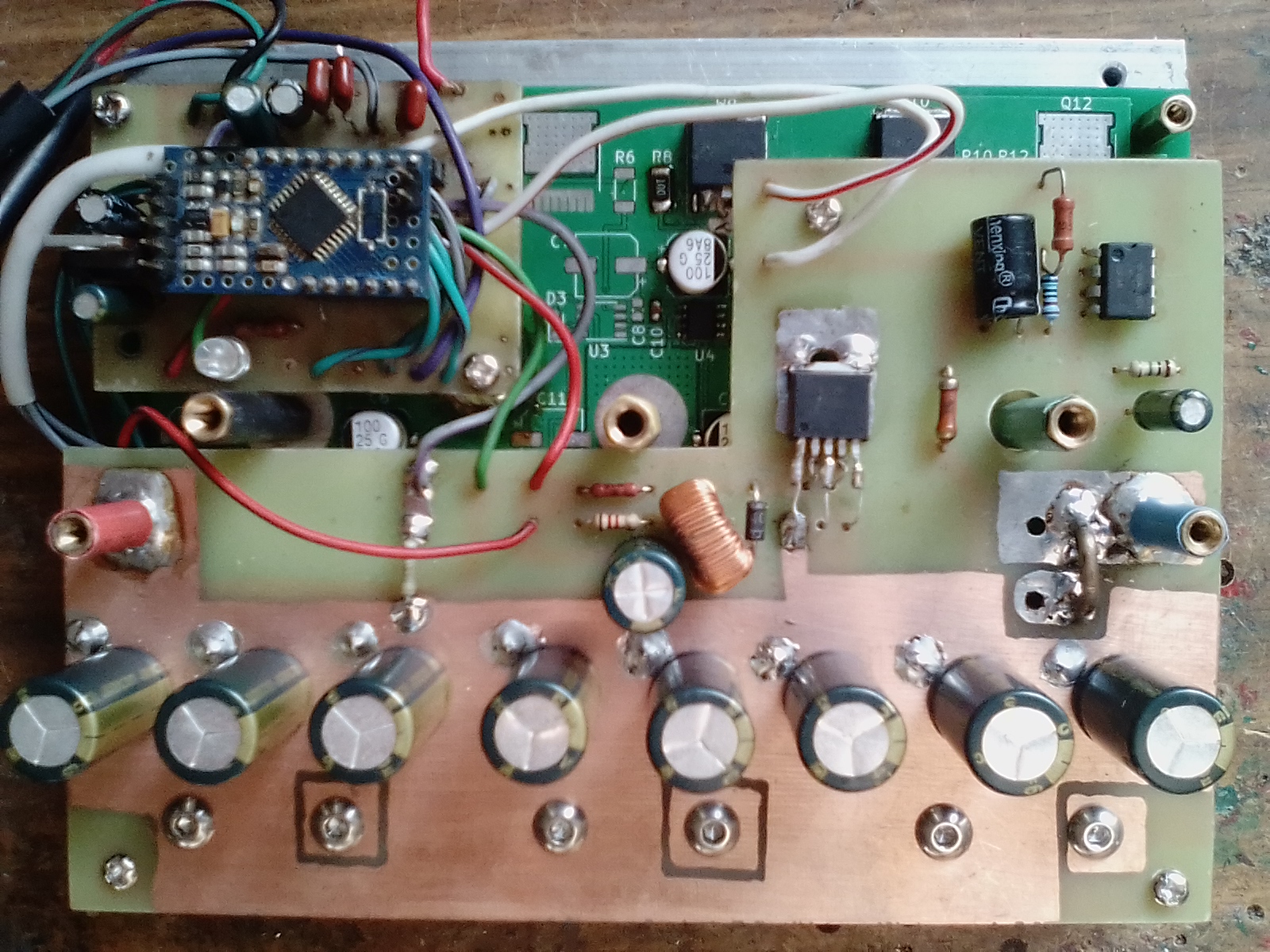

Long ago I began development of its controller, because I did not know many nuances, have developed the firmware in conjunction with a programmer at all on atmege328 in Arduino hardware, the development was used in a child's machine and the speed I got about 20km per hour on the engine 740вт achronim, firmware was the same scalar, but I came up with automatic torque adjustment on the current shunt, it turned out, the algorithm is a bit similar to vector, but still in the future, I could voimat momentum (autopodium) without using the encoder, the slide there was considered to be indirectly, but I liked the good acceleration dynamics in this firmware, if you remove the current correction on the shunt, the dynamics fell, the power consumption depended on the load, I understand that doing so is not the best way but it worked, and automatically adjusted the torque. But when the load increased, the speed fell and then I came up with the idea of regulating the slip by current, this gave its result and the speed began to stay stable under load. If you could connect an encoder to it, then it would be easier, but unfortunately it lacked timers. When you press the gas pedal, even with a small effort, the current was measured and the program adjusted the PWM filling and this regulated the torque.

If we compare it with scalar control, then vector control not only adjusts the phase current , but also the slip itself, depending on the load, this increases the efficiency of the engine, reduces the consumption of the battery in some modes.
This was the entire controller, but it is still working, although I have already reworked entire firmware in it

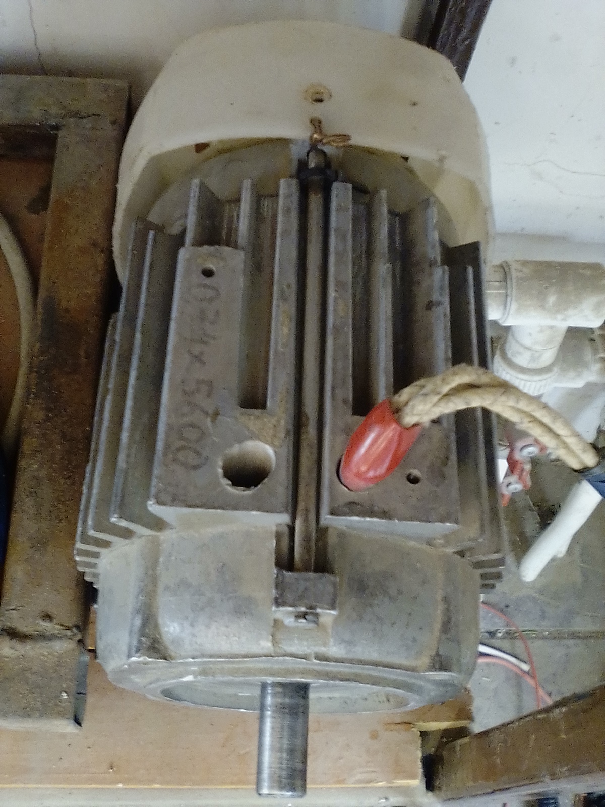

Vector control would expand the adjustment range, I think that then it would be possible to control the engine with combined windings, it has an extended range of control, vector control should solve the problem with torque, I can adjust the DA-90S engine to either very fast dynamics, but not expense of economy, or economy mode, but this reduces the dynamics, although you may need to add a couple of dependencies to the settings

Hi, Johannes. I got my hands on a 3 kW vector controller, decided to spin it, the acceleration dynamics of my go-kart increased, but the current from the battery also pulls higher. At the start, the torque is higher, I decided to find out why, I began to clamp the current on the phase and saw how I pressed the pedal, not only the phase current increases, but also the frequency of sliding when the engine has a jammed shaft on the torque wrench. How do you think it is possible to make such a function in our inverter?
