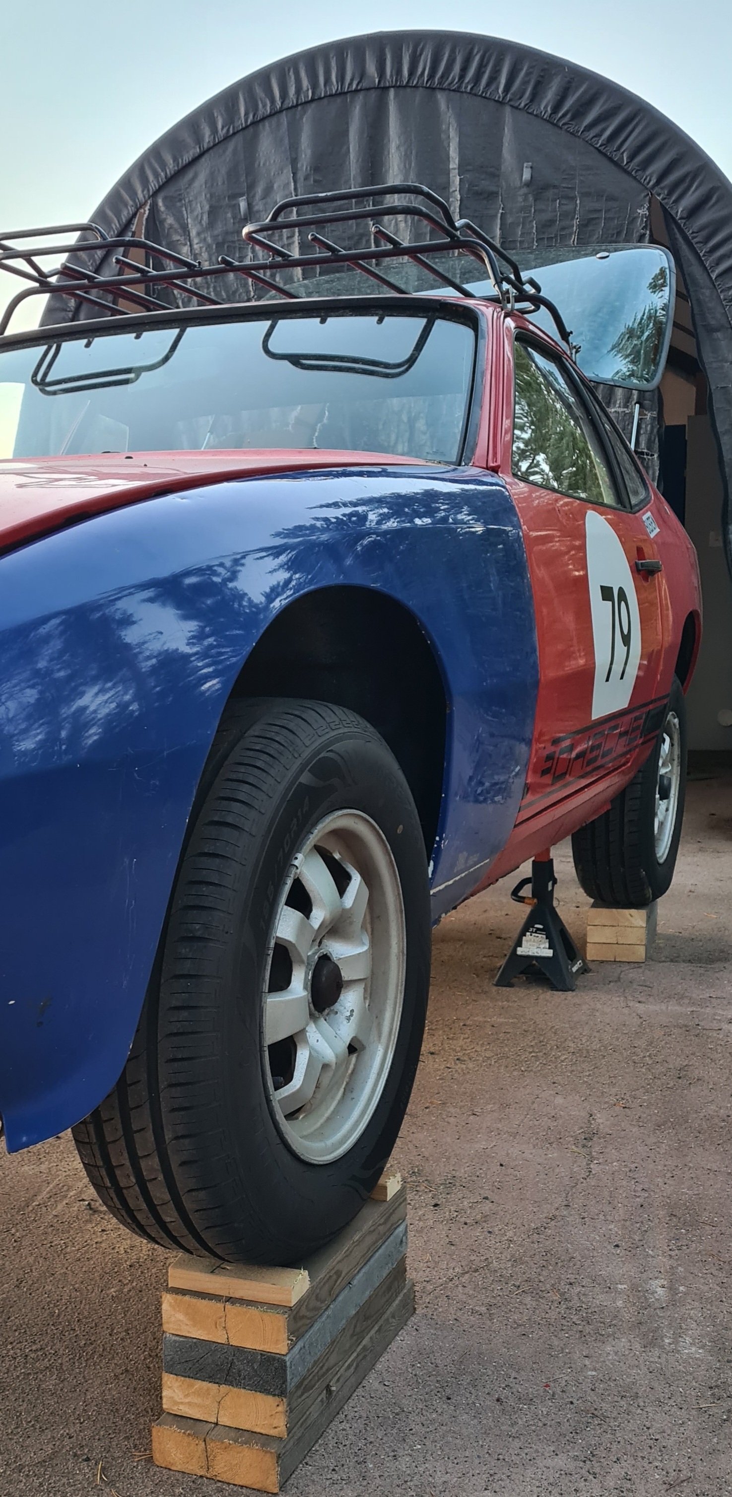

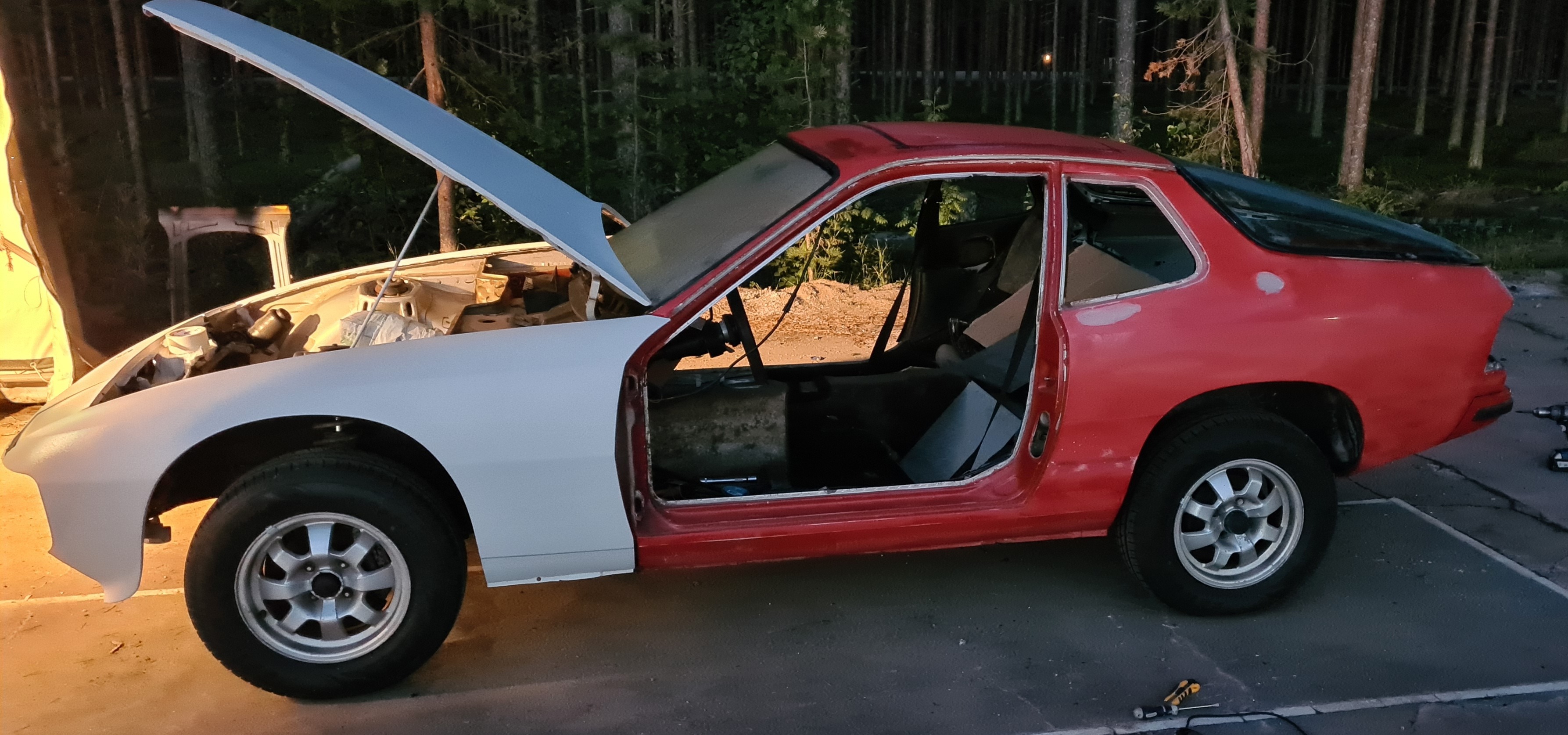

Time to share my project. I will be converting a 1979 Porsche 924.

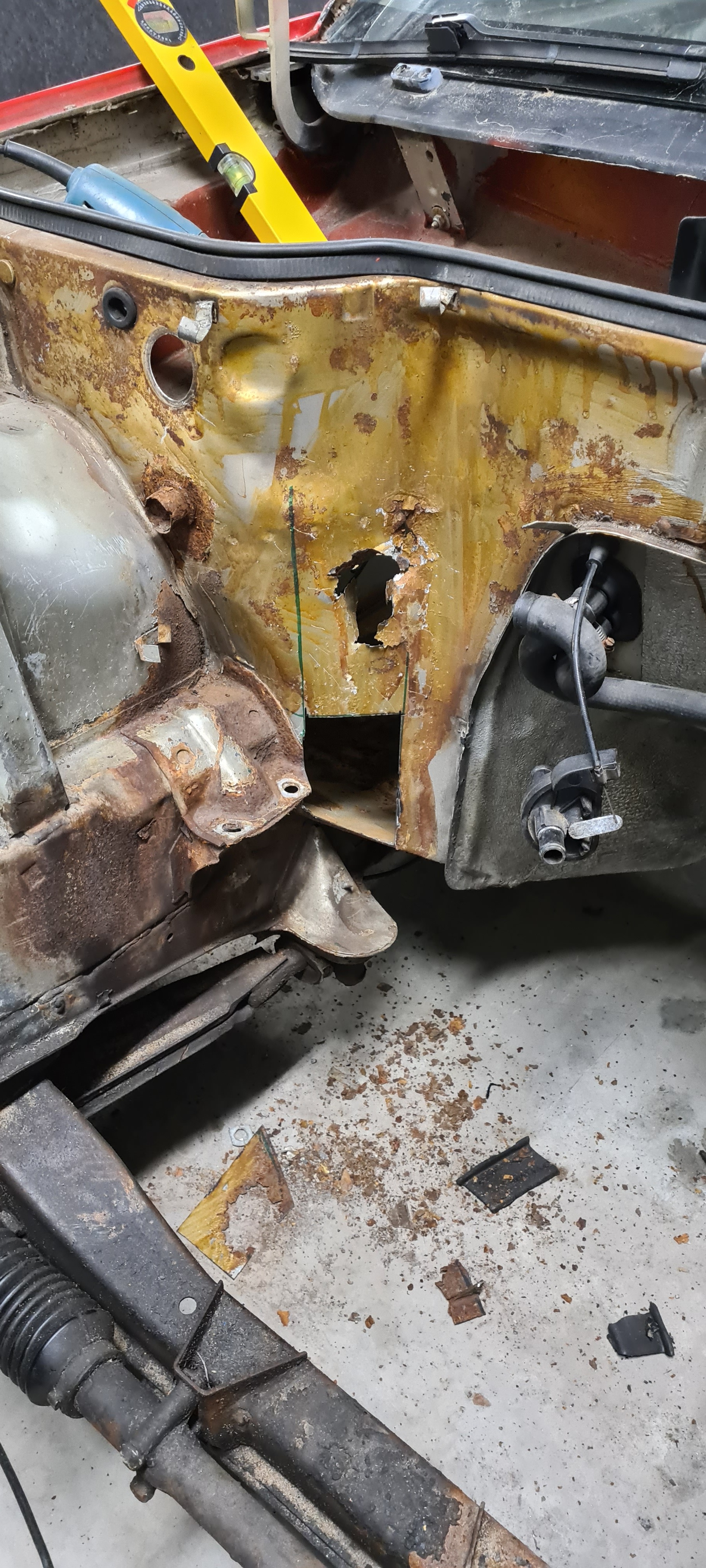

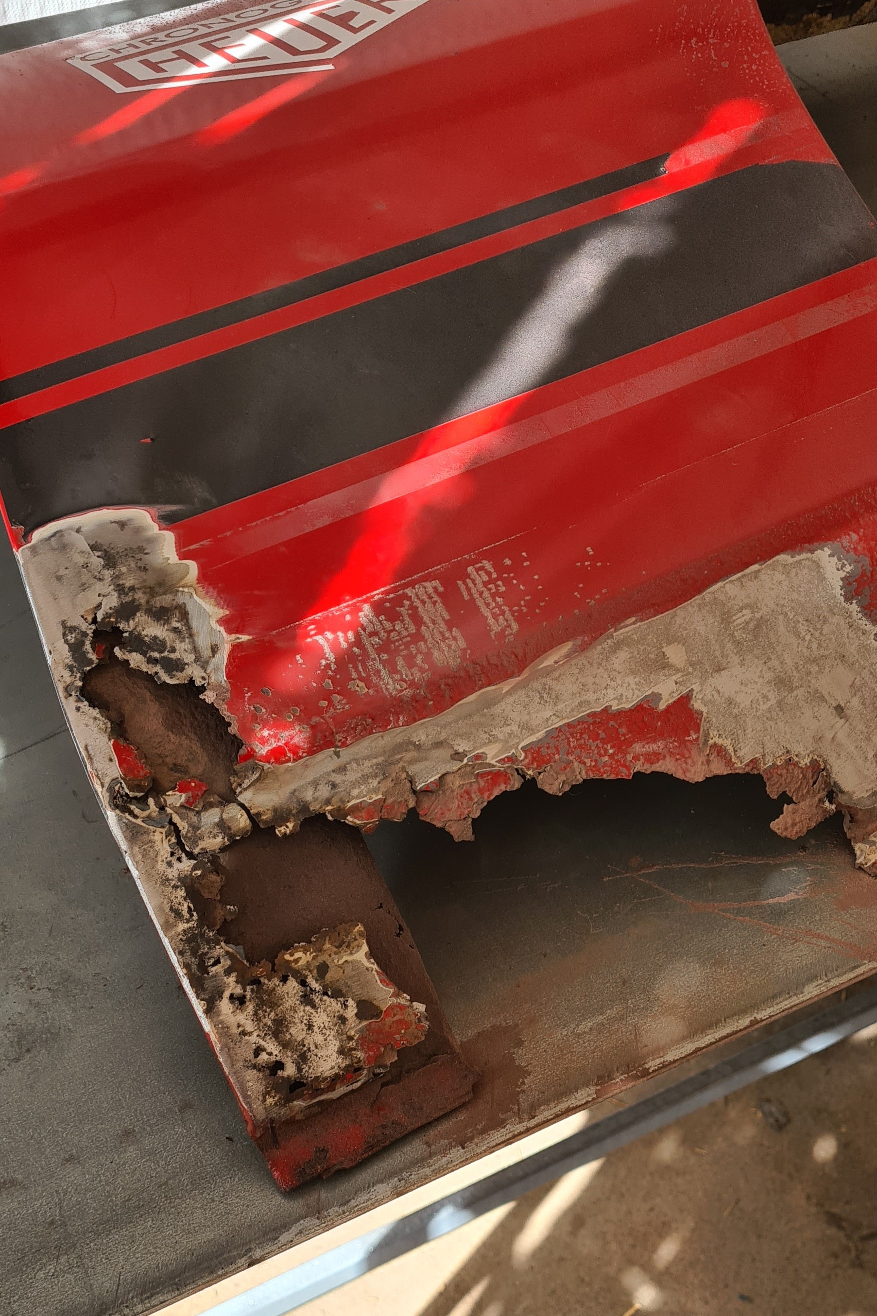

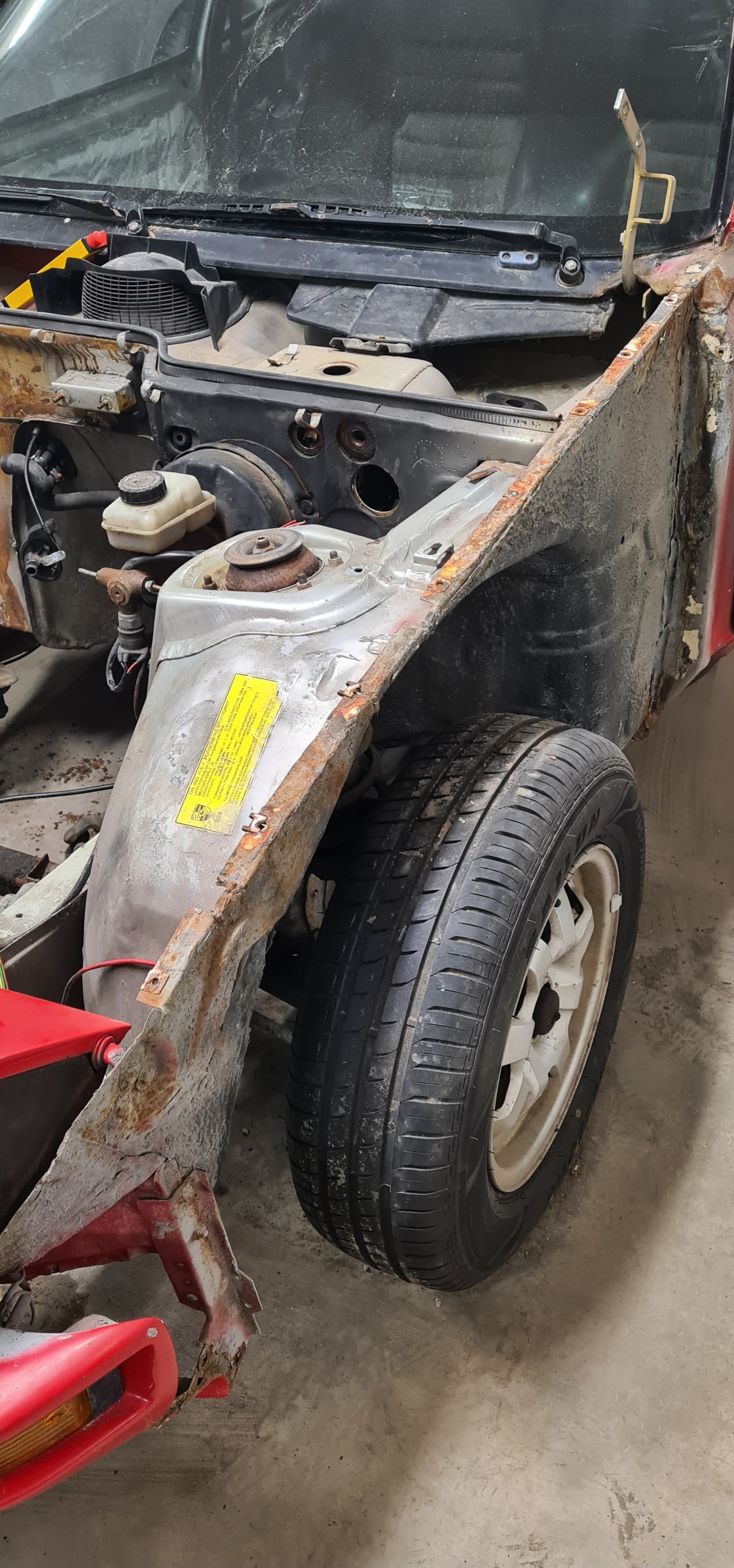

The goal of the project besides completing the conversion is to learn how to weld, restore and have fun along the way. The car was in very poor condition when I bought it and I have no experience with welding or fabrication. So it's taking time but slowly, slowly, progress is being made.
A large part of the project involves rust repair and I will be more or less restore everything on the car including a completely new 12V system.
-- Plan --

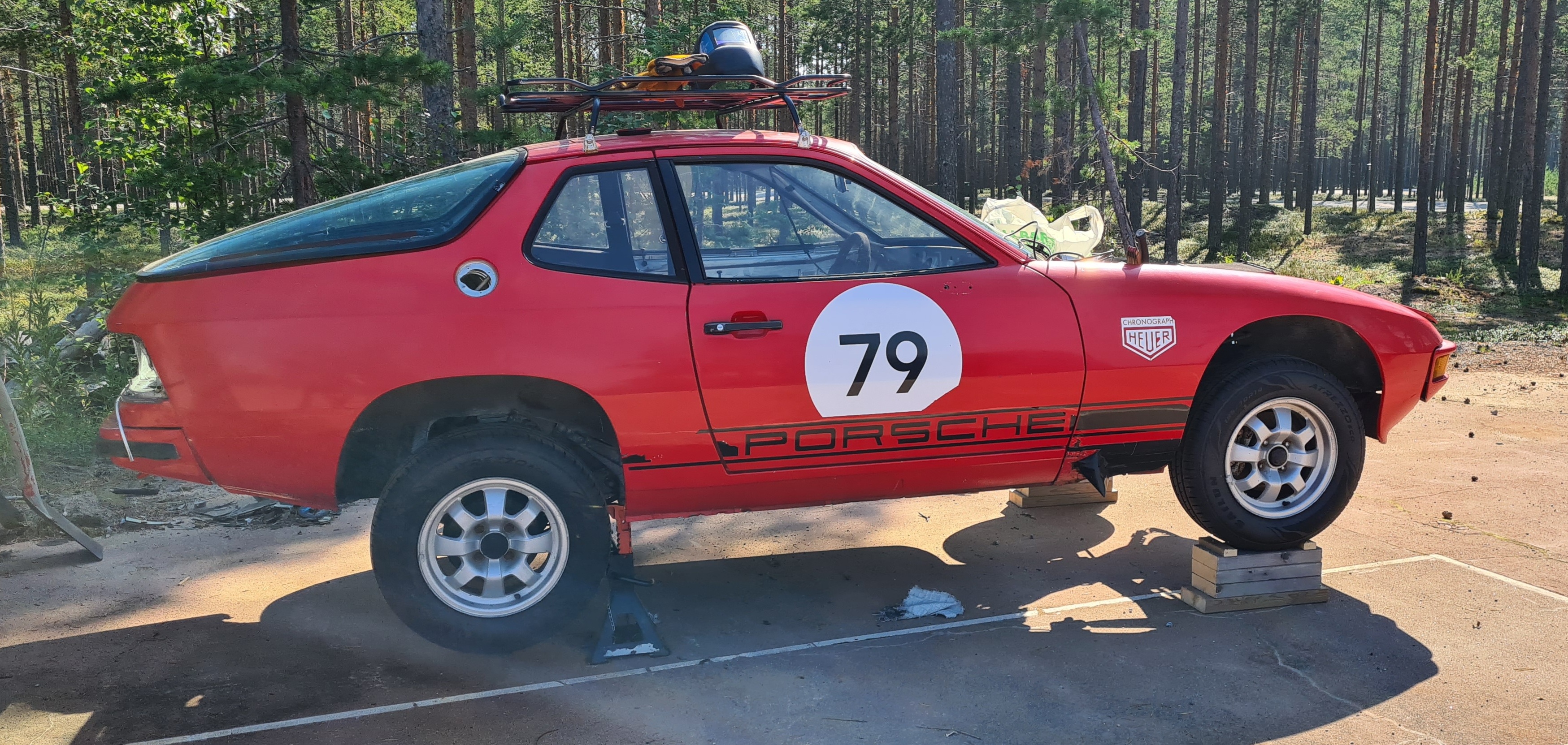

Car: Porsche 924, raised and with offroad tires. Yes I know! Bad combination for an EV :)
Powertrain: Mitsubishi Outlander rear drive unit and inverter.
Charger: MG ZS EV(?) 3-phase charger
Battery: 35kWh VW e-Golf battery

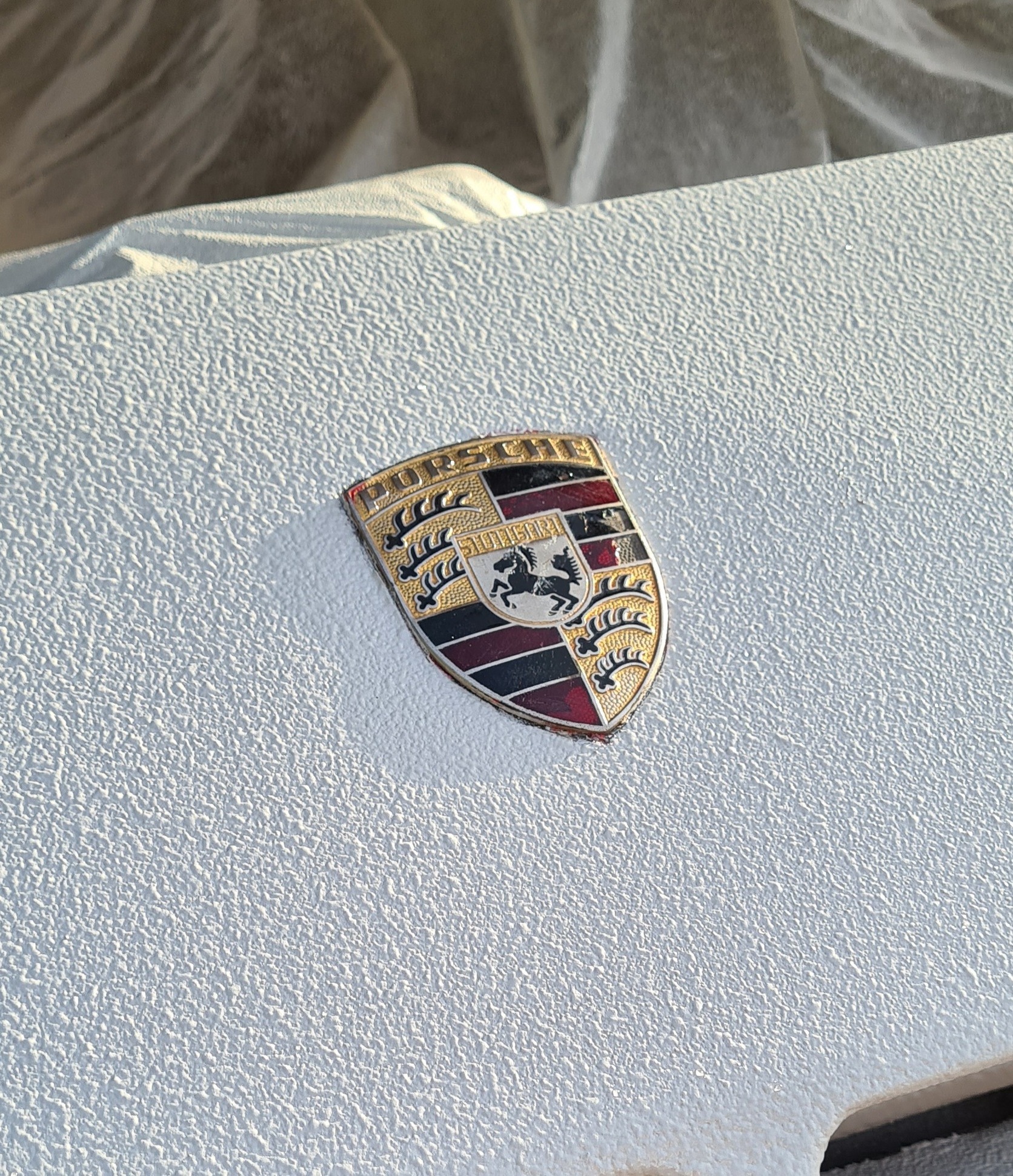

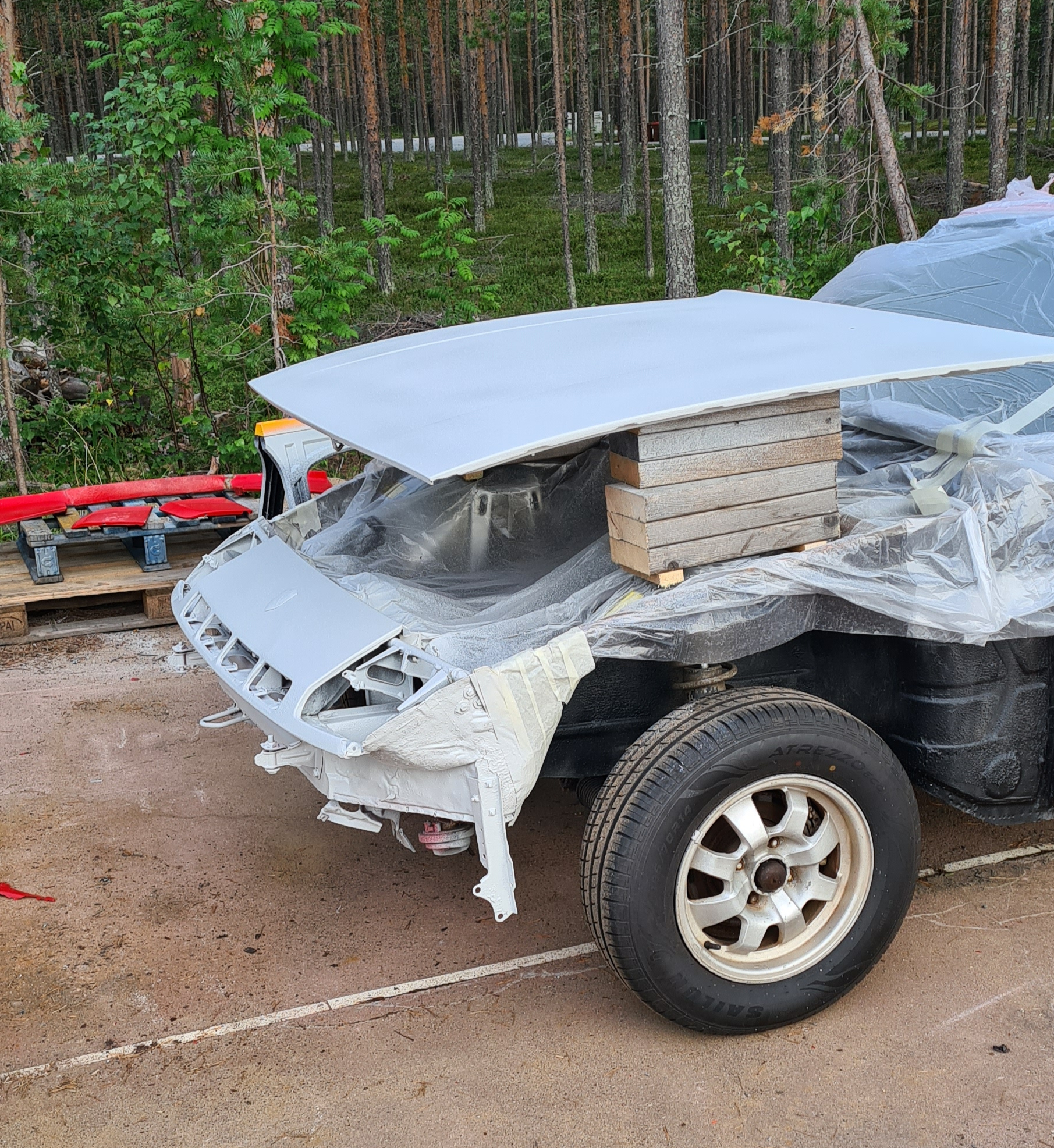

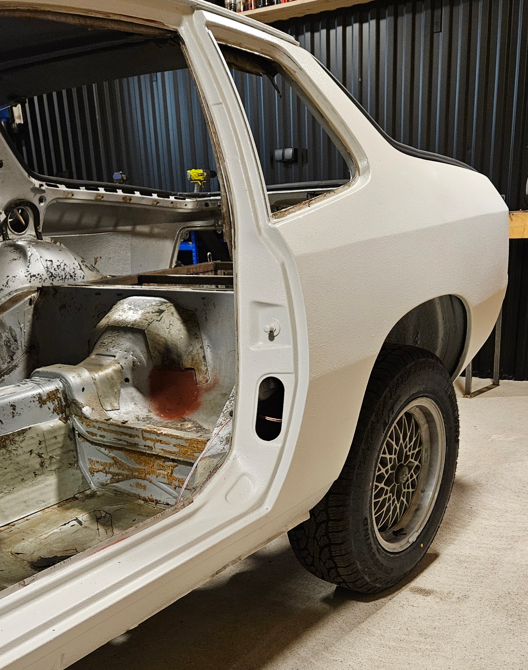

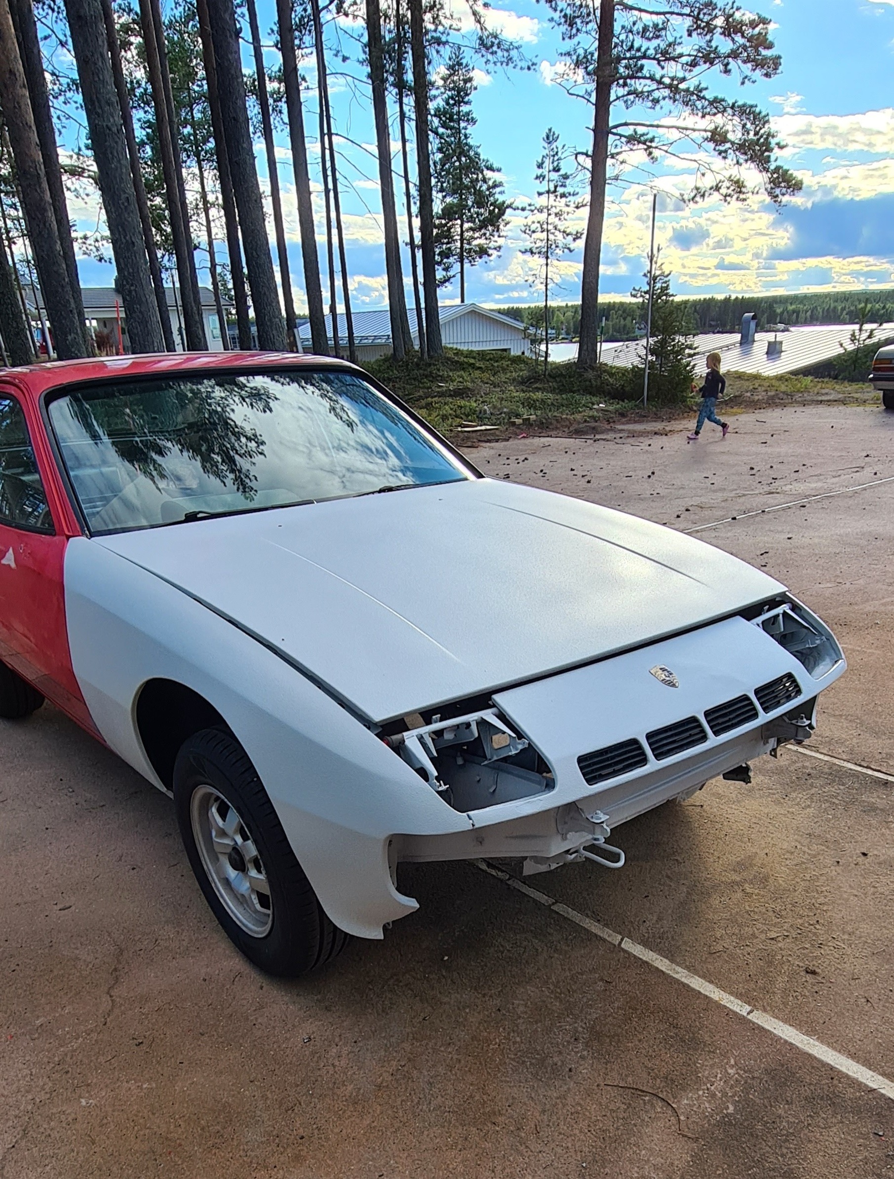

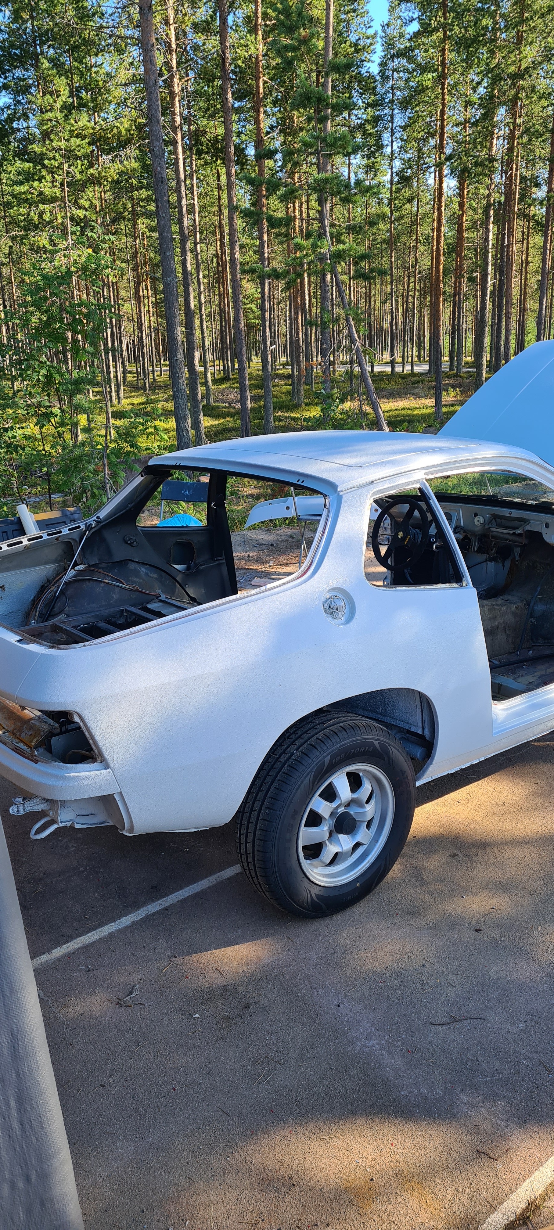

Repaint in white 2k bedliner.

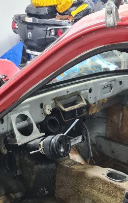

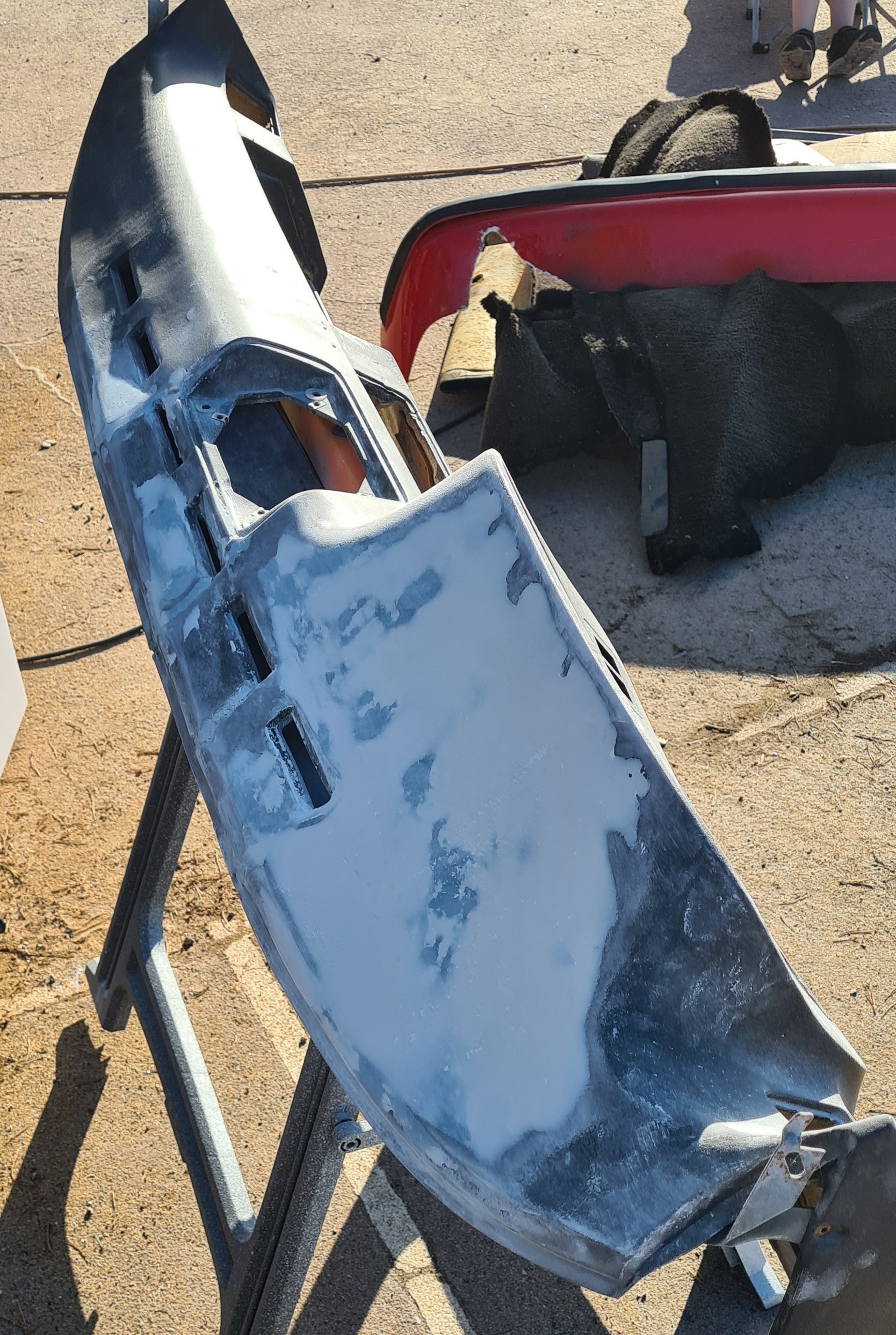

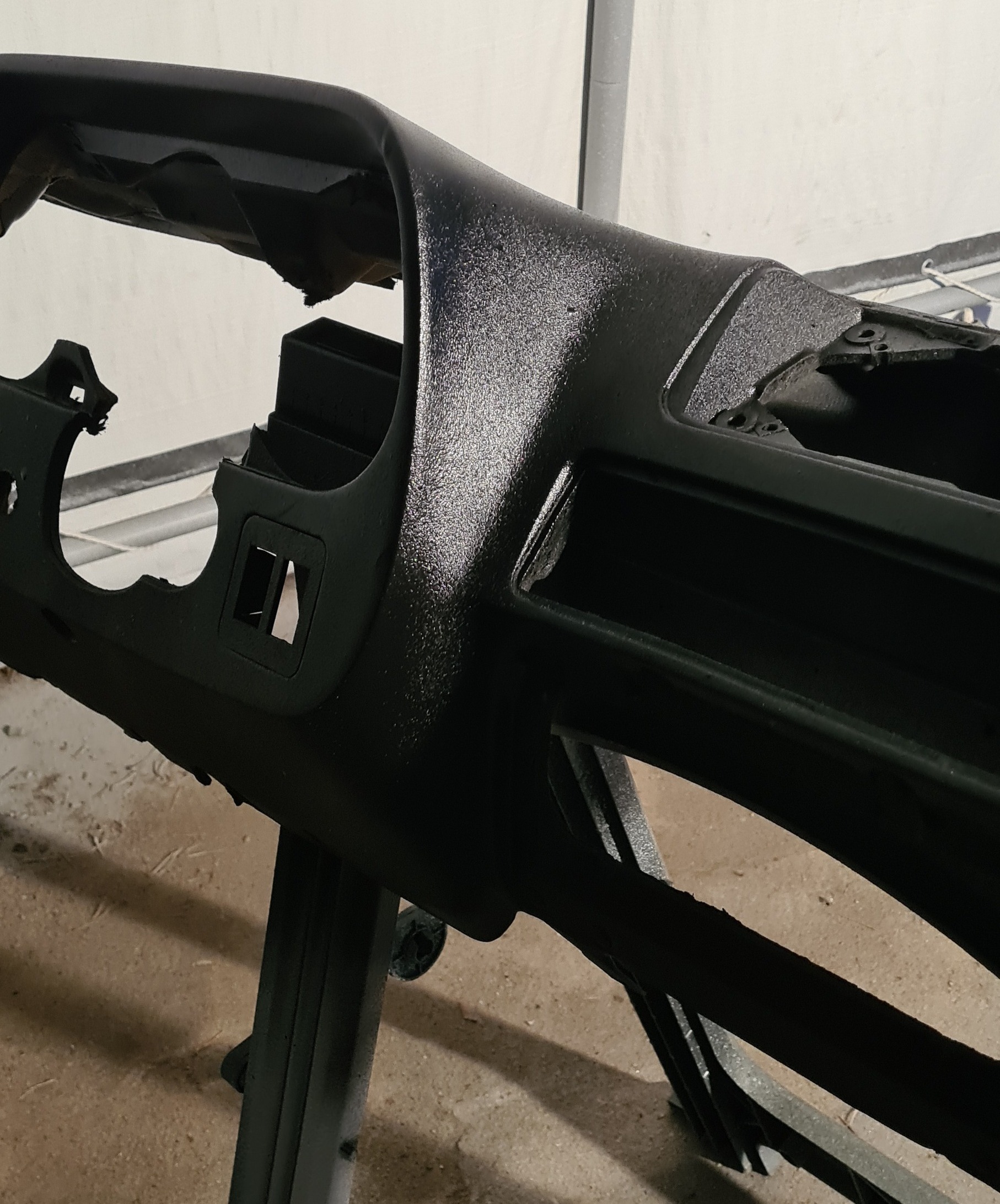

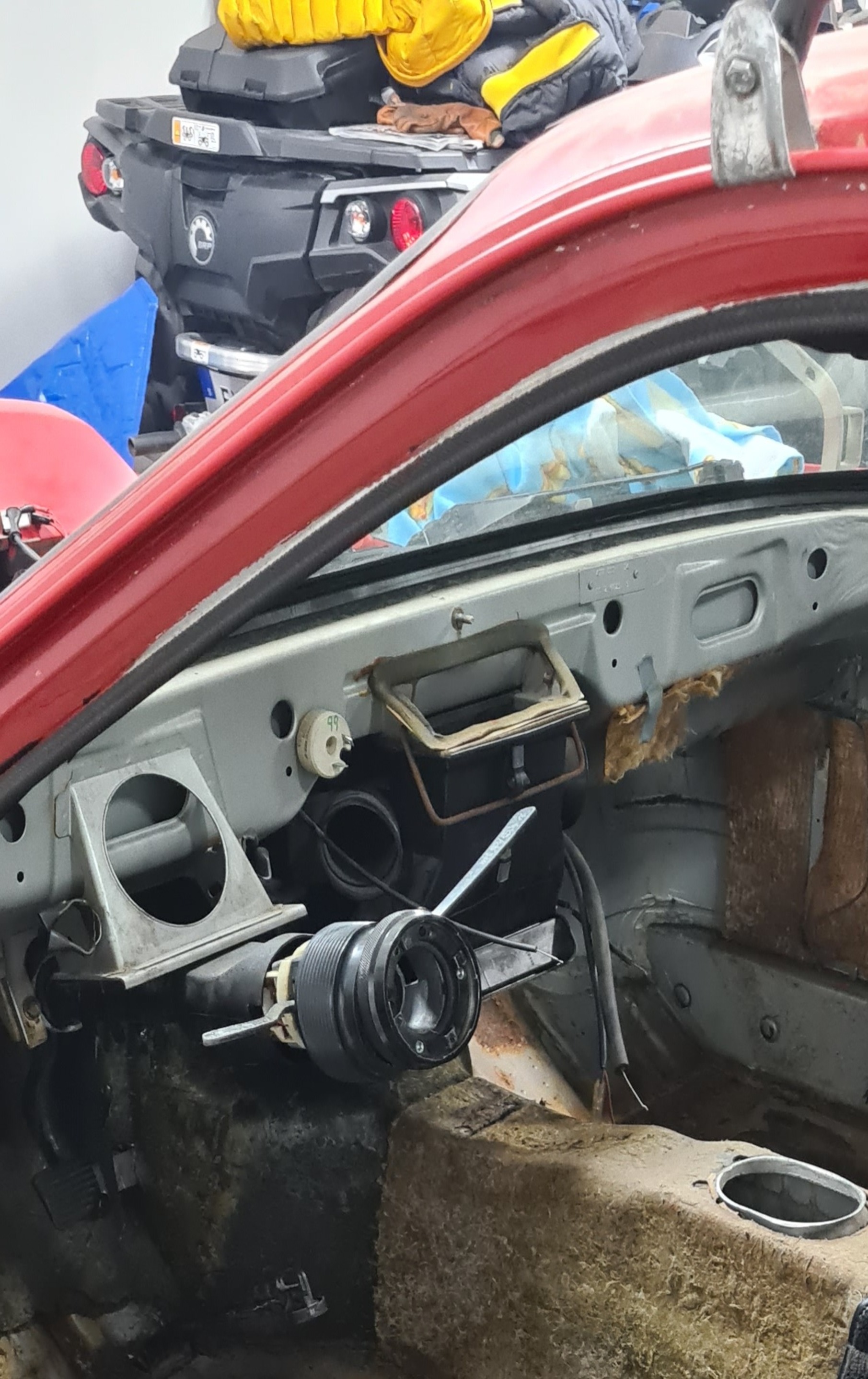

Dashboard restoration.

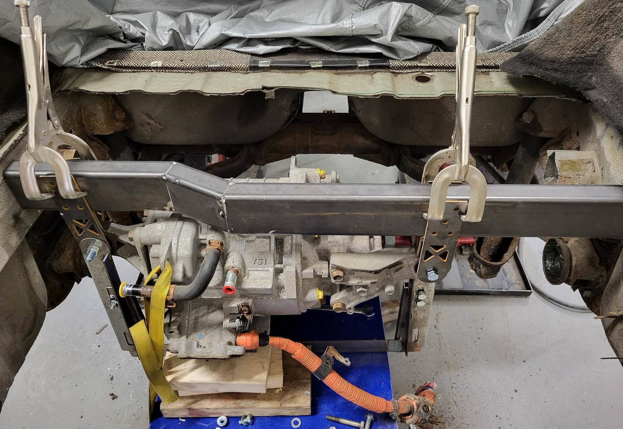

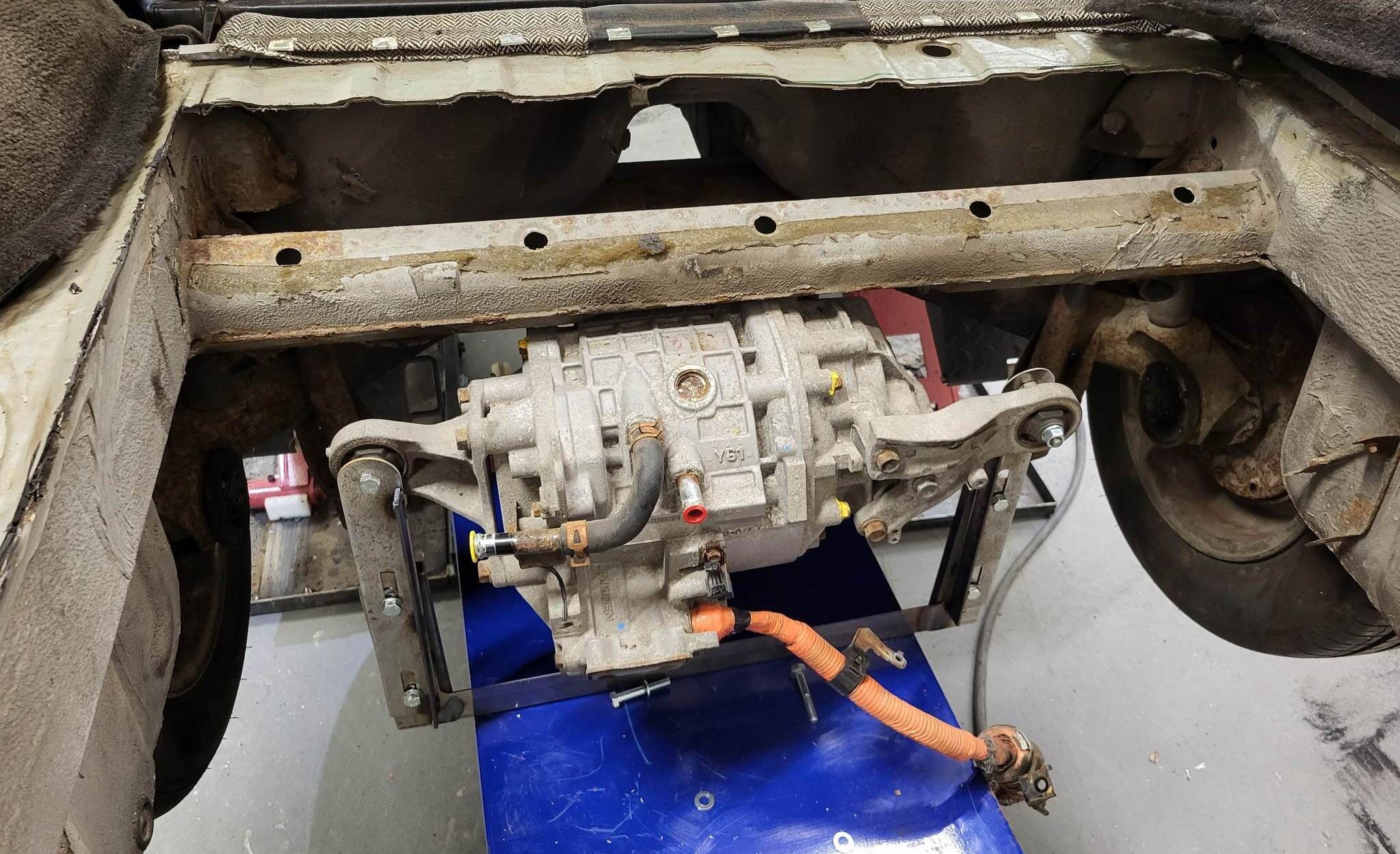

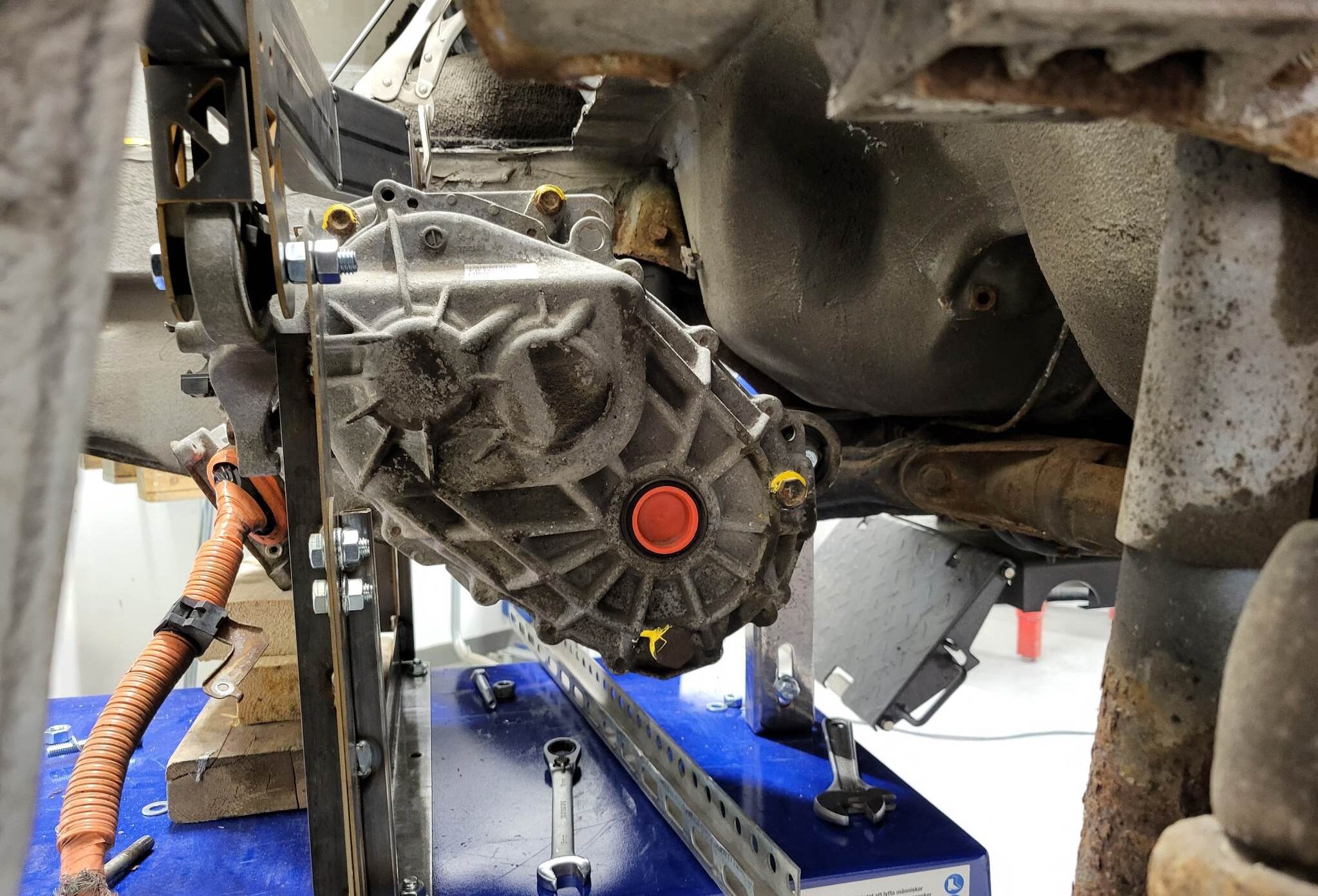

As I said, the goal is to learn. I will do all the welding with TIG but a friend was nice enough to step in and weld the motor mounts. I dont trust myself just yet to do the important welds.. :)
Posts: 1156
Has thanked: 246 times
Been thanked: 469 times
Re: [WIP] Porsche 924 Safari electric

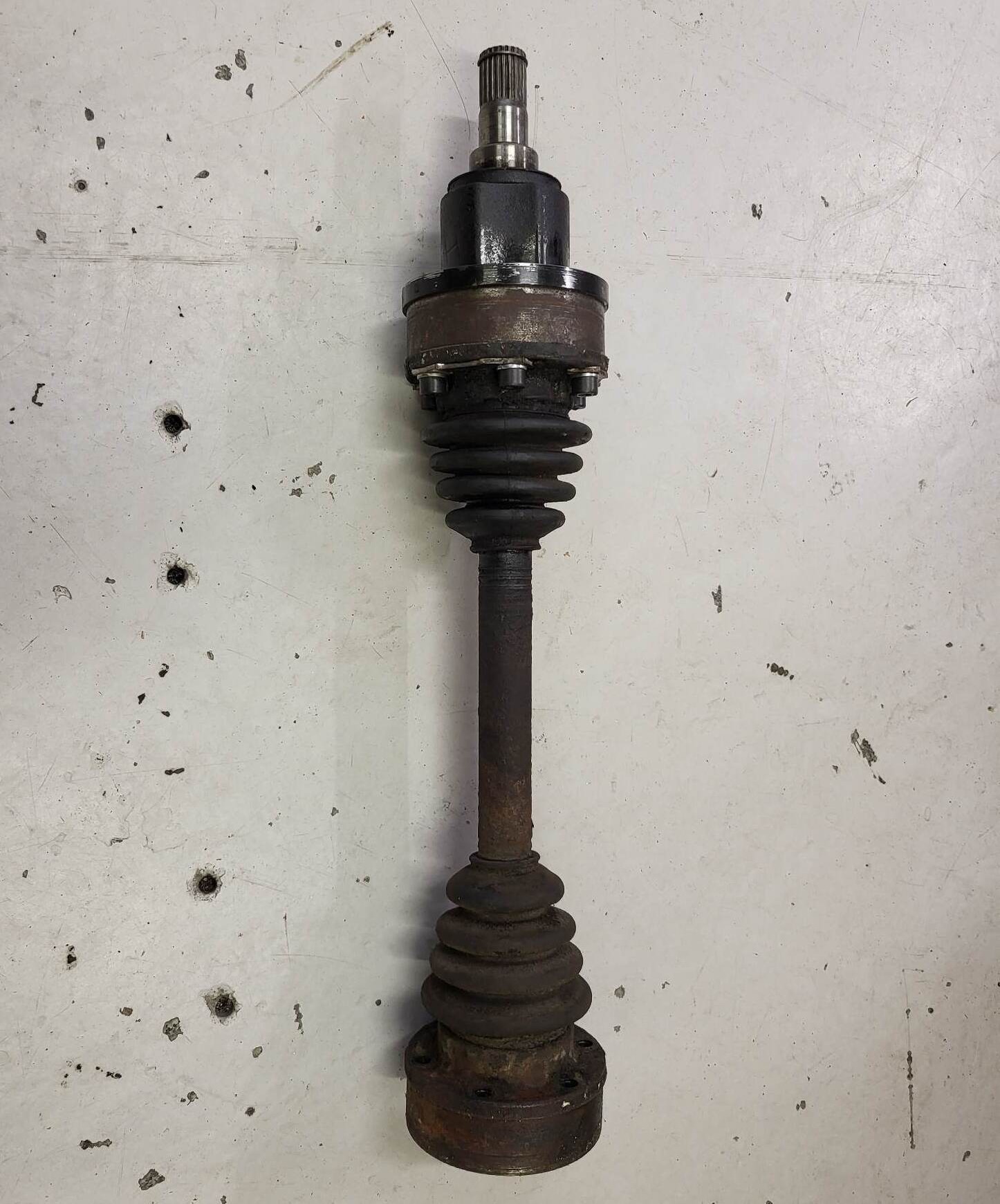

nice work on making drive shaft flanges instead of custom axles!

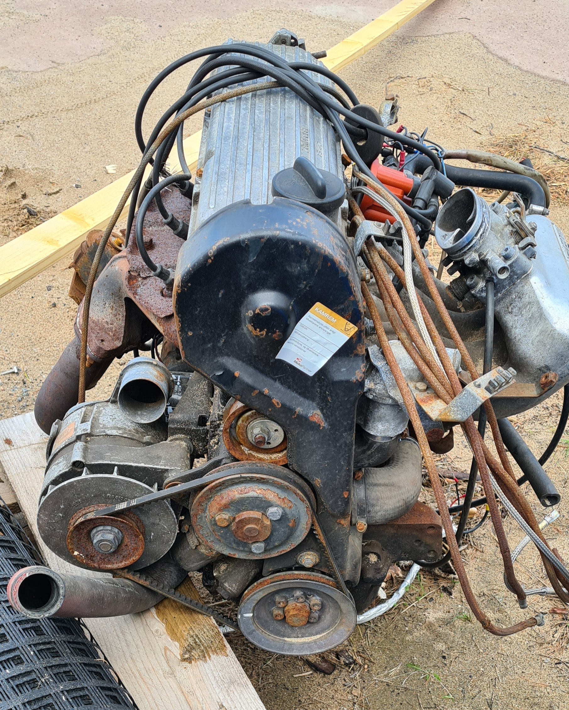

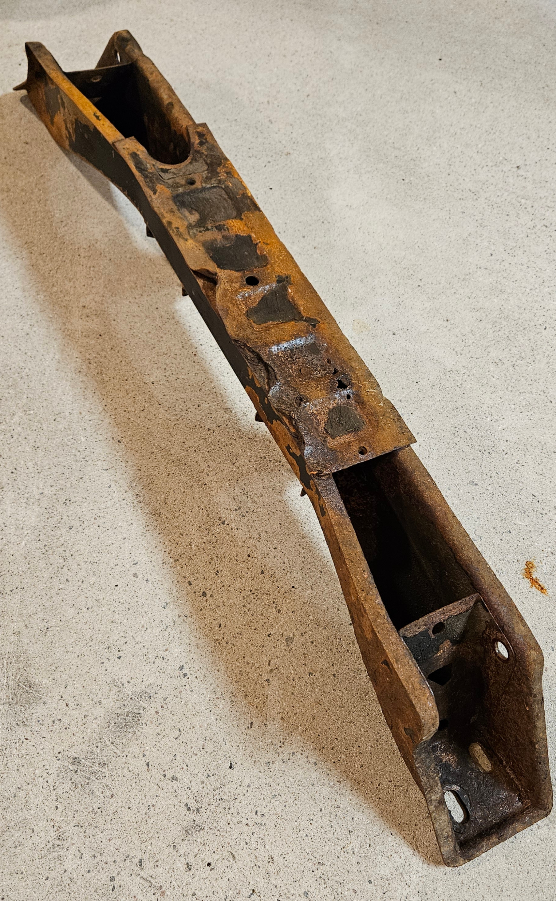

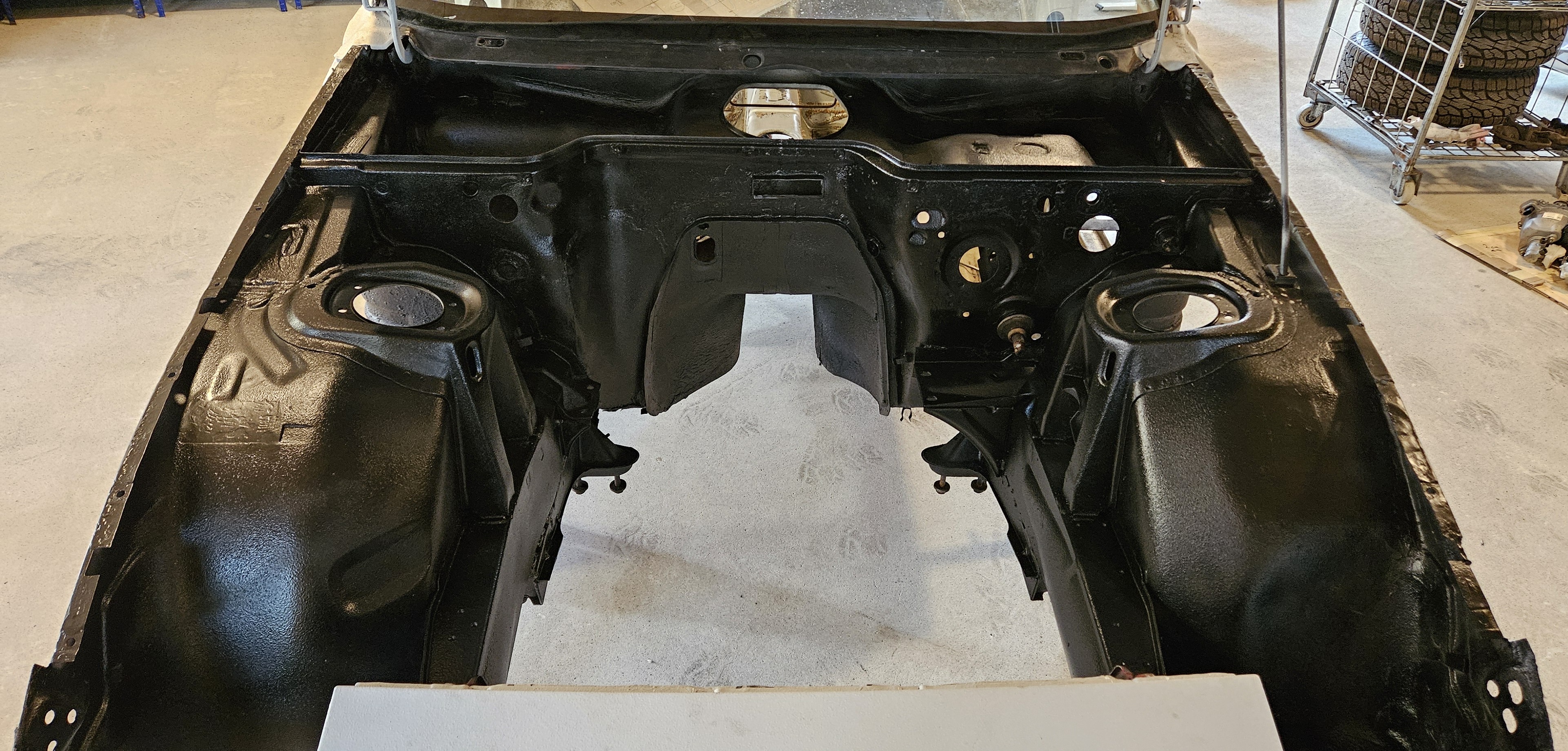

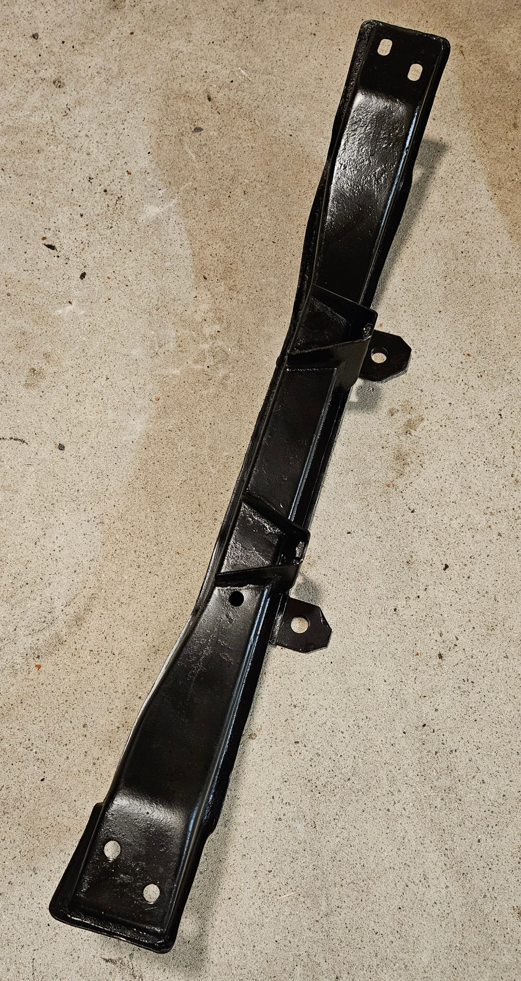

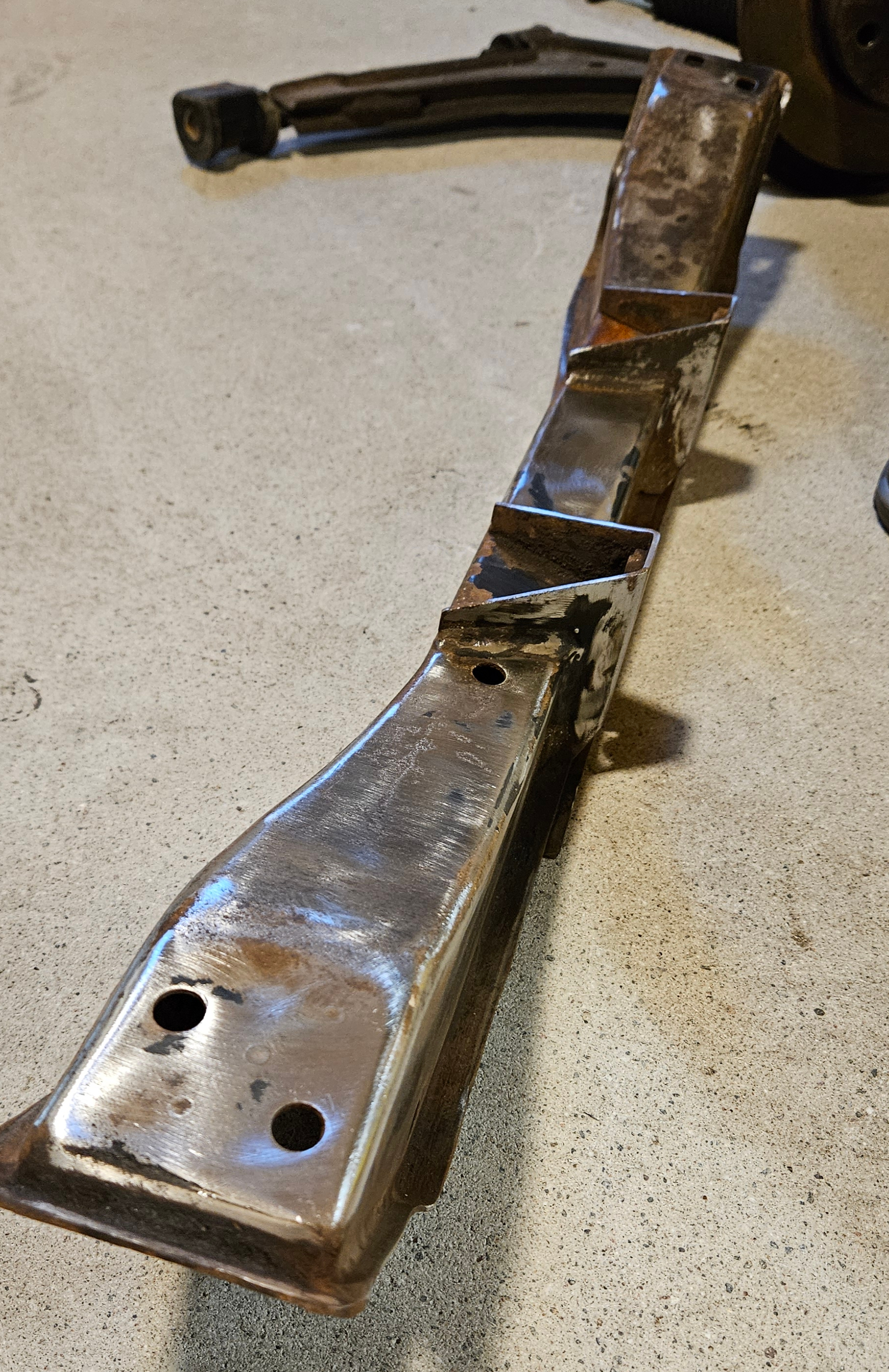

Engine bay and cross member touch up:

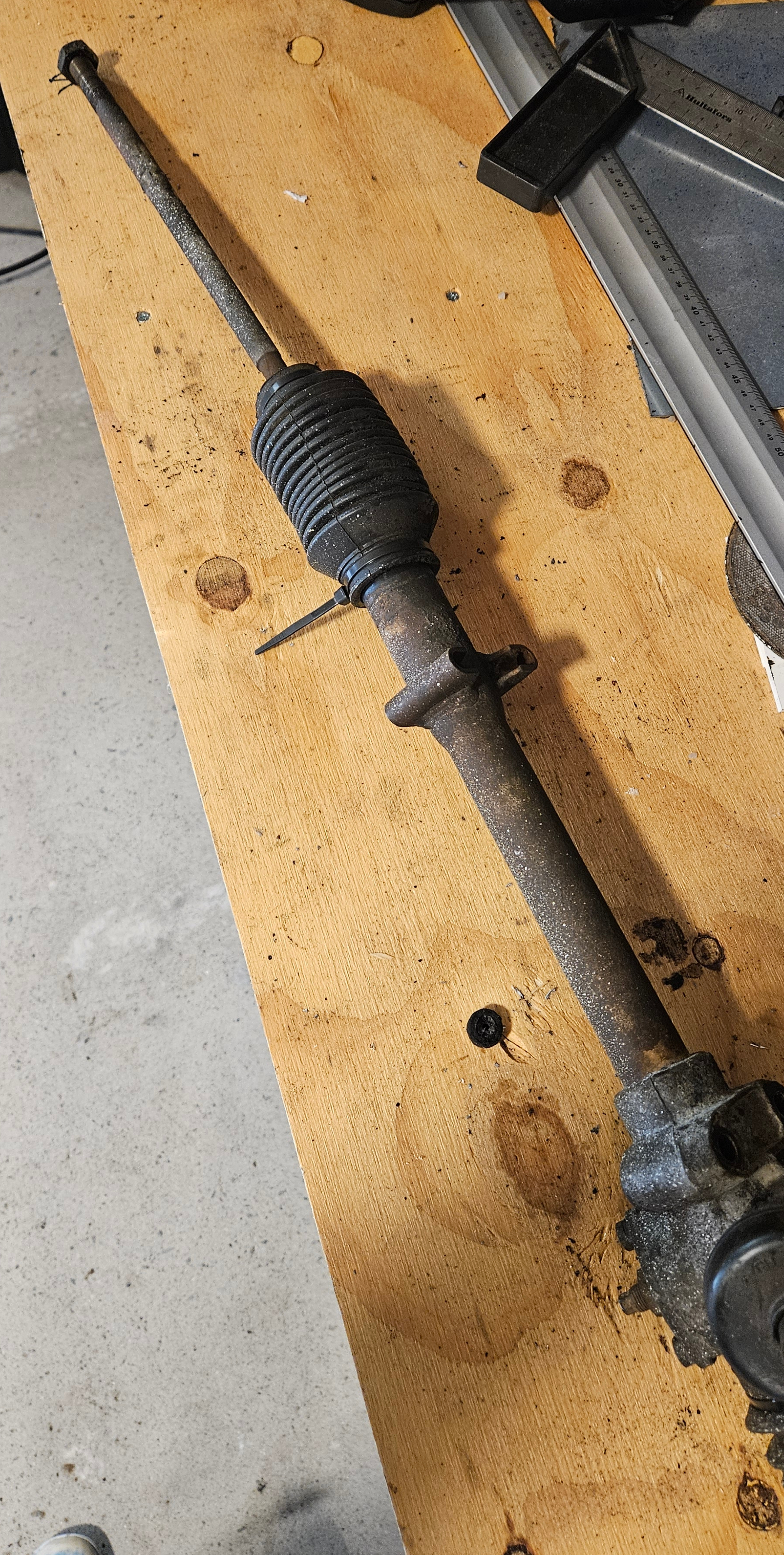

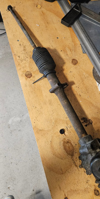

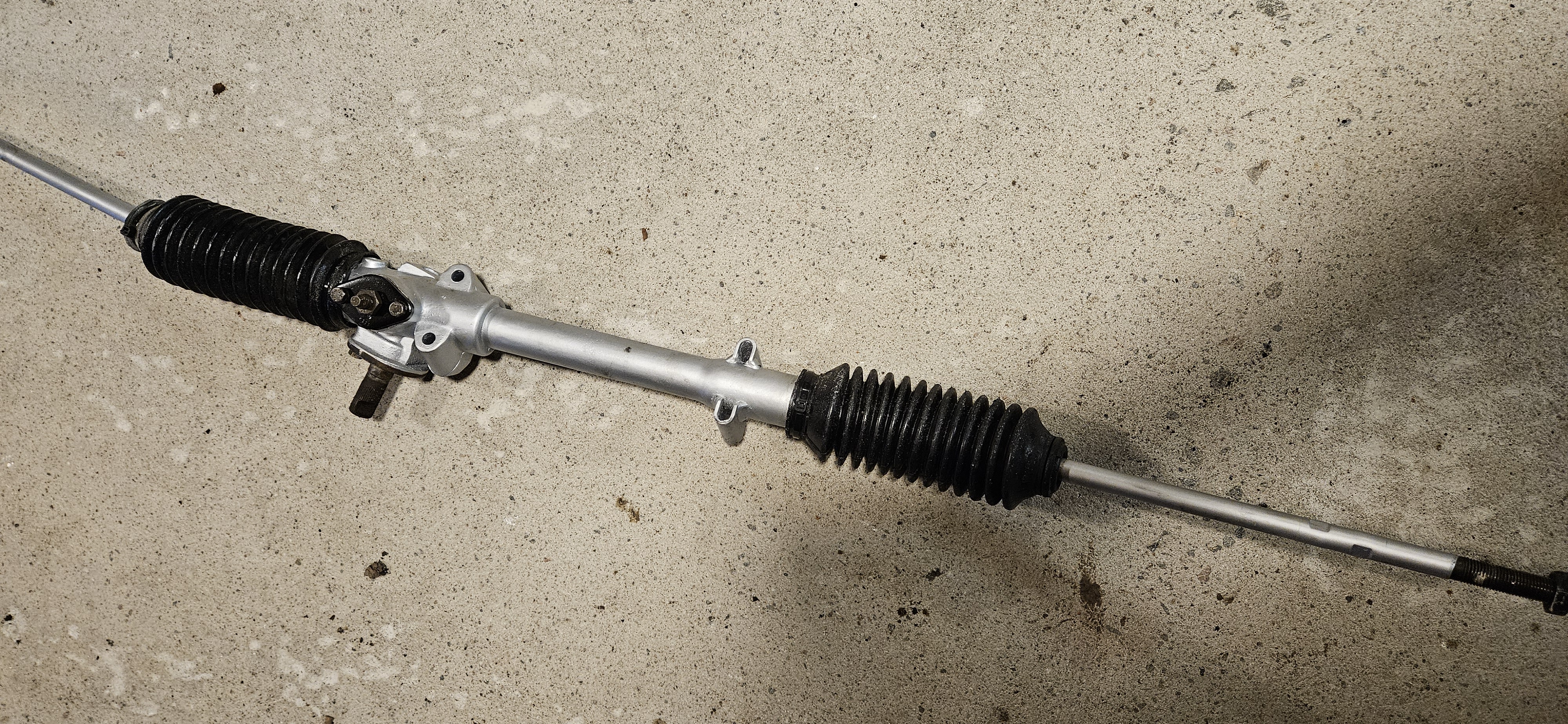

Steering rack refurbish:

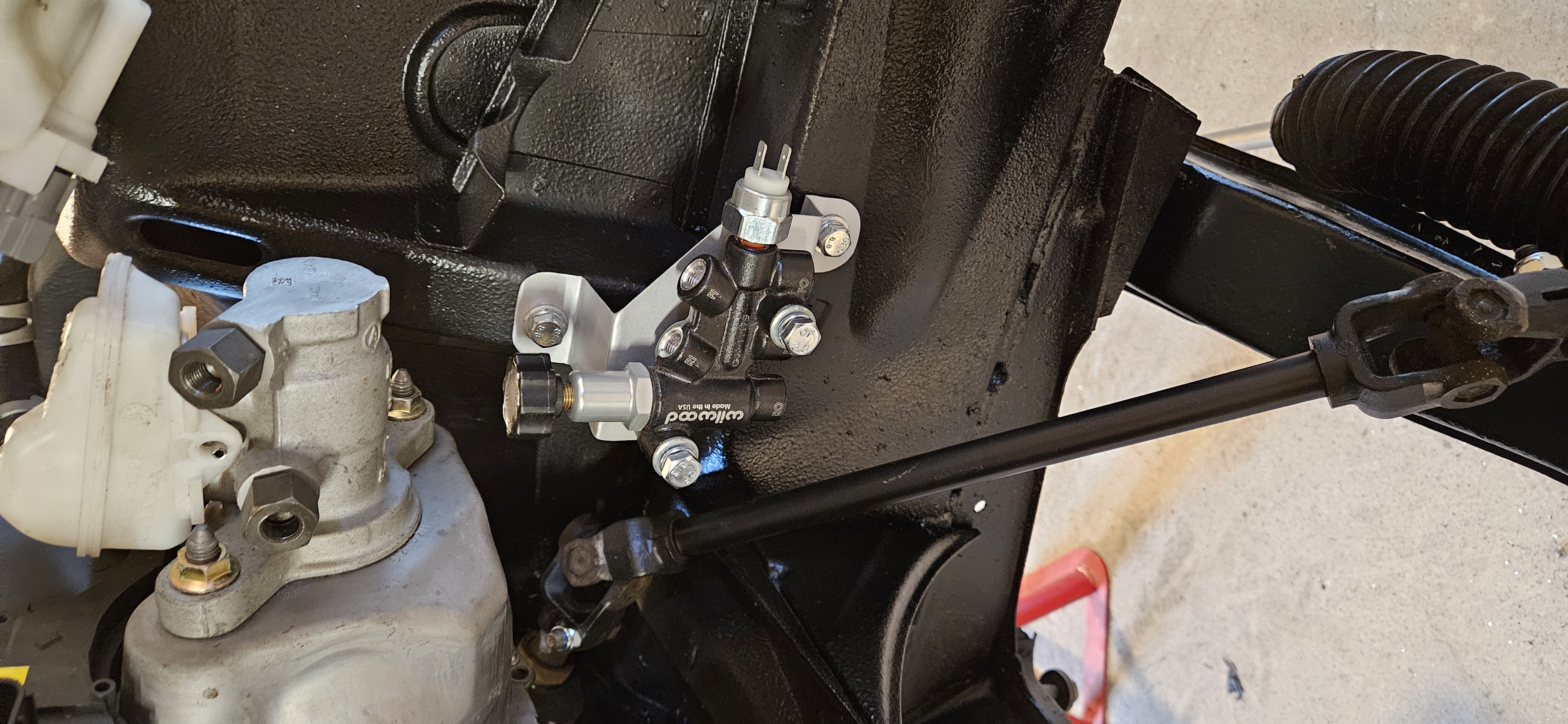

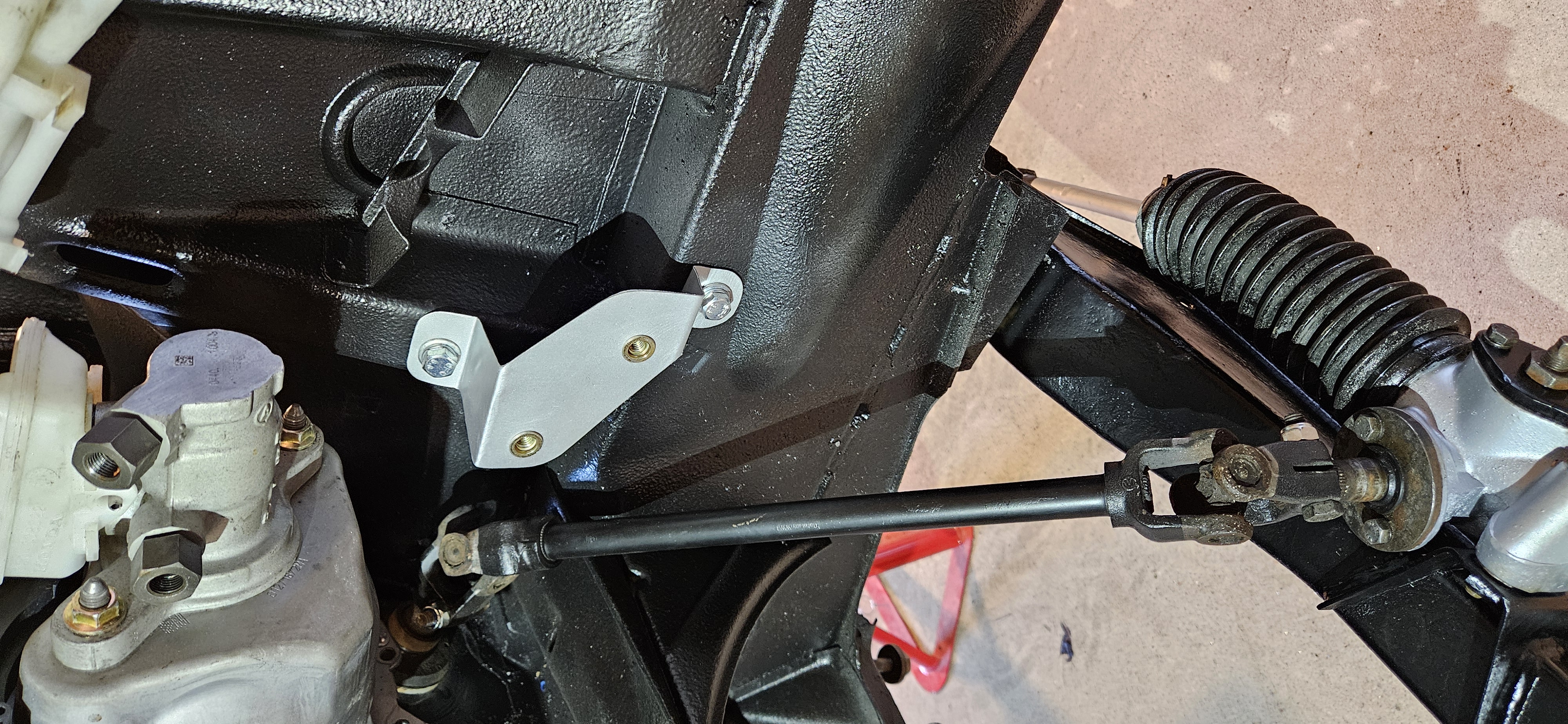

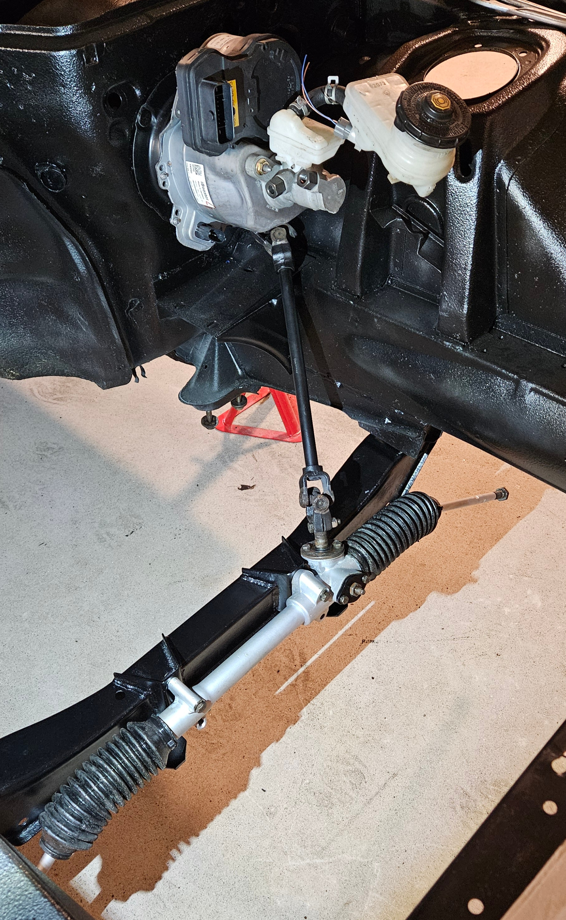

iBooster, Wilwood proportioning valve and bracket install and creation:

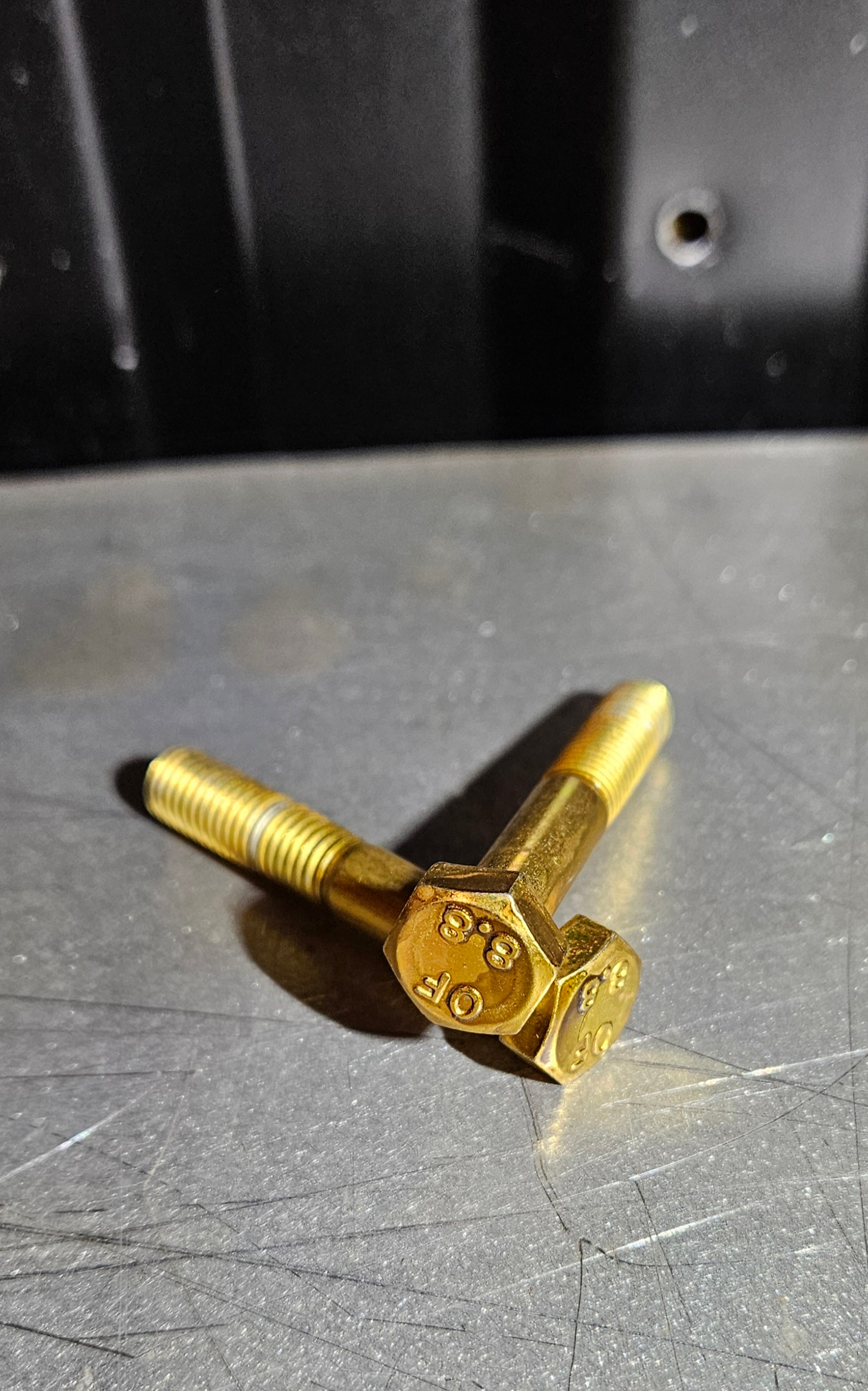

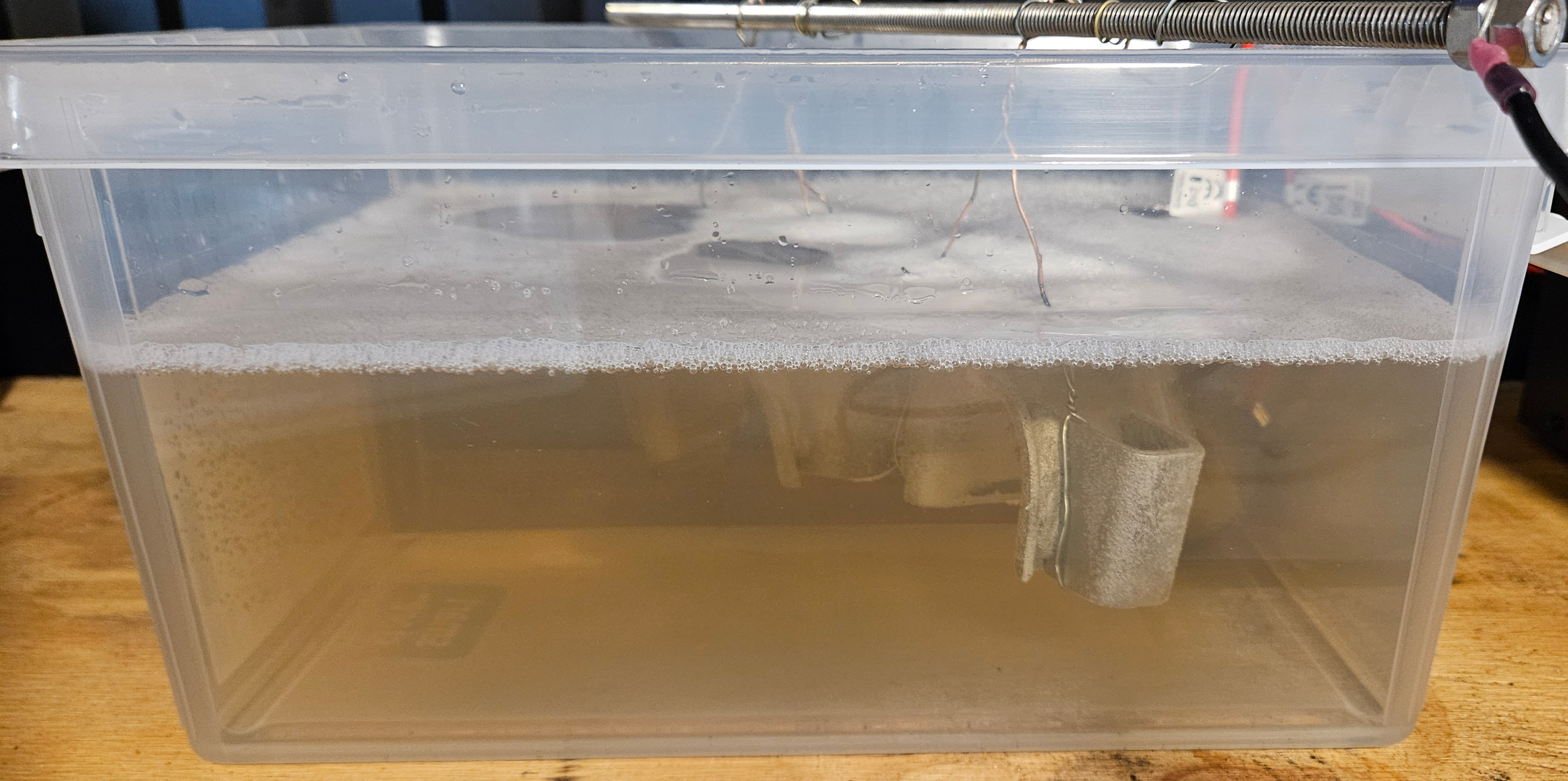

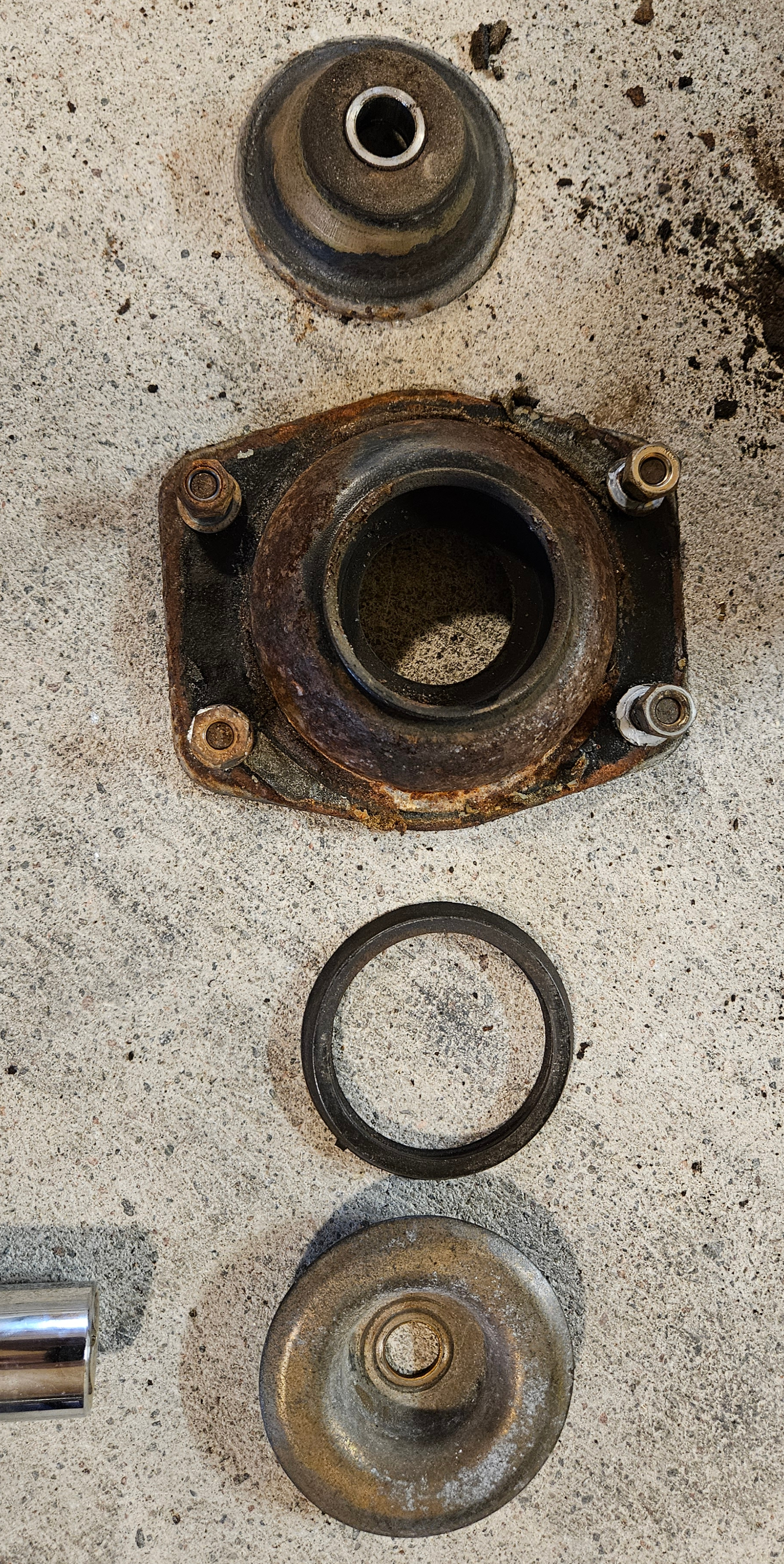

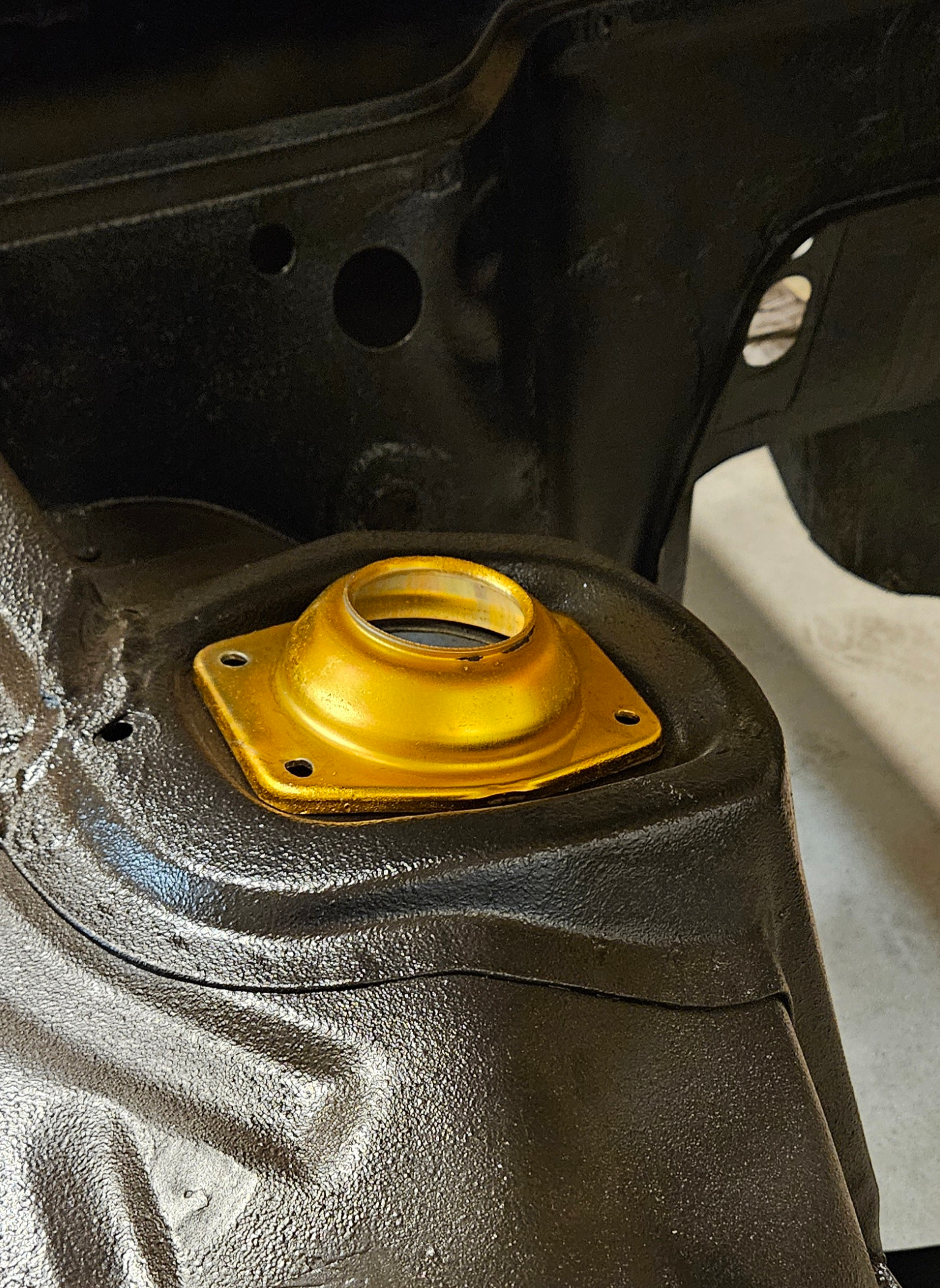

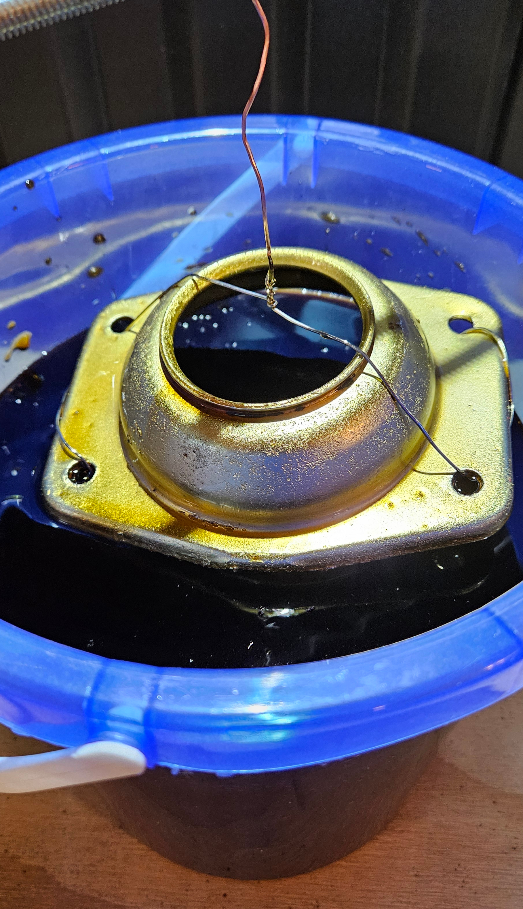

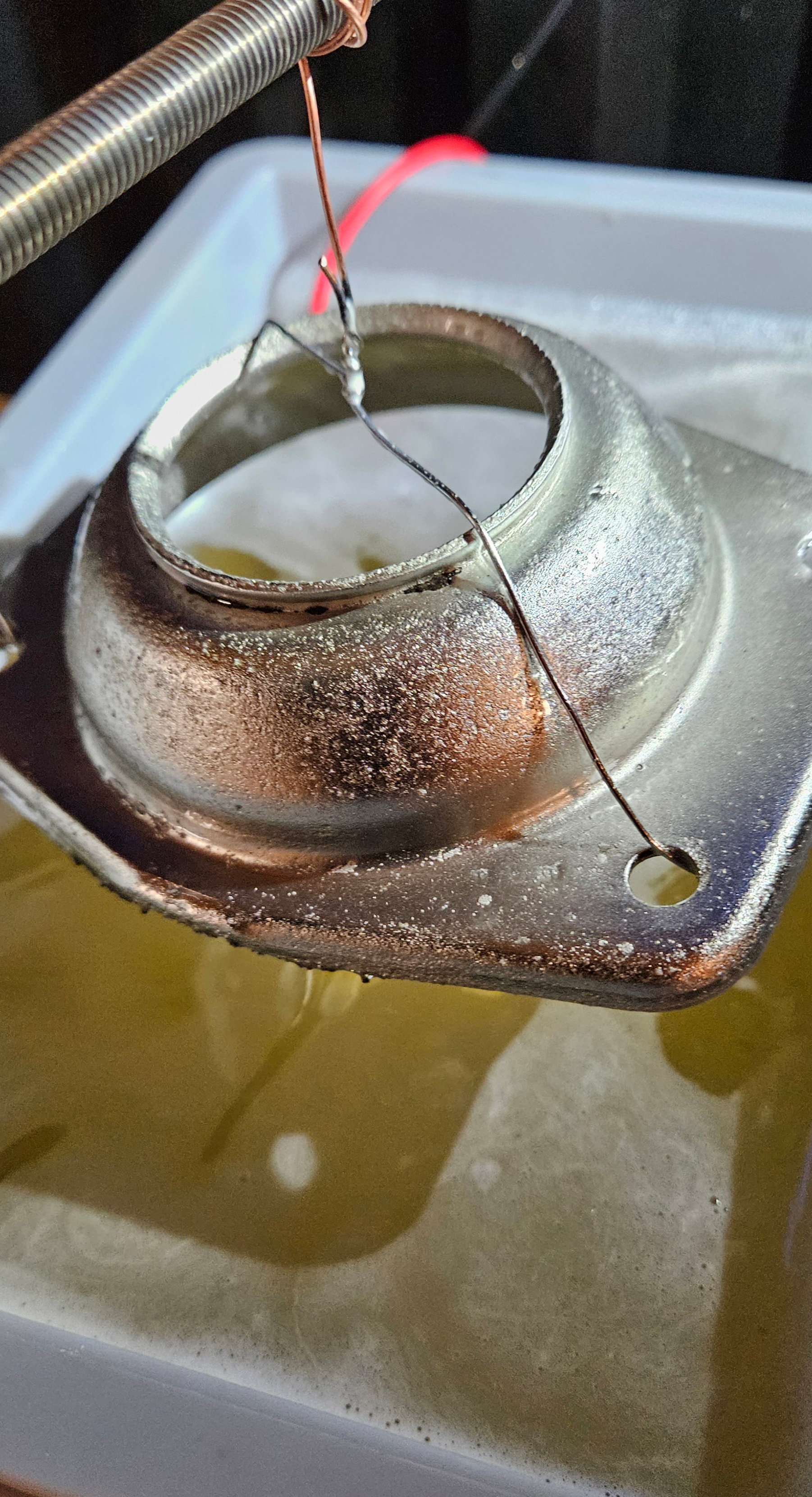

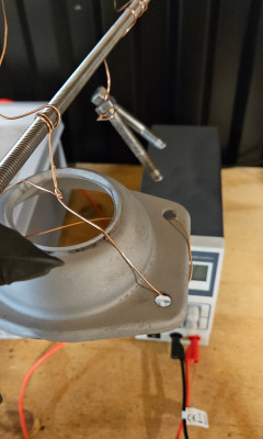

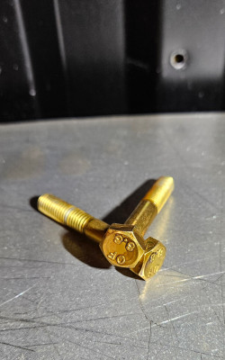

Trying out zinc plating. I'm not sure if I think the style suits the car, but it's fun to experiment! :)
crasbe
Posts: 330
Location: Germany
Has thanked: 58 times
Been thanked: 180 times
Post by crasbe »
The results look really nice and I don't want to be that guy, but be careful when zinc plating bolts (or parts in general). They can lose a lot of their original strength due to hydrogen embrittlement.
mrfred
Posts: 11
Joined: Sun Feb 12, 2023 5:33 pm
Has thanked: 4 times
Post by mrfred »
crasbe wrote: Wed Dec 18, 2024 6:13 pm The results look really nice and I don't want to be that guy, but be careful when zinc plating bolts (or parts in general). They can lose a lot of their original strength due to hydrogen embrittlement.
Didnt know that. Thanx for telling me!
jrbe
Posts: 766
Has thanked: 362 times
Been thanked: 249 times
Post by jrbe »
Looks good.
You can do a post plating bake soon after to combat the hydrogen entitlement. Look up specs for what you're plating.
