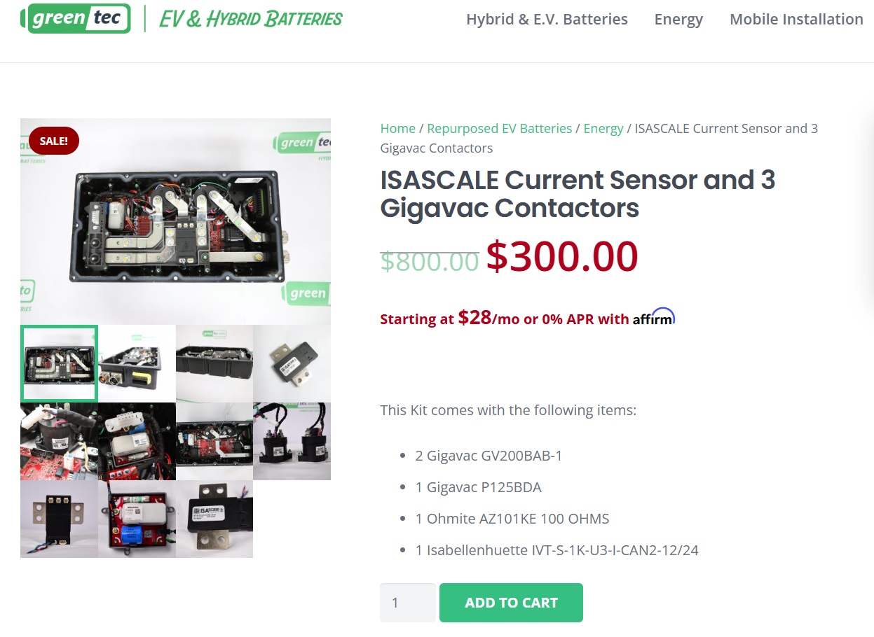

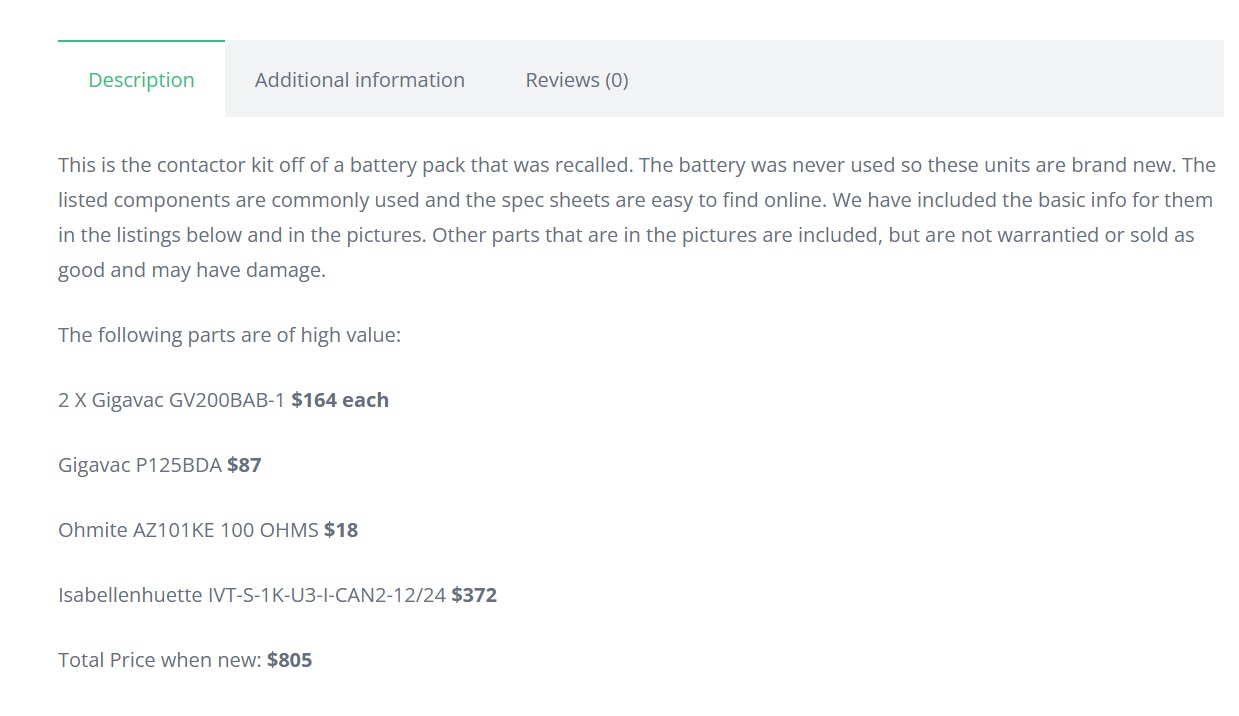

ISASCALE Current Sensor and 3 Gigavac Contactors
gonna provide some screen shots of the original listing in case it sells out and the linky link ends up being orphaned

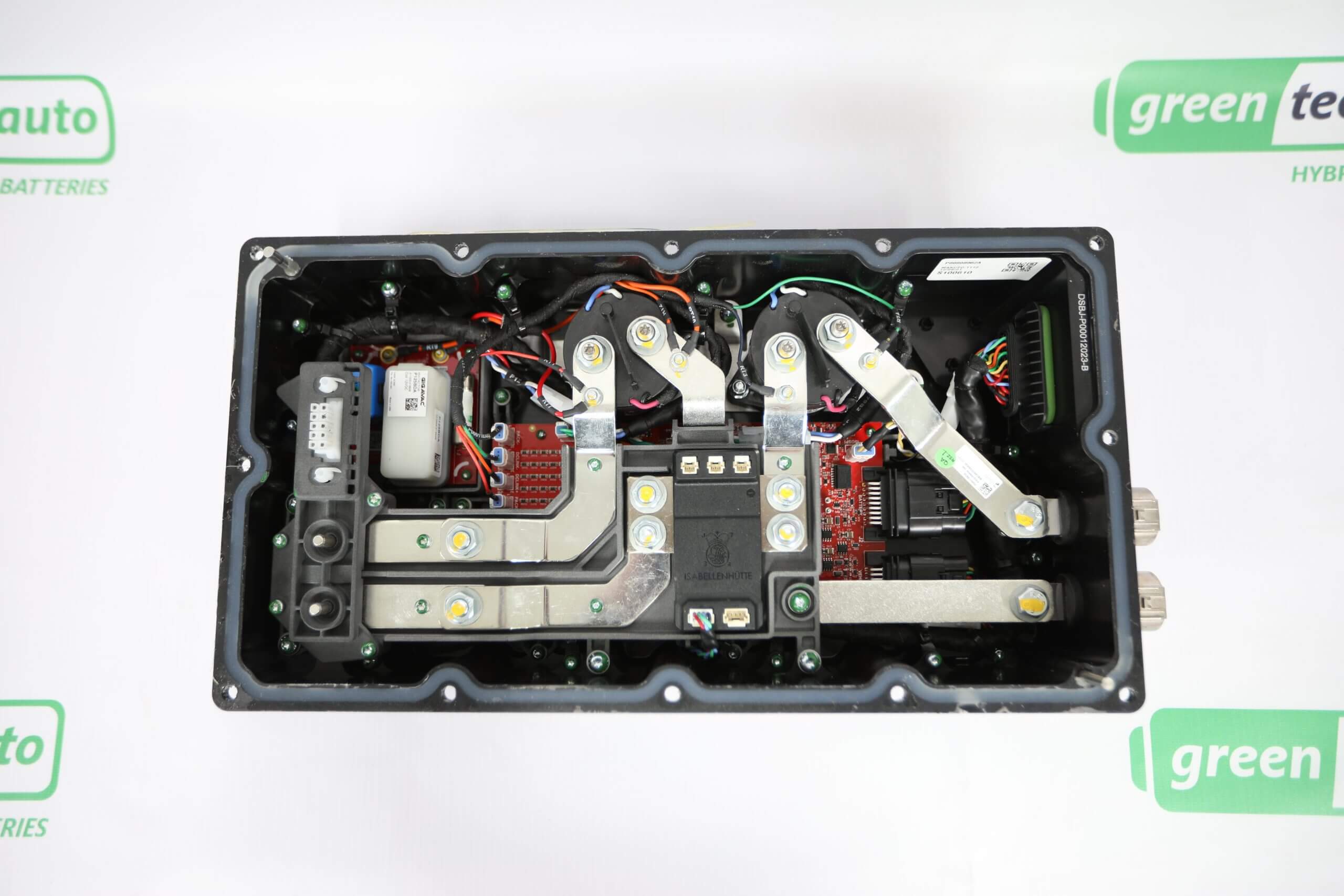

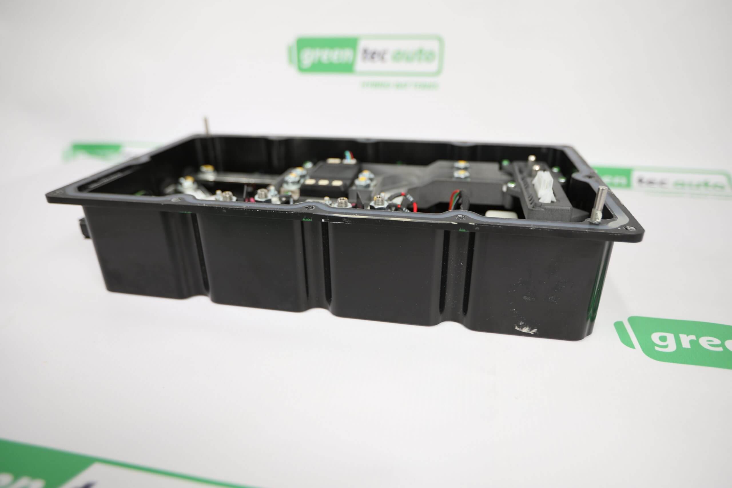

original pictures from the listing

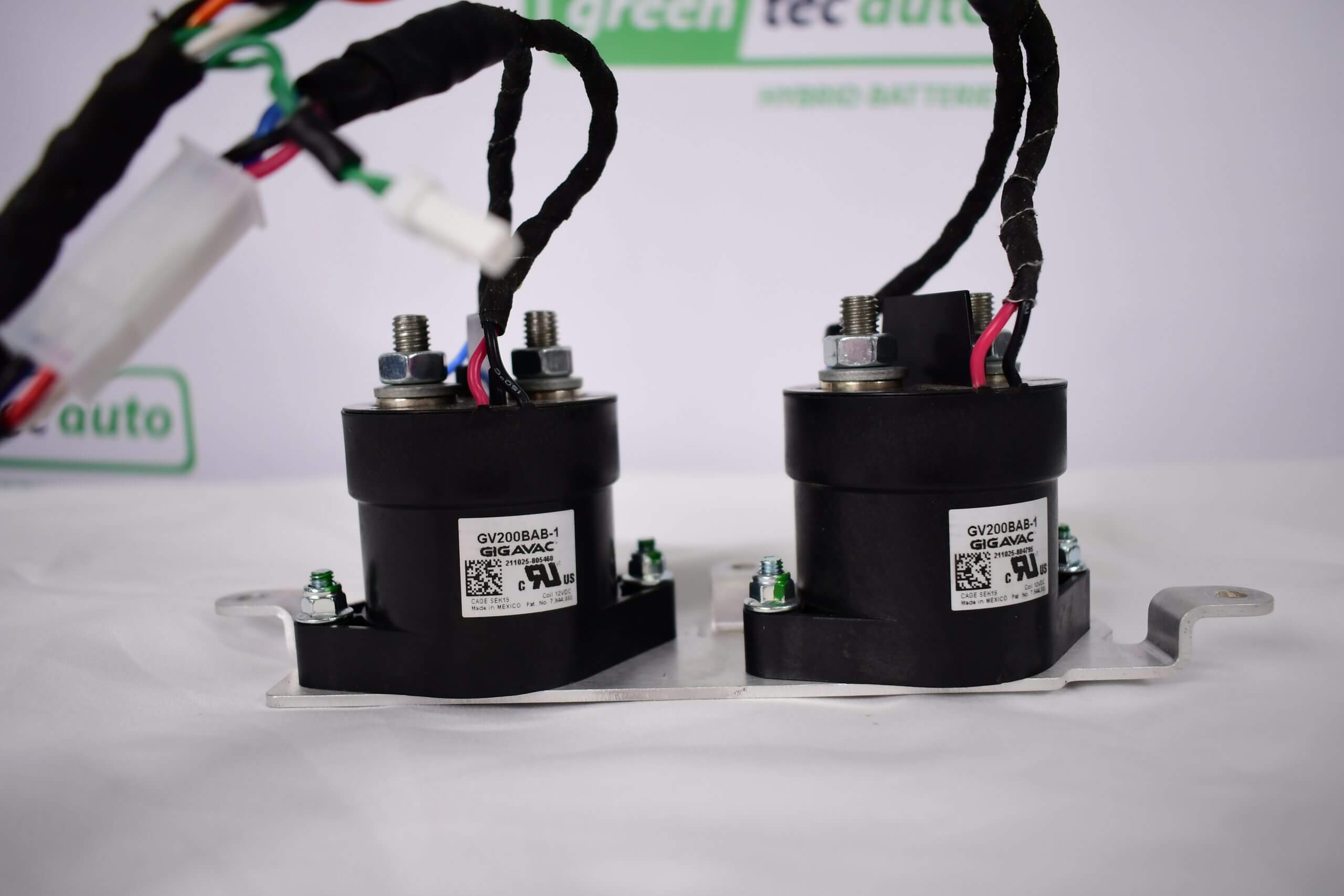

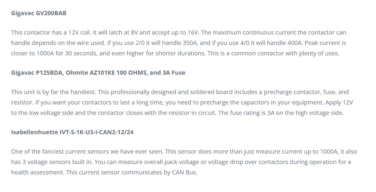

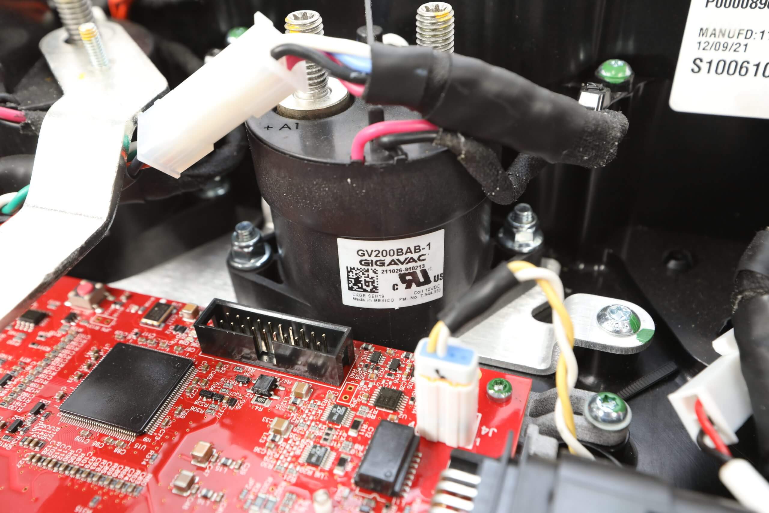

contactor information
  • 2 X Gigavac GV200BAB-1 $164 each
  • 1 Gigavac P125BDA $87
Gigavac GV200BAB
This contactor has a 12V coil. It will latch at 8V and accept up to 16V. The maximum continuous current the contactor can handle depends on the wire used. If you use 2/0 it will handle 350A, and if you use 4/0 it will handle 400A. Peak current is closer to 1000A for 30 seconds, and even higher for shorter durations. This is a common contactor with plenty of uses.

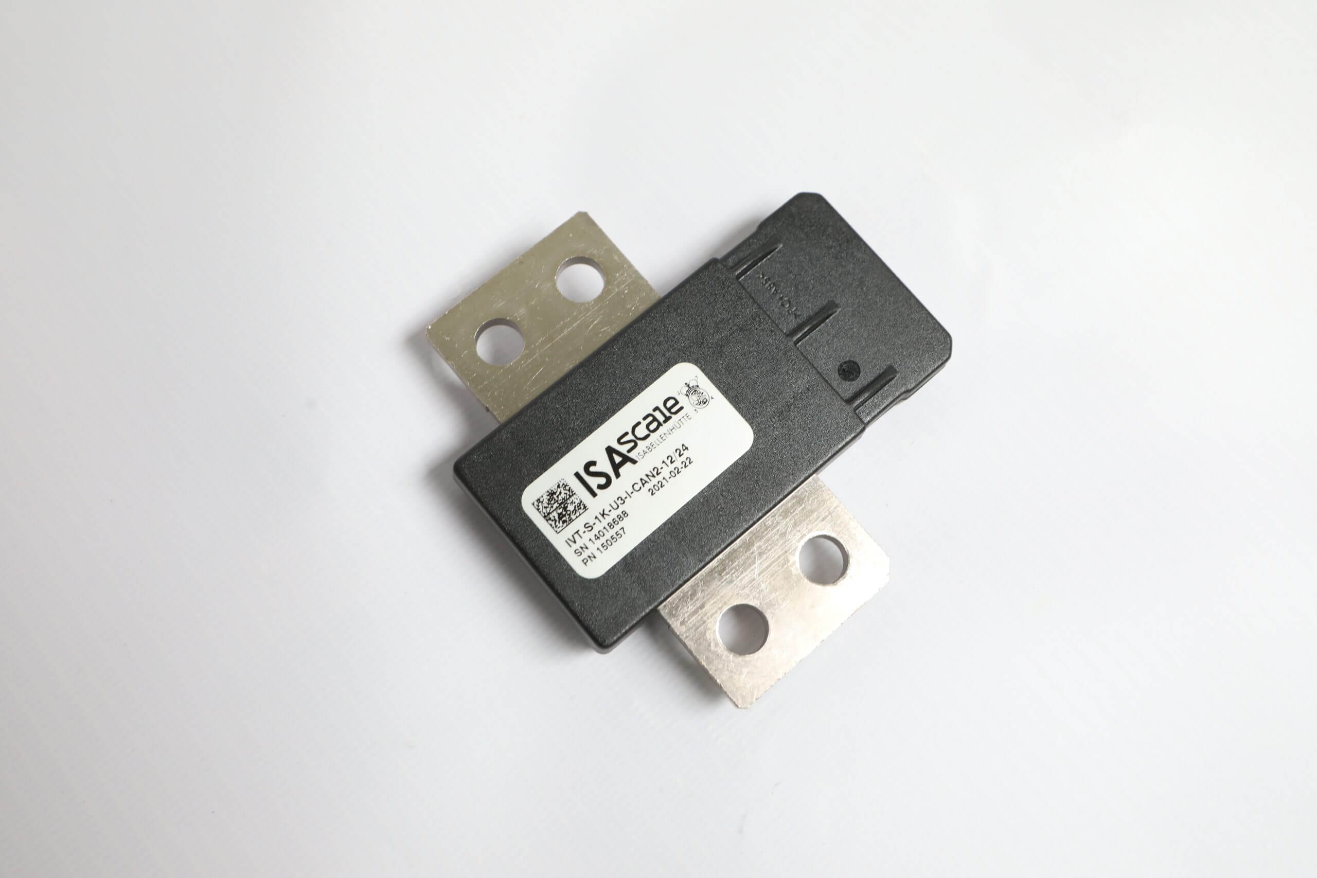

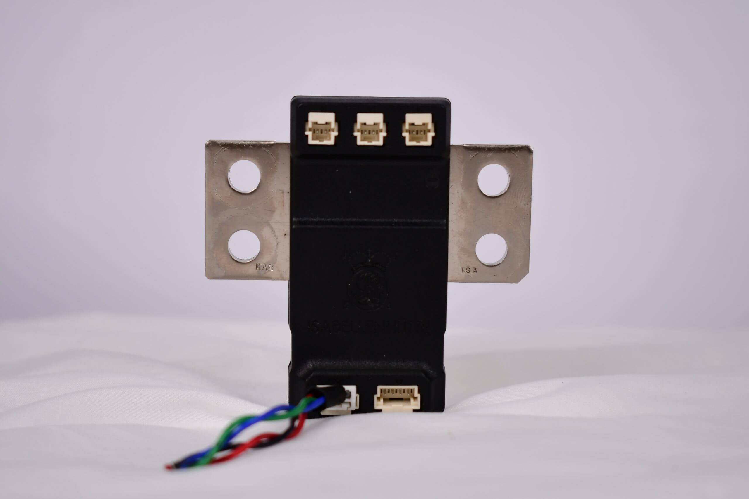

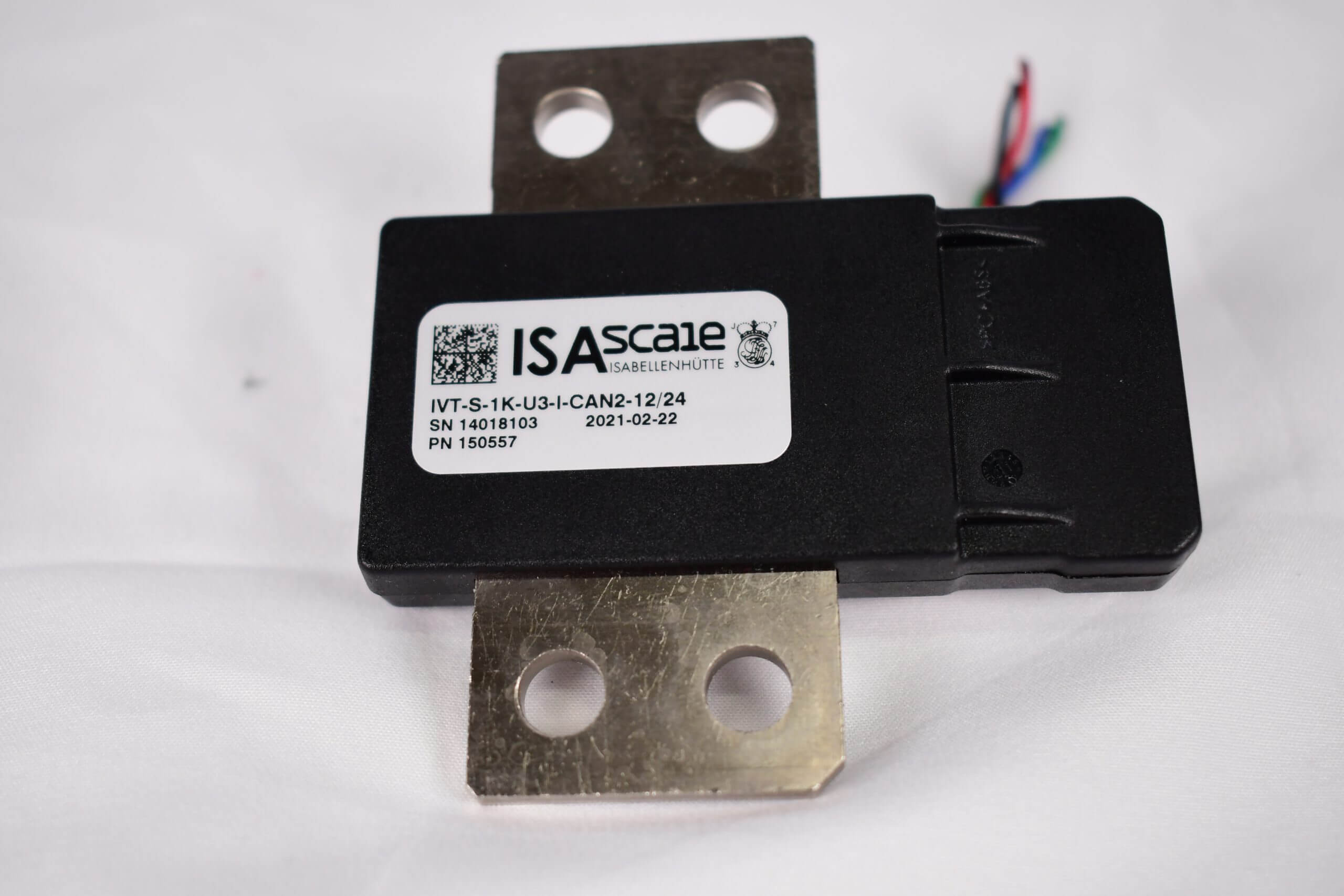

Isabellenhuette IVT-S-1K-U3-I-CAN2-12/24 $372
One of the fanciest current sensors we have ever seen. This sensor does more than just measure current up to 1000A, it also has 3 voltage sensors built in. You can measure overall pack voltage or voltage drop over contactors during operation for a health assessment. This current sensor communicates by CAN Bus.

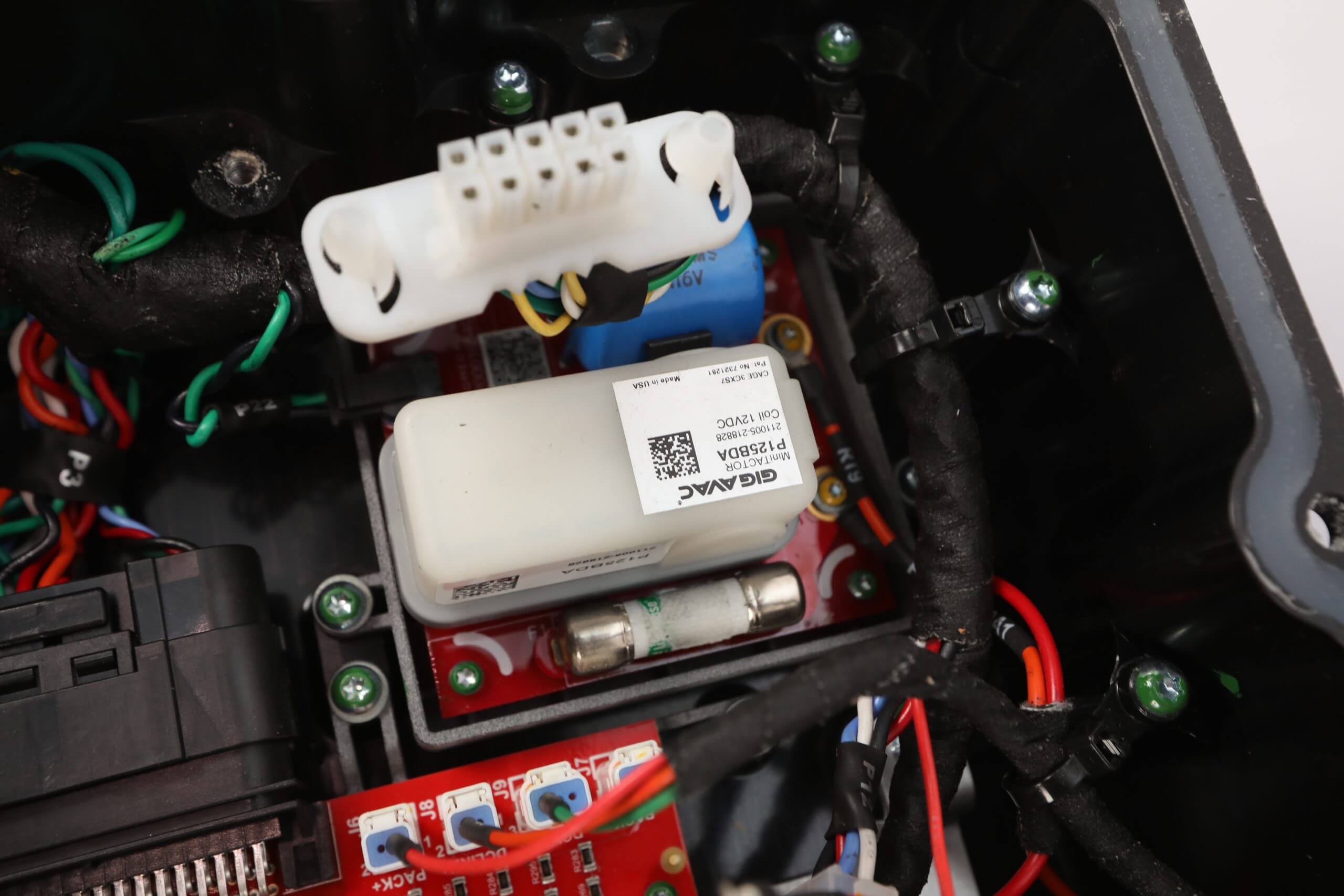

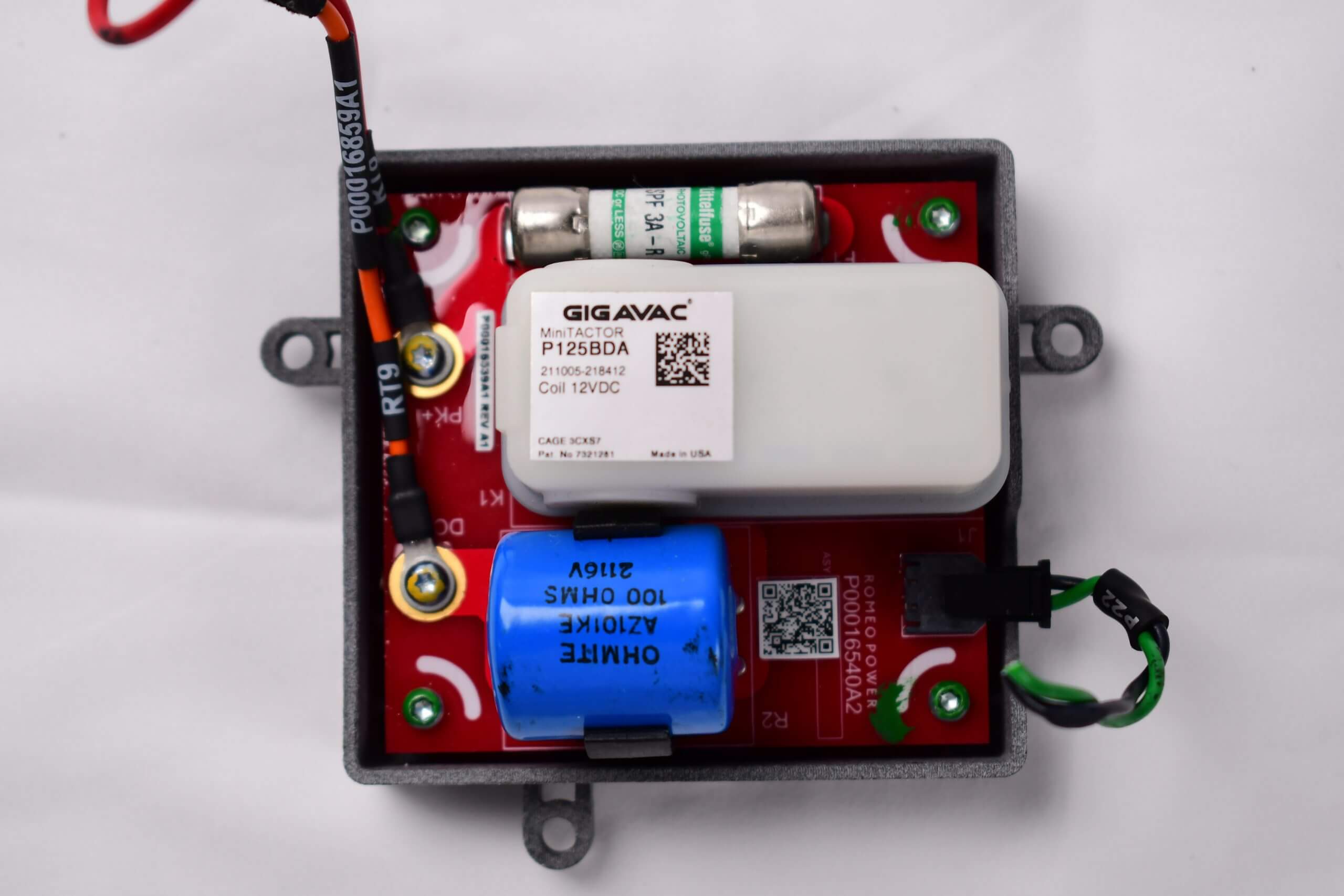

Gigavac P125BDA, Ohmite AZ101KE 100 OHMS, and 3A Fuse
This unit is by far the handiest. This professionally designed and soldered board includes a precharge contactor, fuse, and resistor. If you want your contactors to last a long time, you need to precharge the capacitors in your equipment. Apply 12V to the low voltage side and the contactor closes with the resistor in circuit. The fuse rating is 3A on the high voltage side.

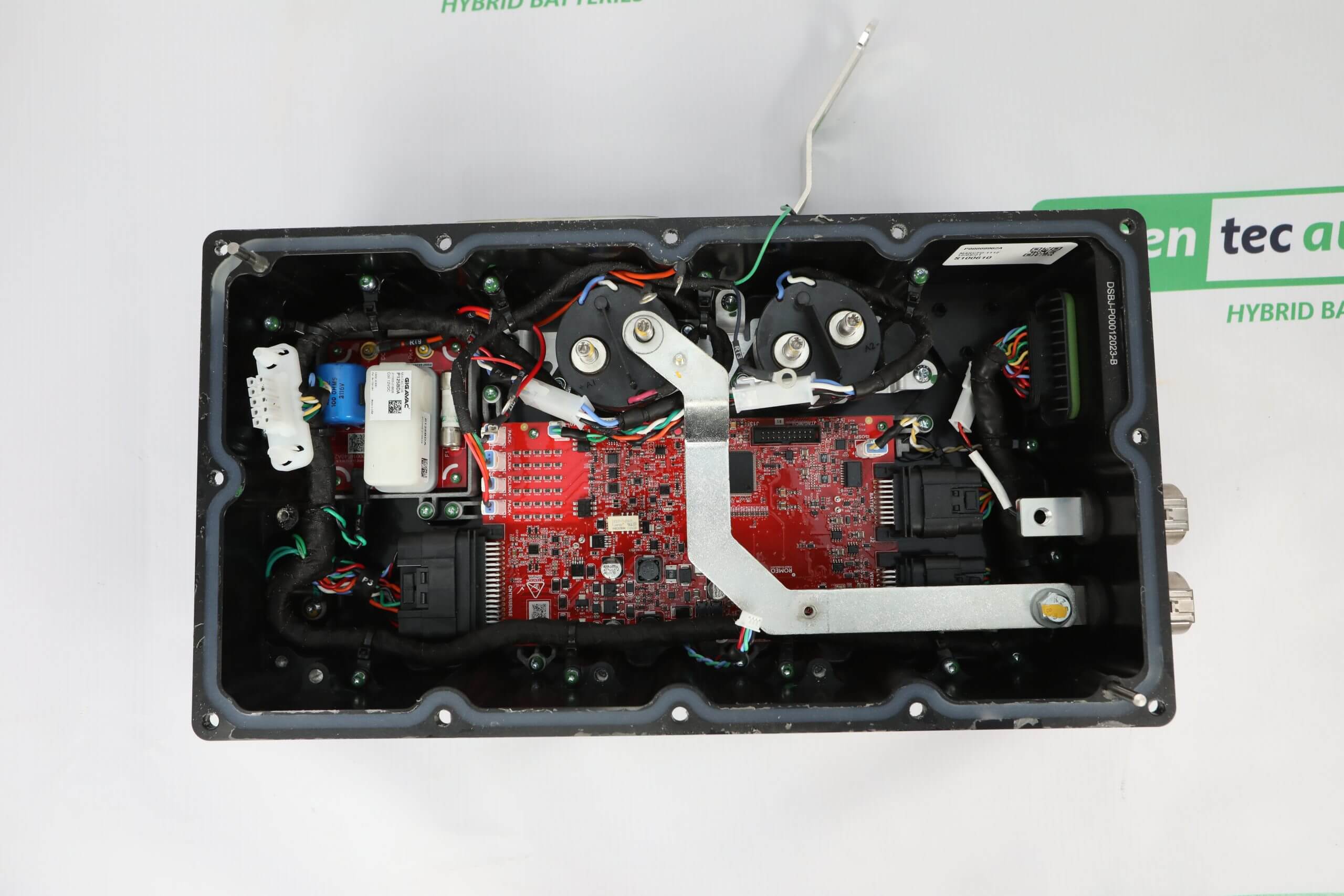

QUESTIONS SECTION:
So what is it, and why do I need it?
How did I find out about it, and why should you care?
What is an ISA and do I really need one?
Are these economizer contactors?
Has this red circuit board been reversed engineered already?

Interesting & handy detail on the two big Gigavac GV200BAB-1 contactors:
They are the dual coil version. This means that while they do not have an economizer, they automatically will — after initial closing (aka “pick-up”) current (3.9A for 0.75 sec) — release one of the two coils to make the continuous 12v current draw on them drop to around 0.23A only.
Spec sheet attached.

Gregski wrote: Tue Nov 26, 2024 6:21 pm Gigavac P125BDA, Ohmite AZ101KE 100 OHMS, and 3A Fuse
is that board its own thing though? i assumed it had some control smarts that would need to be reverse engineered, if it's a complete all in one precharge contactor package with no reverse engineering needed thats extremely nice

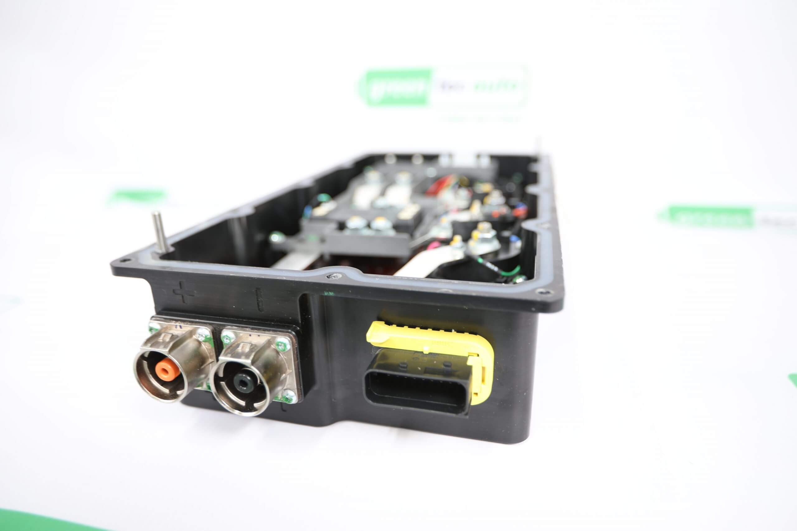

also dont forget the box has two of these amphenol powerlok connectors you can just unscrew from the front

jokeitch wrote: Tue Nov 26, 2024 7:10 pm is that board its own thing though? i assumed it had some control smarts that would need to be reverse engineered, if it's a complete all in one precharge contactor package with no reverse engineering needed thats extremely nice
Well, since the layout and components used seem great no matter what, I intend to re-use the box (or just the layout and bits) even without the control board - with a fair bit of re-wiring…
But I also would like to take a closer look at the board, just out of curiosity. Do I know what I’m doing there? Definitely not! :)

Did the box came with a lid cover? I am intrigued by the vertical HV connections.
Gregski
Posts: 3164
Has thanked: 633 times
Been thanked: 1610 times
Re: I bought an ISASCALE Contactor Box - Now what?
Post by Gregski »
ChurchMcTruck wrote: Wed Feb 05, 2025 9:06 pm Did the box came with a lid cover? I am intrigued by the vertical HV connections.
no word on the street is that it was bolted up to the battery pack directly so that lid of the battery pack was it's lid cover, someone please correct me if I'm wrong

Post by ChurchMcTruck »

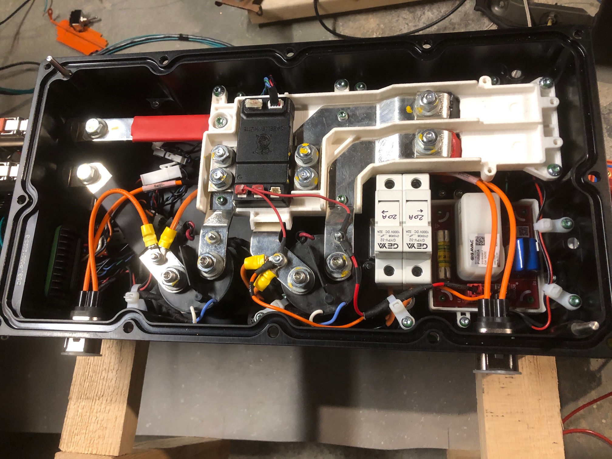

By removing the control board I was able to add two fused Amphenol PL082Y connectors to this box for charger/heater and have the battery cables coming from below.

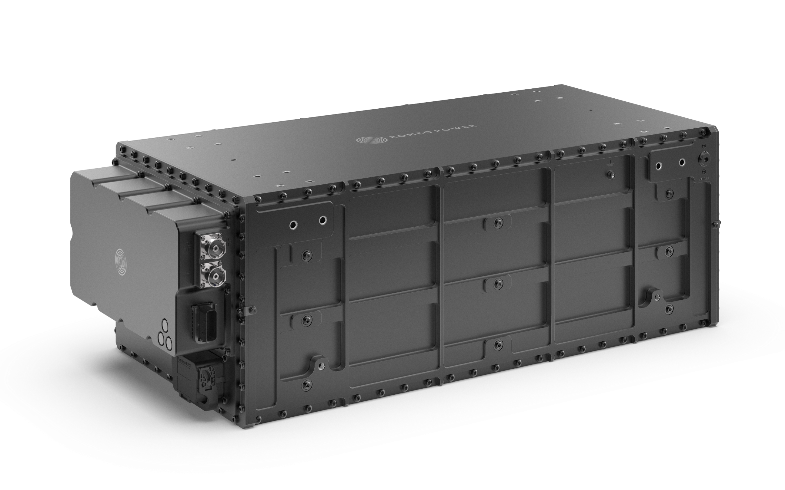

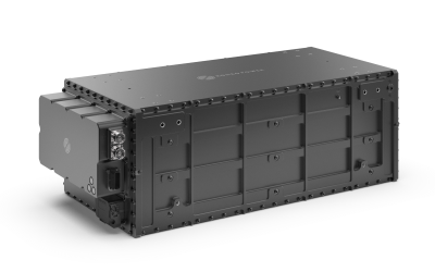

ChurchMcTruck
Posts: 16
Joined: Wed Feb 05, 2025 8:39 pm
r1ckyb0nd wrote: Tue Sep 09, 2025 8:47 pm Do you know what battery it is supposed to be connected to
Found that it was part of a modular battery pack made by Romeo Power Inc for commercial trucks. This company was bought and then liquidated by Nikola in 2023.
EVWest is selling one of these packs and you can find the Data sheet on their website :https://evwest.com/romeo-power-menara-8 ... 15ah-78kwh.
r1ckyb0nd
Posts: 38
Joined: Sun Dec 22, 2024 1:34 pm
Has thanked: 11 times
Been thanked: 9 times
Post by r1ckyb0nd »
Wow 750v battery pack.

Post by robertwa »
ChurchMcTruck wrote: Mon Sep 08, 2025 10:39 pm By removing the control board I was able to add two fused Amphenol PL082Y connectors to this box for charger/heater and have the battery cables coming from below.
Nice job modifying the box! Do you have the part numbers for the mating powerlok connectors (left side of your picture)?
ChurchMcTruck
Posts: 16
robertwa wrote: Thu Dec 25, 2025 7:33 pm Nice job modifying the box! Do you have the part numbers for the mating powerlok connectors (left side of your picture)?
Thx !
Amphenol PowerLok PL18X-301-70 and PL18Y-301-70
