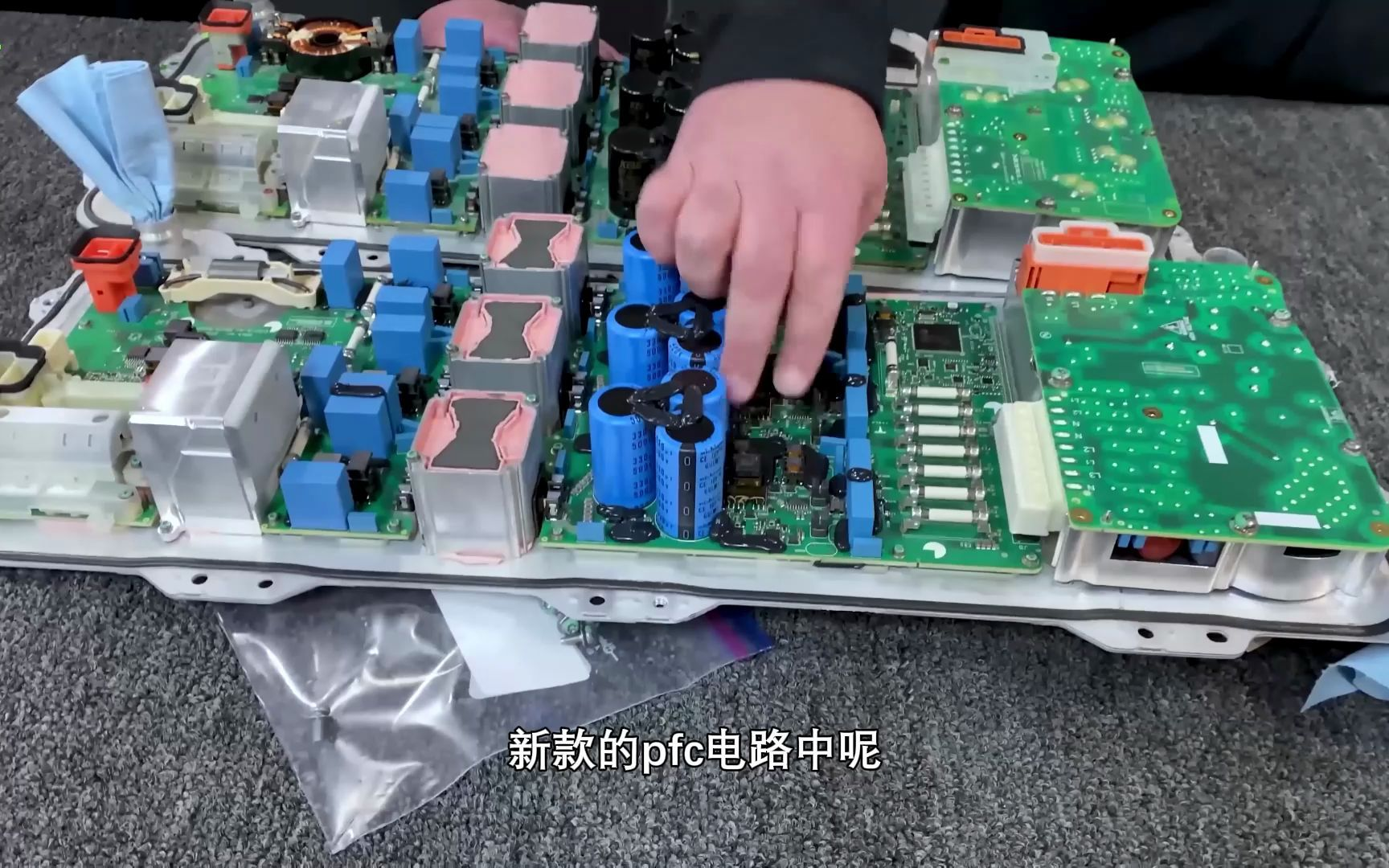

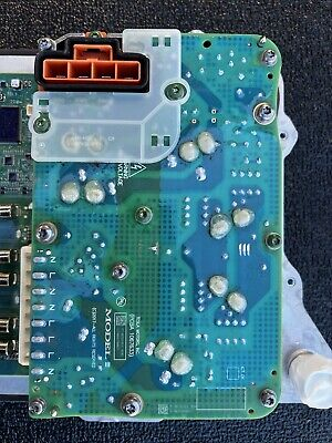

Hello! I have Tesla Model Y USA, but in Ukraine we have 3 phase electricity and I want to charge my car from 3 phase)
PCS have 3 isolated charger inside, but in USA version input filter parallel all 3 input in one, on EU version there is have commutator.

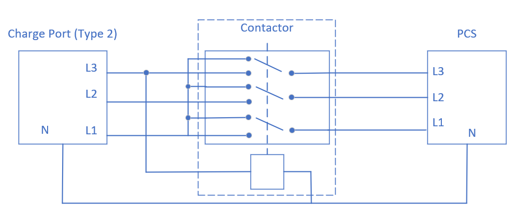

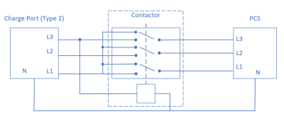

So I have plane to change charge port to type 2 and charge controller, and install relay, that connect 1ph to 3ph on PCS by default or if present 3rd ph connect 3ph to 3ph on PCS.
Problem is that I need remove input filter or modern it like in EU version. So i don't know how to solve it, maybe some one have idea?
I want make it too with PCS in my DIY EV, but first I check it on my Tesla.
USA
EU (China). Source:https://xbeibeix.com/video/BV1LS4y1m7kW (You can see different in input filter)
My idea about commutation phase.
