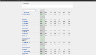

Does anyone know what crc-8 algorithm is used in M3/Y? I've tried different 20 and none of them are similar to Tesla's.
I'm trying to emulate the steering column switch.

I've had good luck using CRCBeagle in the past: https://github.com/colinoflynn/crcbeagle/ - fed enough samples of data and CRC, it should be able to calculate init/poly/xor.
Of course if it's something like the Autosar algorithm mentioned by uhi22 then it won't be able to recover that.

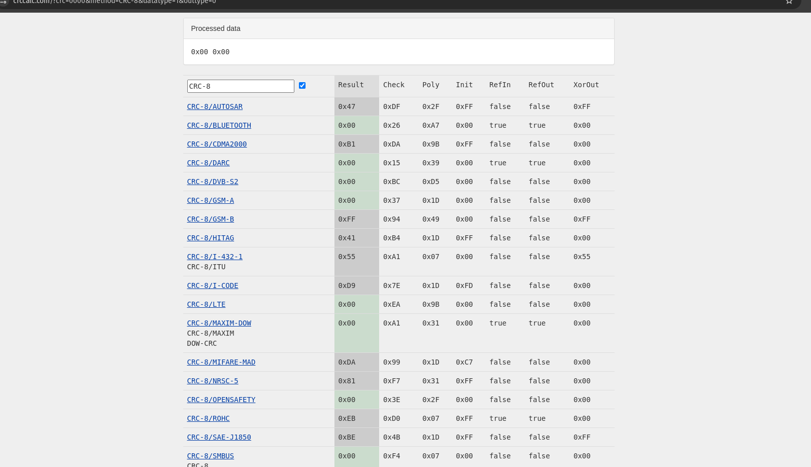

Re: CRC-8 algorithm in m3/y
I don't know yet what crc algorithm is used in the stalks. None of the popular ones are suitable. Sum of bytes doesn't give anything either.tg1929 wrote: ↑Wed Apr 02, 2025 6:41 am Hi AMP3R, I am currently playing with generating Stalk messages and UI messages to test how the VCLeft, VCRight and VCFront modules interact in my model 3.
For example I simulated blinker commands by sending 0x249 messages with a cksum lookup based on a capture of successful messages from the Steering and Stalk ECU.
I am now trying to generate the CKSUM messages for cases where I cant generate a successful example. I have spent all afternoon trying different crc algorithms and different sections of the data packets without success.
I came across this thread but cant seem to replicate the results in the example above. I saw another post, I think also from you mentioning the algorithm is CRC-8/SAE-J1850, is this the case for the example above?
When I use the following data
0x02 0x00 0xC8 0x07 0x00 0x00 0xE0 0x13 0x03
I get result 0x03 not 0xC7 as shown.
Can you give me a hint where I'm going wrong?
But for UI messages, the method I described above is suitable. Carefully sum each byte separately.
crc-8/sae-j1850 is used in ibooster.

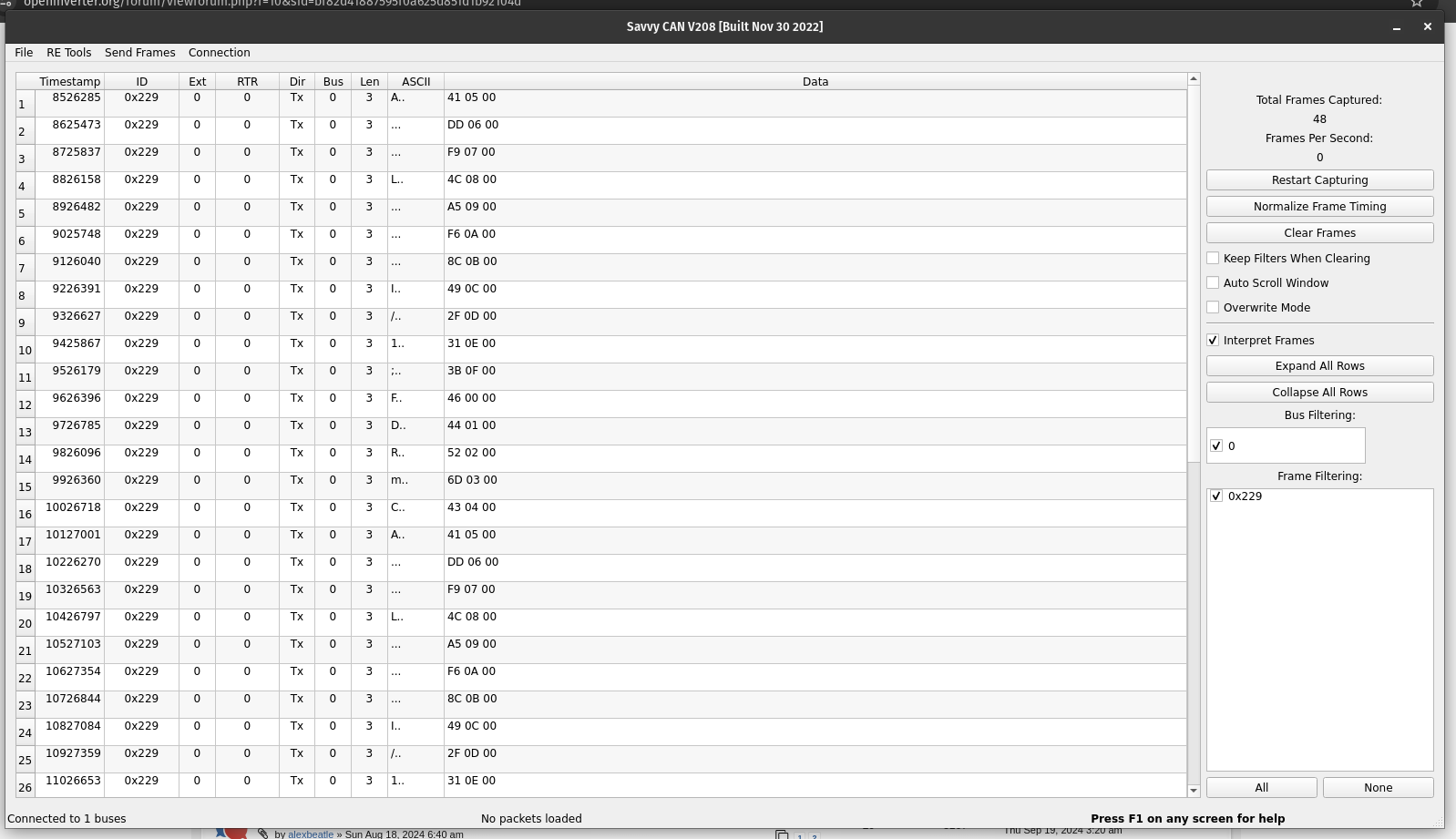

Hey uhi22. Would you help to reverse the algorithm?
Frames crcCenter:
0x229 0x46 0x00 0x00
0x229 0x44 0x01 0x00
0x229 0x52 0x02 0x00
0x229 0x6D 0x03 0x00
0x229 0x43 0x04 0x00
0x229 0x41 0x05 0x00
0x229 0xDD 0x06 0x00
0x229 0xF9 0x07 0x00
0x229 0x4C 0x08 0x00
0x229 0xA5 0x09 0x00
0x229 0xF6 0x0A 0x00
0x229 0x8C 0x0B 0x00
0x229 0x49 0x0C 0x00
0x229 0x2F 0x0D 0x00
0x229 0x31 0x0E 0x00
0x229 0x3B 0x0F 0x00
We would need more data. The full counter range, and some more bits of the buttons.
Looks good, I see patterns. Each button causes a certain XOR delta in the checksum. Do we have more data of single buttons, and maybe also combinations e.g. Park+Down?

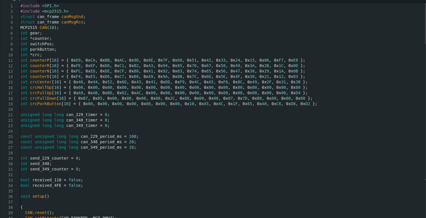

Which positions are possible? If there are only
- Idle
- Full Up
- Full down
- halve Up
- half down
- Park
I guess it is possible to calculate the crc using
1. A table with 16 entries ("Magic Bytes") and
2. A table with 5 "addon" XOR patterns.
If more combinations are necessary, it is worth to search for the crc polynom in the addon patterns.

Hi All, In case it is useful to anyone I spent some time today logging all possible movements of both the left and the right stalk.
Attached is a sorted and filtered list in the format D0 D1 D2 D3(249 only) in both cases D0 is the cksum
I came up with 178 different options for 229 and 870 options for 249
Each possible stick position should have 16 messages as they include the counter, I must have missed a couple as the totals are not divisible by 16.
AMP3R I found when simulating the 249 messages the car would respond to a minimum of 4 consecutive messages with correct cksums. did you find something similar?

Just tested my assumptions, and they fit perfectly to the published data of the 0x229. It needs one table with 16 entries for the magic bytes, and for each direction an additional one-byte value. Available here: https://github.com/uhi22/tesla-crc
To be tested, whether this sufficient for the 0x229, and what is the difference for the 0x249.

Small exercise
Using the "big data" from @tg1929, I found the polynom used in the message 0x249. Not yet verified with the complete data, but what I checked looks plausible. I guess the 0x229 will use the same, just with a different length and different list of magic bytes.
Updated the readme on the github. No C code yet.
