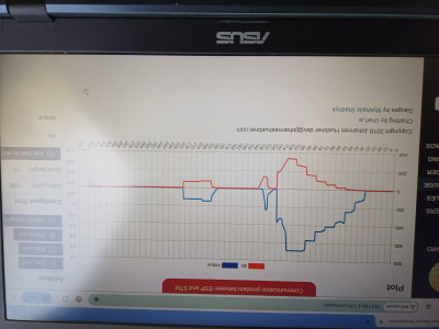

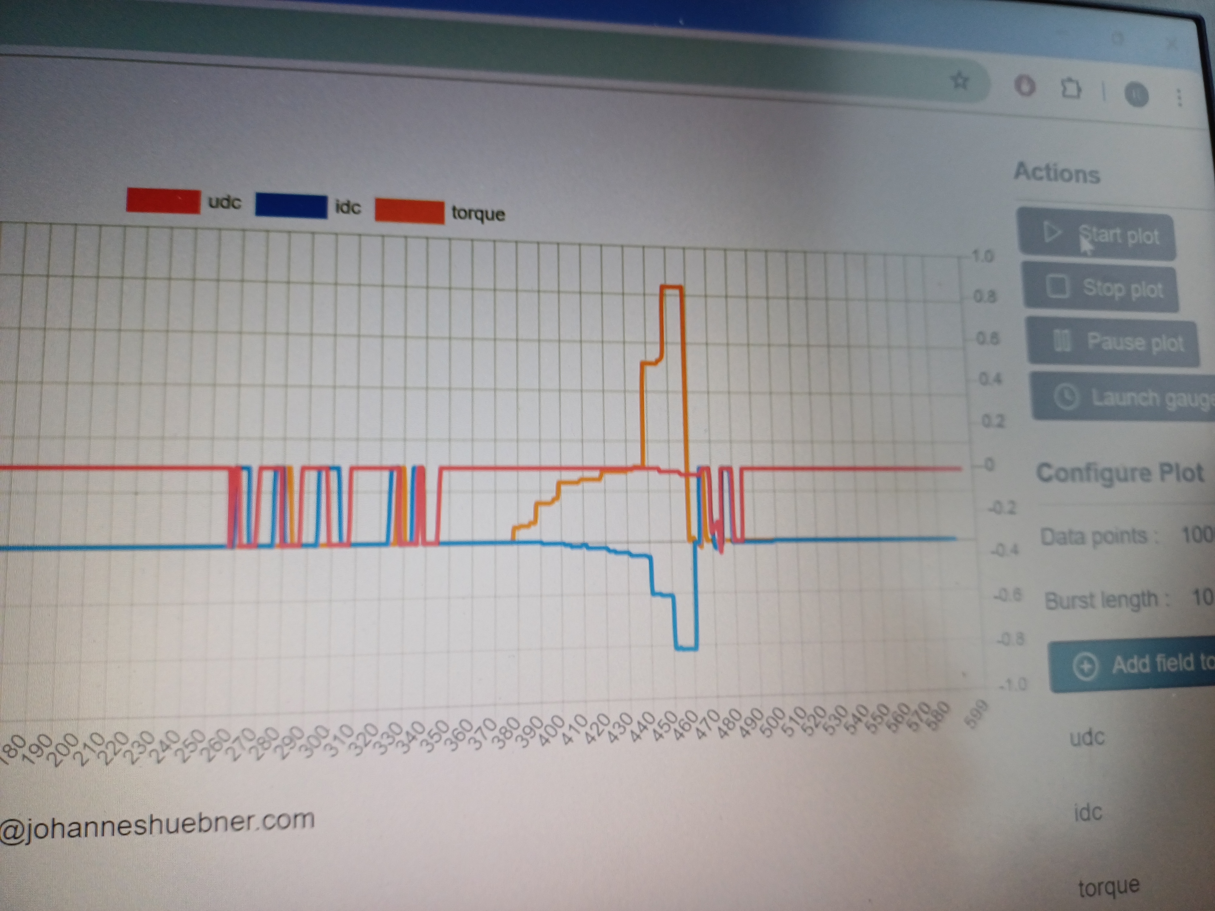

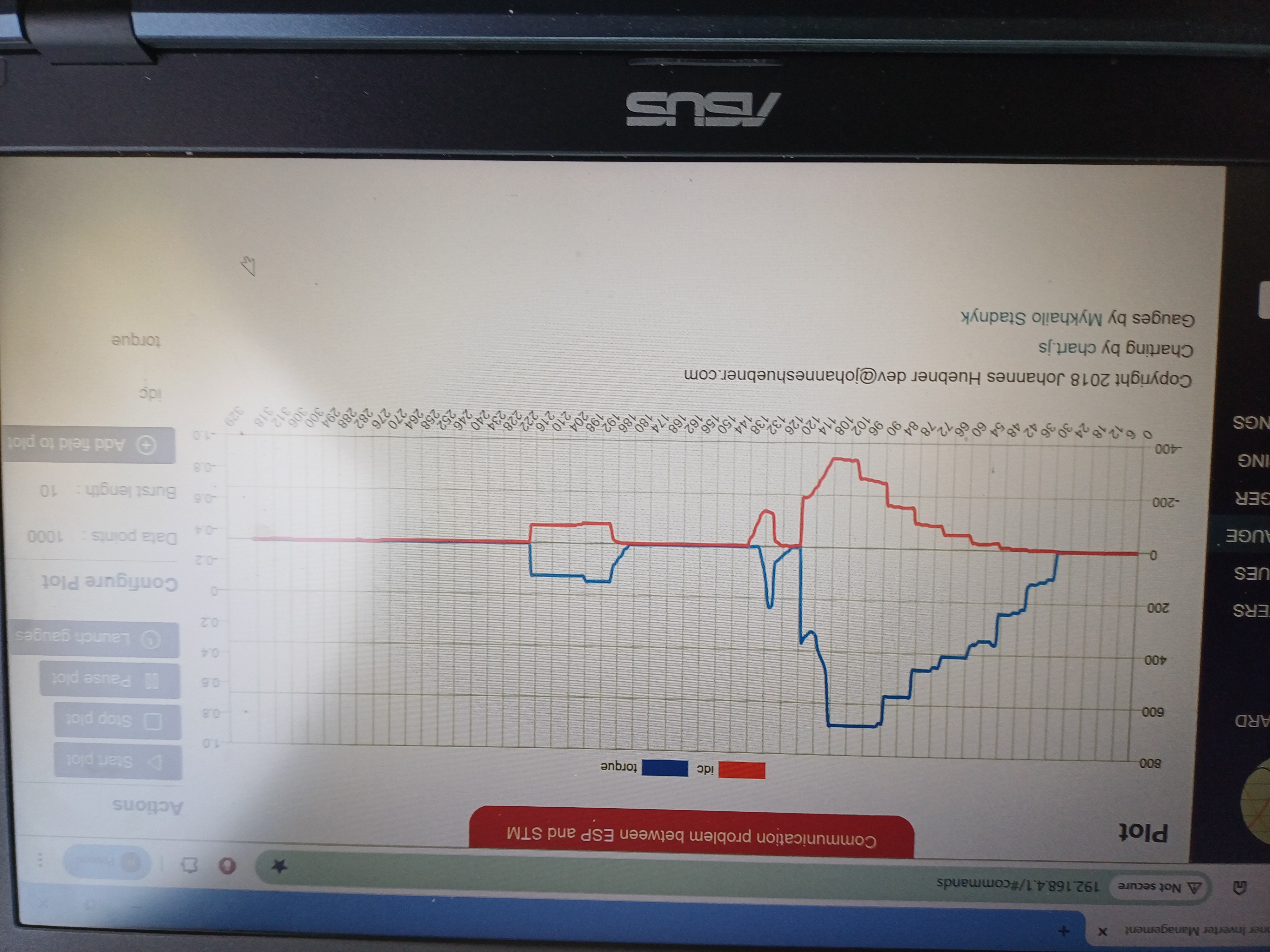

udclim 1000
Idcmax 5000
Ist picture at 80% massive torque cut
2nd picture at 30% moderate acceleration
3rd picture at higher revs 30% still torque cutting
Idcmax 5000

You IDC is going negative...
Guess changing IDCmax does nothing as that would be a positive value.
Your settings
Your settings
"idcmax": 350,
"idcmin": -350,

Cannot see anything on the pictures. Please makes sure to get the whole screen. Better yet grab screenshot. You also need to say which values are on the left scale and which are on the right.

Your previous pictures do not show the full plot views.

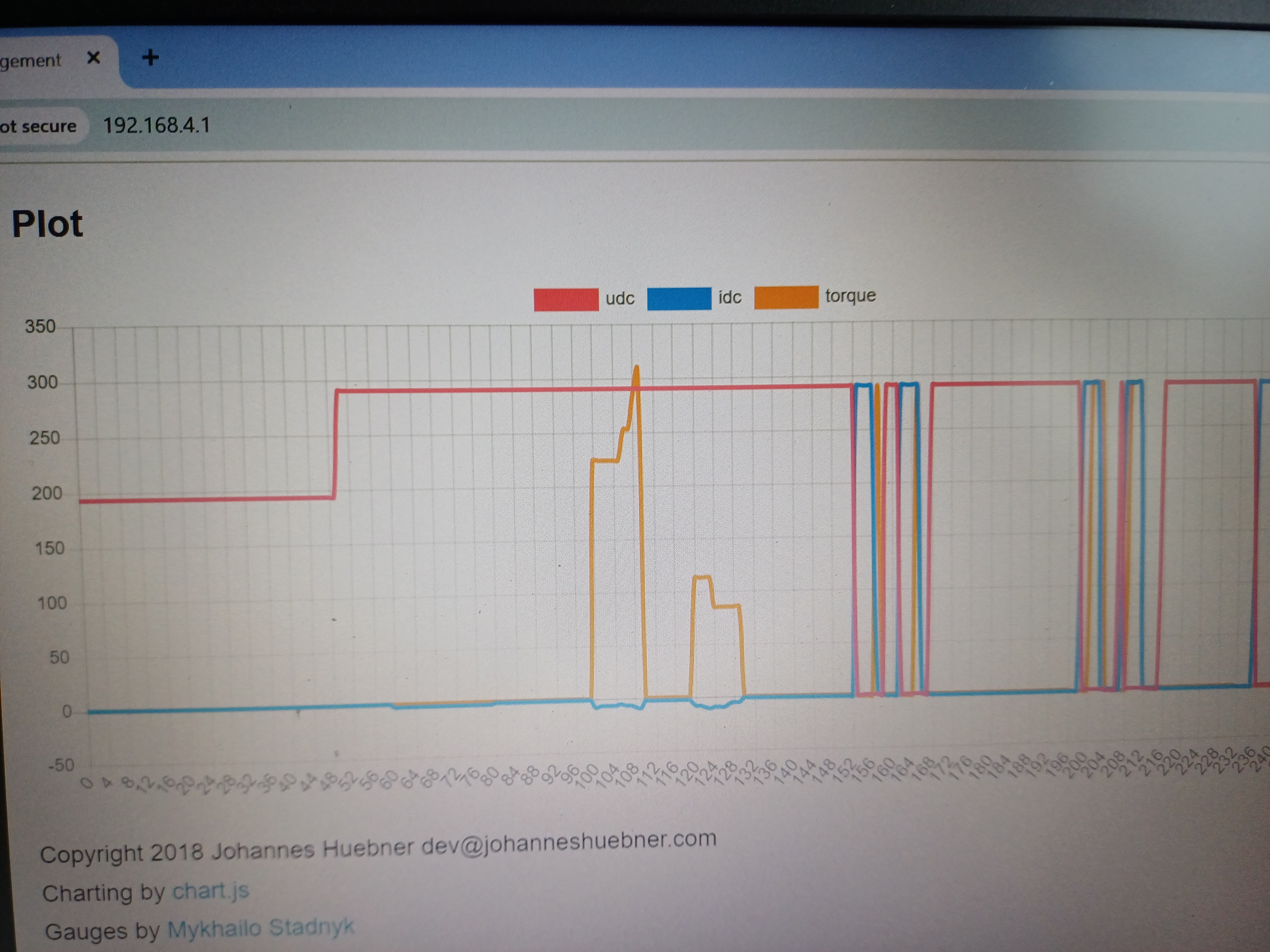

I understand about the photos I was just asking what parameters you need on the plot. This will be with 2.17A of course also what would you suggest would be Safe settings for udc and idc?

Leave them as they were at start of thread and change just one of them. UDCmin UDClim and IDCmin IDCmax, please only change one. Start with IDCmax as per BigPie's suggest. Raise it to lets say 500A.
Plot the following:
Potnom on left
UDC and IDC on right
Plot the following:
Potnom on left

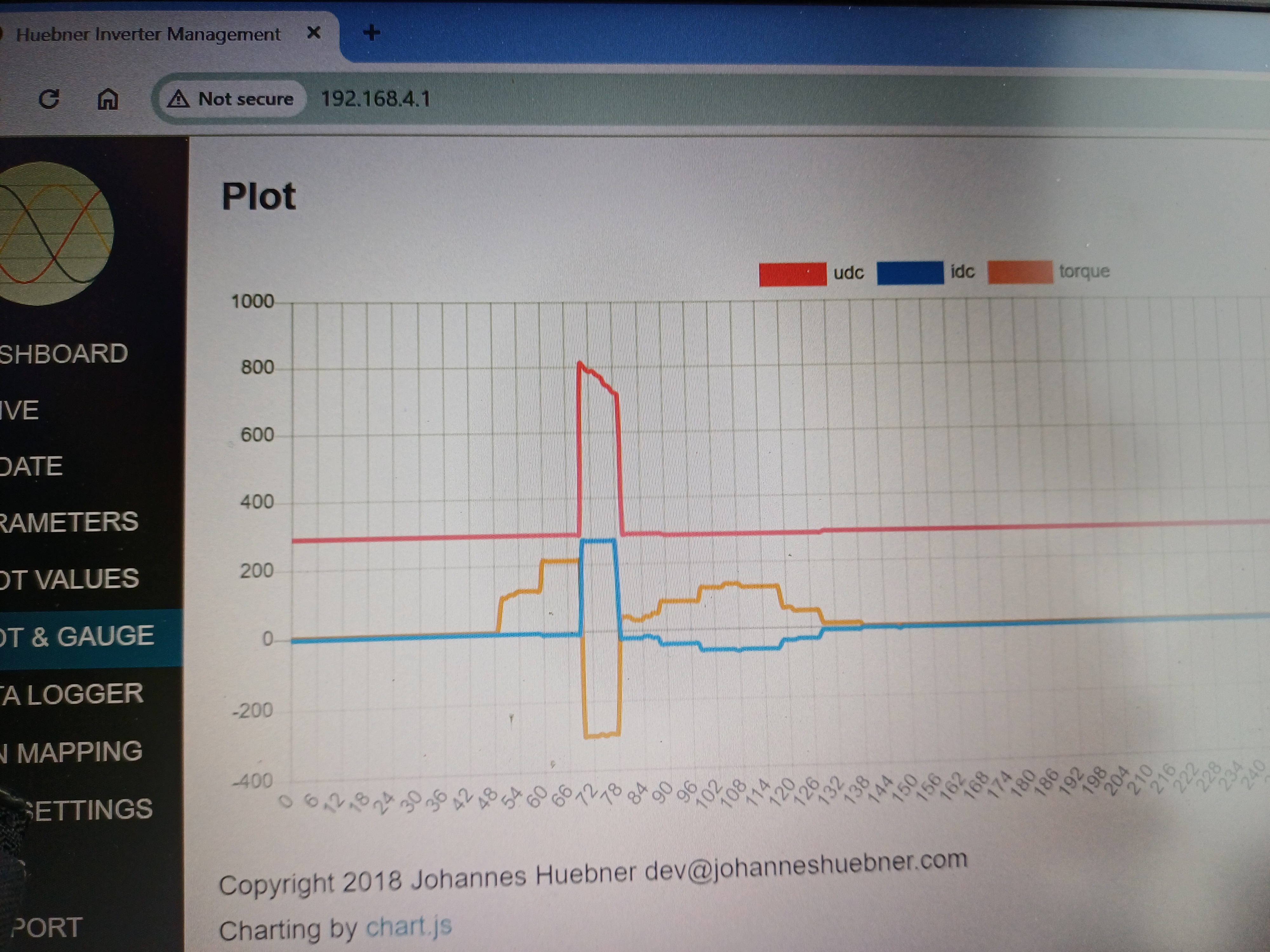

Looking at this plot
What is going on! under regen the UDC goes to 800V (if I read the plot correctly)
Is the switching value between UDC and IDC because of communication problem or something else?

I guess the udc has a different scale on the right hand side of the diagram.
