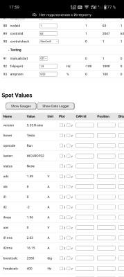

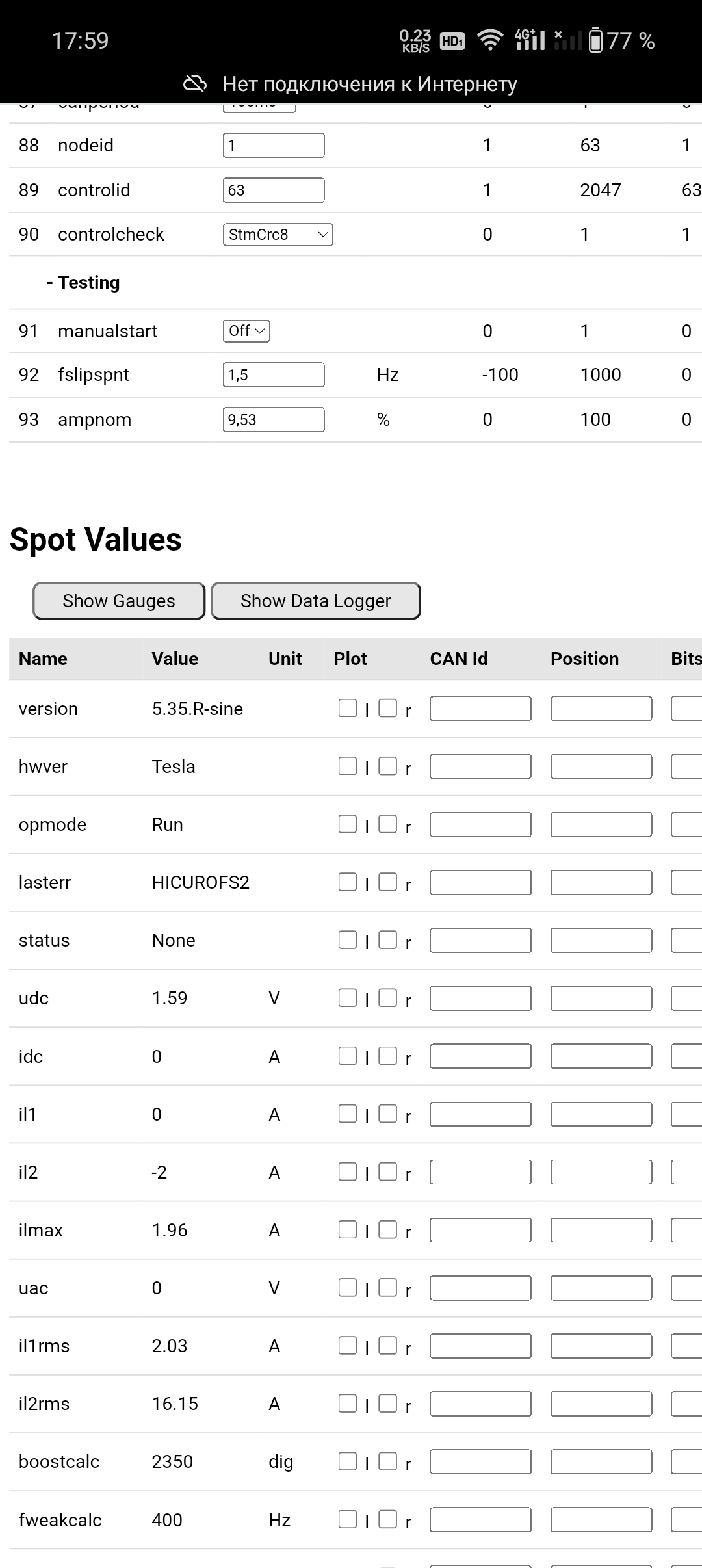

I bought a sports LDU, and a few years ago I got an O.I. board for it, and all this time it was waiting in the wings.
now I have both a power plant and a replacement brain. but I always get this error regardless of whether the high voltage battery is connected.
at the same time, the state of the inverter remains in the "run" status, but the accelerator does not respond and there is an error of the current sensor.
I took the board off the inverter and took it home for a thorough inspection of the soldering points under a microscope. everything is fine in this regard.
How do I properly use a multimeter to check the board on the table for errors in the dividers of the current sensors?
Who has any thoughts?

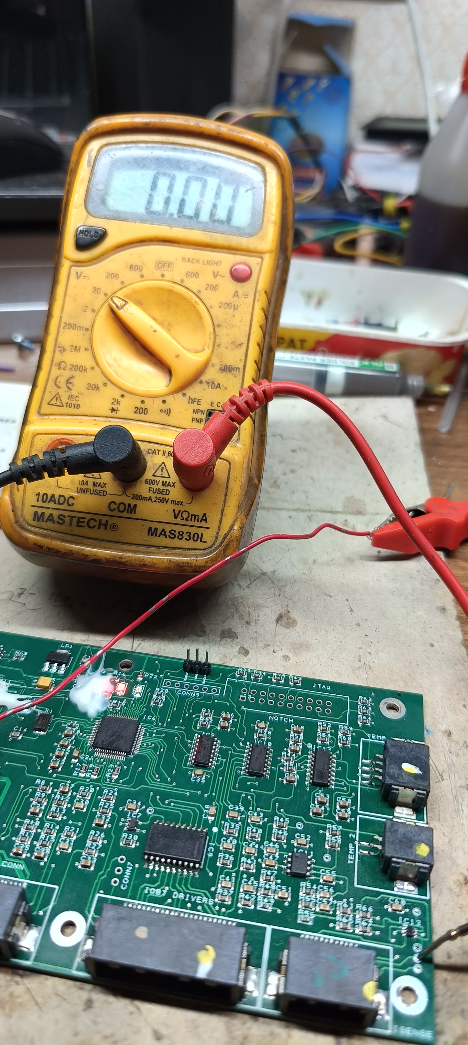

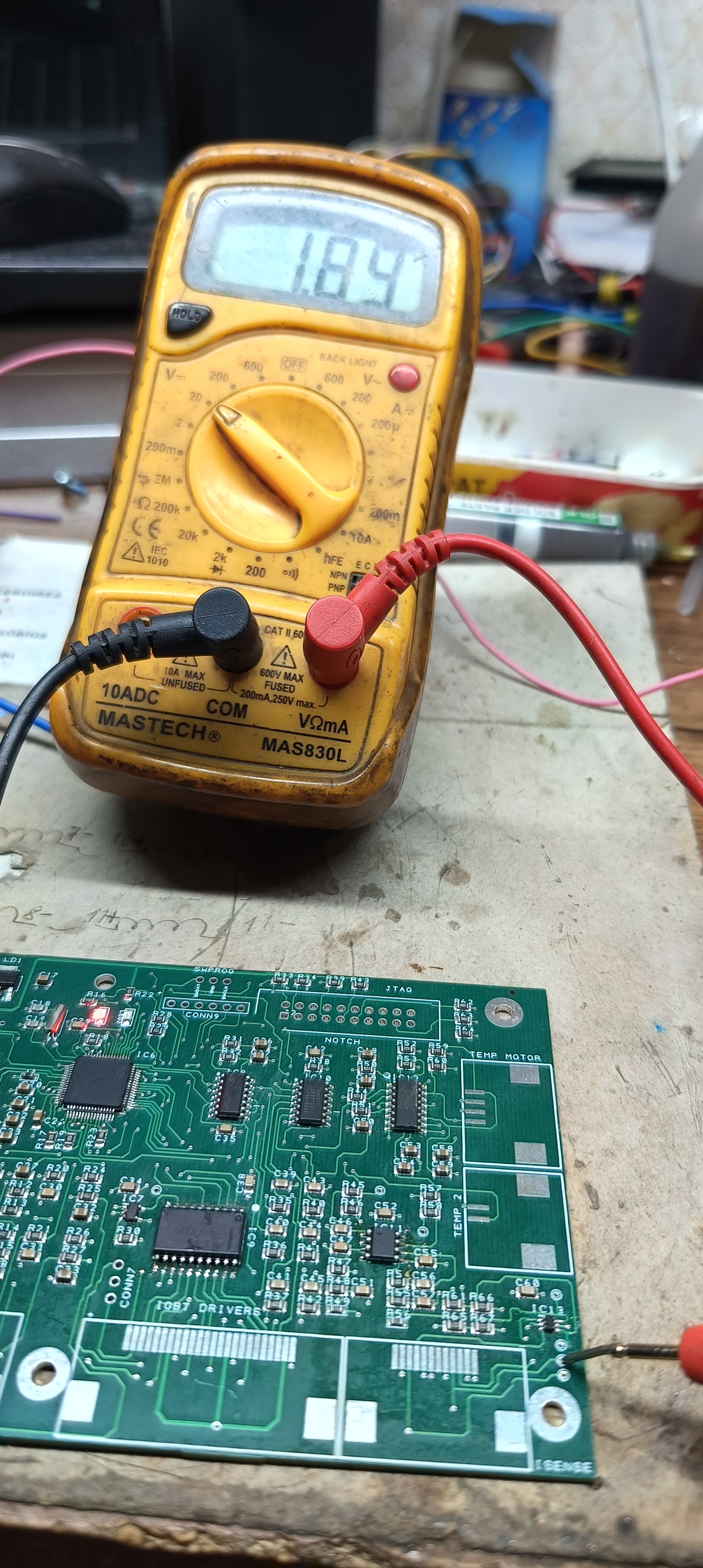

I applied 12 volts of power to the board and measured the voltage at two points near the connector of the current sensors. there were 0 volts.
While on another board (not programmed!) There are 1.9 volts in these places!
Could this be a problem or is it just because the board is without firmware?

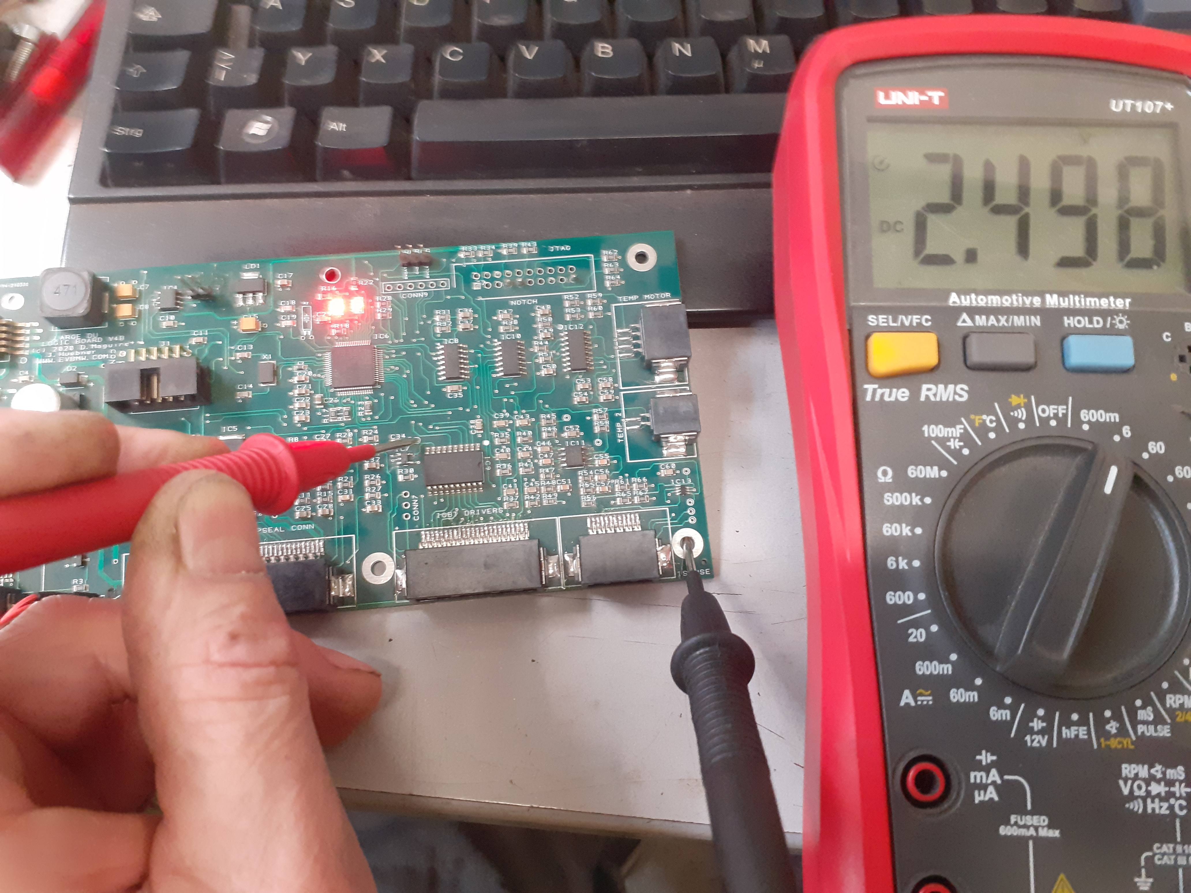

At this point I can measure a square wave signal with 4.6 MHz and 5V level. Also on the pin below.

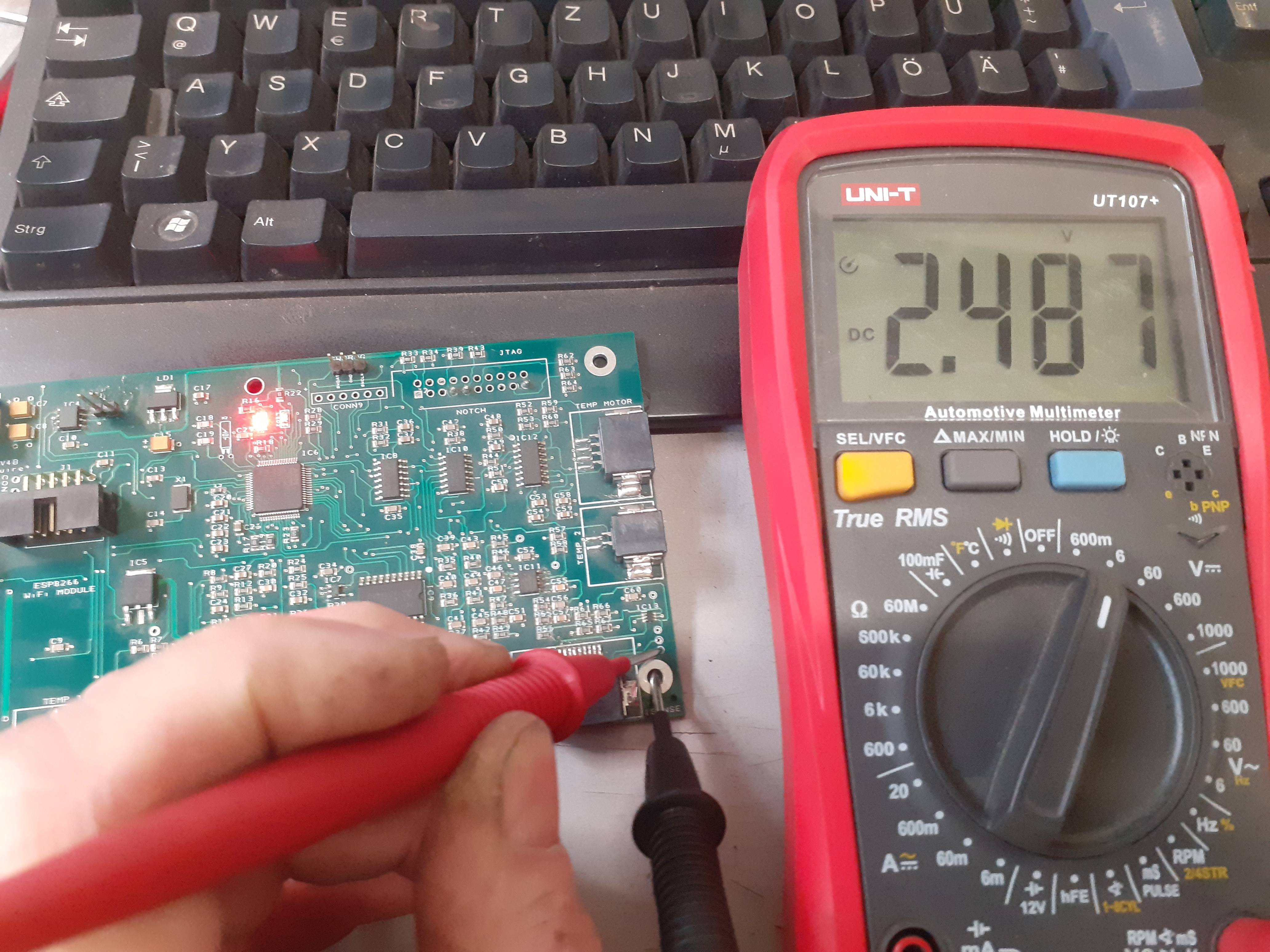

This is CLK-IA and CLK_IB. It is generated by IC7 and goes to the two test points via IC9. There is another test point near IC7/IC9

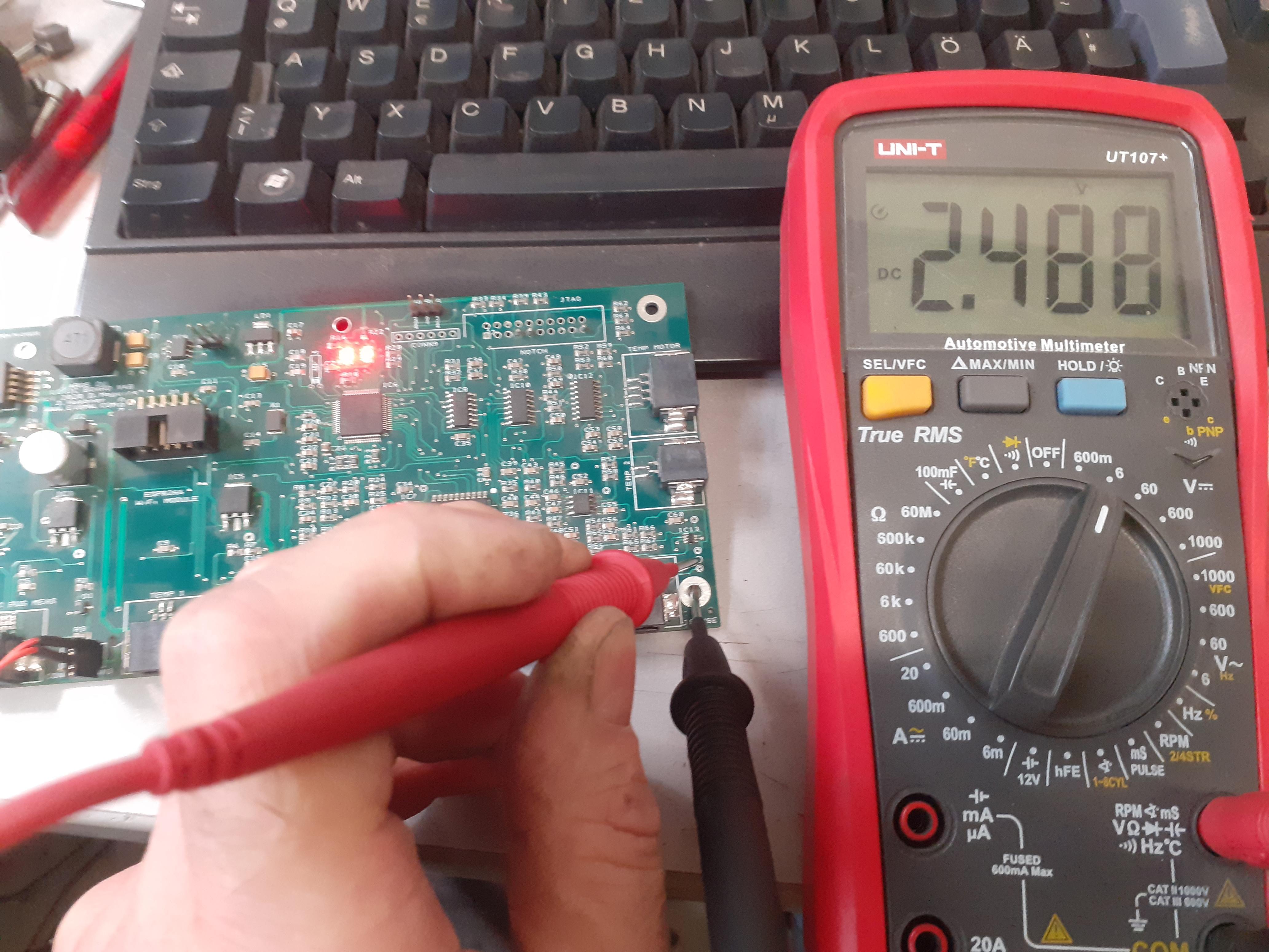

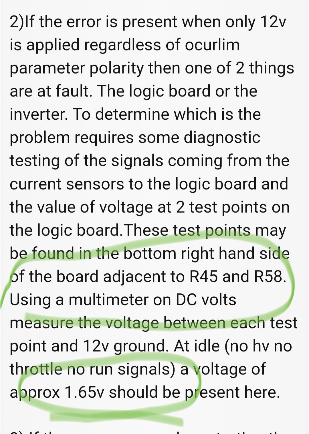

Very easy. With a board lying on the table and only supplied with 12V, regardless of whether it is programmed or not, approx. 2.5V should be measured with the multimeter on the two bottom pins. If this is not the case, IC9 is probably broken. If there is no 2.5V at the test point in the middle, IC7 is broken.

there are 0 volts on the old board in these places.
on the new board, at two points near the ic 13, 1.89 volts each. I'll check it out at ldu today. Thank you.

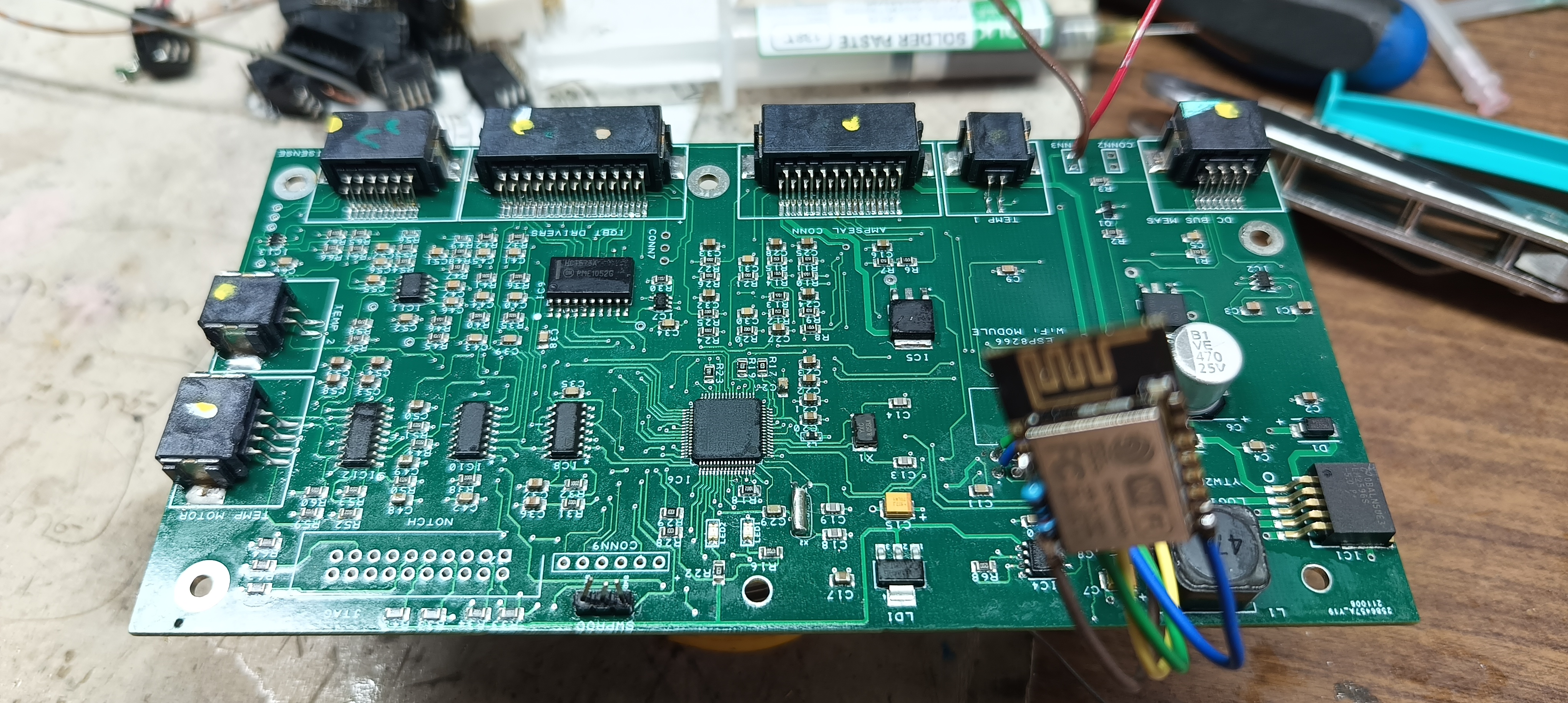

The version in the pictures has the dedicated clock chip so it will always produce a clock. Newer board versions branch off the STM crystal clock so only work when some firmware is running. They don't have ic7
