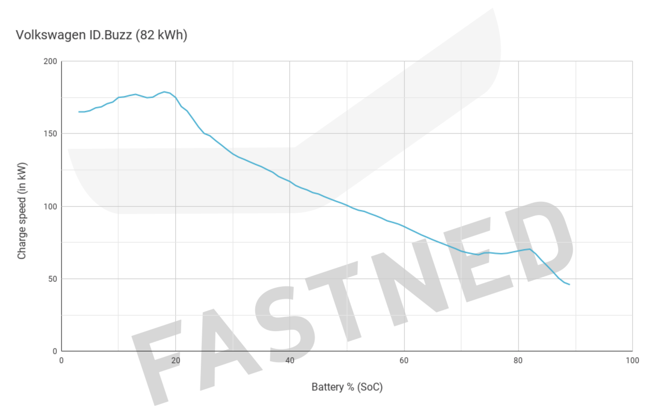

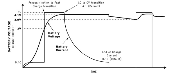

Re: Help with a Simple (Hopefully) CCS Charge Curve?
Post by Aragorn »
Why are you limiting charge current so much at lower SOC?
Dont most EV's see thier highest charging powers at those lowest points?

Post by Aragorn »
Take a look at the Fastned charging curves for various EV's, they all go hard right from the low end then taper off as the SOC increases.
Perhaps be careful below 10%, especially if you've run it really low, but from 10% upwards you should be able to run 50kw
An example:

Post by muehlpower »
I found this charging curve from Texas Instruments. It shows that up to 3V cell voltage is only charged with 10%, then full power until the maximum cell voltage of 4.1V is reached. This is maintained until the current has dropped to 10%. This is the end of charging. This behavior corresponds to what I have seen in OEM cars, but there is always no indication of the cell voltage, which is required for control.

Yeah, i imagine most OEM cars wouldnt let the battery get below 3v per cell anyway... Hence they all go very quickly to full current.

Post by P.S.Mangelsdorf »
muehlpower wrote: Thu Oct 03, 2024 2:08 pm I found this charging curve from Texas Instruments. It shows that up to 3V cell voltage is only charged with 10%, then full power until the maximum cell voltage of 4.1V is reached. This is maintained until the current has dropped to 10%. This is the end of charging. This behavior corresponds to what I have seen in OEM cars, but there is always no indication of the cell voltage, which is required for control.
That's interesting - so they're continuing to provide (decreasing) current after reaching full voltage?
I do know that these Volt packs' charge/discharge curve is more linear than that example, so not sure how that impacts it.
Actually it should be quite easy. Up to 3V 0.1C, so in my case 74000Wh/360V/10=20A, then 200A. At the same time transmit a voltage of 4.1Vx96= 393V. Then the charging station should automatically reduce the amps so as not to go above 393V. For the 3V, the cell with the lowest voltage is crucial. To transmit the maximum voltage, the cell with the highest voltage must be observed and the value corrected if necessary. There is no need to reduce the amps, just observe and stop charging at 20A.
In addition, the temperatures of the battery and the connection should be monitored and the current reduced if necessary. Battery 10°C to 45°C, connection up to max 70°C
