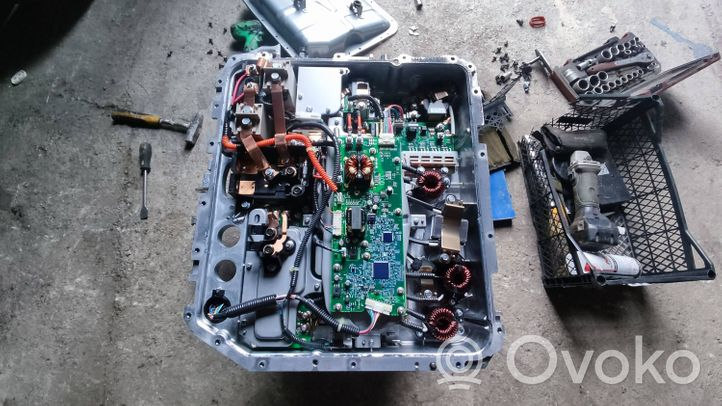

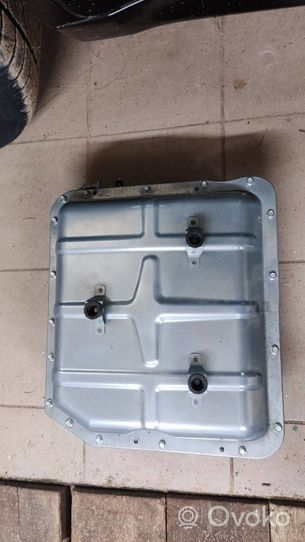

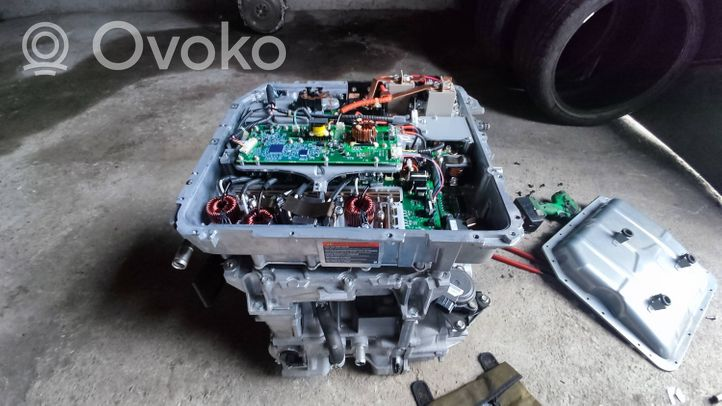

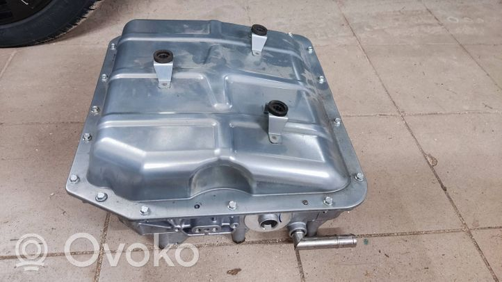

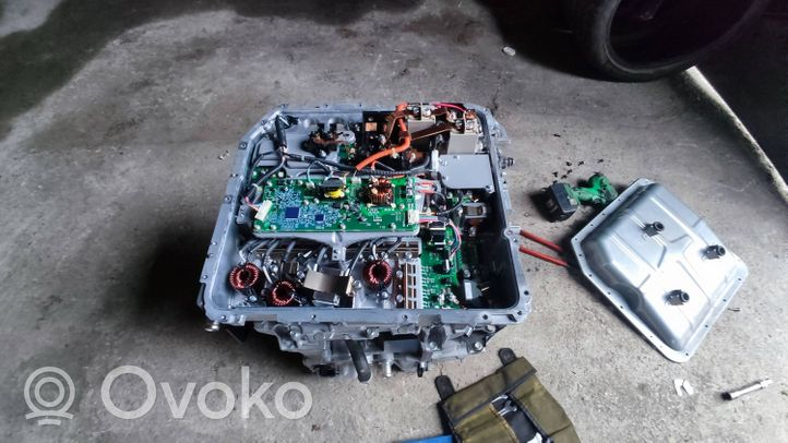

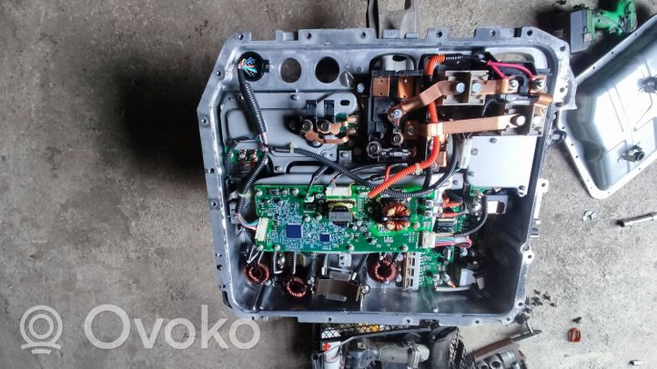

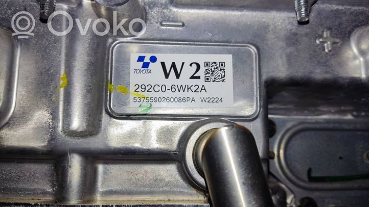

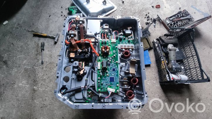

hi, have you ever seen this smaller than normal PDM?
Is there any difference to the bigger ones? Chademo, 3.3kw, 6.6kw?
I see a few for sale they are interesting for when you swap to another vehicle and need the extra head room.
m.art.y
Posts: 672
Location: UK/EU
Has thanked: 37 times
Been thanked: 36 times
Re: Smaller Nissan Leaf PDM made by Toyota?
Post by m.art.y »
I have whole Leaf motor stacks with those PDMs for sale, they are from year 2023 what I call gen4 and as I tested they don't work with Zombie out of the box so something is different. I made CAN logs for people to take a look:
viewtopic.php?t=3748
