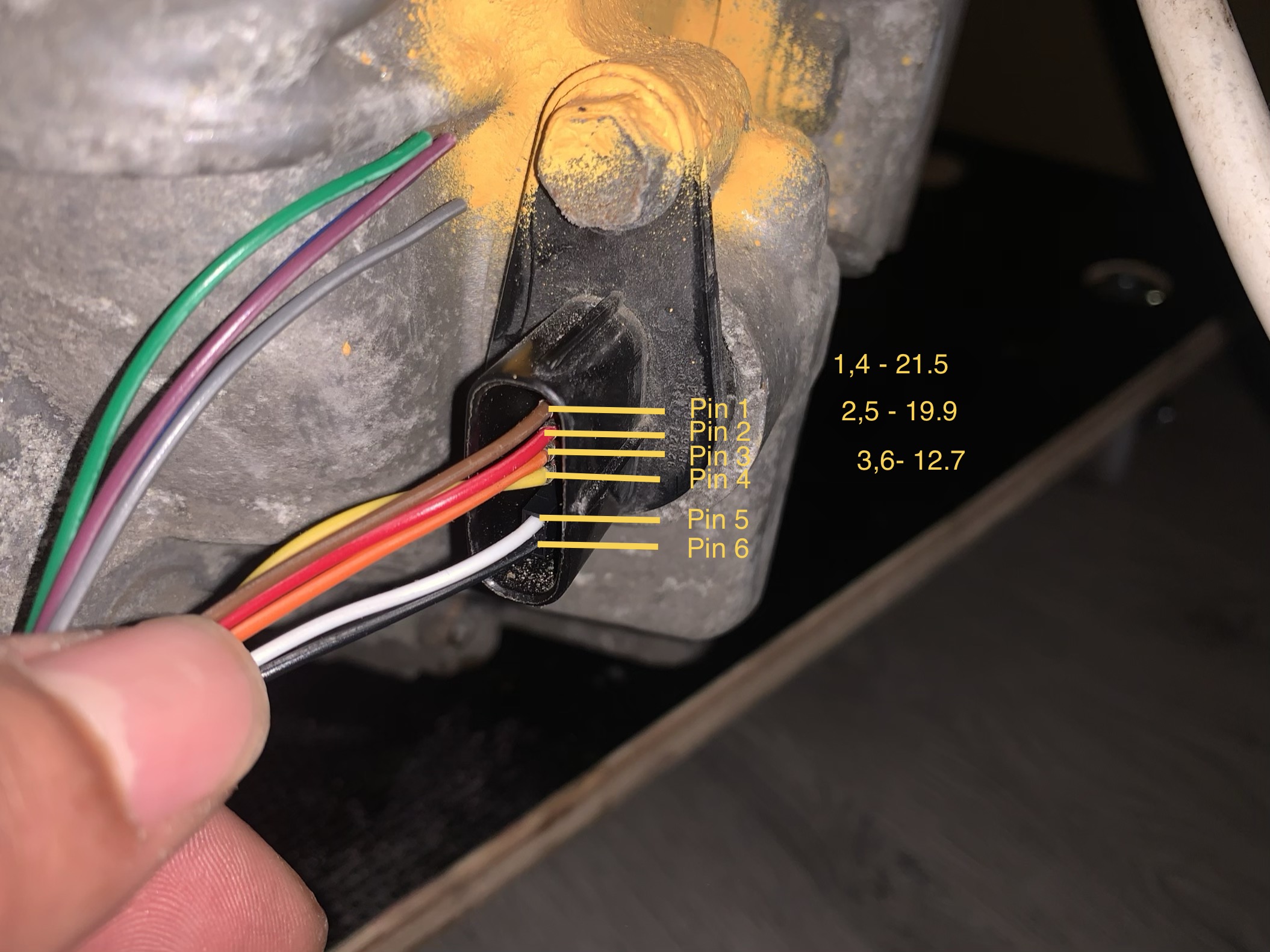

1h30 later, transaxle Mg1 was removed. Not as scary as I thought it would be. Now off to see how we lock up this baby to withstand 30kW of Mg1 Japanese Power added to Mg2... Will hopefully blend power in like Damien's Bexus, so not to solicit from standstill = less torque stress... Planning 4 'toothed wedges' between cage and planet gears to lock them up. Will see what 3D printing comes up with 🤞
