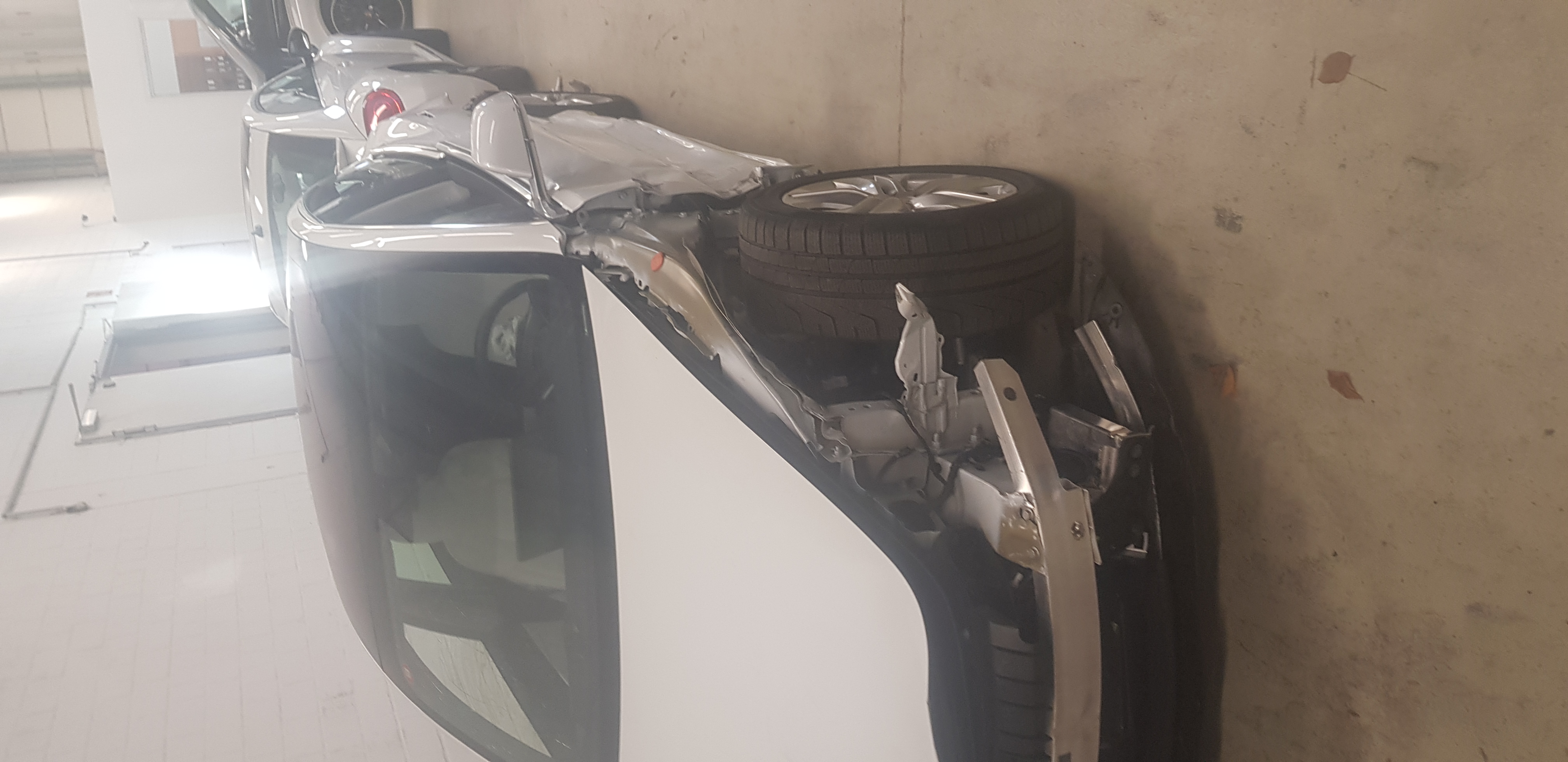

I recently bought a complete tesla car that it was involved in accident model 3 2019 awd that i wanted to swap into another car so..i studied the forum for diferent options to swap this thing.

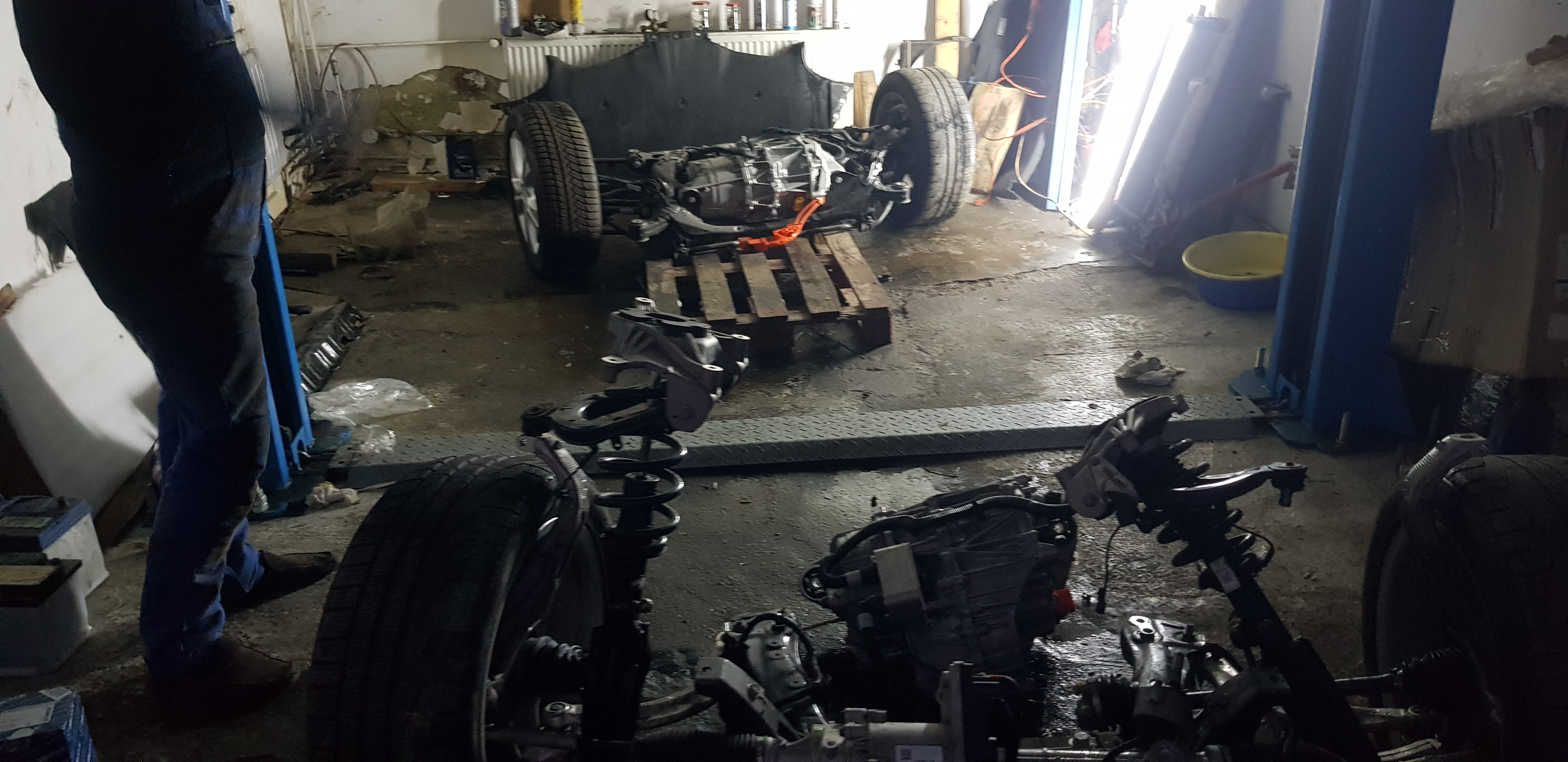

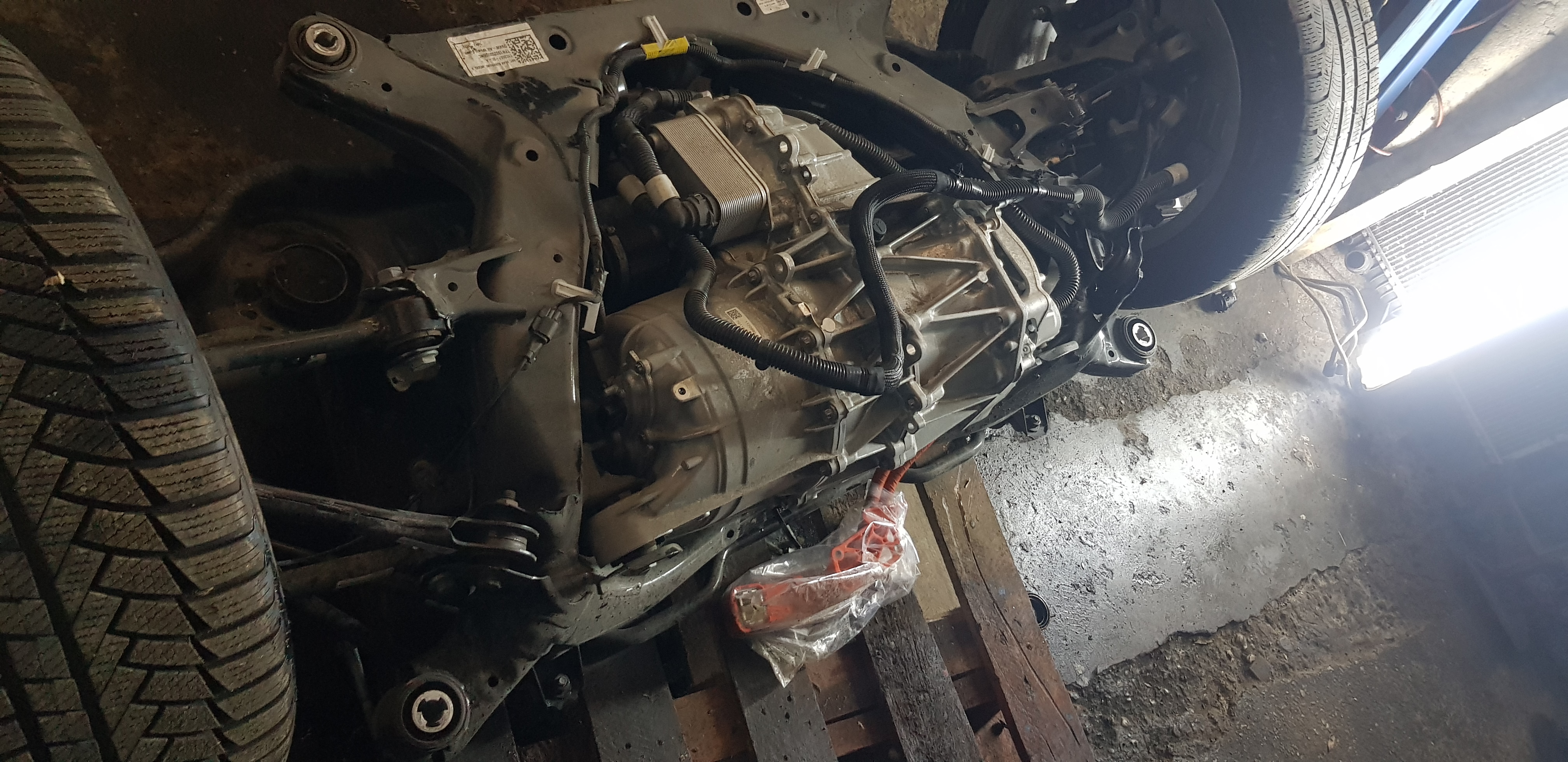

I saw what i have to move...all.that why i need yo know if the pcb for inverter will work.want to put both motors.in sunday i will take down both motors and batery..i will put pictures

The motors are down and i will prepare for shipping to you
