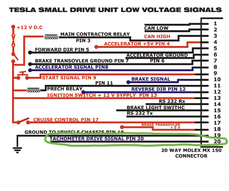

I have the modified (running backwards, ghetto LSD) Tesla SDU with OpenInverter installed in a subframe and all wired up.
I am using the following wiring diagram with the contractor box from the MG ZS EV. I added an extra line to close the Main Negative contactor on Ignition.
When I flick the Ignition switch the Main Neg contactor closes. The Pre-Charge contactor also closes and remains closed for a second or two then opens again. I assume it is looking for the battery voltage, not seeing it, and releasing the Pre-Charge contactor.
I have connected a 60V DC power supply to it and it does the same. Maybe this is not enough? Or maybe there is a setting in the interface for a voltage threshold. I haven't looked yet but thought I would run past the hive mind first.
Let me know your thoughts.

Settings are required to be shown for us to help, please post your settings.
Please graph UDC while this is going on in the webinterface to show if the drive unit is measuring voltage.

I followed your instructions above (thanks):

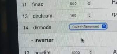

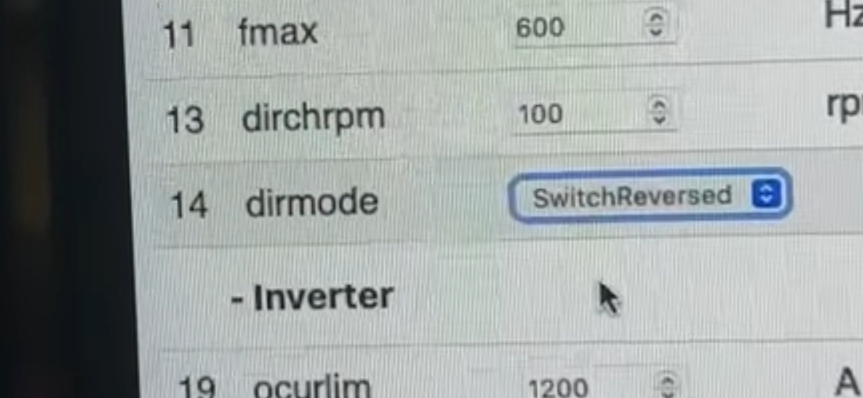

udcsw 0
udcmin 0
Then I calibrated the pedal with a dead spot at the bottom and top of the range.
If you watch the video you'll notice that even though I have the direction switch to FWD and dirmode set to SwitchReversed it actually runs backwards (well forwards, but I have the motor rotated 180º). I've since changed the dirmode to 'Switch' and it behaves properly. Must check my wiring though.
