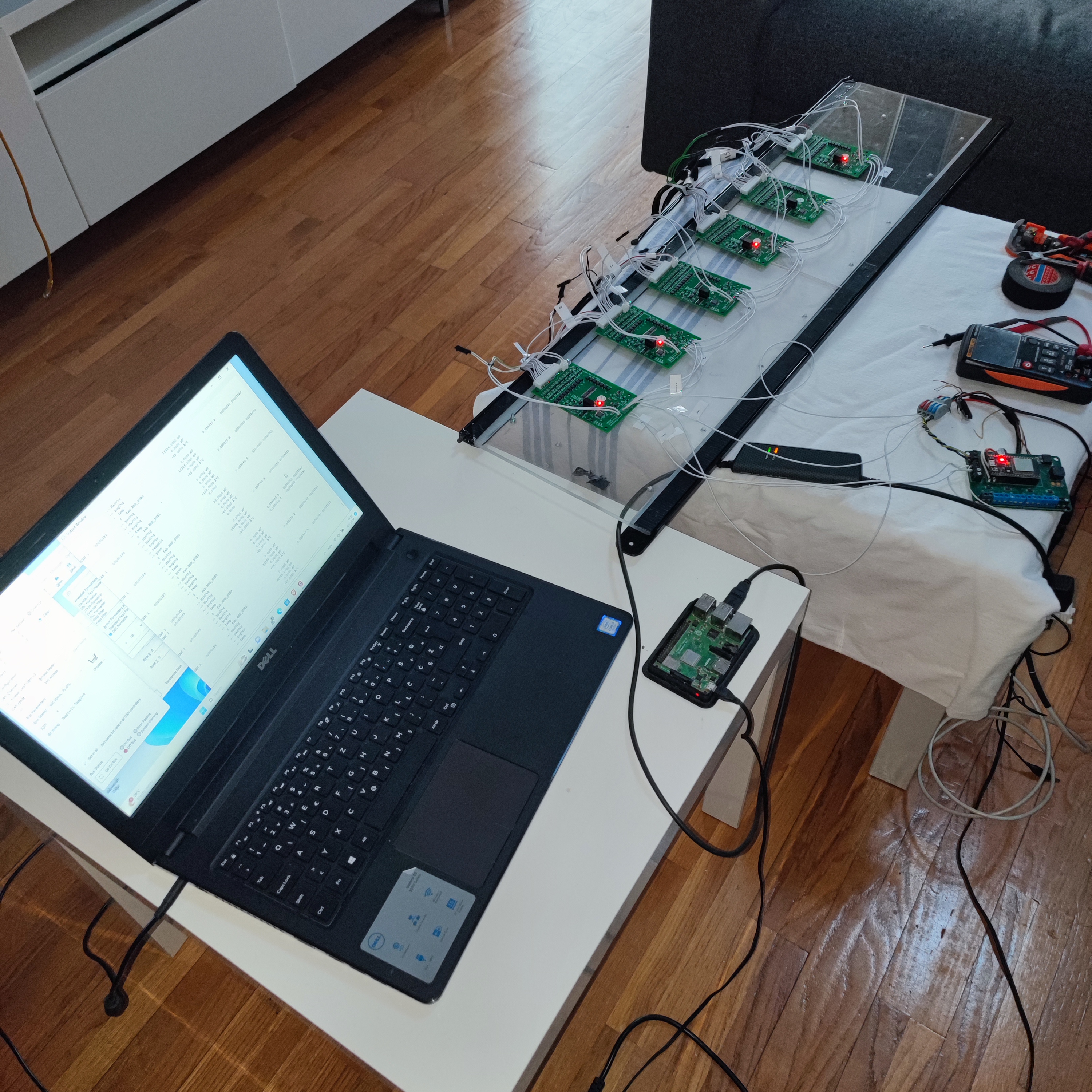

I have a 96s battery that I want to monitor and balance using Flying ADC BMS. I'm using 6 boards from OI shop and have them chained together using CAN.
BMS is connected to vehicle CAN in a BMW e39 and because there is BMW DSC message with 0x1F5 id, I would like to change default master pdobase id to 0x1E4 because default BMS address for submodule 1 is 0x1F5.
Problem is that pdobase parameter change on master board is not persisted after changing it with oic write and repowering BMS board.
I'm using RPi5 with SocketCAN and oic tool connected to CAN using Kvaser Leaf Lite HS v2 adapter.
CAN communication is working great.

test setup
test setup

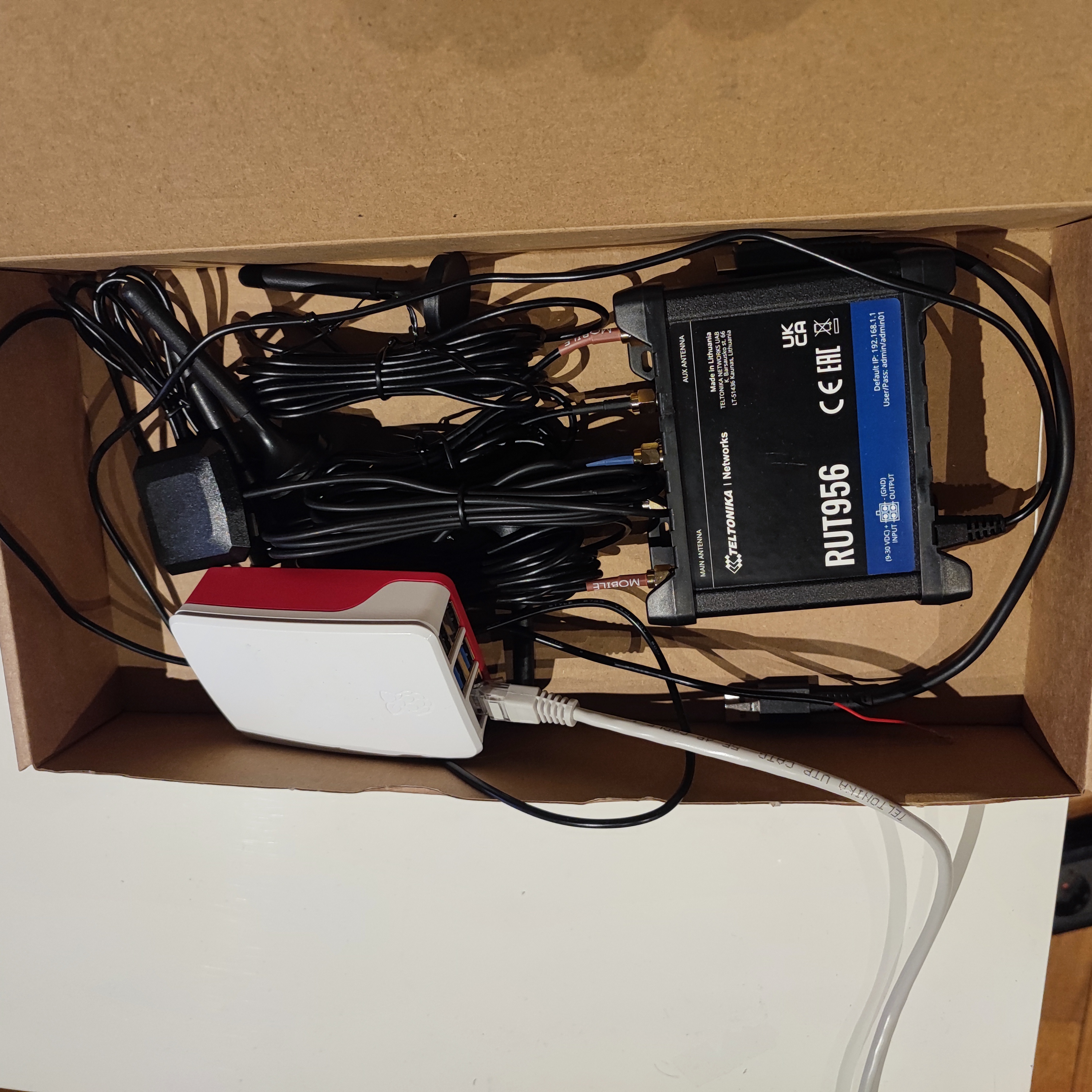

Plan is to log all bms can traffic into influxDB so it can easily be visualised with Grafana or similar. That should look good in pictures. :)
Also, plan is to make it online 24hrs and accessible through RPi connect and SSH - got full box of it. :)
