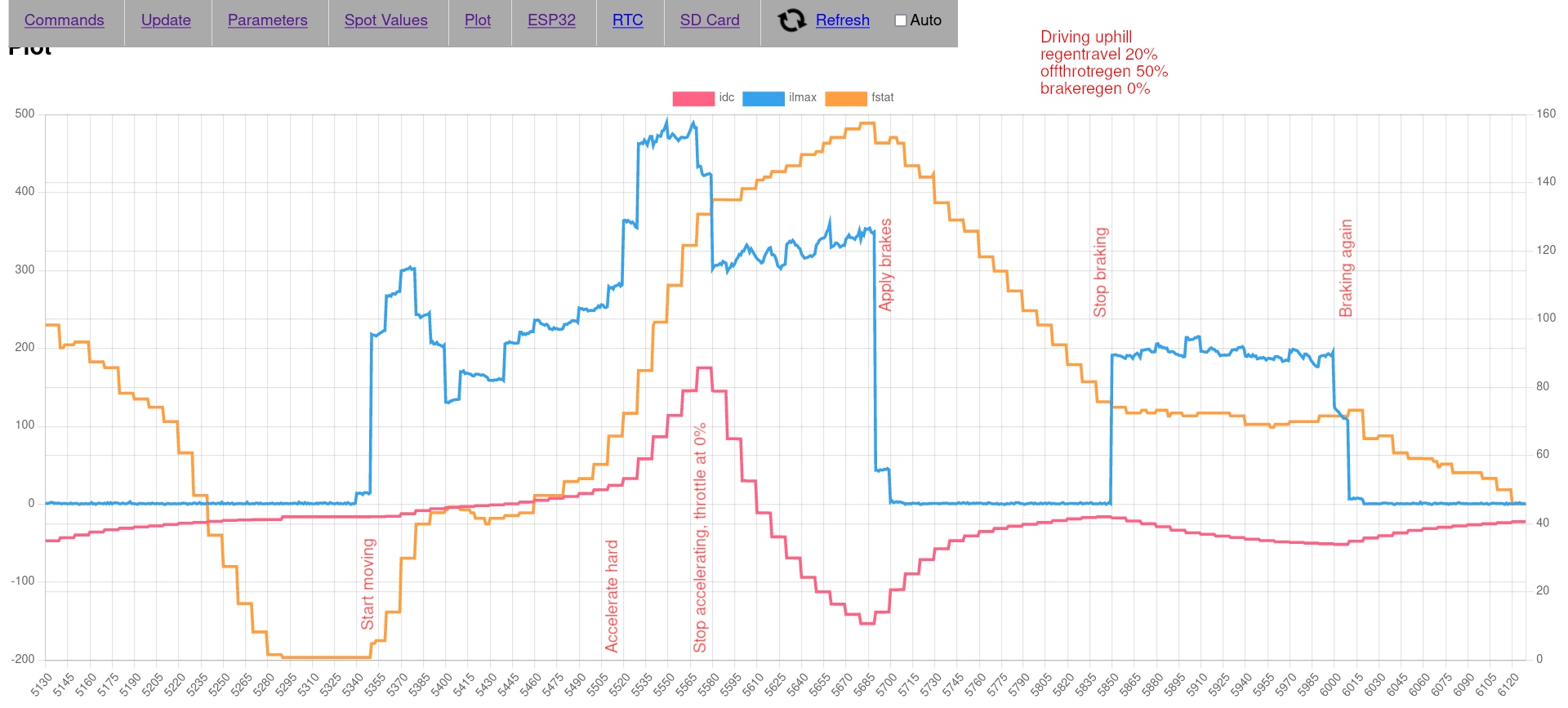

I did some testing, setting regentravel to 20%, offthrotregen to 50% while keeping brakeregen at 0%. The car is low on power due to worn batteries, smaller regen values barely felt different from no regen. I drove uphill in first gear for this test. You can see the idc value going negative during regen, however car continues to accelerate. See the attached screenshot. idc and ilmax on left scale, fstat on right scale. Idc in the positive direction is confirmed accurate by a dc clamp meter on a battery cable.
Acceleration during regen seems to get more aggressive as motor rpm increases. Under 500 rpm nothing happens and the car just cruises. Under ~800 rpm the car does barely slow down on a flat surface. Slowing to around 500 rpm it will slowly oscillate for a few seconds between trying to slightly accelerate and doing nothing.

First assumption : you didn't count the correct number of pulses per turn. Look at one of the two signals and count only positive edges. There is no tolerance on this parameter (numimp) it must be spt on

This was the case. I noticed the numimp was actually the default value, maybe i just forgot to set it initially... Encoder outputs 128 pulses per turn. I did not count the pulses manually, instead i looked at the flywheel from an inspection hole and compared the motor position reported by inverter to actual movement. Took three passes to get it right, last calculation gave 128.004 pulses per rotation.
Car would not move with this new value initially, changing motor polepairs to 4 restored movement. I guess the default values just happened to be close enough for it to work in the first place. Regen works now as well.
