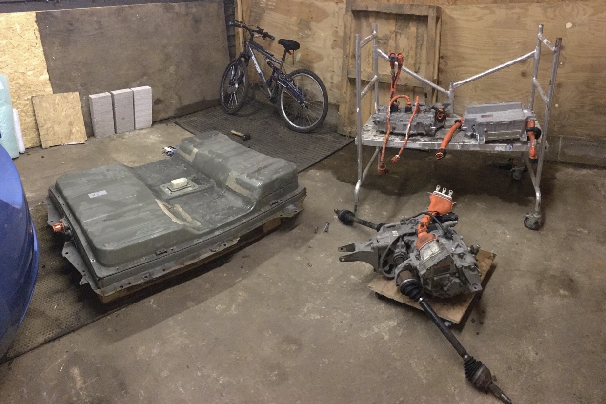

Welcome to Project Fig-Leaf. I am converting a Nissan Figaro to electric using a Gen 1 Nissan Leaf as a donor. The aim is to use as many OEM Nissan parts to complete the build and to make the conversion fully reversible.
Here’s where we are so far:

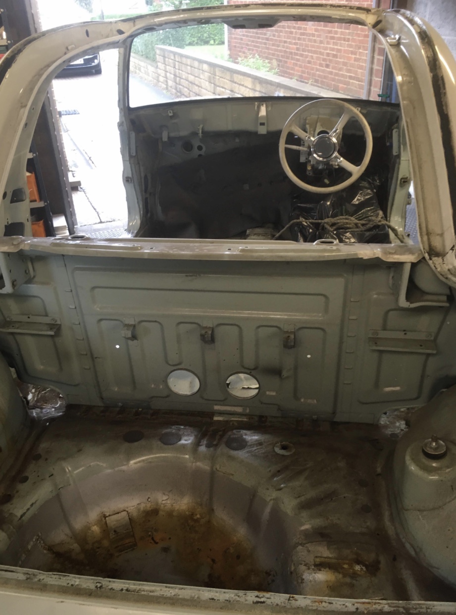

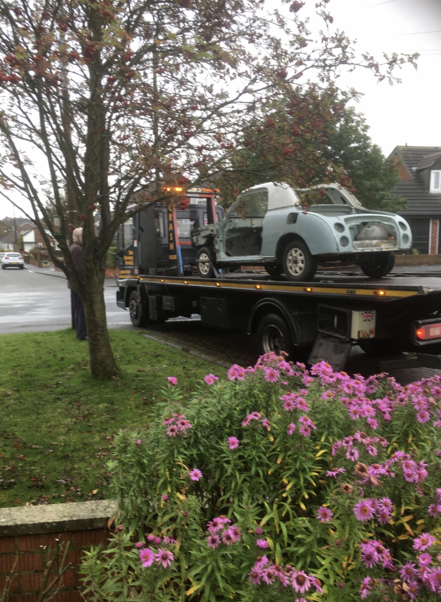

FIGARO
At the end of 2019 we completely stripped out the Figaro to have the bodywork restored. We soon found out she was beyond repair.
Thankfully we have a second working Figaro which will be converted instead (now with plenty of spares). Meanwhile, the original crumbling frame will be used as a testbed for the new drivetrain.
LEAF
The Leaf is a 2013 registered Gen 1 leaf with 52k miles. Leaf spy rated the battery at 75% SOH. All of the main power electronics have been removed (motor, inverter, pdm, battery).
We will attempt to run the motor through the leaf gearbox and use the original driveshafts from both vehicles to make temporary shafts, similar to Shane from Performance EV’s Porsche 911. We will then have custom drive shafts fabricated.

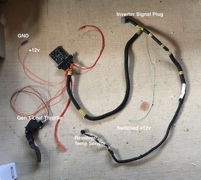

The next step is to use Damien Maguire’s VCU bought from evbmw.com to control the inverter through CAN messages.

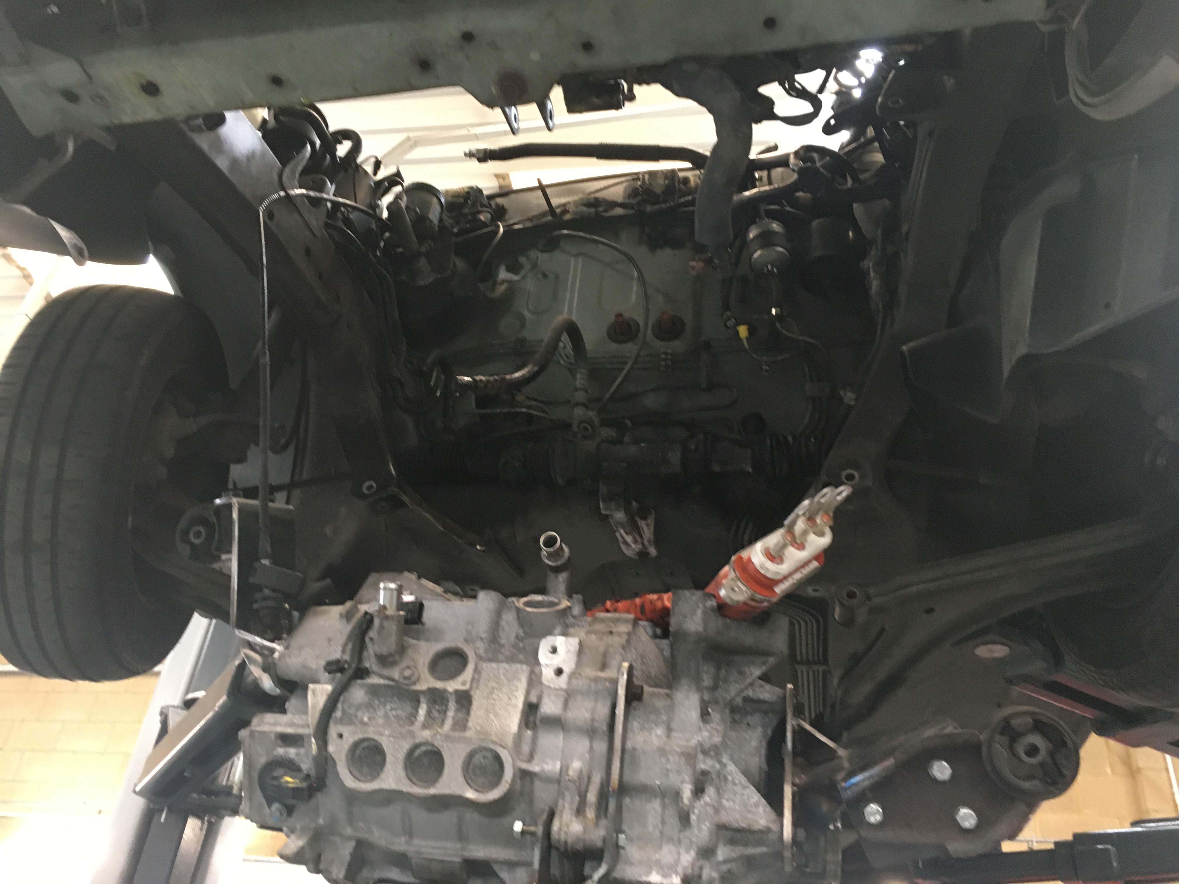

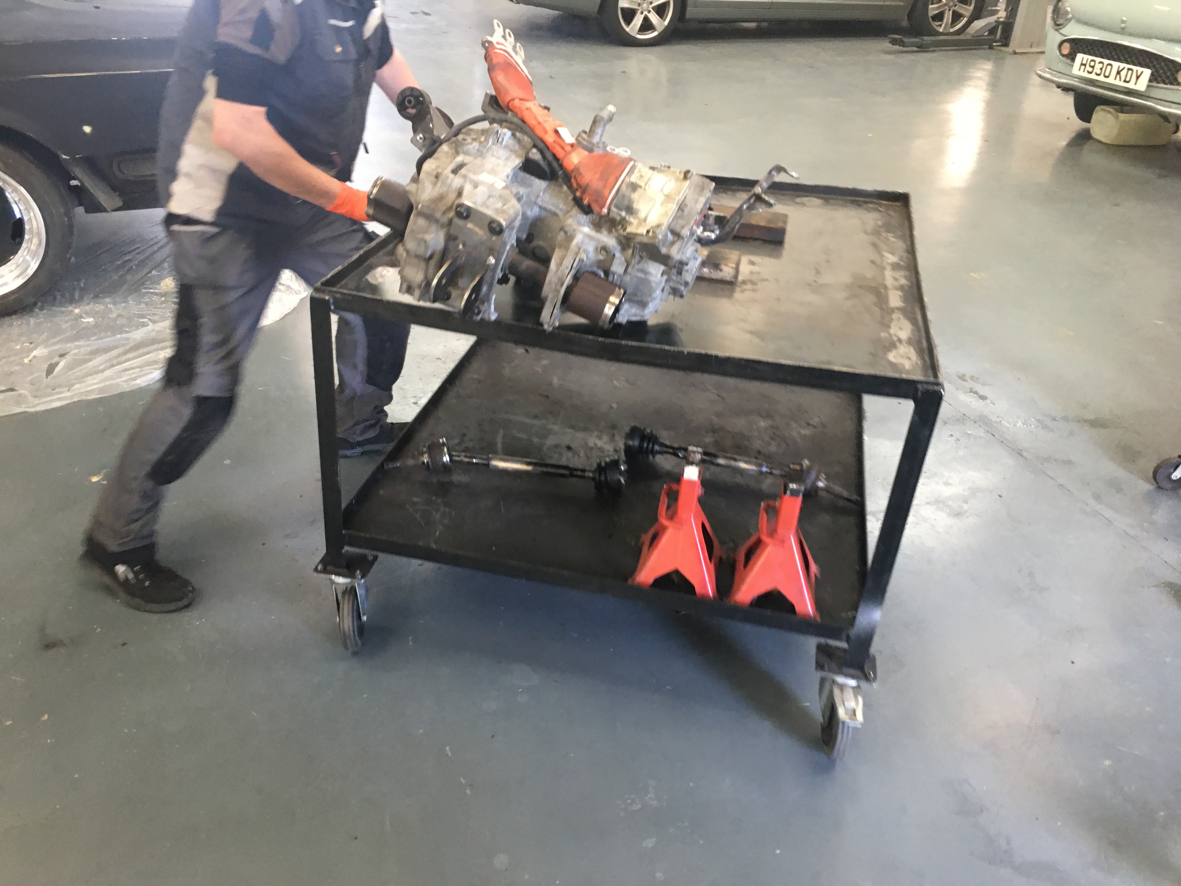

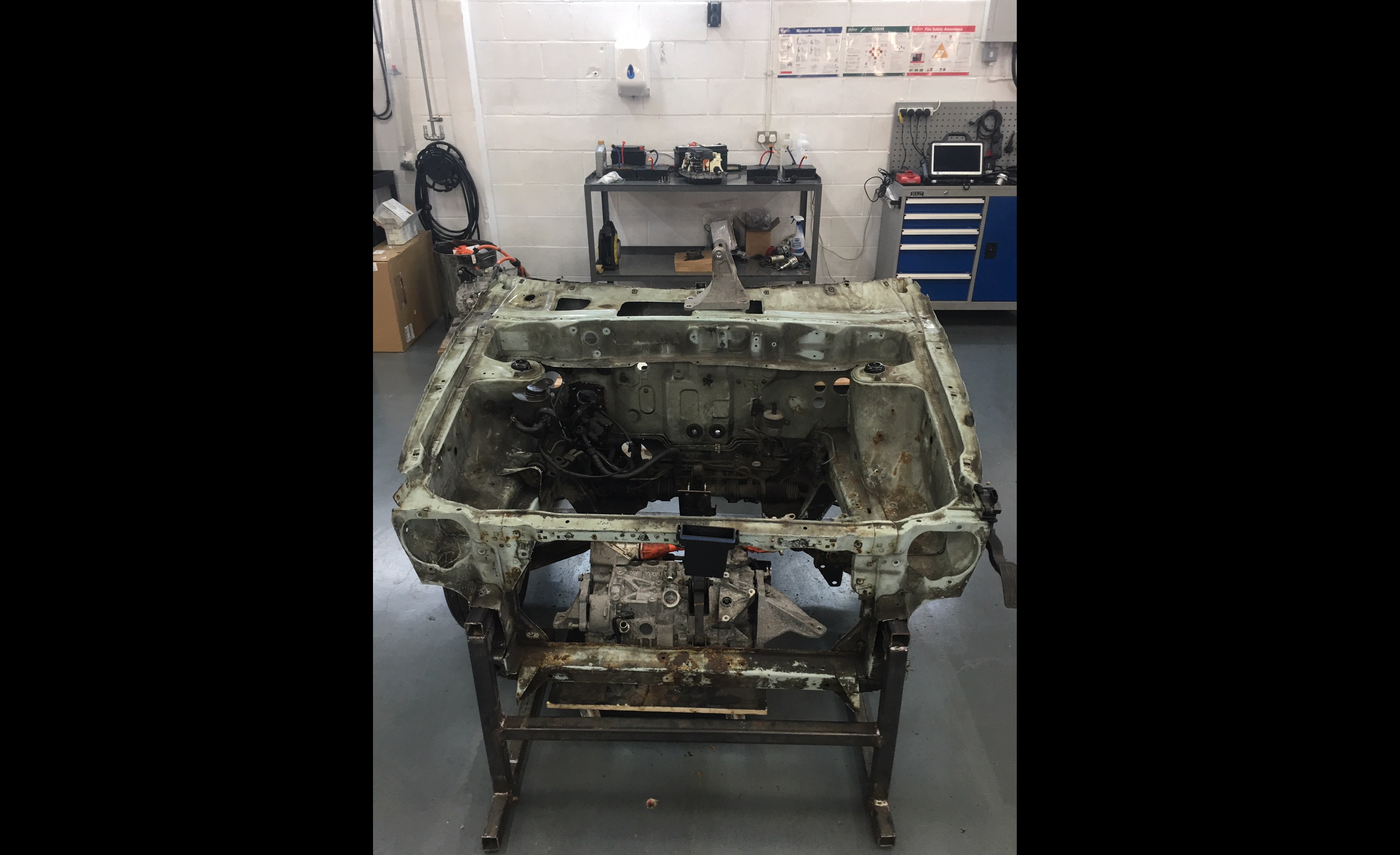

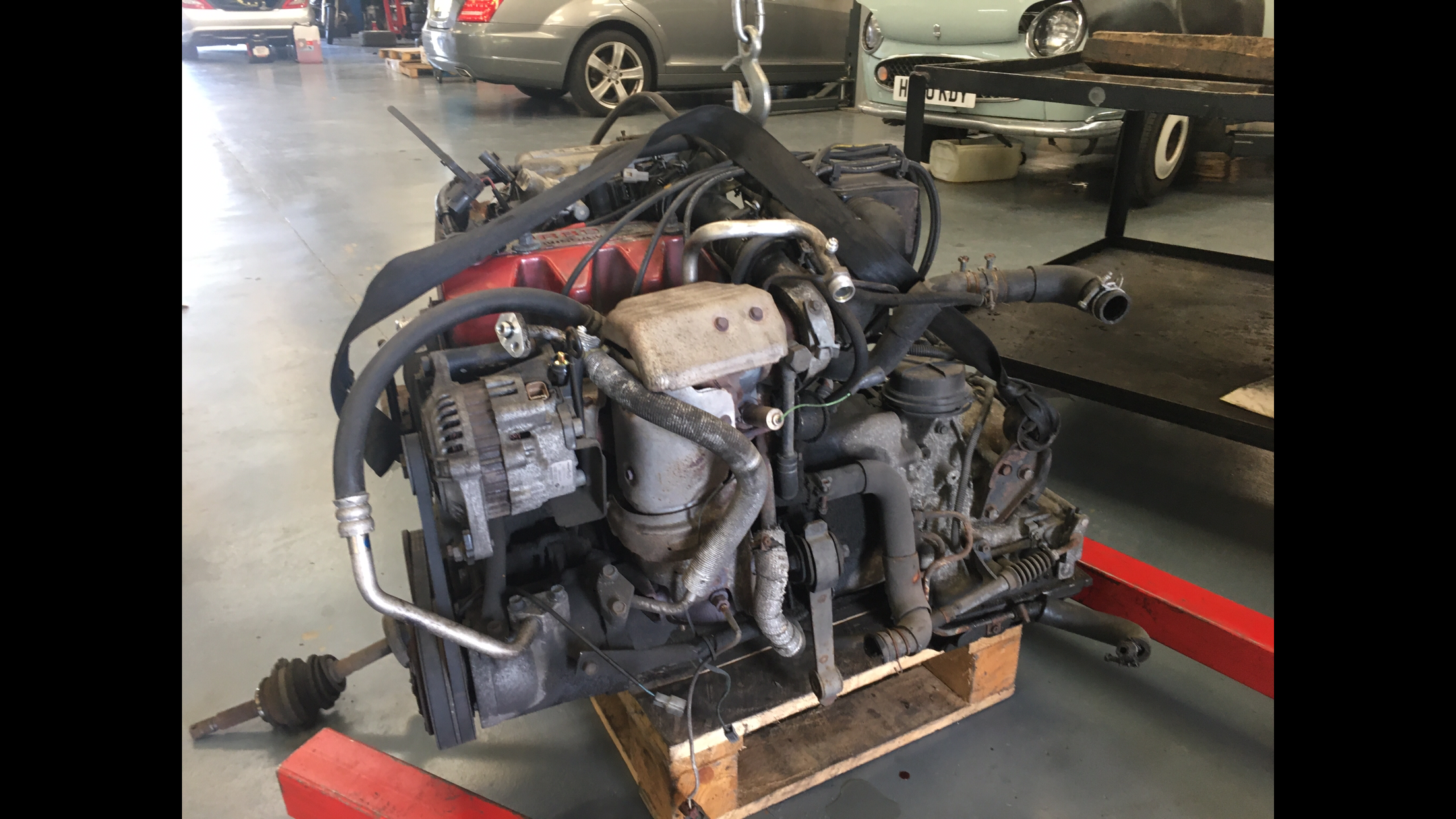

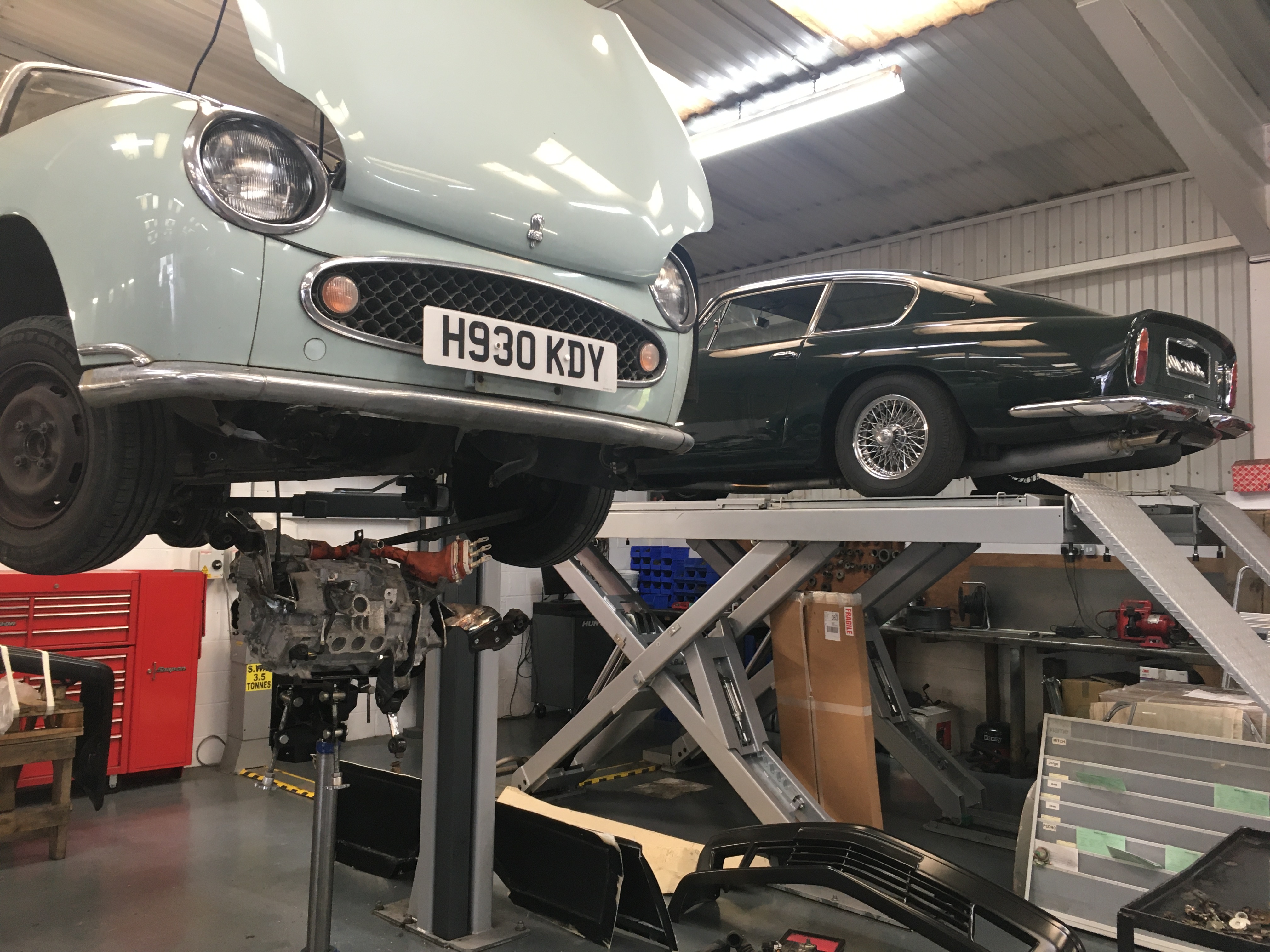

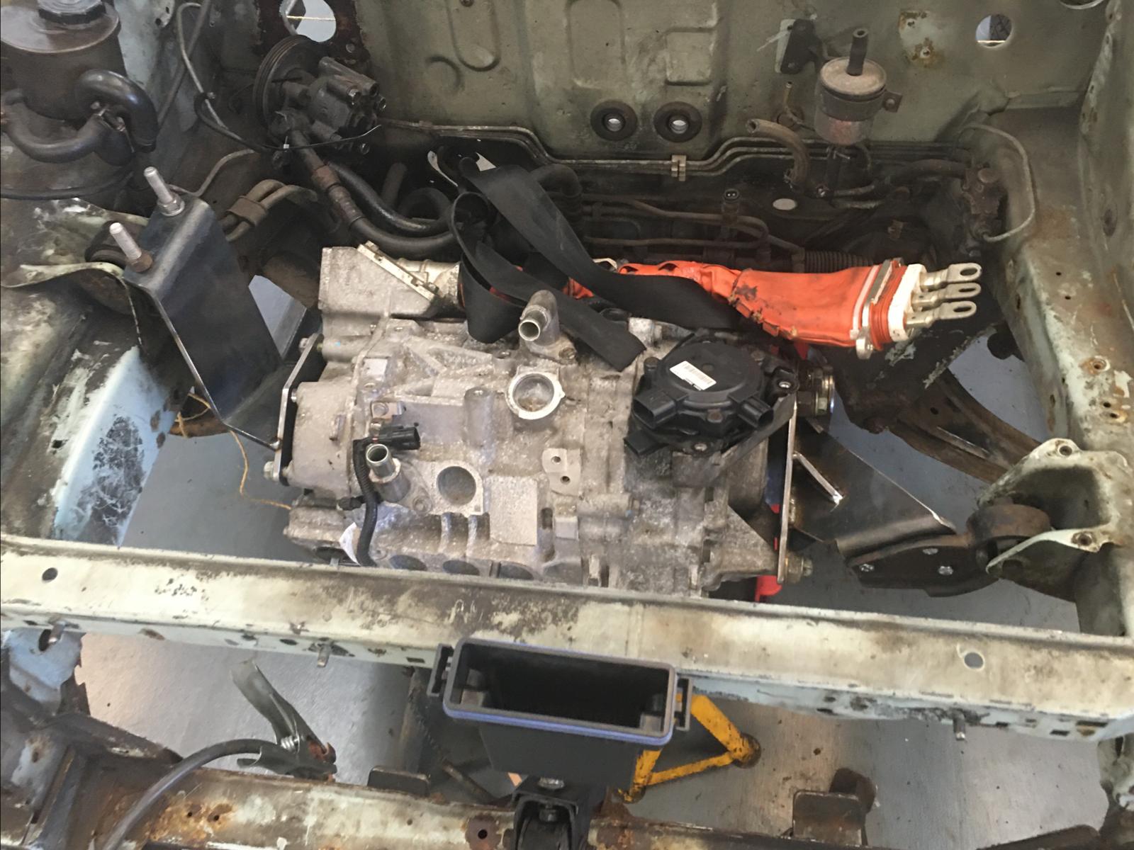

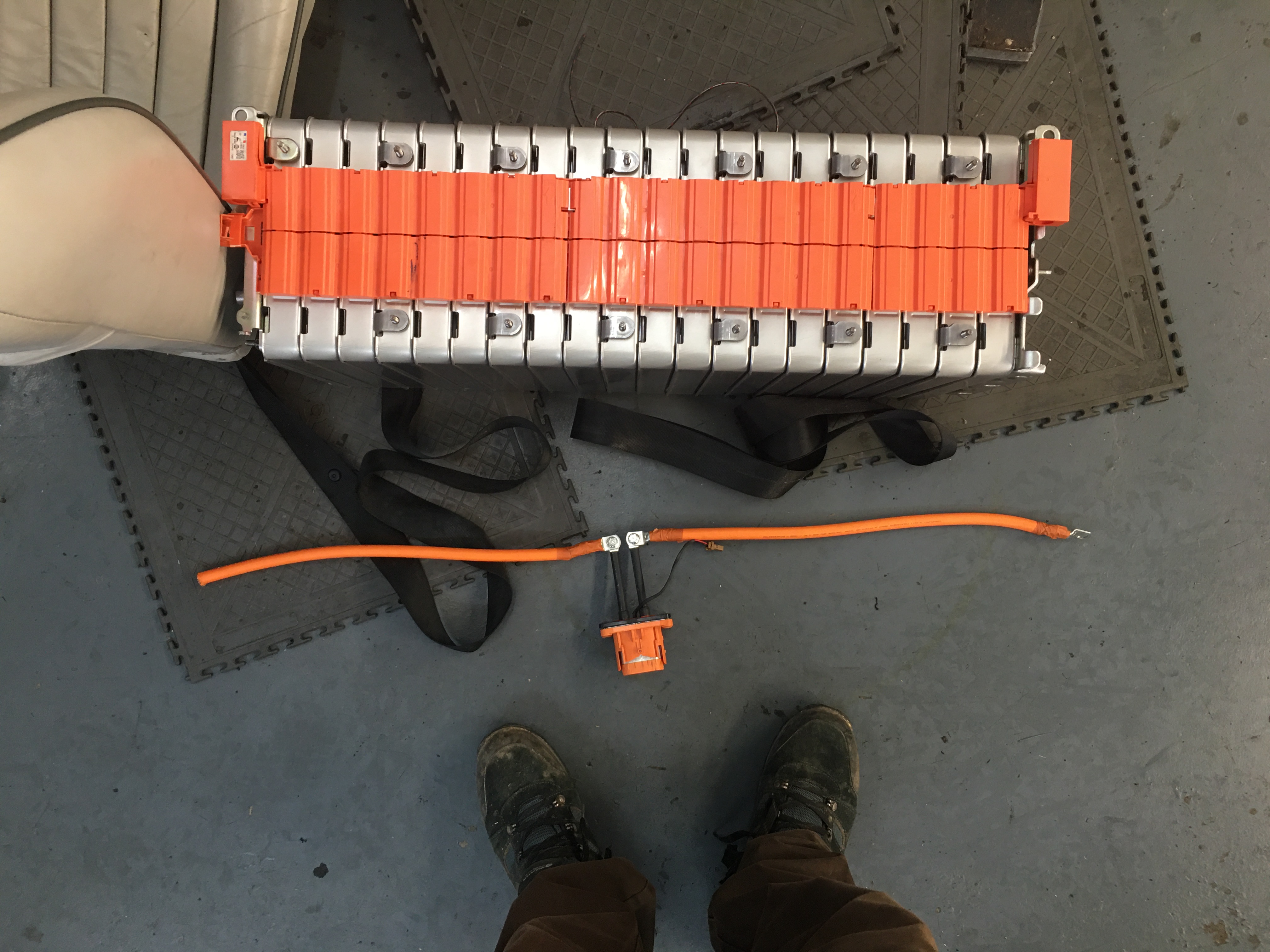

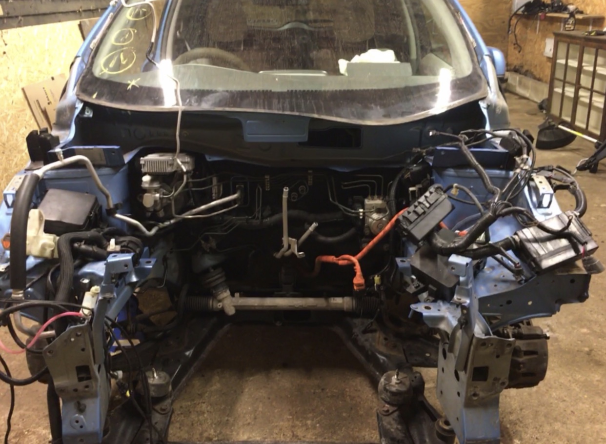

Time for a well overdue update. In my first post we removed all the power electronics from the leaf. The motor and inverter are now ready on a test bed and I have just picked up a Gen 1 Prius battery to test with. Hopefully we should have the motor spinning in the coming weeks.
I also managed to get my hands on the entire front section of a figaro which was bound for the scrap heap. The plan is to suspend the front section on a jig to make fine tuning the motor position and drive shafts much easier. Next, I adapted the Leaf’s original wiring harness to work with Damien Maguire’s VCU. The board will take inputs from the Leaf’s original throttle and send CAN messages to control the inverter.
I still have to figure out how to release the parking actuator located in the gearbox. Once that’s done I should hopefully have some footage to show everyone. Stay tuned and thanks for reading.
Edit: I just released the parking actuator manually. Remove the 3 12mm bolts holding the actuator motor in place and lift it off to expose the splined shaft. A gentle turn of the shaft anti-clockwise by about 10° with a 12mm socket will release the actuator without damaging the shaft.

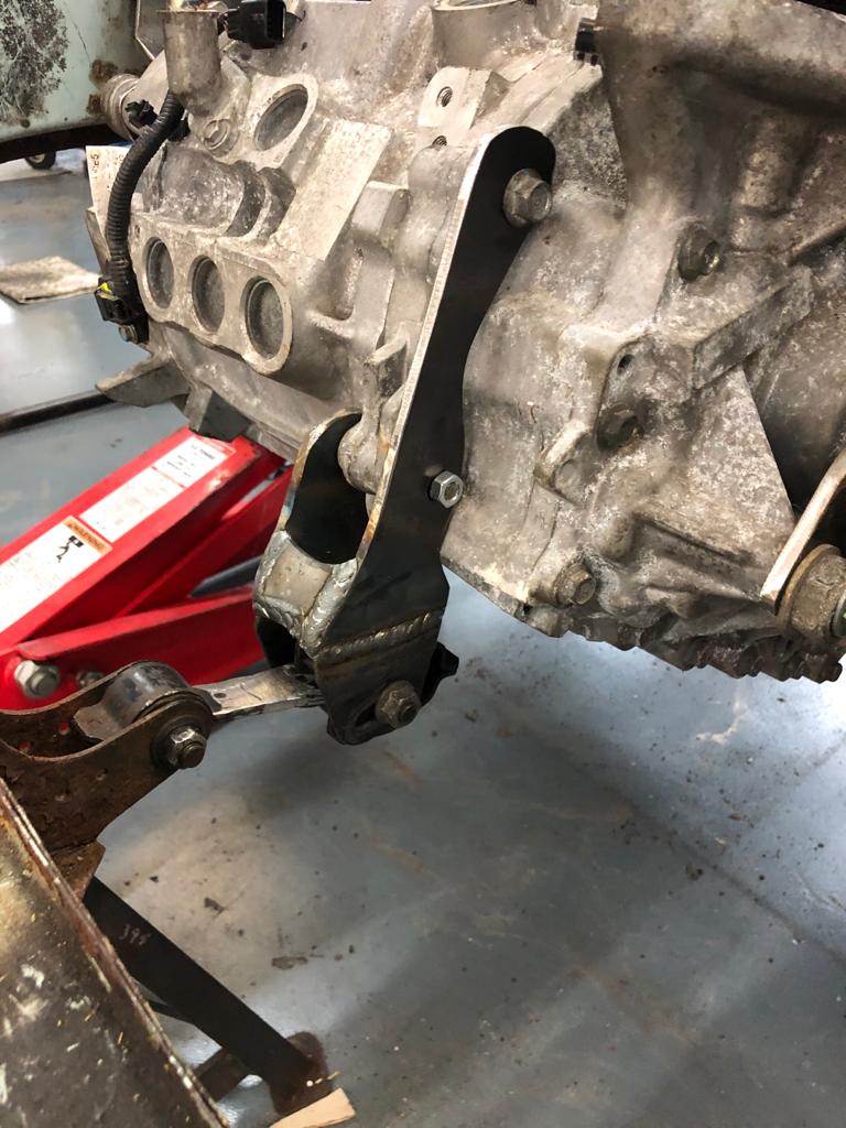

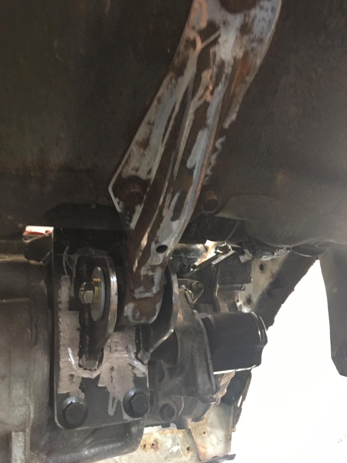

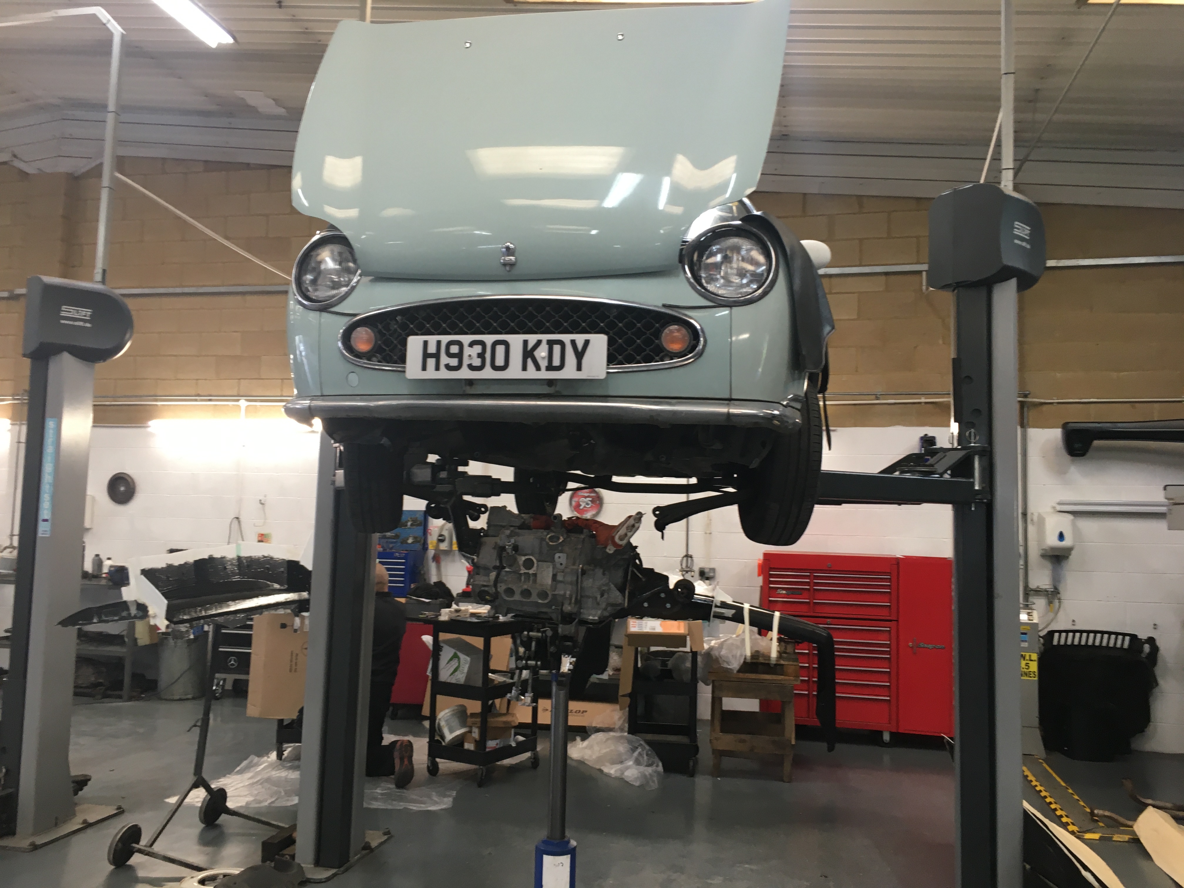

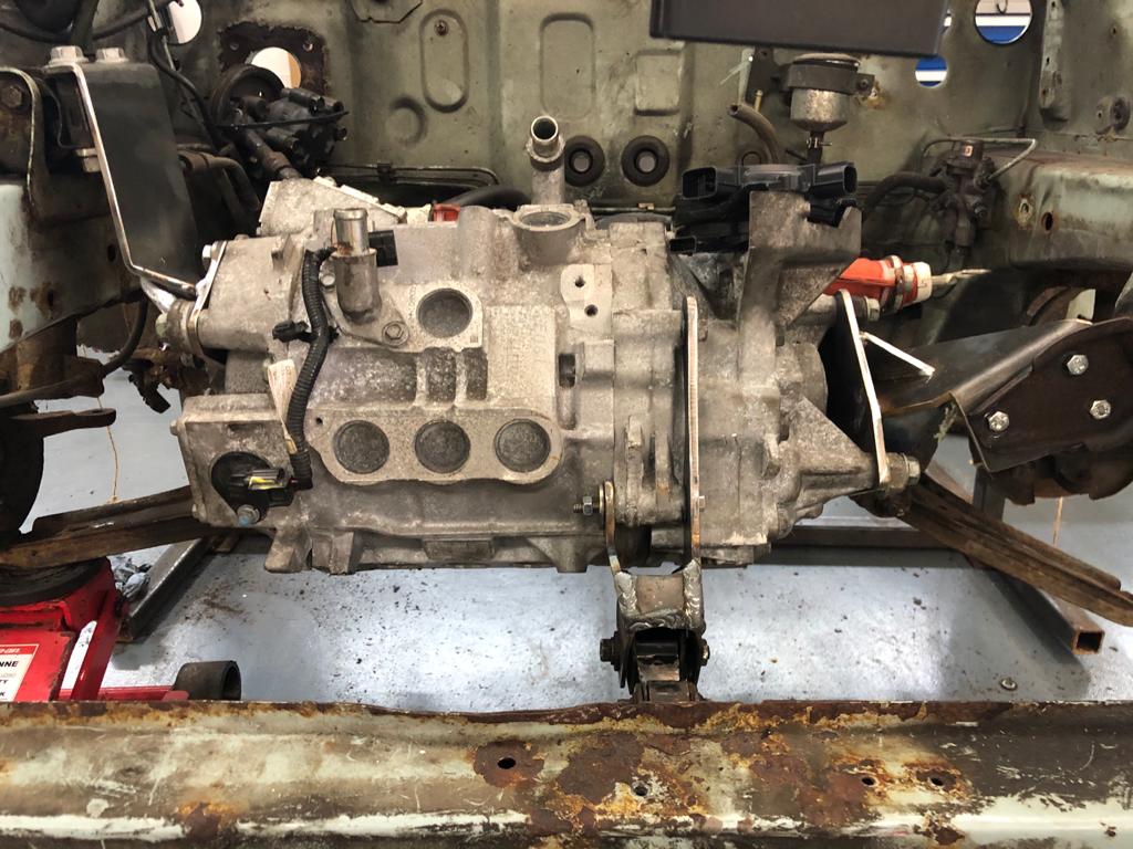

Things are finally progressing with the car, after struggling to finish the first motor mount I was contacted by a friend who also attended the EV Conversion Course last year in Ireland (new course dates will be posted in the events section soon). Pedro at I N Autos in Lingfield, UK and his team offered to help with the design and fabrication so I transported the test rig and our donor Figaro down to them in Surrey.
After much measuring with the car on various mounts to test the full deflection range of the original shafts, it wasn't long before the motor mounts started taking shape.
As you can see they have done a super job of making use of the original engine mounts. The Figaro Shop also make a set of polyurethane bushings we'll be using later on. The driveshafts should be finished next week, so hopefully we'll have some interesting footage soon.

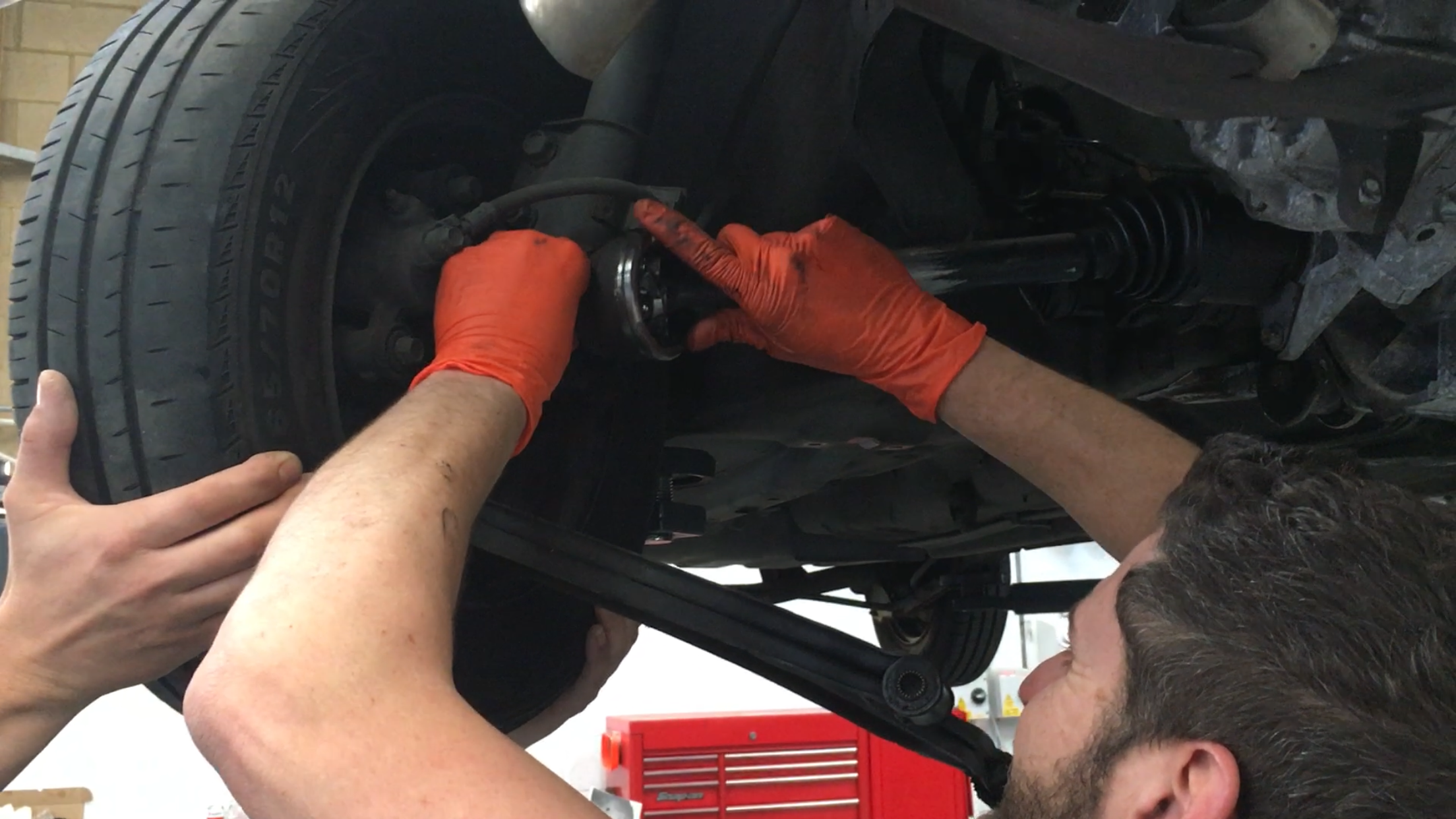

Also there is the thing i forgot to mention before. When splicing shafts you need to observe some rules that i did not...DOH!
For example i forgot to take into account that when wheels sit on ground shafts are almost level and your hypotenuse turns into catete which is considerably shorter. Of course that means to pull tripod halfh way out of its place when cutting shaft to length! When i forgot this part everything was fine except when driving shaft was rubbing the lip of bearing case. I needed to reweld it 20mm shorter which is considerable.

Thanks arber333, we're taking measurements of the shafts at max downward extension (suspended from jacking points), average deflection (unladen weight on wheel ramps) and max upward deflection (max gross weight). Would be interesting to know the wheel to CV length so we can compare? Thanks also to you, MattsAwesomeStuff and SciroccoEV as well for your experience with fabricating drive shafts. We're going to try a couple of different methods, initial shafts will be welded up based on your recommendations. The final shafts will probably be turned from hardened steel to make the DVLA happy

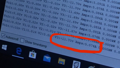

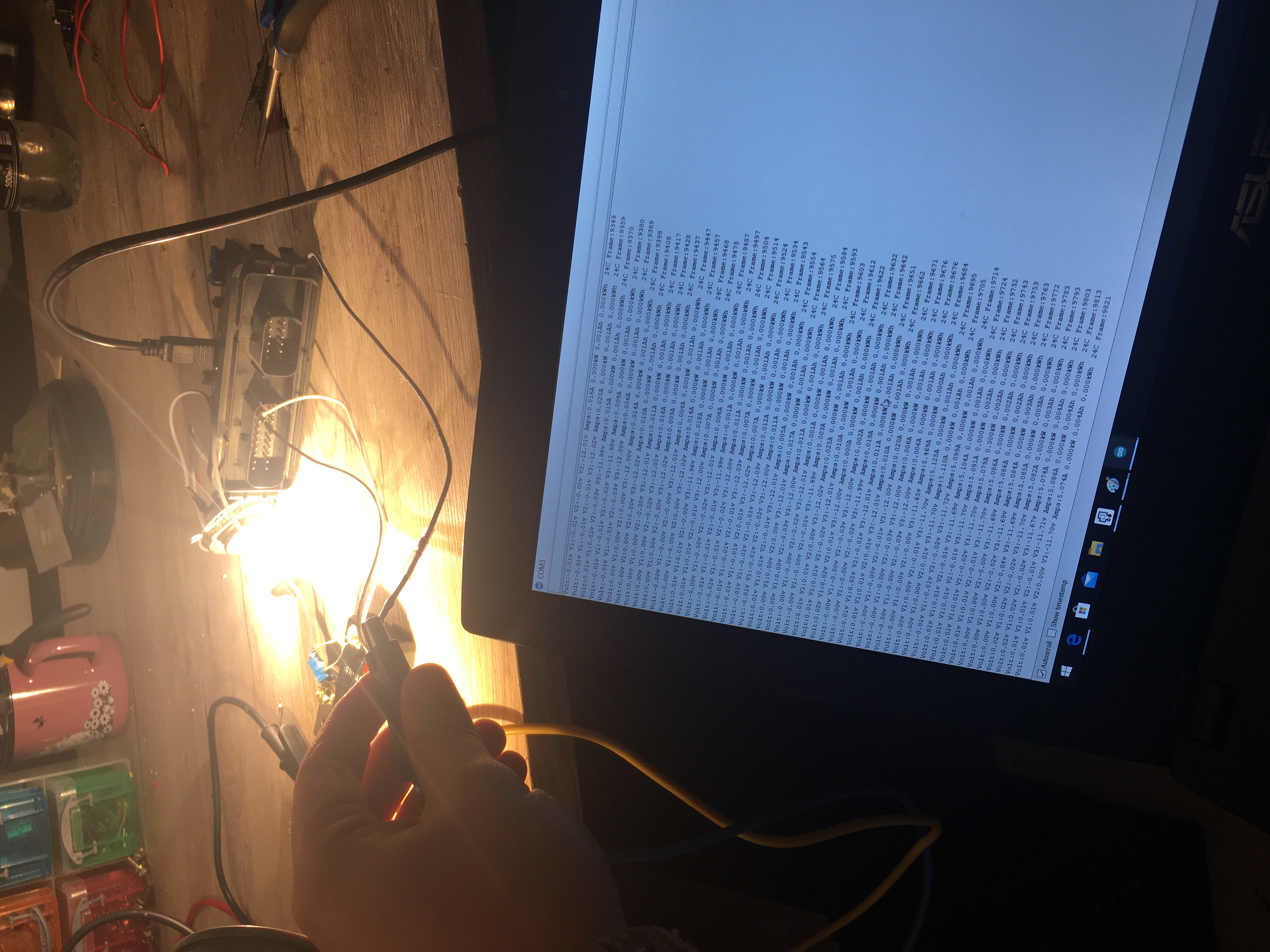

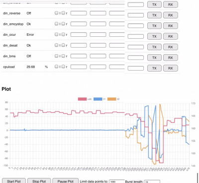

I’ve found the inverter will accept reverse torque commands with the CAN still broadcasting the Drive gear message. The plan is to write a simple negative torque command that is associated with the brake light switch which will cut out at approx 100rpm (to prevent the car trying to go backwards at a dead stop.
I also plan to write in a selectable drive mode which extends the throttle sweep range from say -100 to 2000 trq value with the same 100rpm cutout. That will hopefully make the accelerator pedal act like the e-pedal on the 2018 Leaf (all these values will be tested and tweaked).
Should have the system installed in the car next in a week or so and start trialling the code to make sure it works then will post it on here
