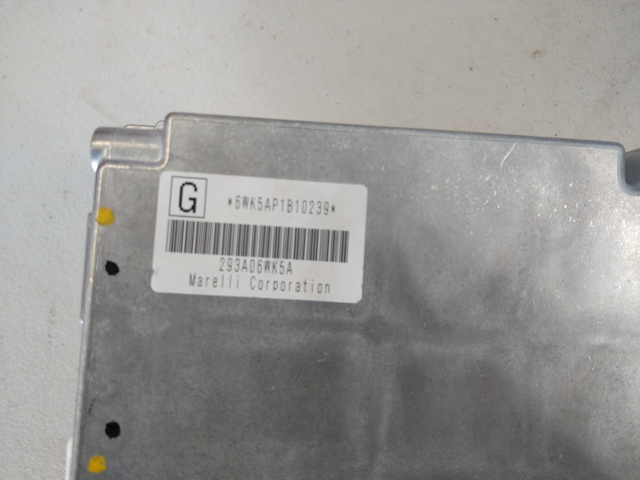

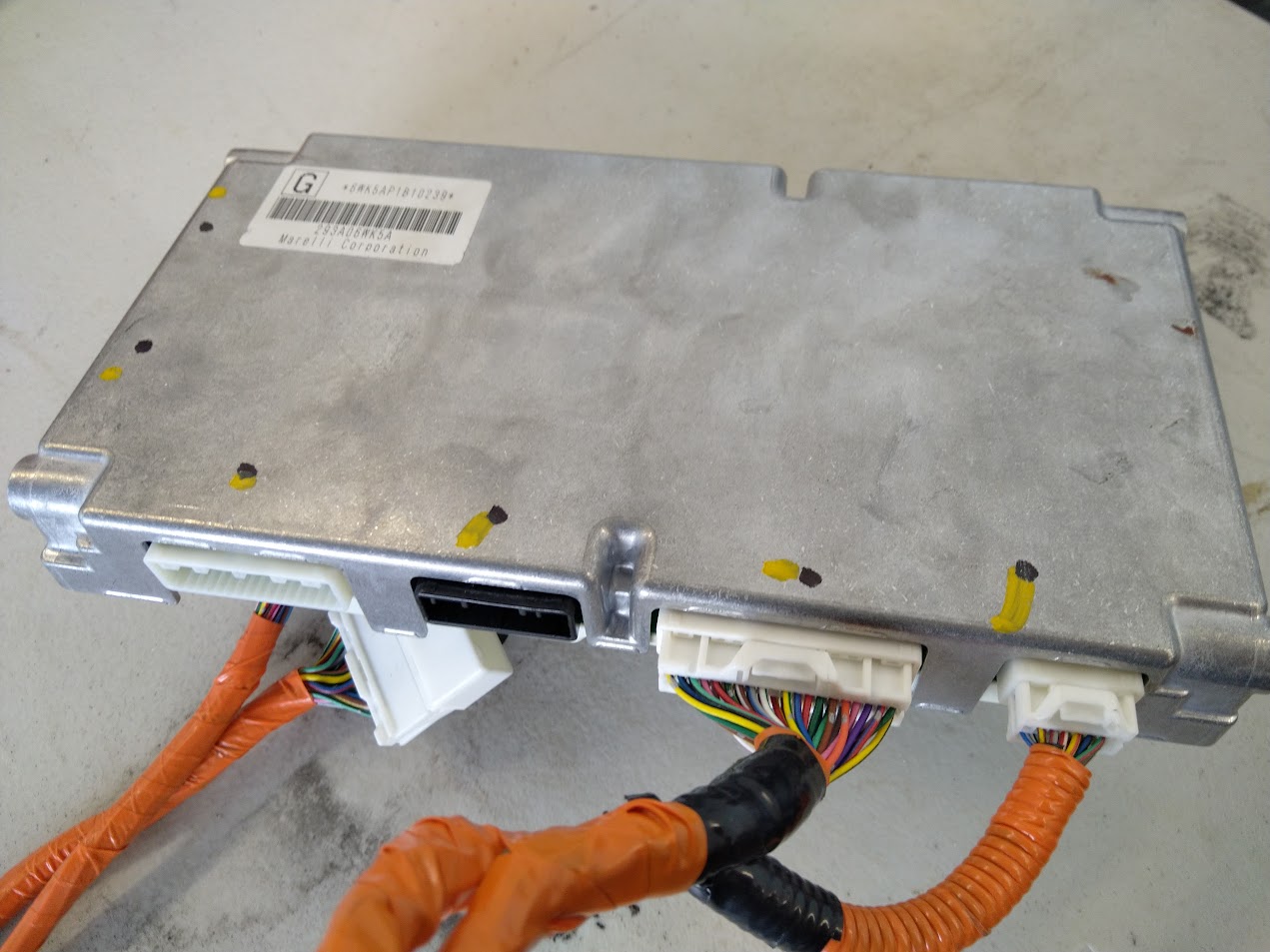

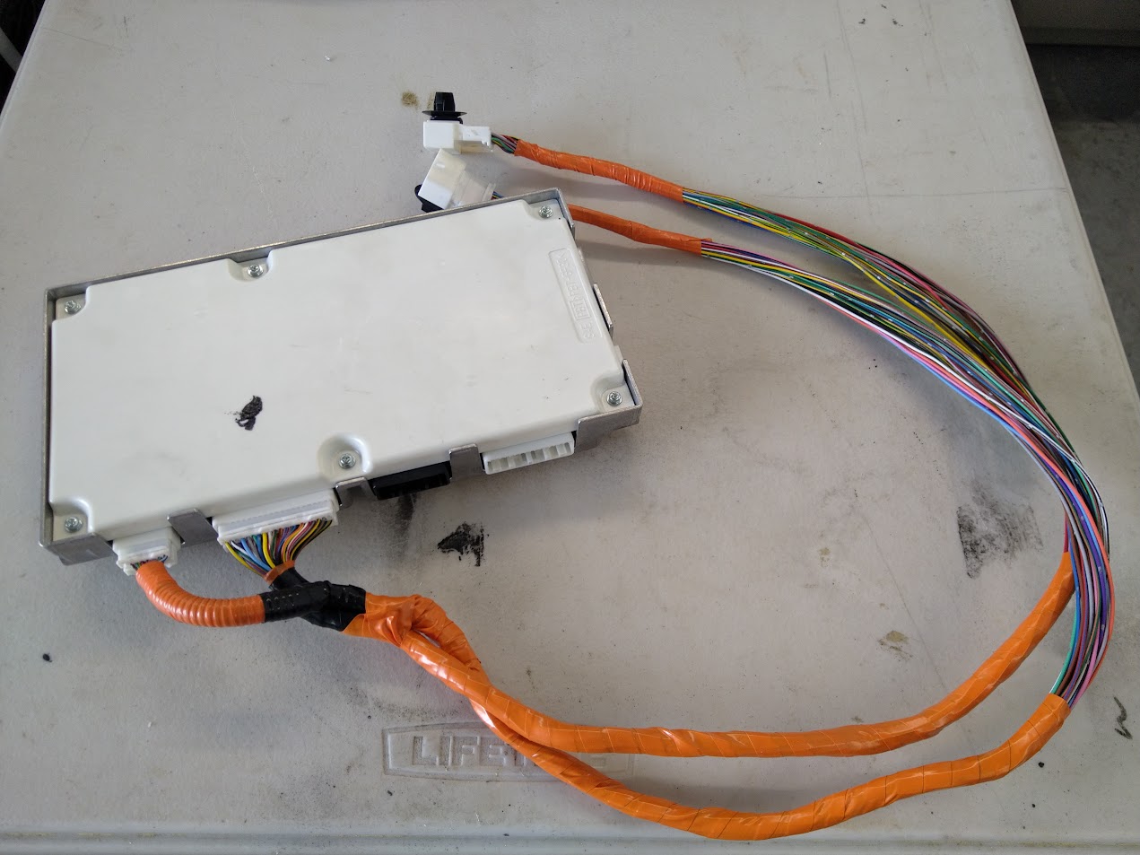

The BMS is the rectangular metal and plastic box with 4 plugs. Then there is also a battery box harness that has the round 36-pin plug and connects to the BMS. The BMS cell taps are located in the orange plastic bus bar assemblies (purple and black wires). You can't really remove the BMS cell taps without dissembling the battery pretty far.
This is the BMS from a 40kwh LEAF:

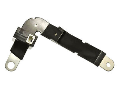

The temperature sensors are also in the orange bus bar pieces.
The current sensor is in the middle near the safety disconnect and looks like this:
